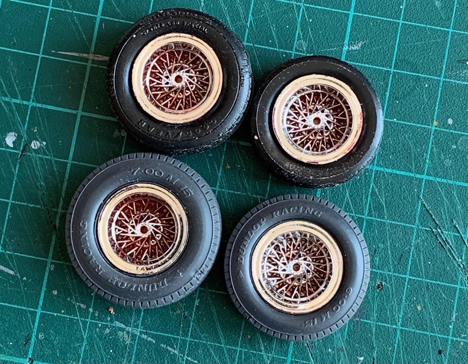

1959scudetto Posted April 17, 2023 Posted April 17, 2023 A few thoughts concerning the wheels: Looking through my stash of kits, I recently discovered that the old Protar 250 GTO (which has been reissued by Revell AG in 2007) has an misshapened body (will be used as a donor for resin kit), but very delicately molded 3-piece wire wheels. Best thing is: it has even 4 parts for outlaced spokes that are not to be used in this kit ! They certainly can be combined with the Italeri back halfs for the Italeri kit tires as well (but these are of the same size front and rear). Here are some pictures (at 10 p.m. unfortunately no daylight pics are possible): on the left the Protar wheels - besides the Monogram chrome tree. The tires are rather crude with Dunlop Racing on the outside and Continental on the other side (fronts) but totally blank (rears): left: Protar front - right Monogram: Here are the rear wheels: from left to right: Monogram - Protar - Italeri I'm not sure if it is possible to tone down convincingly the glossy sticky surface of the Protar vinyl tires, you still have the crude side profile... Maybe I will use the smaller Protar wheels with outside spokes front and Italeris rear. Italeri: Diameter ca. 27 mm, Protar front ca. 26,5 and Protar rear 27 mm (ca. 27,5 mm with Italeri's rims inserted - fits, but stretches the tire a little bit)
