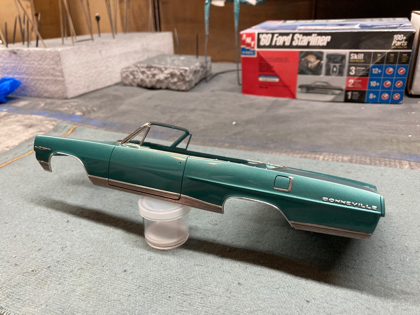

StevenGuthmiller Posted April 16, 2023 Posted April 16, 2023 MCW is some of the best paint you will ever find! Fantastic stuff! The color pallet is nearly endless, and they have a really good handle on getting the metallic paints to look correct to scale. It sprays nice, covers great, and lays down nicely. As others have said, being as it's acrylic lacquer, you can use virtually any kind of primer made for lacquer, and the sky is the limit for clear coat. Personally, I like Duplicolor "primer sealer" under it, and my preference is Duplicolor lacquer "protective clear coat finish" from a spray can in their "Perfect Match" line. One of the advantages of using Duplicolor primer over some others is that should it become necessary to strip the paint for any reason, (I almost never have this happen) it facilitates that process. MCW is without question my go-to paint! Steve 1

StevenGuthmiller Posted April 16, 2023 Posted April 16, 2023 I’ll rephrase that. MCW is just as good as some, and better than most. Or, to put it another way, I don’t know of anything that could be called better. I prefer it over Scale Finishes because the scale of the metallic particles is better. Other than that Scale Finishes is extremely good and comparable to MCW, and between the 2 of them, I can honestly say that I know of nobody else who offers a more comprehensive selection of factory stock colors. Steve 1
