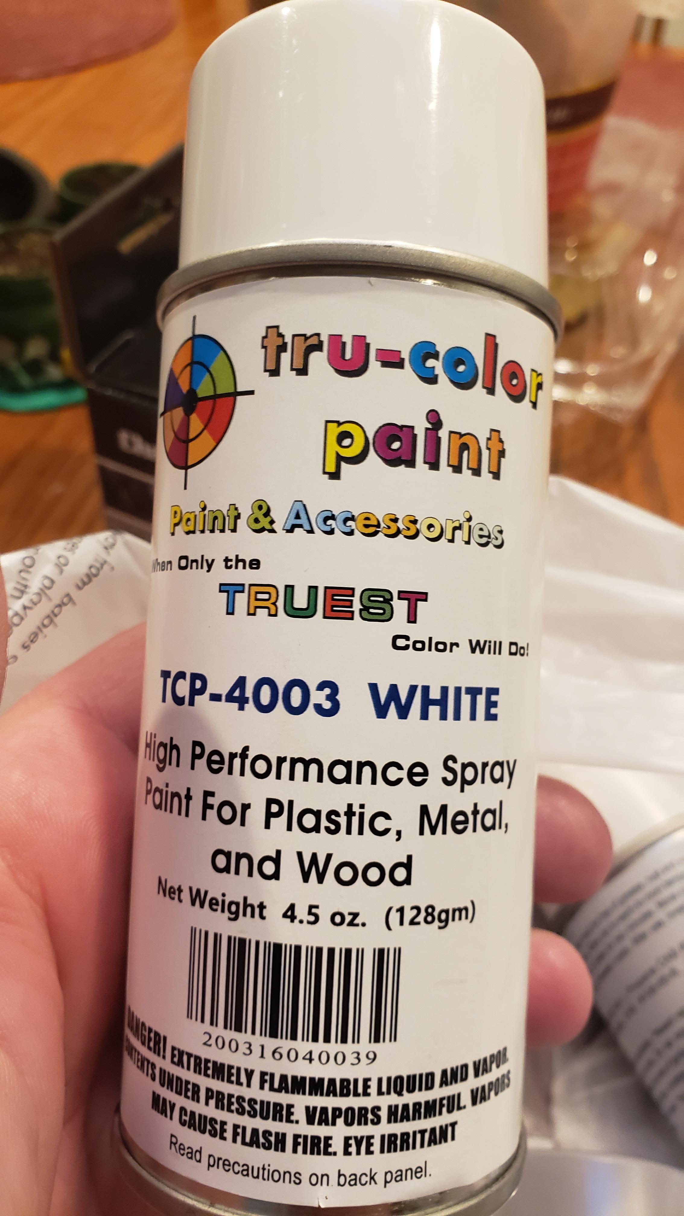

jjsipes Posted April 17, 2023 Posted April 17, 2023 Has anyone used this paint line before? Getting harder to find paints since it seems Testors is going away. I picked this up at my local hobby shop.

SfanGoch Posted April 19, 2023 Posted April 19, 2023 Tru-Color paints are excellent. Large and expanding range of automotive, armor, naval and railroad colors. They can be mixed and blended to create custom colors/shades. They are acrylic solvent-based, containing a small amount of acetone. That said, don't get creative by thinning them with acetone or lacquer thinner. From the Tru-Color FAQ: Quote Although Tru-Color Paint contains a small percentage of acetone we DO NOT RECOMMEND that acetone be used to thin (dilute) the Tru-Color Paint. Adding just acetone to thin Tru-Color Paint may harm the intended gloss or semi-gloss finish our paint is intended to give as it will dry too fast. Also, too much acetone will cause the solvent system to evaporate too quickly during air brushing causing the painted surface to appear rough and/or it may blush. Tru-Color Paint can be diluted, if needed, for ease of application. Please use TCP-015, Thinner, or TCP-310 Retarder for dilution of Tru-Color Paint as it has the blend of solvents that will not interfere with the drying time or the gloss or semi-gloss finish that Tru-Color Paint is intended to give. 1
