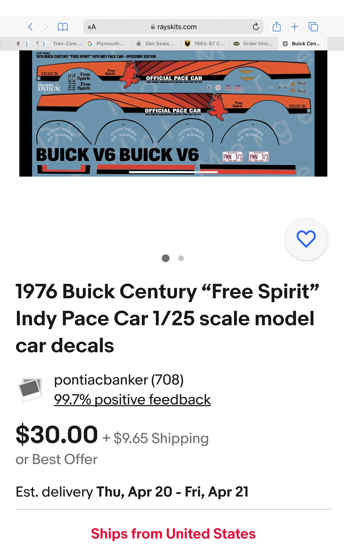

Here's a link to decals :  [see below]. While I cannot personally attest to the quality of Ray's decals, other members have used them and the positive reviews are numerous.
Ray's stuff is great...he includes interior, underhood details also.
 I'll hafta find the link ...but there's a gentleman here in the states that's selling Rays decals & works closely  with Ray.
  • Like 1

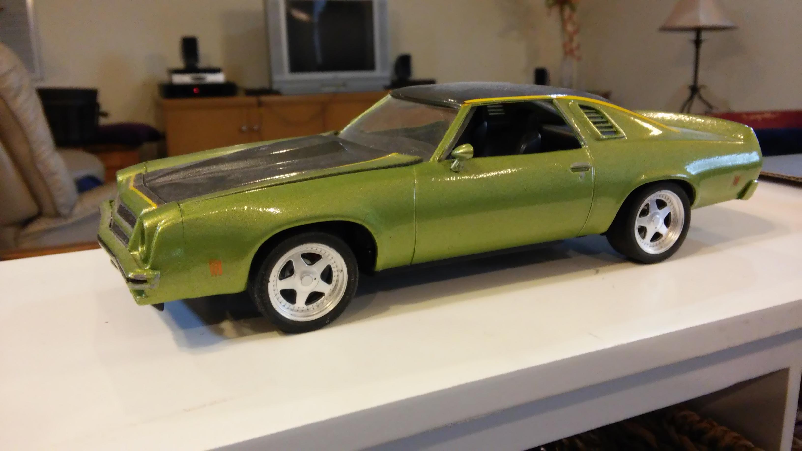

That was my Laguna S-3. I built a replica of my real car. If you want accurate interior, use the parts from a Revell 77 Monte Carlo Snap Kit. They are real hard to find now, but I have some spare parts I would donate to the cause.
