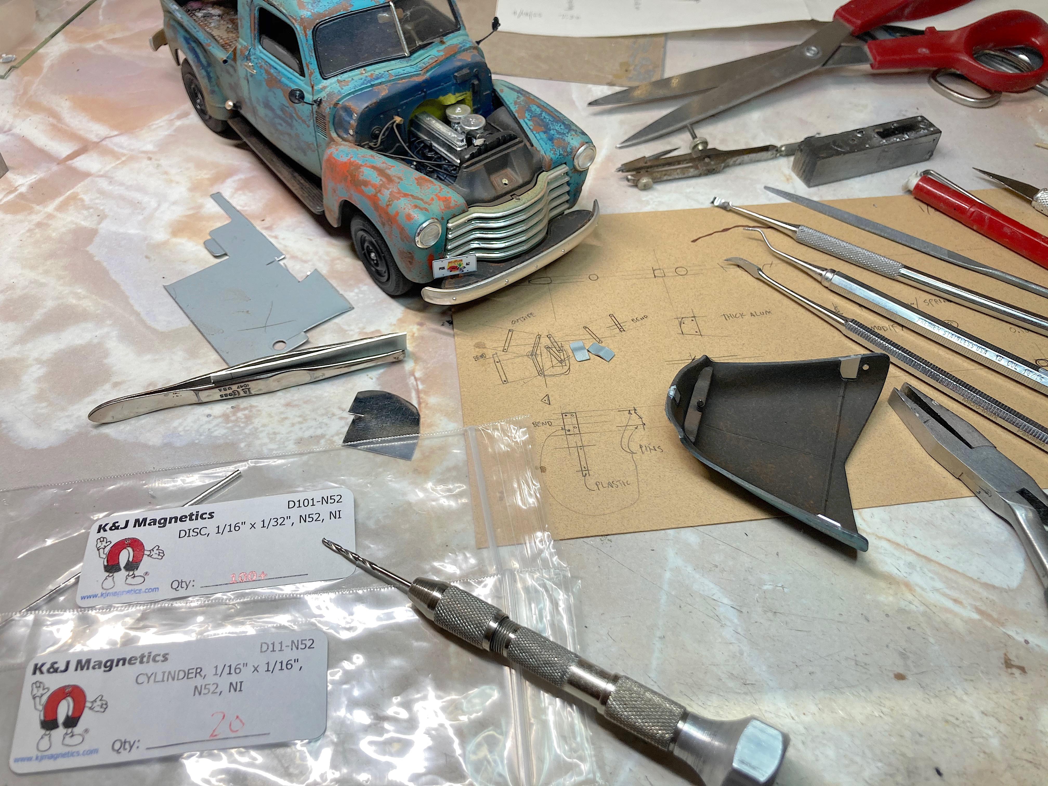

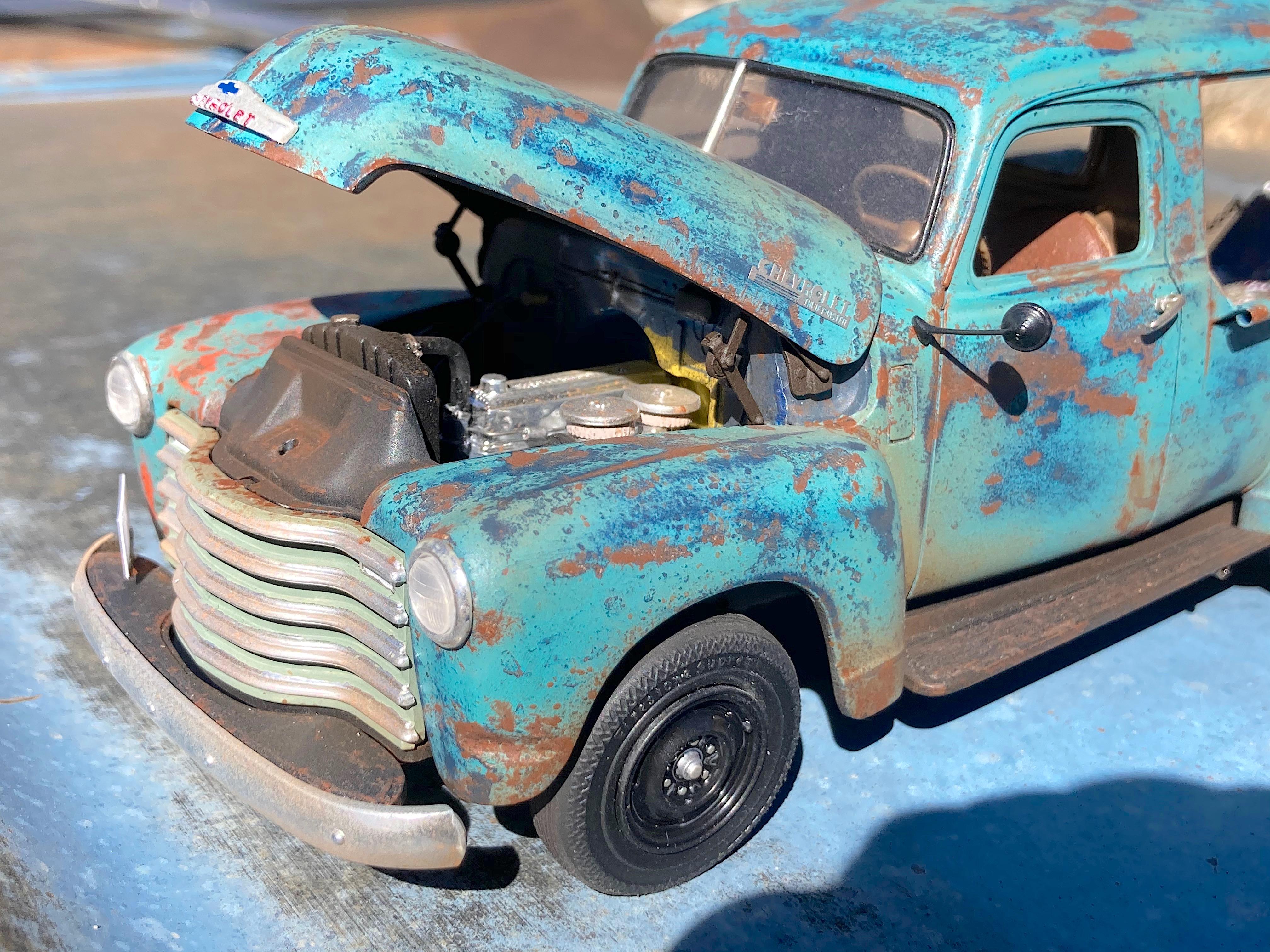

89AKurt Posted April 19, 2023 Posted April 19, 2023 I'm improving the hood on a previous build. A pet peeve is how the hood loves to fall off and hit the hardest surface around, on the pointiest part. ? Even if you don't make a hinge (in this case not operable but looks real), this trick will be an improvement. Obviously if it's not a '50 Chevy, the placement will need to adapt. Materials: K&J Magnetics (website on label), steel from something like a coffee can. In this case, I used thick aluminum so it wouldn't be effected by the magnet. Video demonstrates that I figured out how to make something work. 3

StevenGuthmiller Posted April 19, 2023 Posted April 19, 2023 I haven't used these magnets for holding the hood in place, but I have seen them used for this purpose. I have used them on recent builds, (including my current project) for creating removable hood hinges. Short of making actual operating hinges, this is a nice way to tackle the "hood prop" display issue. It not only eliminates the need for a hood prop for display with the hood in the open position, but it also allows for removing those unrealistic slots in the firewall or fender wells where the kit provided hinges slip into the body. An added benefit not afforded even by actual functioning hinges is that you now have 3 display options. Hood on, hood open, and hood removed completely for more complete engine viewing. The only drawback is the fact that this method requires that you keep track of your separate hinges when the hood is not displayed in the open position. Steve 3

89AKurt Posted April 23, 2023 Author Posted April 23, 2023 I should follow up, and say the two on each side work with the opened hinges. 1
