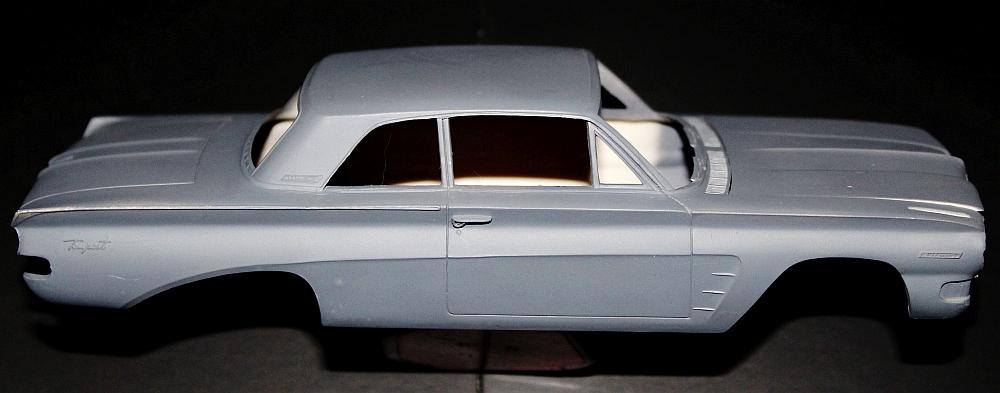

SfanGoch Posted May 3, 2023 Posted May 3, 2023 (edited) 20 hours ago, Dave G. said: I use Stynylrez and have been for about 7 years now. It's smooth right from the bottle and thinning as you've mention all work. Here's one for you though, baby bottom smooth, egg shell sheen finishes thinning with Lacquer thinner. Revell '62 Lancer GT and AMT/SMP '62 Tempest primed with Stynylrez Grey thinned with 70% IPA. Unlike Mr. Hobby or Tamiya primers, Stynylrez won't come off if you wipe the parts with an alcohol-moistened tissue. Edited May 3, 2023 by SfanGoch 2
SfanGoch Posted May 3, 2023 Posted May 3, 2023 Thanks, Dave. Stynylrez is an excellent primer when using Scale Finish, MCW and other automotive quality lacquers. Absolutely bulletproof. It goes on and dries so smoothly that no sanding is required.
