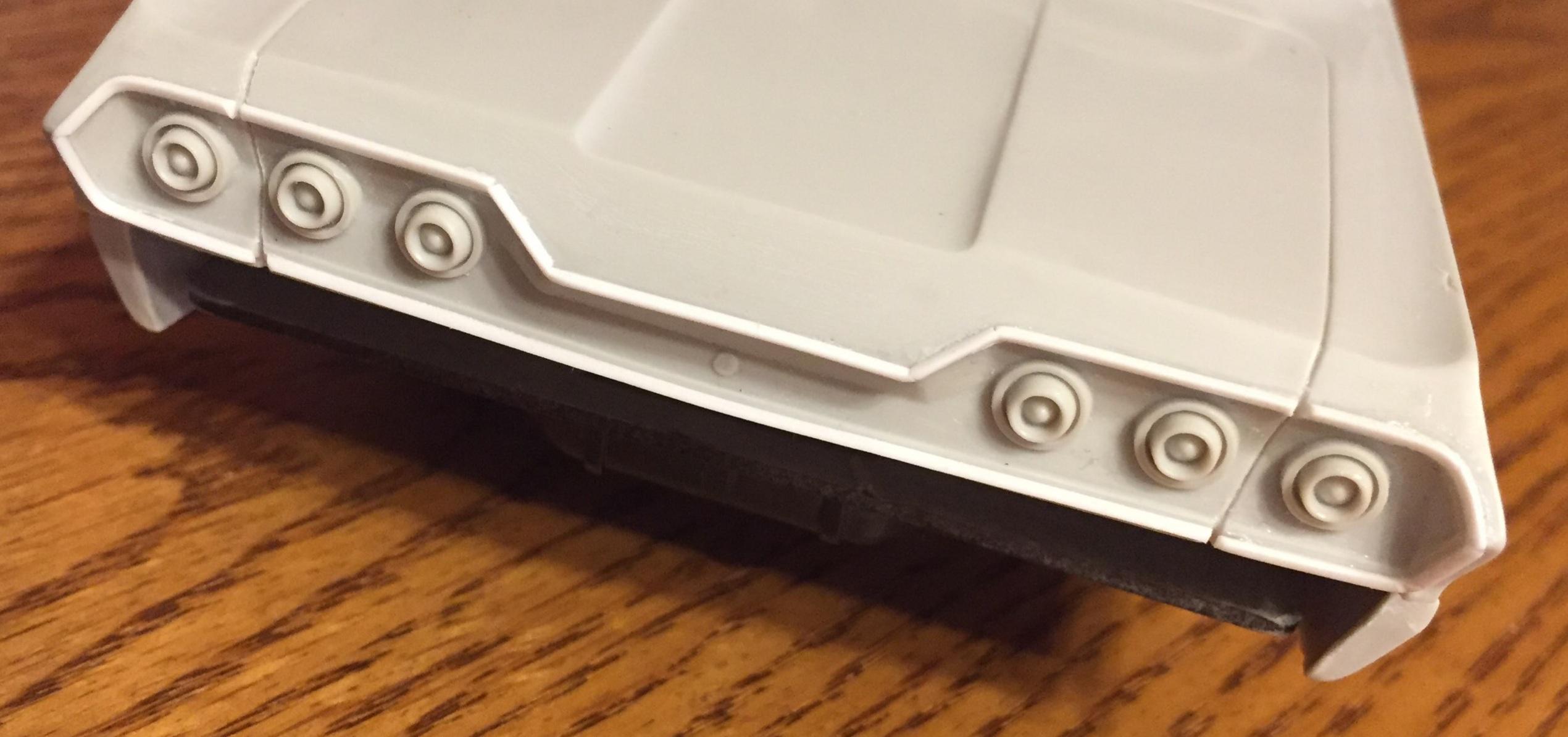

Thanks for your input, Richard, I'm not sure what to do with those pesky tail lights. Maybe drilling them out and frenching or some other custom treatment. I've got to explore my options yet. The flash on that rear panel was horrific.  I used Plastruct triangular strip for the trim. The '63 is a cool body style but not my favorite among '60s Impalas.

...I'm not sure what to do with those pesky tail lights. Maybe drilling them out and frenching or some other custom treatment. I've got to explore my options yet...
Making molds of the lenses wouldn't be very difficult with the right materials, and casting them in a tinted clear epoxy or polyester would also work...with the right materials.
If you have a lathe, turning them from red tinted acrylic rod would work well.
EDIT: For that matter, you could turn some custom bullets from red sprue, using a drill motor.
Or somebody on feePay is doubtless selling something that could be easily adapted. The pair below is about 10 bucks plus shipping.

The Revell '63 Impala tail lights would work. So would the Revell '64 Impala's. Check fleabay for both and look for parts under each.

Totally agree on the P.O.S. comment on this kit.  But, afterall, it is old and not a conventional model.  I did mine curbside, and I guess you can say I "frenched" the taillights after drilling them out. I posted pics mine a few weeks ago .
I just looked at yours, Mike, it really looks great in bright red. Got me thinking.

The one I just finished in the under glass section I used clear red sprew, chopped the ends flat, and drilled in about a 16th.  Then added curved fine wire from the strands of a junk electrical bus to fill in the middle trim.  I should have used clear sprew on the middle backup light, but oh well.

The tail lights and the lack of a firewall seem to be the biggest sticking points for most people with this kit, but they’re both pretty easy to remedy with a little kit bashing.
The tail light lenses could be drilled out pretty easily, and I have to believe that between the AMT ‘62 and ‘64, and the Revell ‘62, ‘63, ‘64 and ‘65 Impalas, one of them should work for replacement lenses.
Likewise, a firewall, and/or chassis from almost any one of them would probably work as well.
