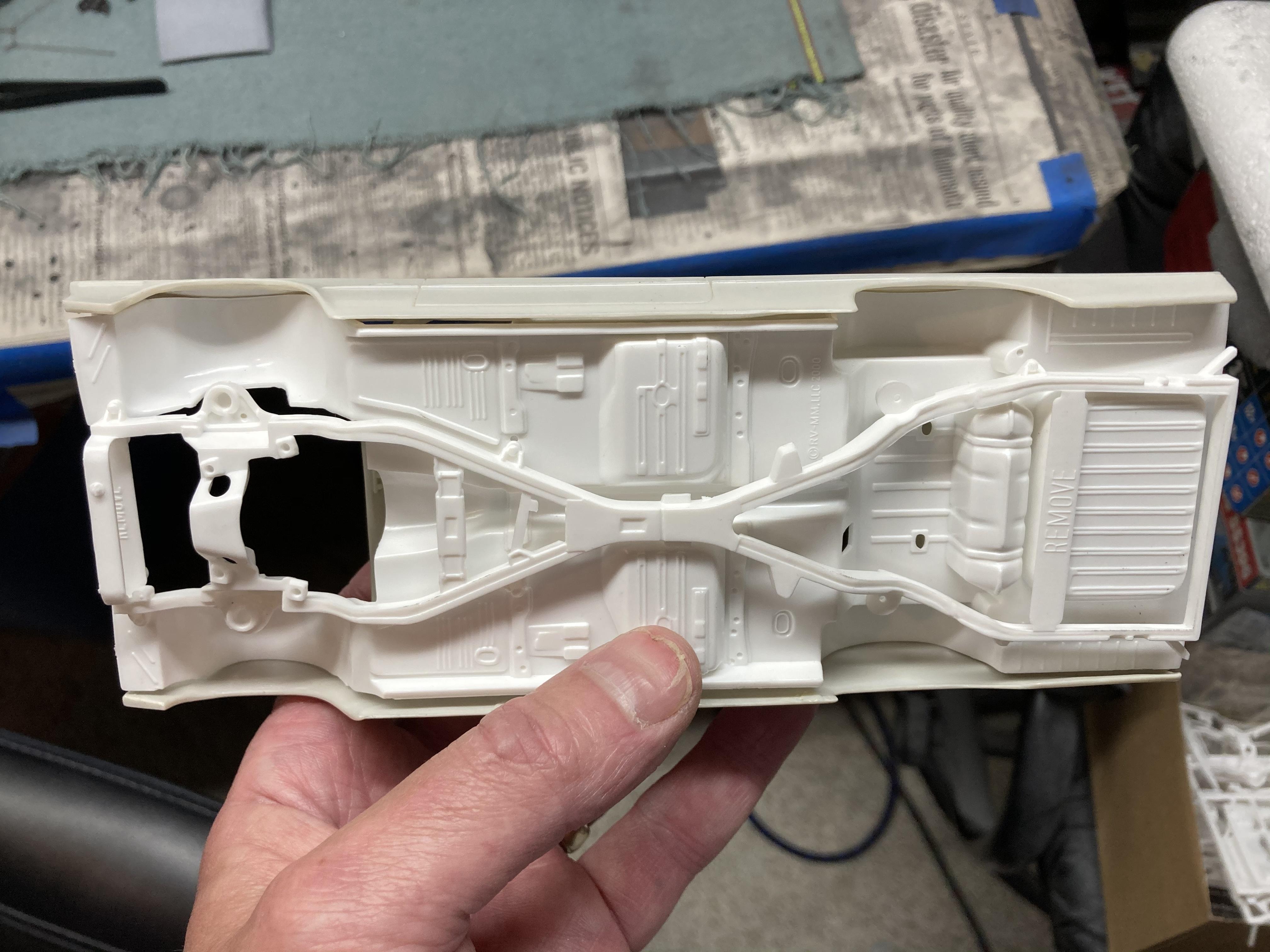

If it's not too late, you might try parts from AMT's 62 Bel Air kits.  Their were several versions a while back. That kit is a modern design with all separate chassis parts you could use the entire chassis with a little work and the firewall fits the 63 kit.  I did a quick mockup and it's almost a "bolt in".
Thanks for your attention and comments. I do have those '62 kits and I believe it's the way to go.....if the object of my affection was the '63.

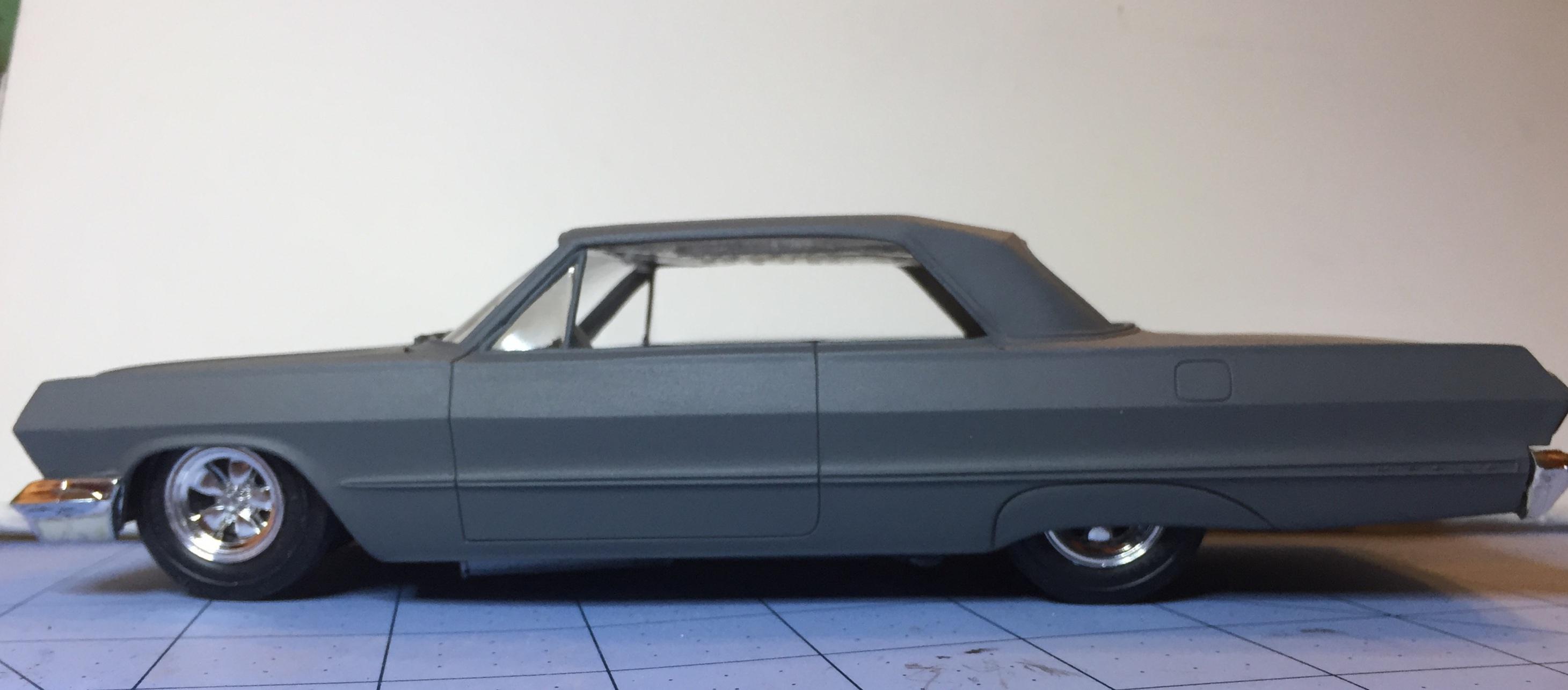

On 5/8/2023 at 8:32 PM, customline said:
The kit engine ain't that bad, is it? It just needs a little love ?.  I was able to actually drill 9 separate holes in the distributor!  It is wired with the correct firing order (I never do that.) I added an oil filler and generator brackets. Although It does not has a separate oil pan (a big plus), you can't see the block of plastic that serves as a carburetor once the air cleaner is in place. When heater and radiator hoses are finally added it will look just fine. I dunno, ladies and gentlemen, I find it acceptable ?. Maybe I'd change out that weird fan. Looks like some horrid disease. Why would there be rivets on the fan blades? Ace?

The kit engine ain't that bad, is it?  It is that bad. Compare it to the 1964 Impala with its 409. The valve covers are a funky shape. The last issue of the amt 63 impala was the drag set with the the Chevelle funny car which had no engineSome time in the mid seventies AMT re-engineered this kit fo maybe another Countdown kit? ERTL brought it back from the dead in the Prestige series.

Well, OK...the engine is not great. It won't look bad in a barn find or a beat-up truck.

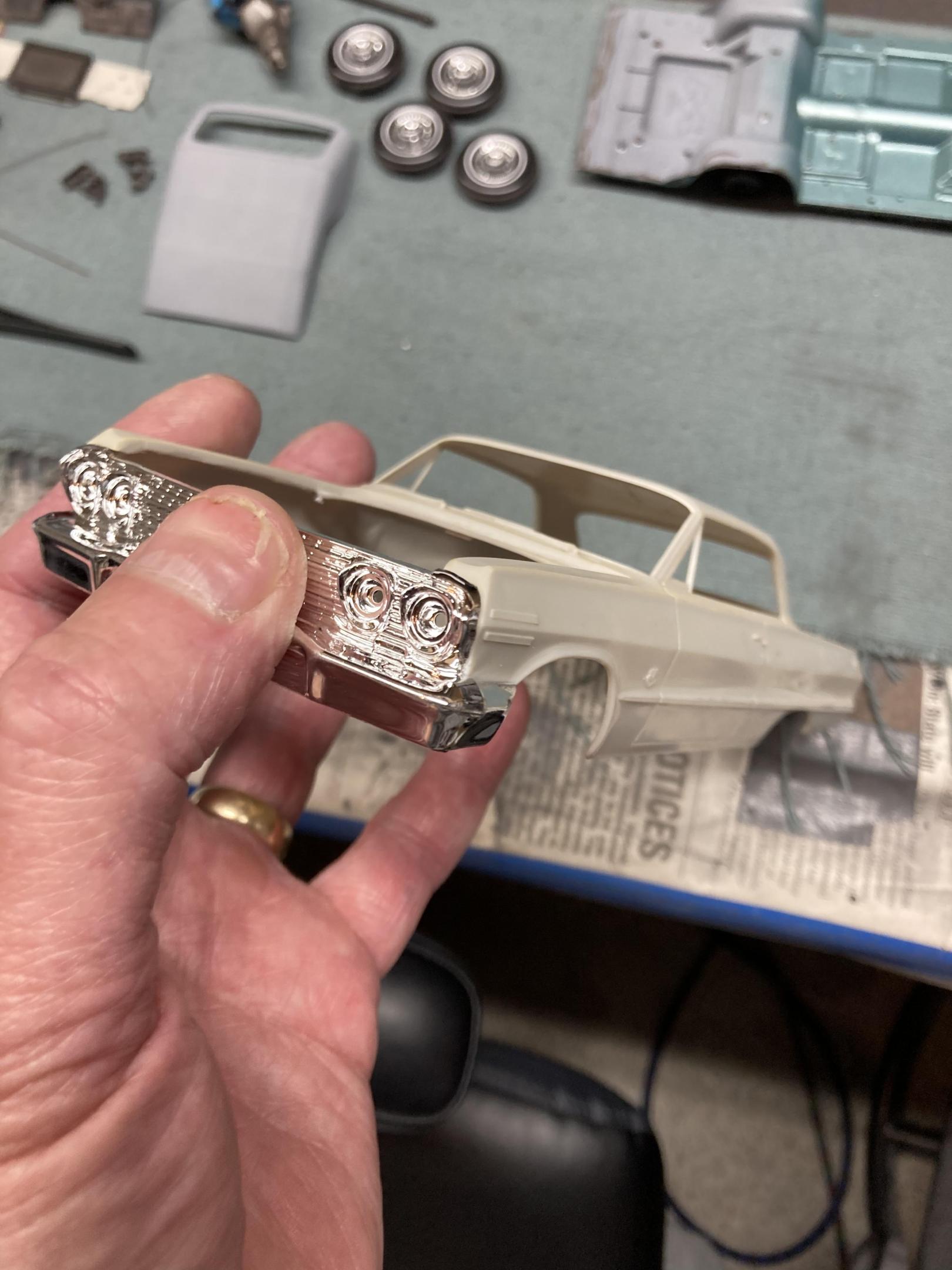

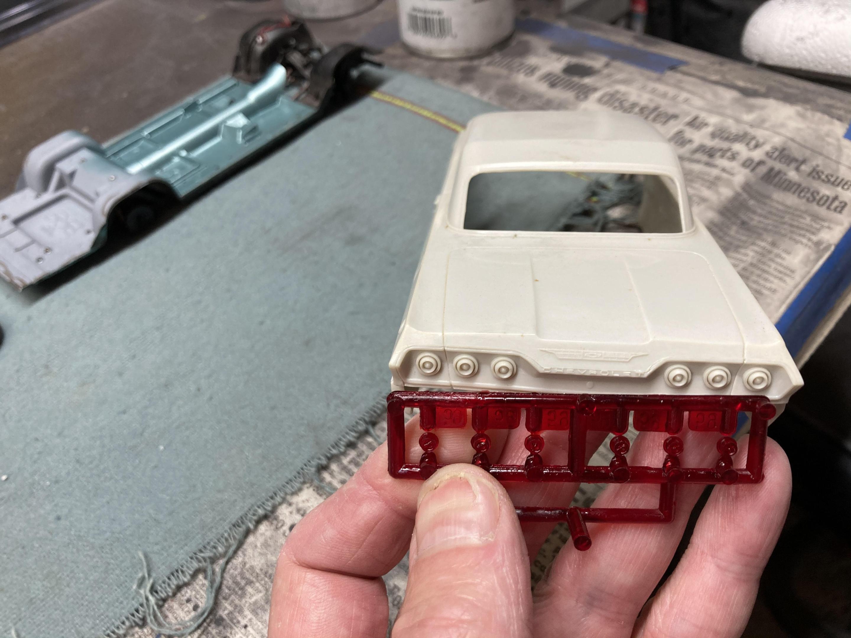

Now I’m starting to think that I should build one of these AMT ‘63 Impalas.
Decided to pull out the boxes, and all of the discussed issues in this thread would be easily addressed with some kit bashing.
Easy operation to drill out the tail lights and replace with the lenses from the Revell ‘63.
The Revell interior is very nice compared to the AMTs, and the chassis from either the Revell ‘63 or ‘64 drops right in.
Hell, even the Revell grille fits the AMT! ?

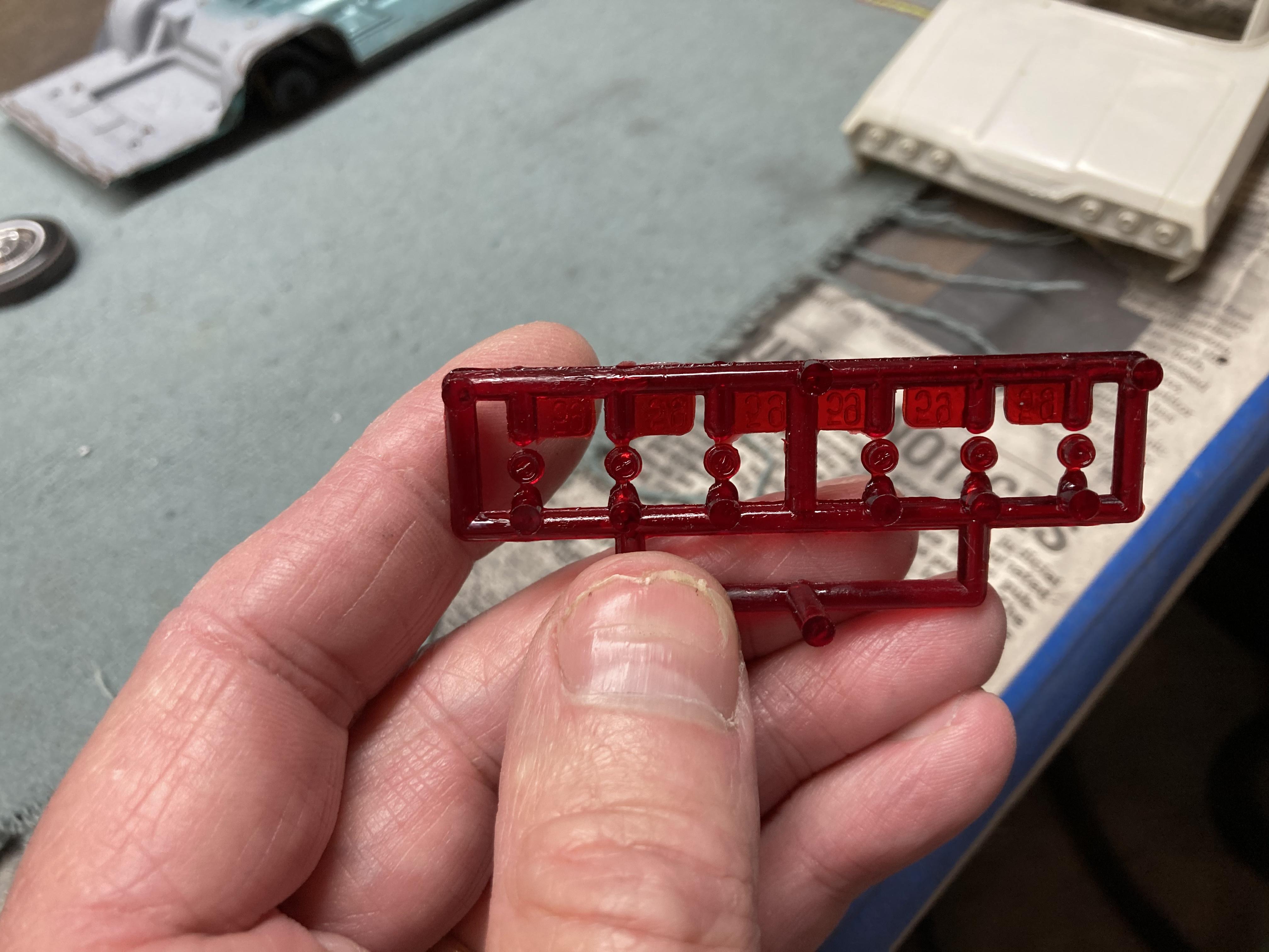

Not the best picture of the taillights but I drilled them out and used the custom lenses (kit comes with one set for only one side so a aquired another set) and used them.

Not the best picture of the taillights but I drilled them out and used the custom lenses (kit comes with one set for only one side so a aquired another set) ....
I wonder if anyone ever built the radical custom version. ?.   The rear treatment is the most bizarre idea I've ever seen.  It makes no sense at all. Who would do that?
Yours looks pretty darn good, Mike.  Red works really well on this body style.  Since I have committed to building this as a very mild street custom, I will explore the "bullet lens" angle. I think it's my best chance for success.
