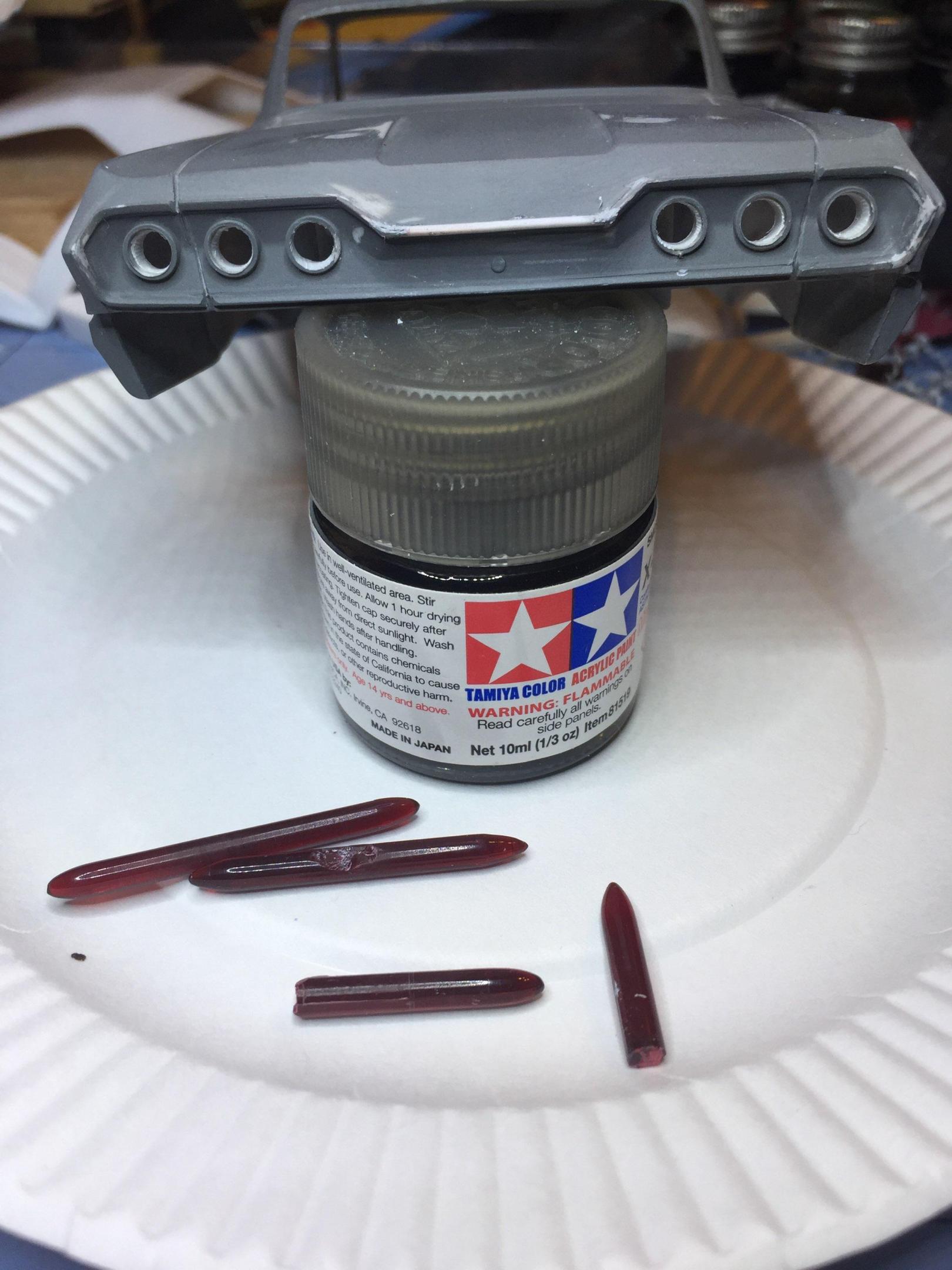

horsepower Posted October 21, 2023 Posted October 21, 2023 On 5/19/2023 at 2:17 PM, customline said: OK, I did it. I made bullets. With my Micro. On low. ?. Problem is the clear red sprue stock is not really round. But it fit in the Micro and I was off and running. I'm happy with 'em and that's all I'm saying. ?. I also drilled the lights out. I'm commited. Done deal. Wish me luck. Want to add a really cool little vintage touch? Pick up a package of multi color sew on sequins at the local craft store and if you look closely in the bottom of the little bag you'll find a bunch of the little dots that are from the centers of the sequins where they punched the hole in them. Just pick out the blue ones and file a tiny flat spot on the ends of those cool bullets you turned and touch it with a straight pin point with a super tiny bit of epoxy, or clear enamel and drop on that little piece of the sequin and voila! Instant (well almost) blue dot tail lights.
horsepower Posted October 21, 2023 Posted October 21, 2023 On 5/20/2023 at 6:19 PM, customline said: Yup, that's what I did. The material (clear red sprue) that I had to work with was not consistently shaped (round) and I had a bad time making a .....anyway, I will be looking for more sprue to work with because I don't like the ones I made. Gotta go through my kits. Thanks for your thoughts, Joe. Try epoxying the sprue into a couple of aluminum tubing pieces so they will spin truer in the drill chuck and use the tubing to start the trueing process and the tubing you're gonna just hack off anyway when you get done. Or you can pick up some round transparent rods and dip the finished light into the transparent red and some clear if you can't find red, but clear and the fluorescent colors like orange and red can be tinted with transparent red easier than the clear even.
