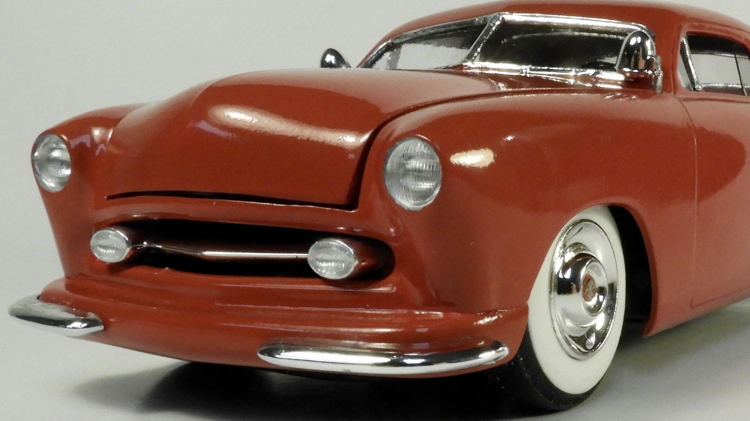

slownlow Posted May 10, 2023 Posted May 10, 2023 The parking lights here just have a drop of 5 minute epoxy over the chrome lights. I think it turned out very well and with much less work. 1 1
peteski Posted May 10, 2023 Posted May 10, 2023 1 hour ago, slownlow said: The parking lights here just have a drop of 5 minute epoxy over the chrome lights. I think it turned out very well and with much less work. That looks great now, but in few years epoxy will turn amber/yellow. making the headlights look like footlights. I got burned by this more than once. I tried about half a dozen of 5-minute epoxy brands, and they all yellow in time. I finally learned my lesson and no longer use it when I was a clear part. This yellowing is pretty much exclusive to the 5-minute epoxy. Longer cure epoxies do not yellow (or yellow less drastically, and it likely takes longer time). I highly discourage anybody from using 5-minute epoxy for parts which are to remain colorless clear. BTW, I'm really surprised how realistic those parking lights look. I would never have guessed that it is just a thin coating of epoxy over an opaque chromed domed lens molding. The way lights reflects in them looks like there is concave reflector behind the lens.

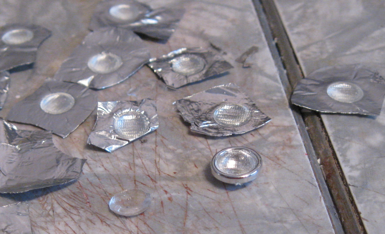

Can-Con Posted May 10, 2023 Posted May 10, 2023 (edited) 5 hours ago, Ace-Garageguy said: EDIT: Something else to remember is that there are only two standard sizes for US sealed beam round headlights, and only two for rectangular as well, so there aren't that many molds you'll need to make. True Bill 5" and 7". , , BUT, you have 1/24 and 1/25 scales not to mention there's a LOT of variation in that "5" and 7"" between kits. I made these by pressing kitchen foil down over a headlight tightly. Usually I use a soft pencil eraser to get the details sharp and then put a couple drops of clear casting resin in them. Just enough to form a convex surface. Just trim and the foil creates the reflector and has the prism detail in it. If you want a clear lens I just use non-stick foil and the resin pops right off. The one in the chrome bezel below was made that way. This pic was taken 7 years ago. I'm still using these and they haven't turned yellow yet. This is what they look like installed. Edited May 10, 2023 by Can-Con 1 1

Ace-Garageguy Posted May 10, 2023 Posted May 10, 2023 1 minute ago, Can-Con said: I made these by pressing kitchen foil down over a headlight tightly... This pic was taken 7 years ago. I'm still using these and they haven't turned yellow yet. Man, those look great. Nice trick there, sir. 2 minutes ago, Can-Con said: True Bill 5" and 7". , , BUT, you have 1/24 and 1/25 scales not to mention there's a LOT of variation in that "5" and 7"" between kits. Yeah, I sometimes forget how measuring-challenged many in the model-tooling biz apparently are. 1

Can-Con Posted May 11, 2023 Posted May 11, 2023 23 hours ago, peteski said: 5-minute epoxy? Interesting. What brand did you use? I used this stuff, Peter.
peteski Posted May 11, 2023 Posted May 11, 2023 Just now, Can-Con said: I used this stuff, Peter. Ah ok, this is not the yellowing 5-minute epoxy. This one takes long time to set, and will likely not yellow. Like I mentioned, 5-minute epoxy is the bad stuff for clear lenses.
Can-Con Posted May 11, 2023 Posted May 11, 2023 Just now, peteski said: Ah ok, this is not the yellowing 5-minute epoxy. This one takes long time to set, and will likely not yellow. Like I mentioned, 5-minute epoxy is the bad stuff for clear lenses. Yes, it takes at least over night and I don't handle them for a couple days myself just to make sure.
