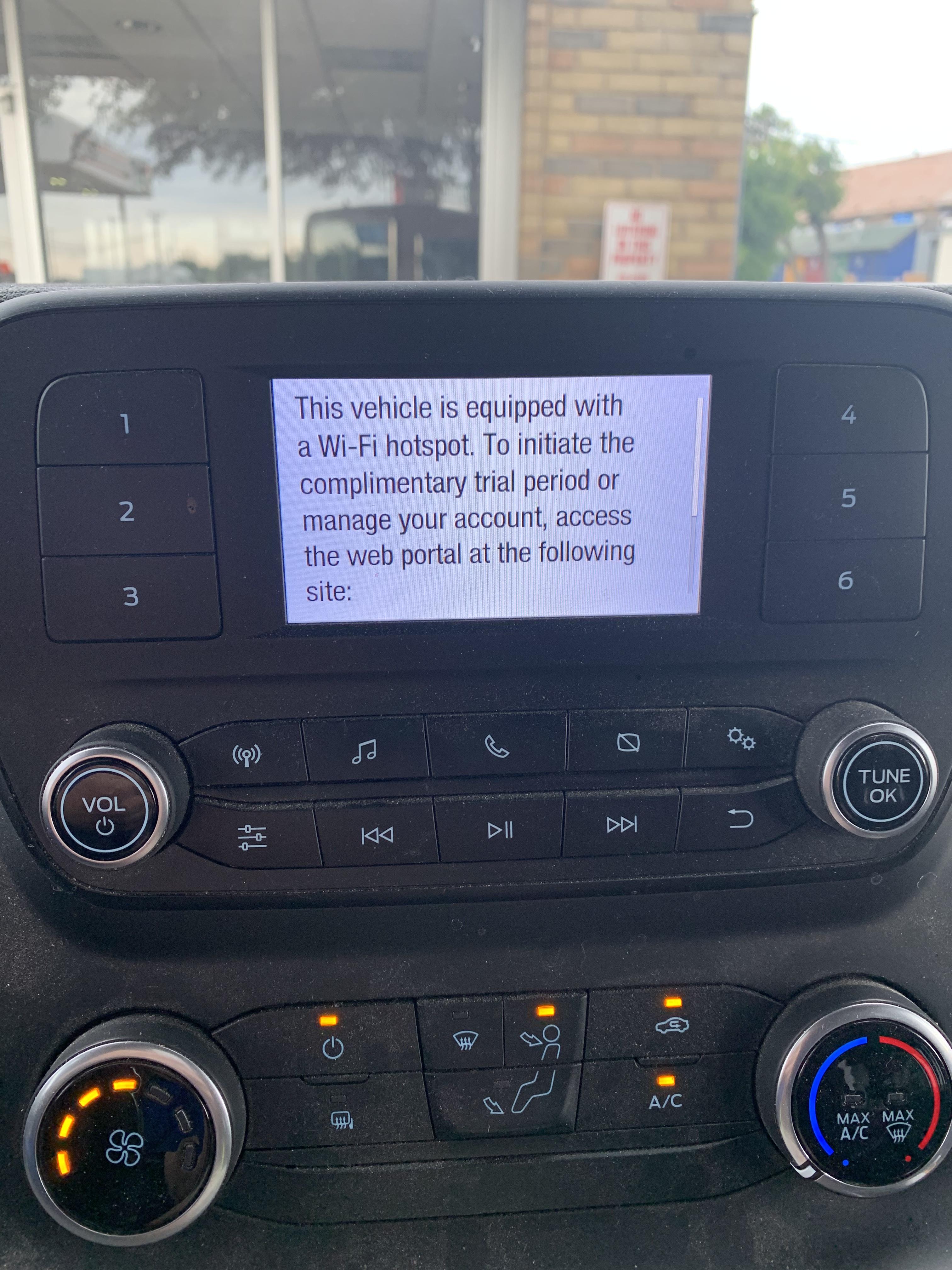

LDO Posted May 15, 2023 Posted May 15, 2023 When this is displayed, only the volume can be changed. Please help. The radio stations are boring in the Austin area. I need to play music from my phone. I have called a couple of dealerships and they are stumped.

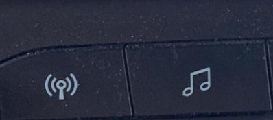

Rodent Posted May 15, 2023 Posted May 15, 2023 (edited) Dumb question: Did the button on the left get accidentally pushed? What happens when you push the one on the right (with the musical note?) We have had a couple of Fords with Sync. Holding down the power button and the Fast Forward >>| reboots it. I don't know anything about the basic system in your van though. I assume Dan will be along in a bit to save the day.... Edited May 15, 2023 by Rodent 2

LDO Posted May 16, 2023 Author Posted May 16, 2023 1 hour ago, Rodent said: Dumb question: Did the button on the left get accidentally pushed? What happens when you push the one on the right (with the musical note?) We have had a couple of Fords with Sync. Holding down the power button and the Fast Forward >>| reboots it. I don't know anything about the basic system in your van though. I assume Dan will be along in a bit to save the day.... Nothing happens with either button. I’ll try the reboot idea. After I posted the OP, I called Ford Motor Company. They couldn’t help. This annoys the *•#% out of me.

Rodent Posted May 16, 2023 Posted May 16, 2023 19 minutes ago, LDO said: Nothing happens with either button. I’ll try the reboot idea. After I posted the OP, I called Ford Motor Company. They couldn’t help. This annoys the *•#% out of me. It's possible that the pushbutton input died. Not really in a place that it would suffer from Pepsi Syndrome though. Not sure that your system will reboot like a Sync 3, but it is worth a try.
iamsuperdan Posted May 16, 2023 Posted May 16, 2023 3 hours ago, Rodent said: . I assume Dan will be along in a bit to save the day.... Well thanks for the vote of confidence! My first thought was just to press the tune/ok button. That works like an enter button. And if that didn't work, the reboot would have been my next suggestion. We've seen a few with that system that require it. Somewhat common. What are the specs on your van?
LDO Posted May 16, 2023 Author Posted May 16, 2023 40 minutes ago, iamsuperdan said: Well thanks for the vote of confidence! My first thought was just to press the tune/ok button. That works like an enter button. And if that didn't work, the reboot would have been my next suggestion. We've seen a few with that system that require it. Somewhat common. What are the specs on your van? I don’t know the specs. It belongs to my employer. It’s a high roof van with a long wheelbase (I don’t know if it is offered in different lengths, but it’s LWB compared to other work vans I have driven). The color is nice; a dark metallic blue that is no longer offered. The newer vans in the fleet are a bit lighter.
Ace-Garageguy Posted May 16, 2023 Posted May 16, 2023 1 hour ago, LDO said: I tried the reboot. It worked. I didn't mean to make light of your problem with the hammer photo, but really...what does it tell you that you called dealerships and Ford and nobody had a clue?

iamsuperdan Posted May 16, 2023 Posted May 16, 2023 From a dealer perspective, these electronics are a serious pain in the butt. A lot of the time, it's that old joke. Have you tried turning it off an on again? Seriously. Computers. Ugh. Most times, dealers will not try to diagnose an issue over the phone. Too many backyard mechanics that will try something themselves, but will get clear instructions wrong, and then they're at the dealer complaining that someone told them the wrong info. Now it's the dealer's word against theirs. Quite often, diagnosing a problem requires the vehicle be plugged into the Ford computer system. Without the VIN or the van, it can be tough. On the Transits for example, there are 5 different head unit options, and 4 of them look the same. If its a company van, how would the driver know which was ordered? Then factor in some of the options that are tied into that radio. Navigation, 360 degree cameras, satellite radio, bluetooth, backup cameras, park sensors, climate control, heated seats...plus all of the set up for vehicle features. Now which one of those is causing the issue? I really, really like the tech, and think most of it is great. But when off warranty, modern cars scare me. As such, I'm quite happy with my old Tahoe or my old K1500.
