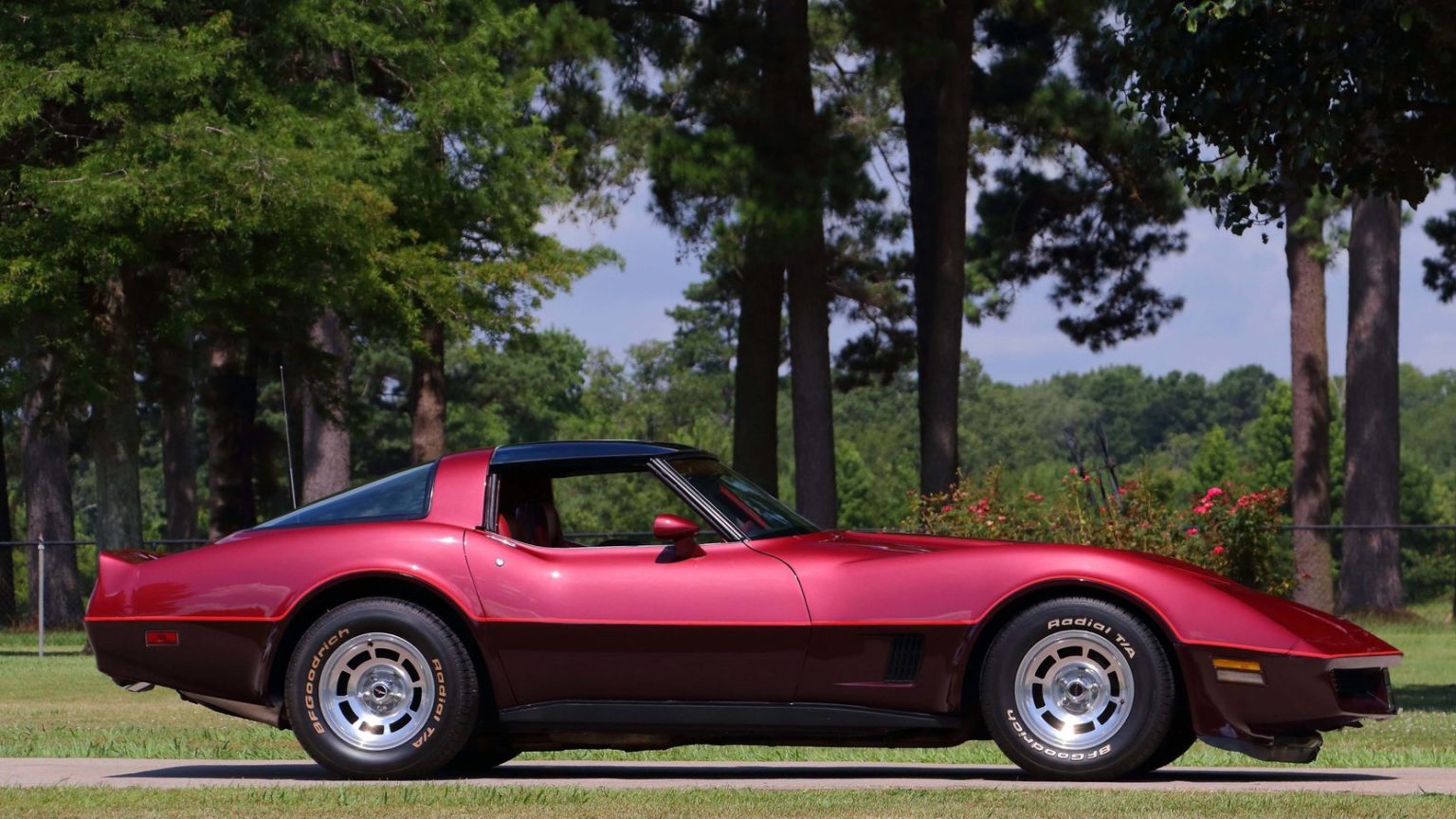

Monty Posted May 16, 2023 Posted May 16, 2023 I've got an idea or two for some two-tone paintjobs but would like to use a pinstripe to separate and set off the two colors a la this: Obviously the straight lines would be easy but following the wheel wells on many cars would not. Basically I'm looking for pinstripe decals in a variety of colors, that could be "worked" to follow a given pattern or profile, assuming such a thing exists. Not really interested in "tape" options as they don't seem to offer much flexibility.
