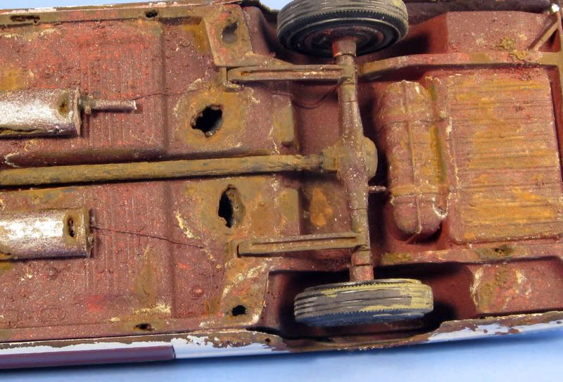

Jeff Johnston Posted February 22, 2009 Posted February 22, 2009 At Michaels you can find somethign called "sophisticatef finishes" rust. It's a 2 part system. Here is the results on one of my junkers. It goes for about 12 bucks and will last longer then we will this is what you are looking for.

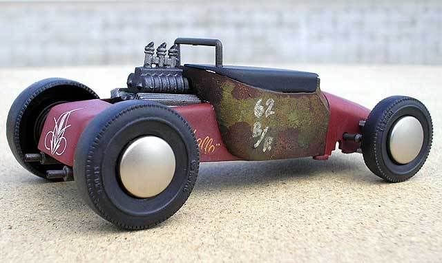

gowjobs Posted February 23, 2009 Posted February 23, 2009 Rust-All is a water-based 4-part system that can be used to make some really realistically rusted finishes, but it takes a bit of experimentation to get exactly what you're looking for - not a problem, because there's enough in the bottles to do a BUNCH of models, and it's easily removed with an ammonia-based cleaner until you seal it. My suggestions: A quick and easy way to a basic oxidized steel look is to buy a can of Tamiya Light Gunmetal and one of Floquil Roof Brown. Mist these alternately over the parts in question until you get the look you're going for (I hold one can in each hand, and shoot from a couple of feet away). The headlight buckets on this 1/8 bucket were treated in this manner: The following were done with a base coat using this "oxidized steel" method, and then RustAll, followed by rubber cement to mask my rusty areas before I shot the "paint" over the top:
