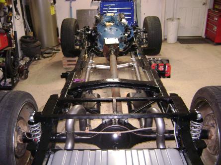

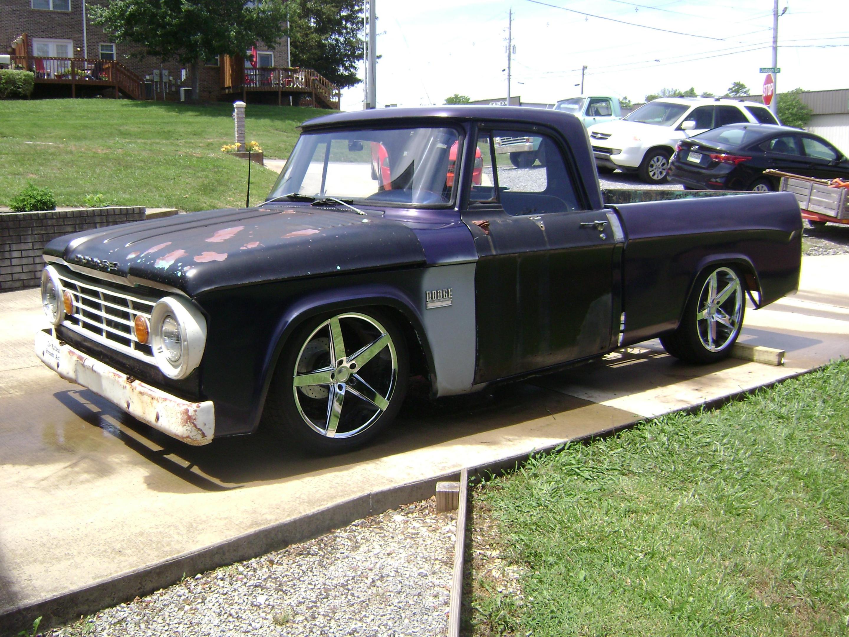

drummerdad Posted January 28, 2024 Posted January 28, 2024 Quote On 1/21/2024 at 11:21 PM, JollySipper said: That's a super cool truck! They're tough trucks, too...... My first thought when I saw the pic was 'I wonder how he lowered it?'. I used to have a '71 in about the same condition, short bed, too. Do you have more pics? I have a ton of pictures. Im not sure I can post them all here. I lowered the truck by adding a mustang 2 front suspension with coil overs, and a triangulated 4-link in the back. I have a complete build thread on the dodge forums and the sweptline forums. I agree they are very tough. The frames are big and heavy. I boxed this one, and after the mods, I couldnt lift it. I had to use the engine hoist. 2 1
JollySipper Posted January 28, 2024 Posted January 28, 2024 That's so very cool, Thank You! I see you also relocated the fuel tank............. Do you guys have a plan as far as body/paint?

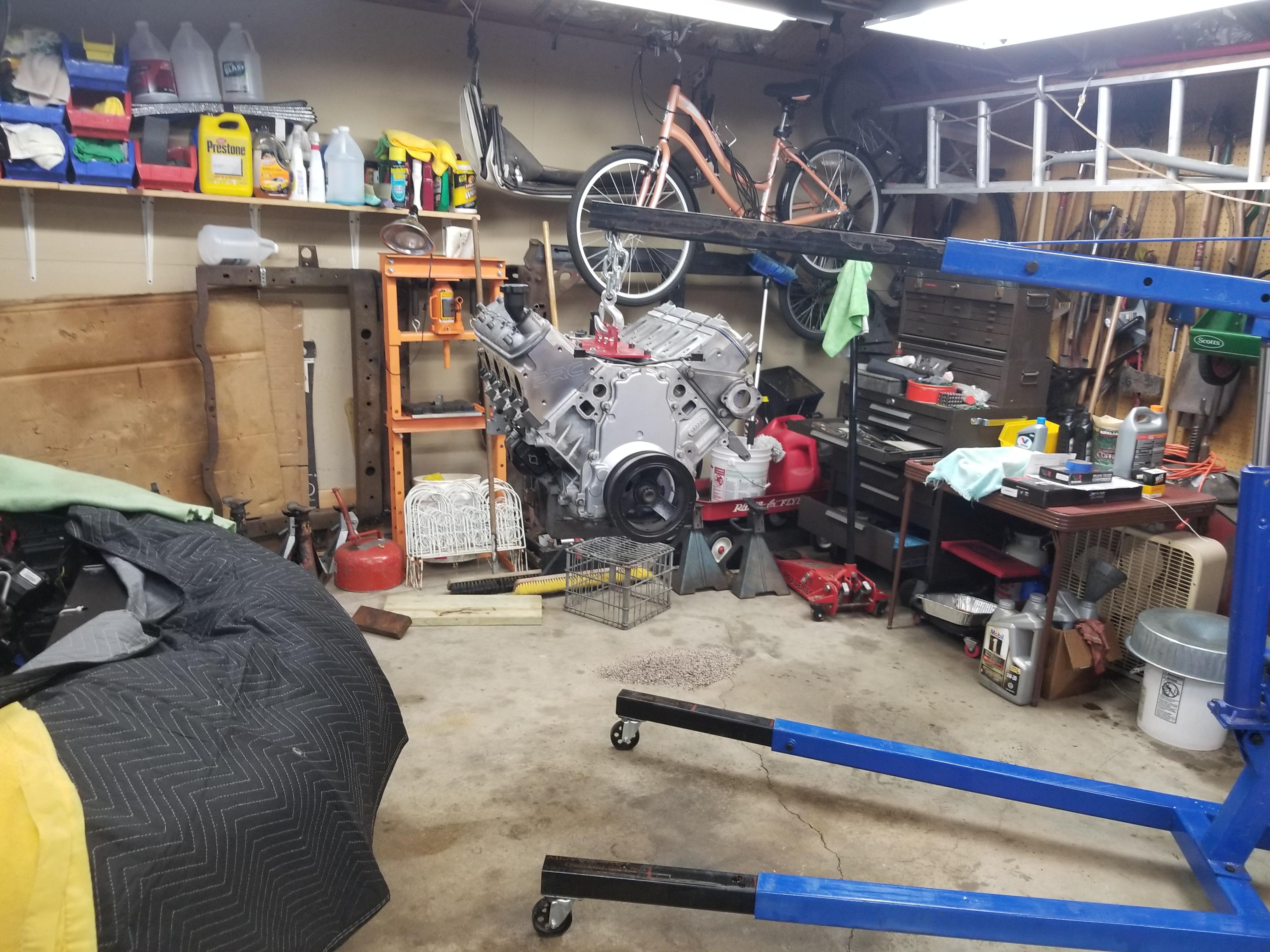

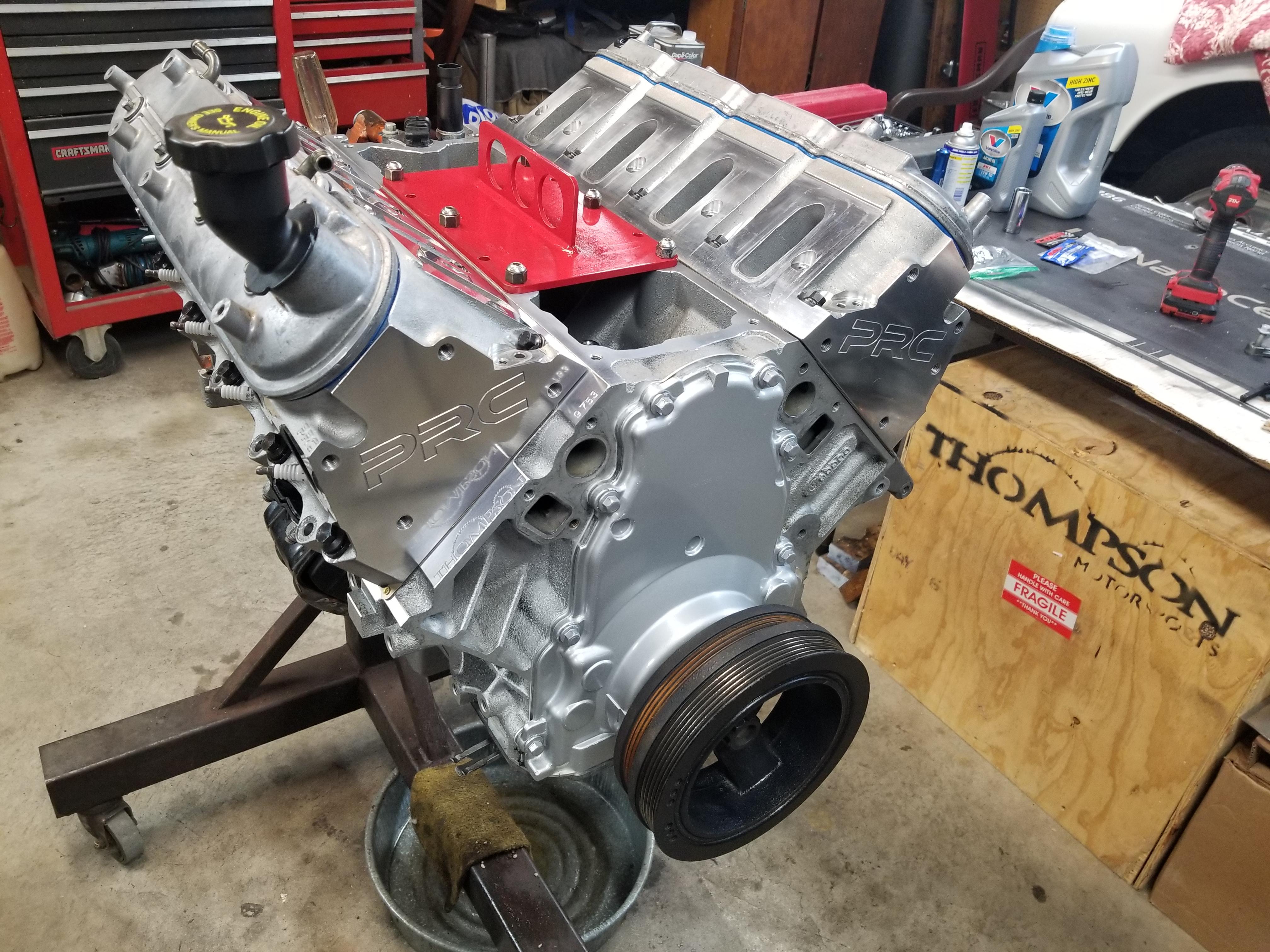

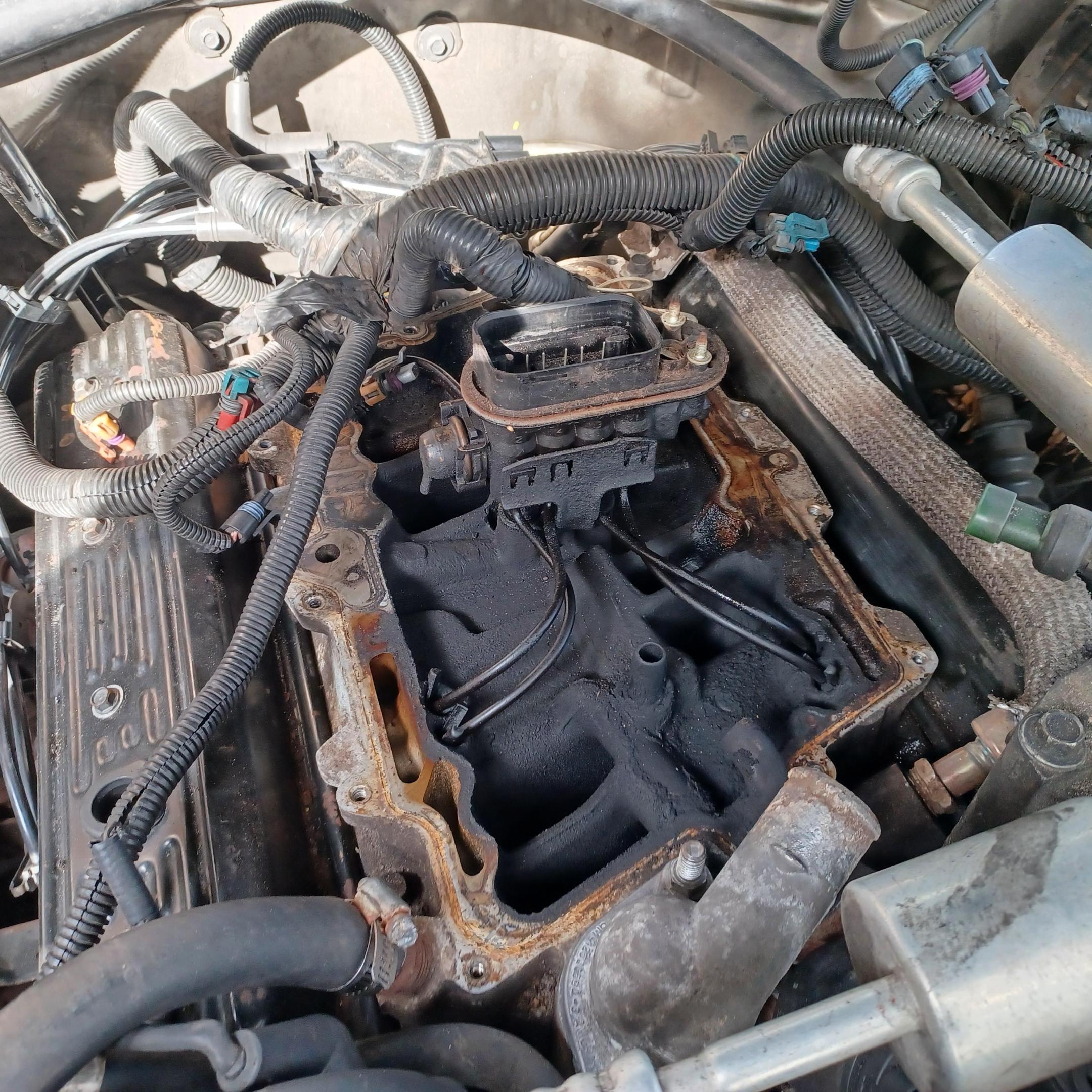

Tabbysdaddy Posted January 29, 2024 Posted January 29, 2024 Hopefully this is the final update of the engine swap. Distributor seems to be set, haven't had the check engine light come on. Well, not for that anyways. Cylinder misfire #6. I suspected I would have to change the injectors, just like all the other stuff. Pulled the upper intake, swapped out the "spider" injector assembly. Running like it was before now.

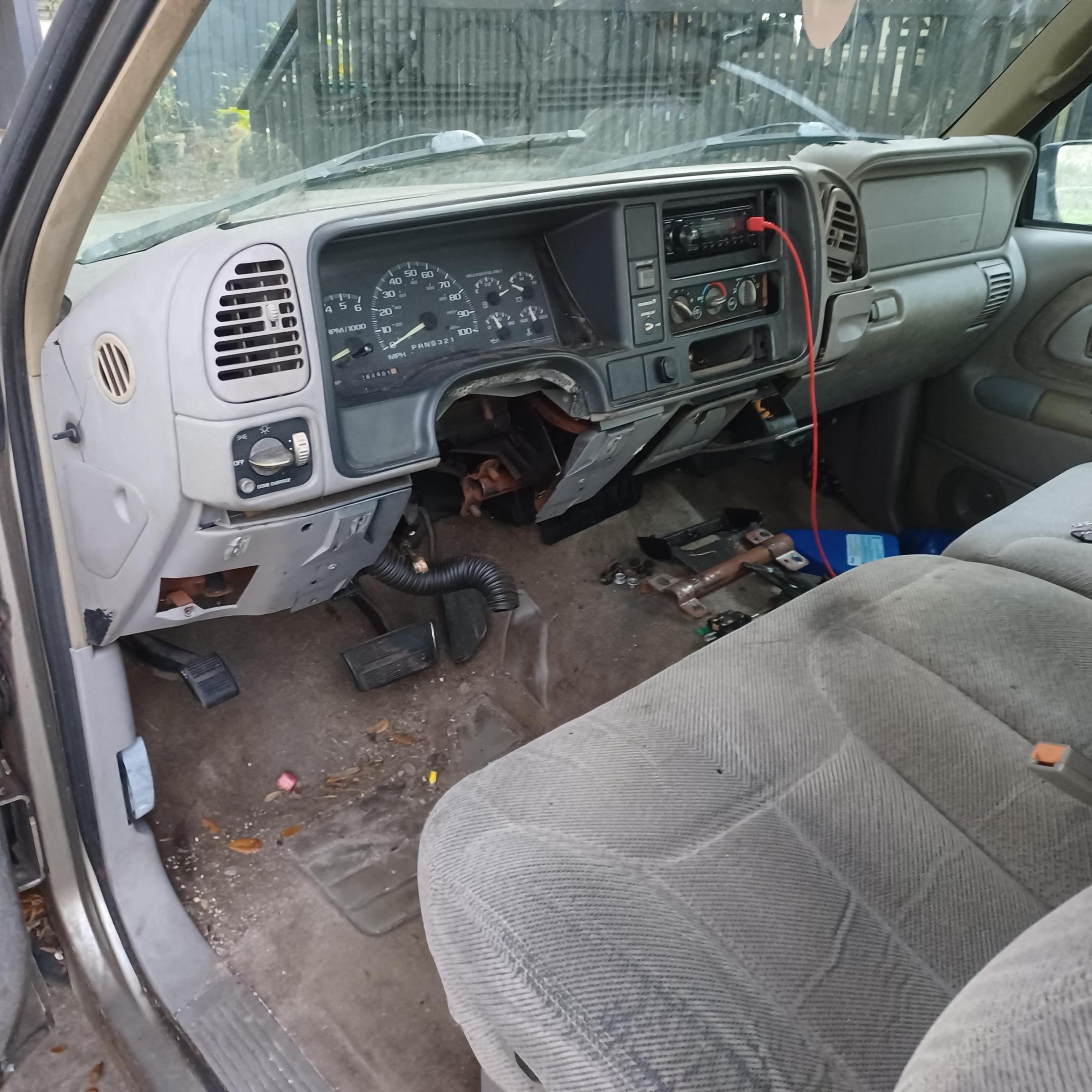

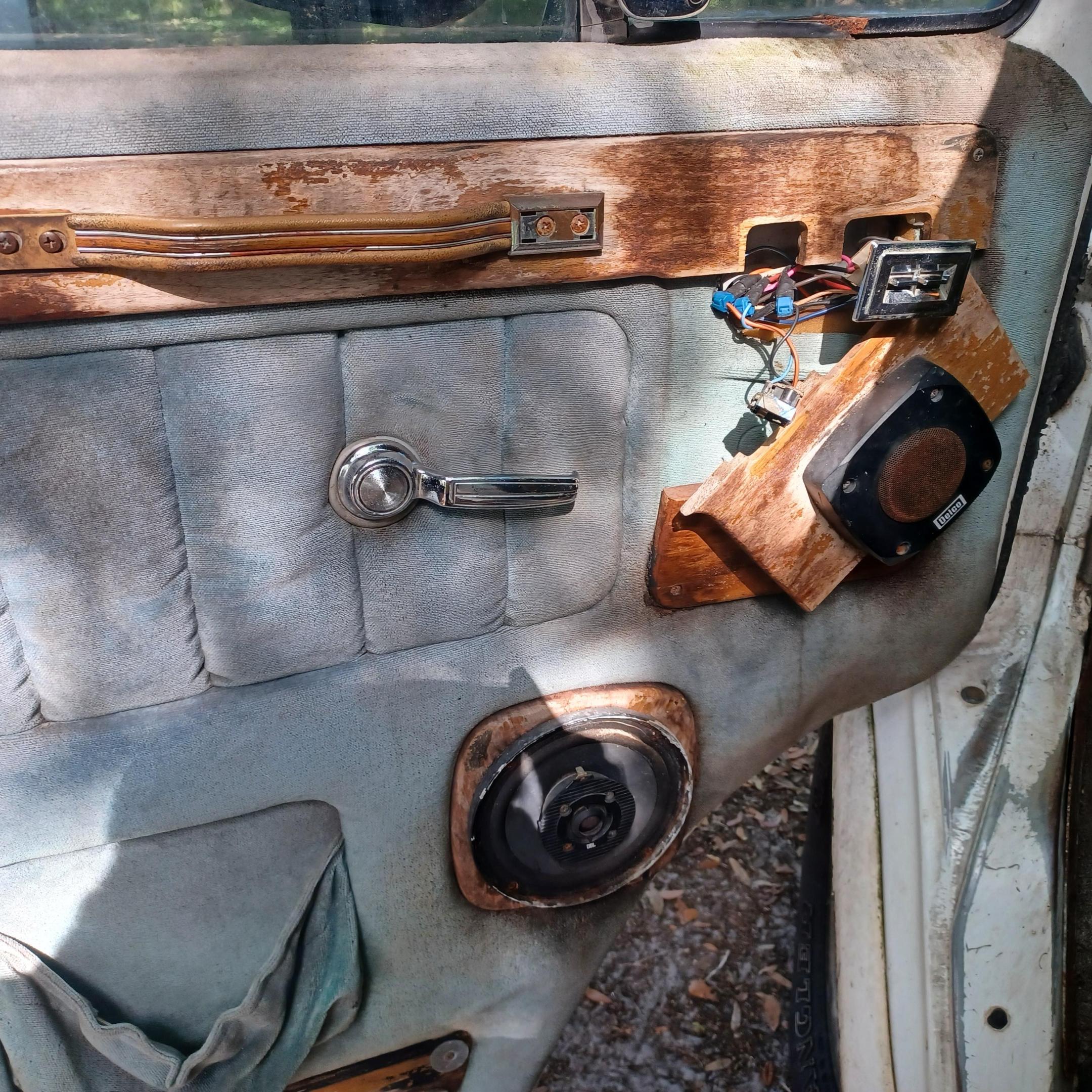

Tabbysdaddy Posted April 10, 2024 Posted April 10, 2024 I think I'm ready to do something about this. It's been this way for a while. The lock switch has been busted for a long time, but the window switch just had a wire pull out so I have to jam it in the plug to make the window work. I'm better at putting things back as they were, but I don't want to do that here. I've been trying to kick start my imagination but haven't come up with anything yet. I don't really want to use wood.

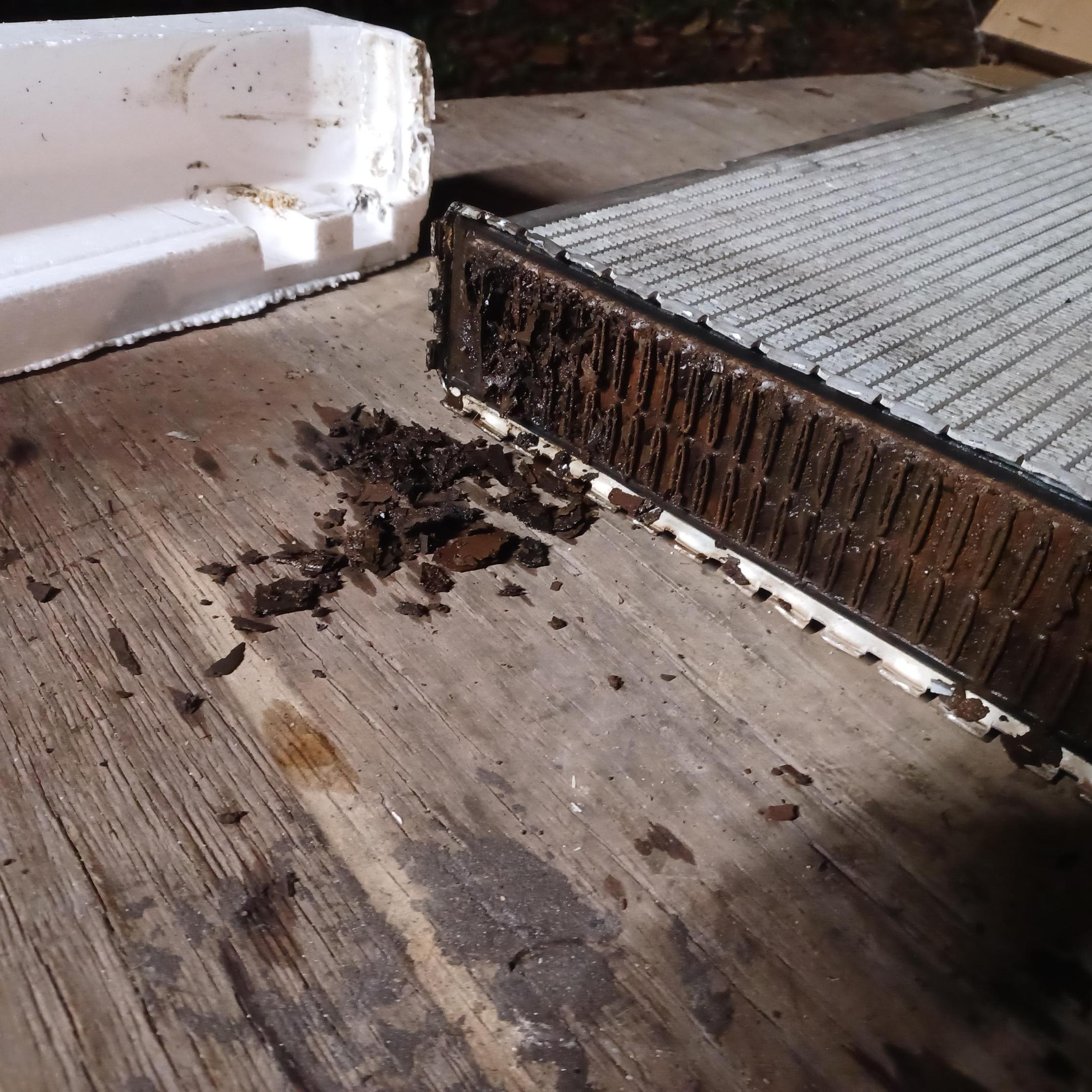

Tabbysdaddy Posted May 13, 2024 Posted May 13, 2024 And the winner is... blocked radiator. I think it may have been partially blocked and the block sealer finished it off, as it runs cooler now with a new radiator than it ever did before even with the old engine. I got a lot of junk out of the block, a lot of junk. There was even gobs of RTV inside from when they "glued" the water pump and thermostat housing on. The old radiator weighs at least twice as much as the new one.

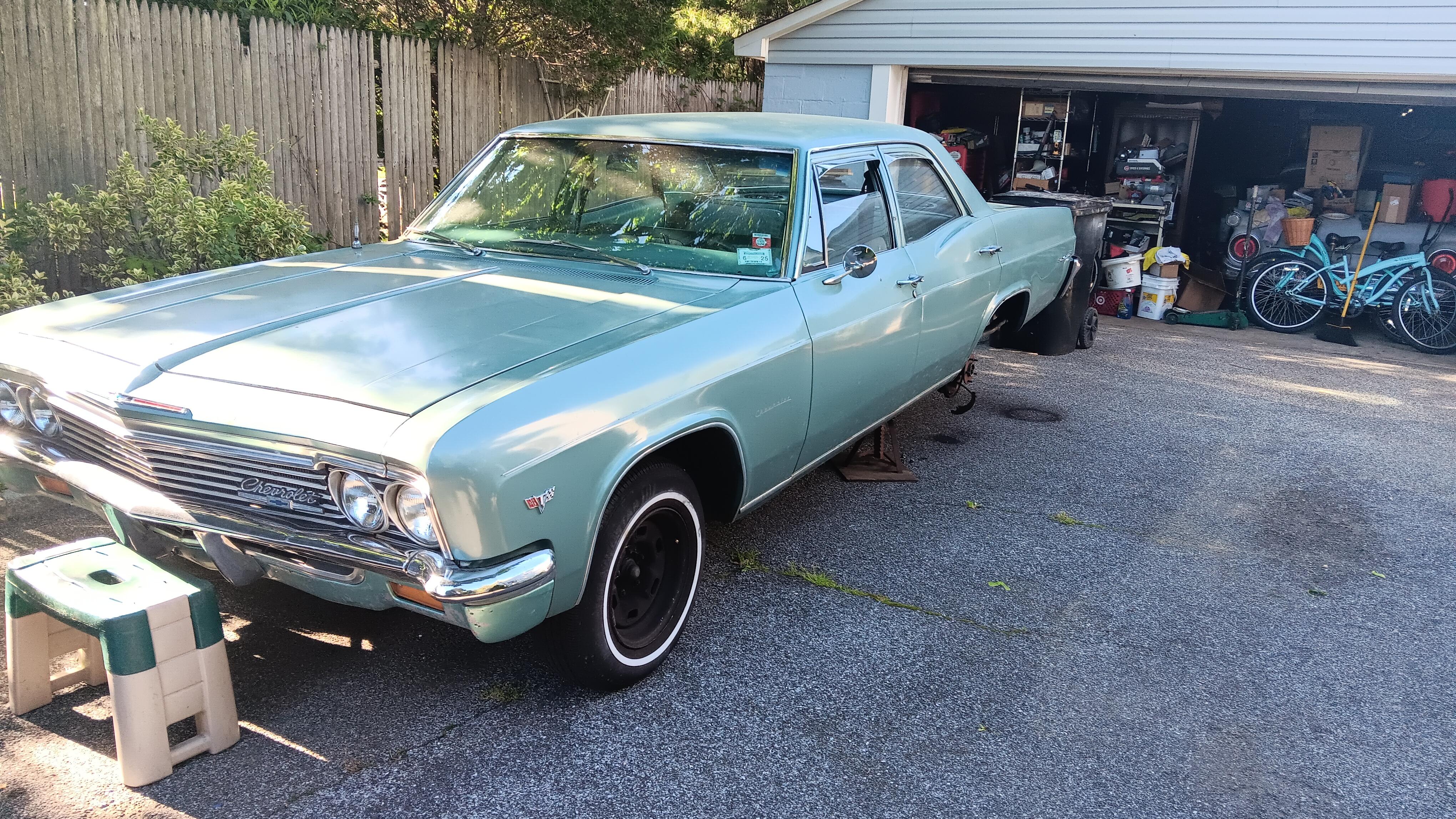

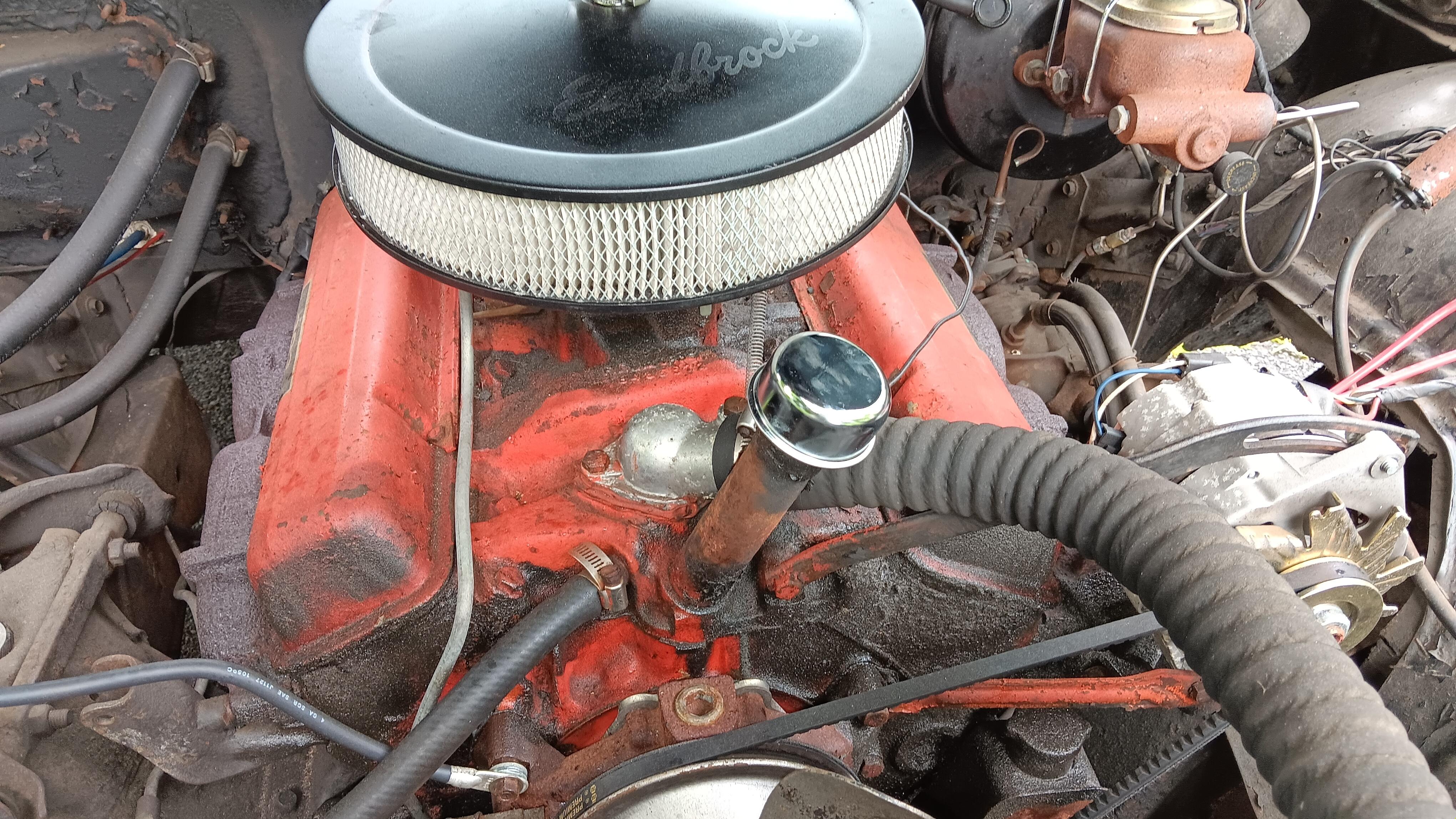

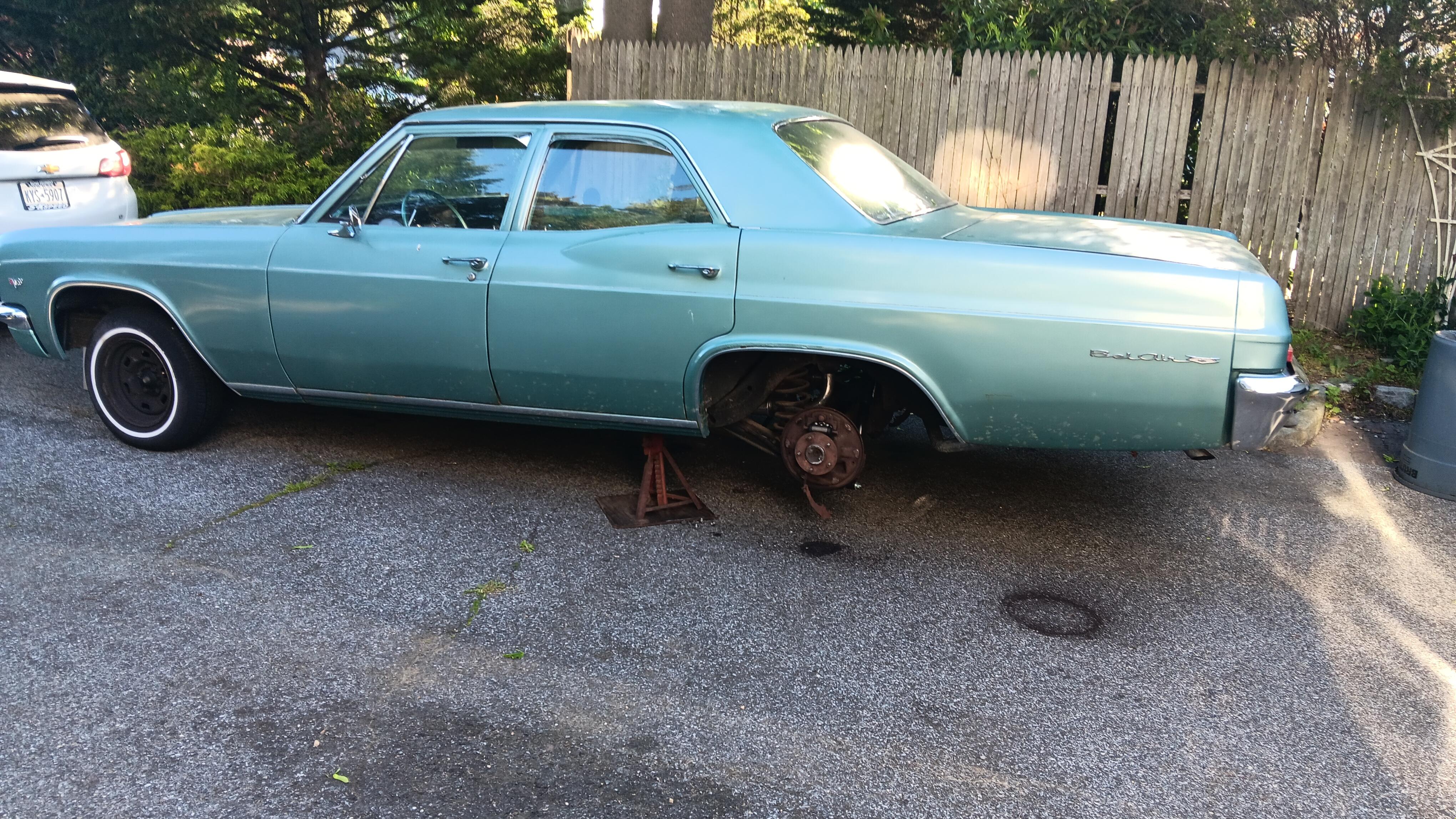

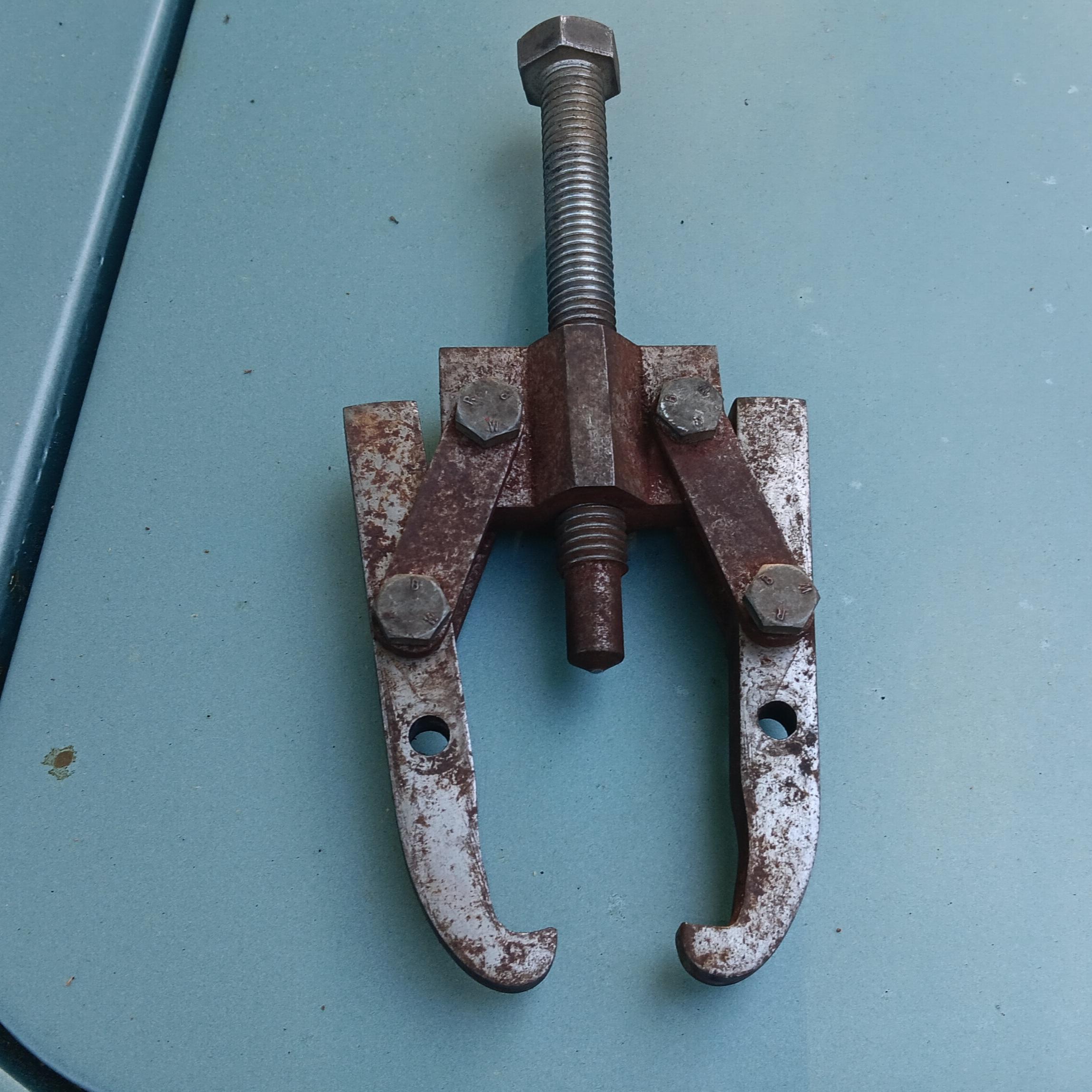

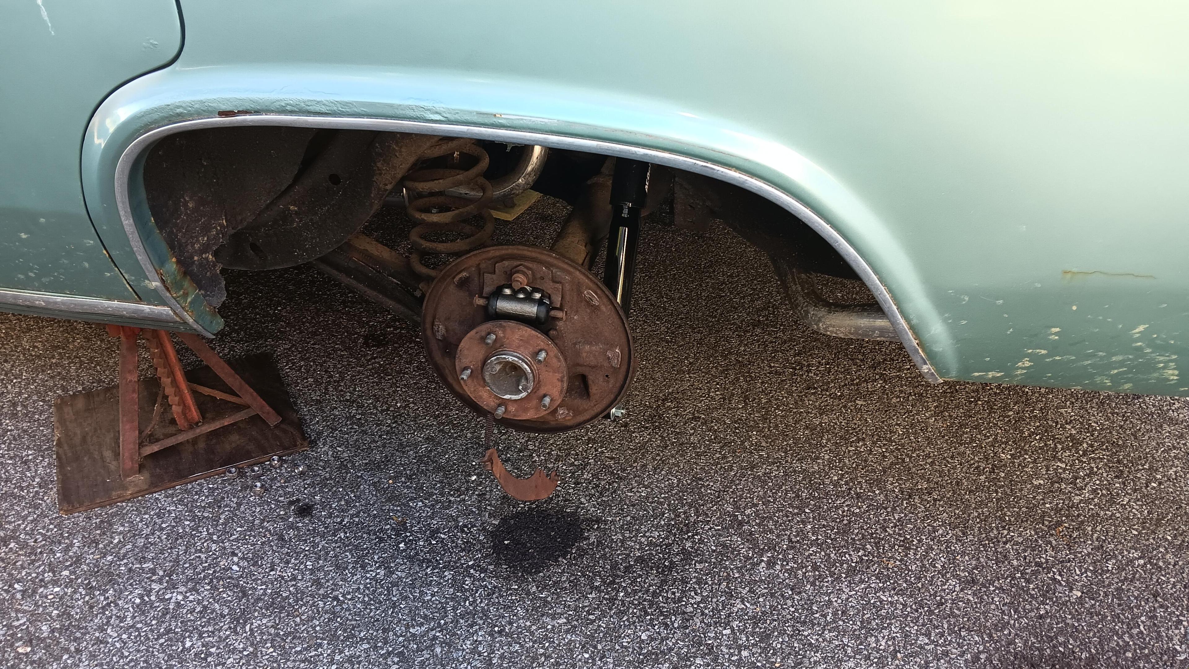

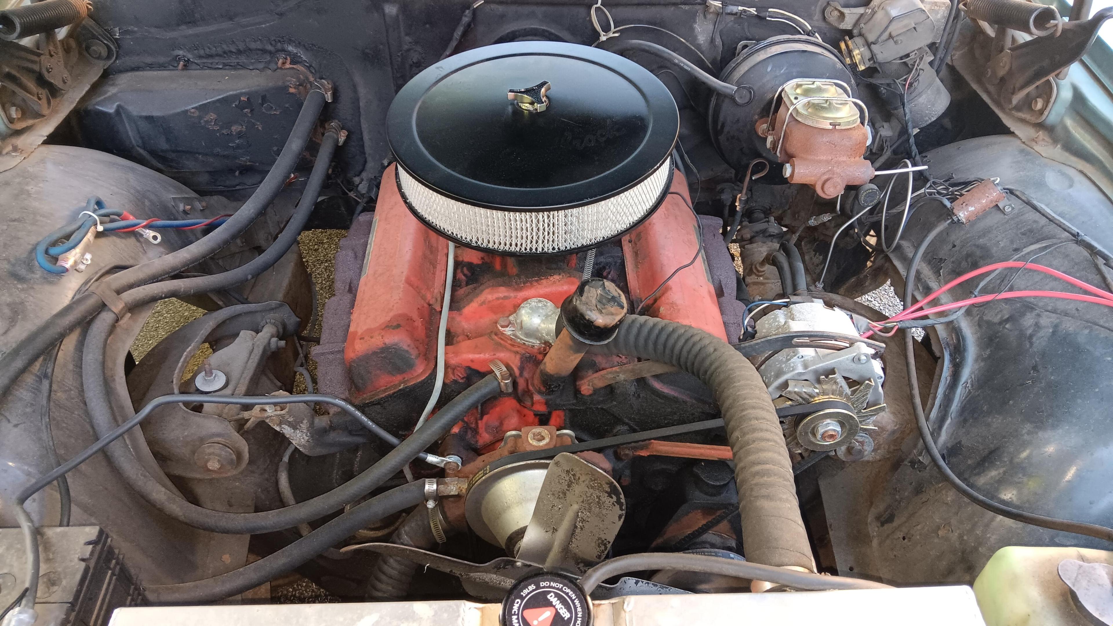

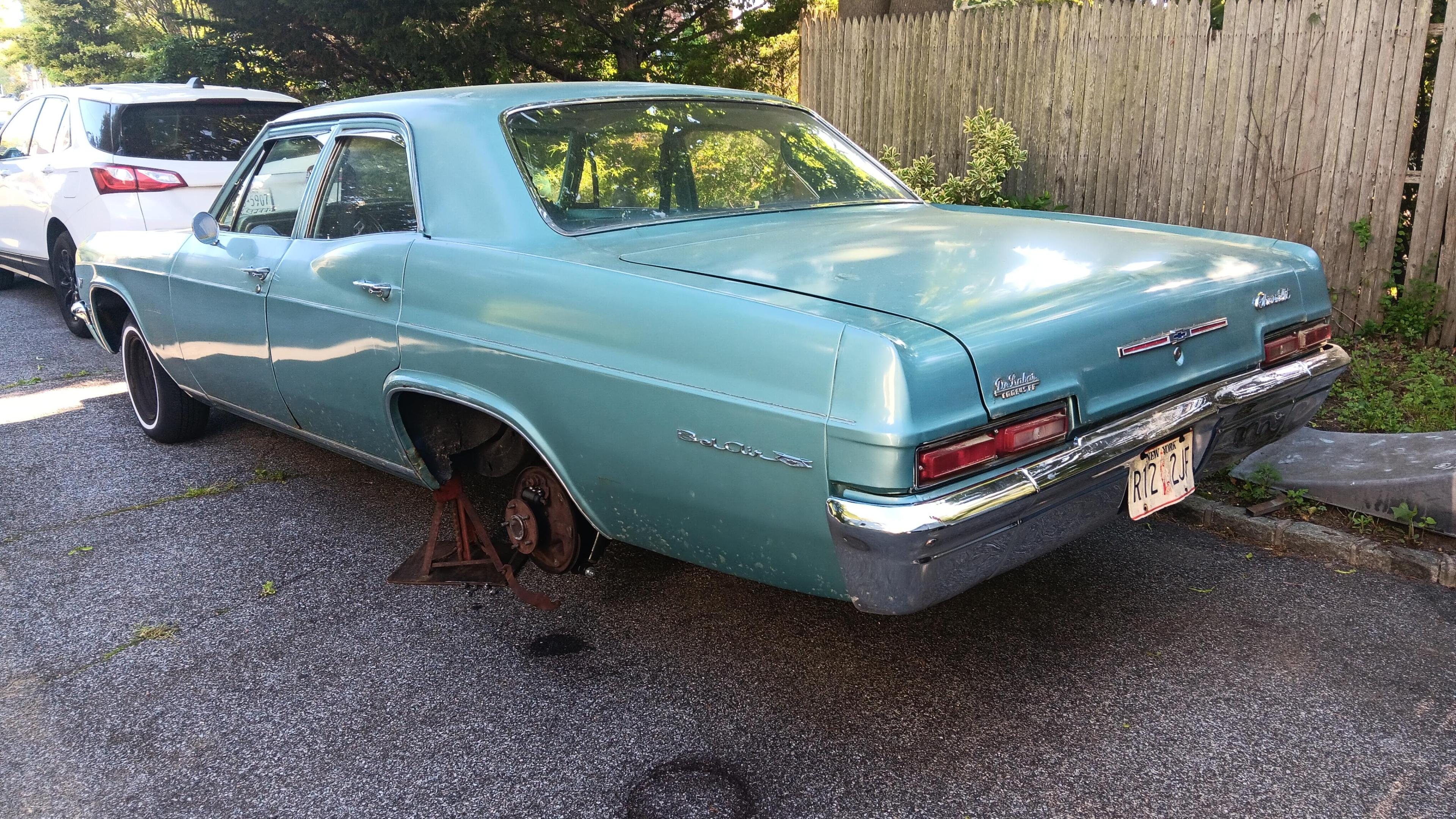

bobss396 Posted May 22, 2024 Posted May 22, 2024 Like I need a hole in my head. My girlfriend saw this for sale. I saw it last Thursday and bought it. A 1966 Belair that runs well. I got the rear brakes out waiting on parts. I put the OG steering wheel back on. I'm putting fresh springs under it, some minor front end work and an alignment. It has power disc's up front, a HEI ignition, aluminum radiator, new dual exhaust. The puller I used to get the steering wheel off, I made in college around 1974. The main part was made on a shaper. 3
JollySipper Posted May 22, 2024 Posted May 22, 2024 Ol' car looks to be in pretty good shape! Thank you for rescuing a four-door........... 283 engine? 1

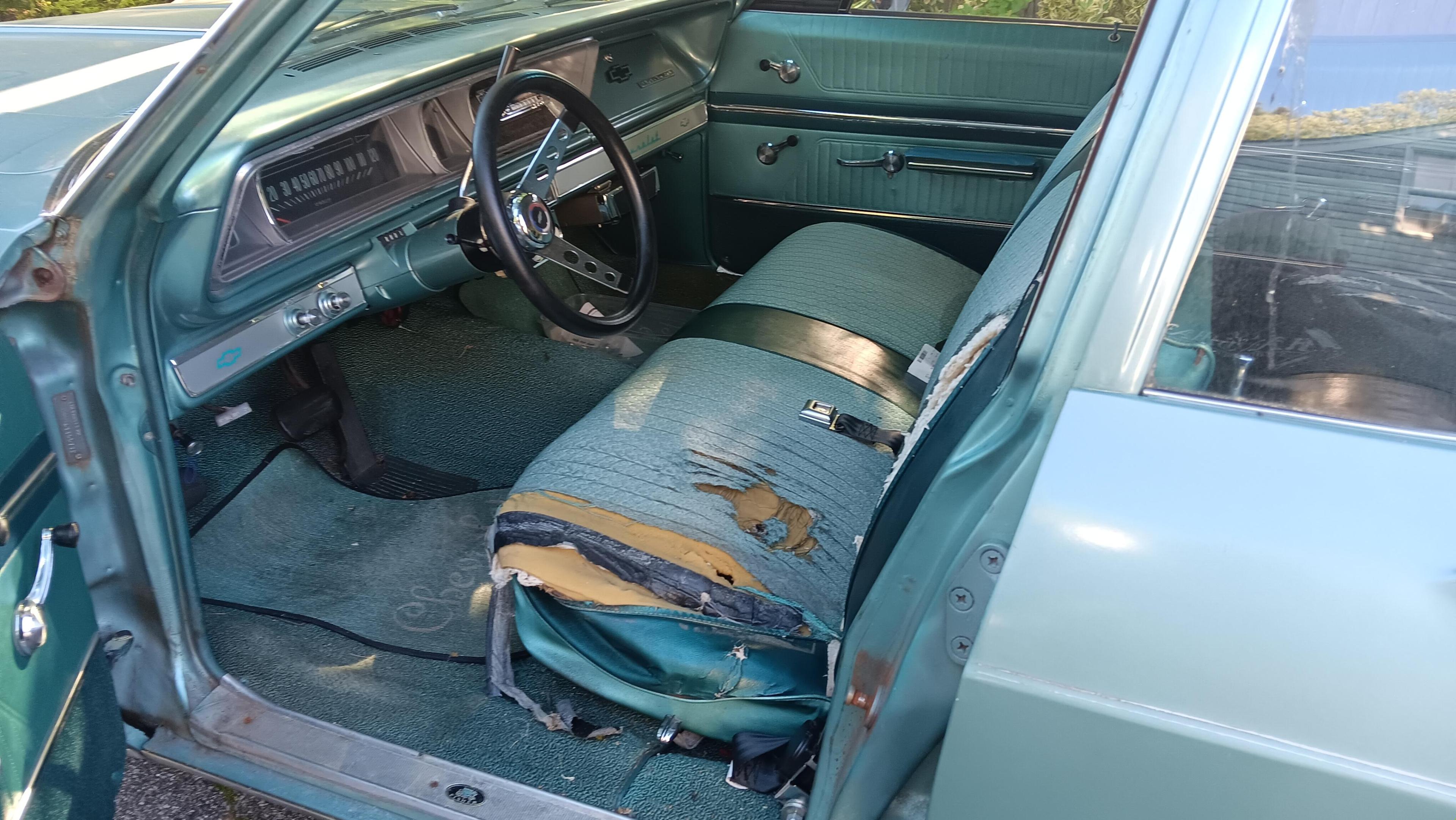

bobss396 Posted May 23, 2024 Posted May 23, 2024 12 hours ago, JollySipper said: Ol' car looks to be in pretty good shape! Thank you for rescuing a four-door........... 283 engine? I had one many years ago, same car only a Caprice with a 396 in it around 1975. This is a 283 with a 2 barrel on it, I need to lean out the choke a little bit. I need the seat done... like sitting on the john as it is now. The locking gas cap is a PITA... ordered a new one. Once I had the SS hub caps off it, I realized it has Camaro 7" wheels on it. I got some 215/75-14 tires for the back and the existing ones I was going to use are too narrow for the wheels, so I'm getting 2 more. Next up is arranging to drop the front seat off to be done. Maybe early next week, I'm tackling the upper a-arm bushings next and possibly the front springs on the driveway. 2
Big_John Posted May 23, 2024 Posted May 23, 2024 14 hours ago, bobss396 said: The puller I used to get the steering wheel off, I made in college around 1974. The main part was made on a shaper. I went to a vocational high school, and we learned to use the shaper. I worked as a Tool & Diemaker for 20 years, and then spent the rest of my career doing tool and gauge calibration, often going into machine shops and toolrooms. That shaper that I learned to use in 1970 was the last one I saw that was still in use. For those that want to know what a shaper is: https://en.wikipedia.org/wiki/Shaper 1

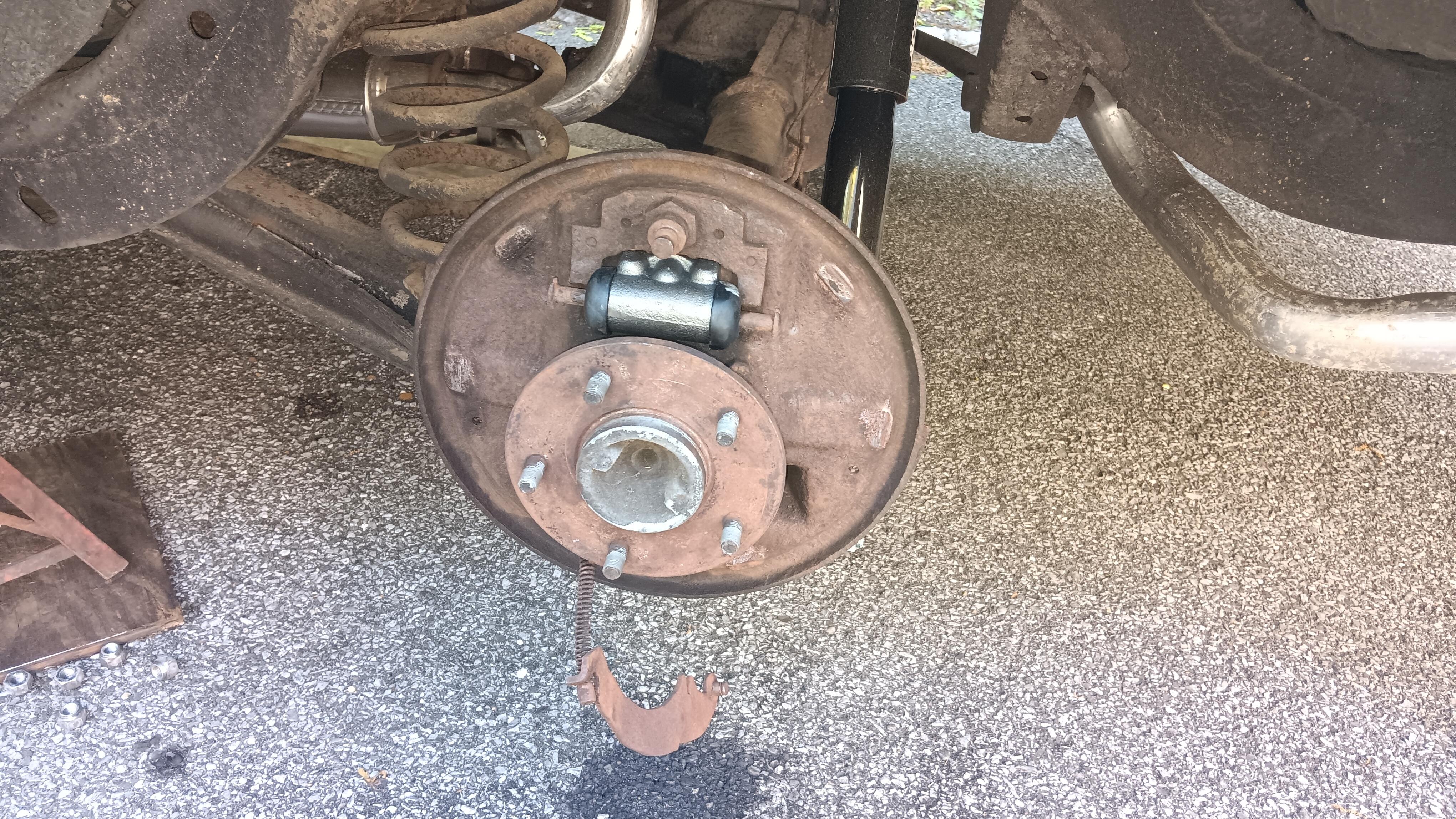

espo Posted May 23, 2024 Posted May 23, 2024 Remarkably great shape for a car approaching 60 years old. Wise to install the new wheel cylinders, the inside of the OEM ones would have to be pitted too much to rely upon.

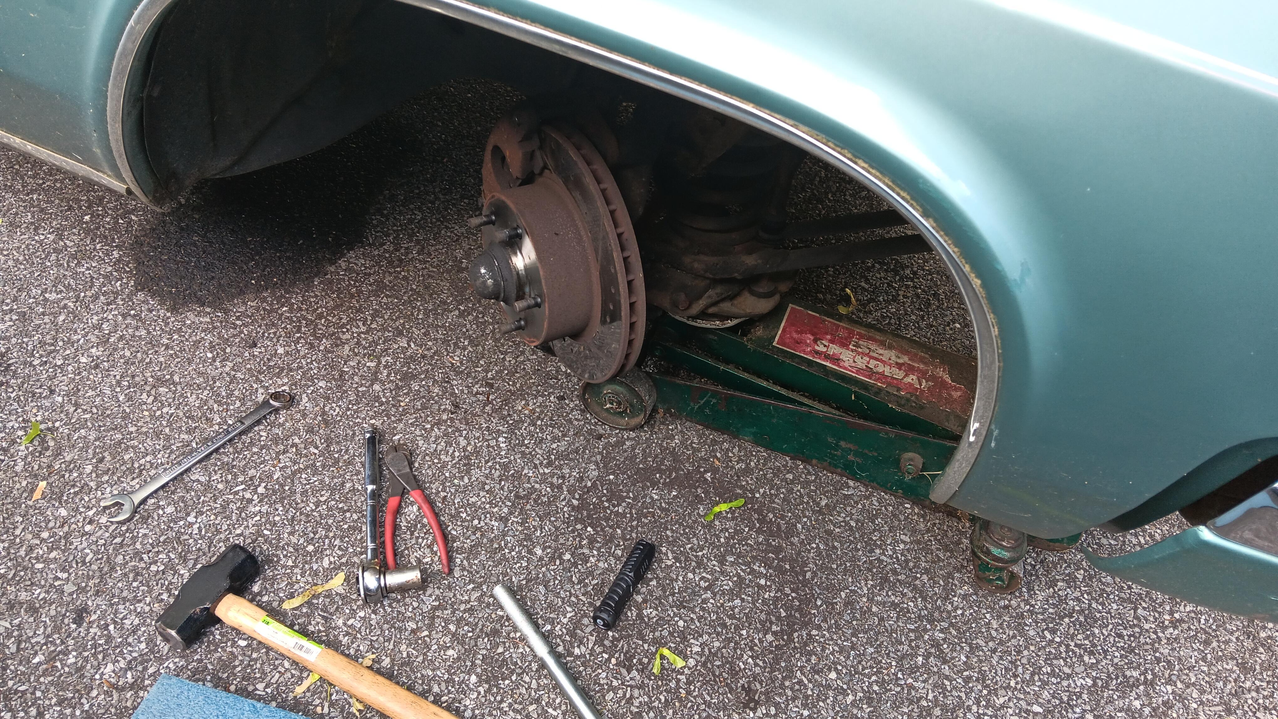

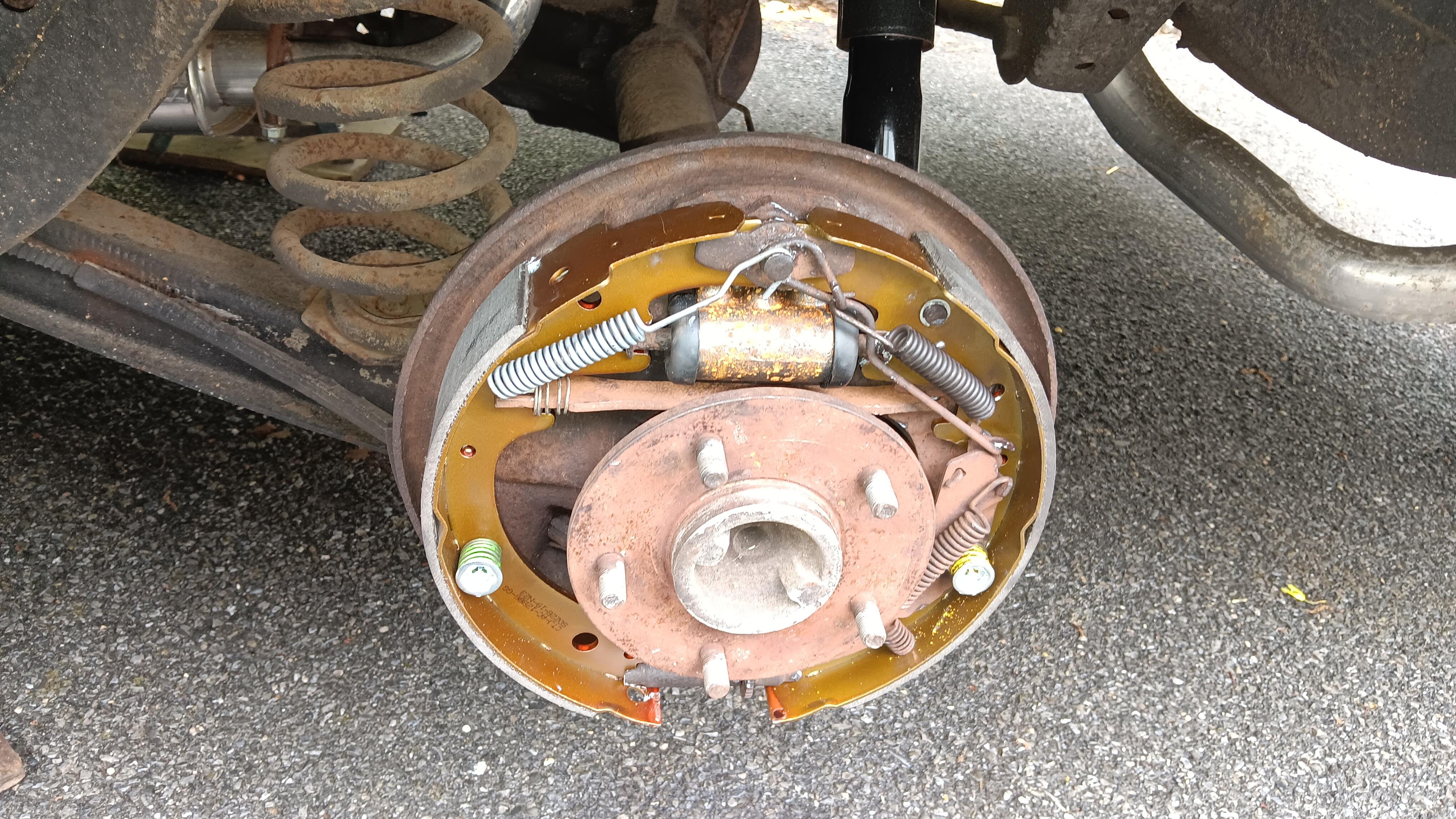

bobss396 Posted May 24, 2024 Posted May 24, 2024 3 hours ago, espo said: Remarkably great shape for a car approaching 60 years old. Wise to install the new wheel cylinders, the inside of the OEM ones would have to be pitted too much to rely upon. One was leaky and they are cheap at Rock Auto. I got the brakes in, my son was over and helped me bleed them. The old oil breather was clogged up solid, must have been original. I replaced the locking gas cap with a regular one. I have to put in a new dimmer switch that came today. 2
bobss396 Posted May 24, 2024 Posted May 24, 2024 10 hours ago, Big_John said: I went to a vocational high school, and we learned to use the shaper. I worked as a Tool & Diemaker for 20 years, and then spent the rest of my career doing tool and gauge calibration, often going into machine shops and toolrooms. That shaper that I learned to use in 1970 was the last one I saw that was still in use. For those that want to know what a shaper is: https://en.wikipedia.org/wiki/Shaper Shapers are still used. Die shops used them to rough things out, as they could run with minimal attention. I was a tool and die apprentice but mainly worked in regular machine shops. I did a lot of heat treating. I also programmed CNC mills for a while and set them up at a night gig I had for many years. 1

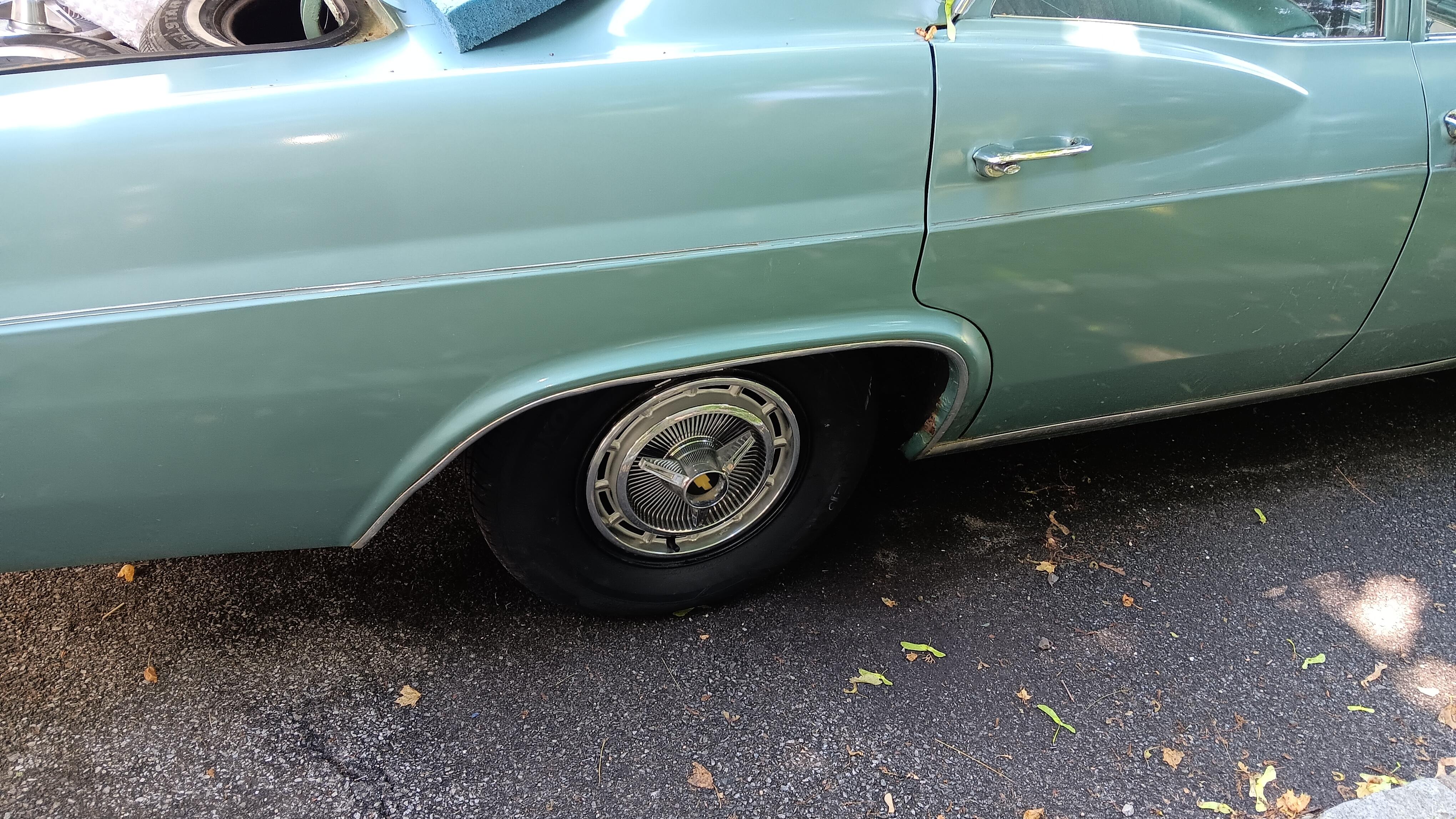

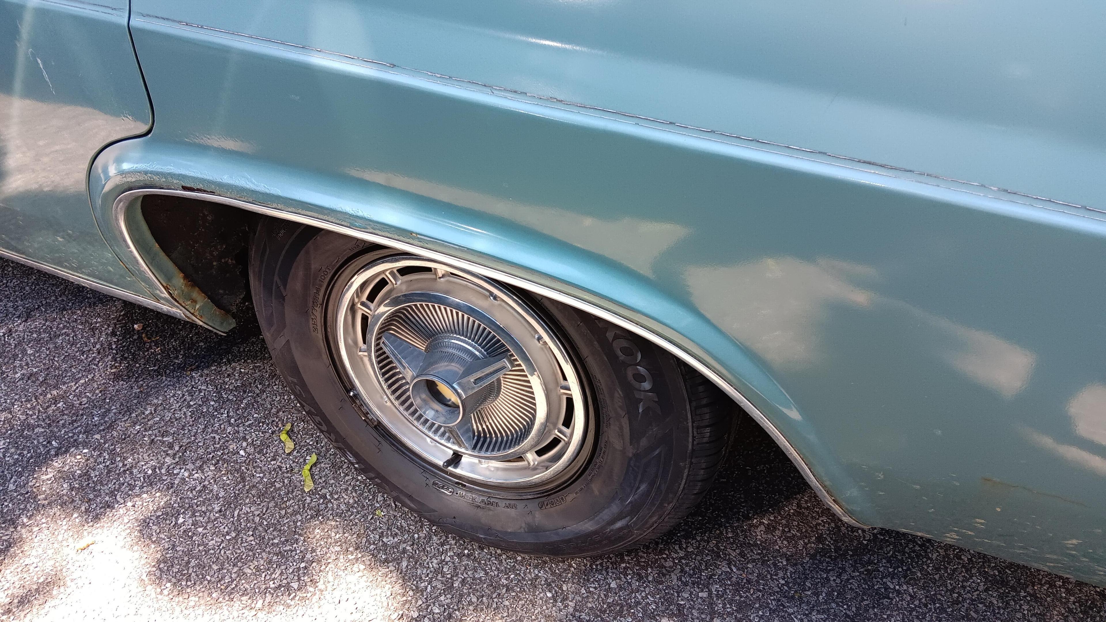

bobss396 Posted May 24, 2024 Posted May 24, 2024 Rear brakes are adjusted, new rear tires and hubcaps are back on. 3
Tabbysdaddy Posted May 24, 2024 Posted May 24, 2024 7 hours ago, bobss396 said: Fed Ex... can almost set my clocks by them. You should get some rest, you look two tired. 1

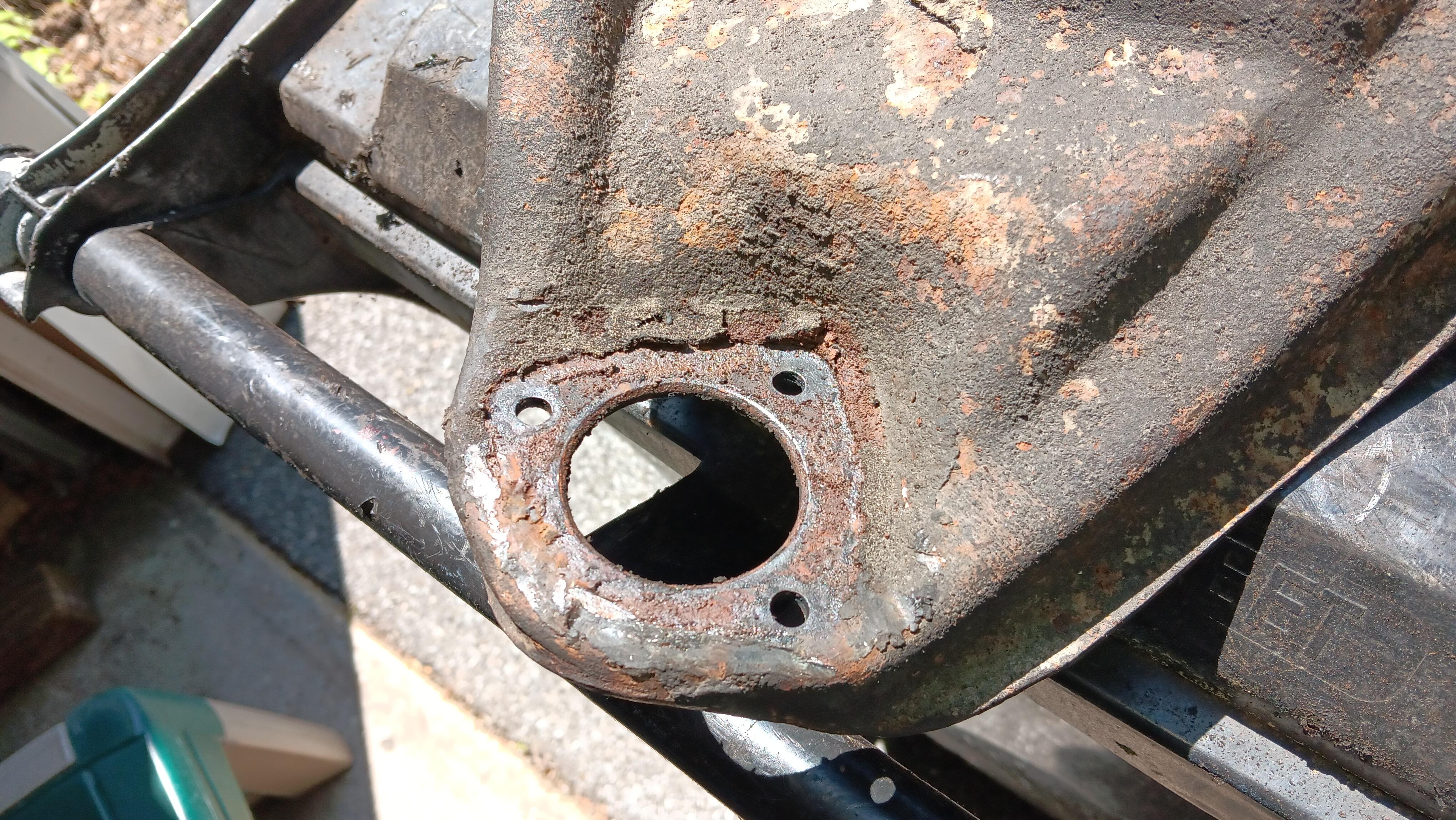

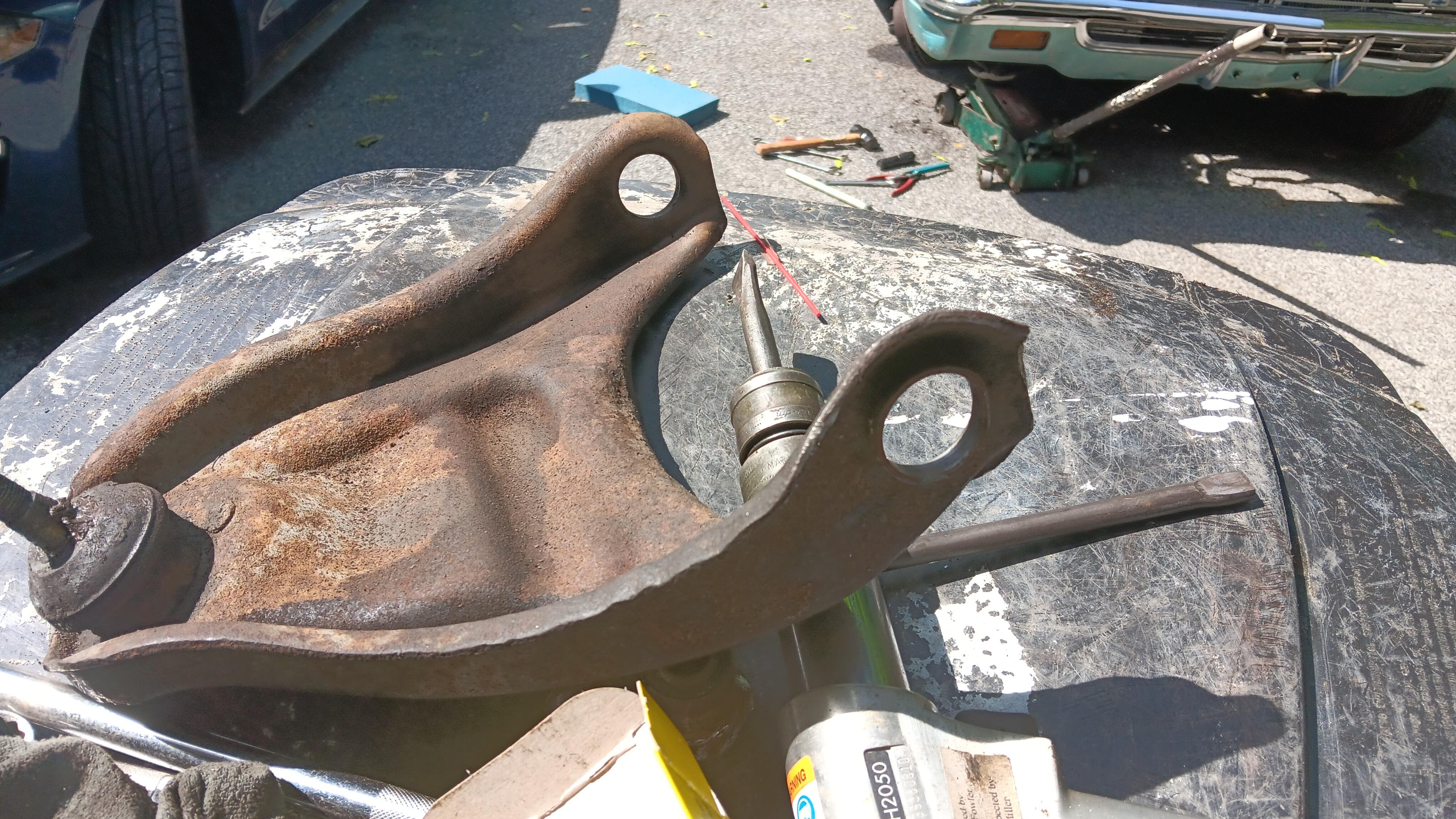

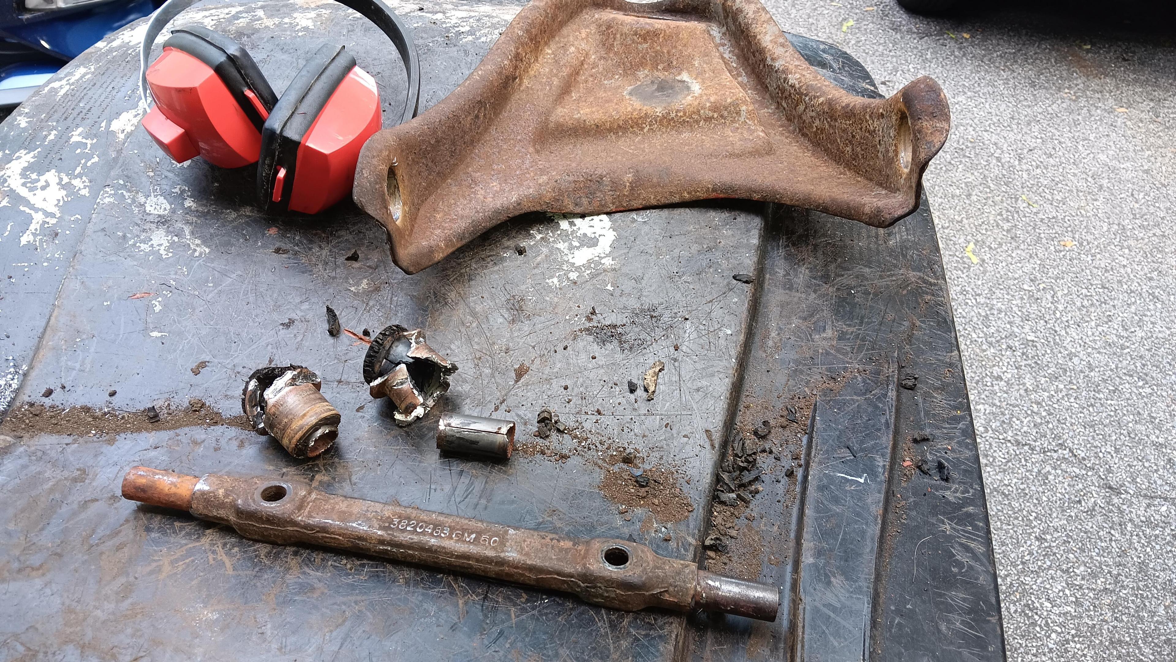

bobss396 Posted May 25, 2024 Posted May 25, 2024 17 hours ago, Tabbysdaddy said: You should get some rest, you look two tired. I am shot. Messed up my knee somehow, truly the walking wounded. New control arm bushings are in, 1 side. Have to pick up upper ball joints after 1. Cut myself using the air chisel too....
bobss396 Posted May 25, 2024 Posted May 25, 2024 Passenger side is together. I was able to track down upper ball joints too. The 2nd side is all apart. One bushing the inner sleeve was frozen. The air chisel makes it easier.
