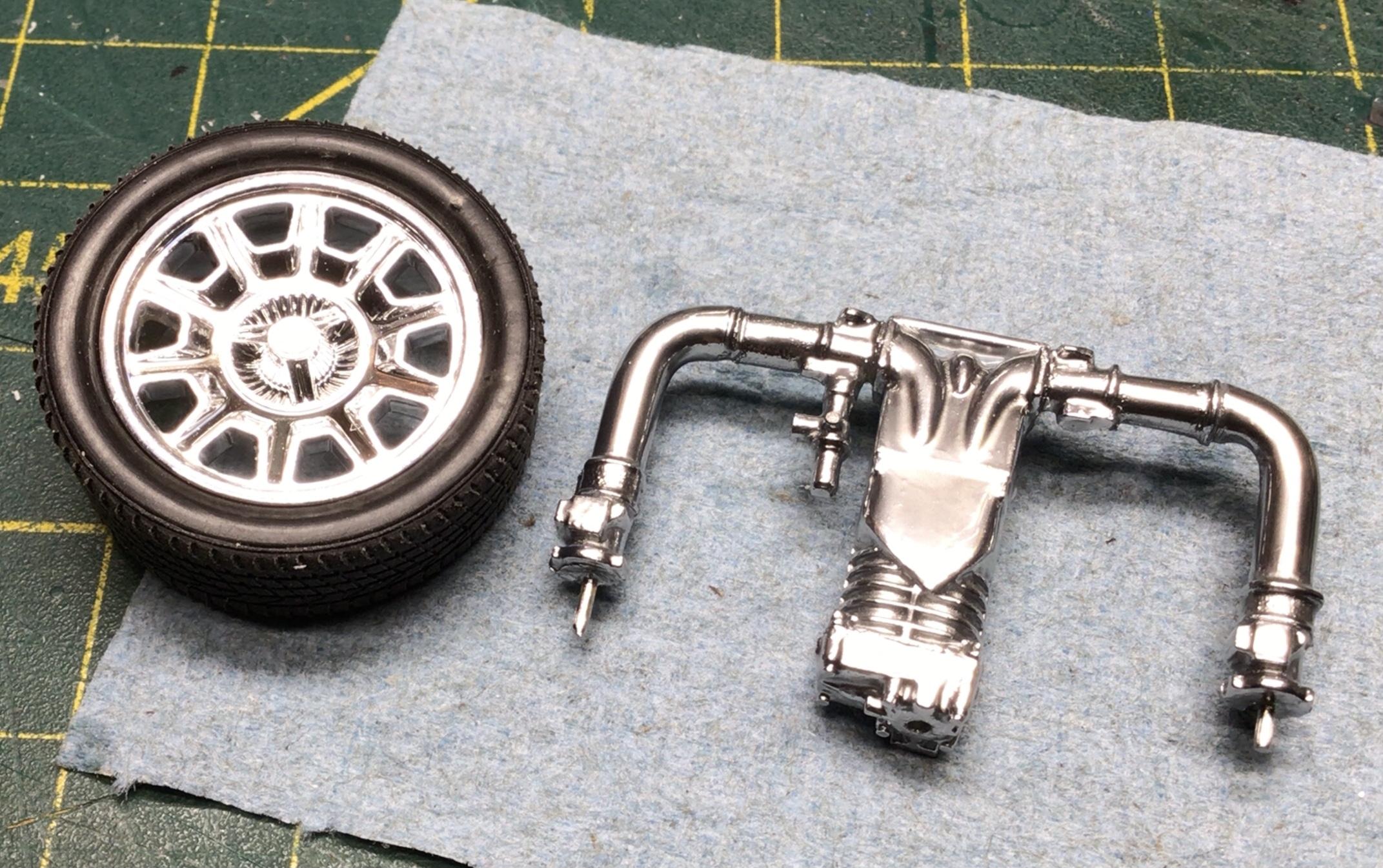

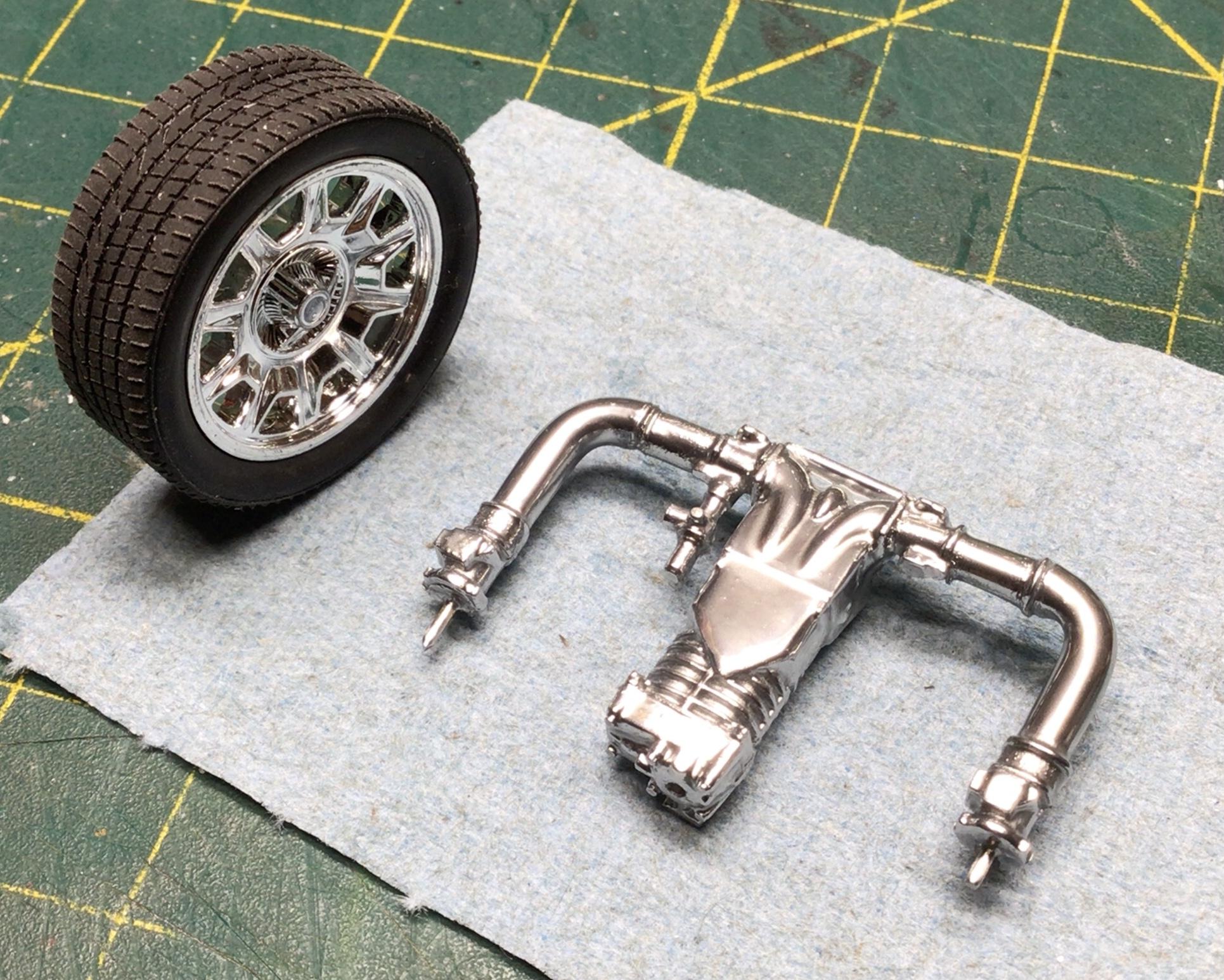

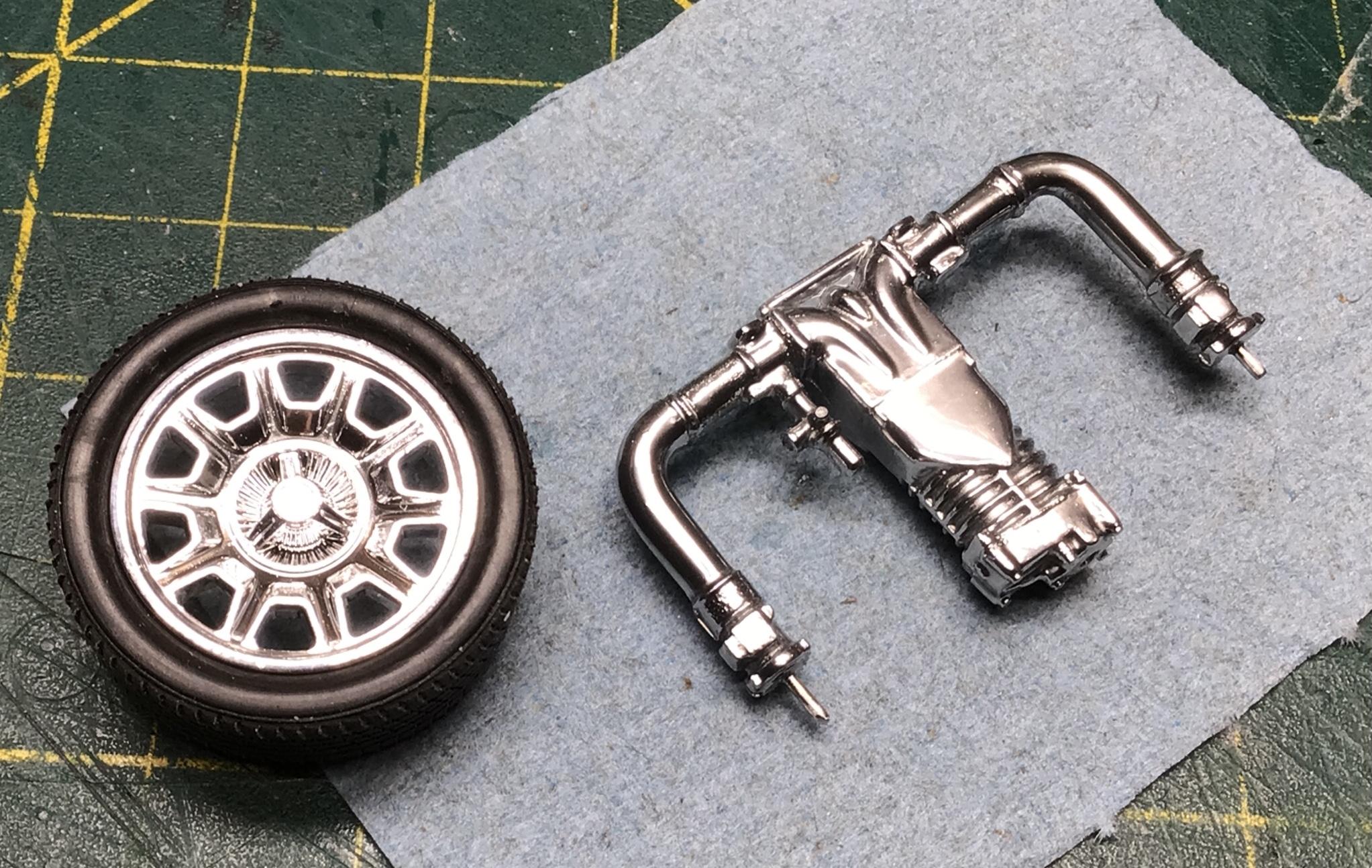

NOBLNG Posted December 17, 2023 Posted December 17, 2023 (edited) Here’s a better look at the Pledge treatment. The blower has one coat of Chrom straight from the can, and then dipped twice in Pledge, about 12 hours apart. The rim is the kit chrome from the Foose Impala. Edited December 17, 2023 by NOBLNG 5 1

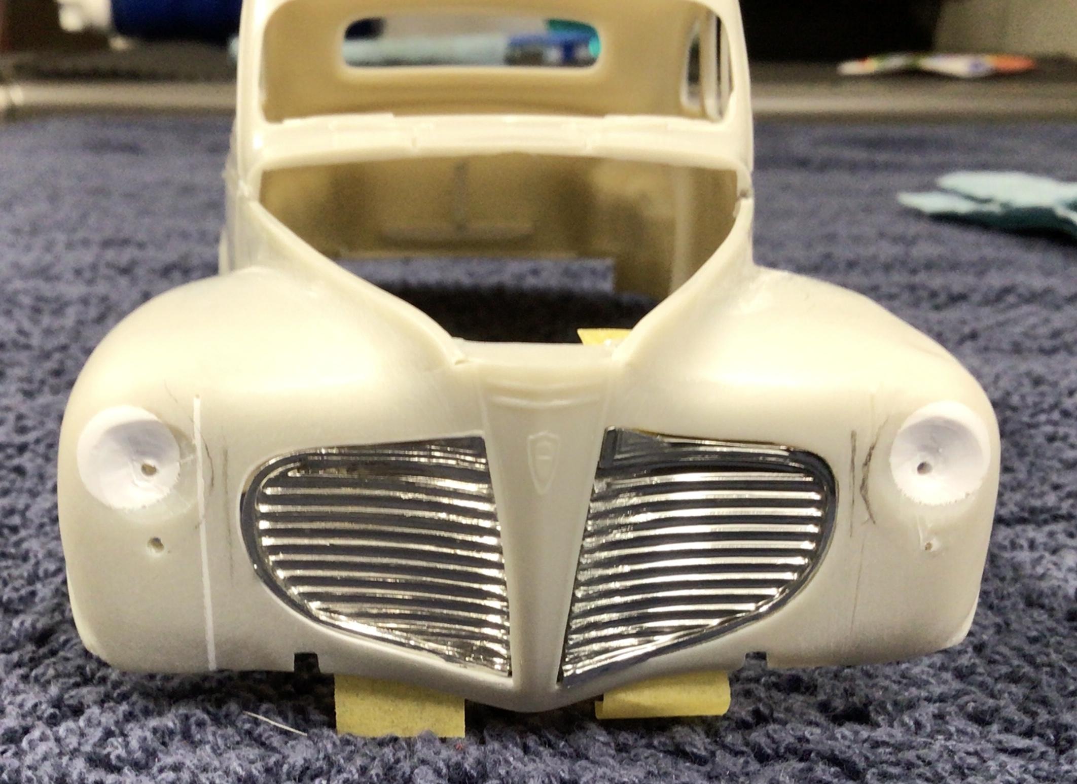

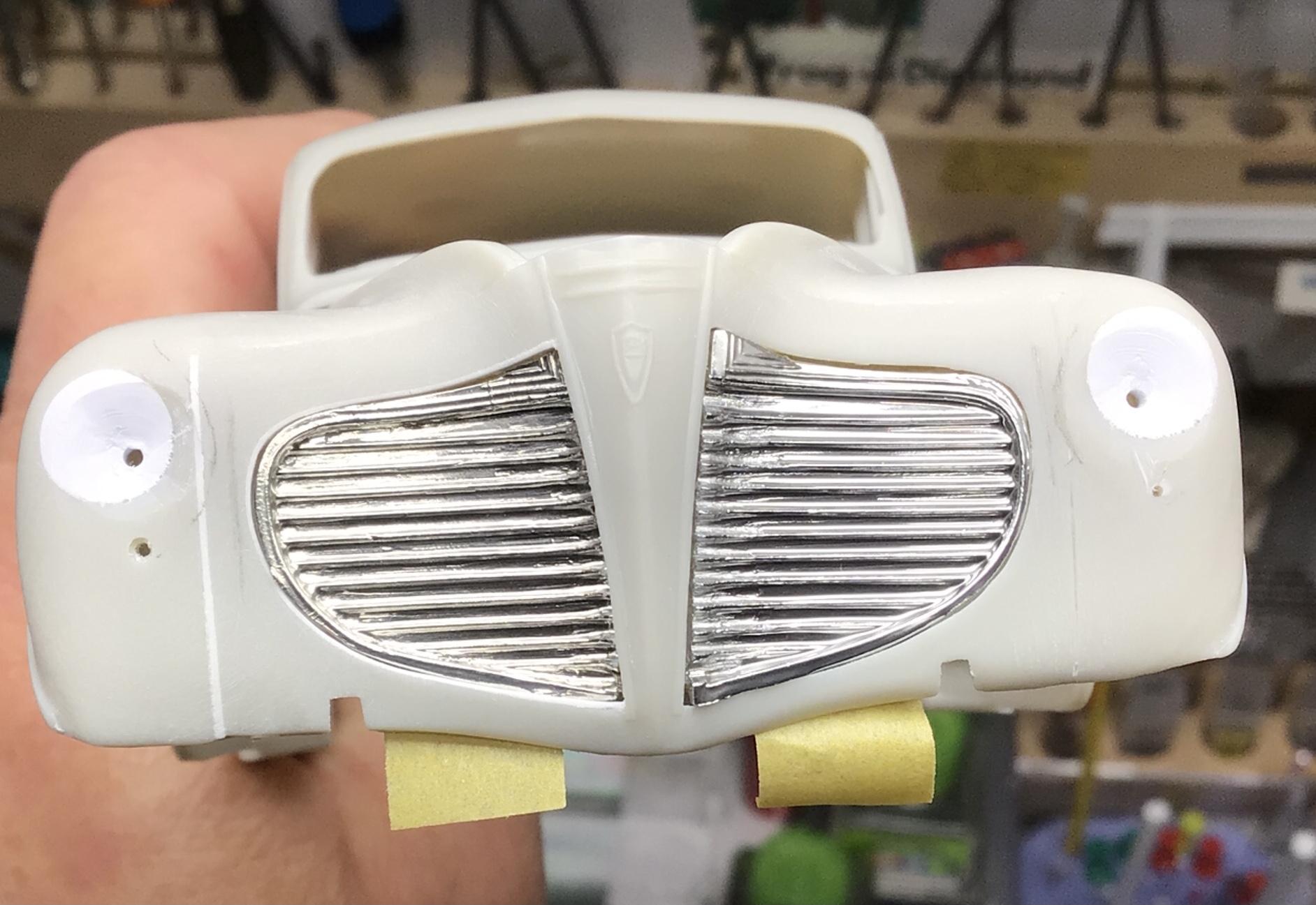

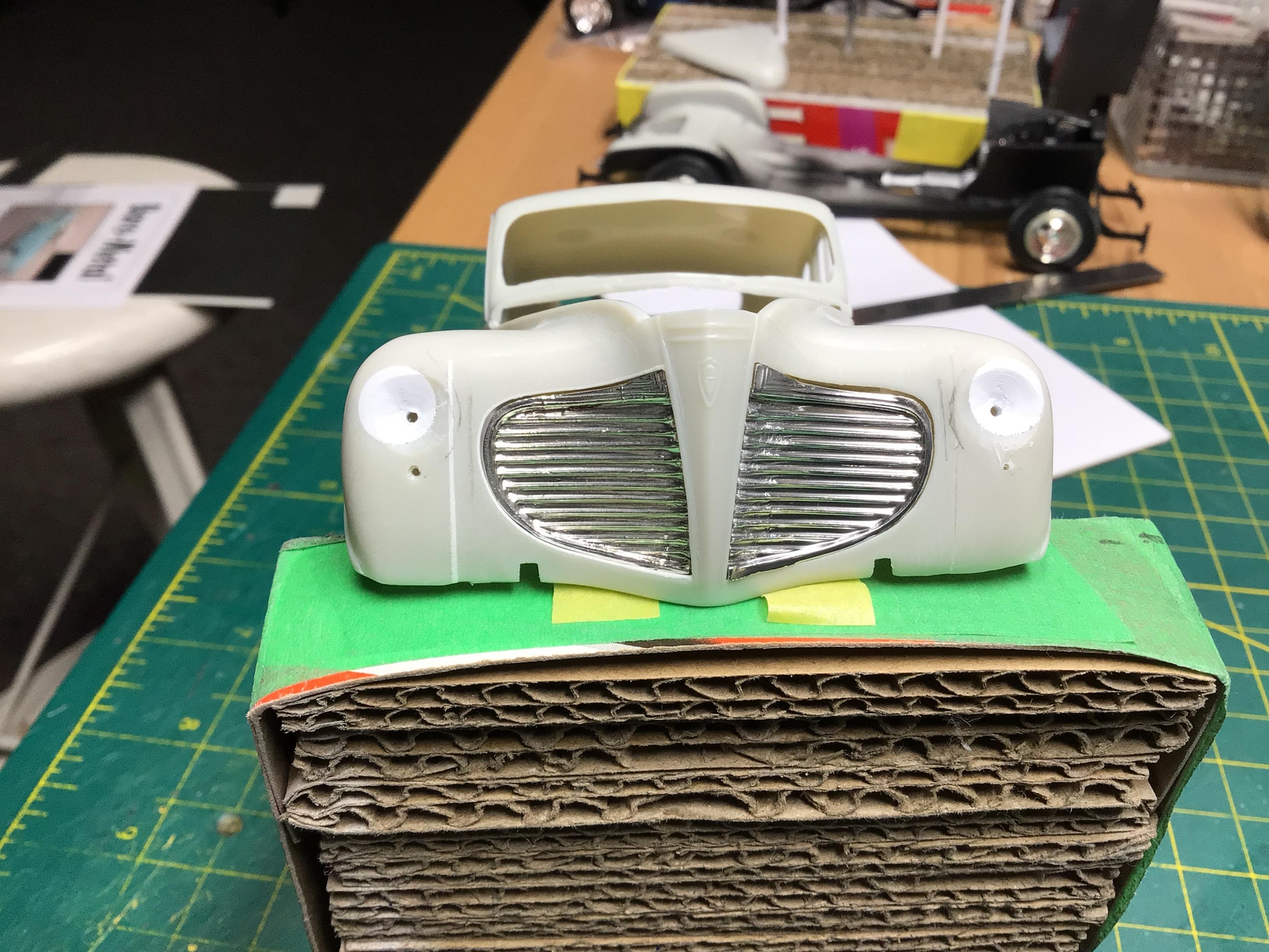

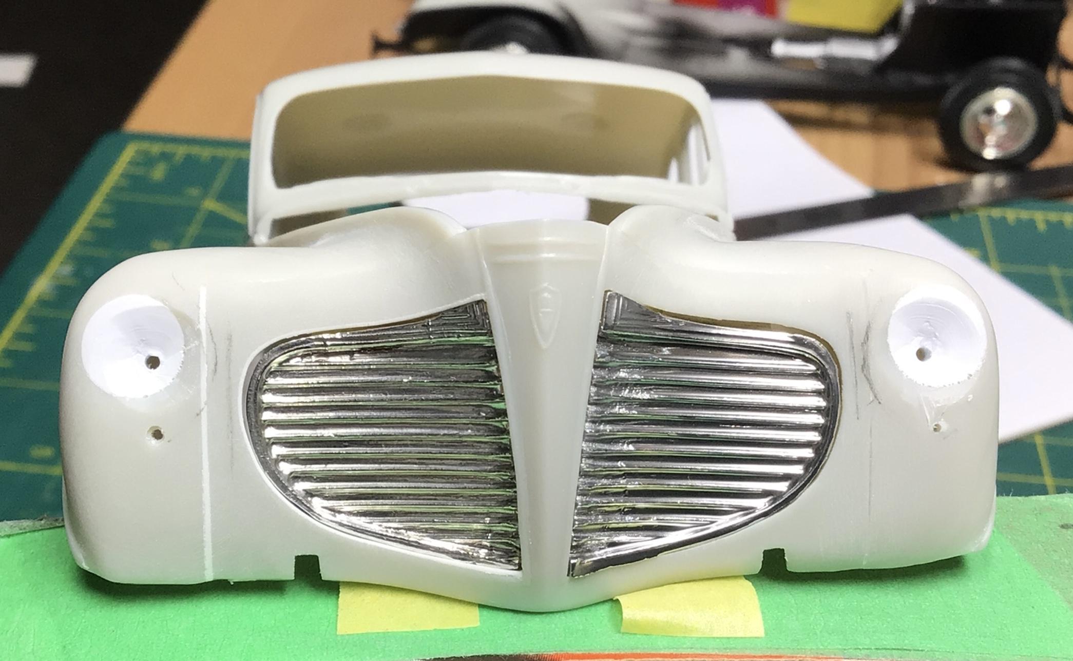

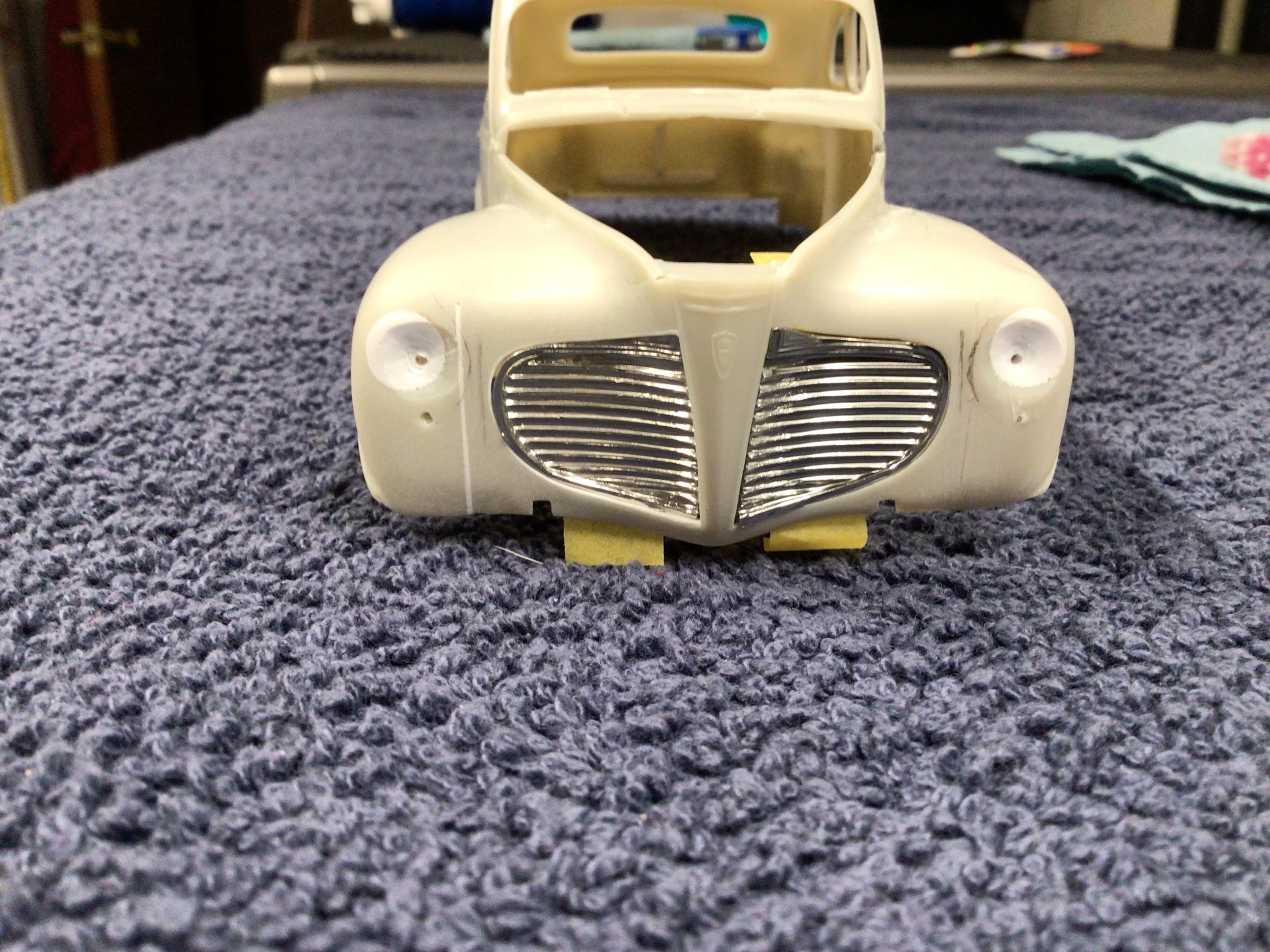

NOBLNG Posted March 7, 2024 Posted March 7, 2024 Here is a shot of a ‘41 Plymouth grill. On the right is the Chrome that I sprayed through an air brush and dipped in Pledge. On the left is BMF. I didn’t sand the slots smooth enough after modifying the grills especially on the right one. 2
Ragtop Man Posted March 7, 2024 Posted March 7, 2024 With the demise of the last chromer (at least, for now) this is a big, big win. In MOST cases, I like the sprays more than the vacuum plating, which has looked sort of 'bubblegum machine' in some racks I got back a few years ago.

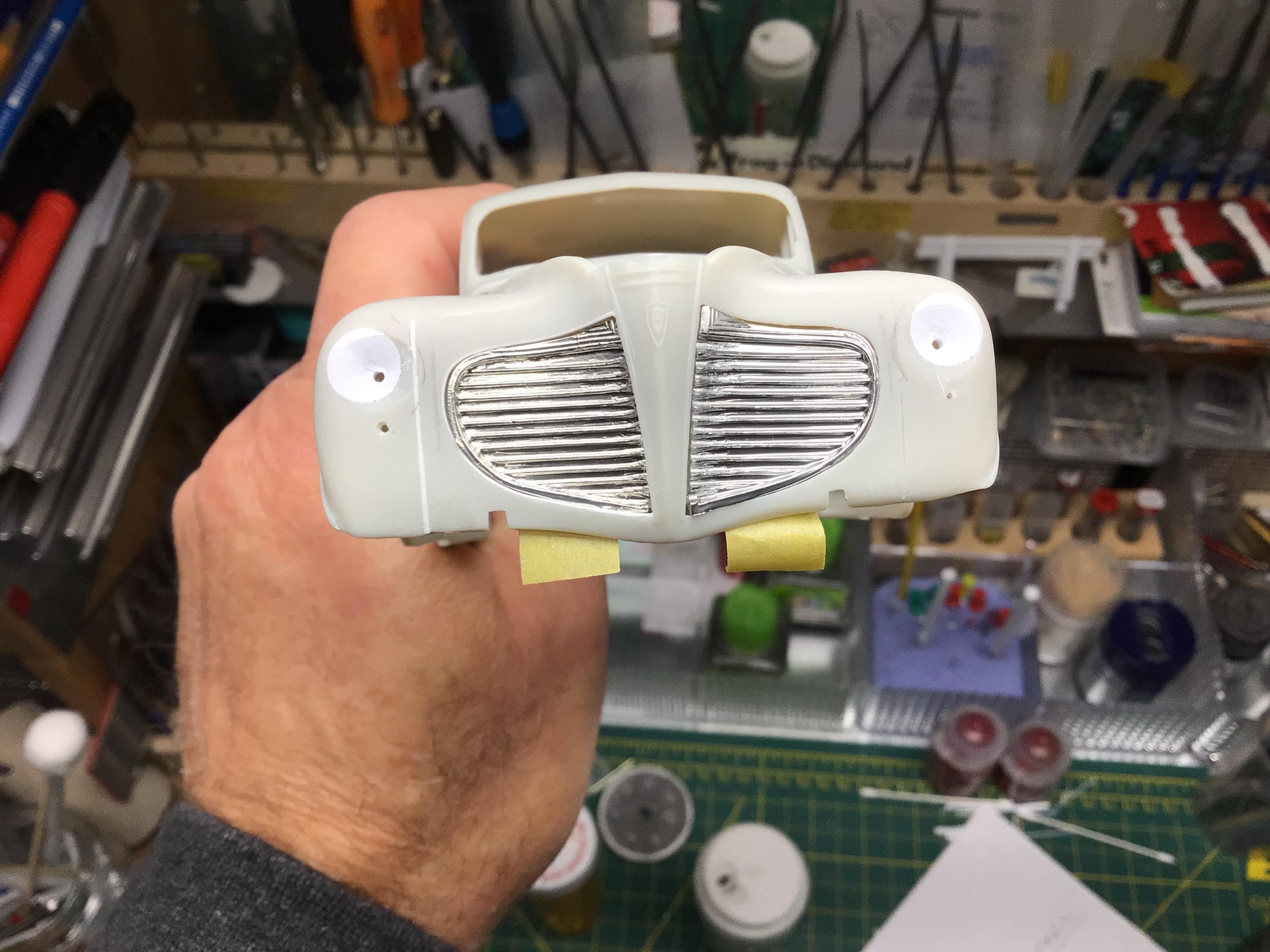

NOBLNG Posted March 7, 2024 Posted March 7, 2024 (edited) This is BMF on the left and Chrom with a pledge dip on the right. The parts have to be stripped and the recesses smoothed better, since I did a rather rough job the first go round. I like the Chrome better, but I have to paint the recesses black, so I’ll test to see which one is better for painting before I strip them. Edited March 7, 2024 by NOBLNG Crop pics
