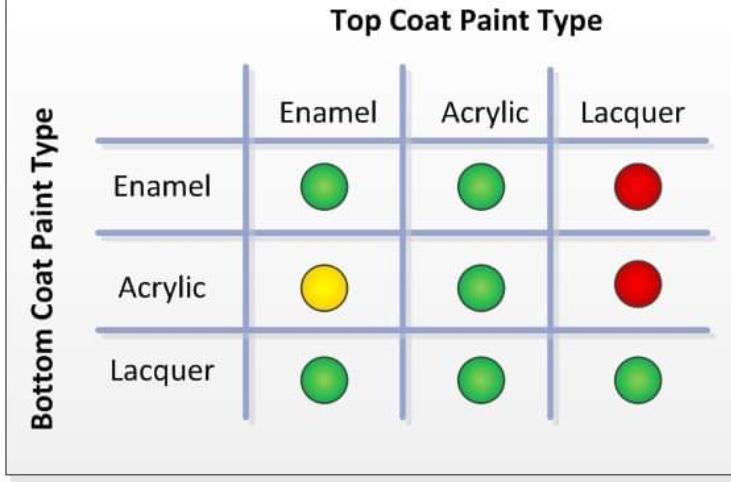

vincen47 Posted May 23, 2023 Posted May 23, 2023 (edited) This general guide is useful. I saved it to my photos. I don’t remember who originally posted it here on the forum, but a big thanks to them. Edited May 23, 2023 by vincen47 1
Jim B Posted May 23, 2023 Author Posted May 23, 2023 That helps a lot. I'll probably print it & post it on my wall somewhere.
ctruss53 Posted May 24, 2023 Posted May 24, 2023 (edited) On 5/22/2023 at 8:43 PM, vincen47 said: This general guide is useful. I saved it to my photos. I don’t remember who originally posted it here on the forum, but a big thanks to them. This can't be right. I spray lacquer clear coat over acrylic paints all the time. Edited May 24, 2023 by ctruss53
Dave G. Posted May 24, 2023 Posted May 24, 2023 11 hours ago, ctruss53 said: This can't be right. I spray lacquer clear coat over acrylic paints all the time. Could depend on the acrylic used. But I agree, certainly lacquers goes over the water based acrylics at least. I've never tried hot clears over Tamiya acrylic but it goes over artist acrylics, craft paints and Vallejo easy enough. I'm moving from clear lacquers on models, going more and more with Createx 4050 or 4053 and very pleased with the results. I still use lacquer over my wife's acrylic paintings though, in fact I'm clear coating one today.
ctruss53 Posted May 24, 2023 Posted May 24, 2023 1 hour ago, Dave G. said: Could depend on the acrylic used. But I agree, certainly lacquers goes over the water based acrylics at least. I've never tried hot clears over Tamiya acrylic but it goes over artist acrylics, craft paints and Vallejo easy enough. I'm moving from clear lacquers on models, going more and more with Createx 4050 or 4053 and very pleased with the results. I still use lacquer over my wife's acrylic paintings though, in fact I'm clear coating one today. I use Mr Super Clear UV Cut almost exclusively, for clear coats. It is a lacquer from Mr Hobby. I spray it over lacquer paints and I have used it over several acrylics. Mission Models, Vallejo, Createx, and Tamiya acrylics, just to name a few. I also spray it over decals and BMF without issues.
