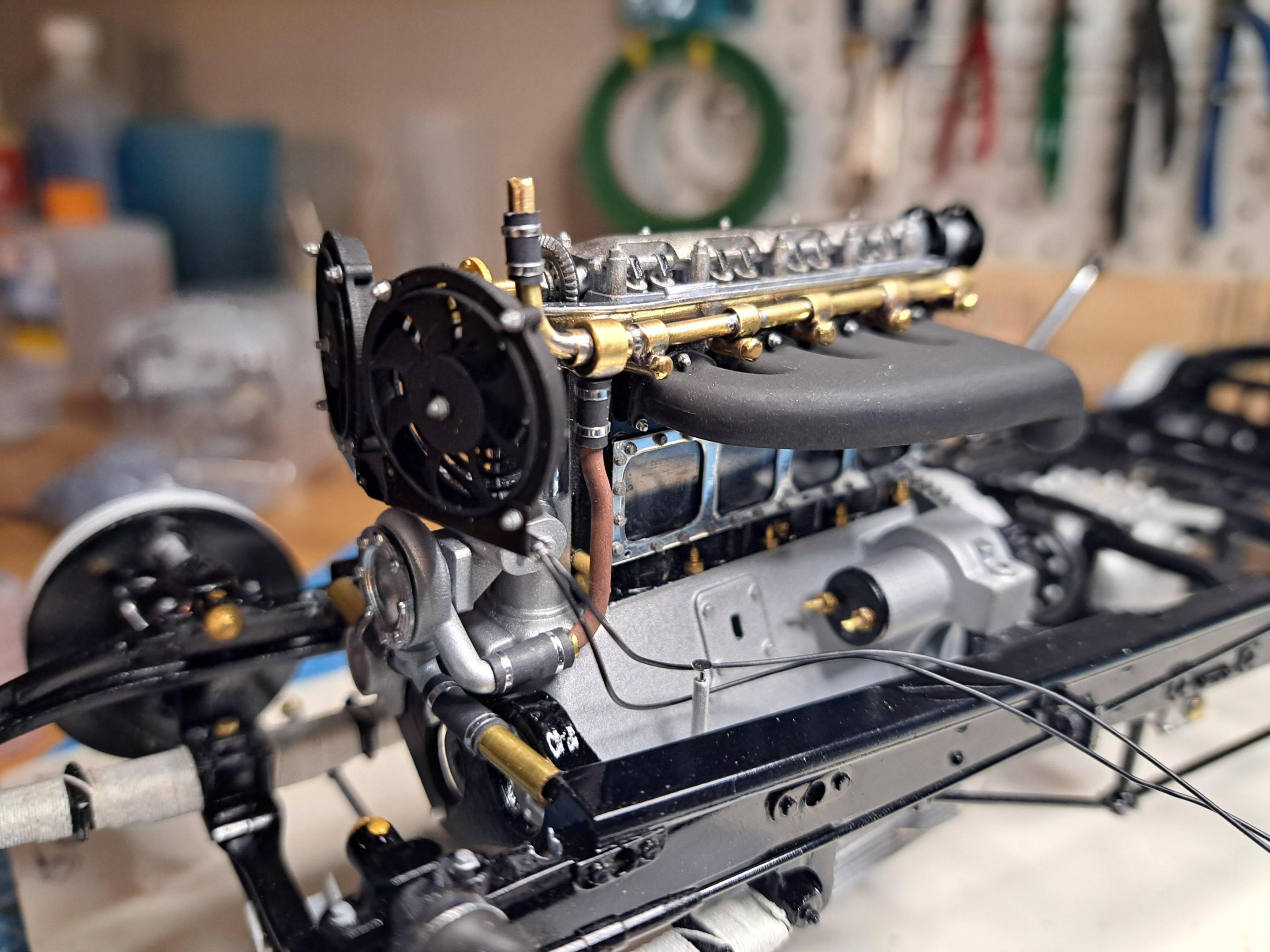

Absolutely stunning modelling, Francois, Your choice to include the two cooling fans is interesting as these were not original fitments and look to me like a much more modern modification. They are beautifully done and the model will replicate your chosen subject as it is now, nothing wrong with that! I love your choice of black as the colour.
Well done!
-Don.

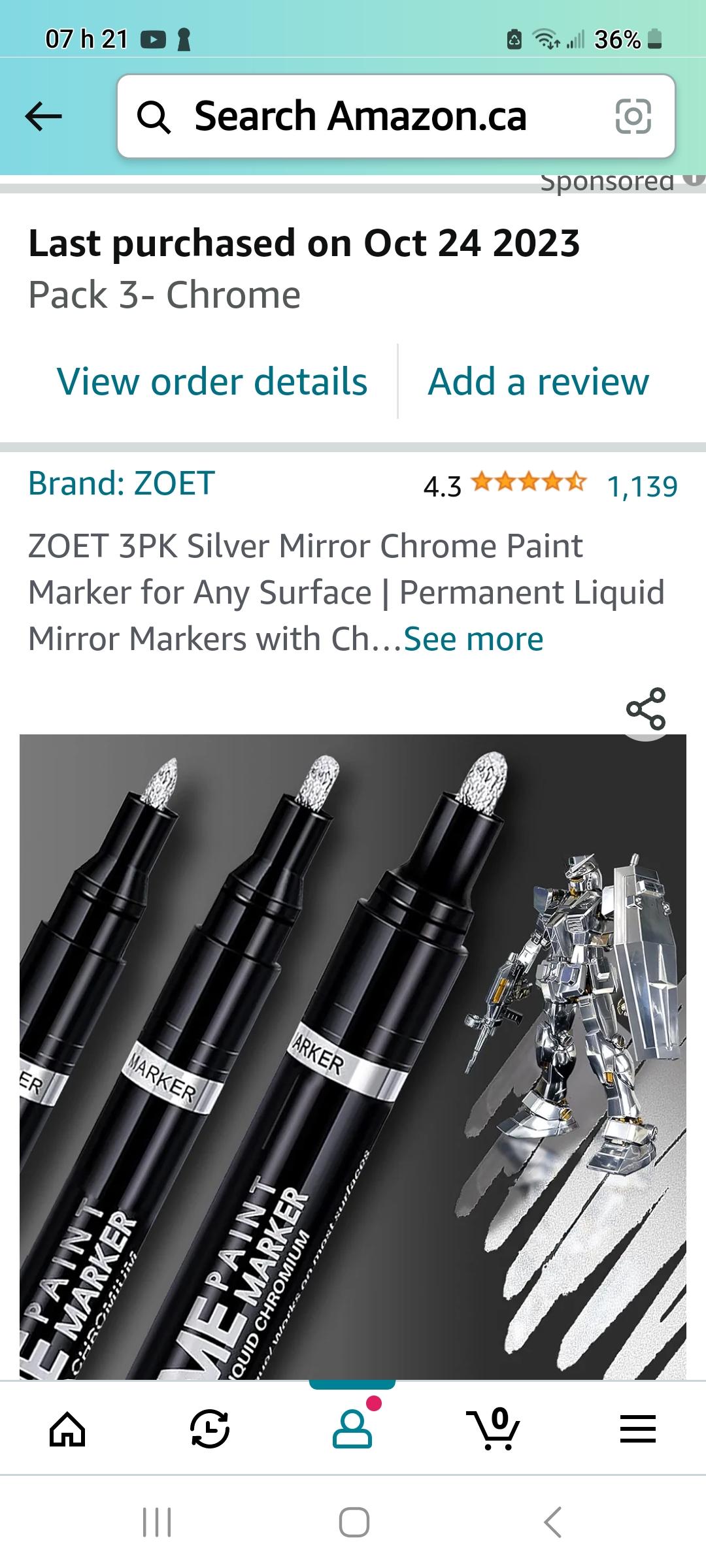

Oops, sorry bugatti. Zoet, on Amazon.
590038169_Screenshot_20231027_072140_AmazonShopping.thumb.jpg.c2ed9c59935e2a5f115b77b83b8b65e9.jpg
Thank you very much Don. Just so nobody thinks I invented the double fan set up, here's a shot of my ref car with the fans mounted. (Sorry for the fussyness, it was taken from a video)

I didn't think anybody is accusing you of inventing the dual-fan setup.  Since  the prototype car you are modeling has them, your modeling is accurate.  But it is a modern modification since I'm sure the original Bentley had a large single fan mechanically driven by a belt from the crankshaft pulley (like most other cars of the day).

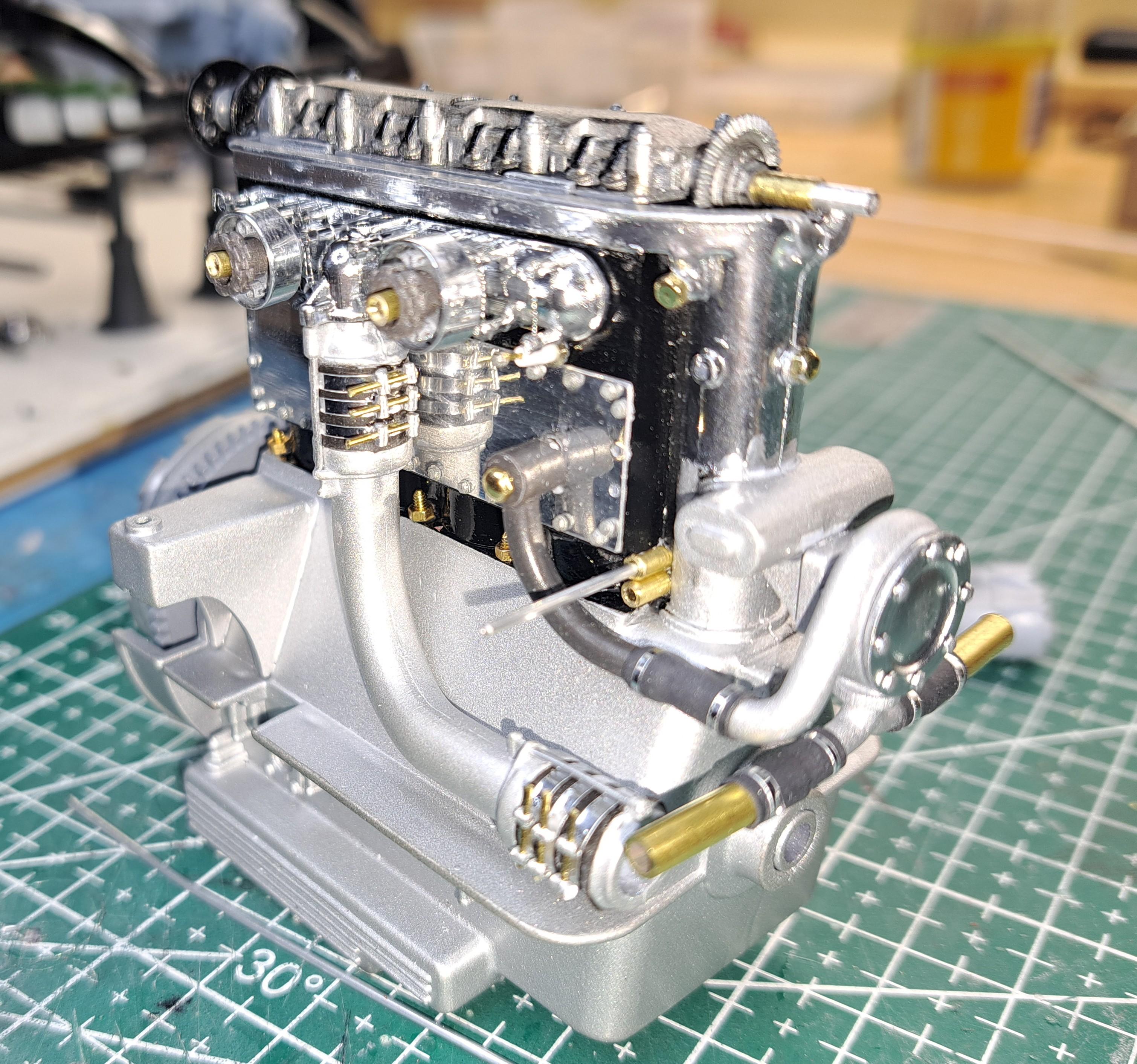

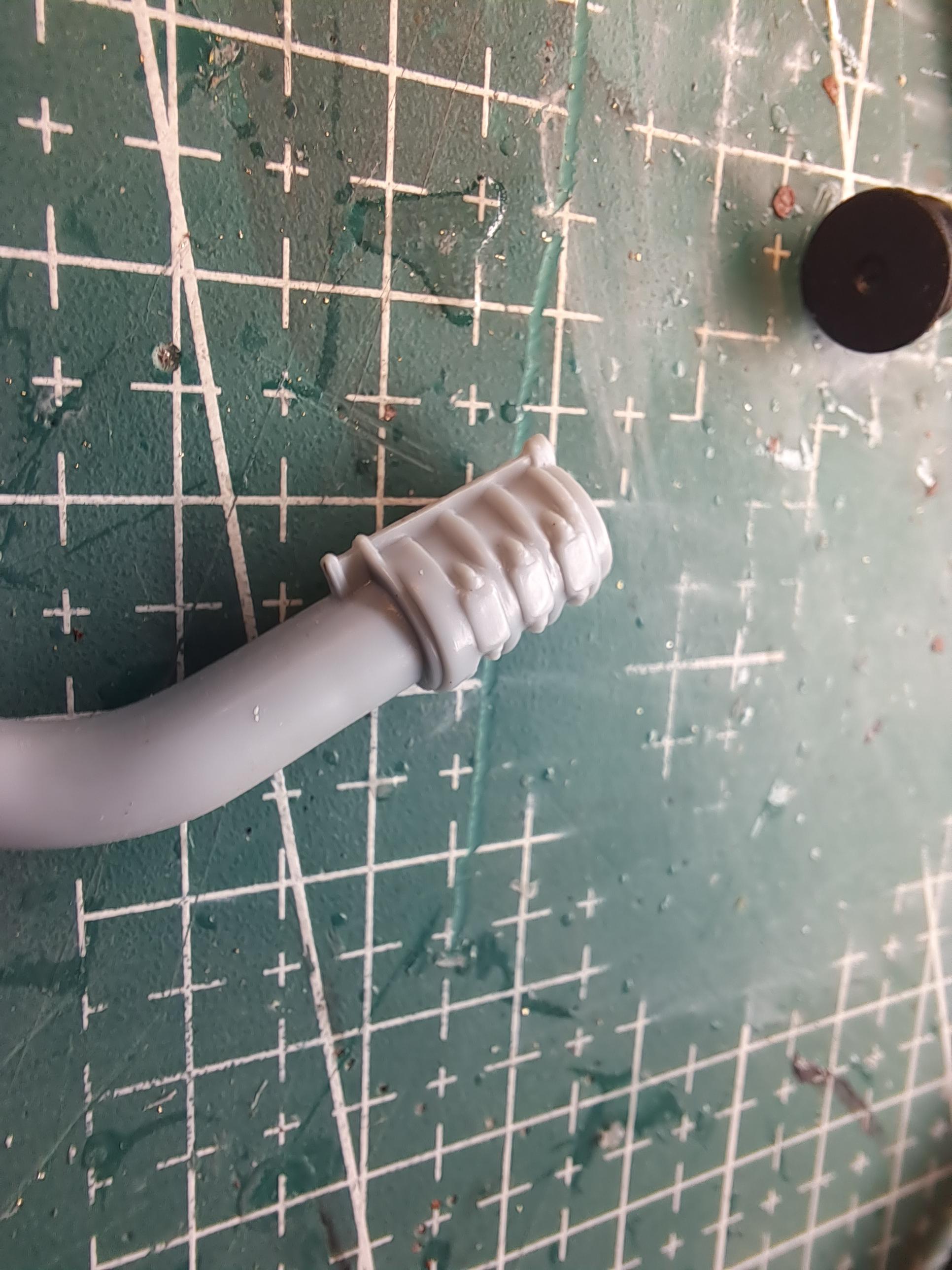

Worked on the blower feed tube today. I removed the moulded features at both ends of the part.
These moulded features represent a rubber coupling with 3 hose clamps and tie rods.
This is the real thing.
And here is mine without the clamps
And once finished

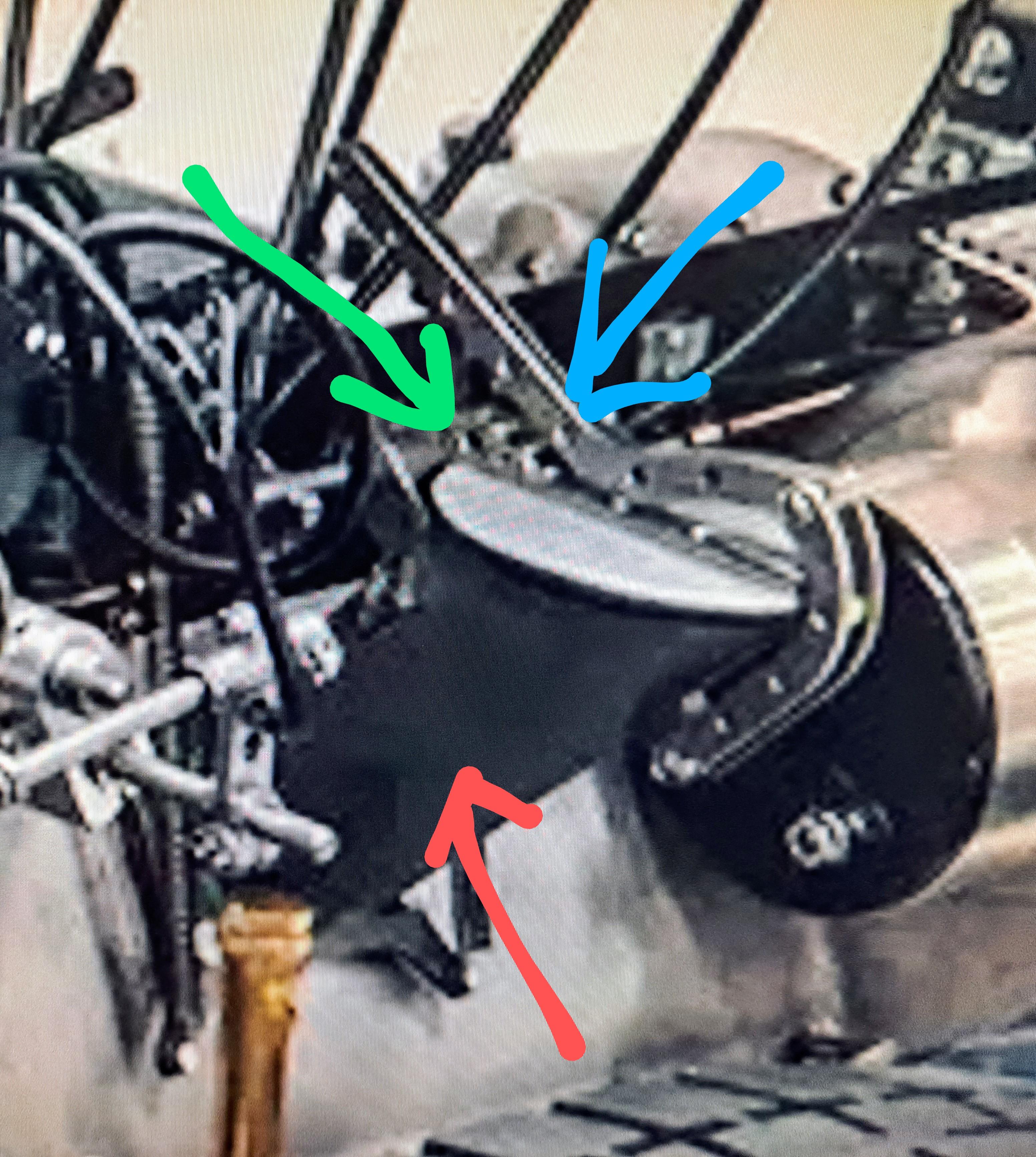

Next. I tackled what seems to be the oil filler neck.
it's this thing. Pointed in red is the filler tube, in blue the cap release lever and in green the cap pivot assy which has a pivot shaft and 2 levers connected to extension springs.
I 3d modeled it the best I could considering the bad picture and lack of info I have. This is what I have.
I'll print the cap and levers, the rest I'll either modify or build from scratch.

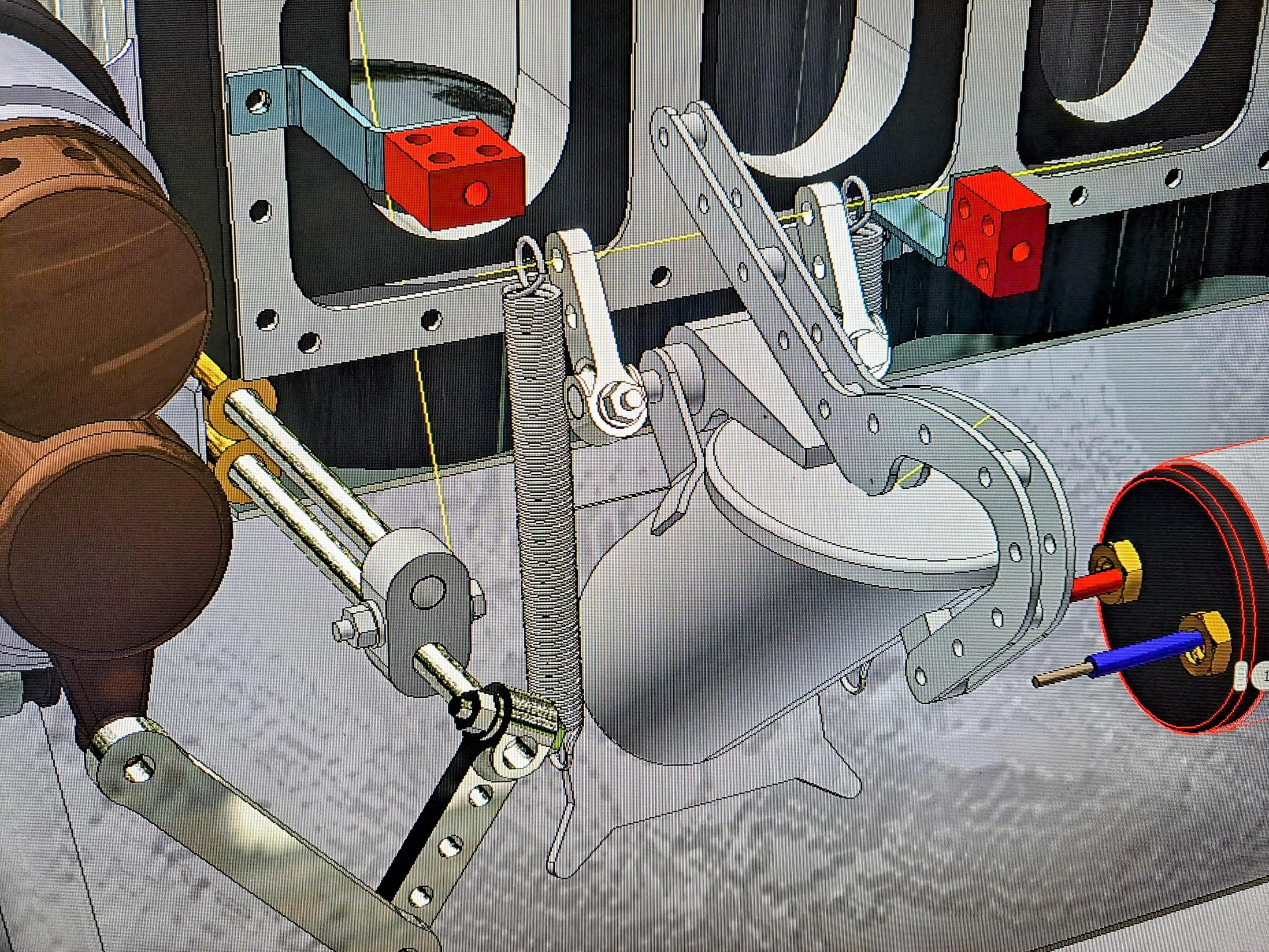

I also finished modeling the magneto linkage.

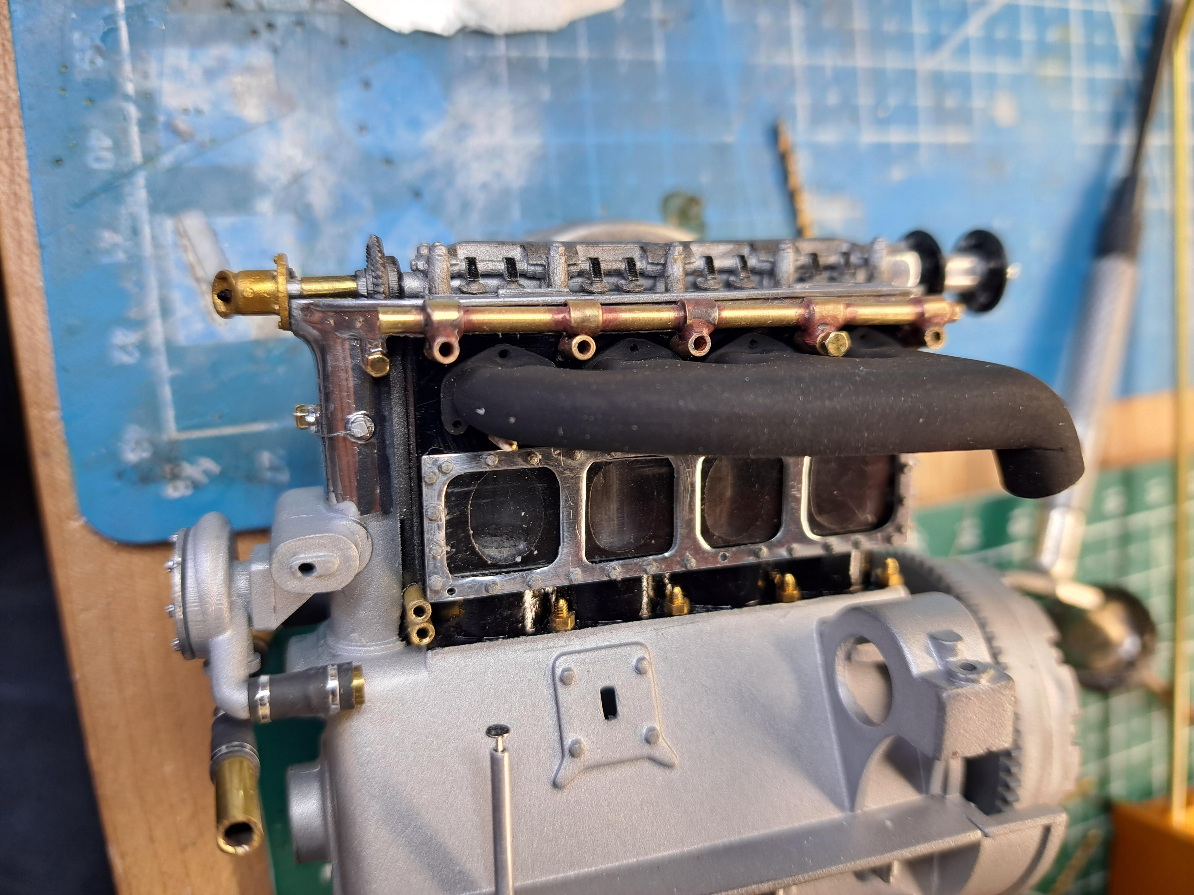

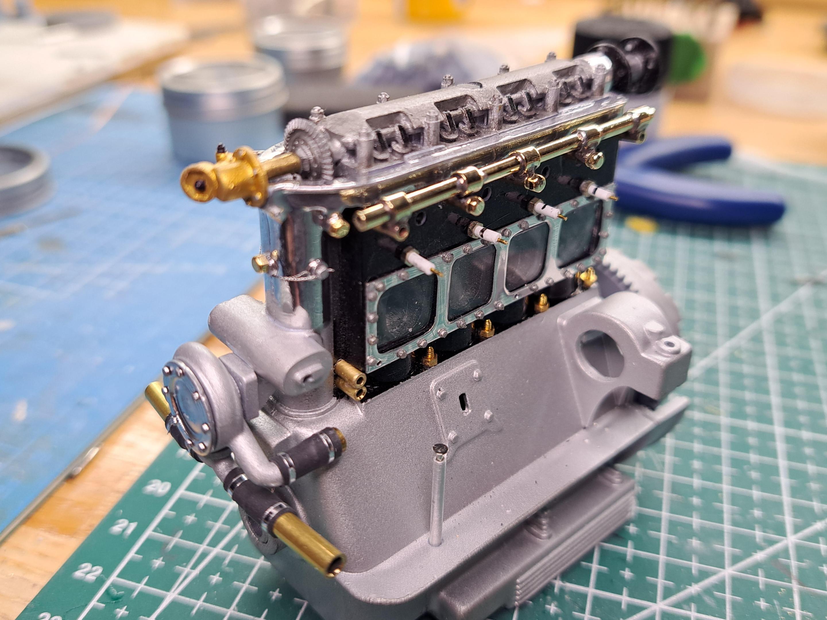

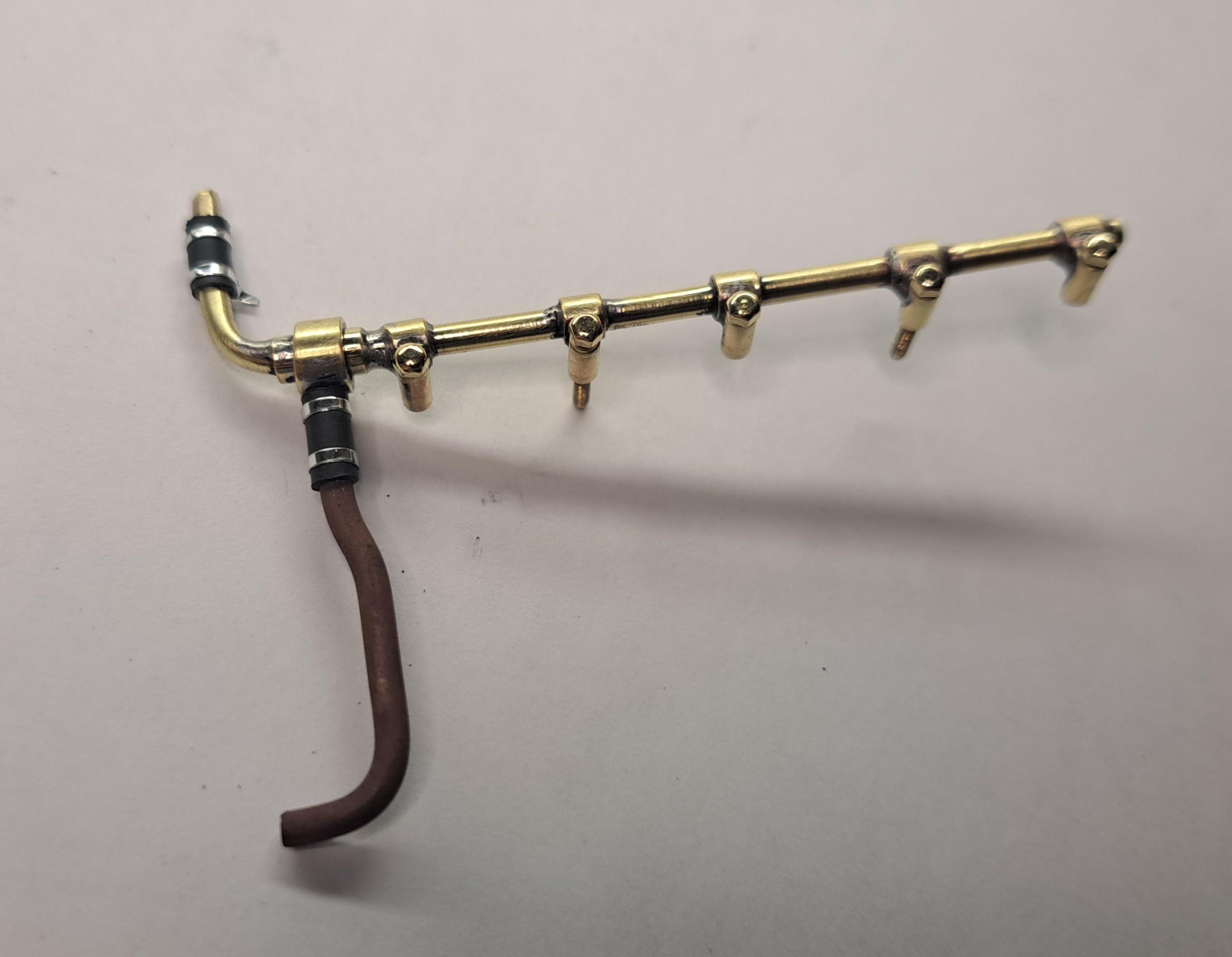

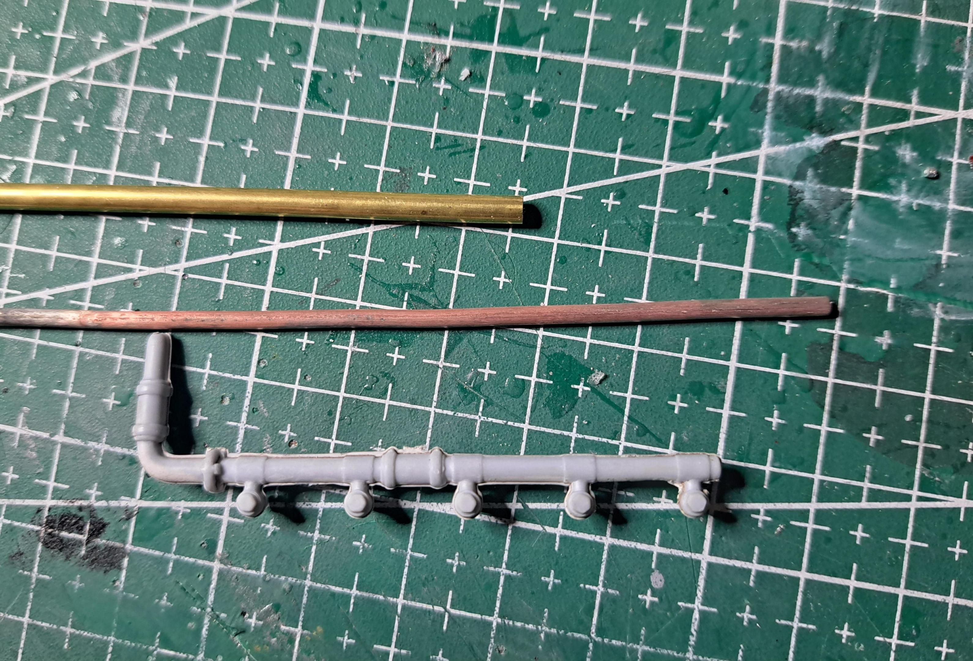

I started to tinker with the water rail, it's this copper tubing.
I would like to make it from scratch using a lenght of lead, colored with a copper patina acid and a brass tubing to represent the jonctions. Not sure if it will work but I'll give it a try.

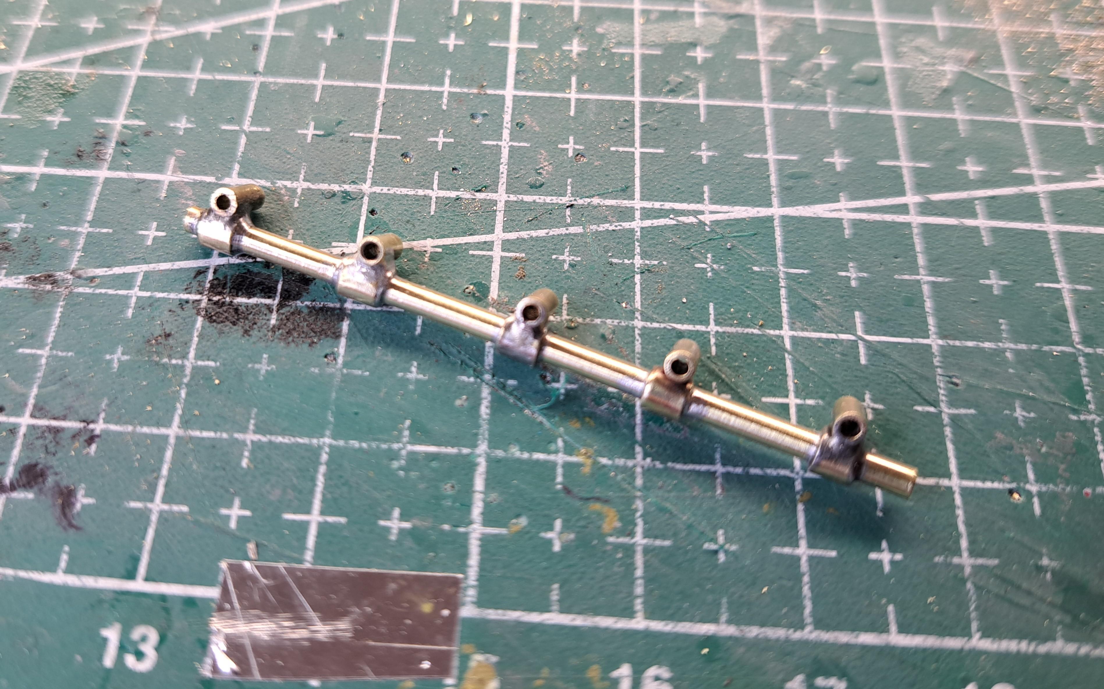

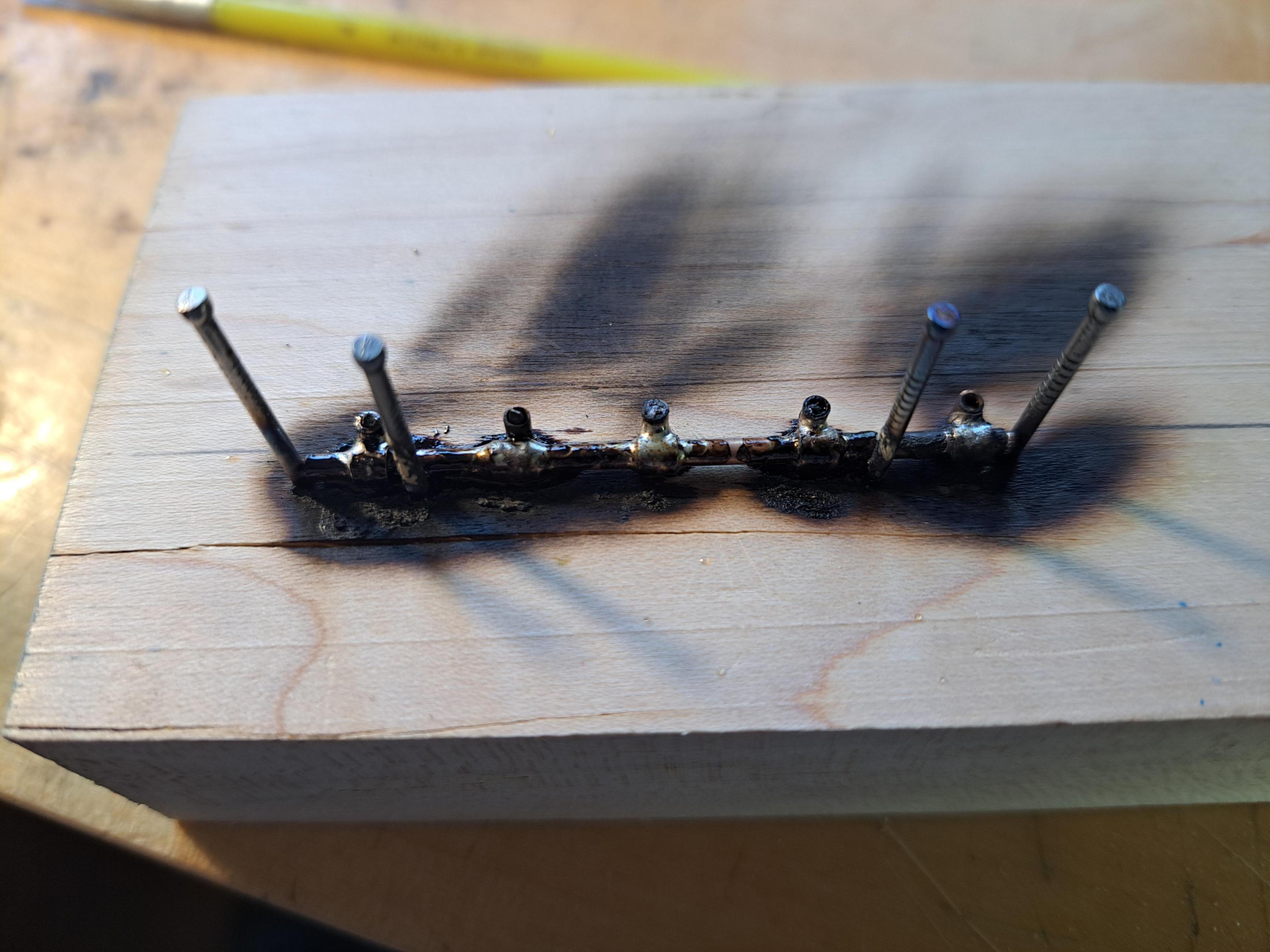

I fabricated the water rail but instead of using a piece of soldering lead colored copper,  I used brass tubing, both for the main tube and for the jonction couplings. After cutting all the parts, 11 in all, I tried to glue them together.  That did work so good. I decided to solder the joints as on the real thing.  So I started by making a welding jig. Which is this.
On my first try, I used small steel pins to hold the 5 small vertical tubings but after soldering, the pin were stuck inside the tubes. So that didn't work either.  This was the result.
I then replaced the small steel pins with aluminium pin and applied much less solder. This is what came out of the jig.
much better. And after cleaning i got this
Test fitting to make sure it would fit with the exhaust manifold
and after a quick polishing, got this.
I'm very happy with the result,  it came out a lot better than expected. Now I just need to go get a few hex bolt (I'm missing 1 at each end) and to figure out how to make the jonction to the rad.
Super - even with all of the skill you’ve developed with 3D design / printing - the engine still required some last century black-smithing for certain critical parts ….
I discovered that on the new old bentley blowers built in 2019, there's a pipe connected to the water rail going down to the water pump. Back in the 30's, this pipe was used only on the non blown car, not on the blowers.
Here's the pipe on one of the 12 new Blowers.
176273787_Screenshot_20231101_053234_Photos2.jpg.a1360445e44ef82615d4fe614b1cbab2.jpg
So I added it to the rail setup.  I also added the tubing that will connect to the top of the radiator. I also added the starter motor which is actually a micro gearmotor.

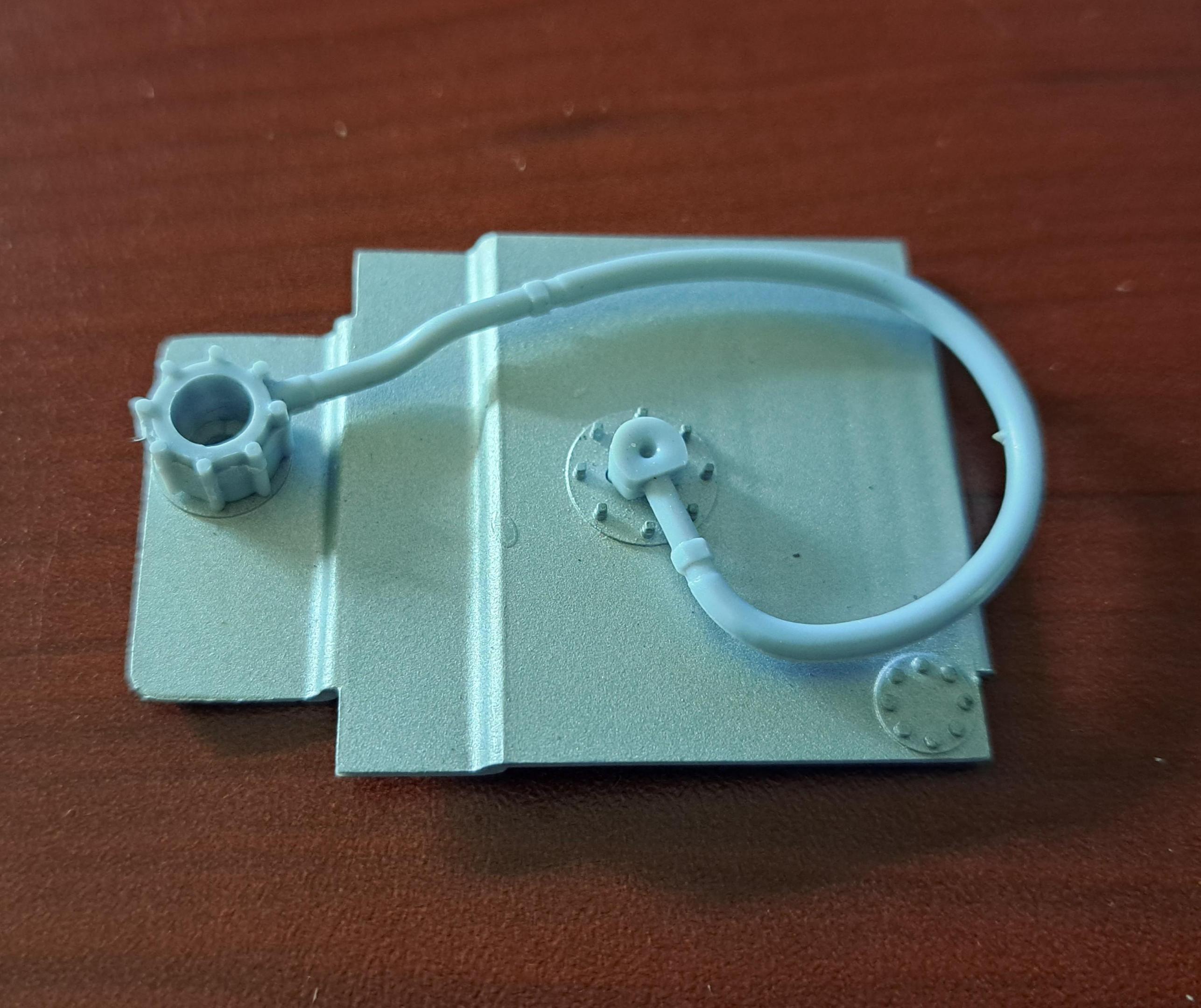

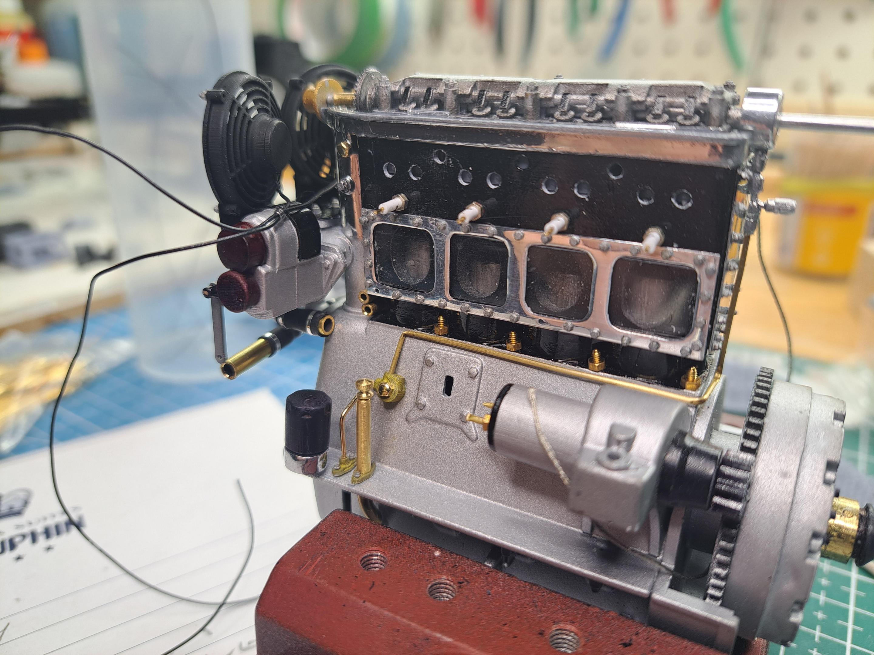

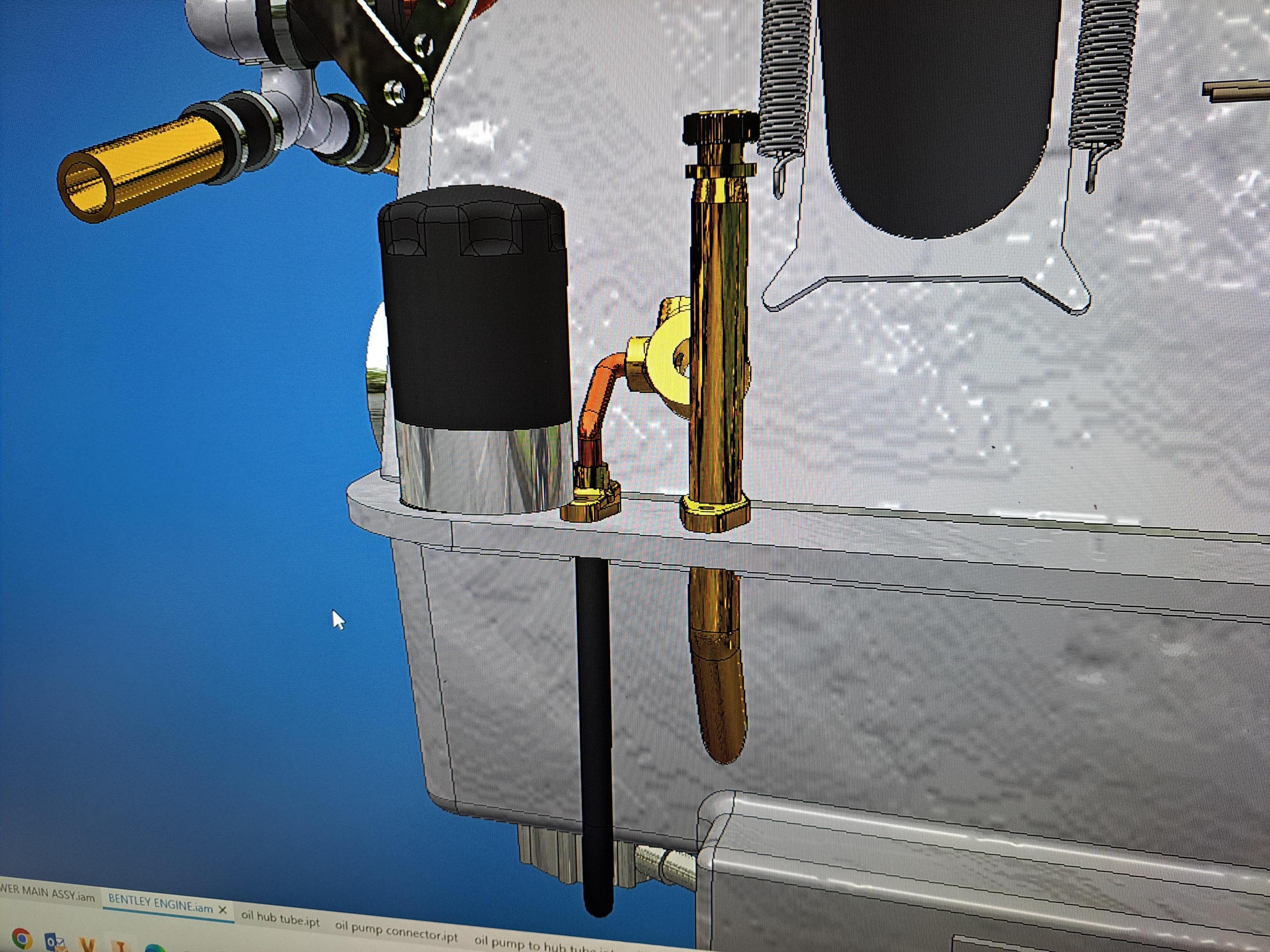

I've been working on the oil management system which is not present in the base kit.  Aside from a hose on the underside of the engine, that seems to go from the oil pump to the sump, there's nothing.
I had already made the oil level dip stick but I didn't like it so i made a new one.  I'll also add a modern type oil filter, the oil pump, an oil distribution hub that will connect to the cam shaft among other things. The one part that is in the kit, the hose under the engine, will be modified by replacing the plastic hose by a real rubber hose plus I'll add another hose from the pump hub to the distribution hub.

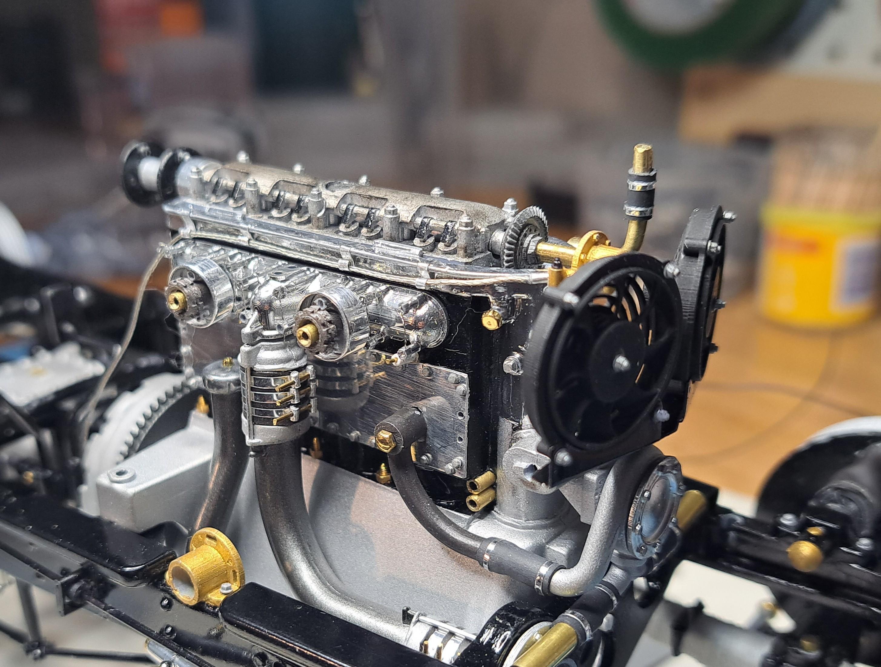

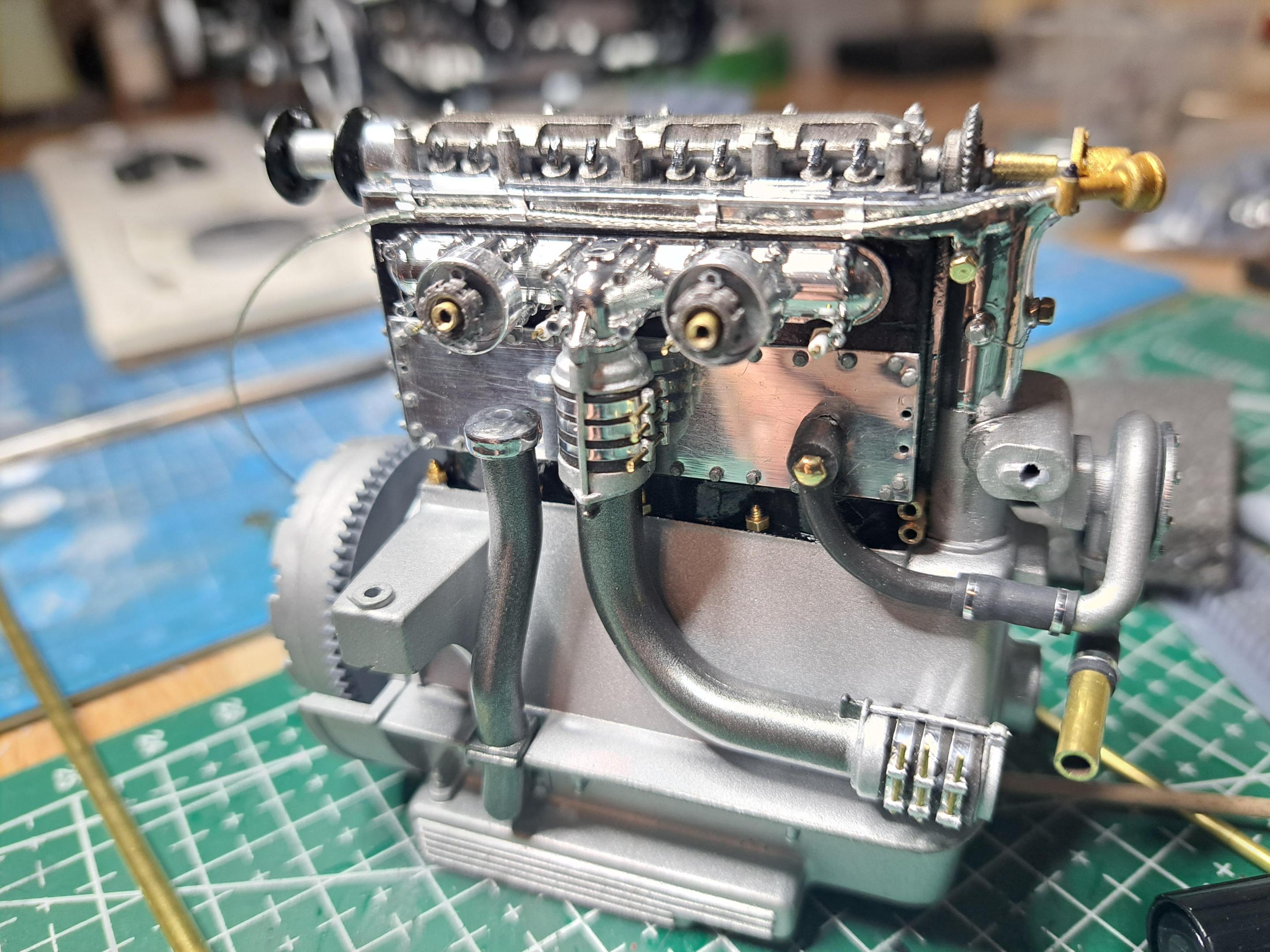

I also added the cooling fans.
Here are a few pictures.
Only part present in kit
New dip stick
Oil on stick
3d modeled components to be added
Cooling fans in place

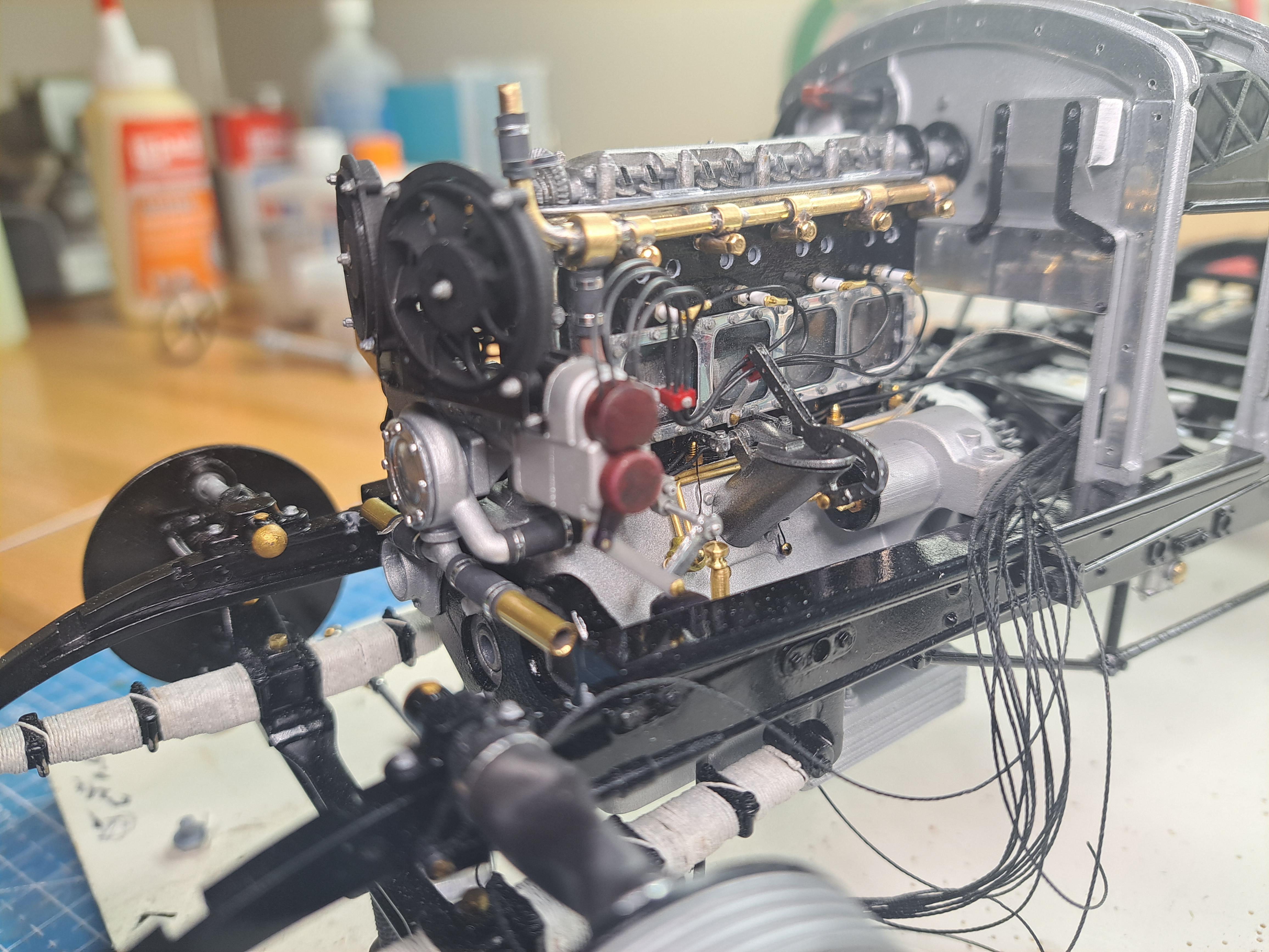

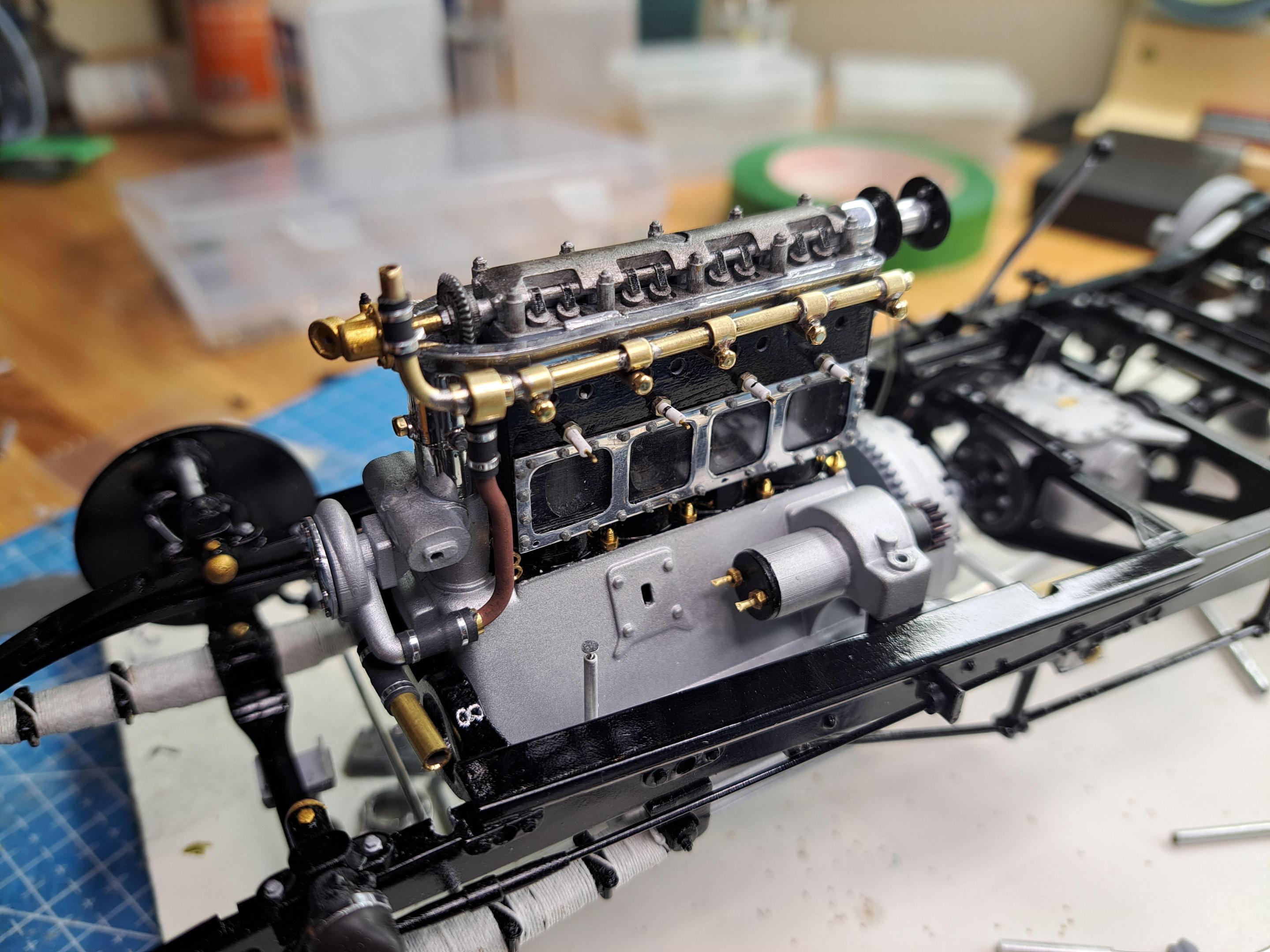

Received a bunch of printed parts for the engine.
I test fitted the oil filler tube.

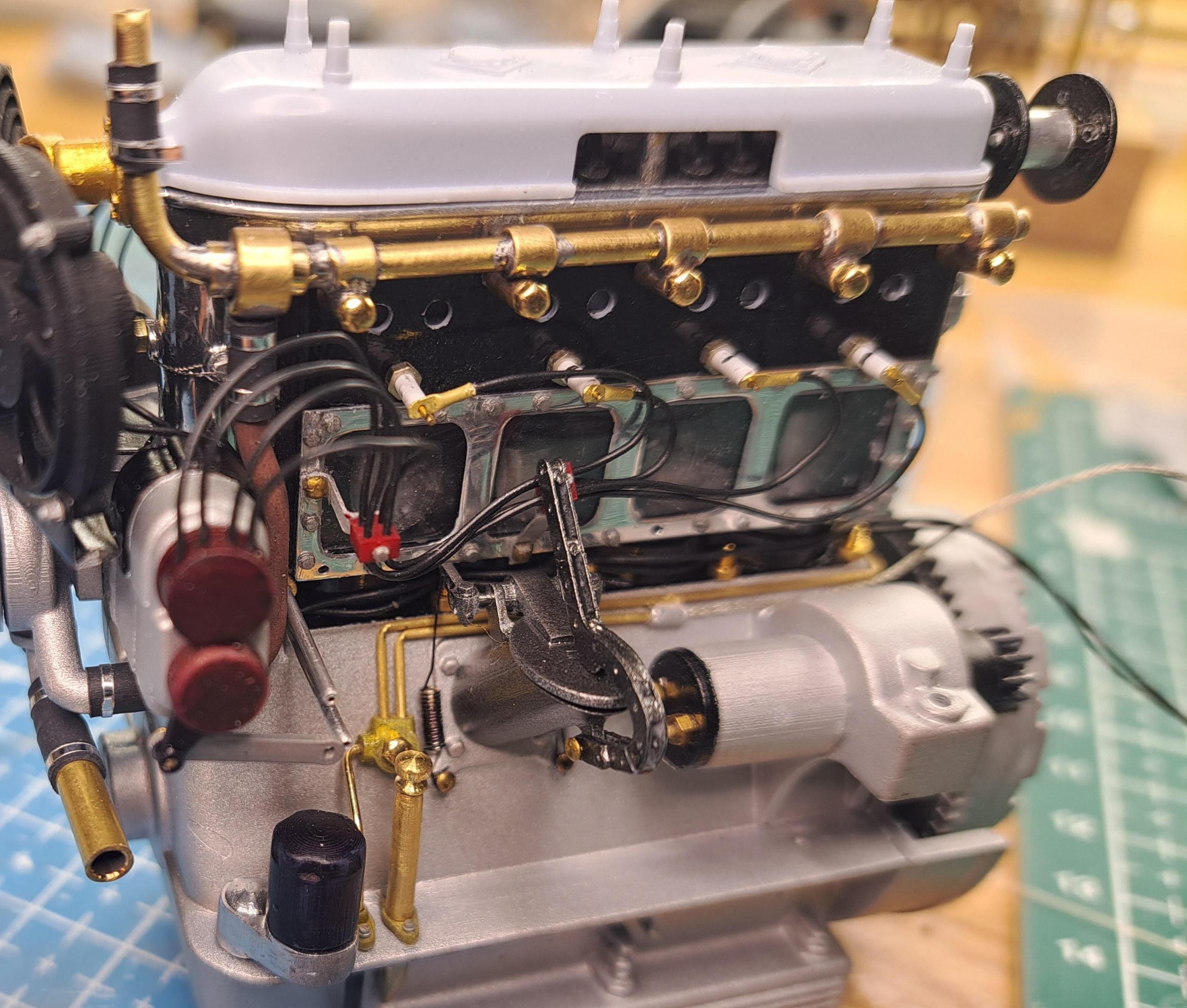

Installed the oil filter along with a small connection hub and oil line to cam shaft.

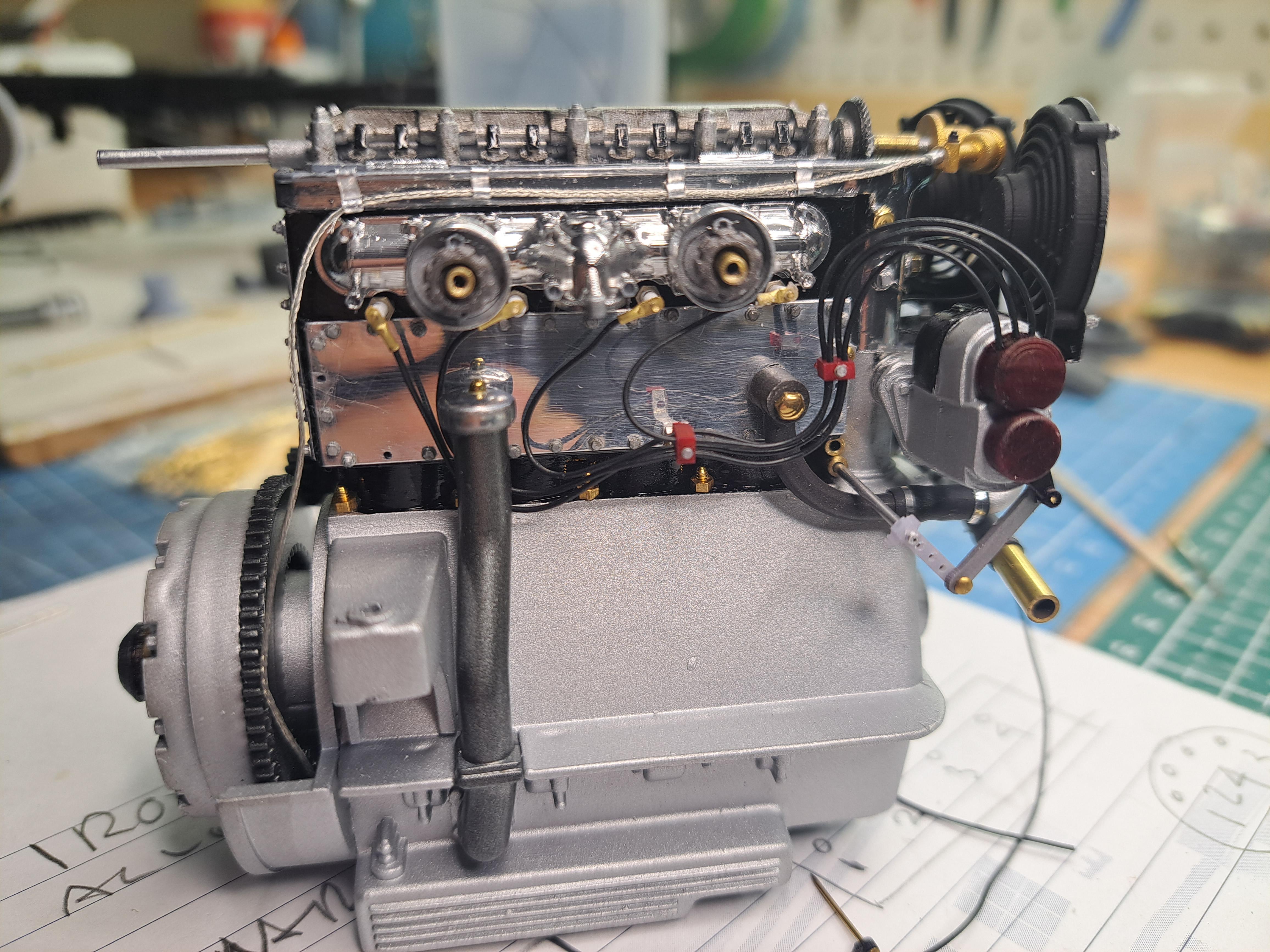

made 4 spark plug cable pass thru bloc
Installed plug cables and magneto on drivers side.
the real thing
411733629_Screenshot_20231110_232400_Photos2.jpg.2937925bf43ceb80064f7a98a7351486.jpg
The plug wires are done on the passanger side and with the installation of the oil filler tube assy, the oil management system is now complete.
I'll try to complete the magneto linkage next. I really wanted these linkages to work but I'm not sure l'll be able to.  In order to respect the scale,  the levers are very small ans fragile.  They break very easily.  The worst case will have them glued in place and for show only.

I worked on the magneto linkage and after some tweaking and lever reprinting, I was able to assemble a functional mecanism.  Now, it still needs to be connected to the stator shaft on the steering column but that will be much later. Here are a few pictures.

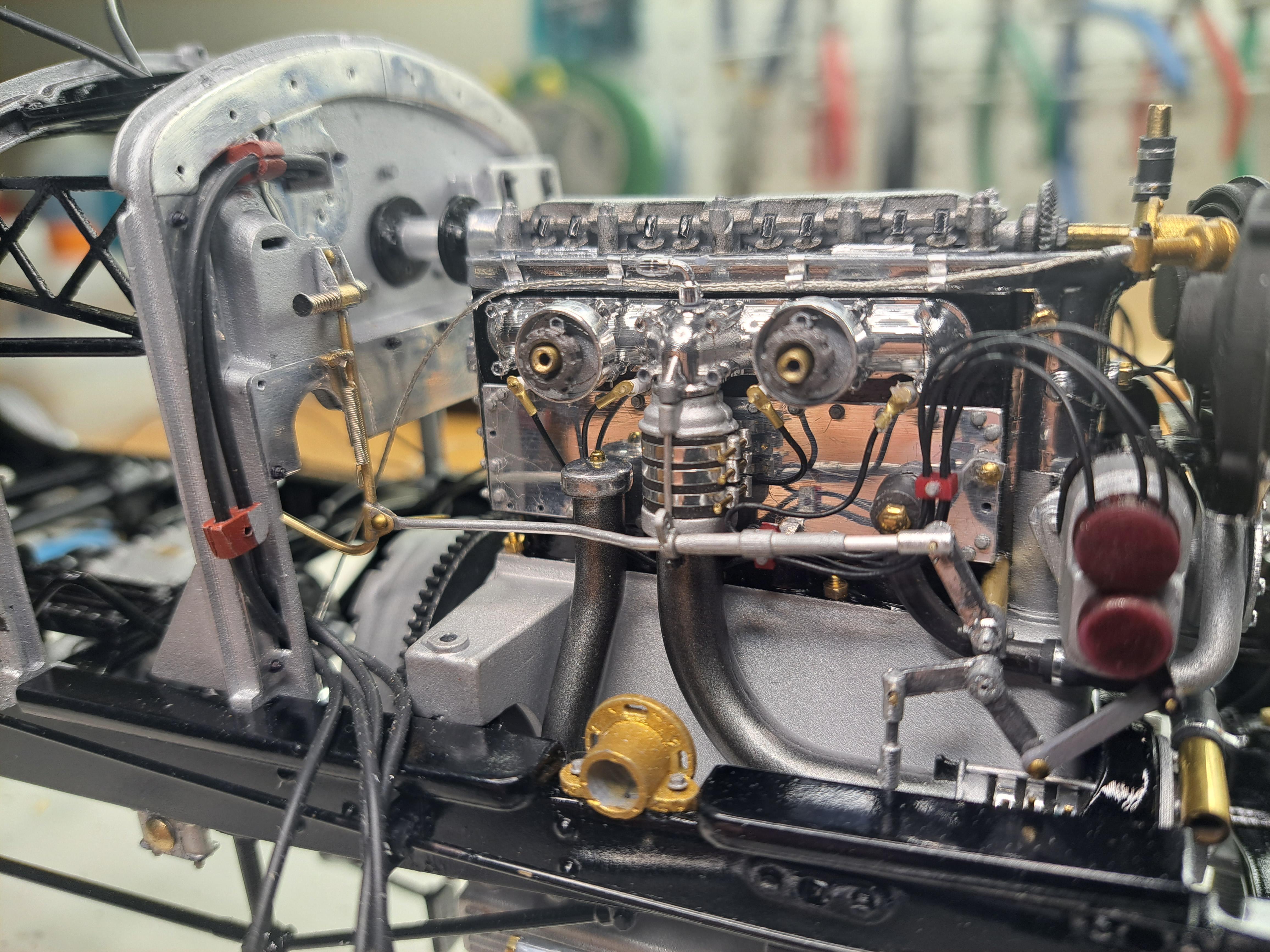

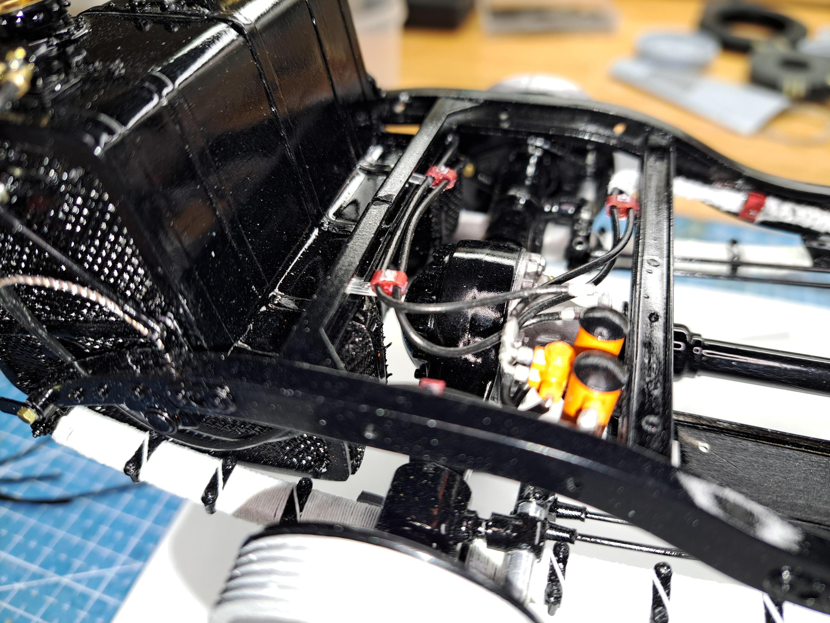

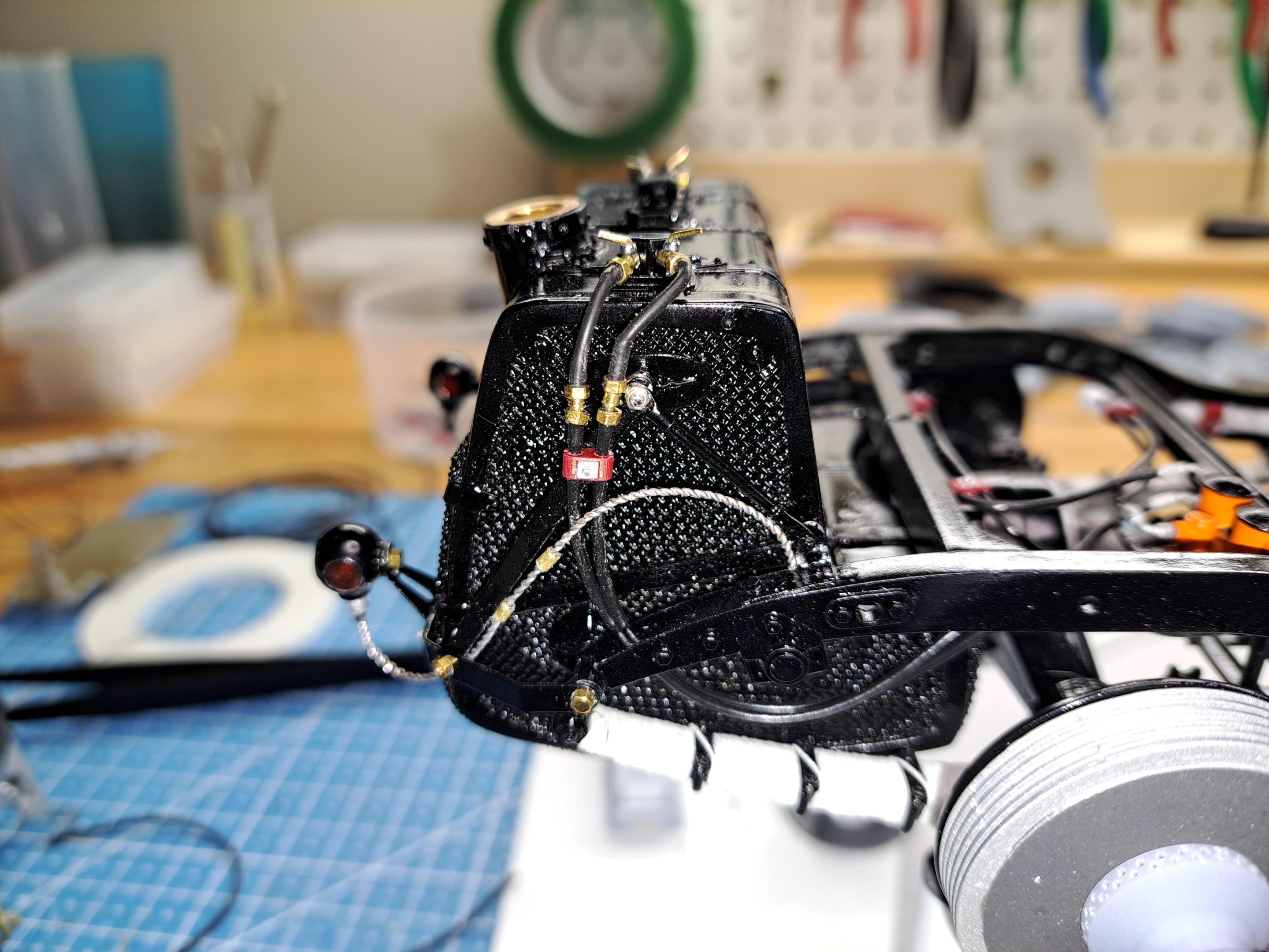

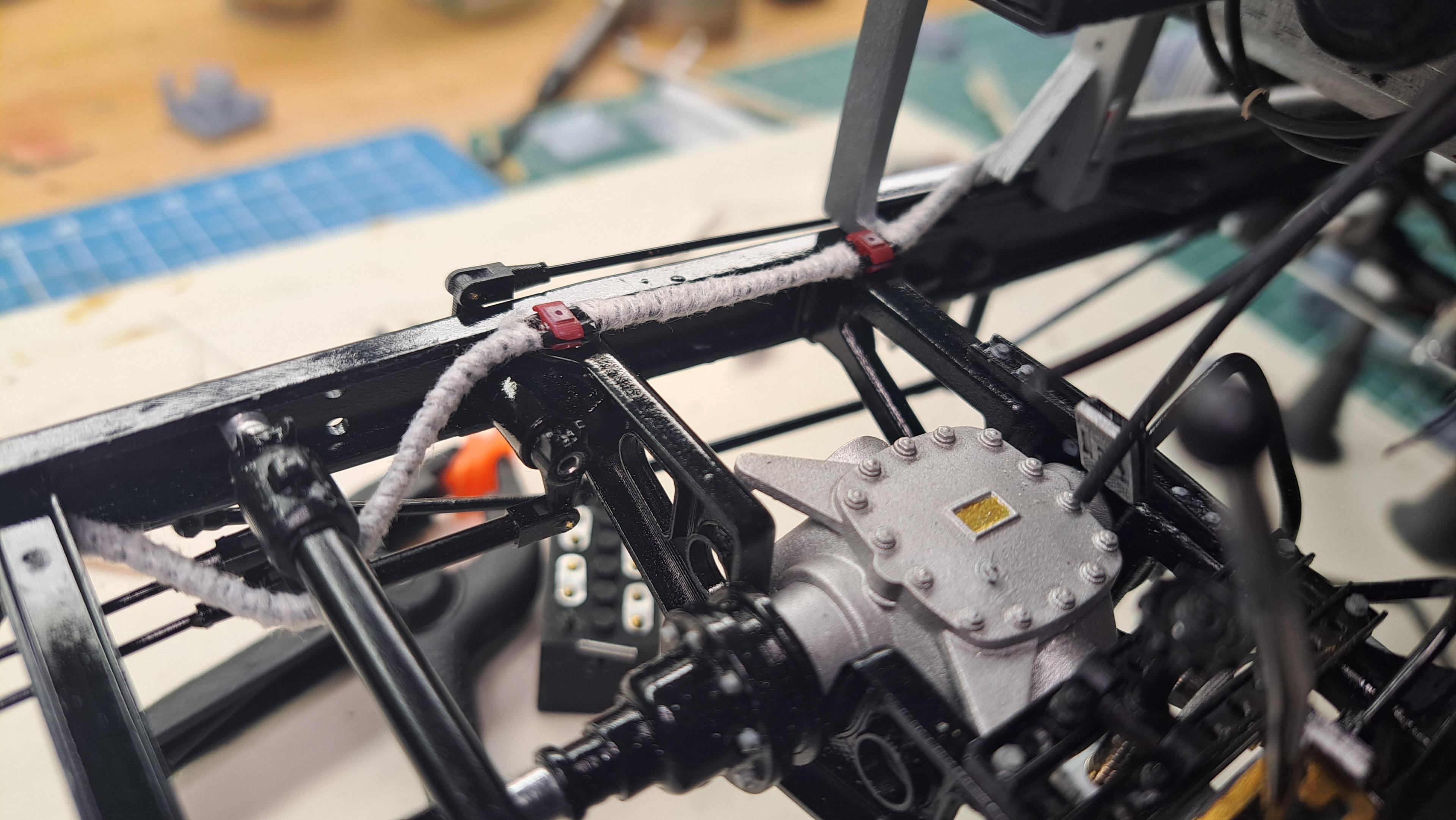

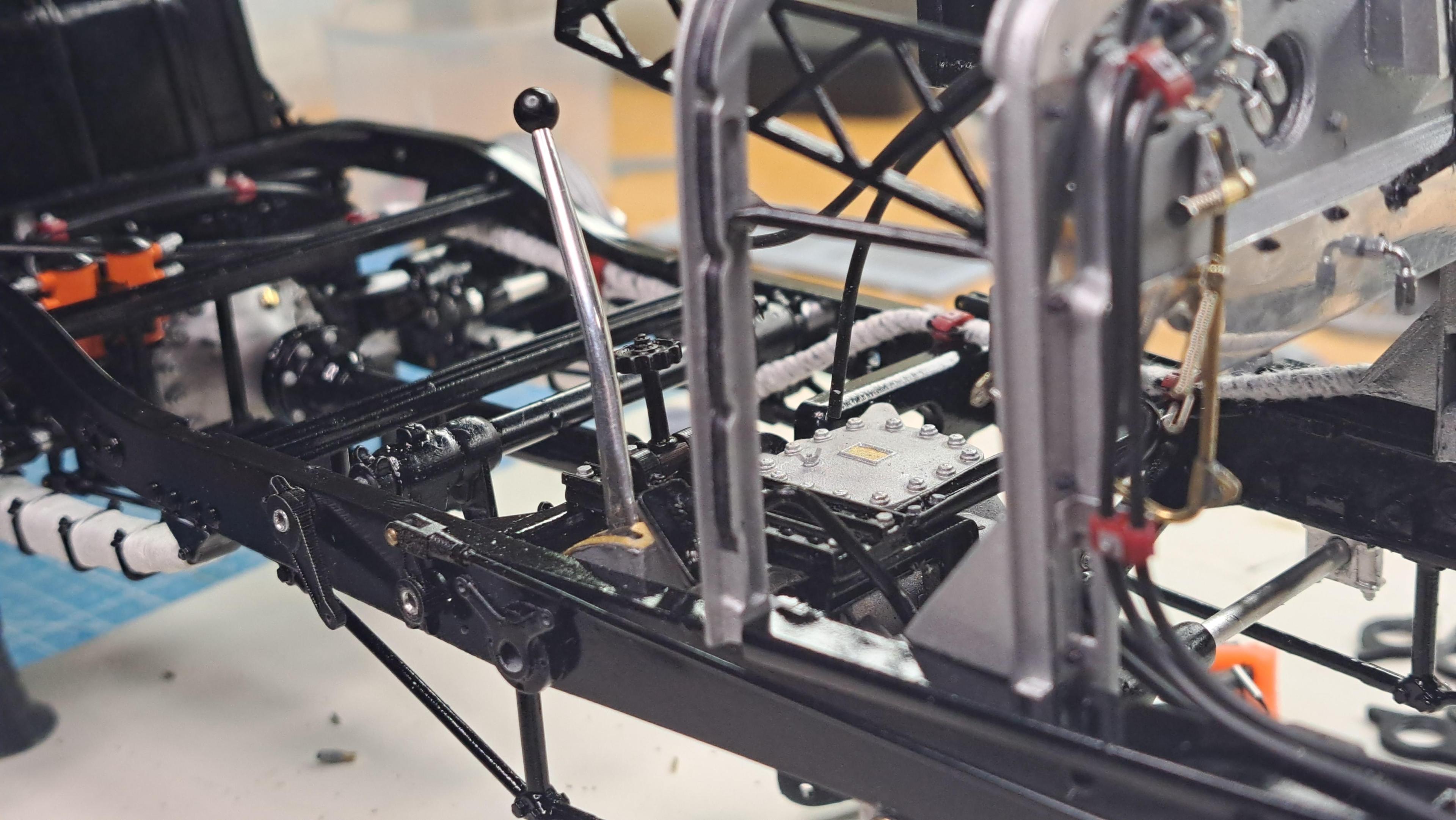

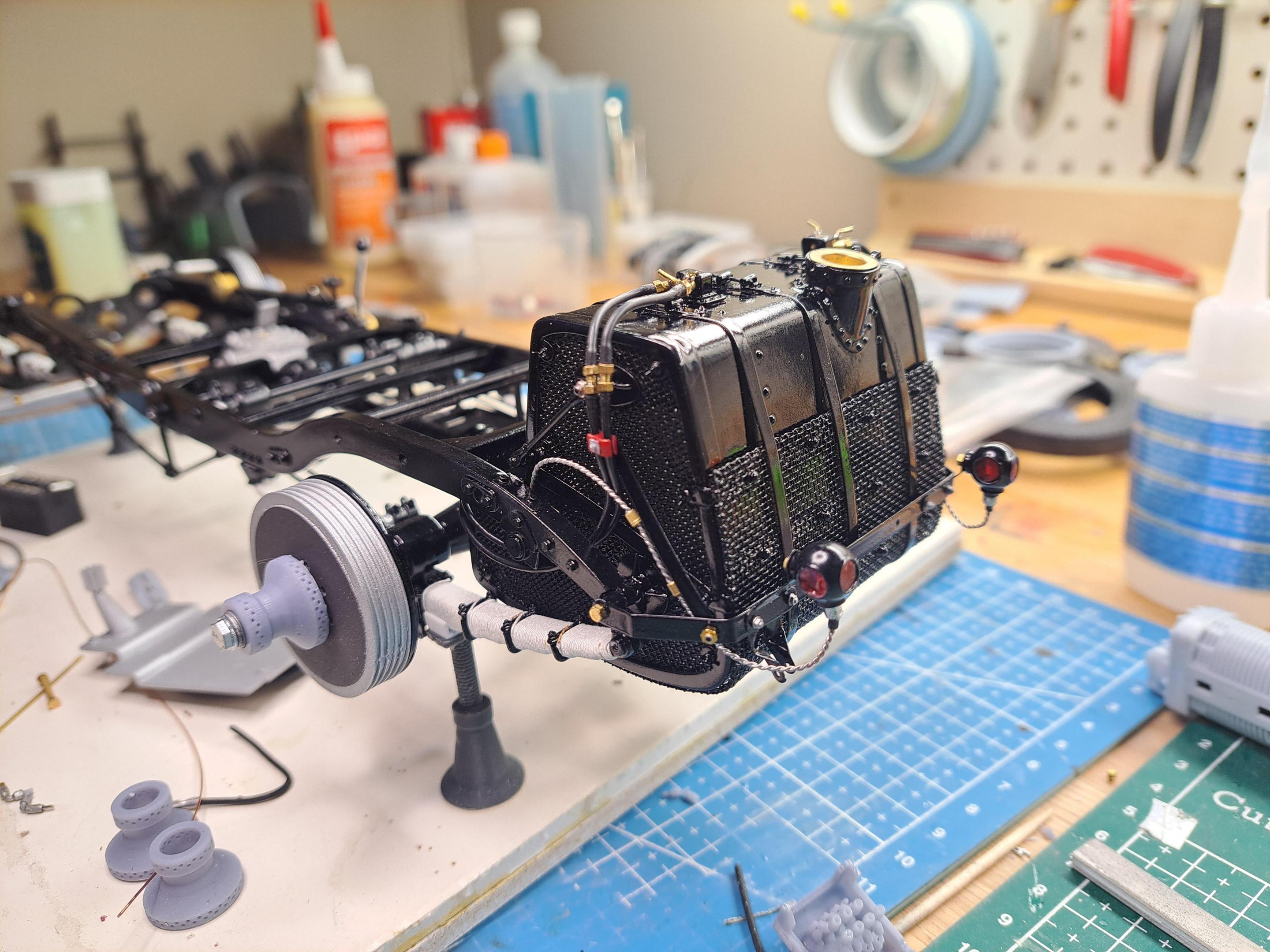

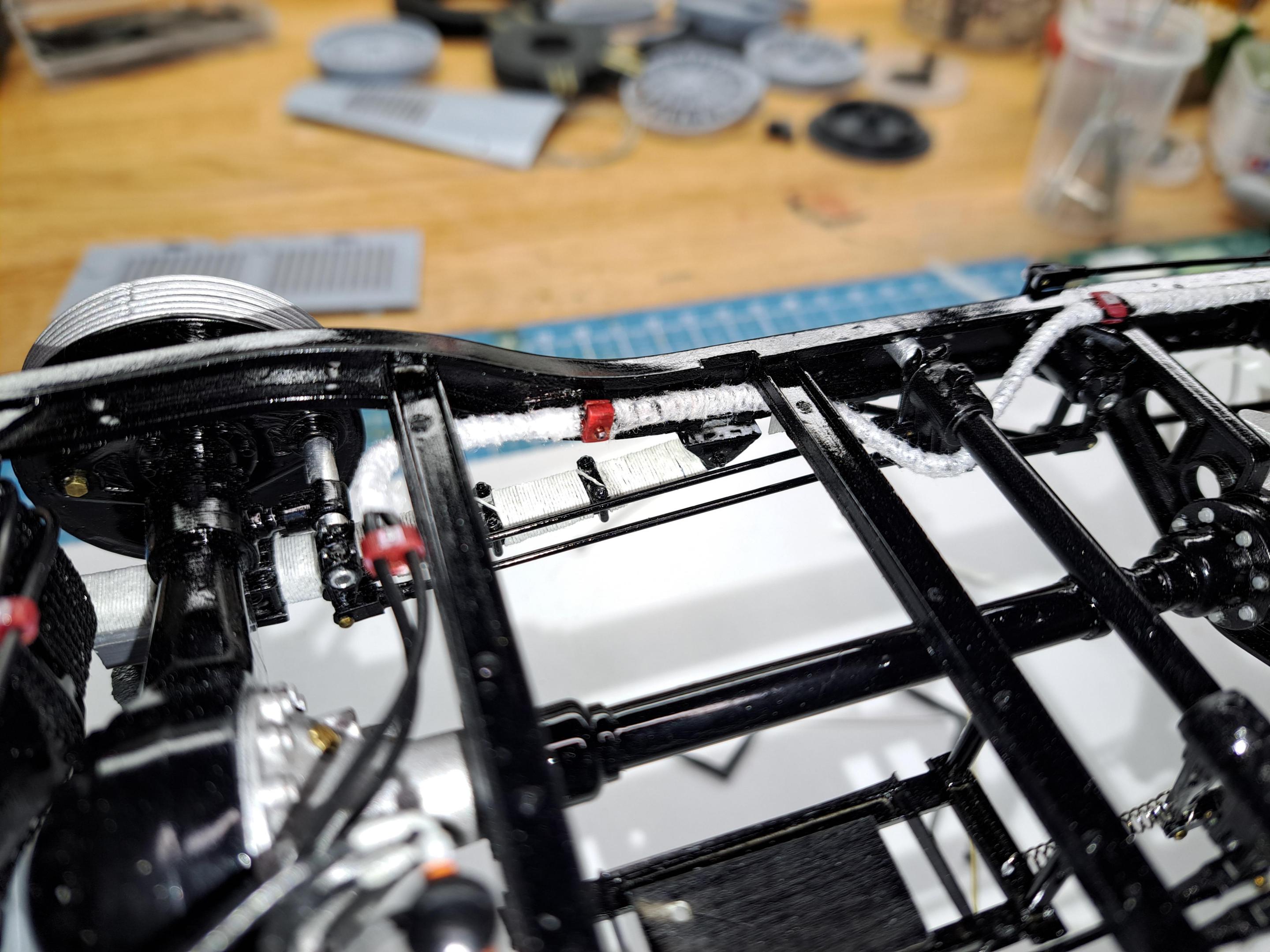

Ok, so I'm just about ready to install the engine on the frame but before I do that, I need to rout the fuel lines from the tank all the way to the front. So I decided to finish the fuel tank install and go from the tank to the fuel pump and to the from. On the real car, the fuel lines are coverded with a cloth tape that I imagine is fire proof.  I tried many different type of tape but nothing worked until I remembered a medical tape used on a WW1 plane I did last year. It's called Hypafix, it's seems to ge made of some type of fabric l, is very thin and flexible. It did the trick. This is the tape.
This is what I was aiming for.
And here what I made.

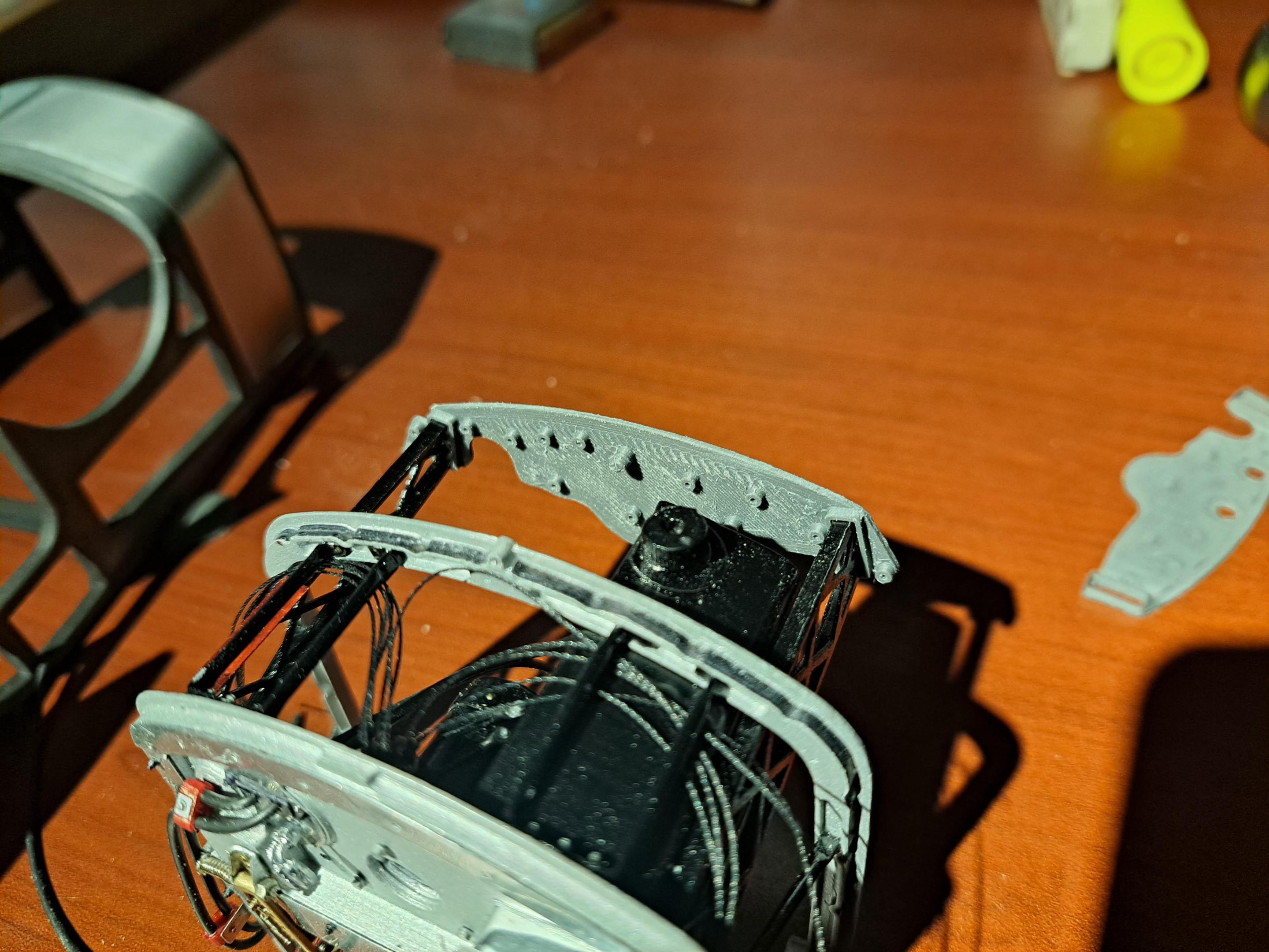

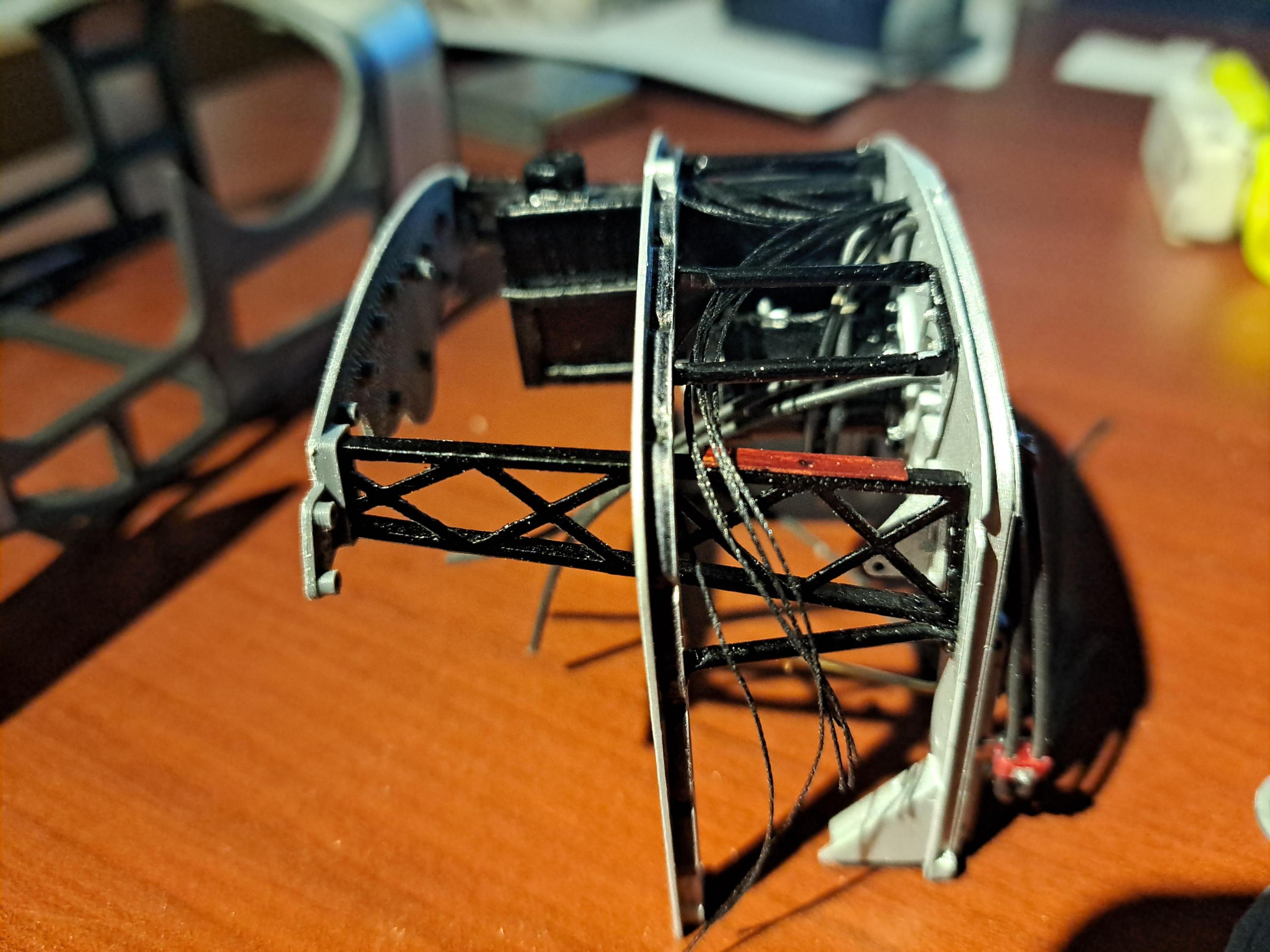

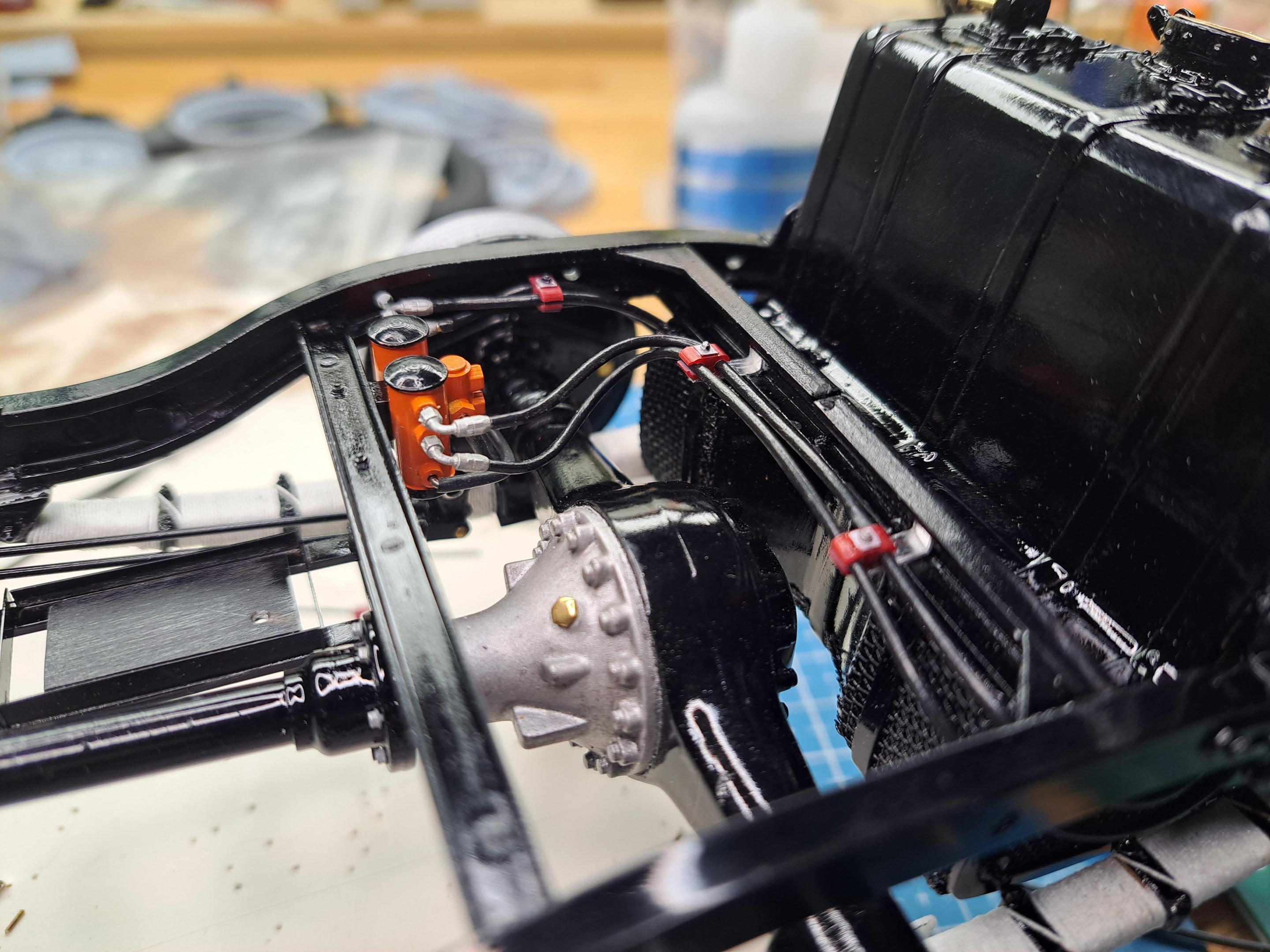

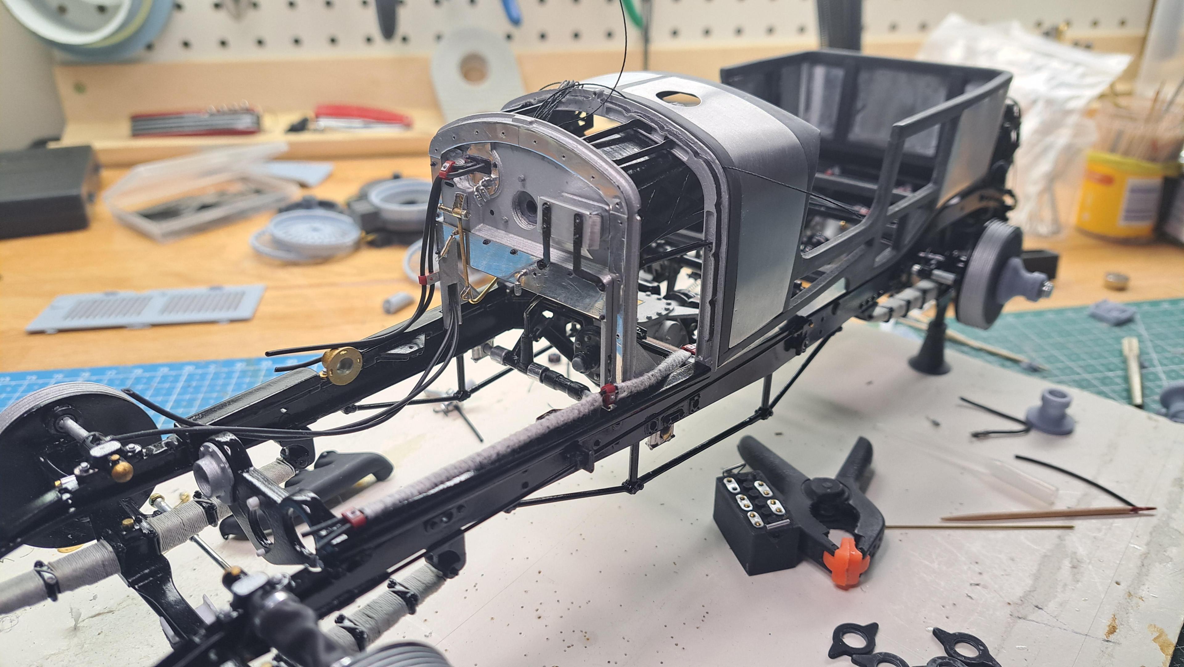

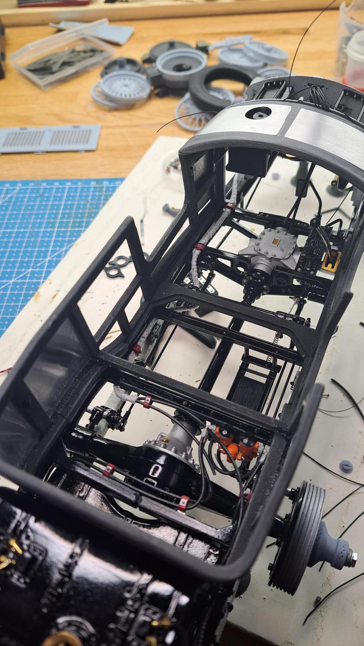

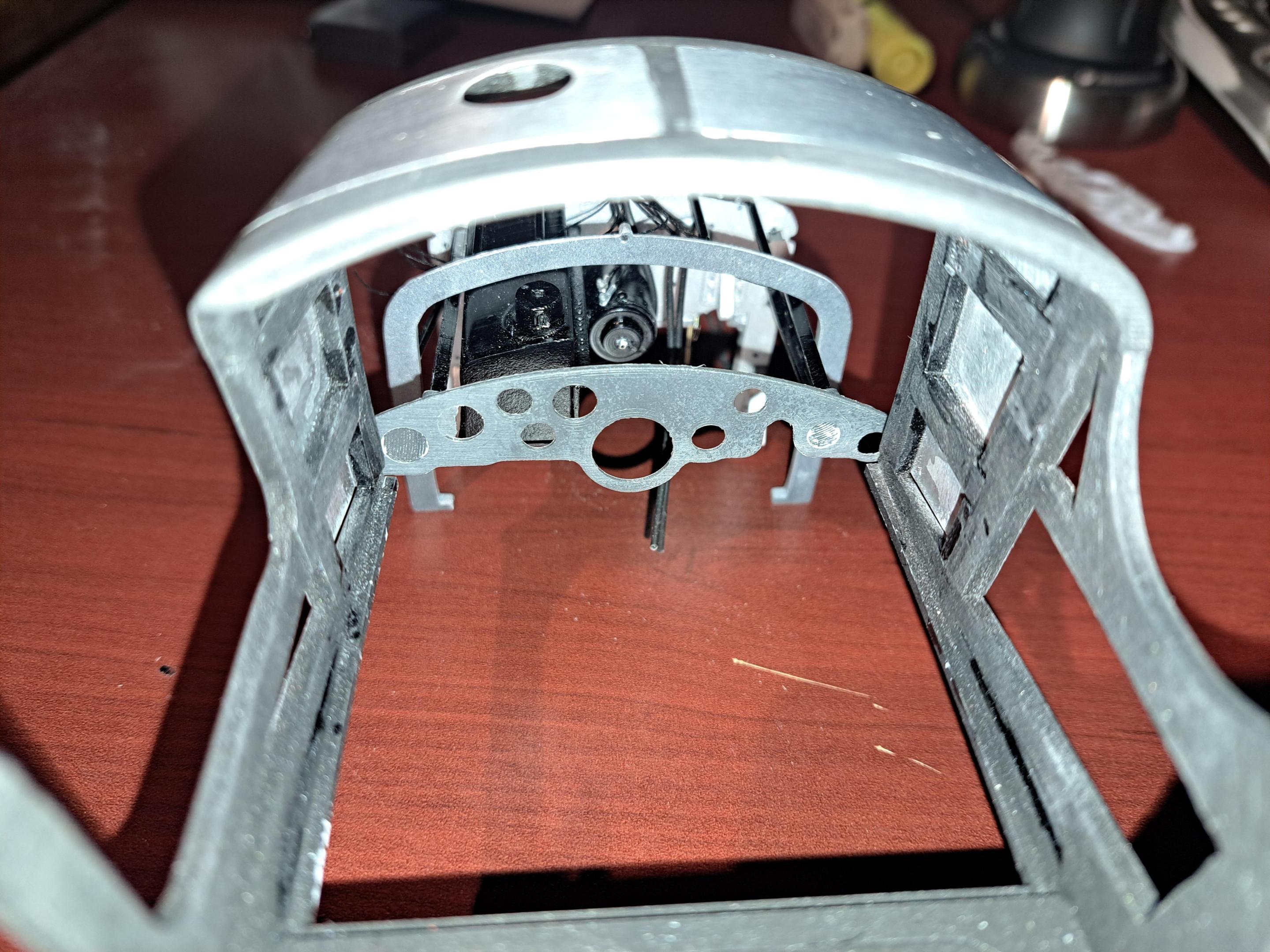

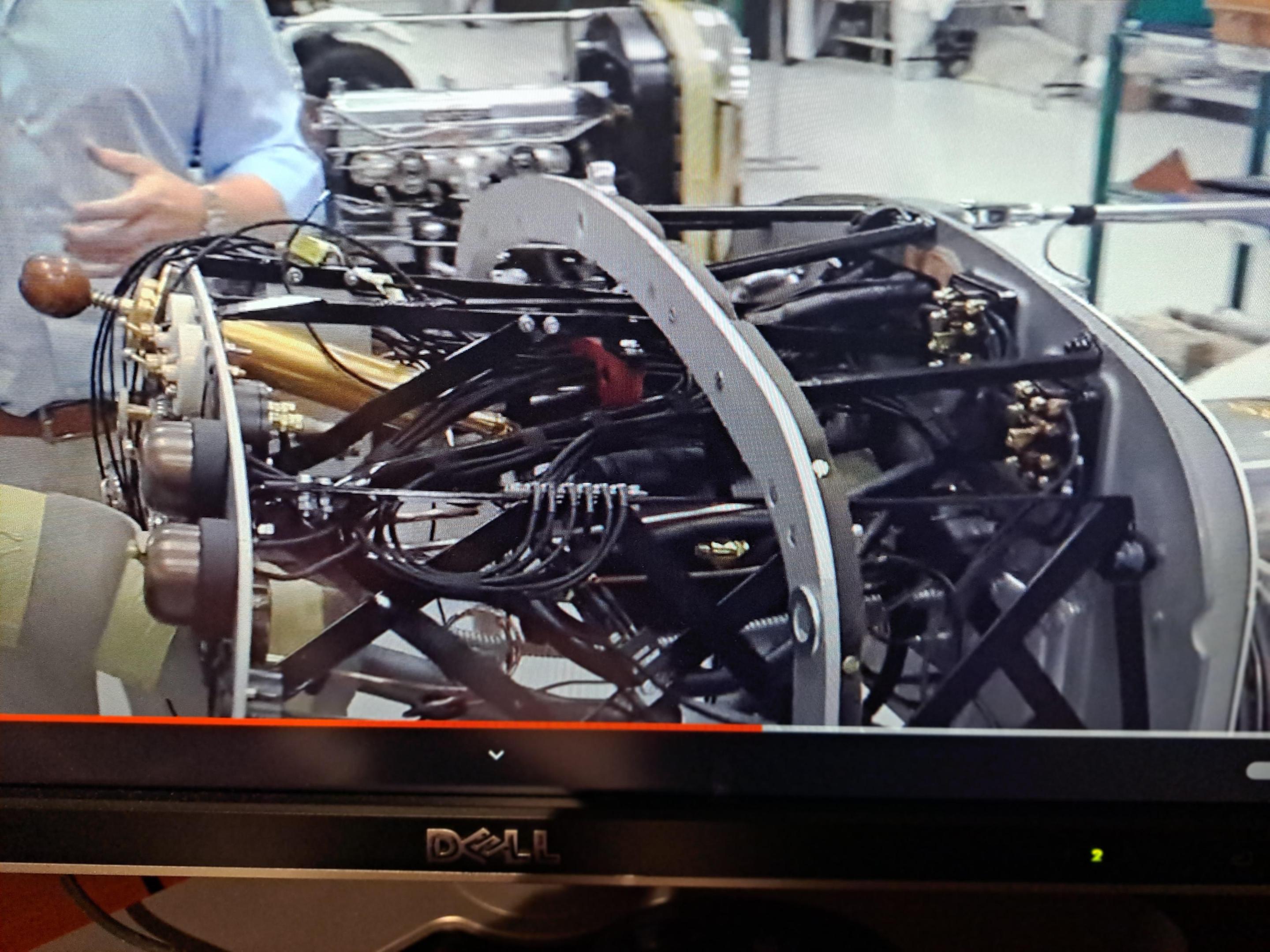

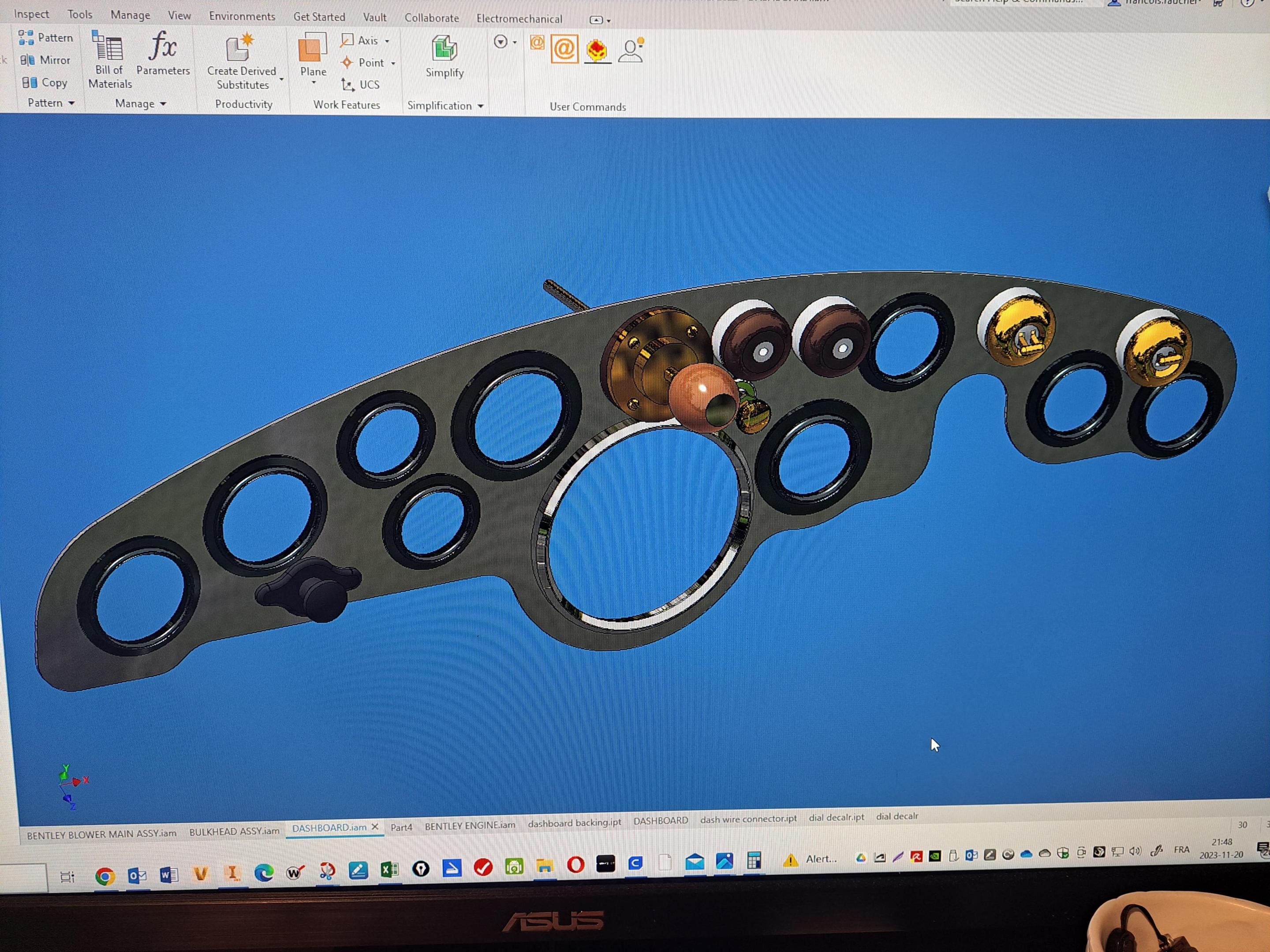

Like I said in my last post,  I'm just about ready to install the engine but I've hid a catch-22. I can't install the engine before finalizing the hose/tubing/wire routing, but I can't finalize the routing before installing the bulkhead assy, but I can't install the bulkhead before installing the ingene... see my dilemma? So I figured out an assembly sequence that permits me to get everything in place.  It's tenions and complicated but doable. But first,  I have to finish wiring the dashboard. Here I hit another snag. To do this wiring, I need to install the dashboard on the bulkhead assy but if I do this, I won't be able to eventually install the body because the dashboard is to wide. On the real car that's the way it's done but for some reason,  I can't.  It's probably due to the fact that I based my bodywork on the kit's body that might not be 100% accurate. So the solution I came up with is to print a dashboard back plate that is narrower so the body will fit and that has holes in the back to receive the different wires. The finished dashboard will be installed only once the body is in place.  I might even glue the board to the body,  that way I could remove the body to better show the details. Here are some pictures.
Dashboard on bulkhead assy (real car). You can see the ton of wires and hoses.
My bulkhead assy with a fraction of wires and hoses.
The almost completed 3d model of the dashboard,  the board will be made from aluminium.  I'll try to replicate the swirl patterns on the front face. The bezels, switchs and knobs will be 3d printed.

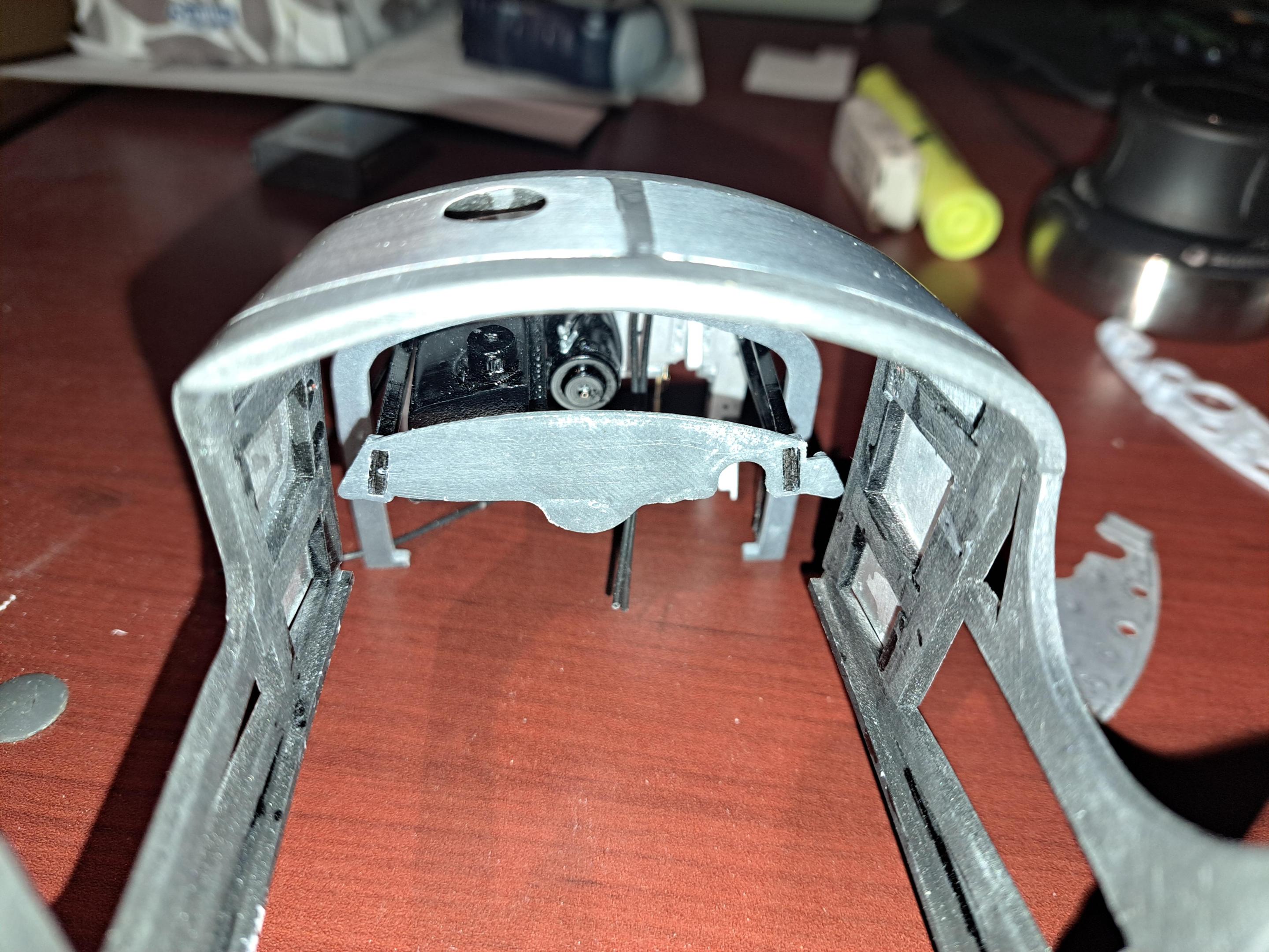

The body doesn't fit if the dashboard is already in place.
Back plate solution,  the body will fit over ity
Back plate in place, you can see the small holes to receive wires.

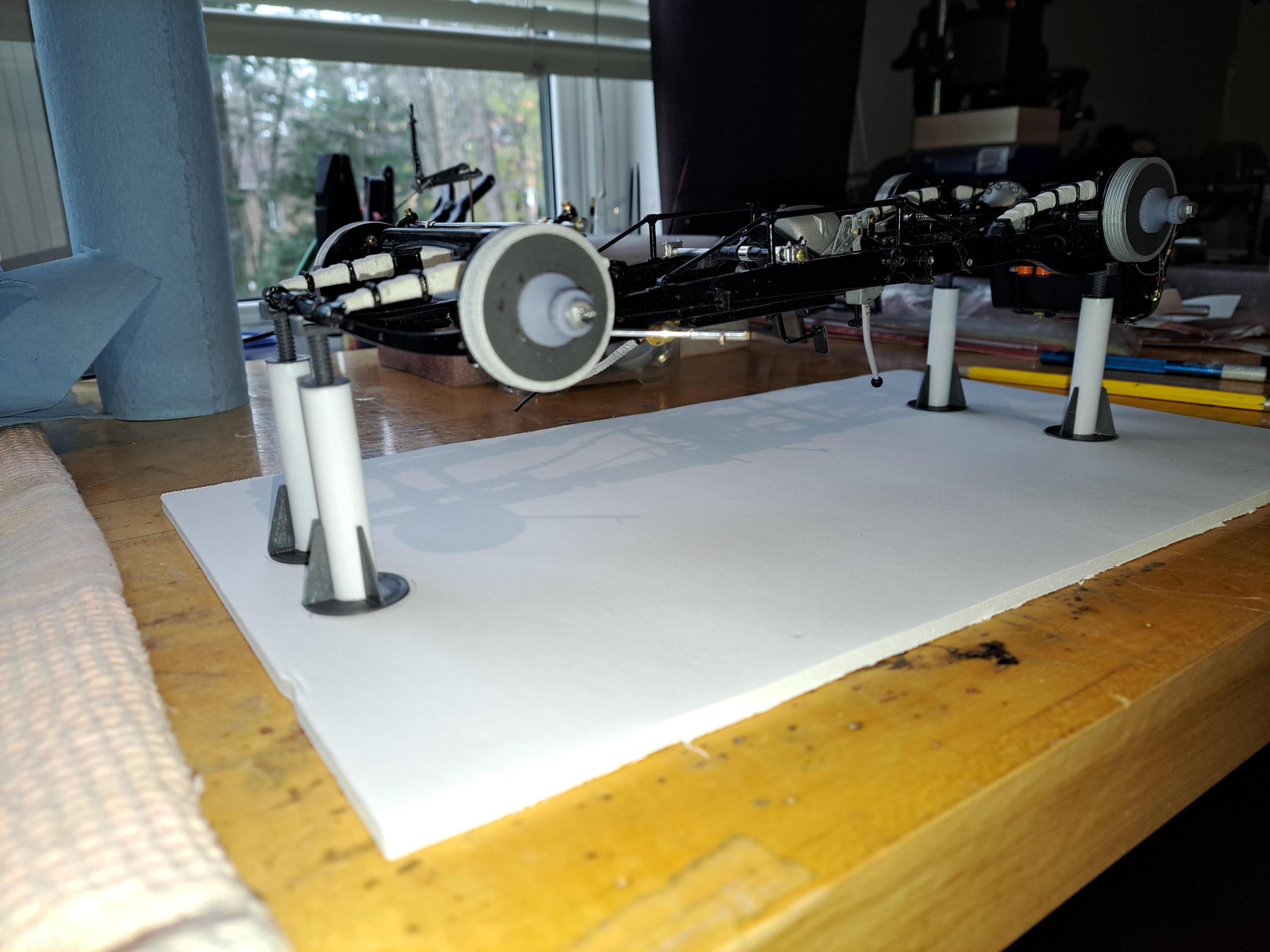

I made new higher candles to be able to flip the car once the engine and bulkhead are in place.

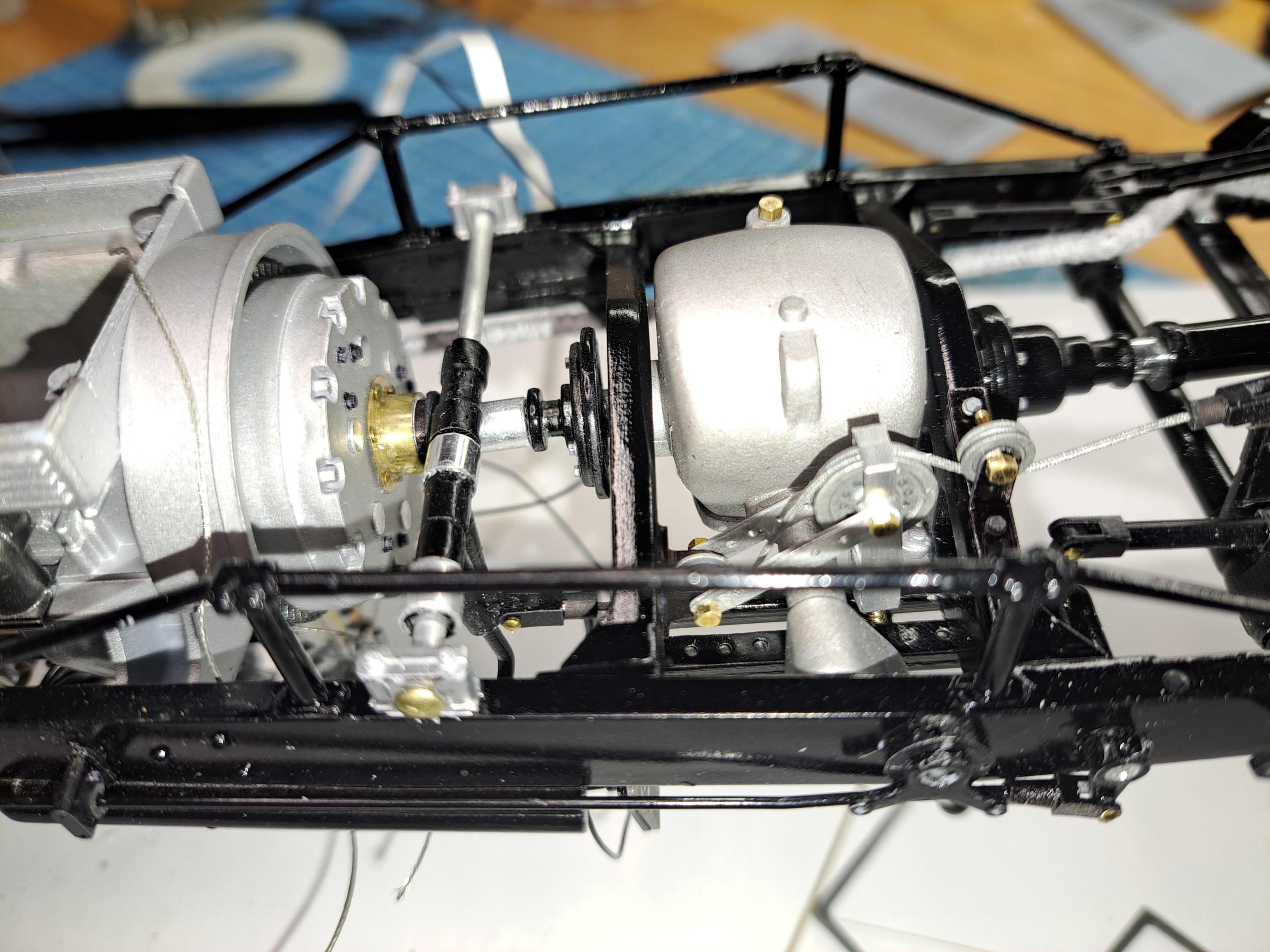

here are some more pictures of the fuel line snd fuel pump install.
