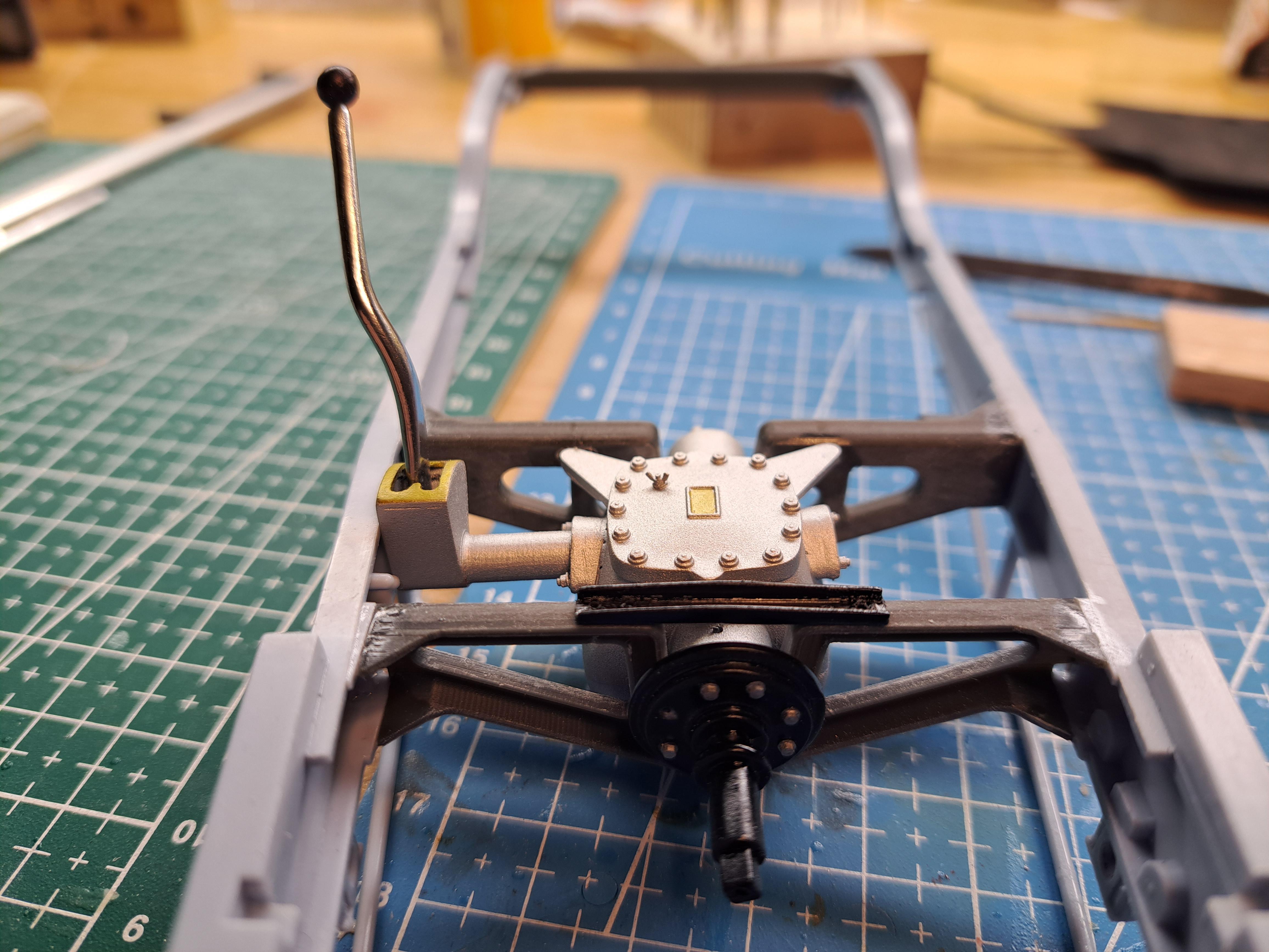

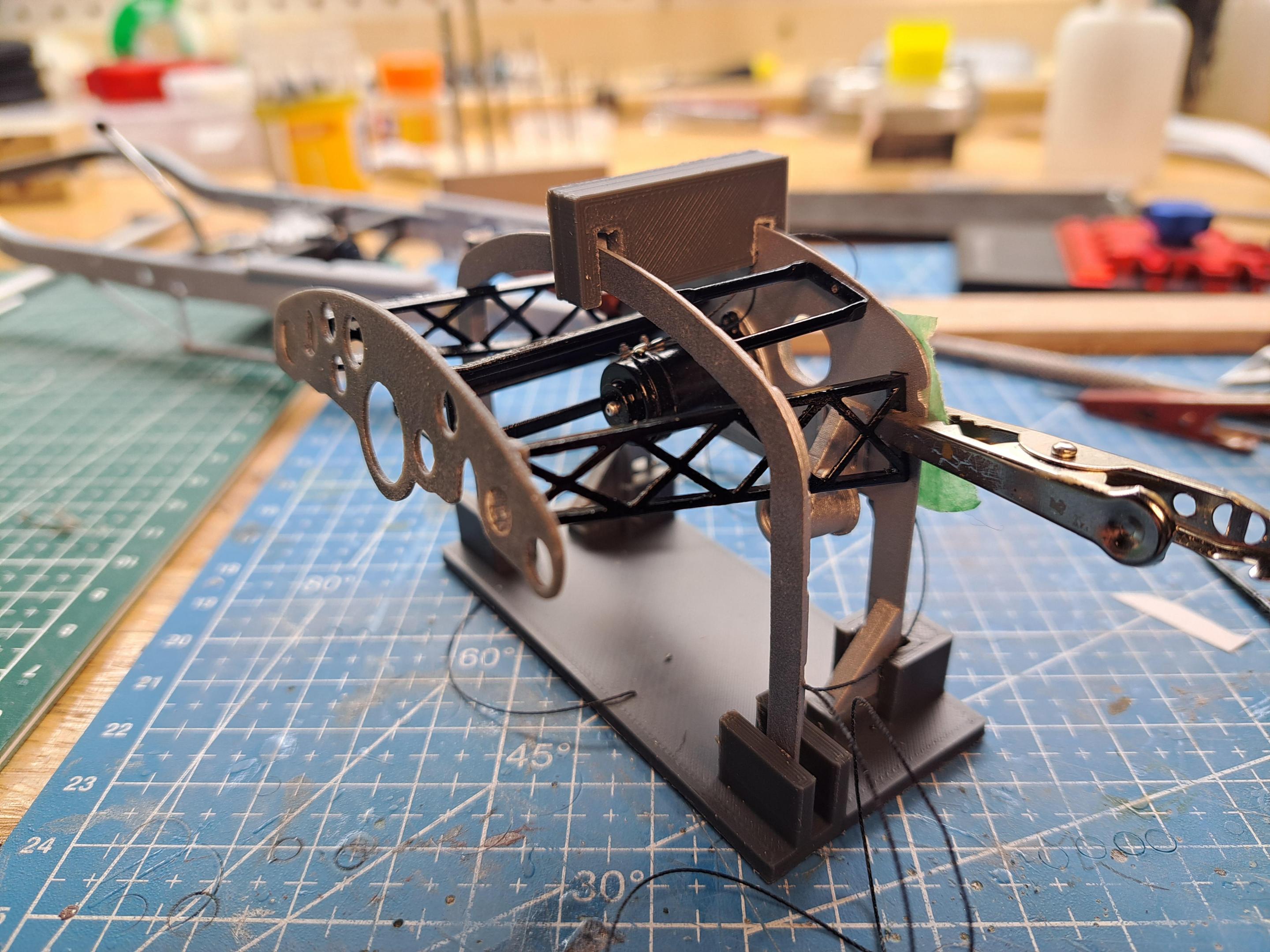

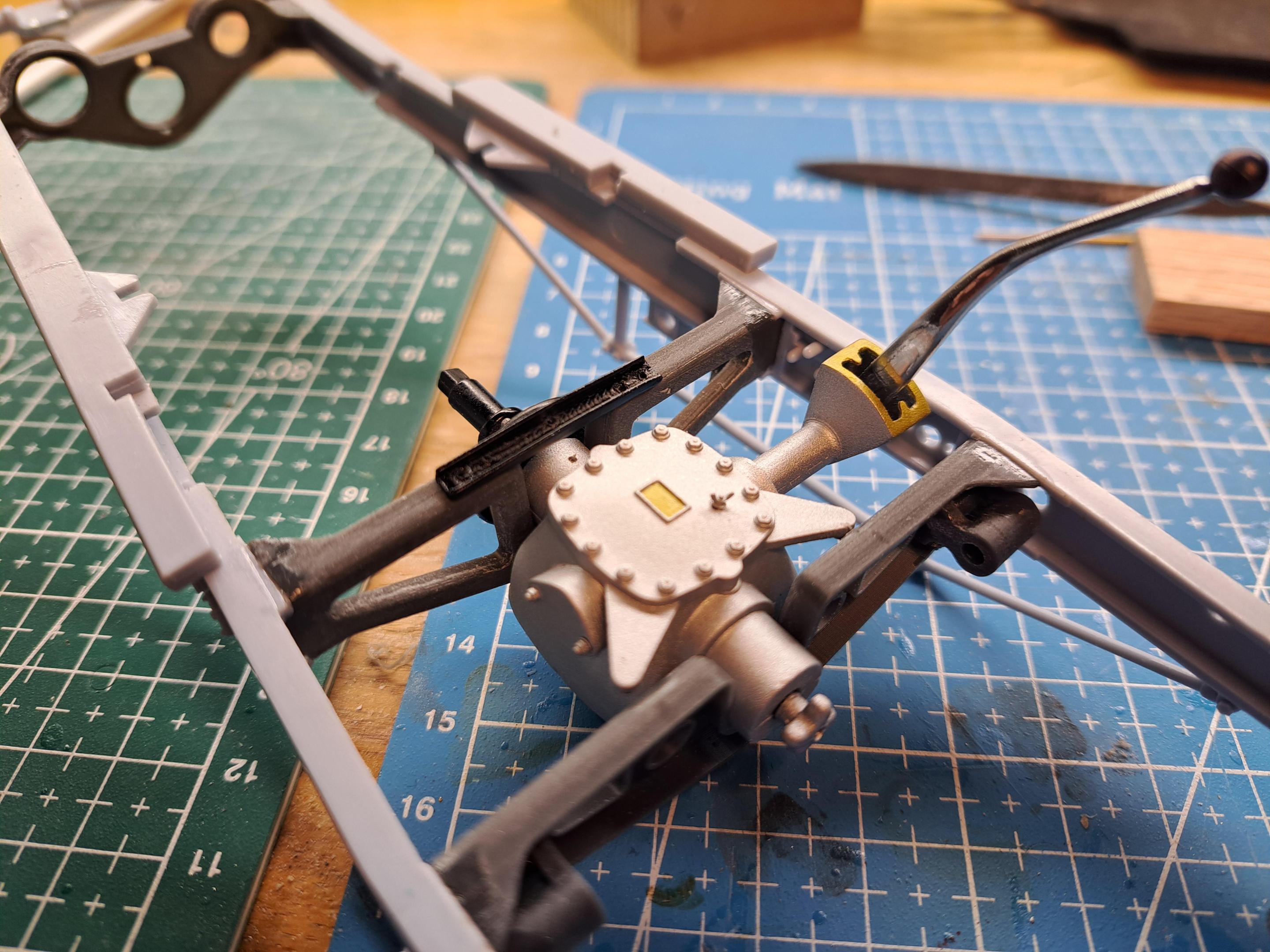

François Posted August 1, 2023 Author Posted August 1, 2023 Completed the gearbox today. I'm not 100% satisfied with the shifter gate. Right now, it's painted to look like brass but I might try and make a real brass one. Espacialy since the gate and shifter are the only 2 things from the gearbox assy that are visible once the model is complet. 20230731_215821.mp4 l also printed a holding fixture to hold both bulkheads in relation while I glue some brackets in place. Here's the design (hi-lighted in blue) And the fixture in use I'm still scratching my head as to how l'll glue the latex covering on the body, it's getting clearer but I'm not quite there yet. I do know that I'll probably glue a thin felt between the body and the latex to give a little more volume and roundness to the latex.

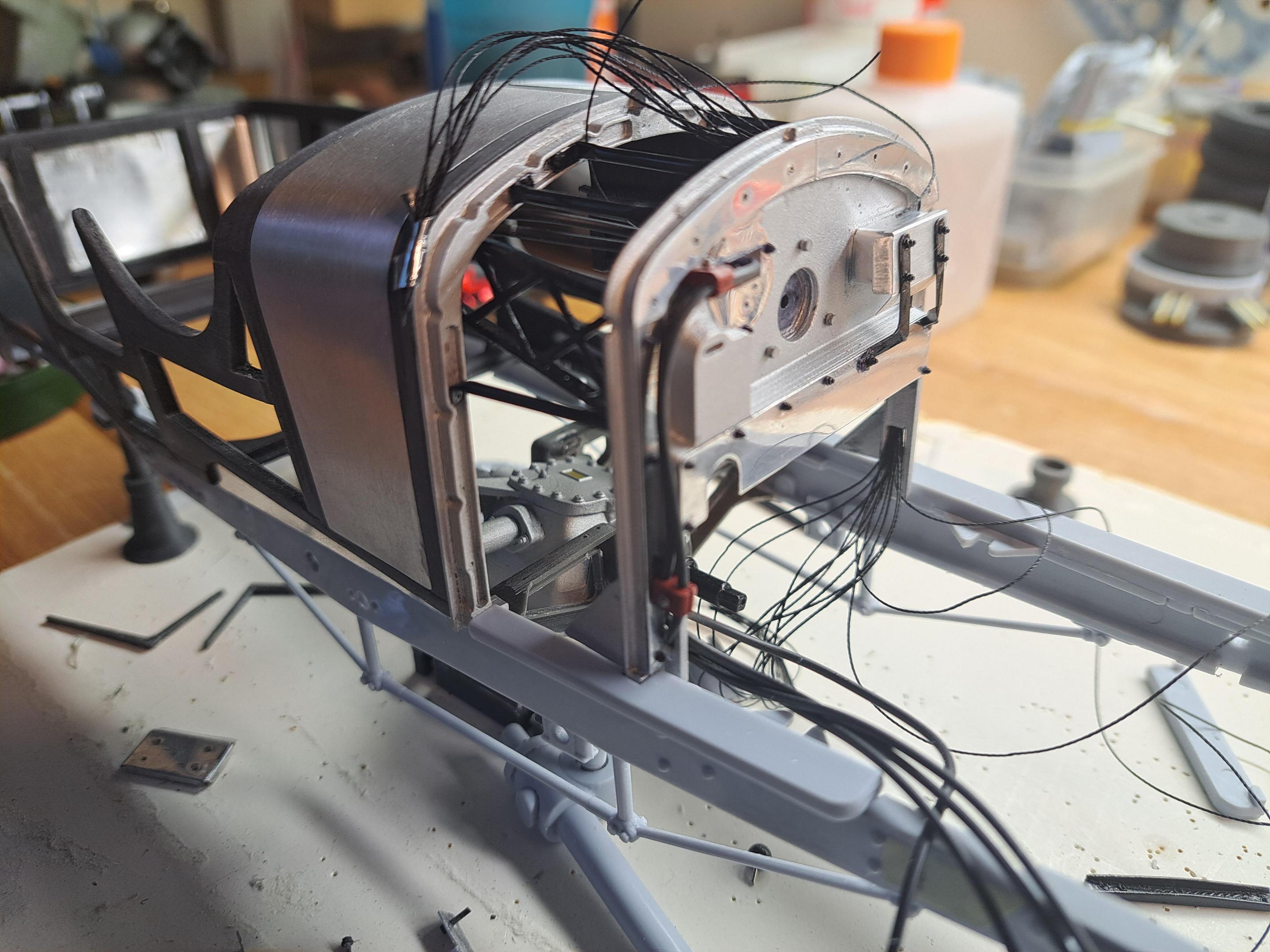

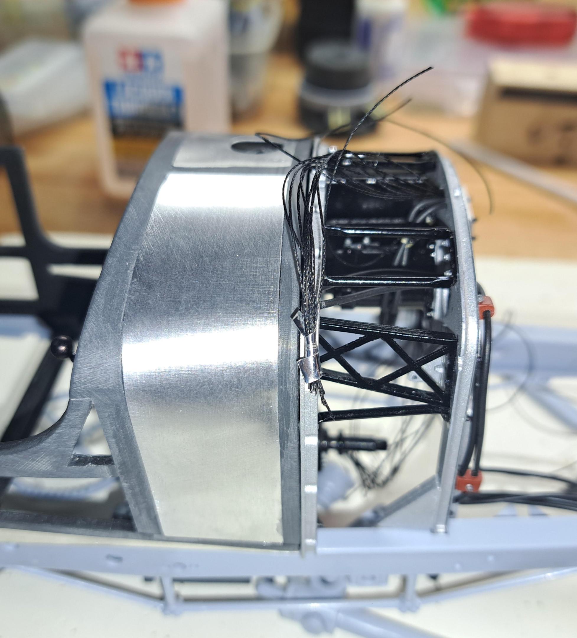

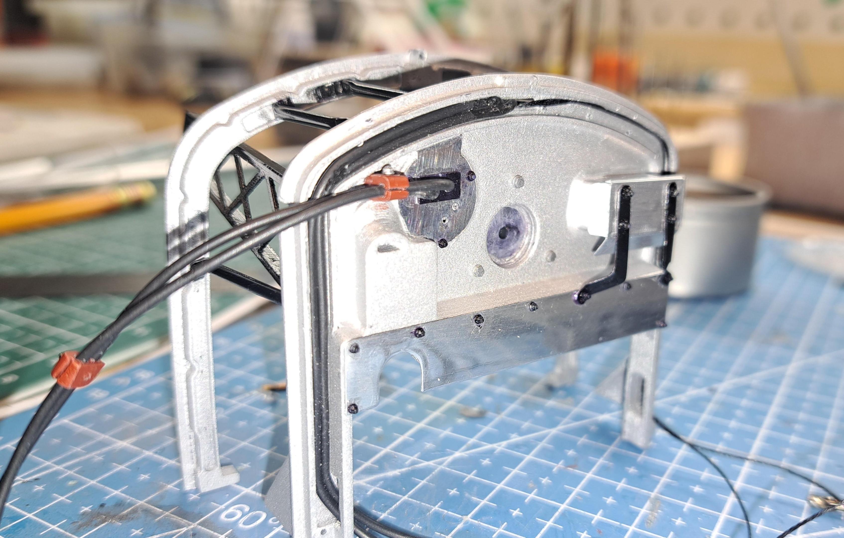

François Posted August 6, 2023 Author Posted August 6, 2023 Pretty much completed the bulkhead assembly. I still have the gas pedal to do plus a few more wires to install but that will come later. And the real thing

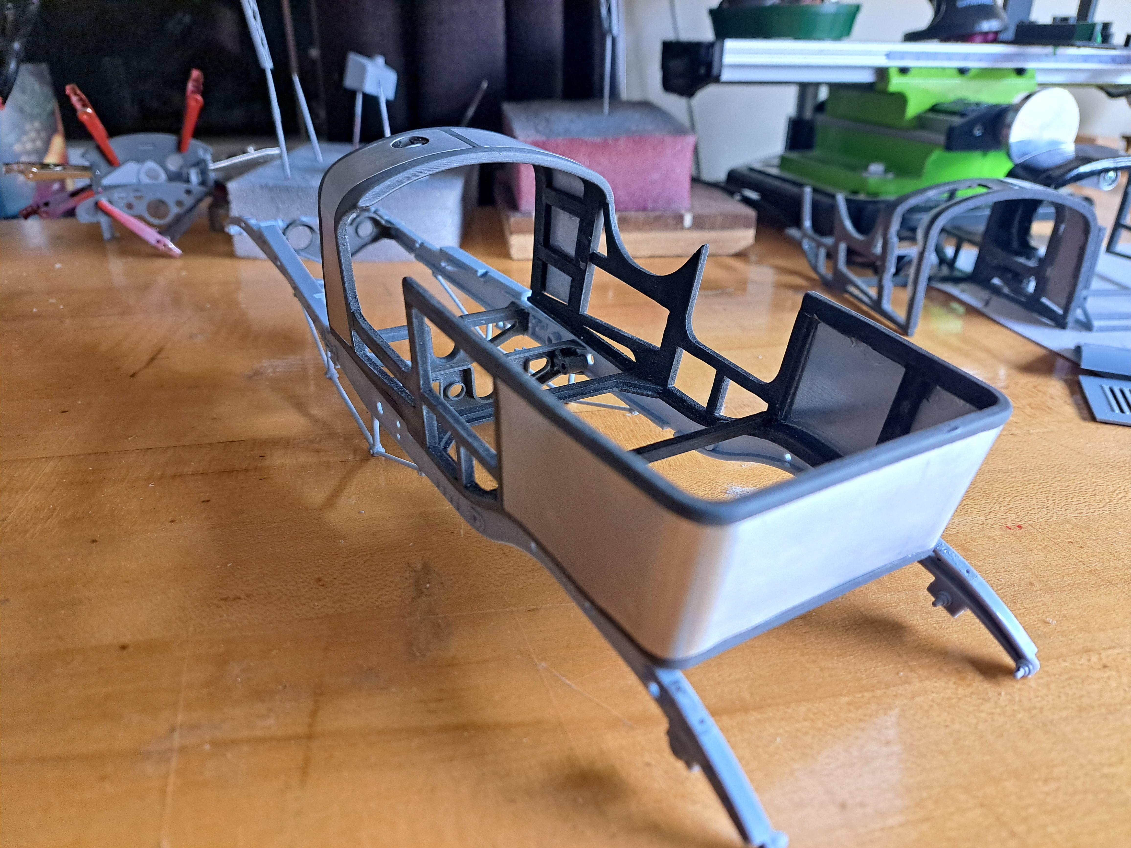

François Posted August 8, 2023 Author Posted August 8, 2023 A word about my body covering dilemma . I had found some very thin latex (party balloons) but someone from another forum mentionned that latex will degrade in a fearly short time so that's a no go. I'm looking at the option of using neoprene instead. I found a wetsuit fabricator who uses 0.3mm (.012") thick neoprene (apparently the thinnest available) which is exactly what I need. He's looking to see if he might have some cutoffs for me. If it works out my model will end up saying 'l'm Batman' . More to come on this.

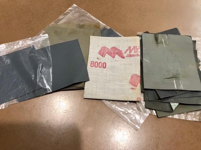

absmiami Posted August 9, 2023 Posted August 9, 2023 What if you tried cloth-backed sanding sheets ? They are thin and a little flexible - just choose a sheet with some texture - glue it and paint it - ive used this method to cover 24th sc racing seats - might work -
François Posted August 9, 2023 Author Posted August 9, 2023 I'm affraid it would not be flexible enough. It needs to be as flexible as ultra thin latex but non degradable. The frame has multiple curves and very small radii. I'm stiil waiting to hear from the wetsuit guy that has 0.3mm thick neoprene.

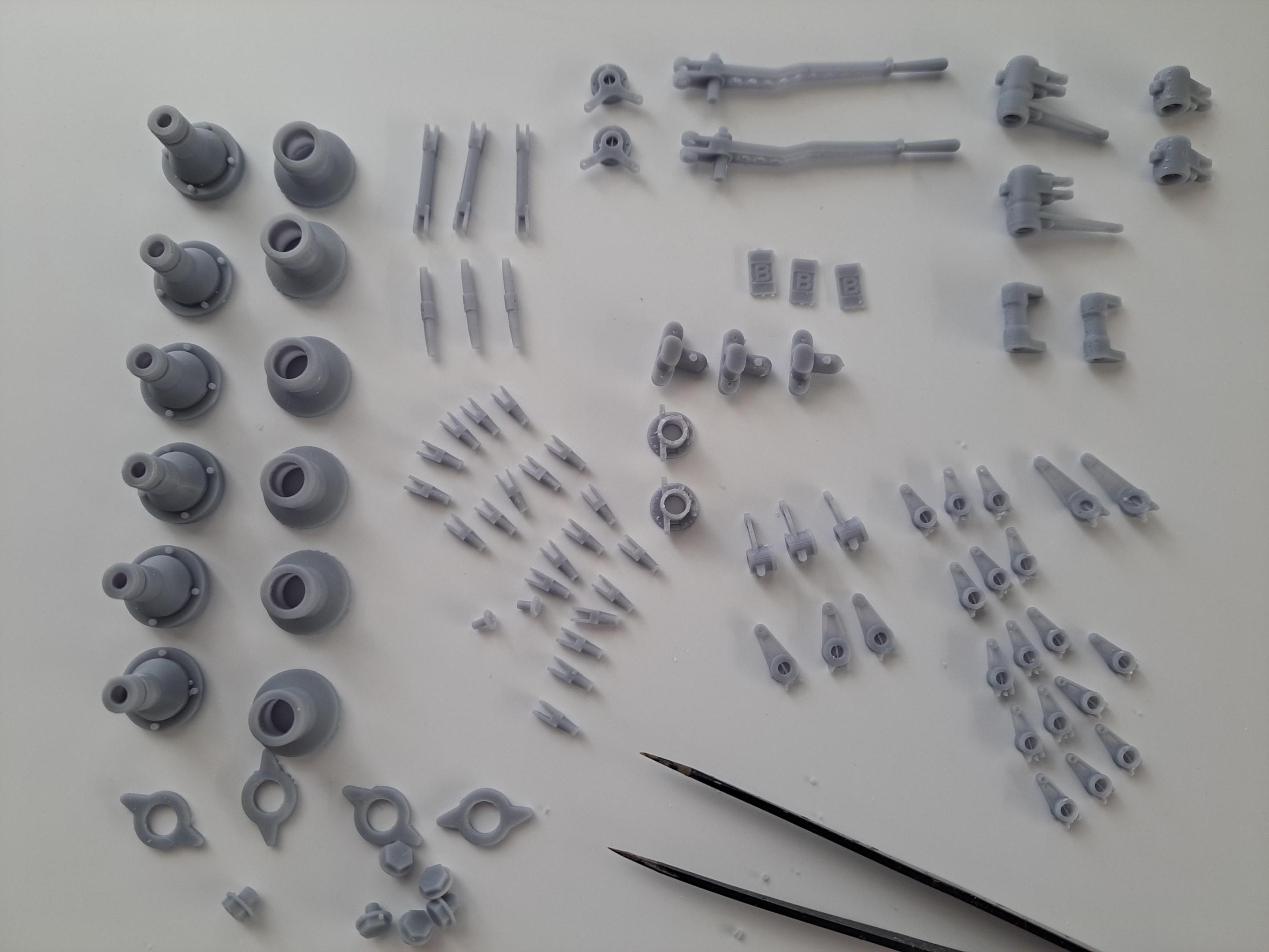

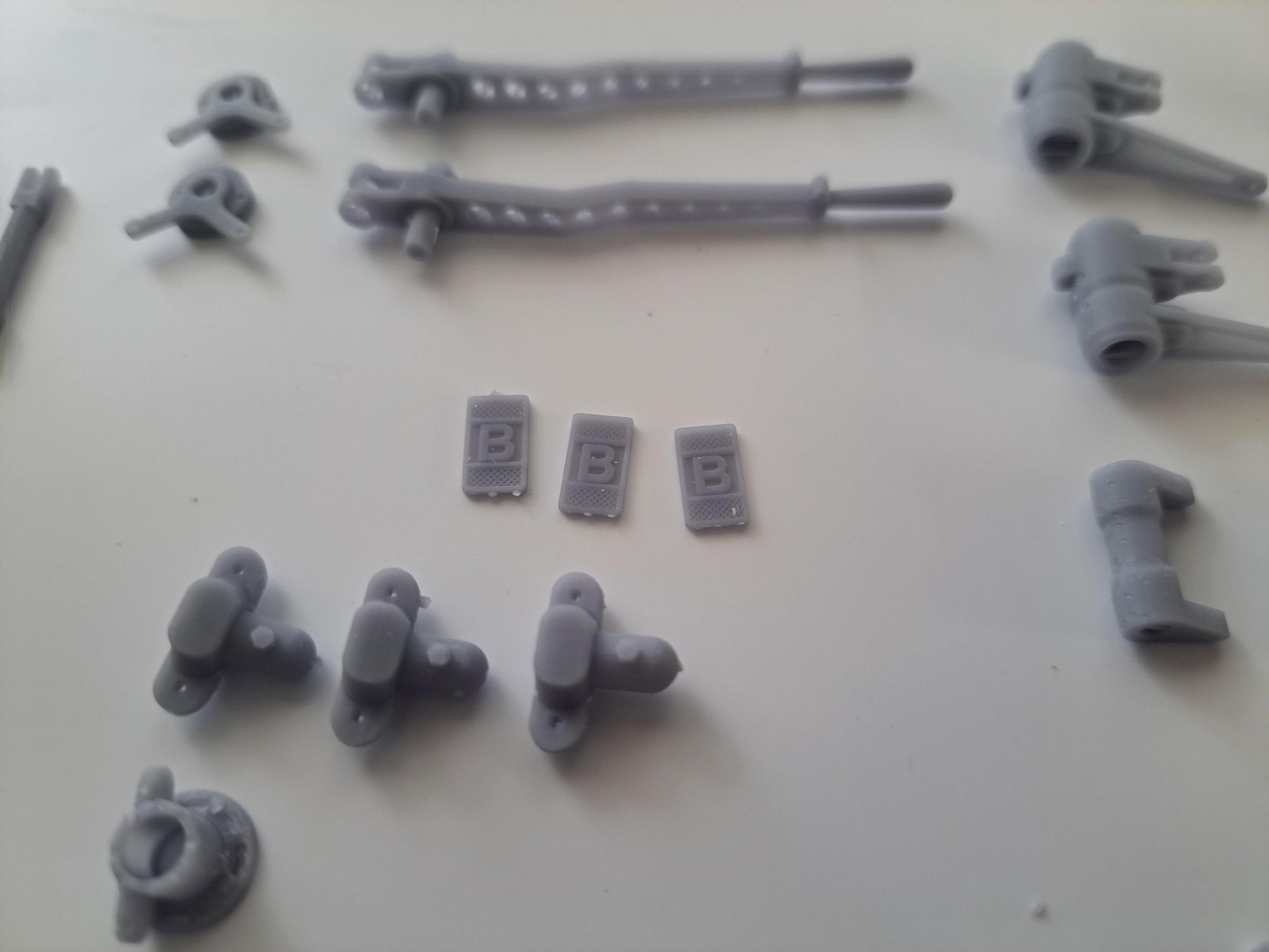

François Posted September 1, 2023 Author Posted September 1, 2023 Hello all, it's been a while since my last post. I've been busy with another project but should be getting back on the Bentley soon. I received a bunch of resin printed parts today. So I'll be able to start on the wire wheels and the brake linkage. Still waiting for the. 3mm neoprene for the body.
