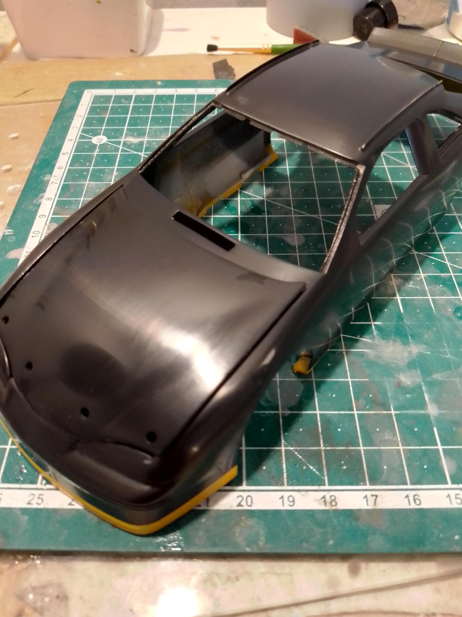

atomicholiday Posted May 25, 2023 Posted May 25, 2023 (edited) This year, my main goal is to get my painting technique as close to perfect as I can get it. I've watched every video and read every thread I could find. To that end, I've switched paint and now am using mainly three paints. Duplicate color perfect match, Tamiya TS line, and Testors extreme lacquer. I'm definitely improving, but I'm still getting a little more orange peel than I'm happy with. I can rub it out with effort but I'd rather improve my painting to make the polishing stage easier. I understand what causes orange peel, and I have some theories, but I want your input on a couple of questions. My coats are looking really good and smooth immediately after spraying. The orange peel is happening as the paint cures. 1. The first coat (tack coat) - with lacquer, understanding that the first coat should be light, should it still be just heavy enough to look wet and smooth immediately after spraying , or should it be more of a dust coat and look very dull? 2. Also related to the tack coat- should the first coat sit longer than that other coats? How long? 3. Any other suggestions I might b e missing? And yes, I know. "Get an airbrush." ?I'm working on getting my setup going. But I want to perfect this step too. Edited May 25, 2023 by atomicholiday
MrMiles Posted May 25, 2023 Posted May 25, 2023 (edited) you shouldnt get orange peal with tamiya paint. how far away are you holding the can? the others, i have had it happen, but never tamiya Edited May 25, 2023 by MrMiles 1
atomicholiday Posted May 25, 2023 Author Posted May 25, 2023 (edited) 1 hour ago, MrMiles said: you shouldnt get orange peal with tamiya paint. how far away are you holding the can? the others, i have had it happen, but never tamiya I’ve only shot Tamiya once and I did get the best results with it. Very acceptable. But I don’t want to limit myself to one brand. And to be clear, it’s not terrible. I can rub it out with 2400 pads. But I want to get better. The less wet sanding and polishing I need to do, the better. Also I recognize that ‘some’ orange peel will probably always be there. Let me give some more details. I’m spraying about 6-7 inches away and my passes are pretty quick. After a lot of trial and error, this seems to be getting me closer than anything else I’ve tried. Holding the can 8-10 usually gives me worse orange peel. Seems like the paint was drying before it hit the body. I’m going for thin coats that are just thick enough to be wet. It looks perfect after each coat, but I get a little orange peel when it cures. Also, I’m doing about three color coats and three clear coats. Usually ten minutes apart and 24 hours between color and clear. I paint outside, so I wait for days when it’s at least upper 60’s, with humidity below 40 percent. I might be completely wrong, but my theory is that it has something to do with time between coats. Either after the tack coat or maybe between all coats. Edited May 25, 2023 by atomicholiday 1
