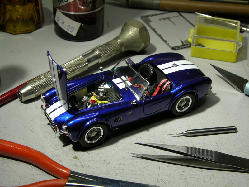

peteski Posted June 7, 2023 Posted June 7, 2023 (edited) Jeremy, How about considering changing your painting technique? When I airbrush my models, I lay the paint rather heavy (except for the initial coat). That results in nice, even, glossy coverage with no orange peel. I open the nozzle rather wide, and use fairly low air pressure (around 20-25 psi). This is my Monogram Ultimates 1:43 scale 289 Cobra. I used Tamiya Fine White Primer, nail polish for the body color, and Testors Wet Look Clear for clear coat. This model has not been touched by any polishing cloths, rubbing compounds or waxes. Just bare clear. This is Gunze Sangyo 1:32 scale '57 Caddy. No primer. The paint is Testors enamel (I built it around 30 years ago, so I don't remember the specific color name). No clear. Again, it is bare paint. I notice that most modelers are afraid to lay the paint on thick, so that creates sub-par finish. I just go nutz! Is my finish perfect? No! But it is quite good (and all those cars placed in model contests in the top 2). Edited June 7, 2023 by peteski
atomicholiday Posted June 8, 2023 Author Posted June 8, 2023 On 6/6/2023 at 9:07 PM, peteski said: Jeremy, How about considering changing your painting technique? When I airbrush my models, I lay the paint rather heavy (except for the initial coat). That results in nice, even, glossy coverage with no orange peel. I open the nozzle rather wide, and use fairly low air pressure (around 20-25 psi). This is my Monogram Ultimates 1:43 scale 289 Cobra. I used Tamiya Fine White Primer, nail polish for the body color, and Testors Wet Look Clear for clear coat. This model has not been touched by any polishing cloths, rubbing compounds or waxes. Just bare clear. This is Gunze Sangyo 1:32 scale '57 Caddy. No primer. The paint is Testors enamel (I built it around 30 years ago, so I don't remember the specific color name). No clear. Again, it is bare paint. I notice that most modelers are afraid to lay the paint on thick, so that creates sub-par finish. I just go nutz! Is my finish perfect? No! But it is quite good (and all those cars placed in model contests in the top 2). Those are both stunning. At a glance the Caddie looks real. I actually have an airbrush. Just need to figure out how to vent it from my basement. 1
