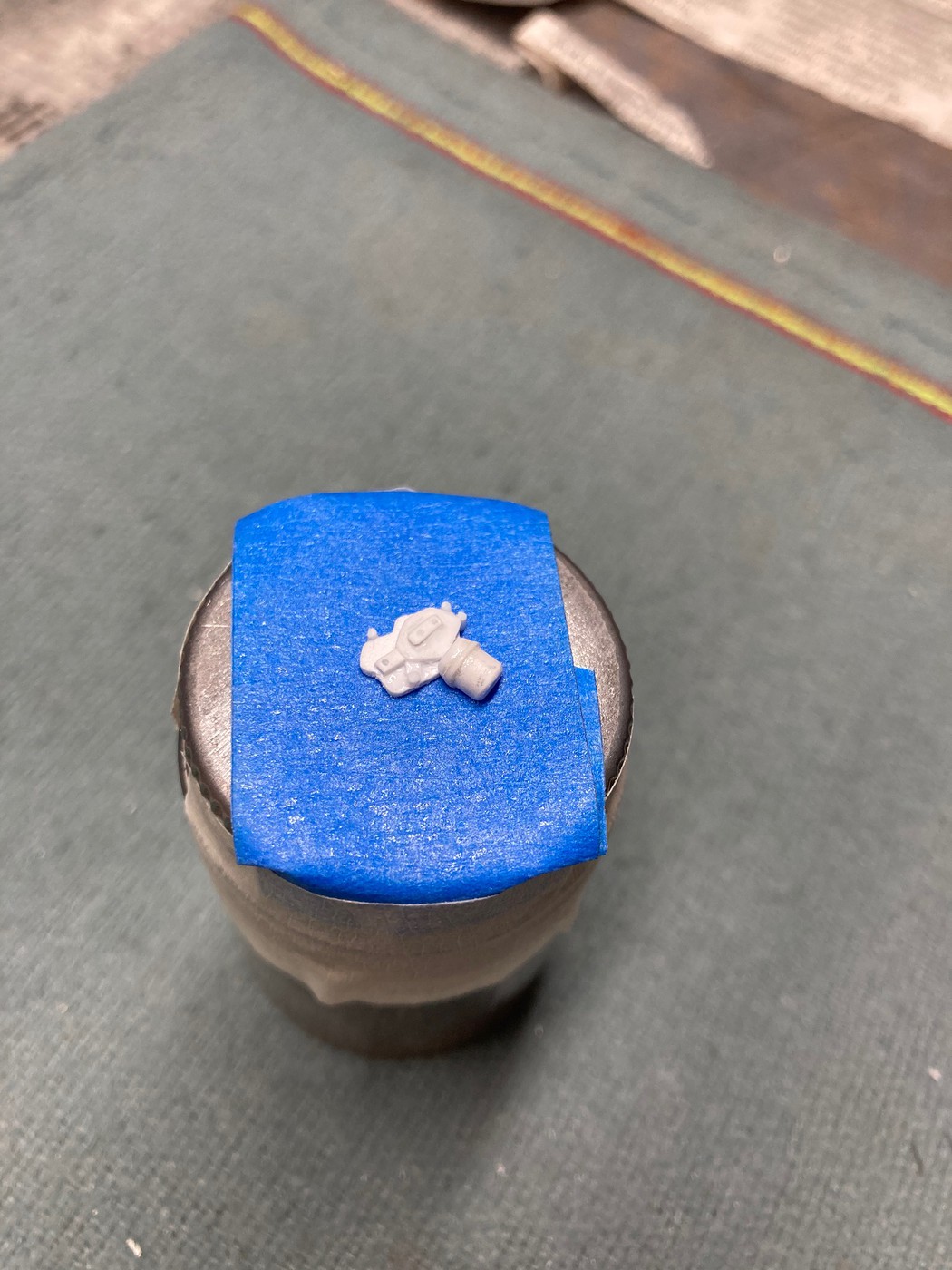

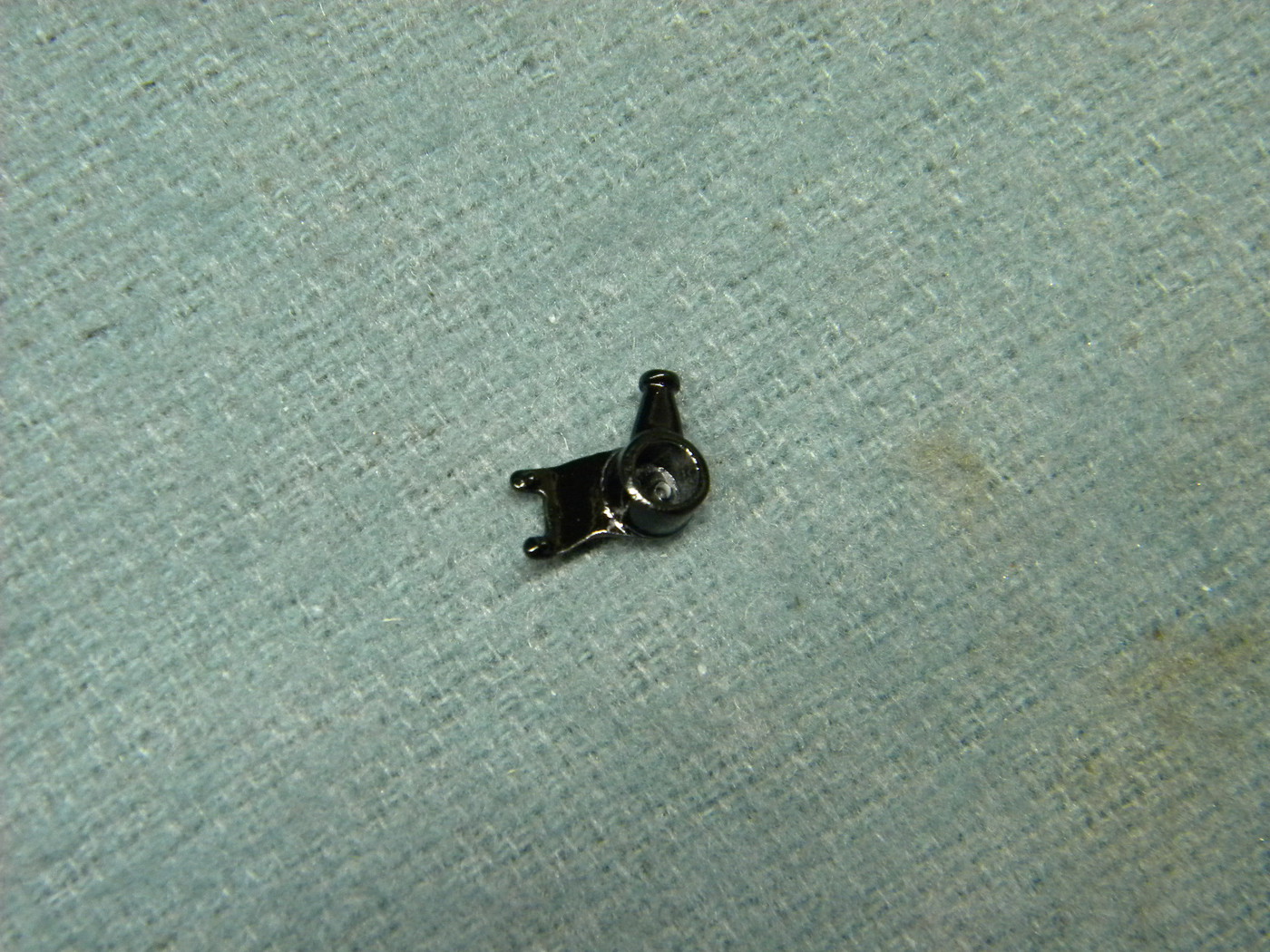

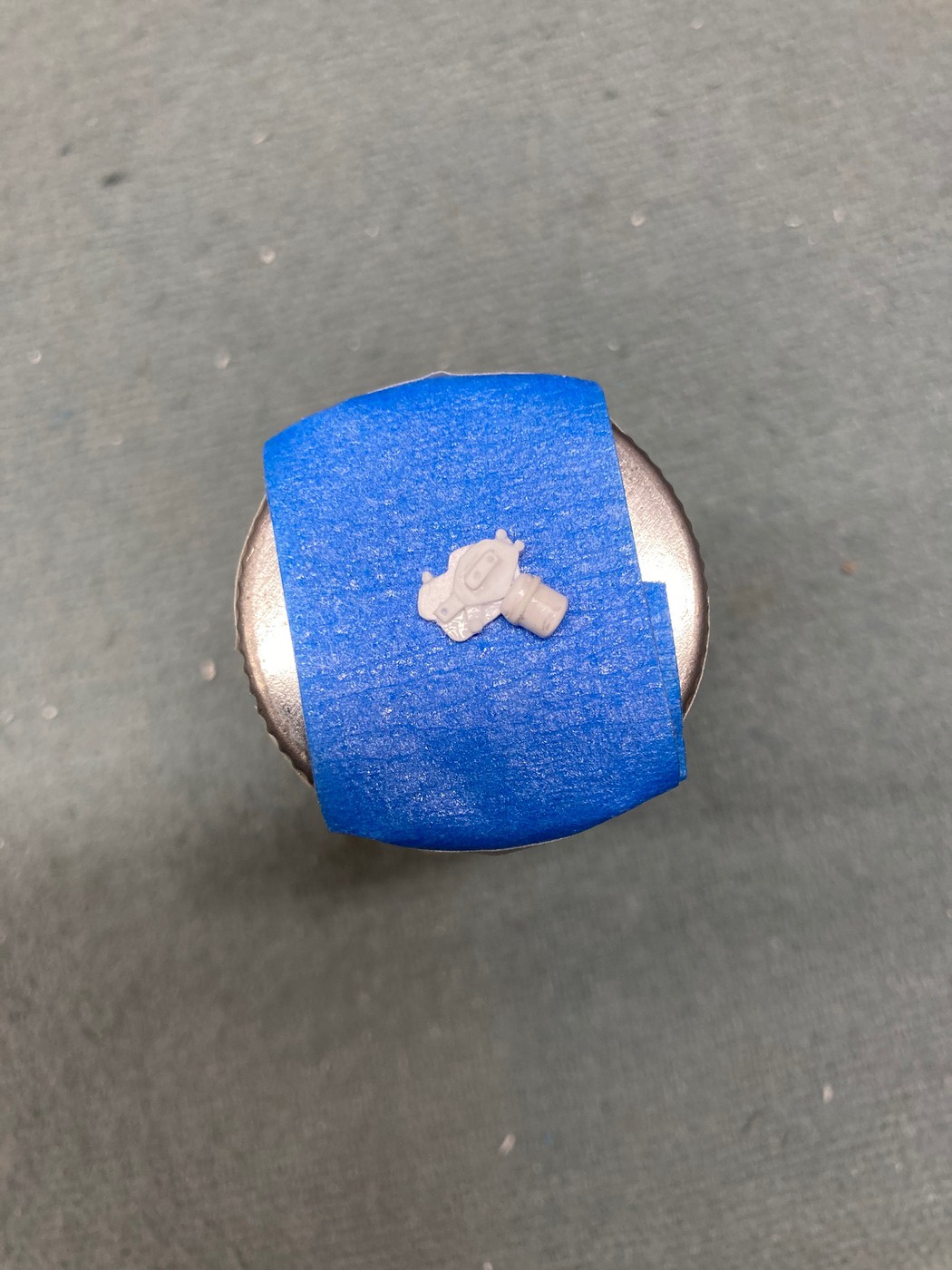

StevenGuthmiller Posted June 7, 2023 Posted June 7, 2023 (edited) Here's another part that I recently made from just basic shapes as Bill suggested. I needed a wiper motor for a '64 Pontiac, so rather than try to scrounge something from another kit, I decided that it was just as easy to make one from plastic sheet plastic. It will do the trick very nicely. I didn't take photographs as I progressed with this one, but you can pick out the individual shapes and pieces used for the overall part just by viewing the finished part's photographs. Steve Edited June 7, 2023 by StevenGuthmiller 5

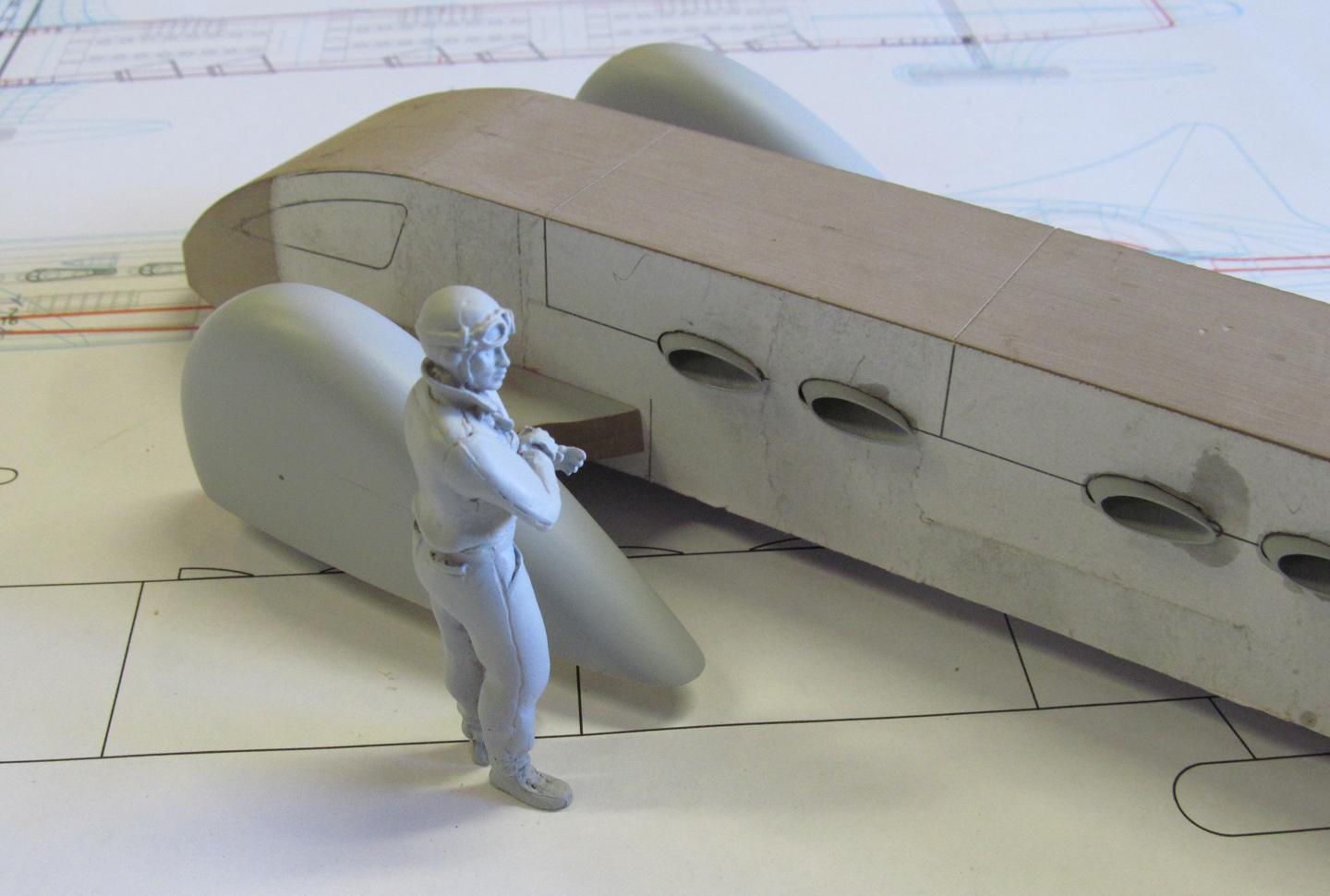

Big John Posted June 10, 2023 Posted June 10, 2023 First the idea then... Research, research,research. As Rod Stewart said "Every picture tells a story". Then any material is your gateway to modeling. 3
Straightliner59 Posted June 10, 2023 Posted June 10, 2023 1 hour ago, Big John said: First the idea then... Research, research,research. As Rod Stewart said "Every picture tells a story". Then any material is your gateway to modeling. That's some nice looking stuff ya' got, there! Renshape?
Chariots of Fire Posted June 10, 2023 Posted June 10, 2023 9 hours ago, Straightliner59 said: That's some nice looking stuff ya' got, there! Renshape? Looks like it to me. I use it quite a bit.
Big John Posted June 10, 2023 Posted June 10, 2023 Yes indeed, even the small scraps can be useful for small parts like flanges. My shop is a testament to hording scraps of wire, plastics, metal, and resins of all kinds for detailing and scratch building. 1
Chariots of Fire Posted June 11, 2023 Posted June 11, 2023 4 hours ago, Big John said: Yes indeed, even the small scraps can be useful for small parts like flanges. My shop is a testament to hording scraps of wire, plastics, metal, and resins of all kinds for detailing and scratch building. I do the same thing, John. I save every little piece. It glues up so nice; if I make a mistake I take a scrap, glue it on and reshape what ever I messed up. Fenders, engine blocks and details, cowls; comes in handy for all sorts of things. I was fortunate enough a few years back to get a 4"x2"x24" piece of it and it has been a wonderful medium to use.
Big John Posted June 13, 2023 Posted June 13, 2023 (edited) Same here Charles, Lucked into the same size slab and prize it highly. The material is basically a pure extrusion of bondo so that works well as a filler also. Below is really an extravagance. Edited June 13, 2023 by Big John aditional discription
