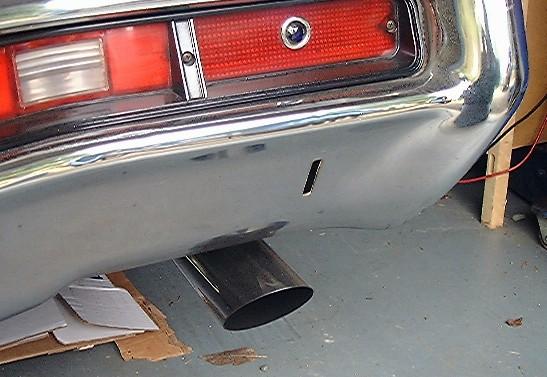

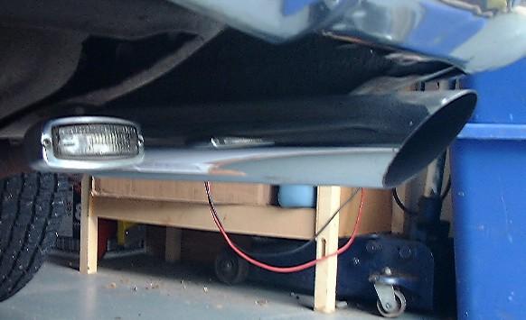

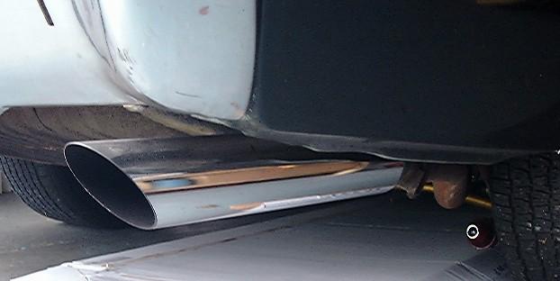

Mine is straight out the back, slightly past the bumper and slash cut. The tips are 4" diameter, 22" long and chrome plated. They are actually marketed for trucks.
