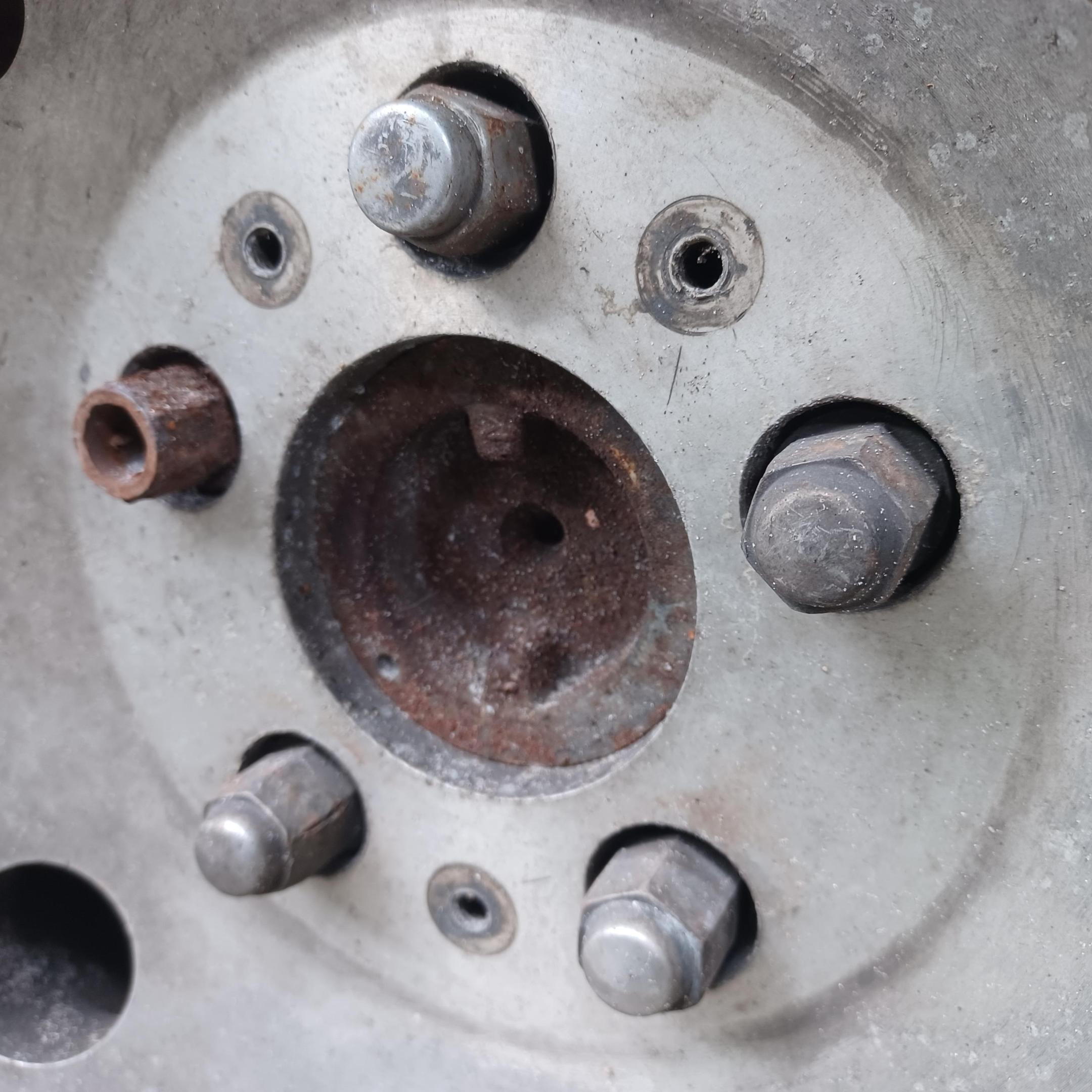

OldNYJim Posted June 16, 2023 Posted June 16, 2023 (edited) I recently learned about Ford's 2-part lug-nut design that they used on vehicles for over a decade, including mine. Local tire shop told me that I had 'swollen nuts' [their words] and offered to switch them out for $800. What happens is, apparently, over time they swell up and distort to the point where the wrench in your trunk won't work to take them off if you get a flat. Why Ford invented a new type of nut after making perfectly acceptable lug nuts for the best part of 100 years, escapes me, but it's apparently a common issue. $20 and 90 minutes of my own time, problem solved (or at least, remedied for now)...and the tire shop was right, they had definitely deformed. Somewhat related - guy at work has a new Bronco and he got a TSB notification from the local dealer about under-tightened lug nuts from the factory on his vehicle which could result in, unsurprisingly, loose wheels ? Edited June 16, 2023 by CabDriver
Tabbysdaddy Posted June 16, 2023 Posted June 16, 2023 Some of my GMs have two part lug nuts. The steel nut rusts under the aluminum skin, which distorts them or if you pull off the skin a standard lug wrench doesn't fit well.
Dave Van Posted June 16, 2023 Posted June 16, 2023 2 hours ago, CabDriver said: I recently learned about Ford's 2-part lug-nut design that they used on vehicles for over a decade, including mine. Local tire shop told me that I had 'swollen nuts' [their words] and offered to switch them out for $800. What happens is, apparently, over time they swell up and distort to the point where the wrench in your trunk won't work to take them off if you get a flat. Why Ford invented a new type of nut after making perfectly acceptable lug nuts for the best part of 100 years, escapes me, but it's apparently a common issue. $20 and 90 minutes of my own time, problem solved (or at least, remedied for now)...and the tire shop was right, they had definitely deformed. Somewhat related - guy at work has a new Bronco and he got a TSB notification from the local dealer about under-tightened lug nuts from the factory on his vehicle which could result in, unsurprisingly, loose wheels ? What cars have these???? thx
OldNYJim Posted June 16, 2023 Posted June 16, 2023 10 minutes ago, Dave Van said: What cars have these???? thx A lot...mostly 2000-2015 models, apparently. This article doesn't specifically mention Mustangs, but mine has the two-part nuts they mention... Some further reading: https://www.caranddriver.com/news/a15339991/swollen-lug-nuts-are-costing-ford-drivers-time-and-money-lawsuit-claims/
Tabbysdaddy Posted June 16, 2023 Posted June 16, 2023 Here's the ones on my Chevy van. One missing the cover, lower left you can see the cover splitting from the rust.

Mark Posted June 16, 2023 Posted June 16, 2023 Only one reason manufacturers use those two-piece lug nuts...they're CHEAPER. They've been using them for years. Condensation gets between sheath and nut, causes rust, expands the inner part a little bit spreading the sheath. Throw in freezing moisture in certain areas, and top it off with the grease monkeys using the rattle gun to loosen and tighten them. I replaced them with solid nuts on a couple of vehicles, current car had solid ones as built.

espo Posted June 17, 2023 Posted June 17, 2023 Not sure if my experience with the lug nut issues is the same, but. My issue had to do with a Grand Prix that had the polished wheels. The Lugnuts had a shiny aluminum cover wrapped around the actual Lugnut more for show than anything else. The problem really started when I had new tires installed and the air gun jockey used a socket that was slightly larger than what was required. This started rounding off the corners of the outer aluminum cover. The problem really became apparent when the outer cover started spinning around the Lugnut that held the wheels too the hub. At this point the only way to get the wheels off was to chisel the outer cover off the Lugnut so that a proper sized socket could be used. The tire shop did finally offer to buy new Lugnuts from the dealer to replace all of the ones they had jacked up. I showed them a less expensive way was to just buy a complete set of new solid chrome Lugnuts for all of the wheels and it was still less than a few OEM Pontiac Lugnuts. Sometimes the stylist designing vehicles should consult with the engineers before a final design goes into production, and shop foramen should make sure the guys in the shop use the correct size socket before rounding off a half a dozen or so Lugnuts.
