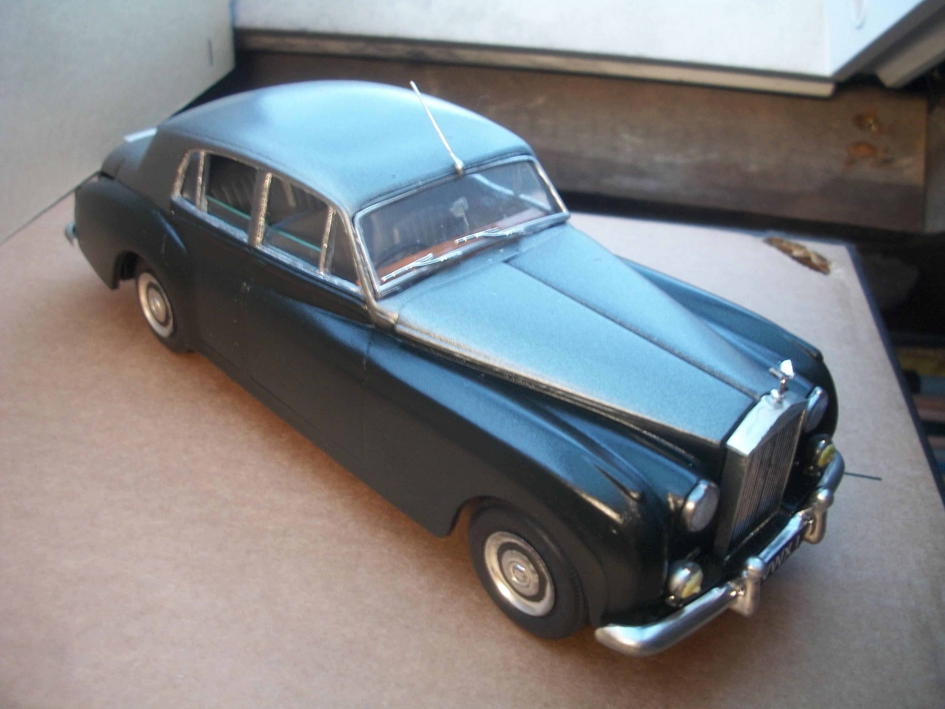

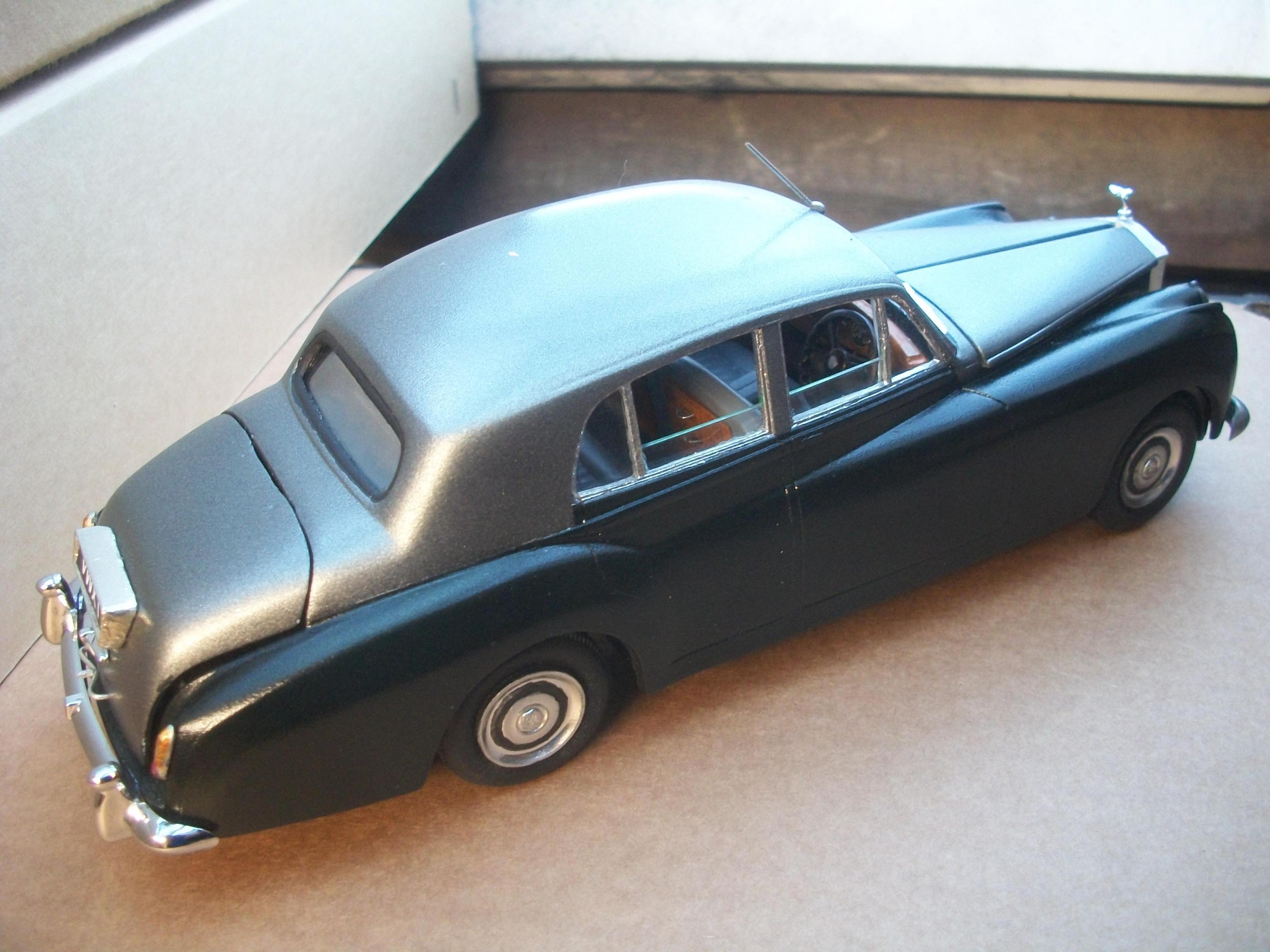

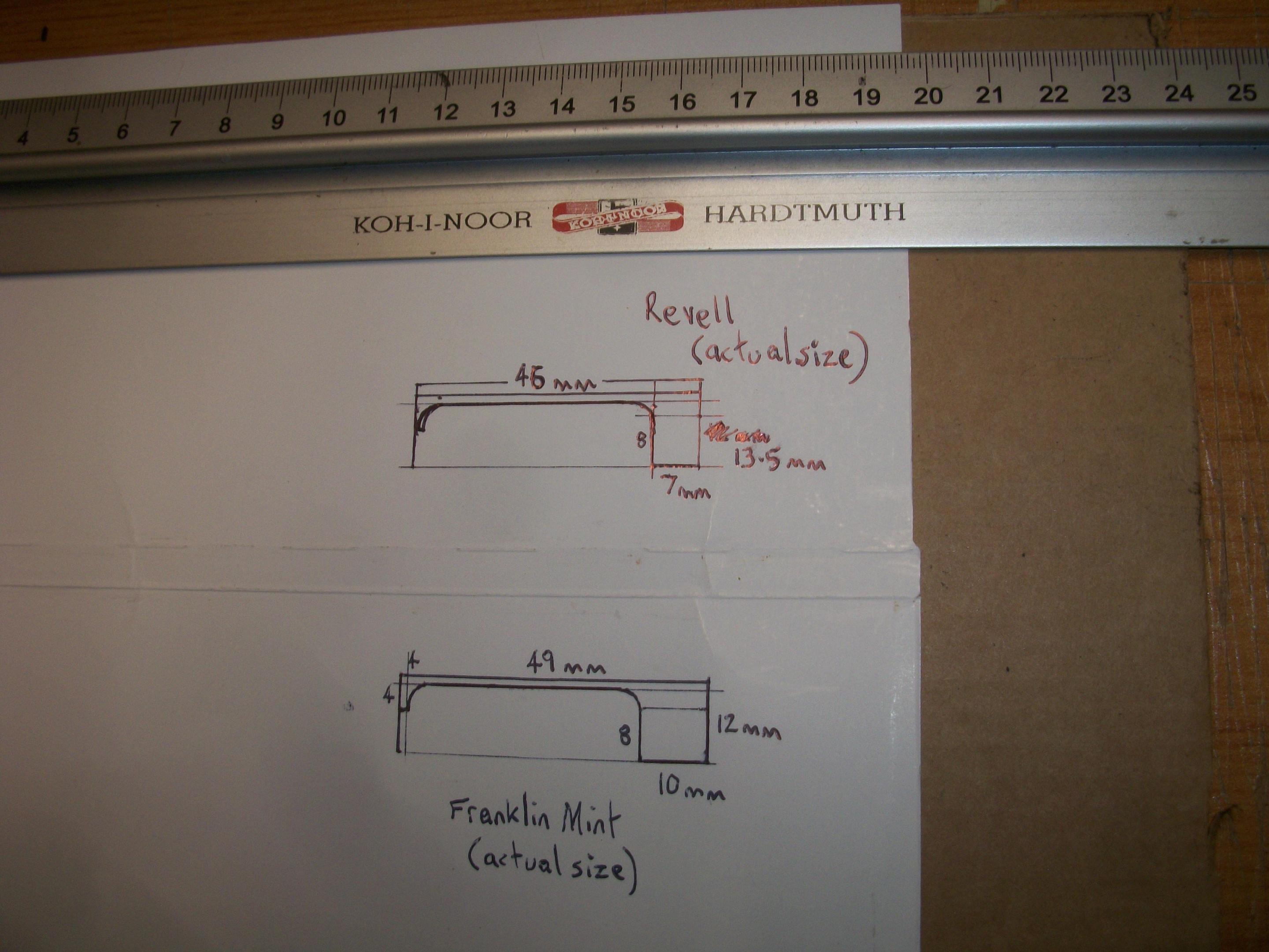

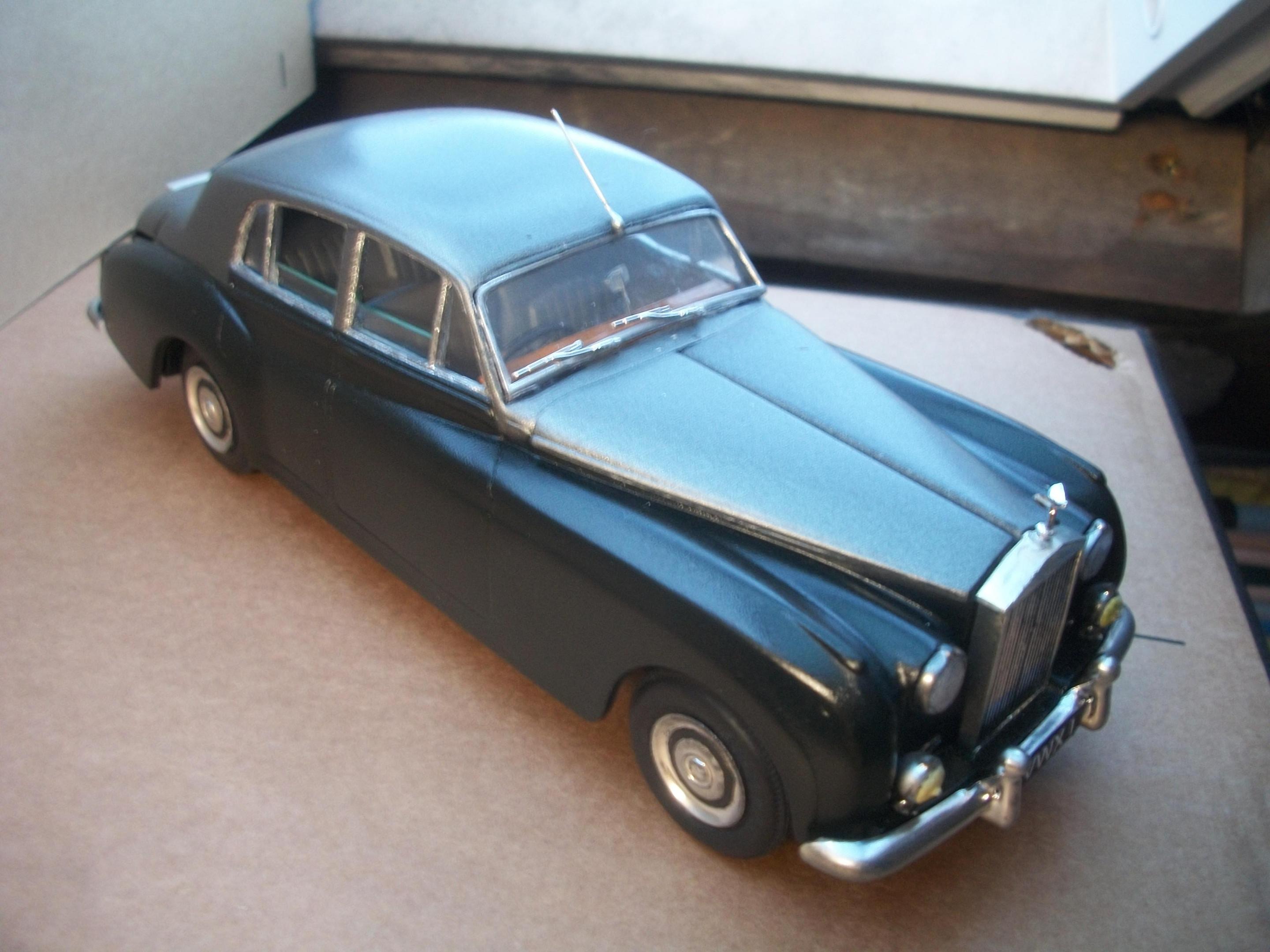

Hi David G., and thank you Noel Smith . . . I am the other David in the UK . . . This is a good effort David, and it is nice to see someone having a go !
I was going to mention that the only real donor model is not a kit, but a diecast from Franklin Mint, and this car is a 1955 Silver Cloud I with the straight 6 -engine, rather than the V8 in the SC II after 1959 . . . The Hubley / Minicraft / Revell / Entex / Masterkit version has 26 parts in the box ( I counted them ).
I agree that you can make this into a nice model, but it does require a HUGE amount of work, including scratch building of course.
The Revell kit for the Silver Cloud has grey parts that need to be chromed, while the Minicraft kit has chrome parts but the chrome is too heavy.
The Revell kit does have nice rubber tyres, whereas the Minicraft kit has horrible tyres that have more plastic than rubber.
The straight-6 cyl. engine can be extracted from the FM diecast, or there is one on Shapeways designed by myself. ( Minicraft V8 engine is a joke ).
Take note : the Spirit of Ecstasy radiator grille top mascot is WAY too large in all of the kits . . . This needs to be significantly smaller, so either a resin cast part or the Franklin Mint part is correct, but always missing from Ebay sellers. Also note, the boot lid reg. number plate plinth that is fitted to all British Silver Clouds is not included in the kit box, and the FM diecast doesn't have it either for the American models.
Good luck with this build David G., and I am not the expert, but I have built eight of these Rolls-Royce models, and the most recent one took me 7 months to build and paint, so any questions are welcome.
There was a Hubley promo in blue plastic, as well as the Hubley kit, also in blue plastic.
David

Nice test fit photos David . . . As you can see now, from the test fit and also the application of primer, there are many issues with these kits.
Two things to keep in mind . . . The aperture for the windscreen is slightly too small, and consequently the windscreen in the kit box is too small. My solution to this involved enlarging the aperture at all four edges, and then you can either cut a piece of clear plastic from something like cake box packaging, or you can use a windshield removed from the 1:24 scale Franklin Mint Rolls-Royce Silver Cloud . . . The other thing is that the rear window should have a matt black surround to represent the rubber seal, and there is no chrome surround to the rear window. Franklin Mint did add a chrome surround to their diecast model, which is absolutely not correct.
The proportions of this motor car were designed to such perfection by the Rolls-Royce company, that the dimensions of the windscreen have to be very precise for the whole car to look right. This is why just one millimetre out on the scale model will make a massive difference. To give the Minicraft people some credit, they did manage to produce an accurate body, which for the most part has good proportions. That is what motivated me to go to great lengths to build a good model from this kit.

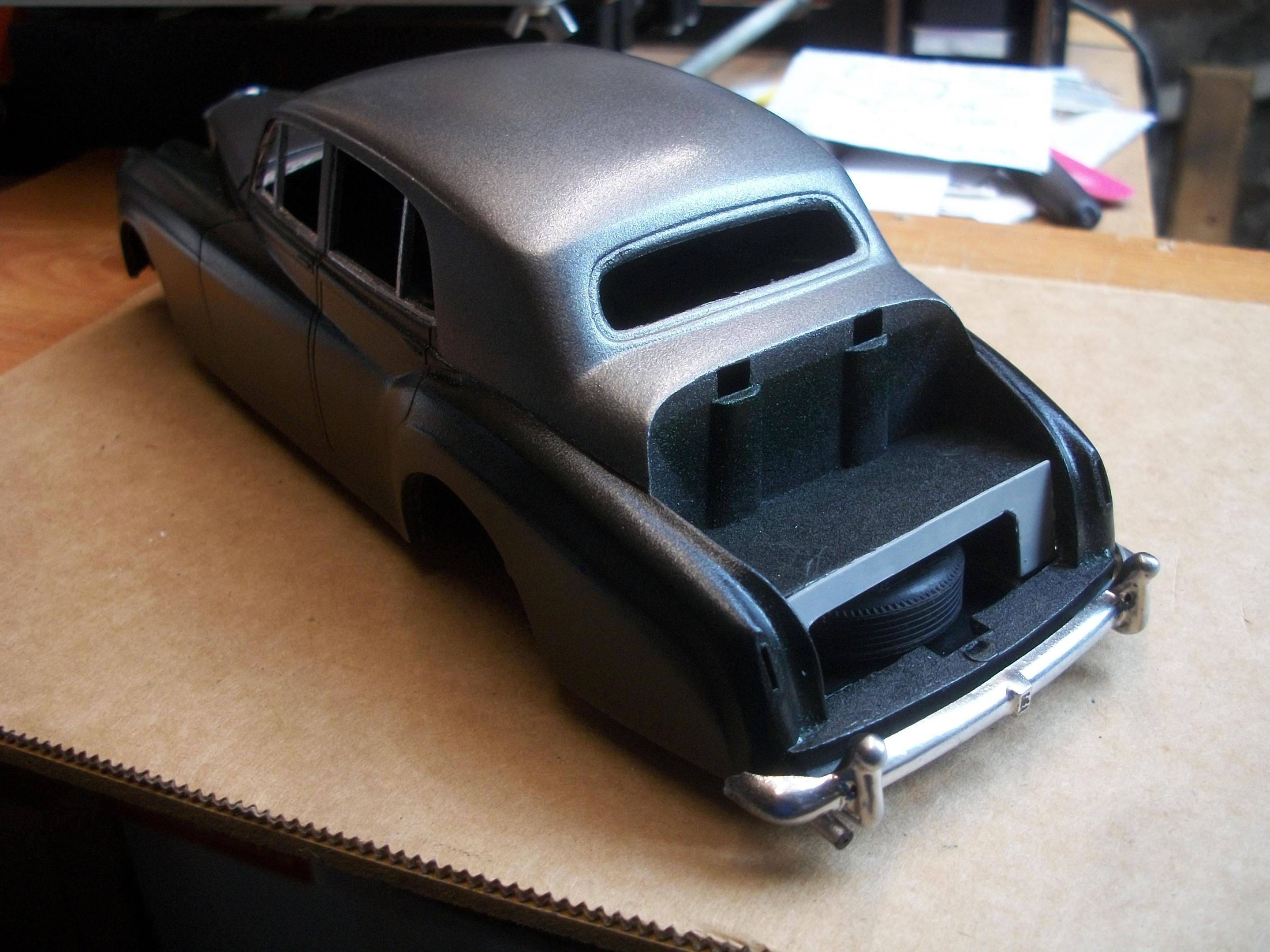

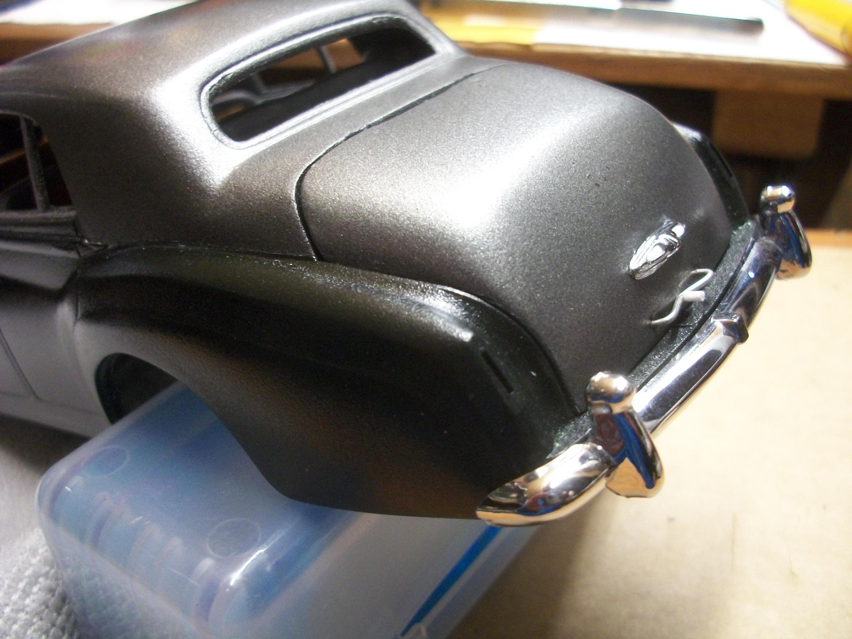

Yea, working on the trunk interior would rob a bunch of time.  I would *have to* make a wicker picnic basket, liquor case, and a couple of expensive looking shotguns or rifles, and perhaps a nitrous bottle.  And what's stupid about adding such details, I play with it a few times, and then it sits on the shelf. ?
Certainly, those joints where the front wings meet the doors and the windscreen pillars are a difficult area of this body to fix. You are doing a fine job, and the joints have to be almost seamless . . . As regards the spare wheel David, I found there were 5 wheels and 5 tyres in every kit that I purchased, so I always put a spare wheel and tyre inside the boot. Maybe the kit that you bought only  had 4 wheels and tyres?

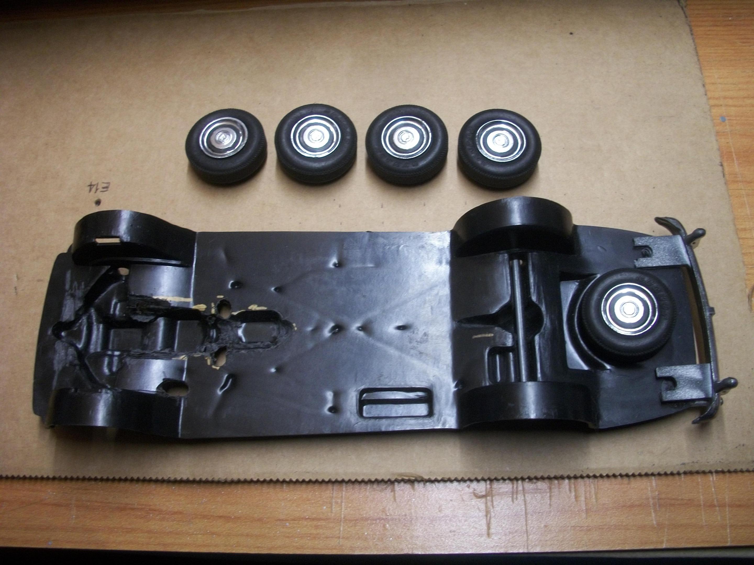

Here are four photos that show the spare wheel setup, which includes a scratchbuilt panel that is not in the kits . . .
David W.
  • Like 2
David W.
Thank you for your kind and encouraging words David.
Unfortunately I did receive five wheels but only four tires. I thought about digging in the parts box for a suitable match but I decided against that. Given the amount of body work I was already tasked with on this build, I felt that my time would be better spent just correcting the poor fit of the boot lid and foregoing any thoughts of retaining the functionality.
The one you built looks great. The added panel is a nice touch as is the carpet texture.

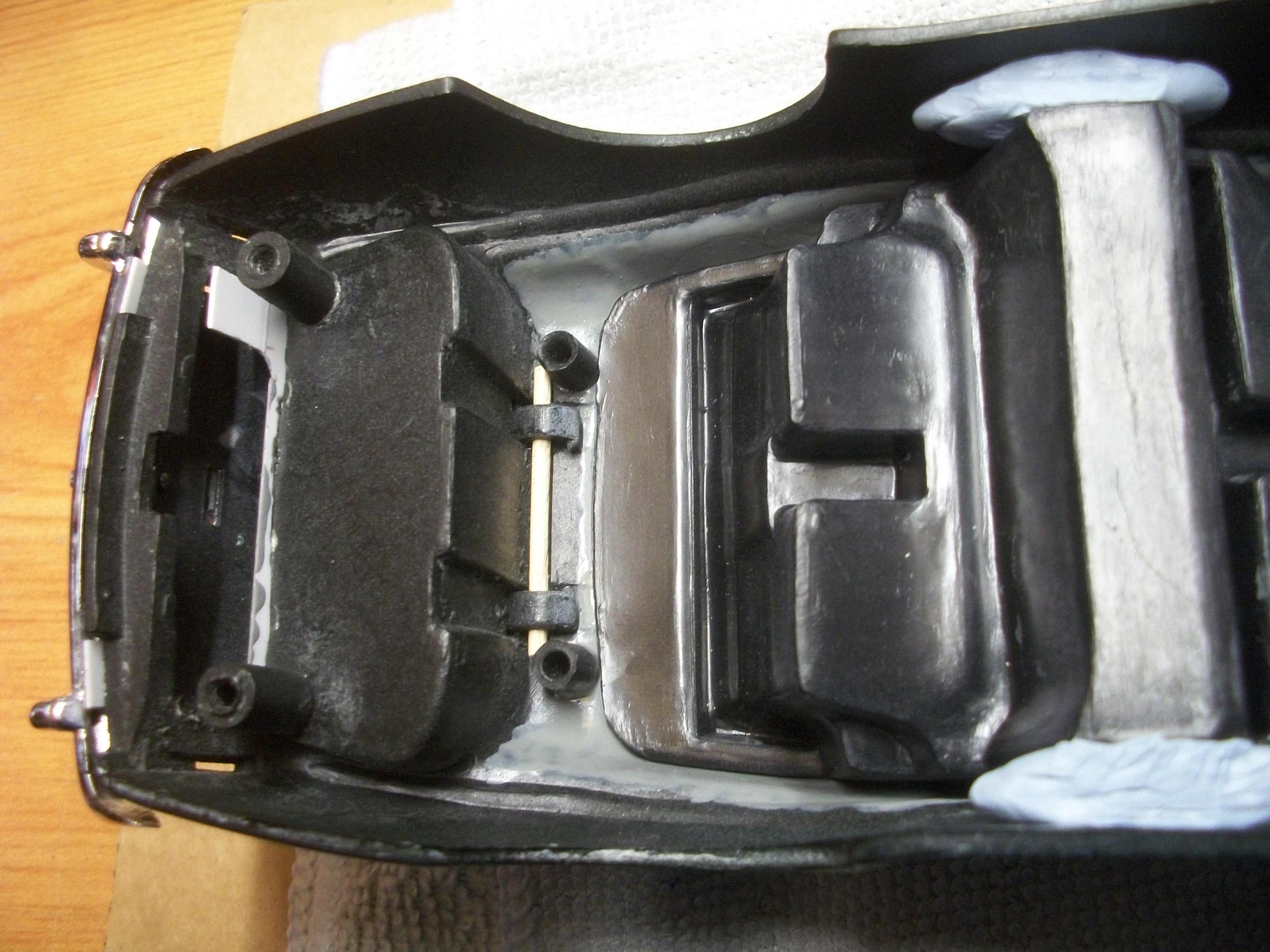

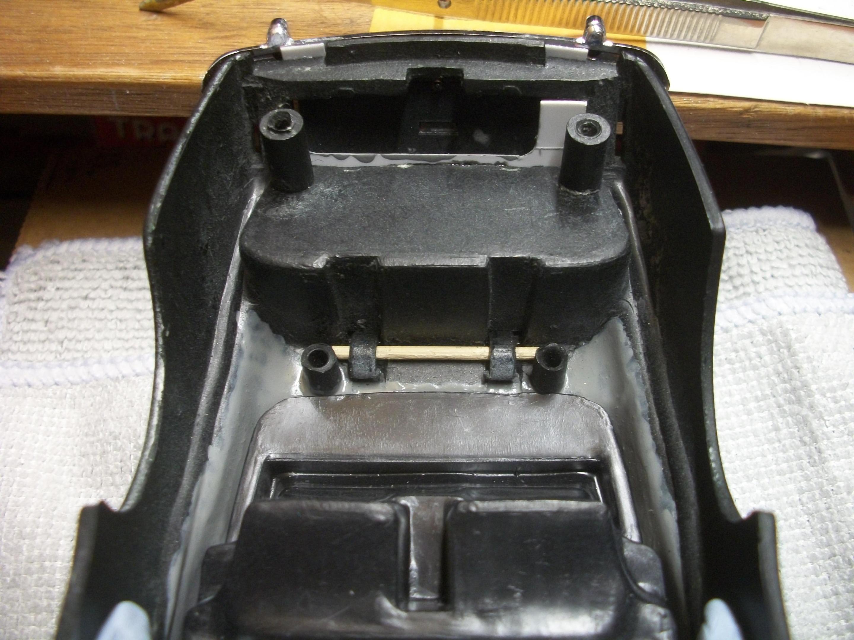

I forgot to mention last time, but as you are having difficulty in getting the boot lid to fit . . . What I do with every Silver Cloud build, is to cut a length of cocktail stick or bamboo toothpick if you like, and insert this under the two boot lid hinges from the inside of the body. This takes out all of the slack from the sloppy fit, and the boot lid hinges up and down quite nicely. There is still a bit of a gap actually, and I noticed you intend to glue the boot lid in the closed position.
These photos show the hinge ' stick ' modification.
David

On 6/17/2023 at 4:19 PM, 89AKurt said:
I recently acquired this exact kit too.  Very curbside chassis.  I want to install an engine, so many 3D printed choices nowadays.  But then you need a realistic suspension, and then and then and then, it's gonna domino.  I'll be lurking.
A reasonable alternative is actually the Chevrolet small block, apparently a fairly common conversion in the US in particular.
There are probably exhaust systems that give the right whisper.
  • Like 1
