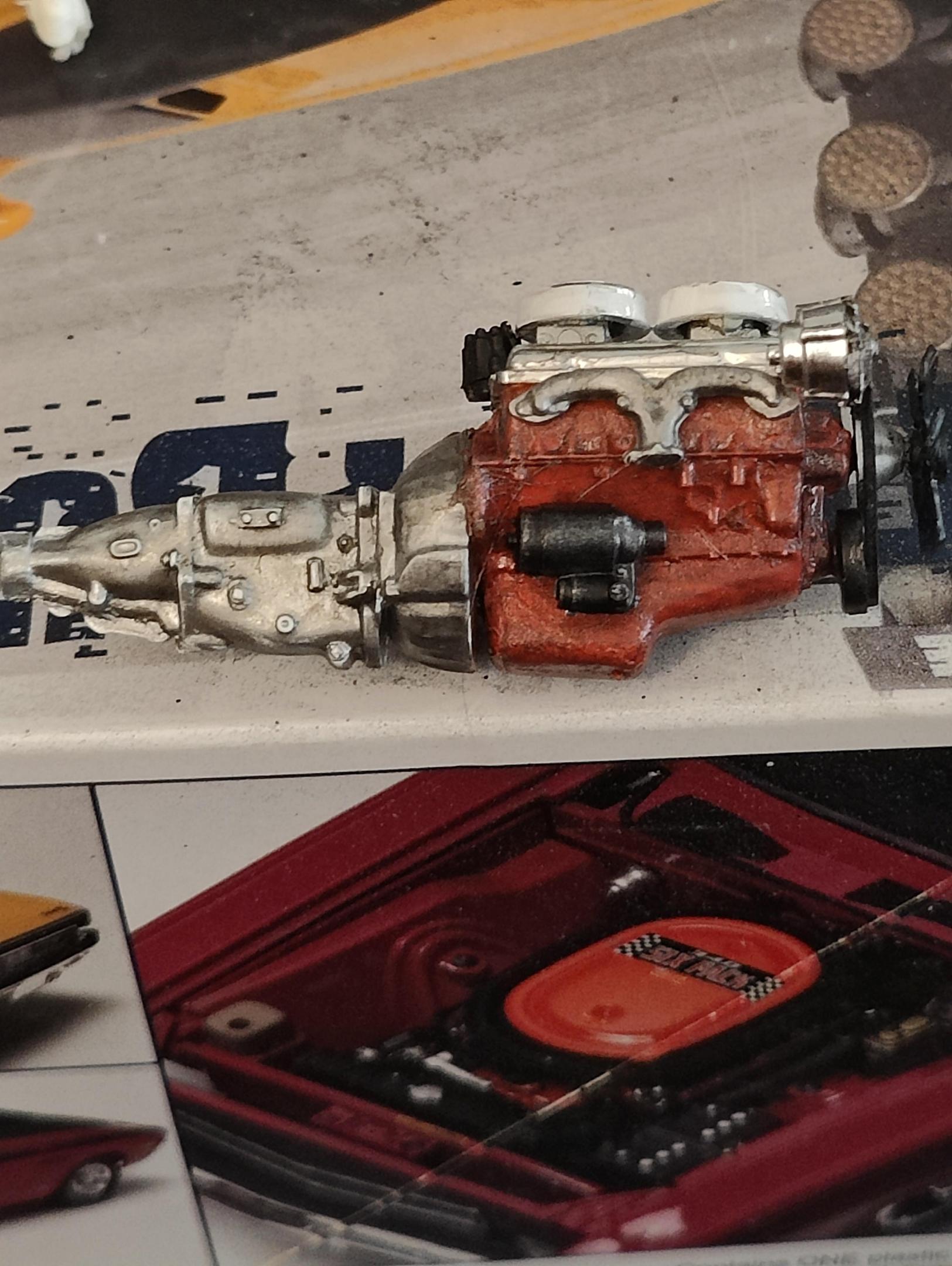

MrMiles Posted June 17, 2023 Posted June 17, 2023 What's the best way to make an engine look used but not rusty and decrepit. For example I'm looking for what would be equivalent to a car that has been used for a couple of years. So not paint chipped or rusty but not shiny showroom fresh either

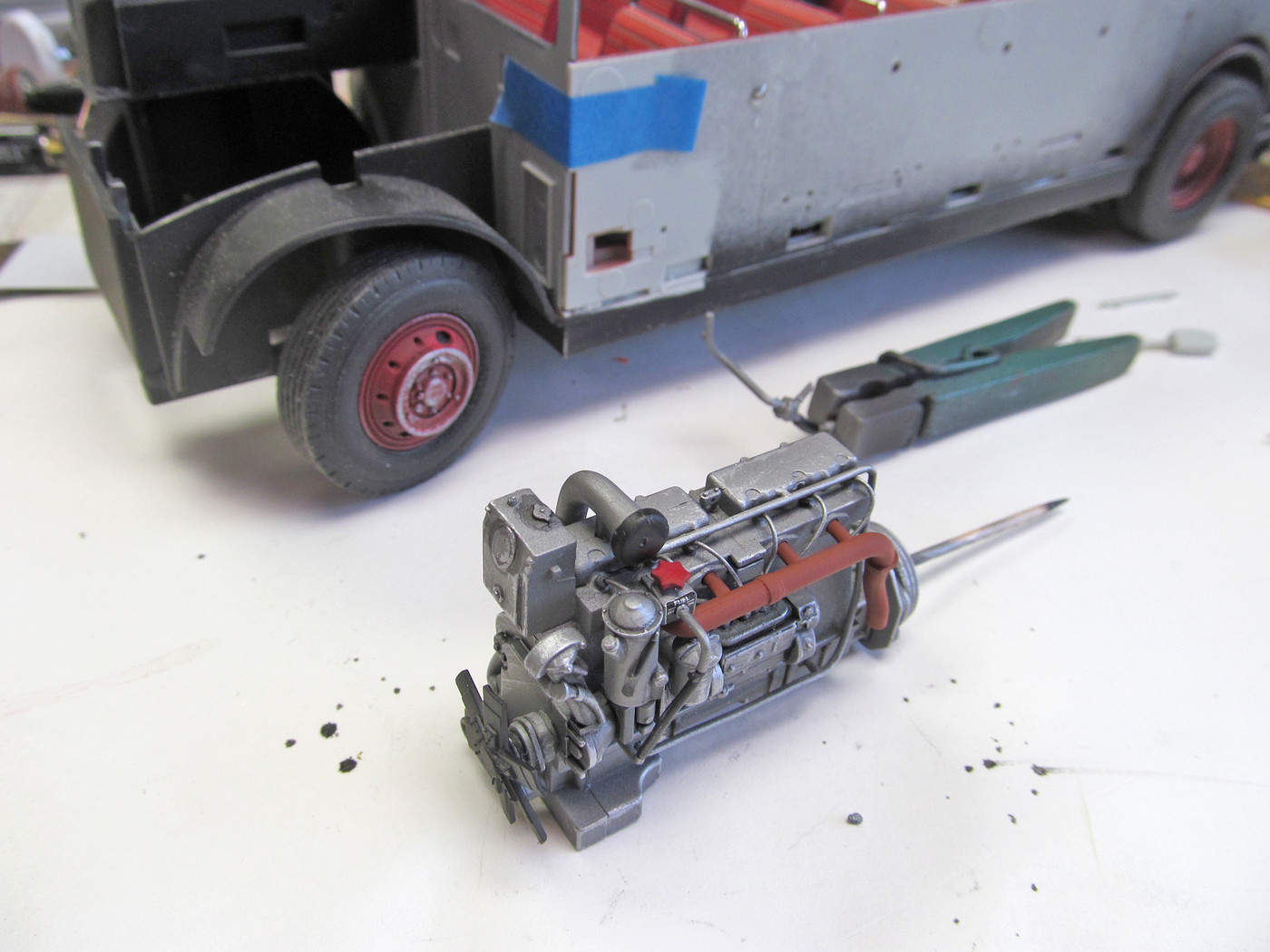

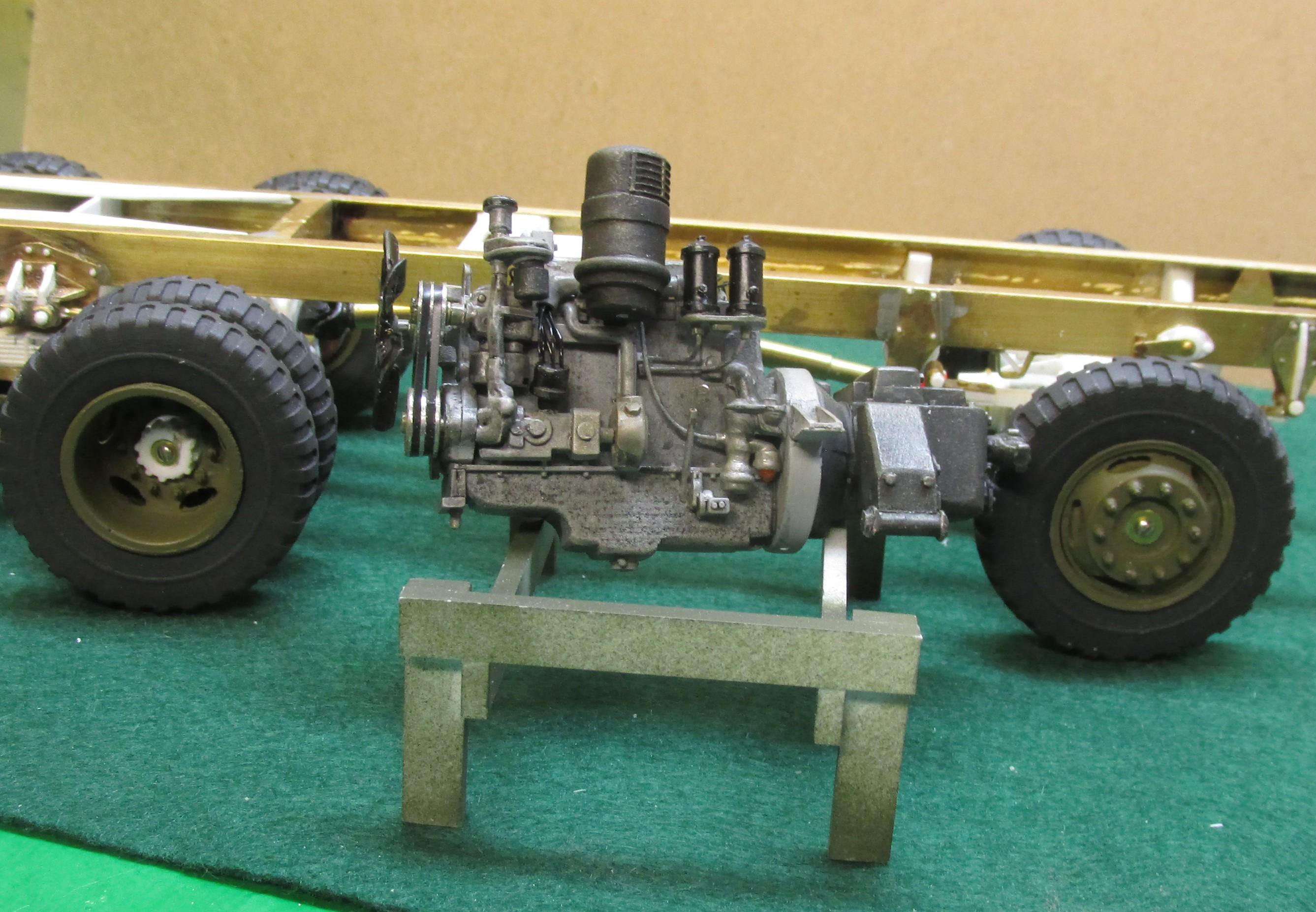

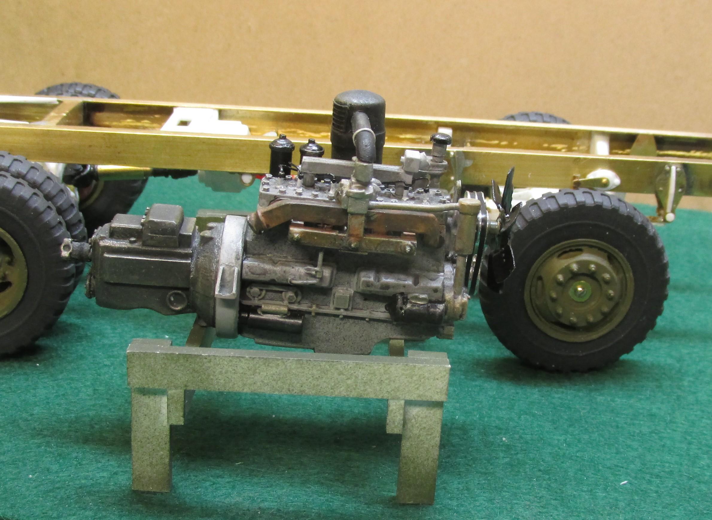

Chariots of Fire Posted June 17, 2023 Posted June 17, 2023 Agree with above. Black or dark gray washes are best. A little oil drip where it would typically happen, rusty exhaust manifold where it gets hot, things like that. Here's a Hercules RXC engine that was done for a Diamond T truck.

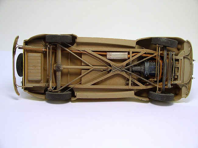

StevenGuthmiller Posted June 17, 2023 Posted June 17, 2023 (edited) I agree with the washes. Some dry brushing with a little thinned acrylic craft paint, and some dabbing and wiping here and there with damp Q-tips after it dries a bit can help to add typical dirt and grime to an engine and chassis as well. I used basically 3 colors of flat craft paint on this engine and chassis. A wash of oily dark brown. Then in select areas, a dry brushing of a rusty reddish brown, some dirty light tan to simulate road grime, an finally a little dabbing here and there with more of the oily brown. Just remember that once you start heading down this path, you're going to want to treat the engine bay and chassis in the same fashion to keep it convincing. There's no such thing as a car with a grungy engine and a squeaky clean engine bay and chassis. My objective with this project was to depict a vehicle that's been well used under regular, normal driving conditions for a few years. A well maintained body and interior with a typical grungy and dirty engine bay and chassis. Steve Edited June 17, 2023 by StevenGuthmiller 1

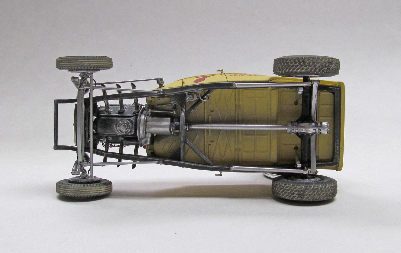

StevenGuthmiller Posted June 18, 2023 Posted June 18, 2023 Here's another example of light weathering, but to a lesser degree, if you're looking for something a little less "dirty". Again, done with cheap acrylic craft paints exclusively. Steve 2
atomicholiday Posted June 18, 2023 Posted June 18, 2023 Steve, do shoot a gloss coat before applying washes? I've seen that done by the airplane and armor guys.
StevenGuthmiller Posted June 18, 2023 Posted June 18, 2023 (edited) 16 minutes ago, atomicholiday said: Steve, do shoot a gloss coat before applying washes? I've seen that done by the airplane and armor guys. Not necessarily for any particular weathering purpose. If the part was originally supposed to be shiny, I shoot it with gloss. If it wasn't, I don't. If you look at the '64 Pontiac chassis you'll most likely be able to tell that some of the parts were painted with gloss paint, (or gloss coated) and some were not prior to weathering. I think this approach gives a good mix of textures and sheens. The frame itself, as well as most of the suspension parts were gloss. The chassis pan and exhaust pipes were not. The front fender wells were also painted satin black. Steve Edited June 18, 2023 by StevenGuthmiller 1 1

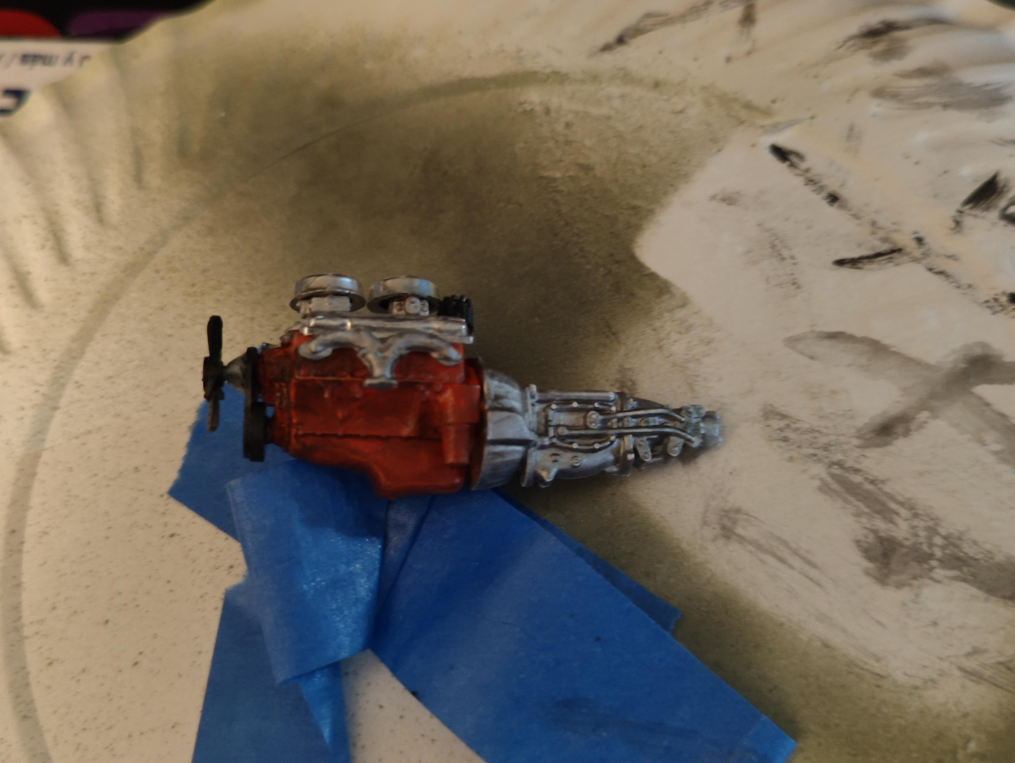

MrMiles Posted June 18, 2023 Author Posted June 18, 2023 I tried to black wash the engine. I think it's too much but I can't seem to be able to get it off now. 1
redscampi Posted June 18, 2023 Posted June 18, 2023 (edited) I think what I would do here is to dry brush the orange back onto the engine. This needs to be done with an old brush with almost no paint on it. Wipe it on a paper towel until almost nothing comes off. Then hit the corners and high spots until you're satisfied with the results. Again, I'd suggest practicing on a spare engine to get the feel of it. Edited June 18, 2023 by redscampi 2
StevenGuthmiller Posted June 18, 2023 Posted June 18, 2023 54 minutes ago, MrMiles said: I tried to black wash the engine. I think it's too much but I can't seem to be able to get it off now. What paint did you use for the wash? That’s one of the advantages of using craft paint. If you don’t like the result, you can easily wash it off with warm water. Steve 1
atomicholiday Posted June 18, 2023 Posted June 18, 2023 (edited) 1 hour ago, MrMiles said: I tried to black wash the engine. I think it's too much but I can't seem to be able to get it off now. What did you use for a wash? You might be able to clean it up with a cotton swab and something like isopropyl alcohol. But that depends on your wash. Don’t saturate the swab. Just get it damp. Be careful using this technique on the chrome. I’ve had issues there before. Don’t “scrub” it. Just wipe over it lightly a time or two. edit- meant to say isopropyl alcohol. Not denatured. Edited June 18, 2023 by atomicholiday
Tom Geiger Posted June 18, 2023 Posted June 18, 2023 Miles your engine looks just fine! Ever time I weather up something I think I went too far but it looks better the next day! Just the act of walking away from it and seeing it fresh! Also you are looking at the whole engine. Perspective changes when it’s in the model

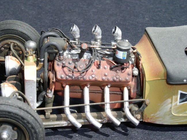

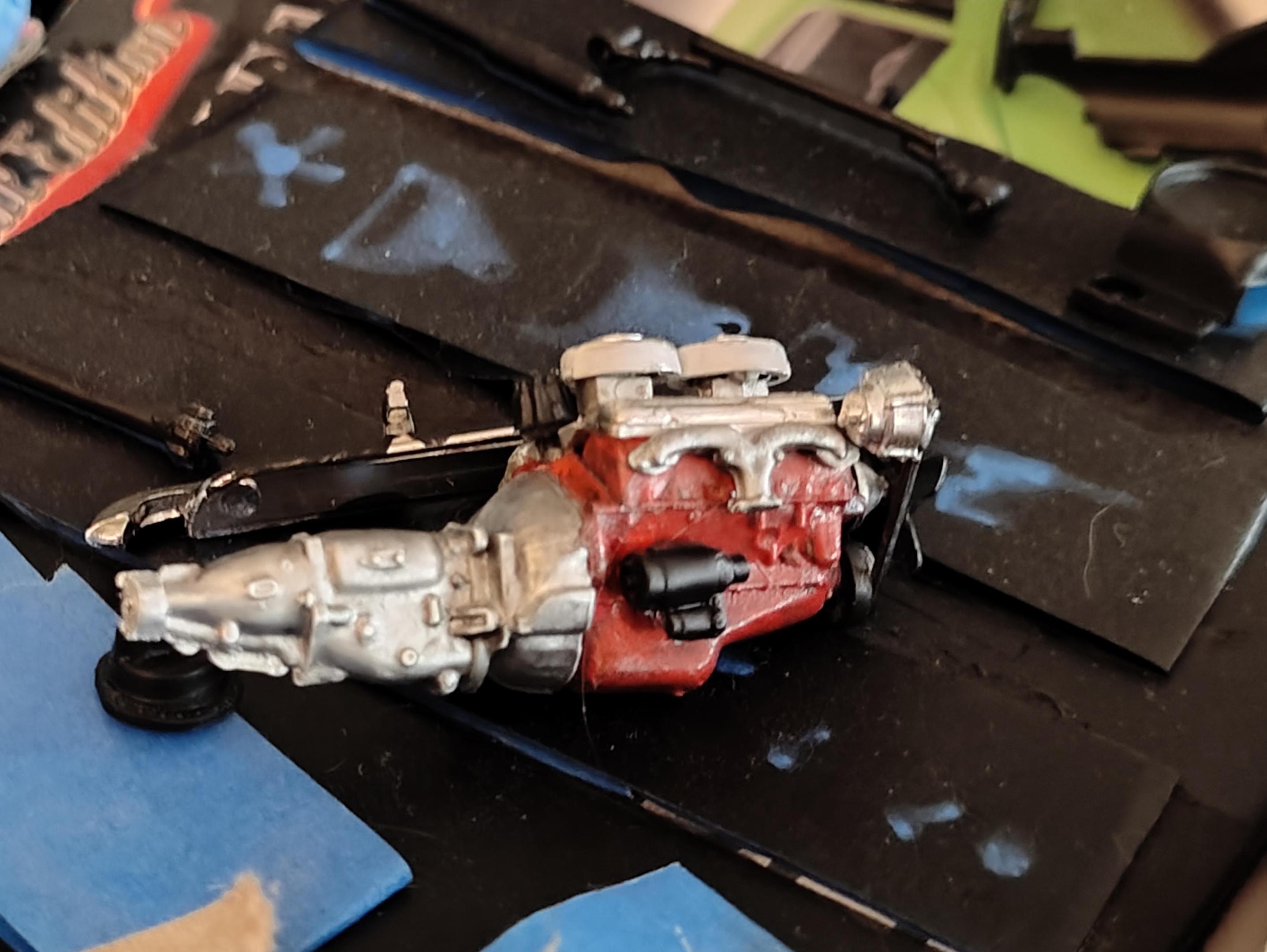

MrMiles Posted June 19, 2023 Author Posted June 19, 2023 (edited) Here it is with the starter. I straightened out the starter after taking the picture. I didn't realize how crooked it was until after 13 hours ago, Tom Geiger said: Miles your engine looks just fine! Ever time I weather up something I think I went too far but it looks better the next day! Just the act of walking away from it and seeing it fresh! Also you are looking at the whole engine. Perspective changes when it’s in the model You were right. It definitely looks better to me today. Way better than if I left it super shiny Edited June 19, 2023 by MrMiles 2
MrMiles Posted June 19, 2023 Author Posted June 19, 2023 I did a little weathering to the starter too

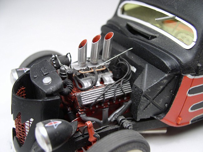

bisc63 Posted June 19, 2023 Posted June 19, 2023 If your engine has "weathered" or aged, one thing that stands out to me is those clean iron exhaust manifolds. Rust 'em! Wash some thin brown over them, and maybe pat a dry brush of a slightly lighter or darker brown over that. You are on the right track, the engine's looking believable!
StevenGuthmiller Posted June 19, 2023 Posted June 19, 2023 30 minutes ago, bisc63 said: If your engine has "weathered" or aged, one thing that stands out to me is those clean iron exhaust manifolds. Rust 'em! Wash some thin brown over them, and maybe pat a dry brush of a slightly lighter or darker brown over that. You are on the right track, the engine's looking believable! True. The first thing that happens when you start up an engine, is that the heat burns the paint off of the exhaust manifolds in very short order, leaving bare metal, that rusts almost as quickly as the paint burns off! ? Steve

MrMiles Posted June 20, 2023 Author Posted June 20, 2023 3 hours ago, StevenGuthmiller said: True. The first thing that happens when you start up an engine, is that the heat burns the paint off of the exhaust manifolds in very short order, leaving bare metal, that rusts almost as quickly as the paint burns off! ? Steve Thank you. Great point. I just ordered some rust wash from Amazon
