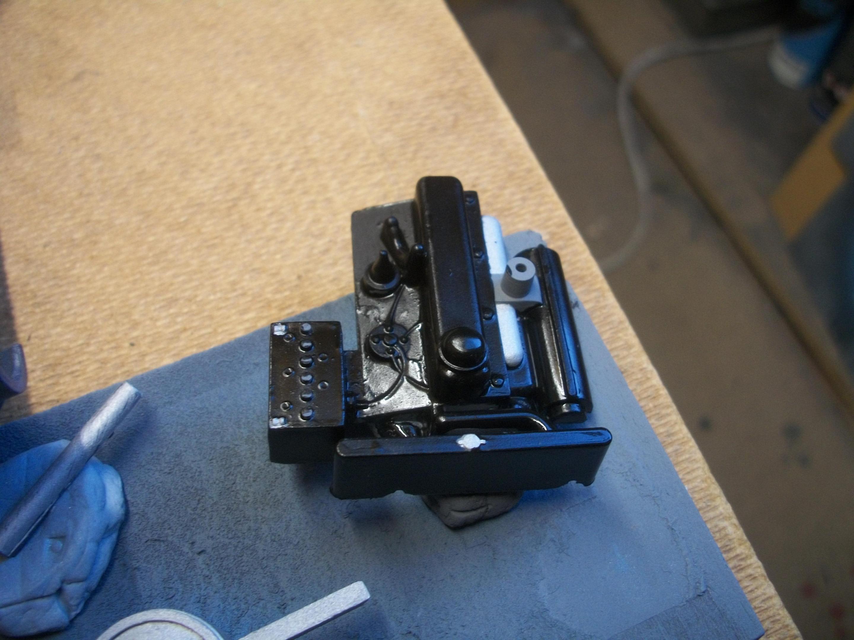

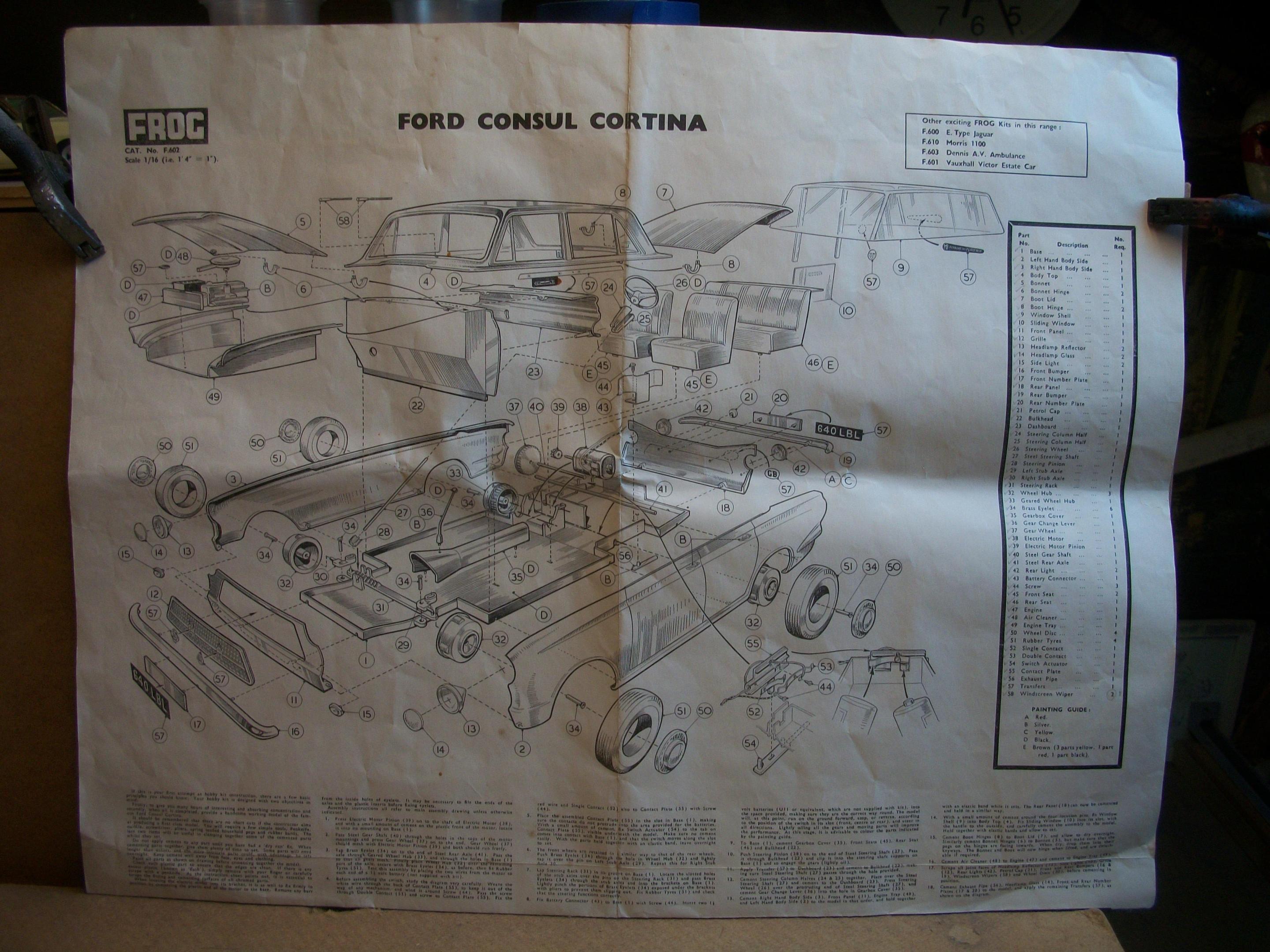

Anglia105E Posted June 21, 2023 Posted June 21, 2023 This excellent vintage kit by Frog was manufactured in 1962, so it is 60 years old . . . These kits rarely appear on Ebay, and when they do come up they fetch high prices. Rightly so, because there can't be many left out there. Luckily, I was able to win the recent Ebay auction, despite finding myself up against several determined bidders who were clearly going to bid high. The price shot up during the final 60 seconds and I somehow came out on top. The kit according the listing on the large instruction sheet has 81 parts plus a small decal sheet. Following my careful inventory of the actual parts in the box, I counted 80 parts in total, so only one part missing which is a front side light. The kit box was in poor condition, and the previous owner of the kit had part built the model by assembling the rolling chassis, including the electric motor and steering. I was aware that this model can be motorised, but I shall not be making use of this feature. My Dad, who passed away back in 2005, used to own a 1963 Ford Consul Cortina MK 1 deluxe, which was a 4-door car and finished in Ford Light Blue . . . During 1970 my Dad taught me how to drive in this Cortina, as I had reached 17 years of age. I passed my driving test at the third attempt and the Cortina was a joy to drive. This is why the following build is very important to me, because I have fond memories of my Dad's car. You may have seen my previous topic in another section ' Rust-oleum Issues? ', which explains why I was so concerned about which paints to use for this rare vintage kit, and having some considerable trepidation regarding the possibility of modern paint products attacking the 60 year old expensive plastic. Thanks to many fellow MCM Forum members offering sound advice and words of encouragement, based on their years of experience, I have decided to go with Tamiya lacquer aerosol cans, rather than the alternatives which included Rust-oleum products, automotive cellulose paints in custom mixed cans and Zero Paints products intended for airbrush use. The method of assembly for this kit is somewhat unorthodox, in the sense that the body parts have to be assembled separately, rather than having a one piece ready made body shell . . . Consequently, the filling of the joints, sanding, primer and paint application will have to be done after the body parts are glued together, and not before adding other parts such as chassis and interior to the body shell. This will be my first time building in this way, and also my first time using Tamiya paint products. I shall be using Mr White Putty 'R' as my preferred filler, and also Tamiya Polishing Compounds, Coarse, Fine and Finish grades. Here are the first batch of photos to show what we have on the workbench . . . I hope this turns out to be an interesting build ! David 4

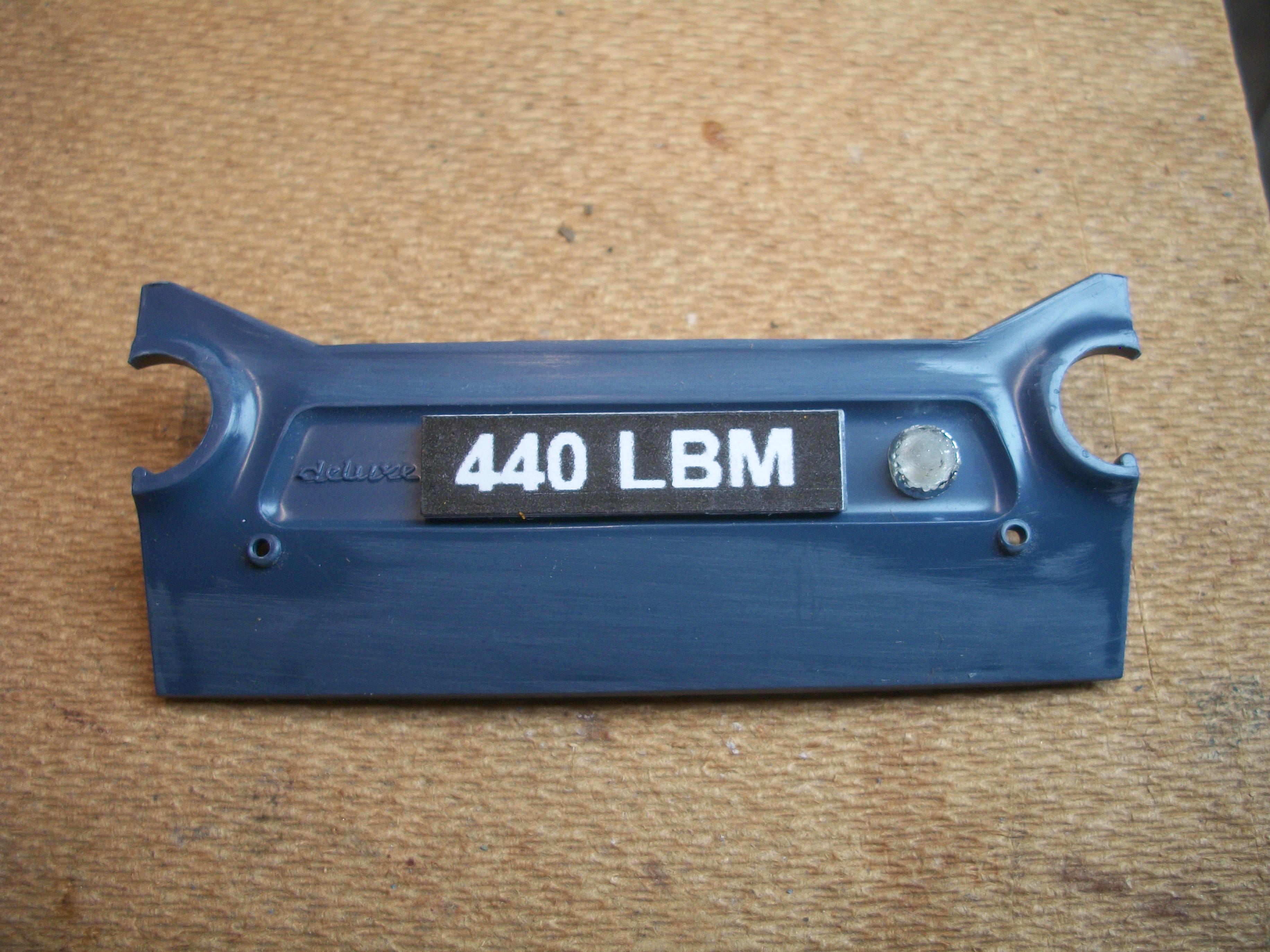

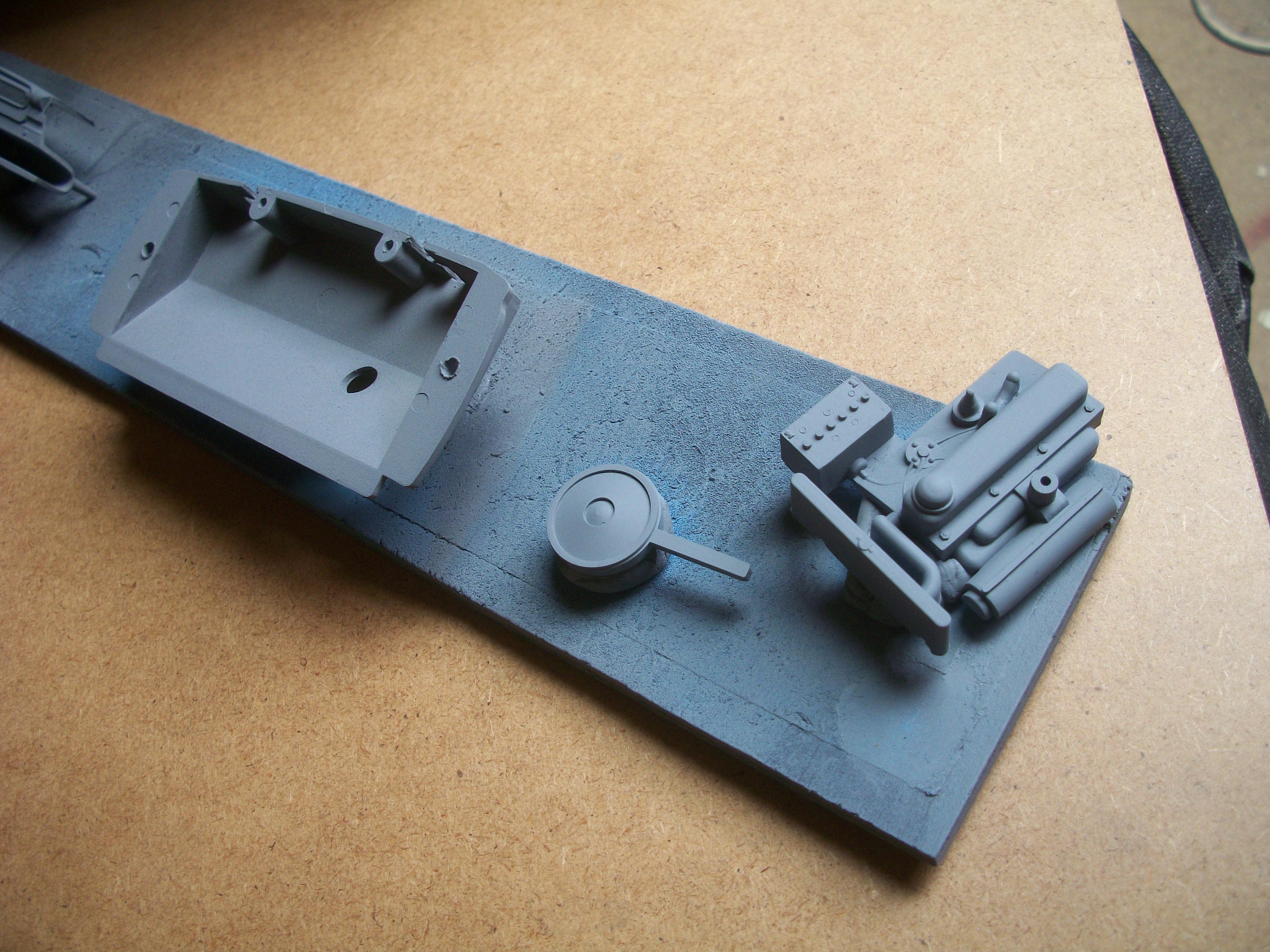

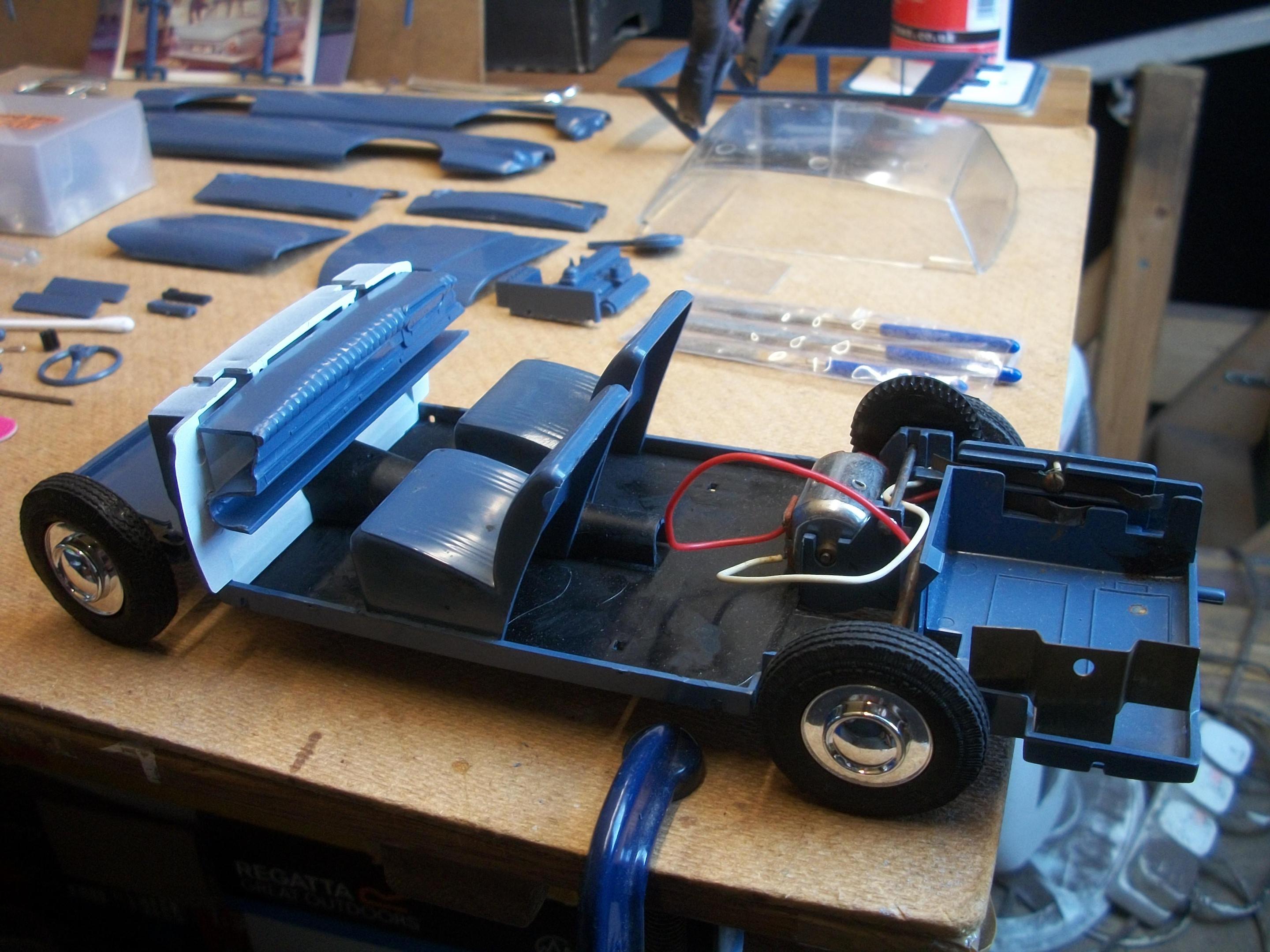

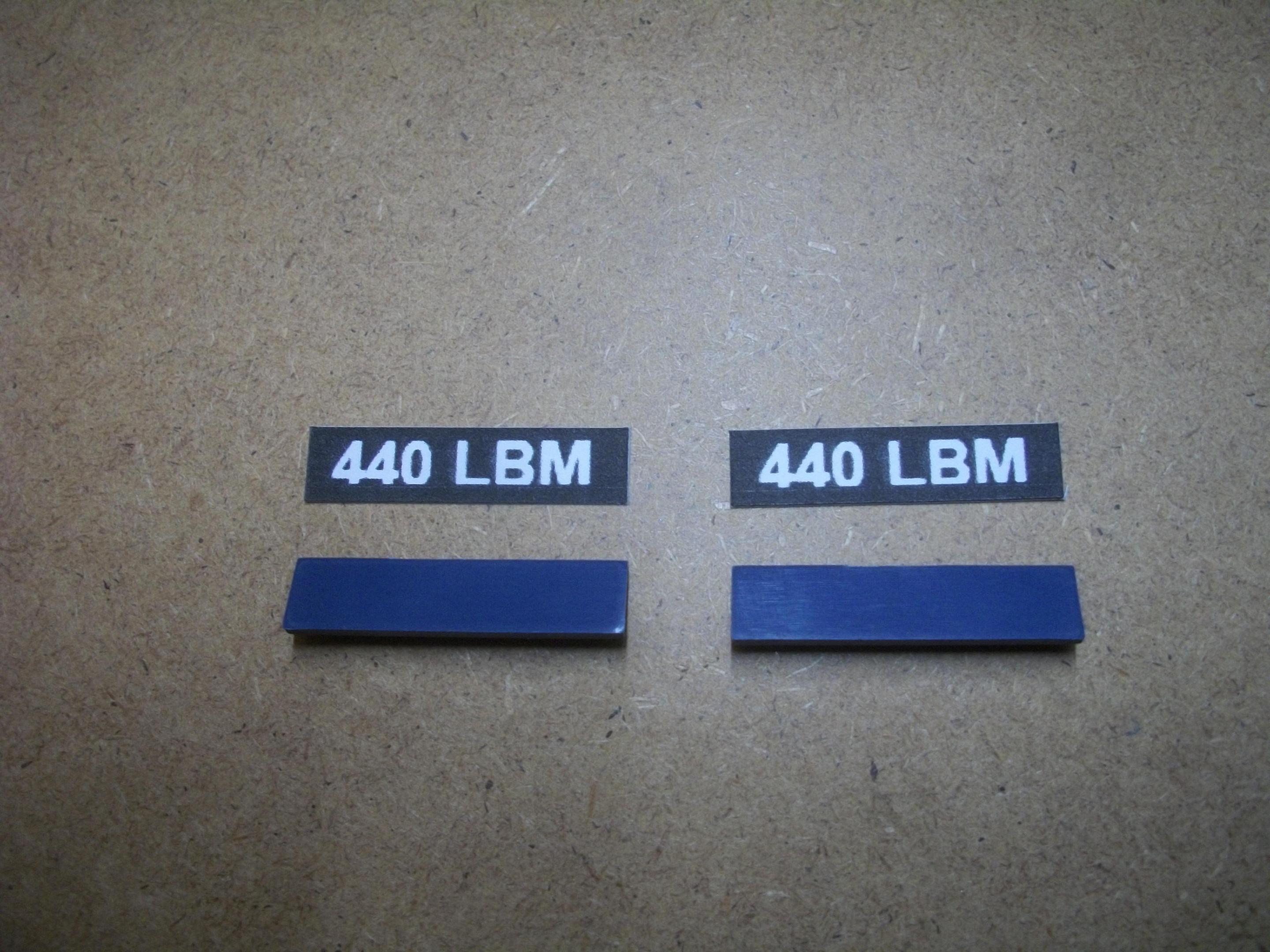

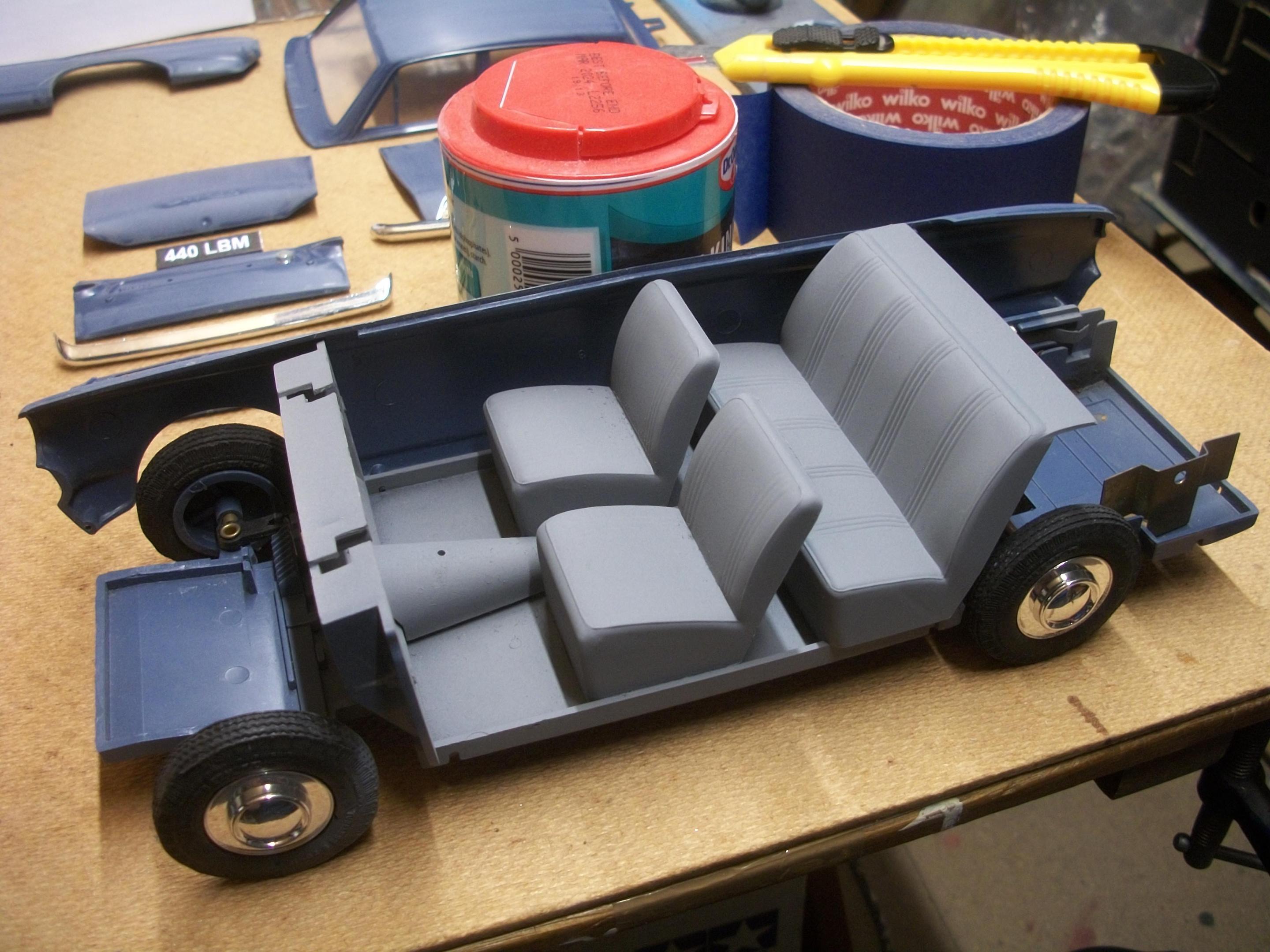

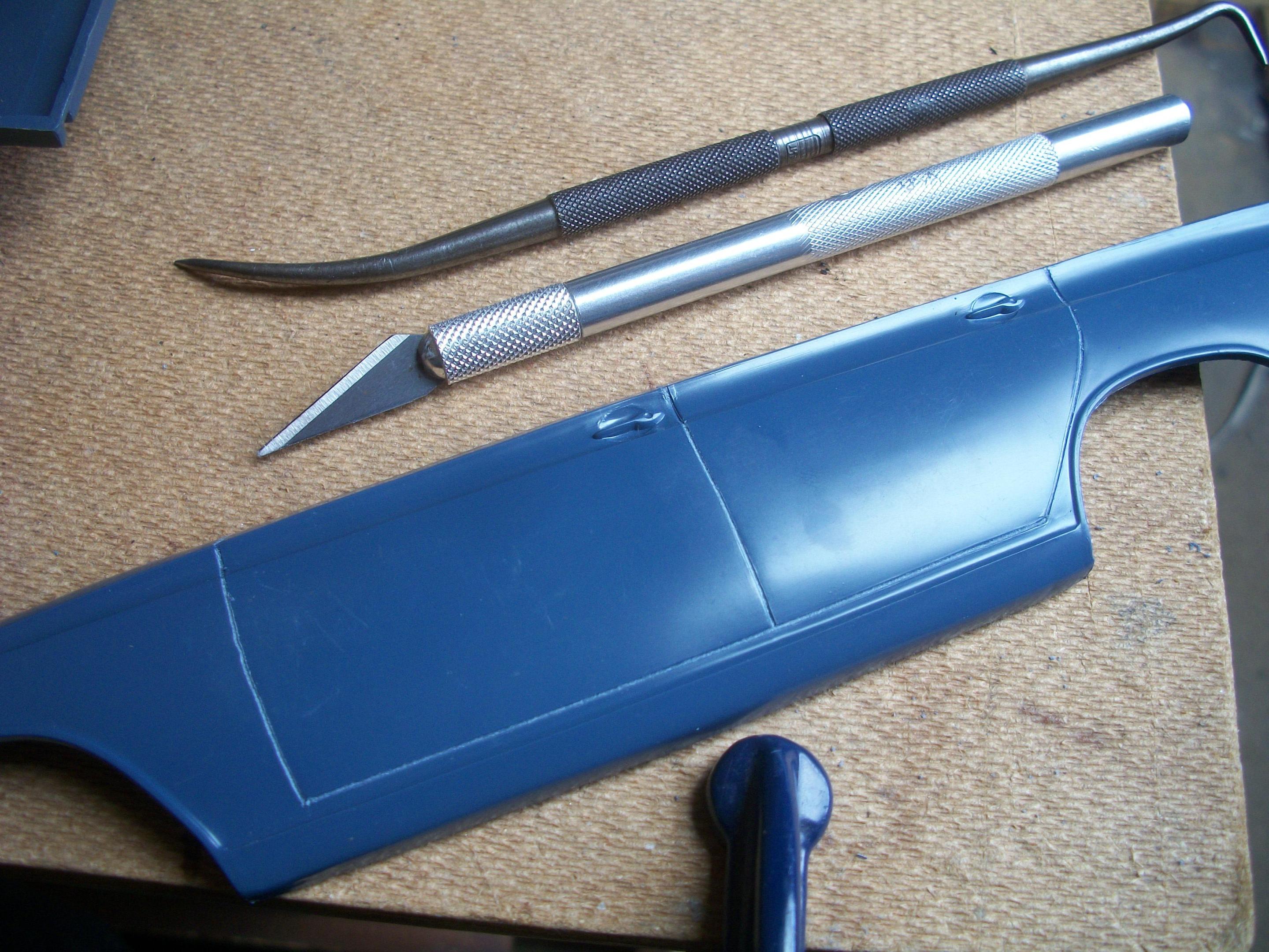

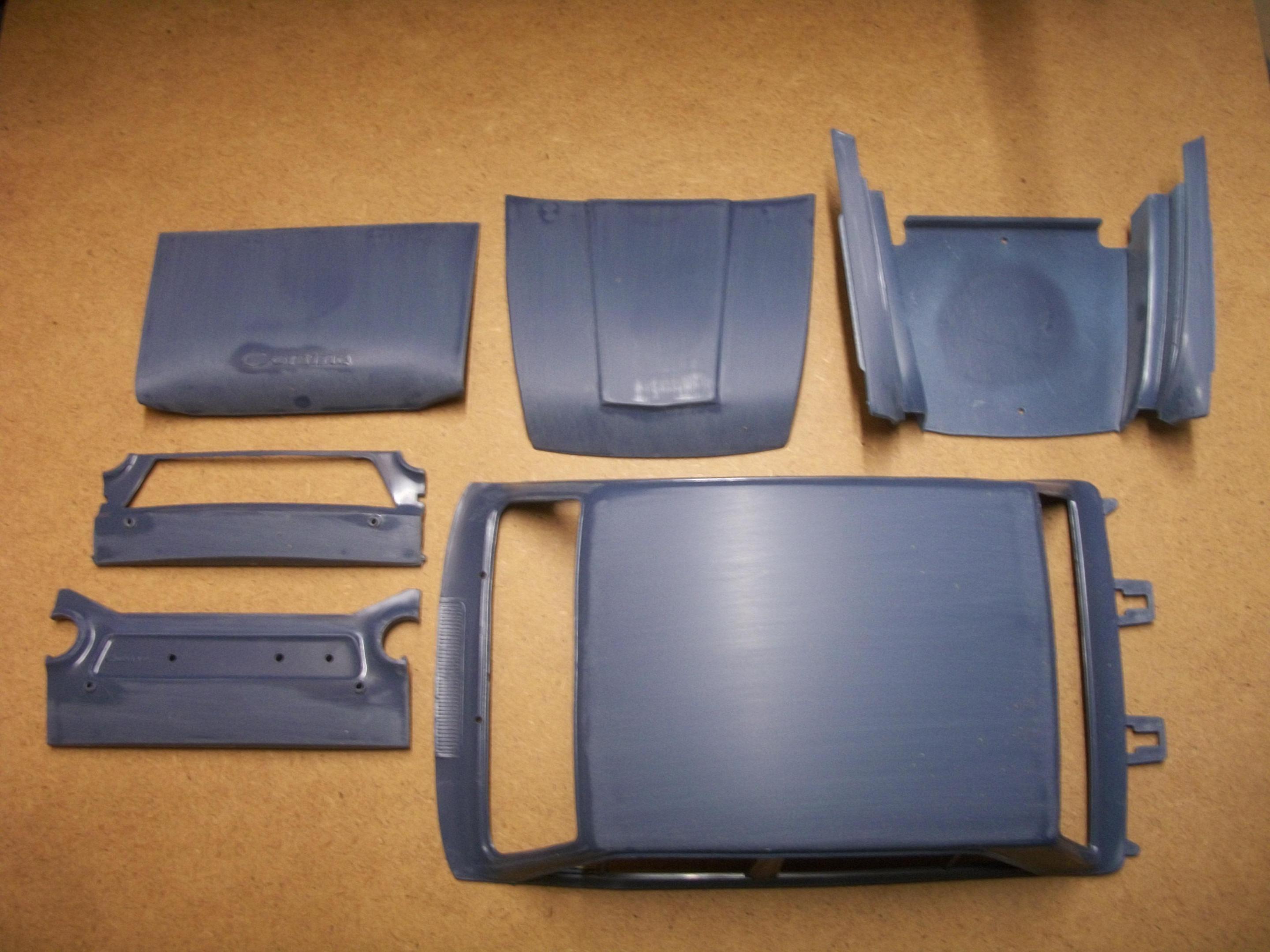

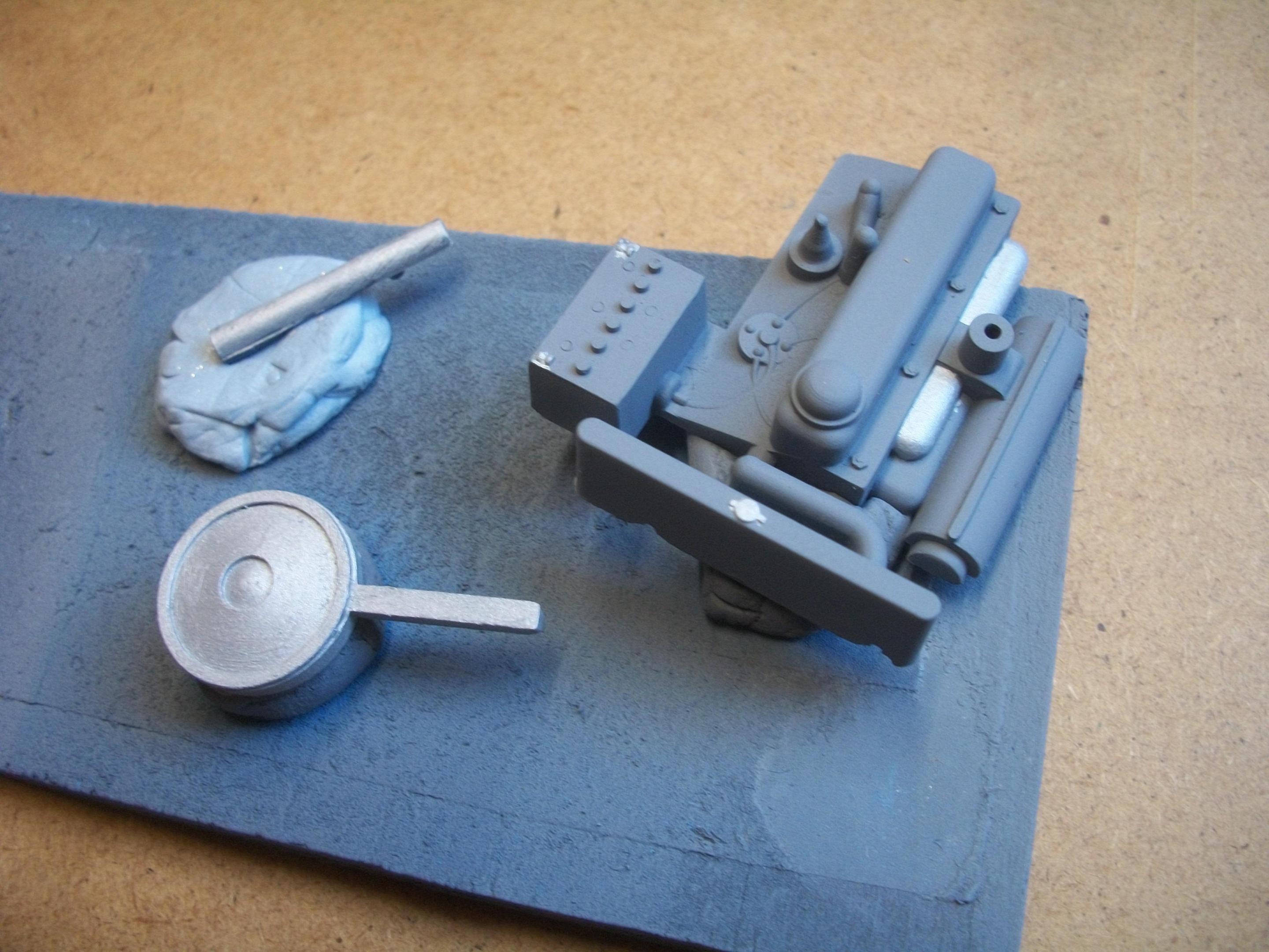

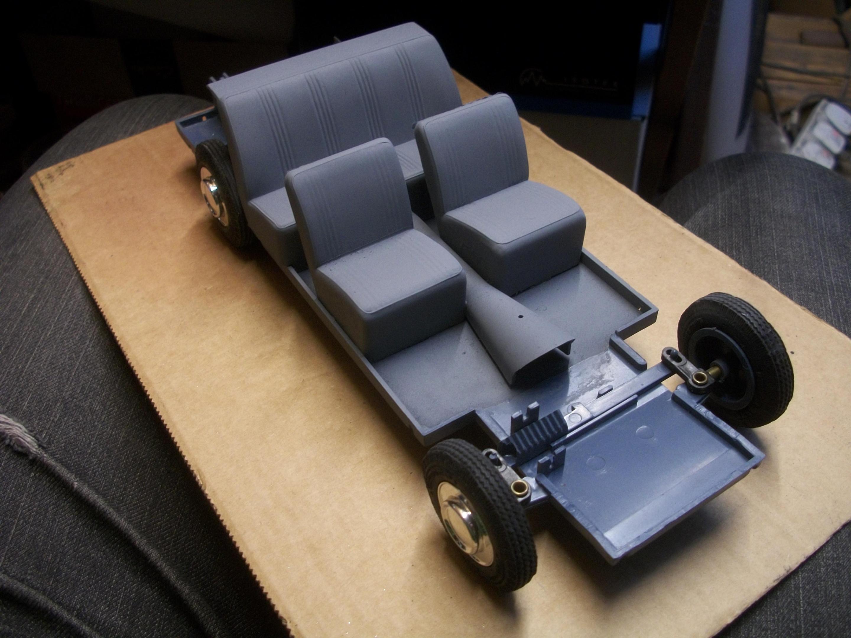

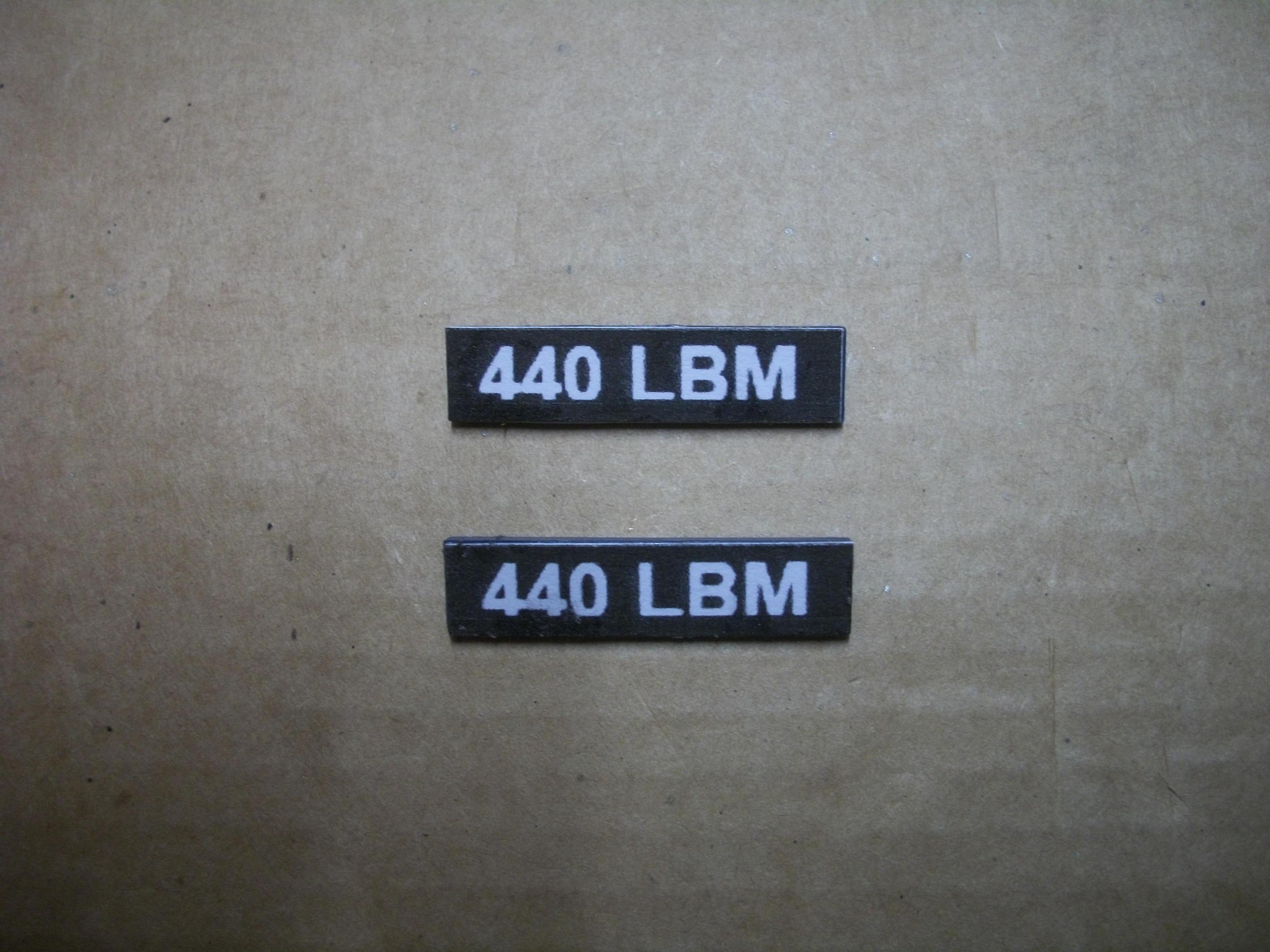

Anglia105E Posted June 21, 2023 Author Posted June 21, 2023 Here is the second batch of photos as the build continues . . . Halfords grey primer has been applied to some parts, and the panel lines have been scribed on the side panels. The registration number plates have been printed and mounted on the license plates, while the petrol filler cap has had the chrome plating removed, as this part needs to be the body colour. David 1

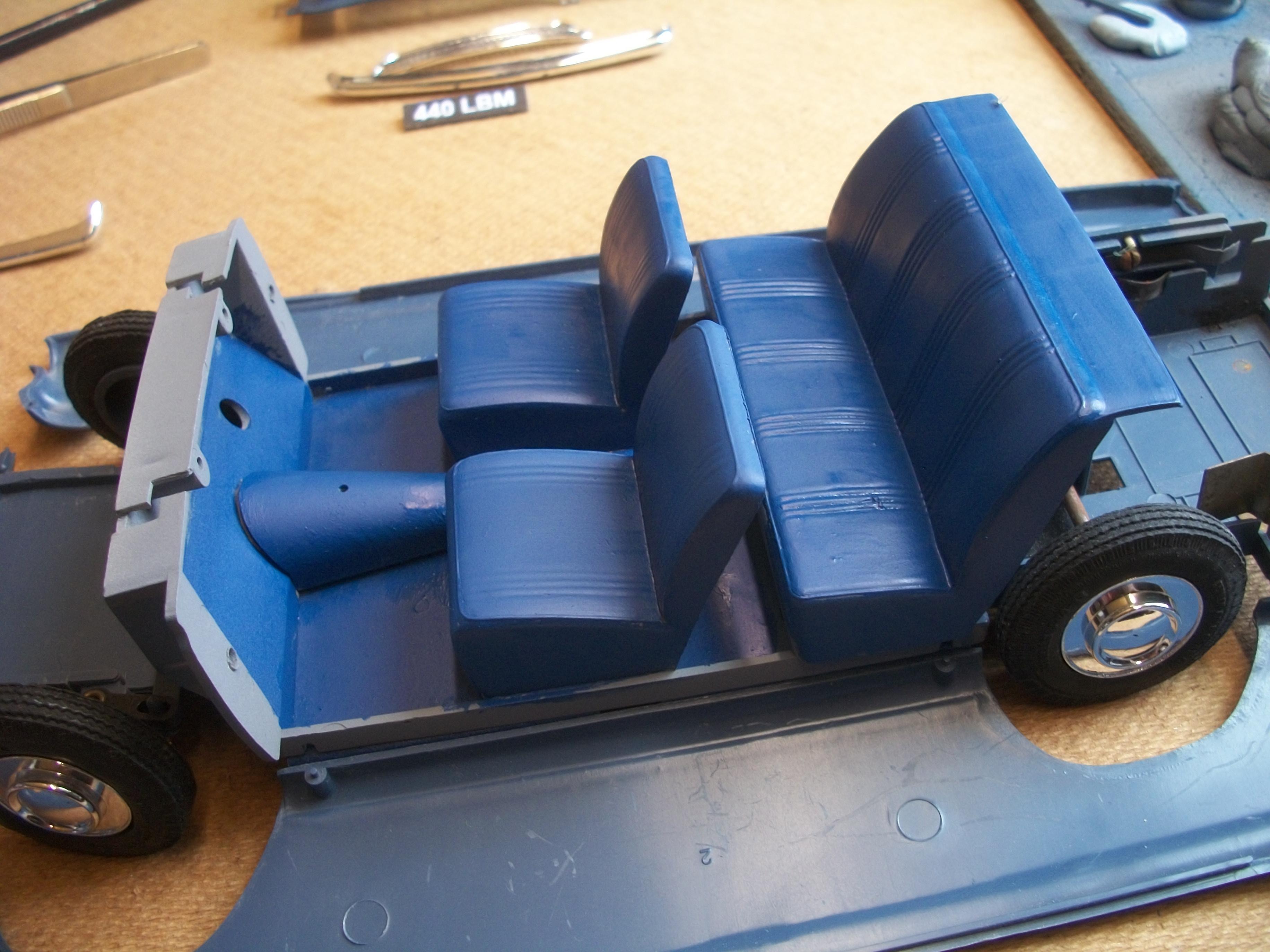

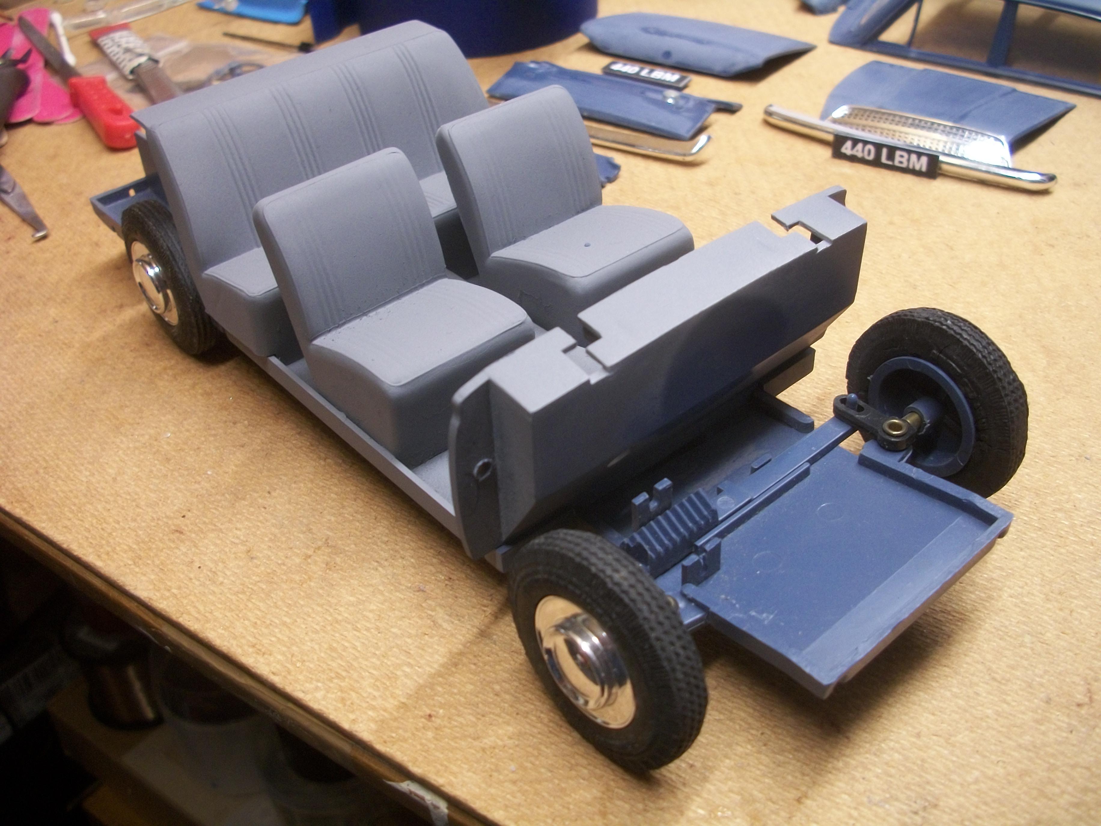

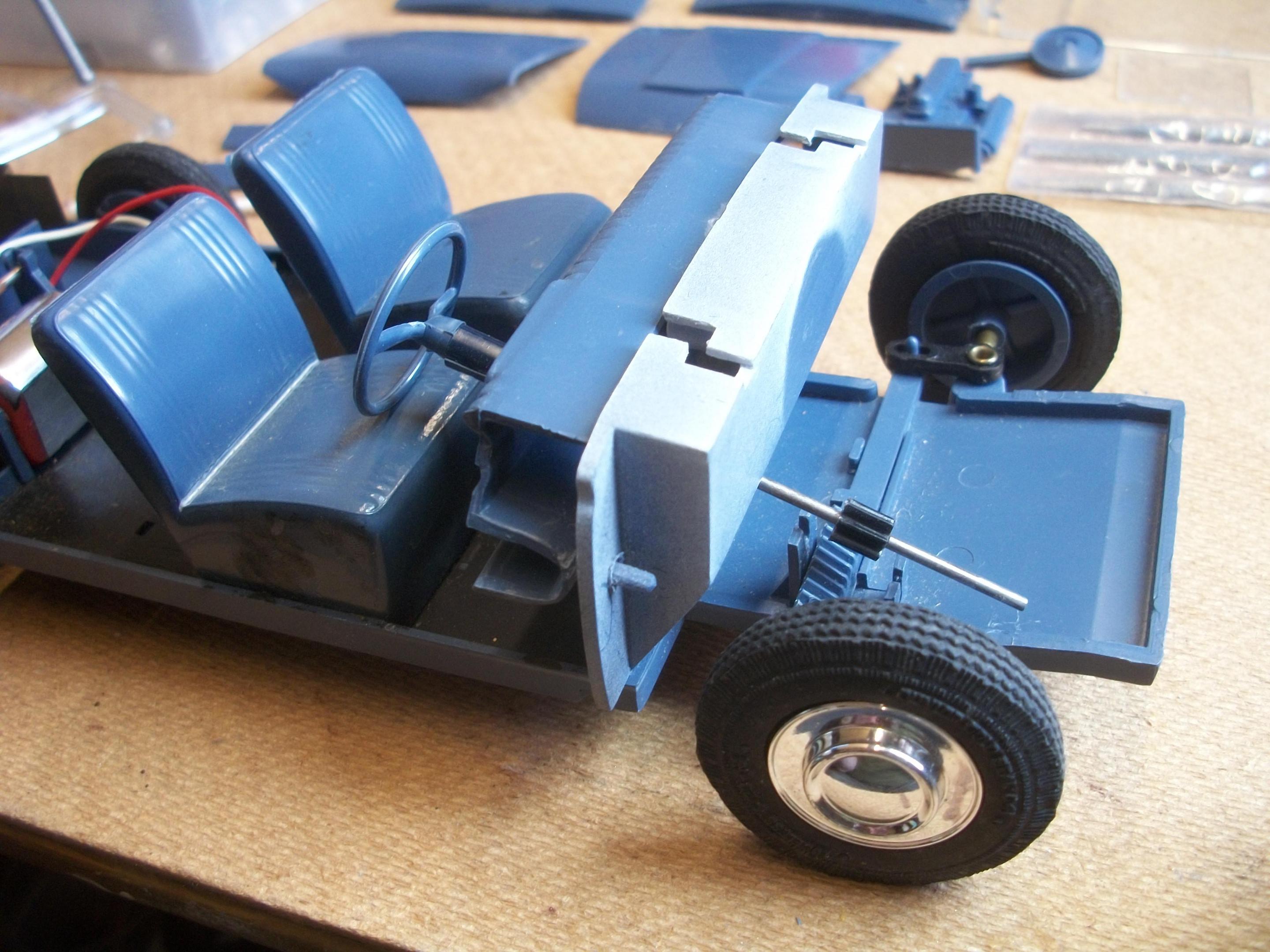

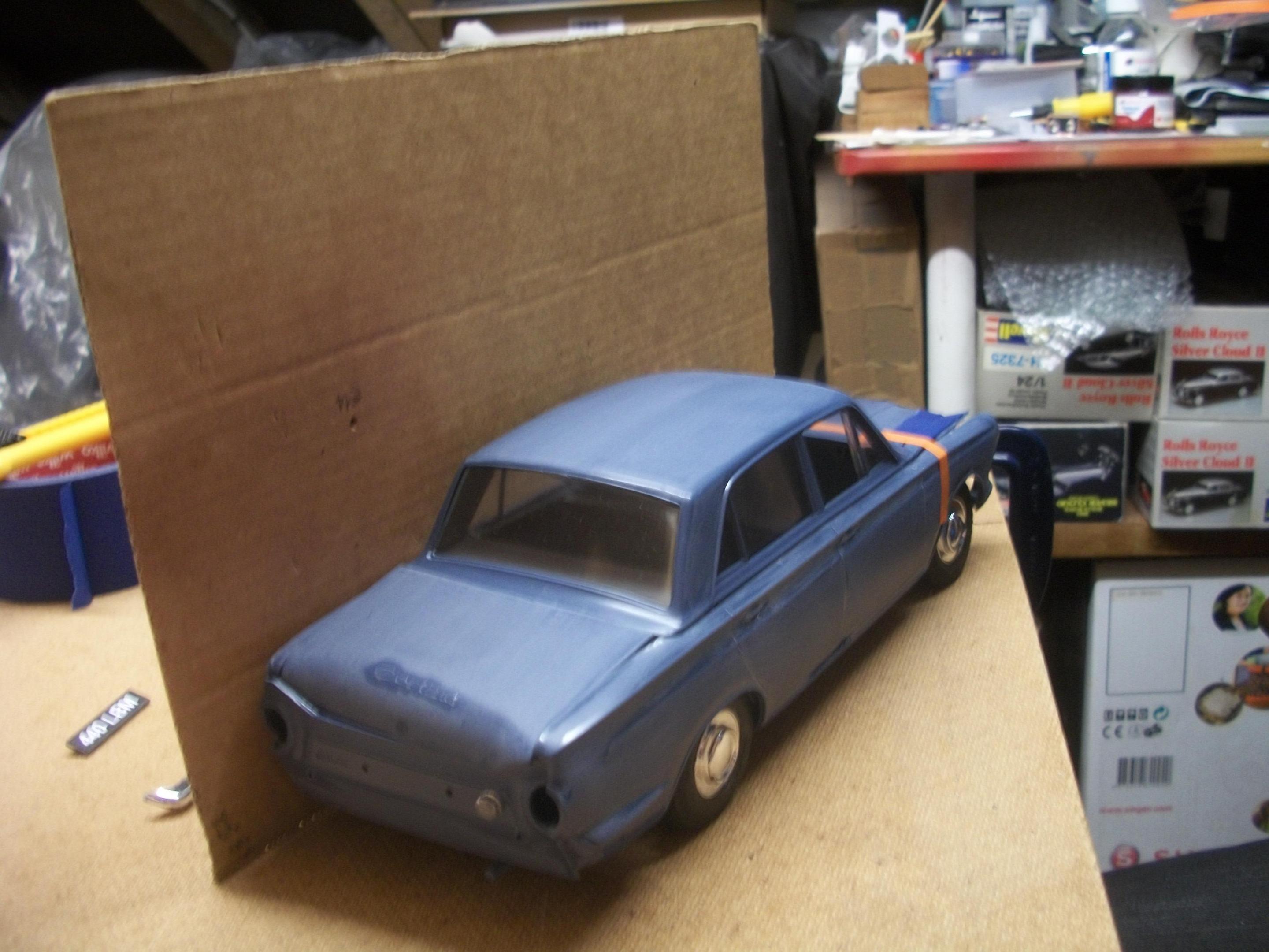

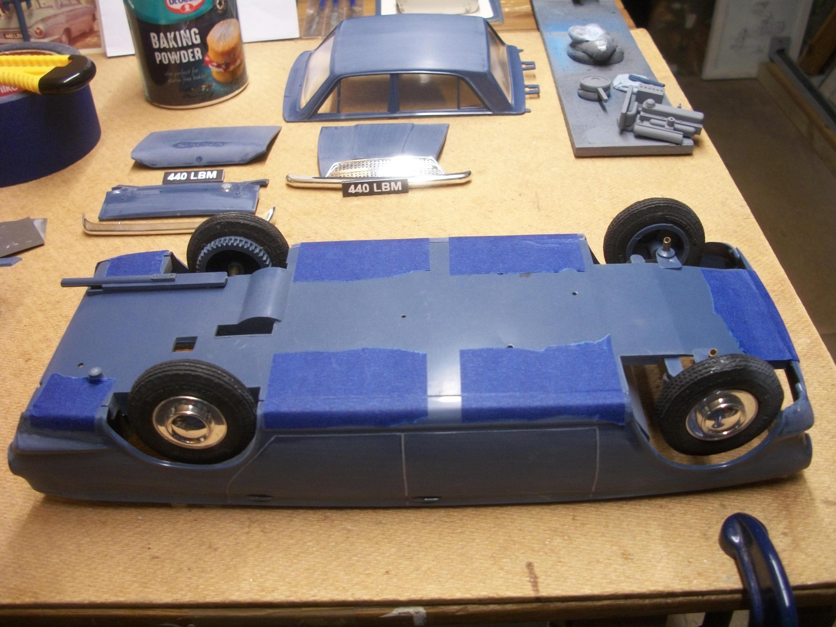

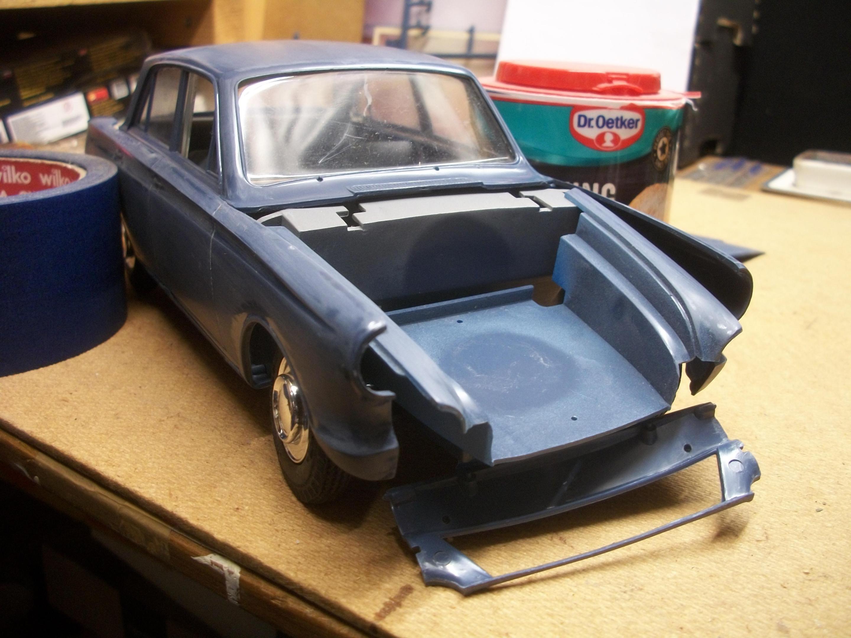

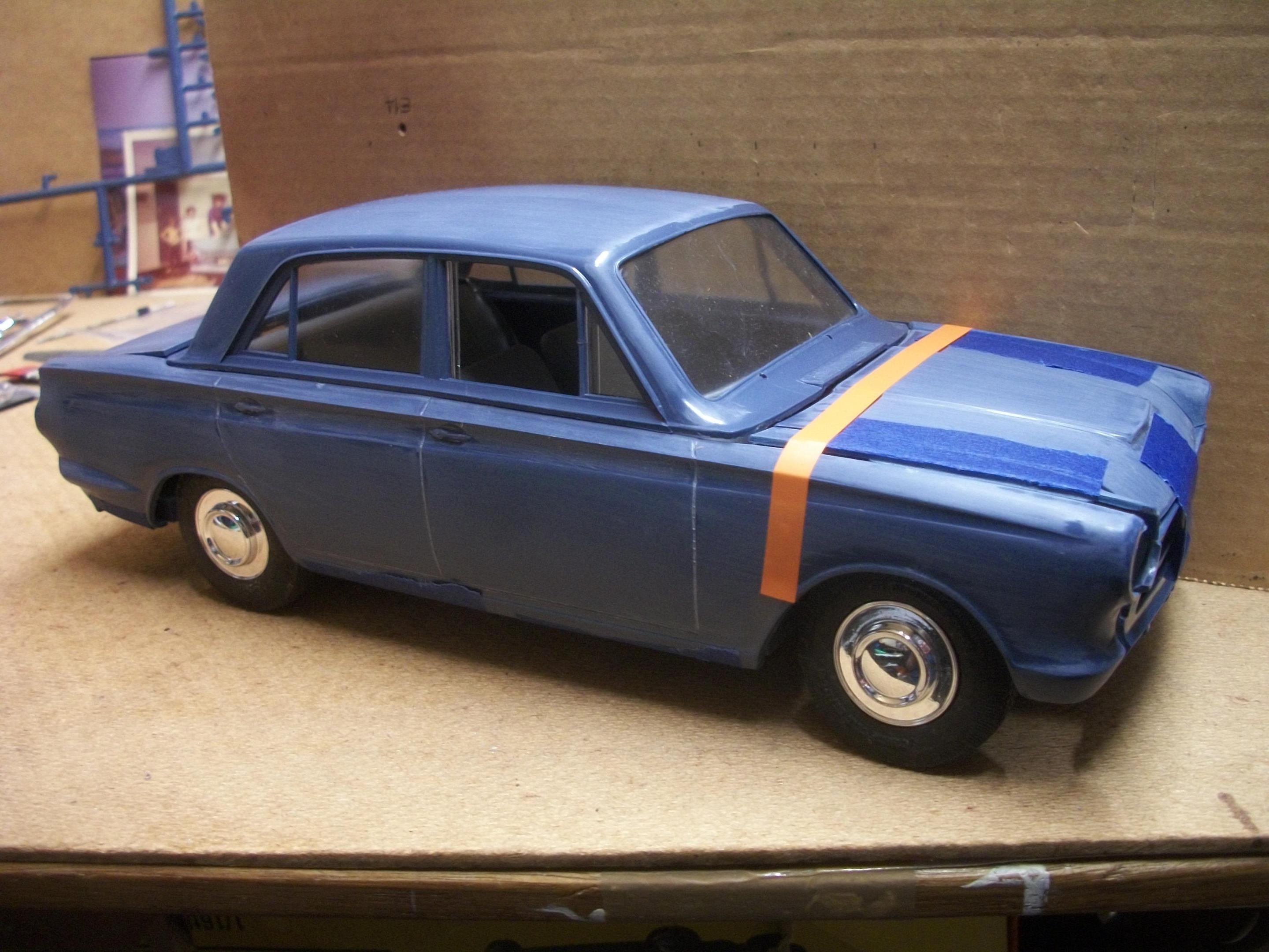

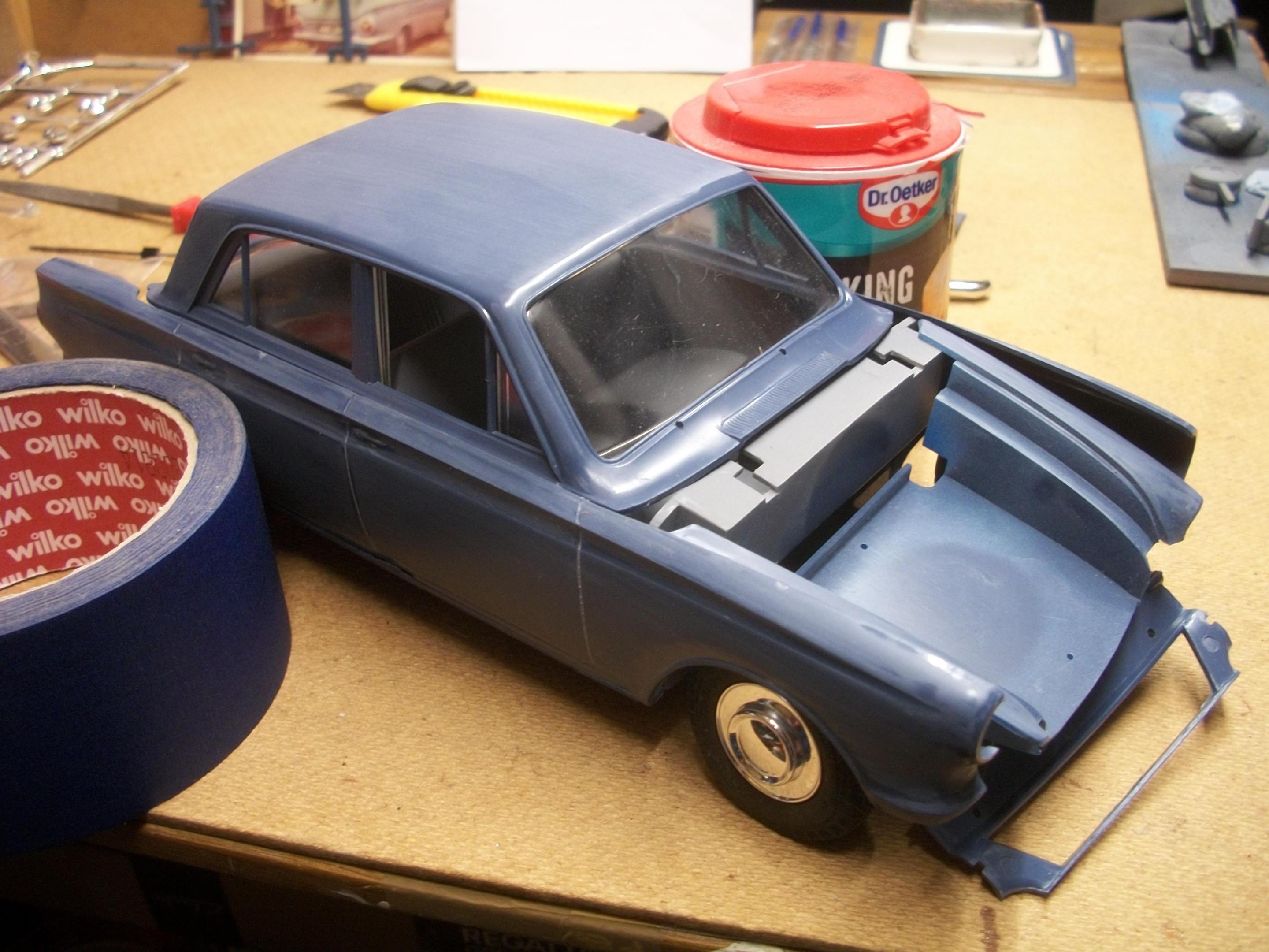

Anglia105E Posted June 21, 2023 Author Posted June 21, 2023 Here we have the third batch of photos, which is all about the mock up, and for me to understand how this kit fits together . . . David 1

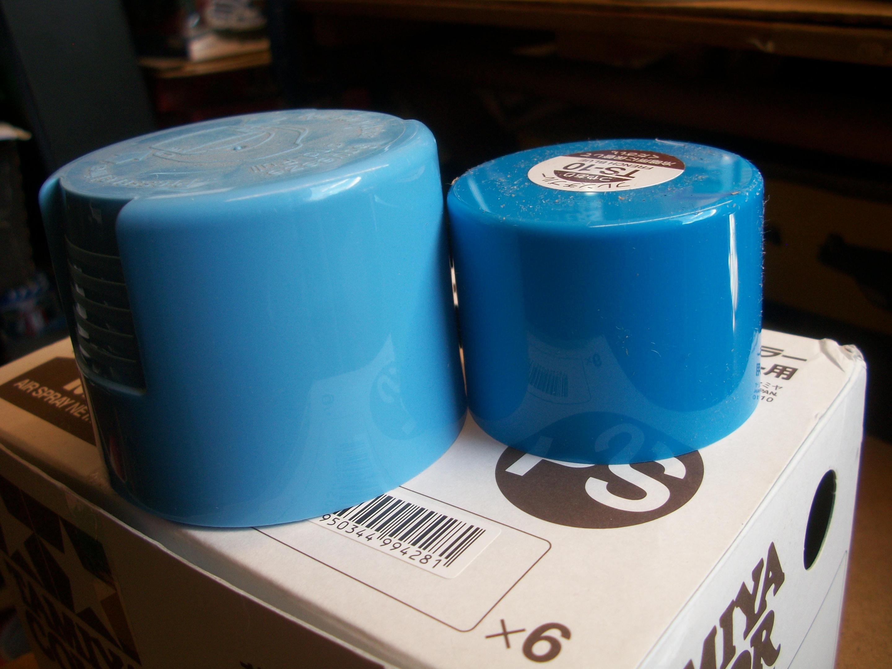

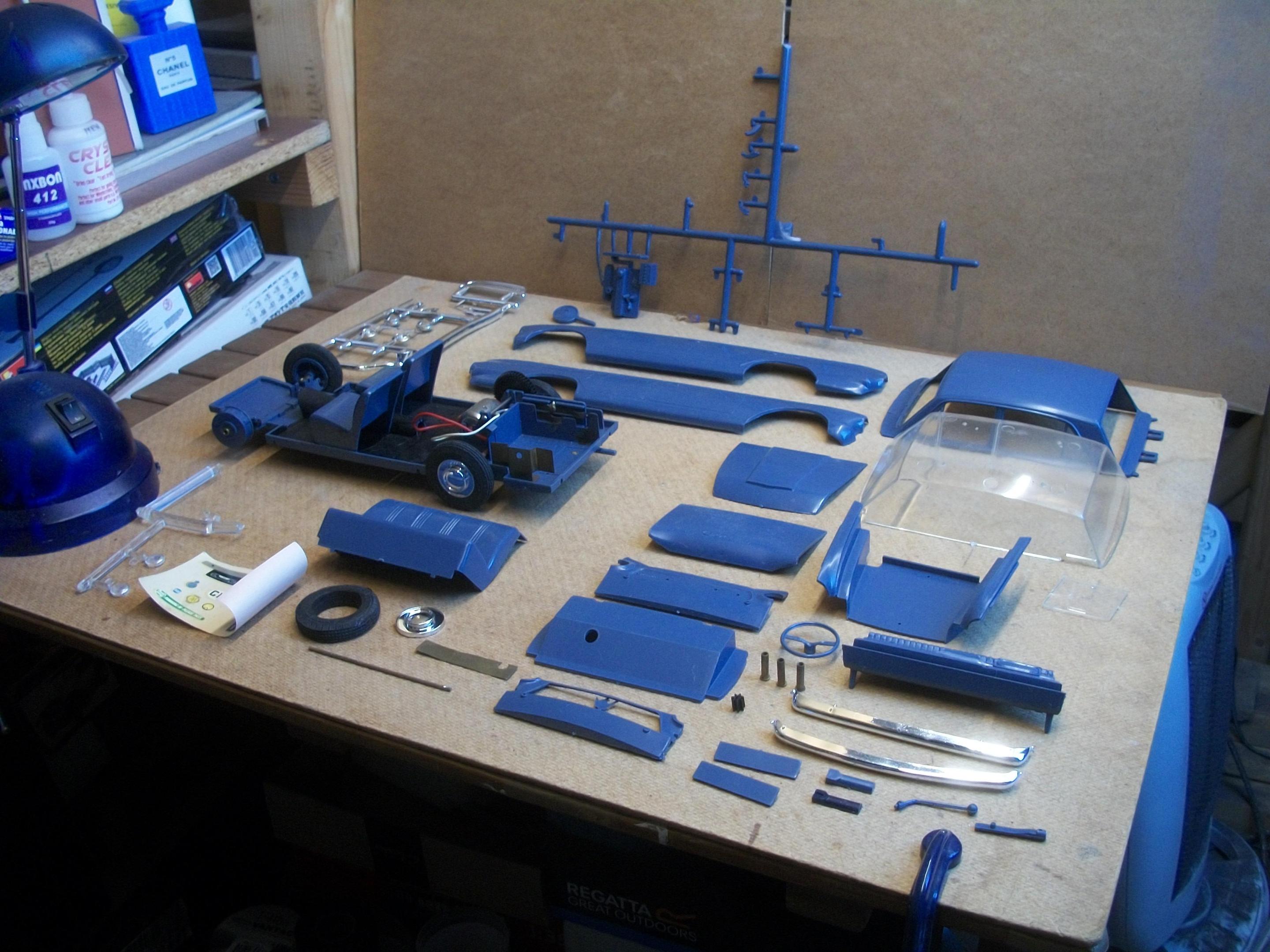

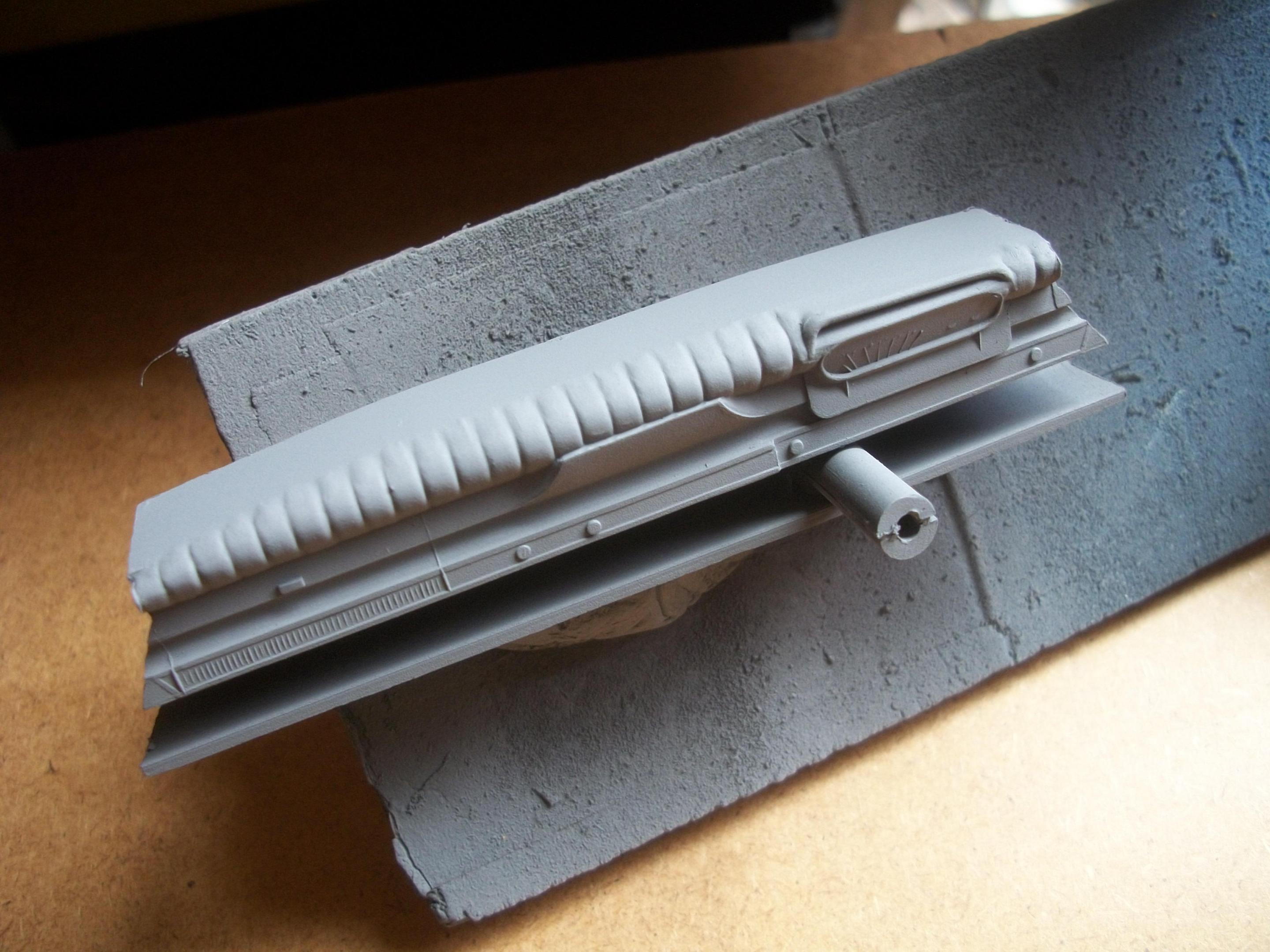

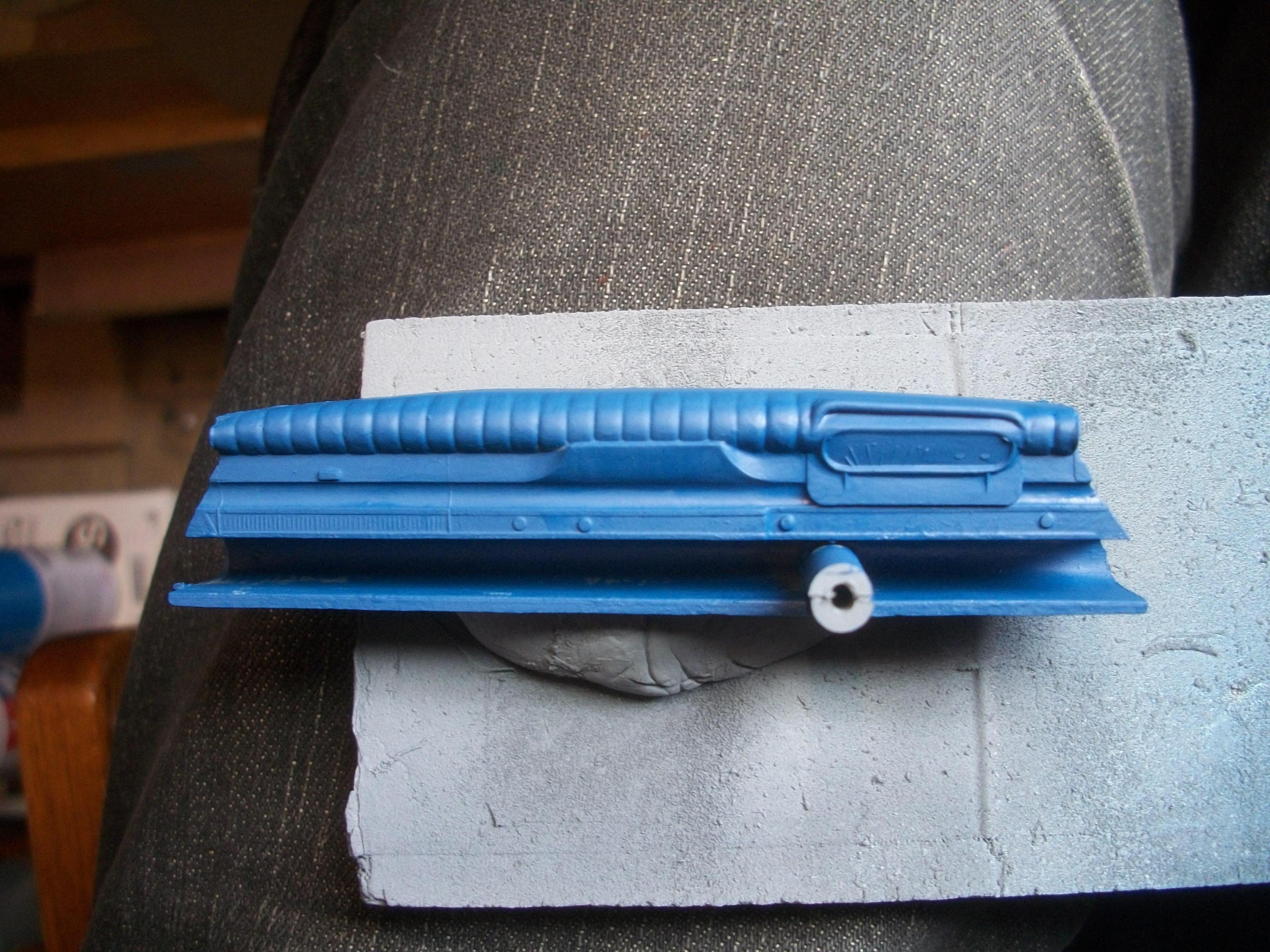

Anglia105E Posted June 21, 2023 Author Posted June 21, 2023 This is the fourth batch of WIP photos, that shows the difference in colour between the Rust-oleum Spa Blue on the left, and the Tamiya TS-10 French Blue on the right . . . The French Blue is very close to the actual color that I remember for my Dad's car, albeit 53 years ago now ! The chosen paint colour for the interior upholstery is Vallejo Prussian Blue acrylic, with some Humbrol Silver 11 enamel for the ancillary engine parts, and Humbrol Matt Black 33 enamel for the engine, battery and radiator. David 2

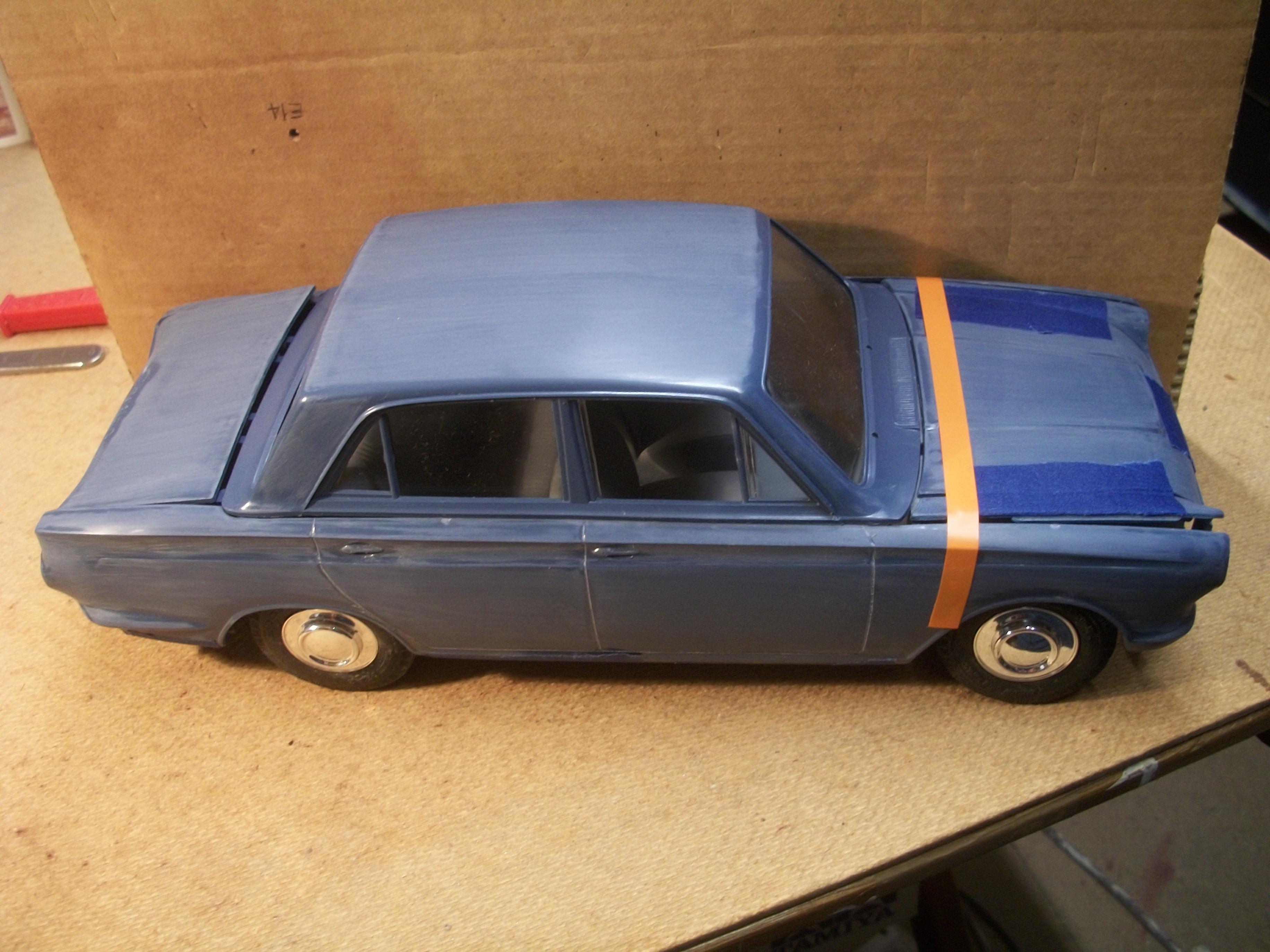

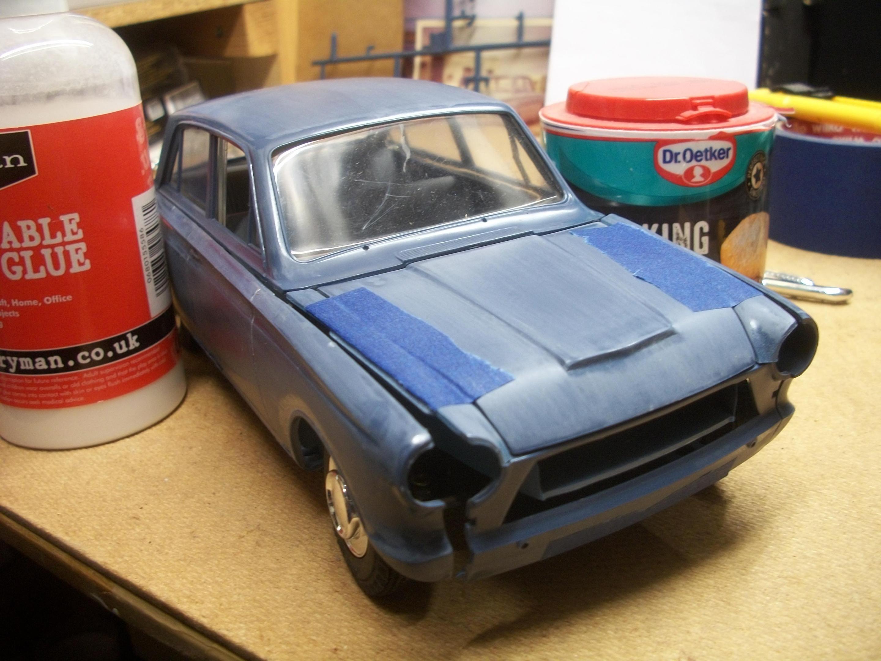

mrm Posted June 23, 2023 Posted June 23, 2023 This is something different on here for sure. And very cool to see. Few things puzzle me in your comments and maybe I am not understanding/missing something. First, what is the problem with assembling the body and making it one whole part, just like in any other kit. And if that is your intention, why would that create any issues with painting it? The other part involves the paints you are contemplating using. I would take Tamiya paint over Rust-Oleum any given day, any time. The only reason I would ever use Rust-Oleum paint is if it gives me a given color readily available. It seems you are going with the Tamiya color, as you say it suits your better. Than why in the blue heavens would you not go with Tamiya Primer. The Tamiya grey primer comes second to none in the hobby. It is amazing stuff, which especially in your project size, you can shoot straight from the can with amazing results. Most of the time it would hold up to most automotive paint, but that is irrelevant, as you are using Tamiya paint. Now having said that, I am talking about their grey primer, not the "fine" white one, which I hate with a passion. Anyway, great project and a very cool back story. I wish I could build a model of the car my dad thought me no and I drove on the day I got my license. But nobody makes a kit of an Opel Ascona.
Anglia105E Posted June 23, 2023 Author Posted June 23, 2023 33 minutes ago, mrm said: This is something different on here for sure. And very cool to see. Few things puzzle me in your comments and maybe I am not understanding/missing something. First, what is the problem with assembling the body and making it one whole part, just like in any other kit. And if that is your intention, why would that create any issues with painting it? The other part involves the paints you are contemplating using. I would take Tamiya paint over Rust-Oleum any given day, any time. The only reason I would ever use Rust-Oleum paint is if it gives me a given color readily available. It seems you are going with the Tamiya color, as you say it suits your better. Than why in the blue heavens would you not go with Tamiya Primer. The Tamiya grey primer comes second to none in the hobby. It is amazing stuff, which especially in your project size, you can shoot straight from the can with amazing results. Most of the time it would hold up to most automotive paint, but that is irrelevant, as you are using Tamiya paint. Now having said that, I am talking about their grey primer, not the "fine" white one, which I hate with a passion. Anyway, great project and a very cool back story. I wish I could build a model of the car my dad thought me no and I drove on the day I got my license. But nobody makes a kit of an Opel Ascona. Thank you Michael for your comments, and also your questions . . . In order to assemble the body, the two side panels have to be glued to the edges of the floor and chassis assembly, then the front panel and engine bay have to be glued to the side panels . . . The engine bay includes the front outer wings, and then the roof that includes the window frames must be glued in place. Only this way can you line everything up correctly and squarely. At that point, the gaps where the body panels join together have to be filled and sanded before painting can begin. This would mean that the window glass part would not have been glued inside the roof. As regards the primer Michael, I was only going to use Halfords grey primer with cellulose automotive paint, and only Rust-oleum primer for Rust-oleum paint, so in this case I am using the Tamiya Fine Surface Primer White, which a professional model builder who lives locally tells me is the best primer in the world. The topcoats will be Tamiya TS-10 French Blue, so I am keeping to paints from the same brand for both primer and topcoat. How about this kit for the Opel Ascona https://www.scalemates.com/kits/belkits-bel-020-opel-ascona-400--1170892 David

mrm Posted June 23, 2023 Posted June 23, 2023 3 hours ago, Anglia105E said: Thank you Michael for your comments, and also your questions . . . In order to assemble the body, the two side panels have to be glued to the edges of the floor and chassis assembly, then the front panel and engine bay have to be glued to the side panels . . . The engine bay includes the front outer wings, and then the roof that includes the window frames must be glued in place. Only this way can you line everything up correctly and squarely. At that point, the gaps where the body panels join together have to be filled and sanded before painting can begin. This would mean that the window glass part would not have been glued inside the roof. As regards the primer Michael, I was only going to use Halfords grey primer with cellulose automotive paint, and only Rust-oleum primer for Rust-oleum paint, so in this case I am using the Tamiya Fine Surface Primer White, which a professional model builder who lives locally tells me is the best primer in the world. The topcoats will be Tamiya TS-10 French Blue, so I am keeping to paints from the same brand for both primer and topcoat. How about this kit for the Opel Ascona https://www.scalemates.com/kits/belkits-bel-020-opel-ascona-400--1170892 David In your particular case, you would be doing yourself a huge favor by using the grey Tamiya primer. Trust me on that one. Dries completely different, hardens differently, sand differently and seals completely differently. If I was using yellow Tamiya paint, then I would spray a thin coat of white primer ON TOP of the grey one, just to make the color pop. But in your case it is unnecessary. Thank you for the Ascona recommendation. Never even heard of any kit of any Ascona ever been made. Ours was a four door and I believe the next generation after the one you sent a link to, so no go. But still, thank you for looking it up. And "a professional model builder told me..." always makes me chuckle. A very well known "professional model builder", who made a small fortune painting model bodies for few different crowds, once publicly claimed that you can't use 2K clear on plastic models or over acrilics because it would eat them. And everyone who has ever used 2K clear knows that's not true. I spend 5 years making a living building replicas of rich people's 1:1 exotic car collections. I still could never bring myself saying that I was a professional model builder without laughing. No. I just found a way to make money from my hobby for a while. And then I got burned out and didn't want to see a model for quite a while. But anyway... I understand the challenges this model poses and now I am even more curious to see how it will turn out. Sounds like a lot of precision masking would need to be involved.

Anglia105E Posted June 23, 2023 Author Posted June 23, 2023 41 minutes ago, mrm said: In your particular case, you would be doing yourself a huge favor by using the grey Tamiya primer. Trust me on that one. Dries completely different, hardens differently, sand differently and seals completely differently. If I was using yellow Tamiya paint, then I would spray a thin coat of white primer ON TOP of the grey one, just to make the color pop. But in your case it is unnecessary. Thank you for the Ascona recommendation. Never even heard of any kit of any Ascona ever been made. Ours was a four door and I believe the next generation after the one you sent a link to, so no go. But still, thank you for looking it up. And "a professional model builder told me..." always makes me chuckle. A very well known "professional model builder", who made a small fortune painting model bodies for few different crowds, once publicly claimed that you can't use 2K clear on plastic models or over acrilics because it would eat them. And everyone who has ever used 2K clear knows that's not true. I spend 5 years making a living building replicas of rich people's 1:1 exotic car collections. I still could never bring myself saying that I was a professional model builder without laughing. No. I just found a way to make money from my hobby for a while. And then I got burned out and didn't want to see a model for quite a while. But anyway... I understand the challenges this model poses and now I am even more curious to see how it will turn out. Sounds like a lot of precision masking would need to be involved. I shall give the Tamiya grey primer some thought and consideration, based upon your ' professional model builder ' advice !!! I was led to believe that 2K paint products are dangerous, and require wearing a mask that has an oxygen supply ? You are right about the masking Michael, because I shall need to glue the window glass in place, inside the roof part, and then carefully mask off the windows while I am spraying on the Tamiya primer and top coat. The wheels and tyres will need to be covered with paper, particularly at the front end while paint is applied. Sounds like you have enjoyed an interesting working life making money from your hobby, which is something I could not do successfully. David

dodgefever Posted June 24, 2023 Posted June 24, 2023 Can you not assemble the body around the bulkhead (using the chassis as a fixture if necessary), then fit the windows, dash and floorpan/interior after painting? That's the way I'd tackle it.
