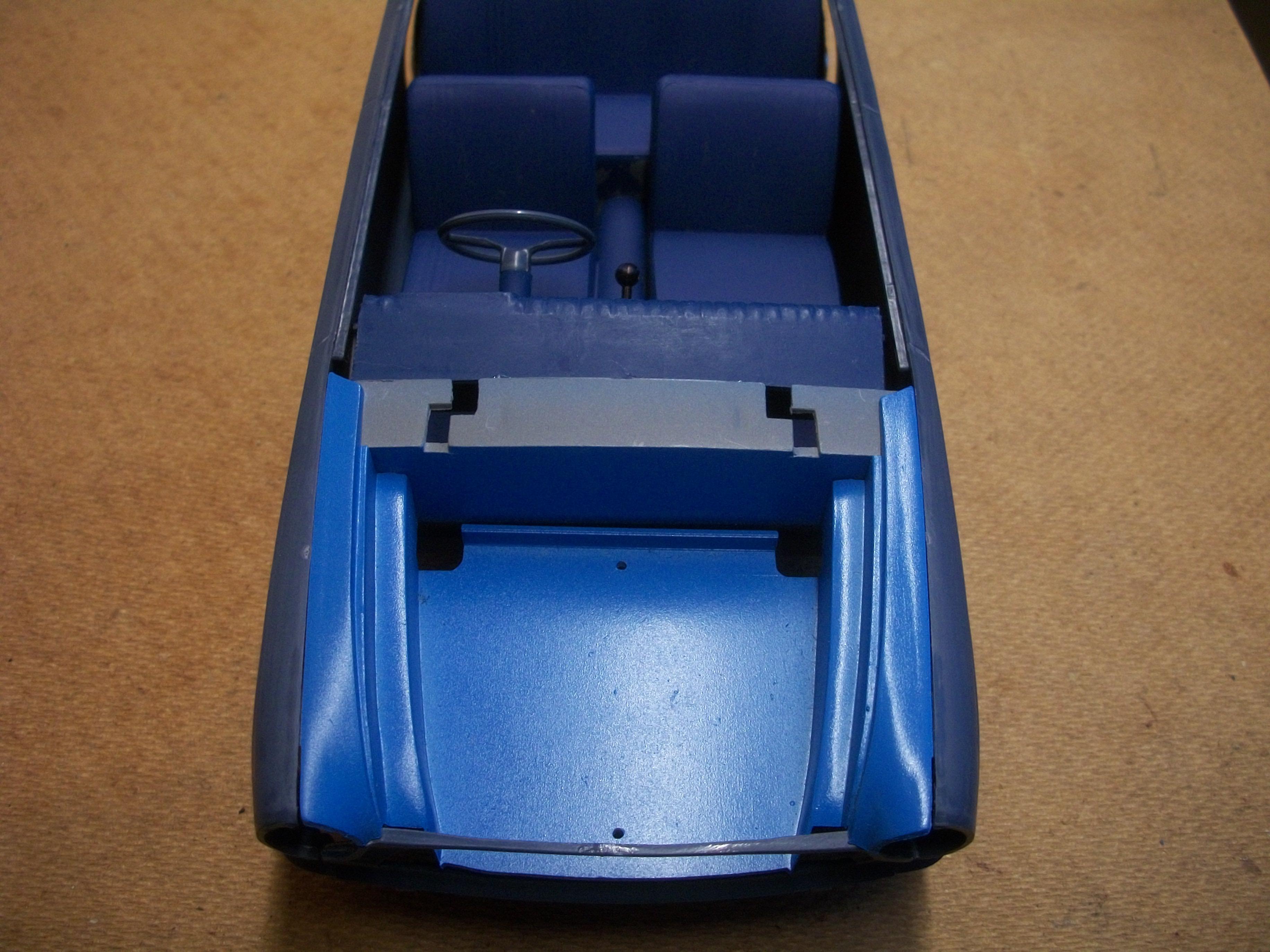

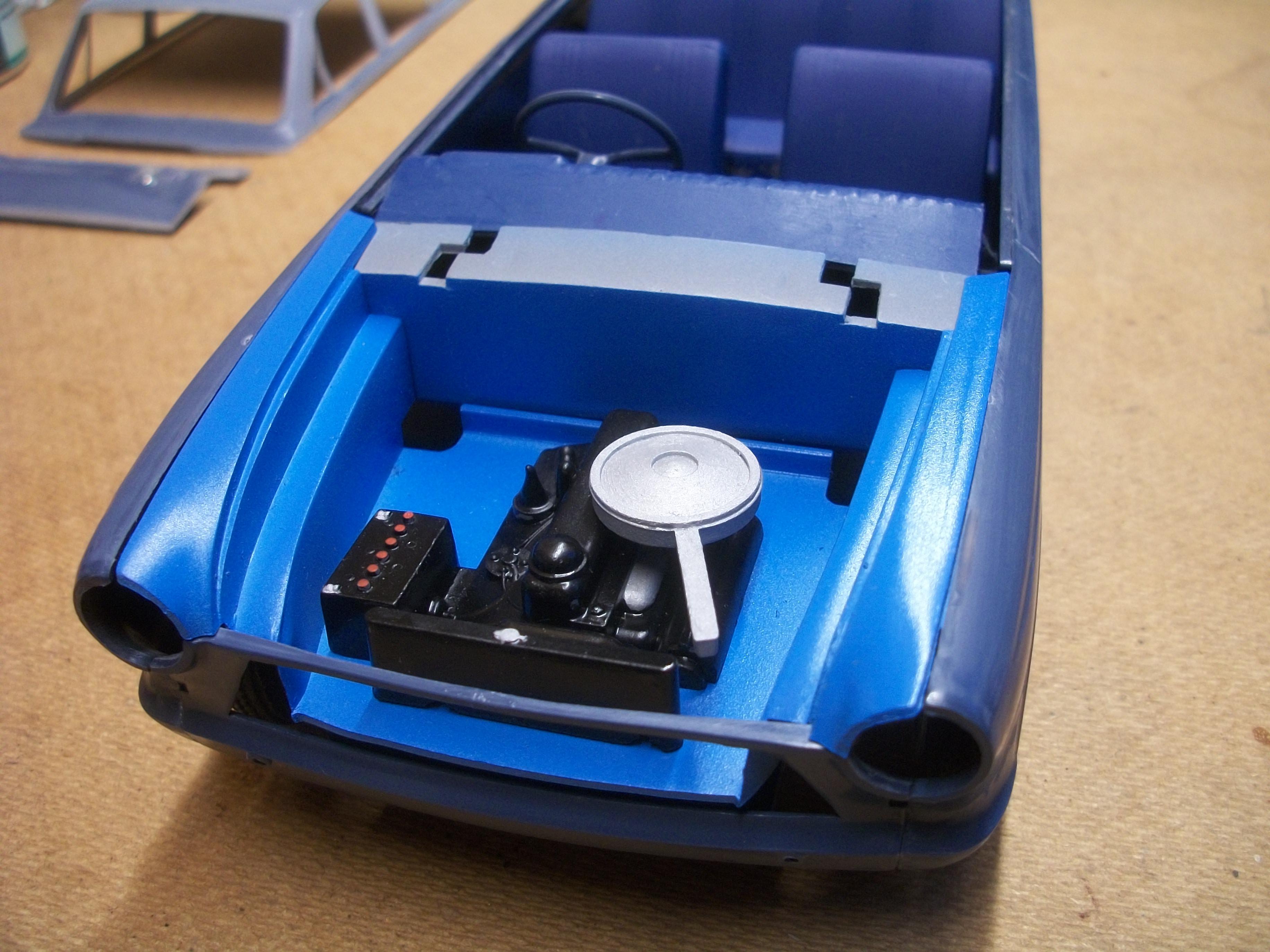

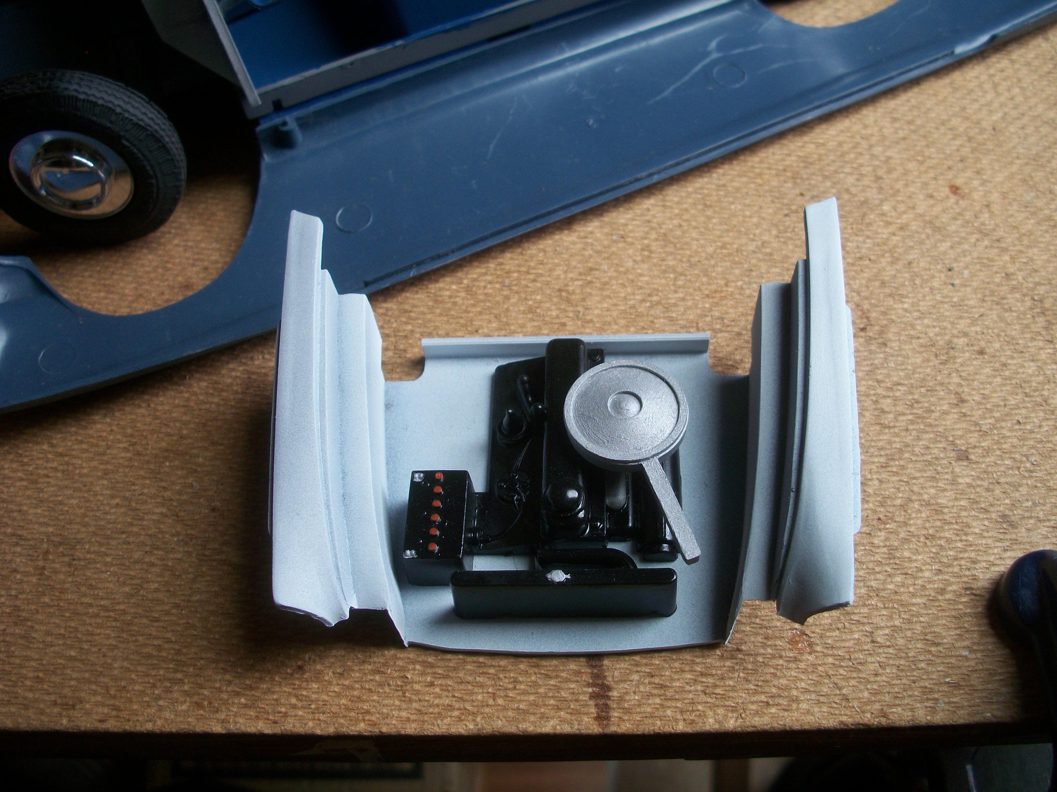

Anglia105E Posted June 24, 2023 Author Posted June 24, 2023 Over the past few days the interior of the Cortina has been painted, and also the dashboard. The paint colour is Vallejo Prussian Blue acrylic. Another mock up was necessary to see how the steering column assembles with the bulkhead and the dashboard. I placed the two side panels and the engine bay roughly where they need to be later. The front inner wings being part of the engine bay might be problematic, as they have to align cleanly with the outer wings of those large side panels that run the length of the car. Two coats of Tamiya TS-10 French Blue have been applied to both the engine bay / front wings and the bulkhead where it becomes part of the engine bay. The paint caps show the difference between the Rust-oleum Spa Blue and the Tamiya French Blue. David

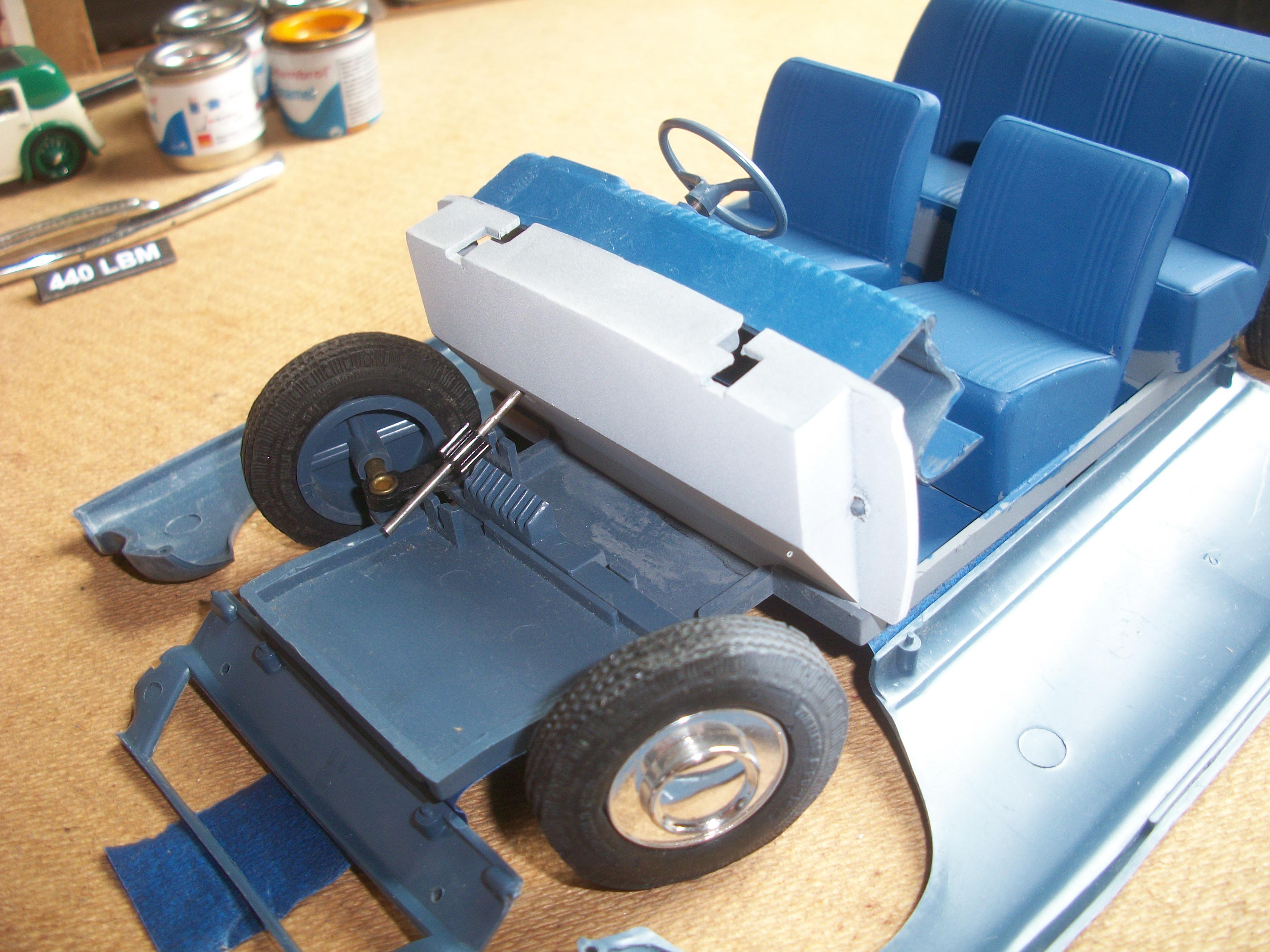

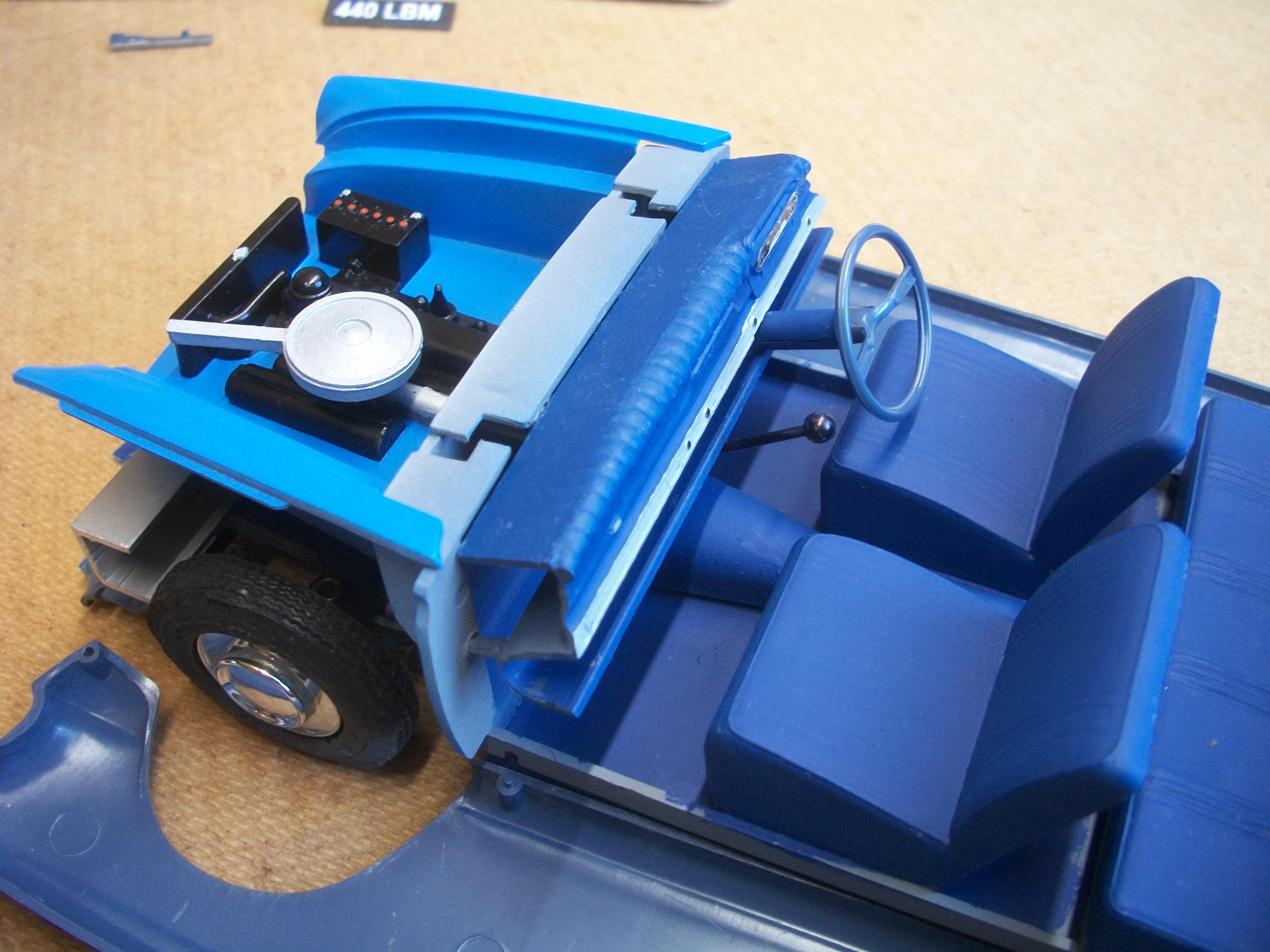

Anglia105E Posted June 27, 2023 Author Posted June 27, 2023 The steering column, dashboard, bulkhead and steering wheel have all been assembled as one unit, and no issues. I have discovered that the parts of the FROG kit fit together so well, that I would say they are as good as modern day Tamiya. Monday turned out to be a very productive day, and I made some really good progress. The front end assembly was giving me cause for concern, and I was fearing the worst. I wanted to follow the order of assembly as detailed in the Frog instructions, so I glued the large R.H. side panel in place, which was then followed by the front panel. This proved to be extremely difficult, so I decided to glue the L.H. side panel in place onto the chassis / floor pan, before tackling the front panel. Also, I decided to use super glue rather than styrene glue for the front panel, which turned out to be a wise decision, as I would never have done it otherwise. Using a lot of patience and ingenuity, I eventually achieved an excellent fit for the front panel. The next part to add was the engine bay and inner front wings, and this went in surprisingly well, and is not even held in place with glue. The rear panel also clipped in without glue, and the roof section clipped in place without glue. I added the engine part, again no glue required. The following day saw the rear panel glued in place between the rear wings, along with the exhaust tailpipe which was glued to the floor pan. Using some green PVC refuse sack, and some orange tissue paper the interior area was masked off, also the the wheels and tyres were masked off. Tamiya Fine Surface Primer White has been applied to all of the exterior panels of the car, which was two coats with five minutes between coats. Once the primer has dried over night for 24 hours, the Tamiya TS-10 French Blue will be applied over the white primer.  David Â

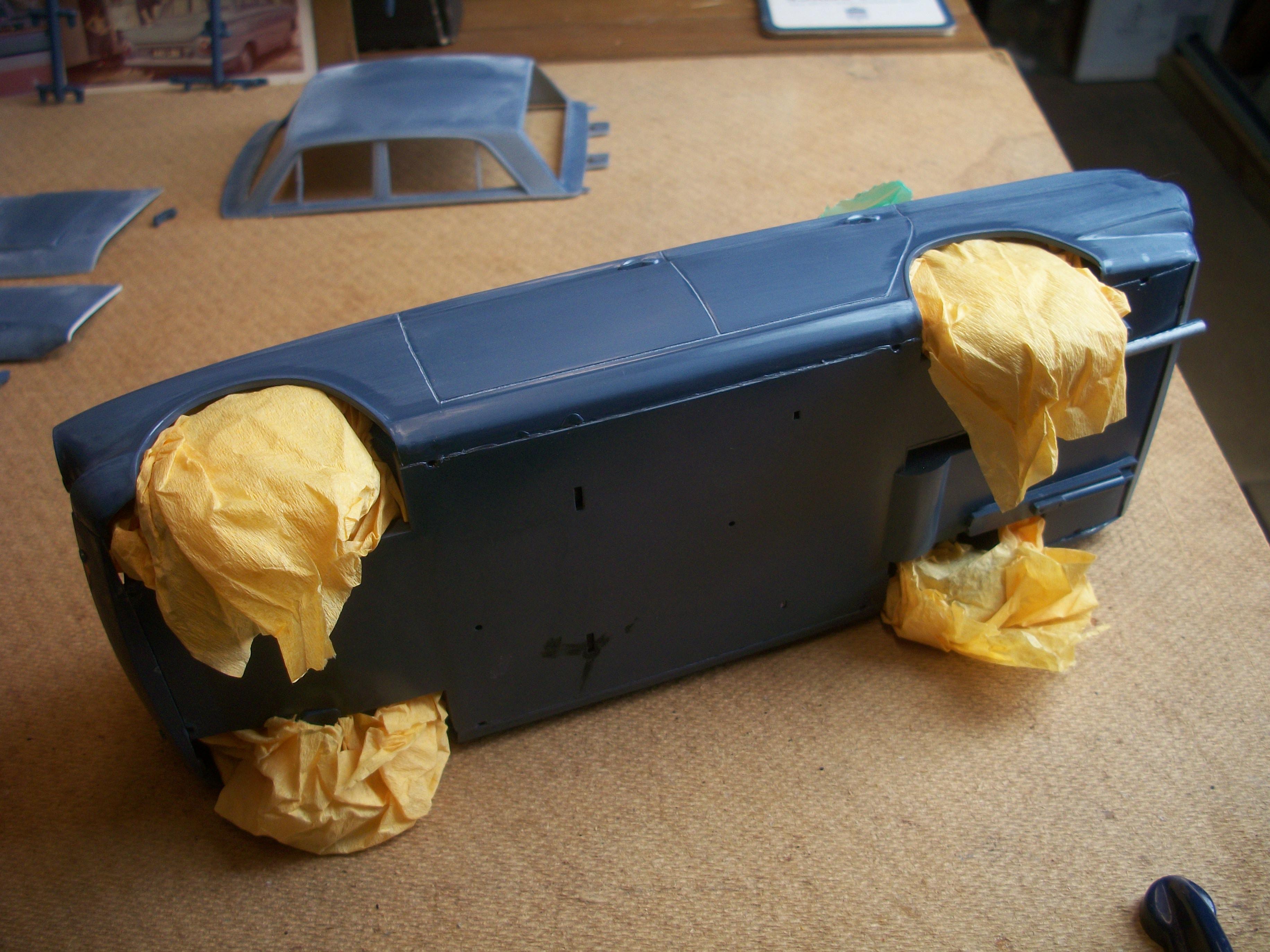

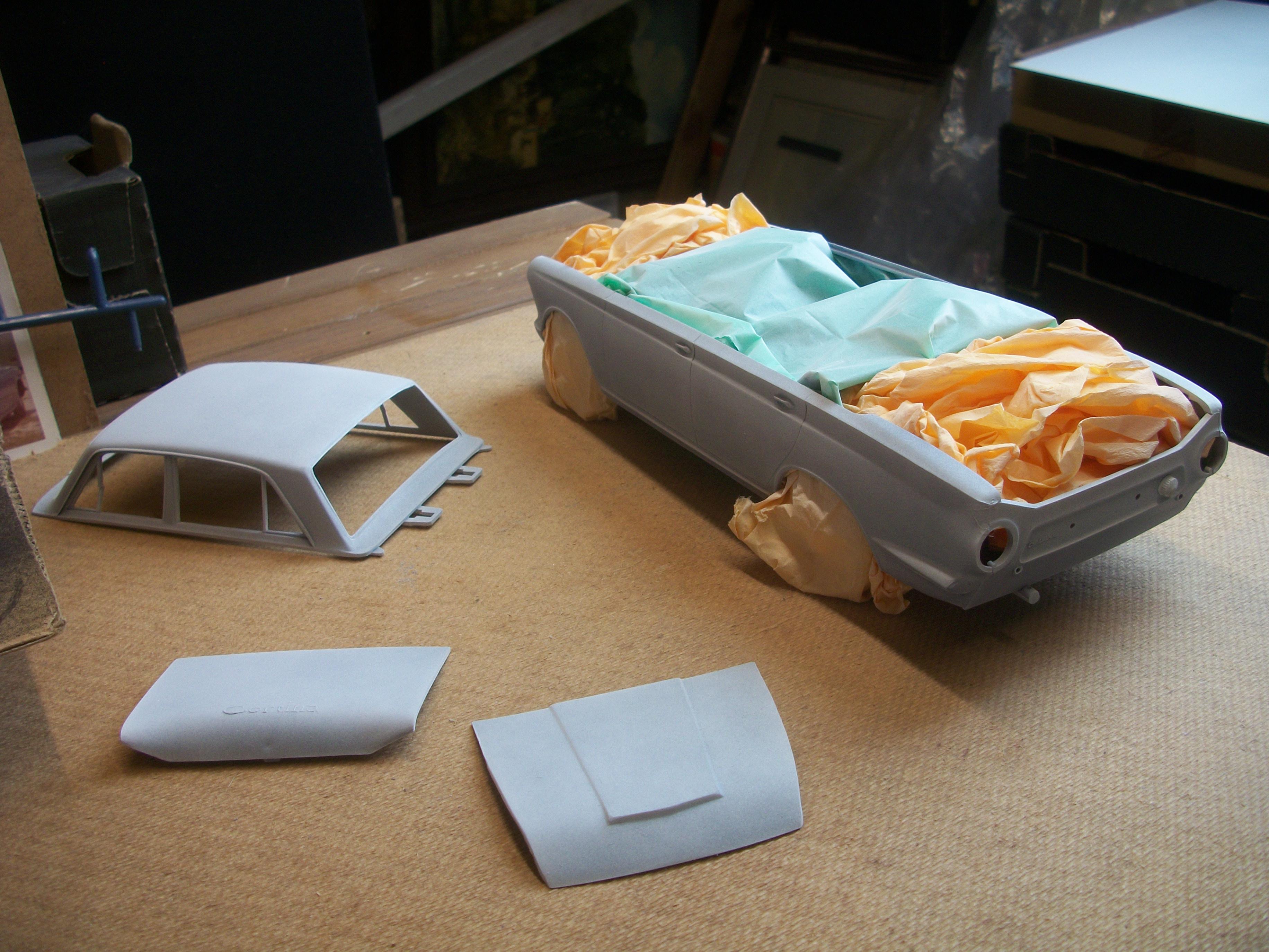

Anglia105E Posted June 29, 2023 Author Posted June 29, 2023 Having attempted, and failed, to print a 1:16 scale road tax disc for the windscreen (road fund license), I decided to cut out the one from the decal sheet and glue it on the inside of the screen, using Crystal Clear glue. These decals are 60 years old, so I didn't want to risk the water slide decal not working. My HP printer cannot print anything as small as a 4.7 mm diameter paper disc. All the external body parts have been given two coats of Tamiya TS-10 French Blue over white primer, and allowed to dry for 24 hours. Today I removed all of the masking material to reveal the paint surface. The following photos show the Cortina with the roof, bonnet and boot lid resting in place, so nothing glued yet. I am generally happy with the result, and I do like the colour. There is quite a lot of work to do yet, which is mostly chrome work and further detailing, including bumpers, number plates, lights, wipers, bonnet and boot hinges and window glass. The sliding driver's door window will be in the lowered position. David
