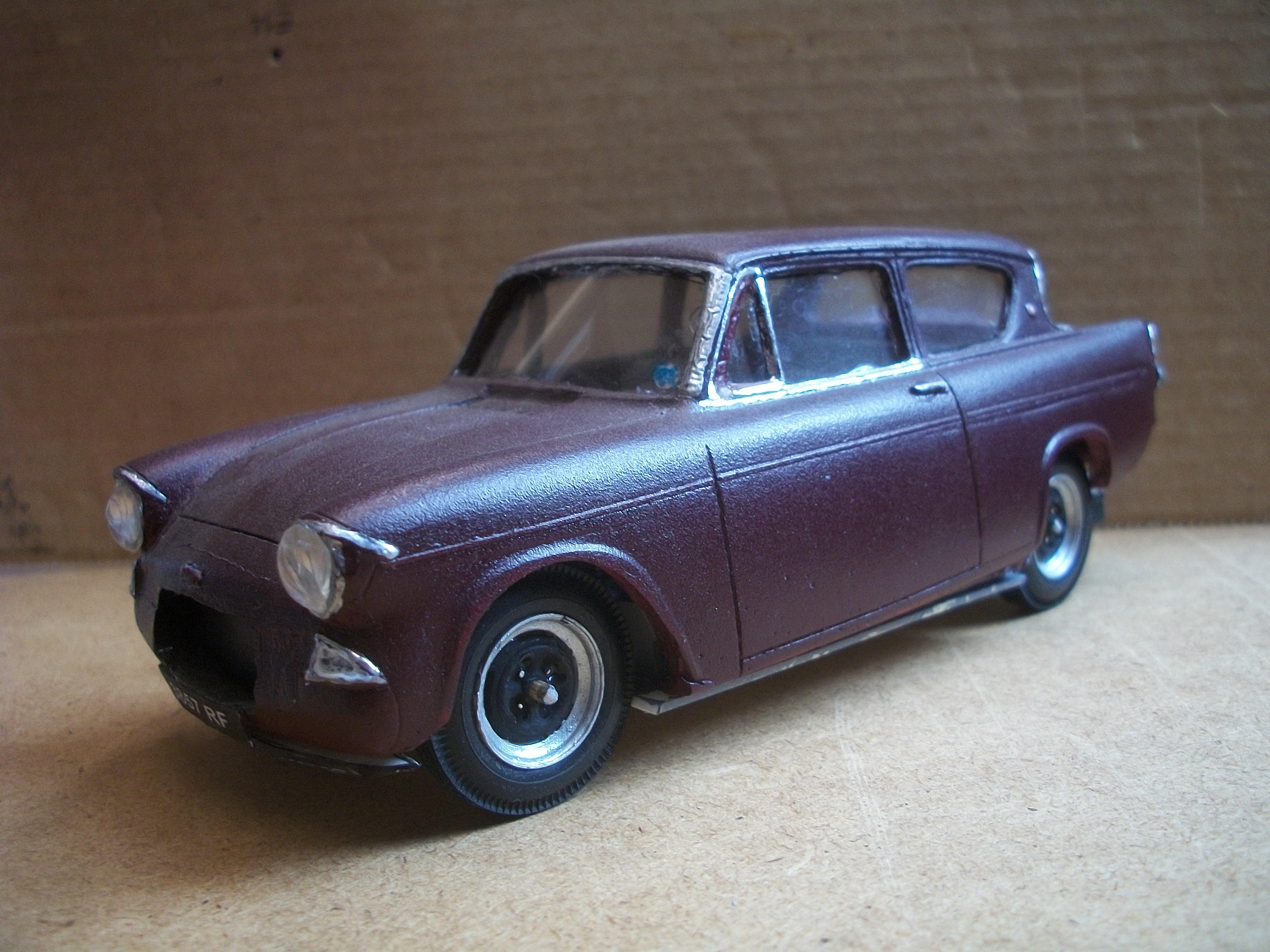

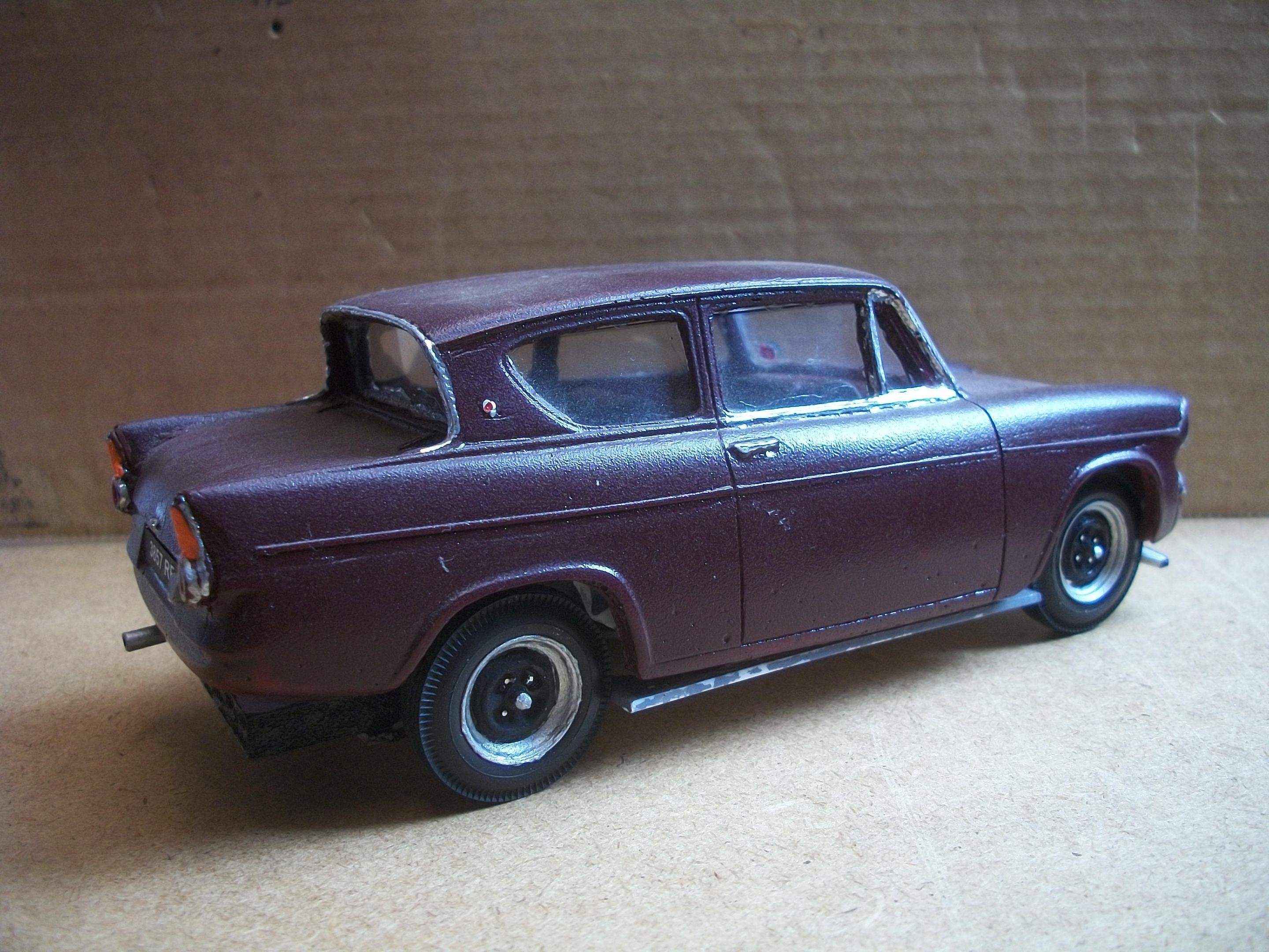

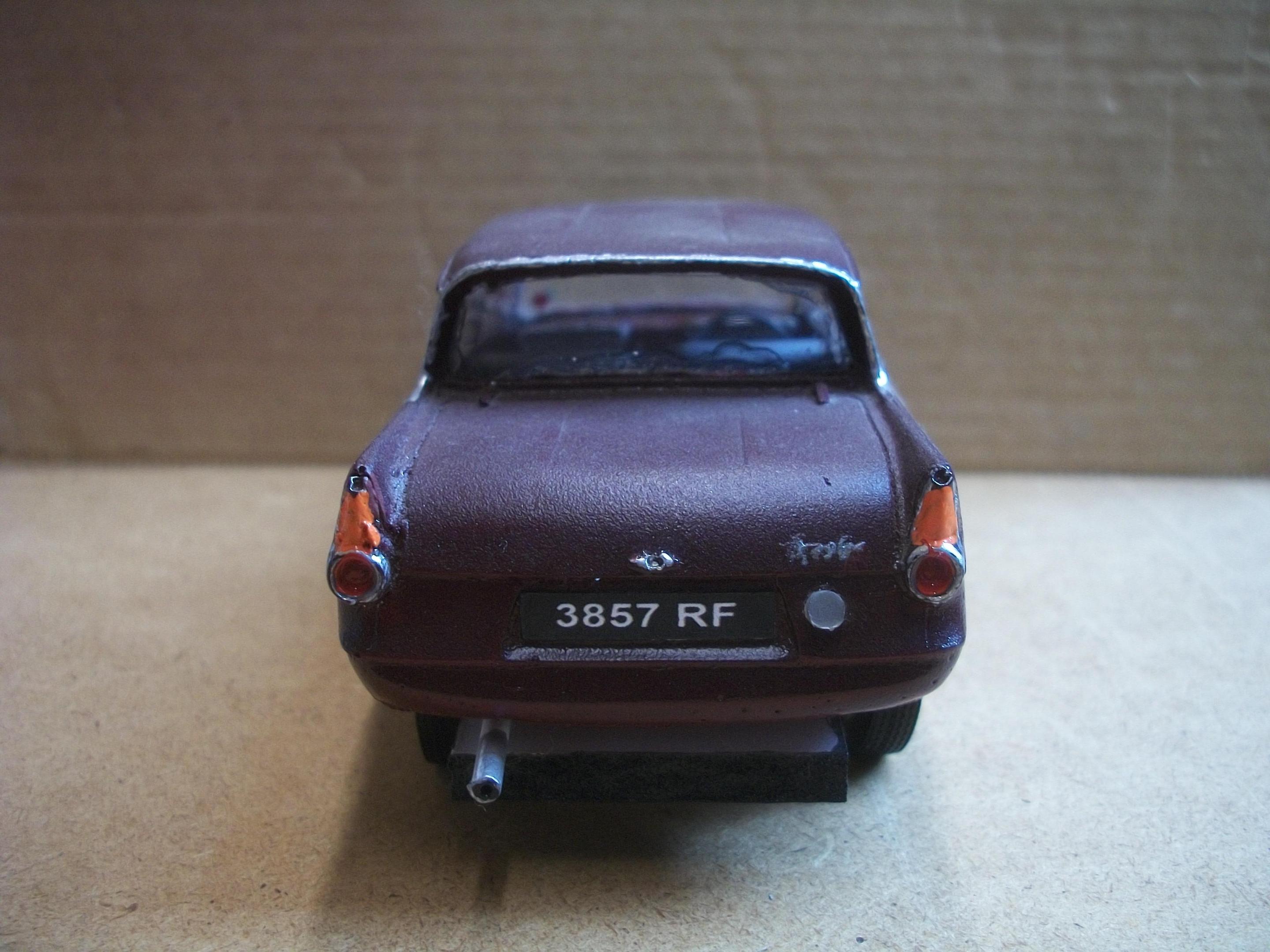

Anglia105E Posted July 16, 2023 Author Posted July 16, 2023 3 hours ago, Bugatti Fan said: David. What a coincidence. My late brother in law's first car was a maroon 105E also. Knowing that your first car was an Anglia 105E, thinking about it, if you are looking to make a model of your own first car look to Harry Potter. I am pretty sure that I saw a nice little 1/24th scale die cast of the one featured in one of two of the films advertised somewhere. Looks like it is a standard car so should be very easy to make yours from I would imagine. The Potter one is light blue from what I can remember, so a respray and possibly getting it apart to change the interior trim colour if necessary should not be too difficult. Incidentally, Motobitz make old style UK number plate decals for cars of that era. A coincidence indeed Noel . . . and talking of coincidences, I was reading an article about George Harrison of the Beatles and how the first car that he owned was a dark blue 1959 Ford Anglia 105E . . . My second car, after the 1960 maroon 105E, was a dark blue 1959 Ford Anglia 105E which I painted black in due course ! I have already built a resin bodied Ford Anglia 105E some years ago in 1:24 scale, for which I scratch built a chassis, fitted some clear plastic windows and sprayed the car with the Ford colour Imperial Maroon. Here are a few photos of that model car . . . The 1:24 scale diecast Anglia 105E, the Harry Potter one, is quite good but somewhere I did read that it was slightly out of scale? David

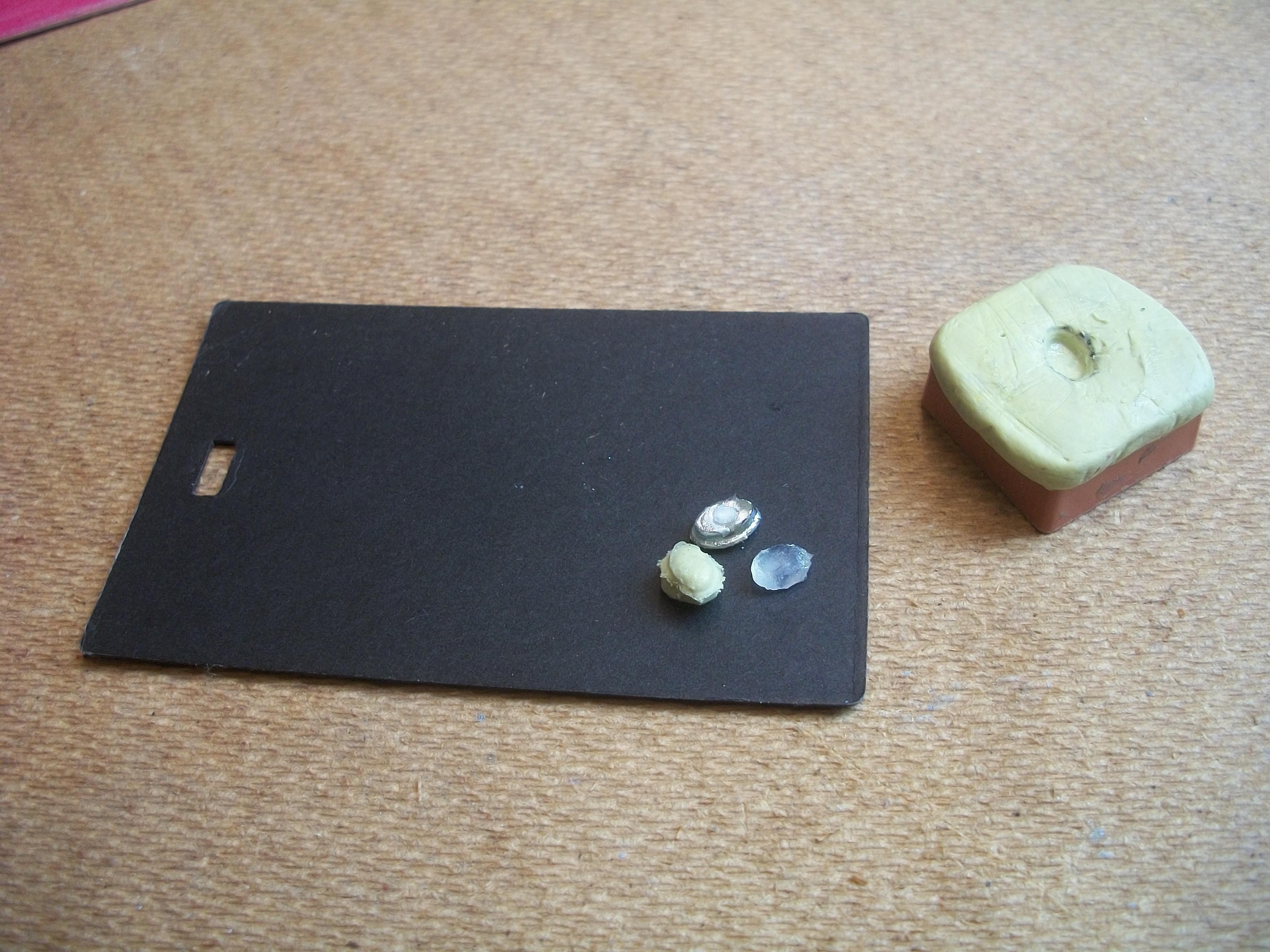

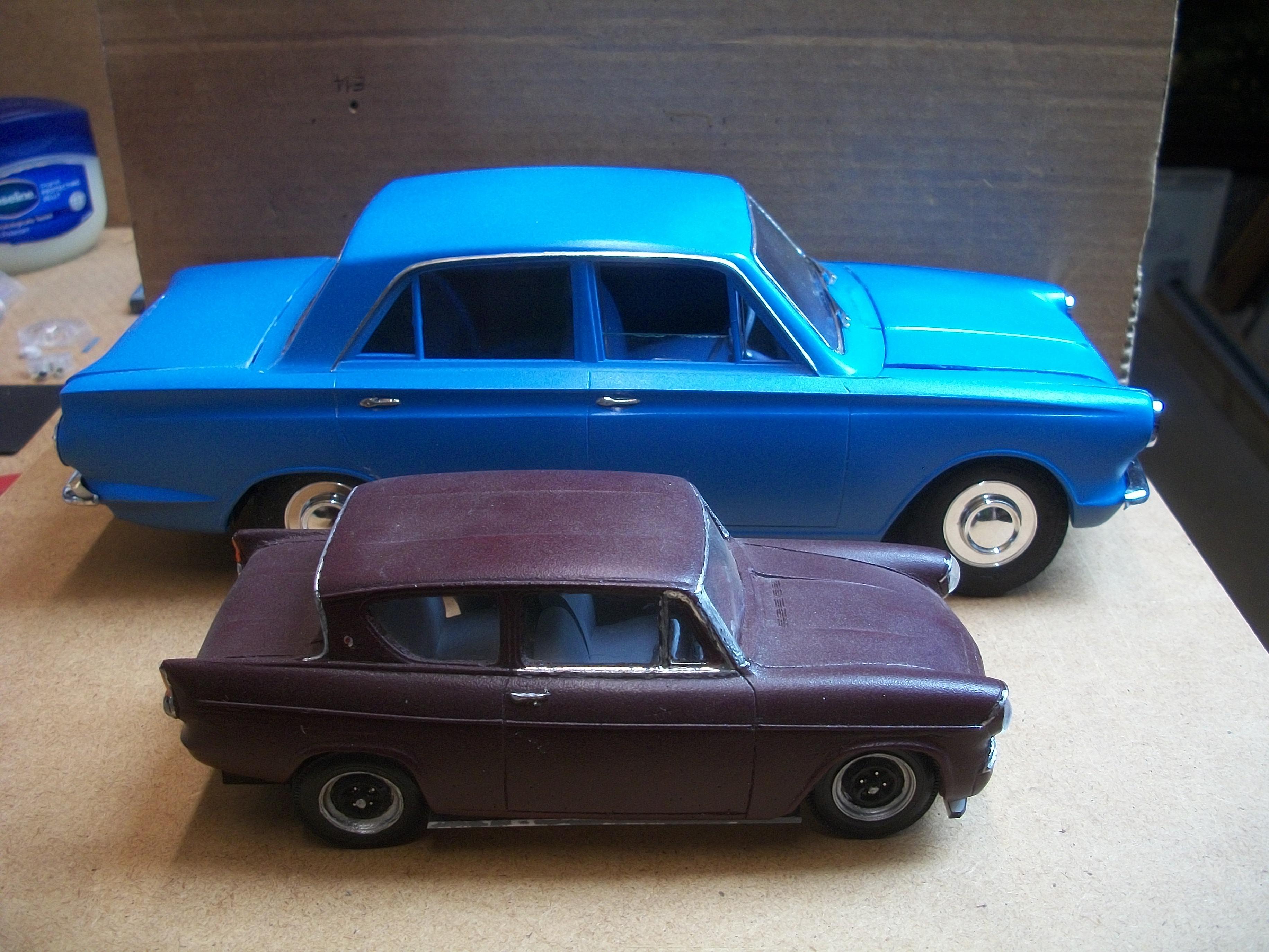

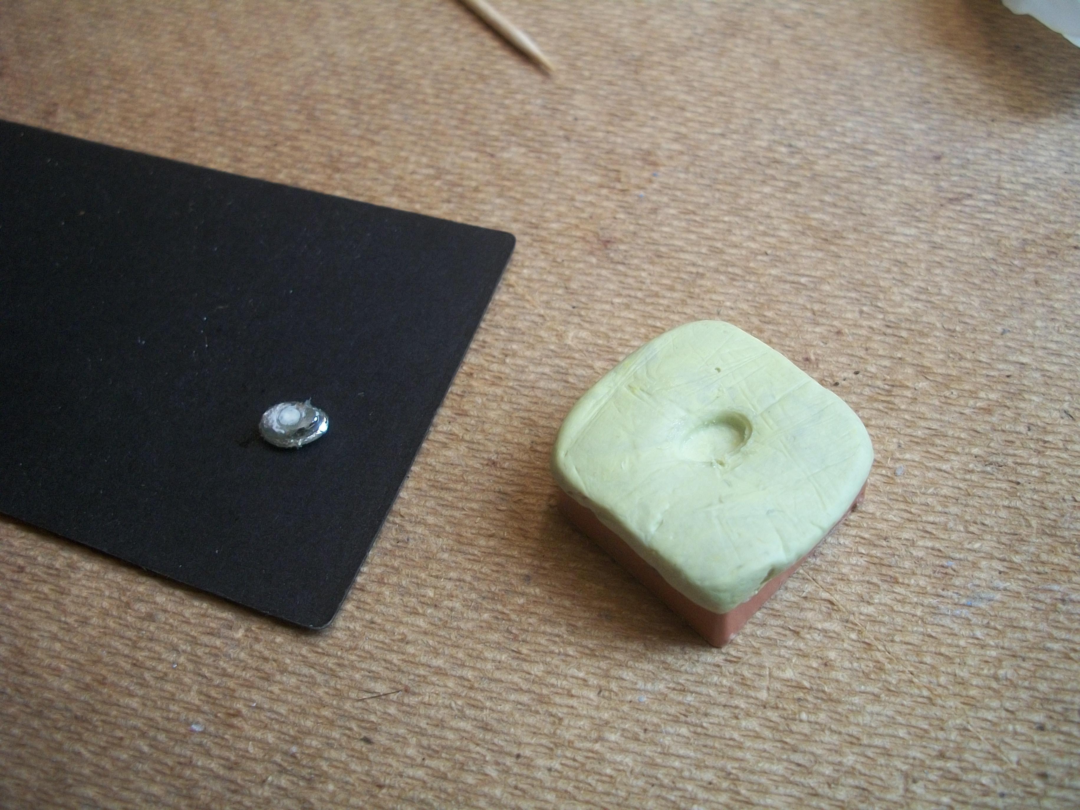

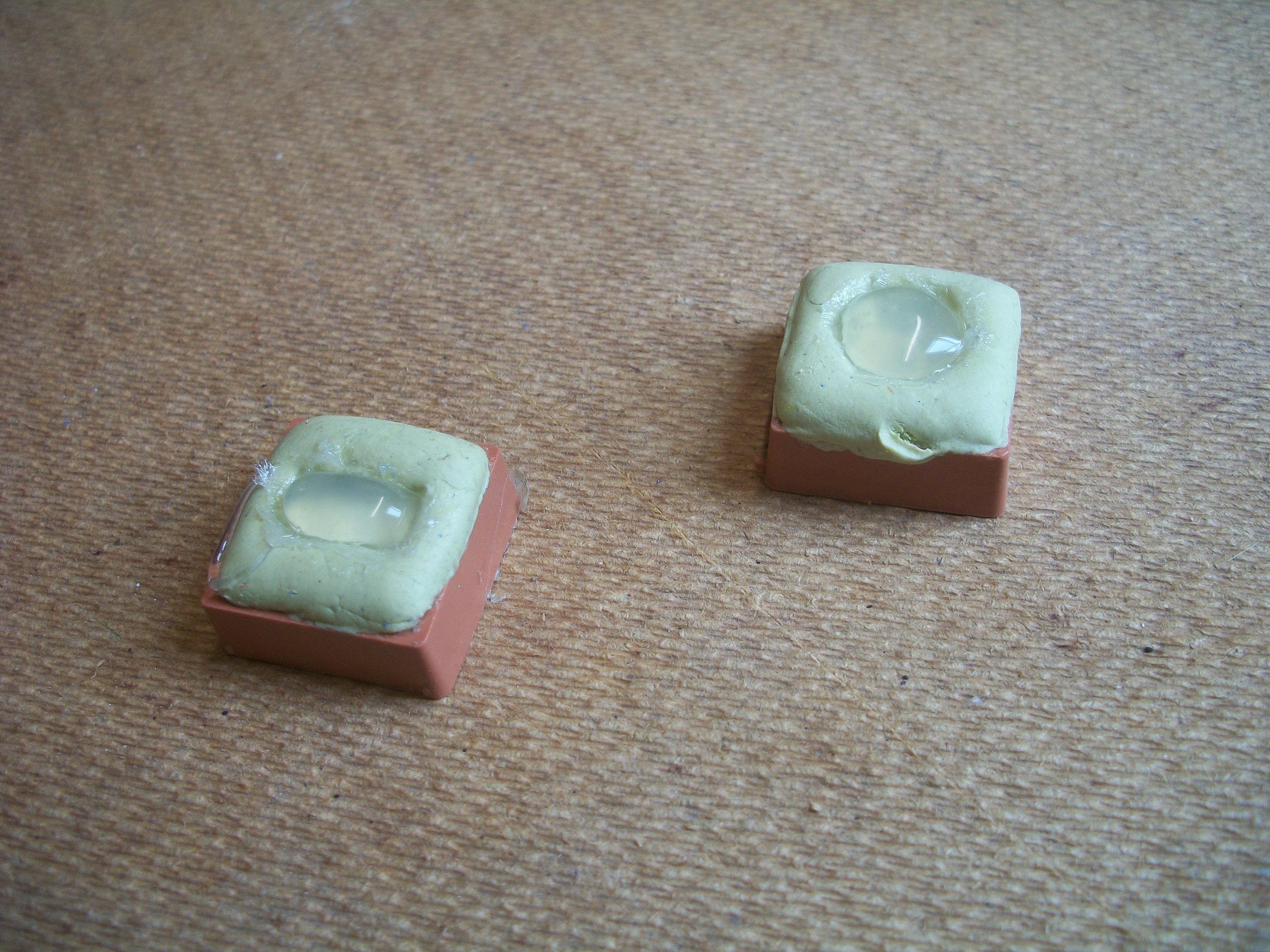

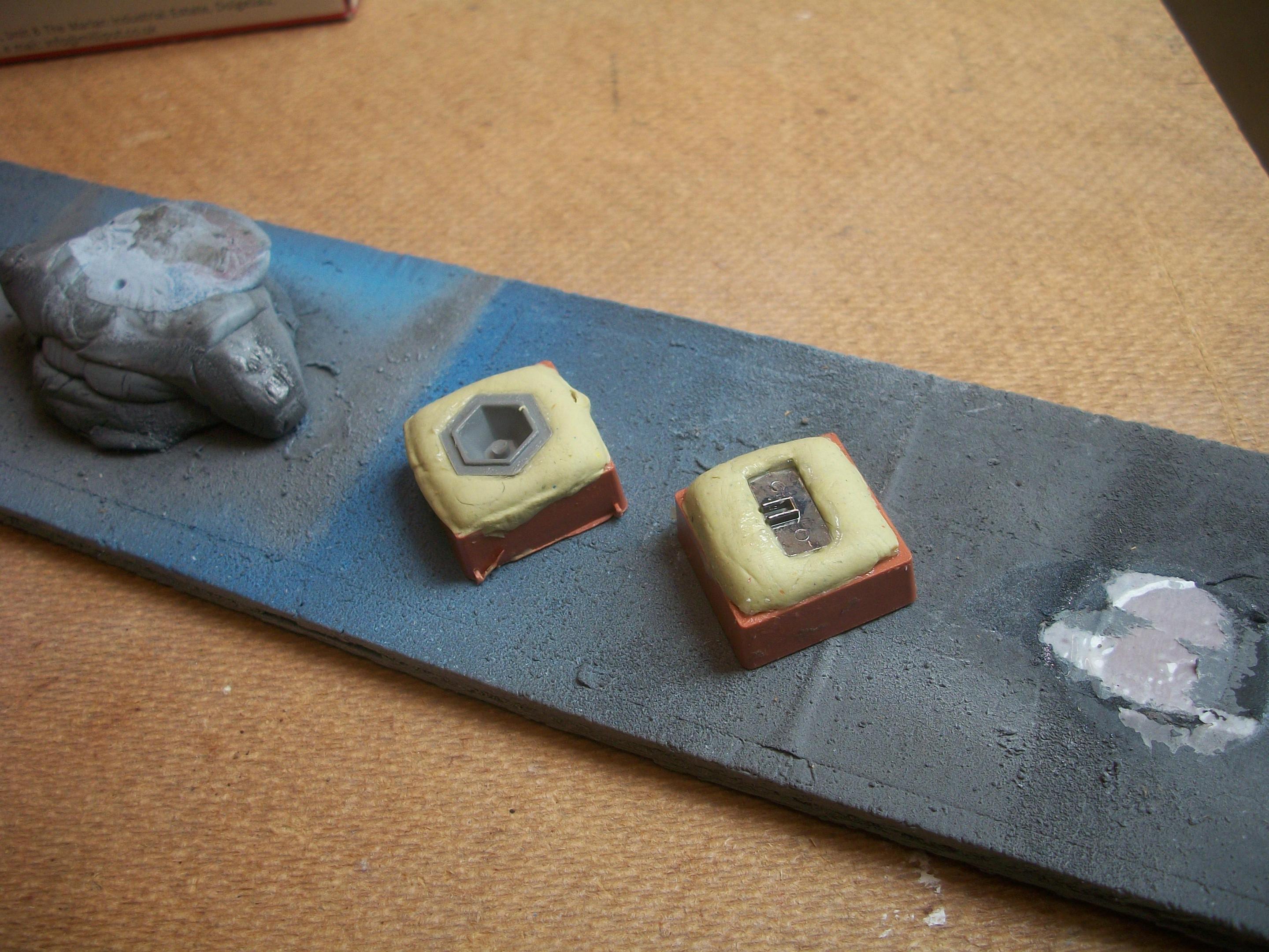

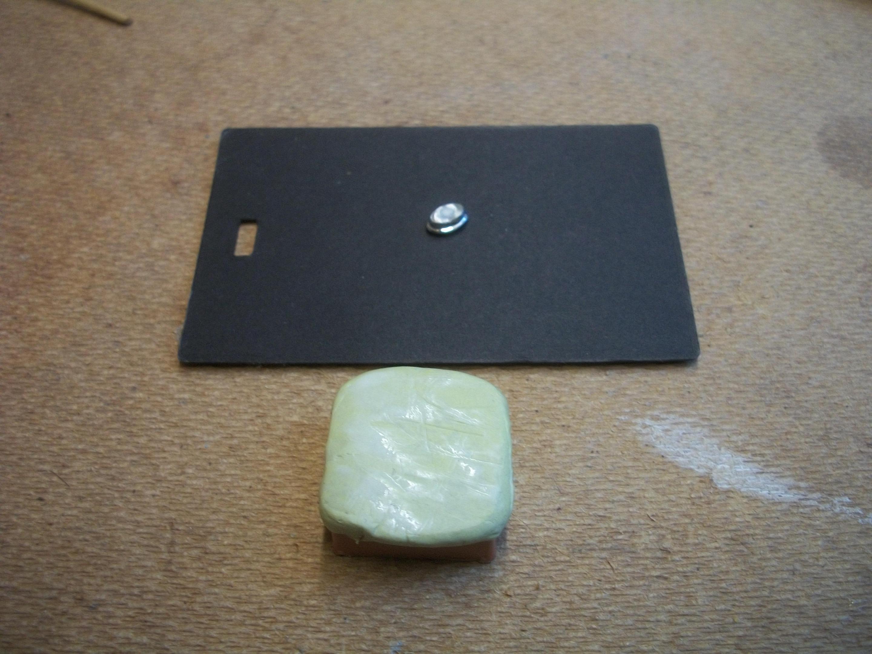

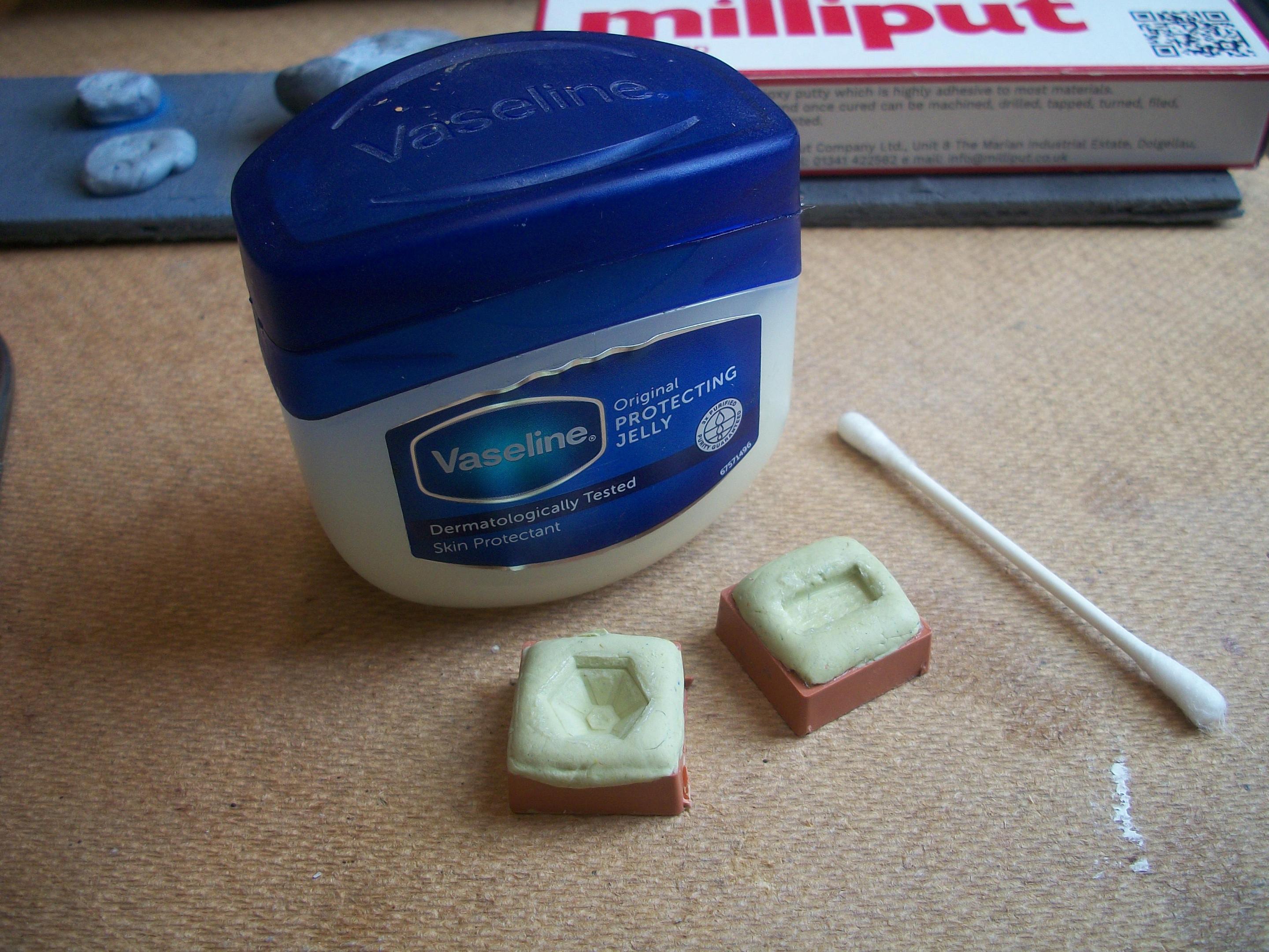

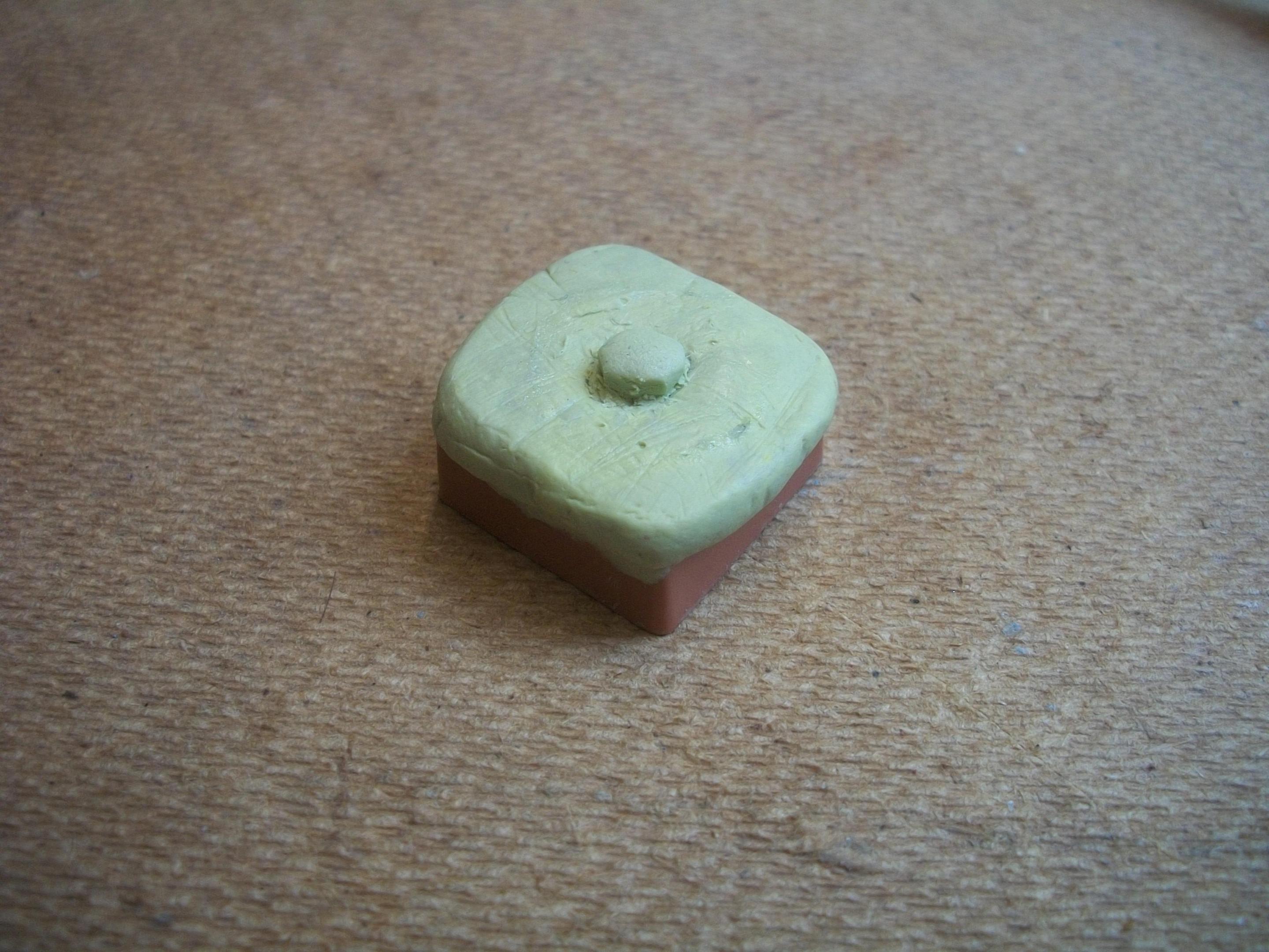

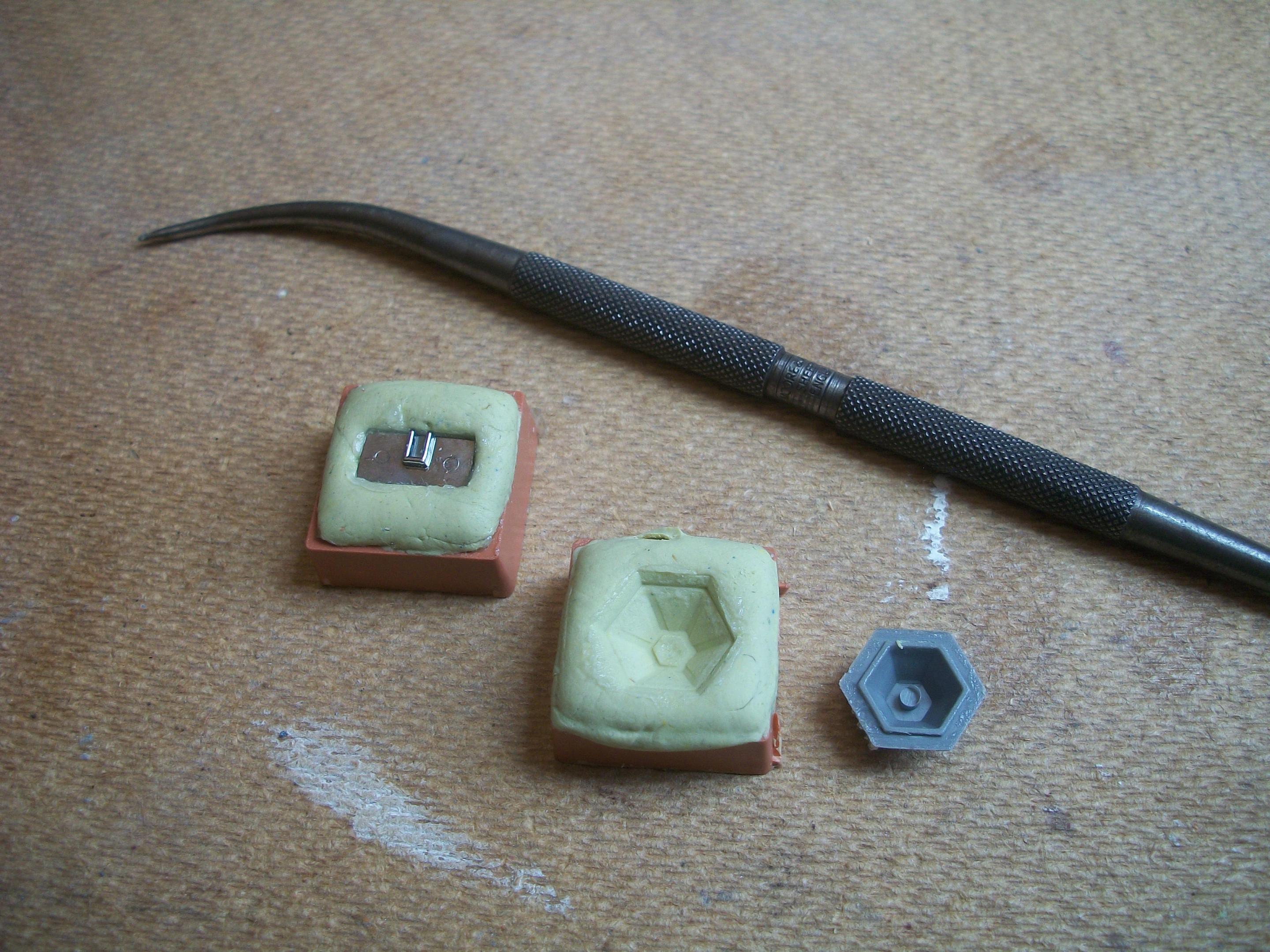

Anglia105E Posted July 17, 2023 Author Posted July 17, 2023 To continue with the moulding and casting tests, in order to produce a front side light for this Cortina, I have used Milliput to create the mould for two test parts . . . Vaseline was applied to the inside of the small plastic box, and also to the surface of the part. Following overnight setting of the Milliput, I have filled each mould with hot glue. This has turned out successful, and the part cast in hot glue was easily removed . . . This process is being repeated tonight, using the original side light part from the FROG kit. One more photo of the 1:16 scale Ford Cortina, and the smaller 1:24 scale Ford Anglia. David

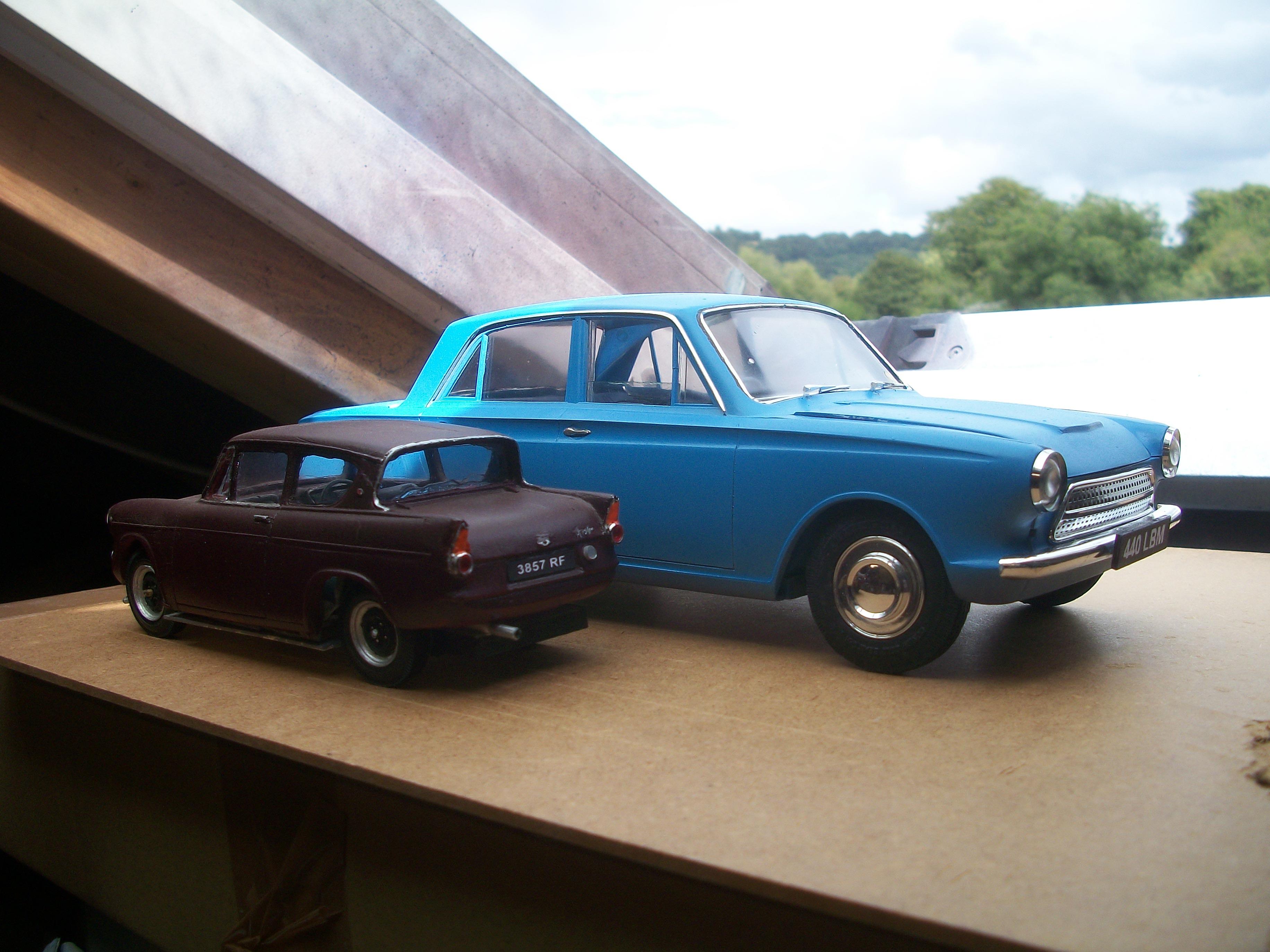

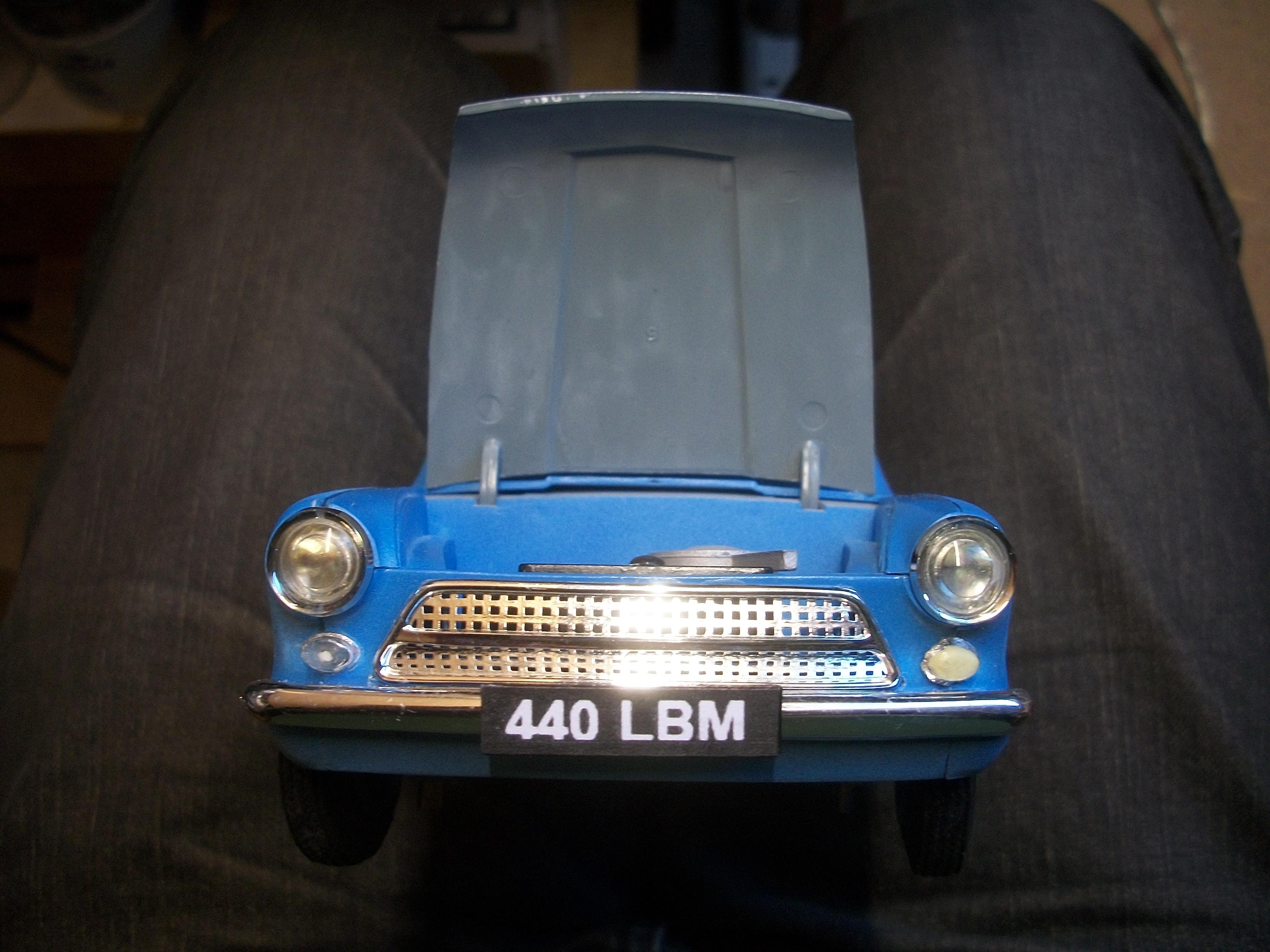

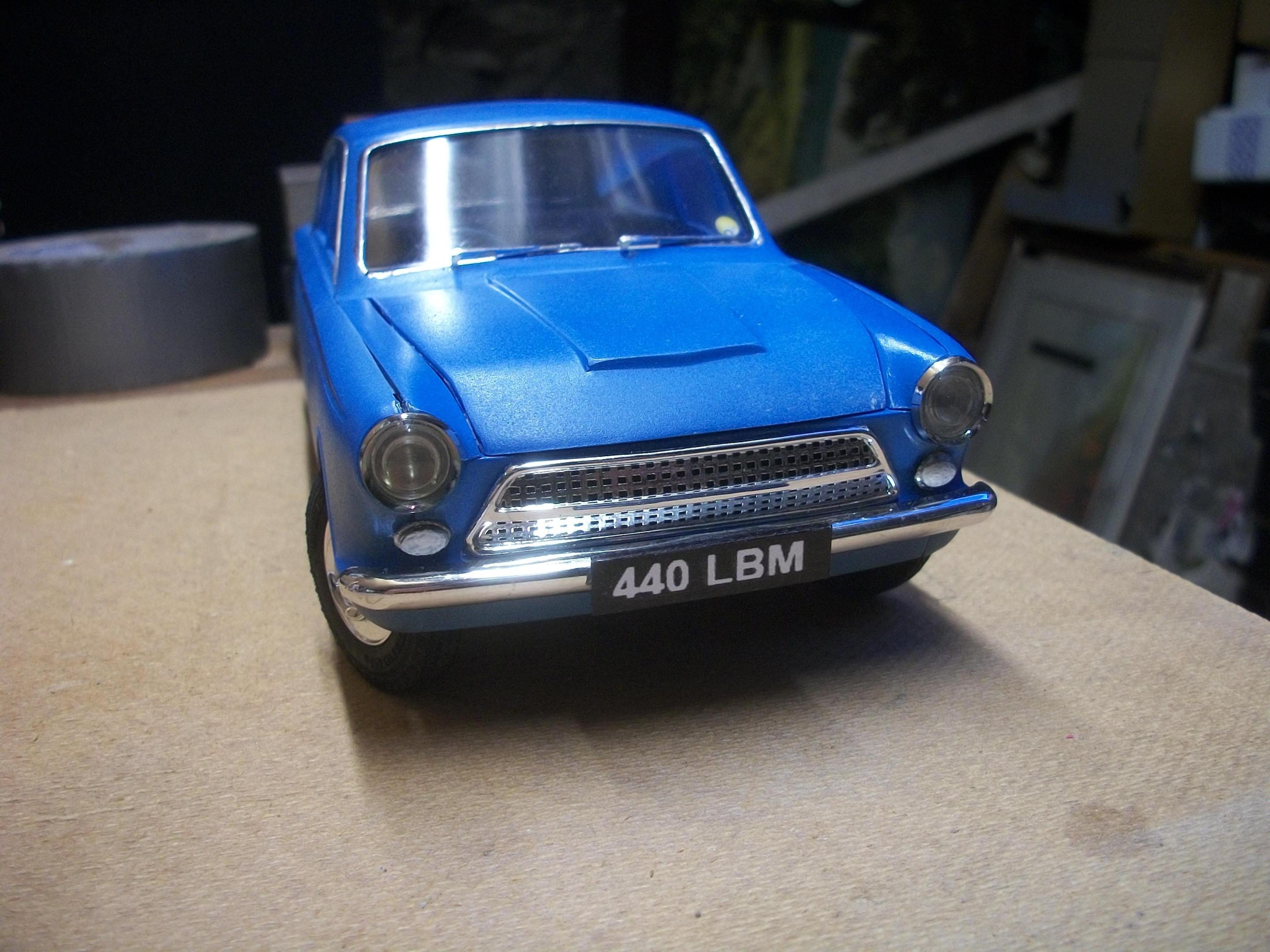

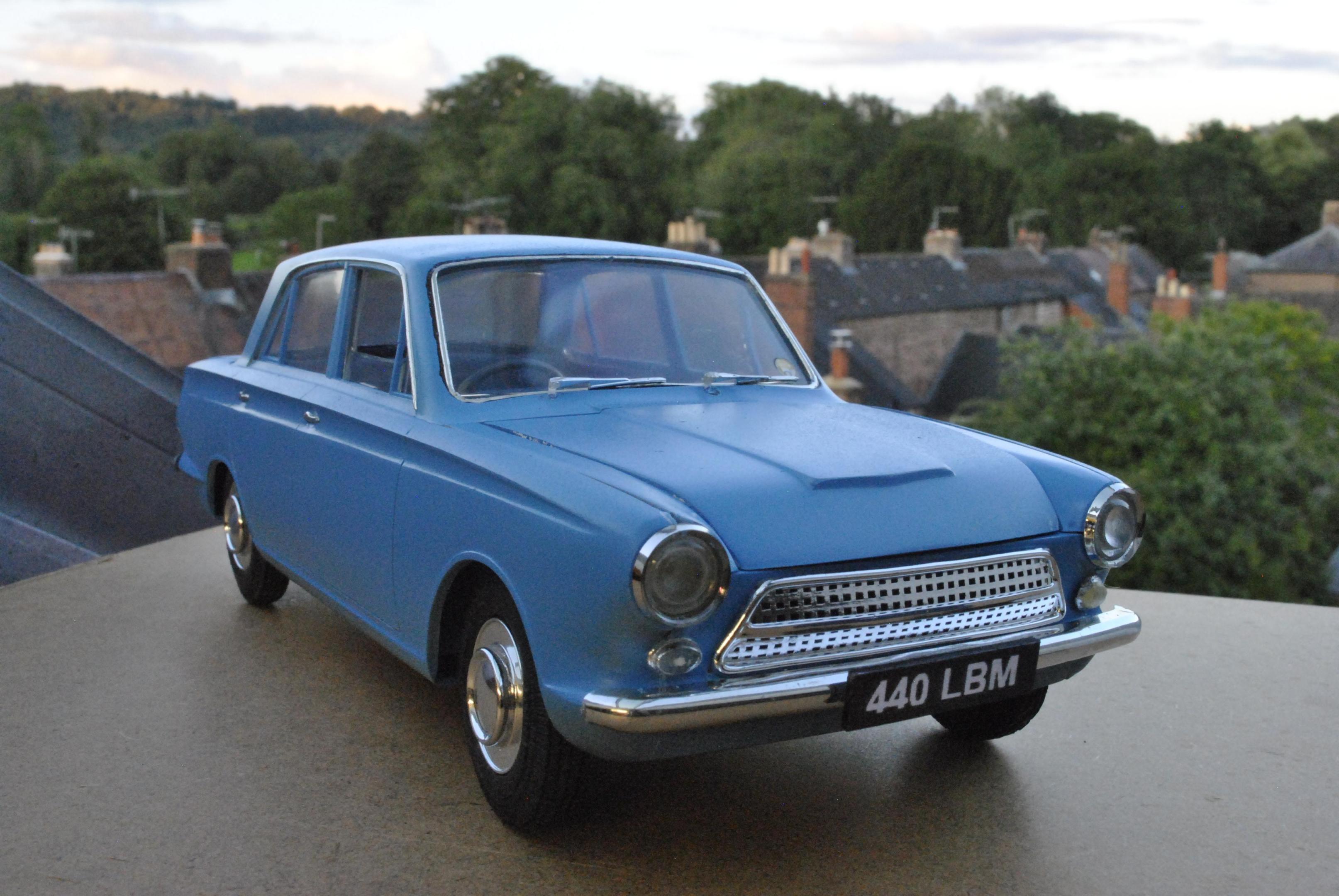

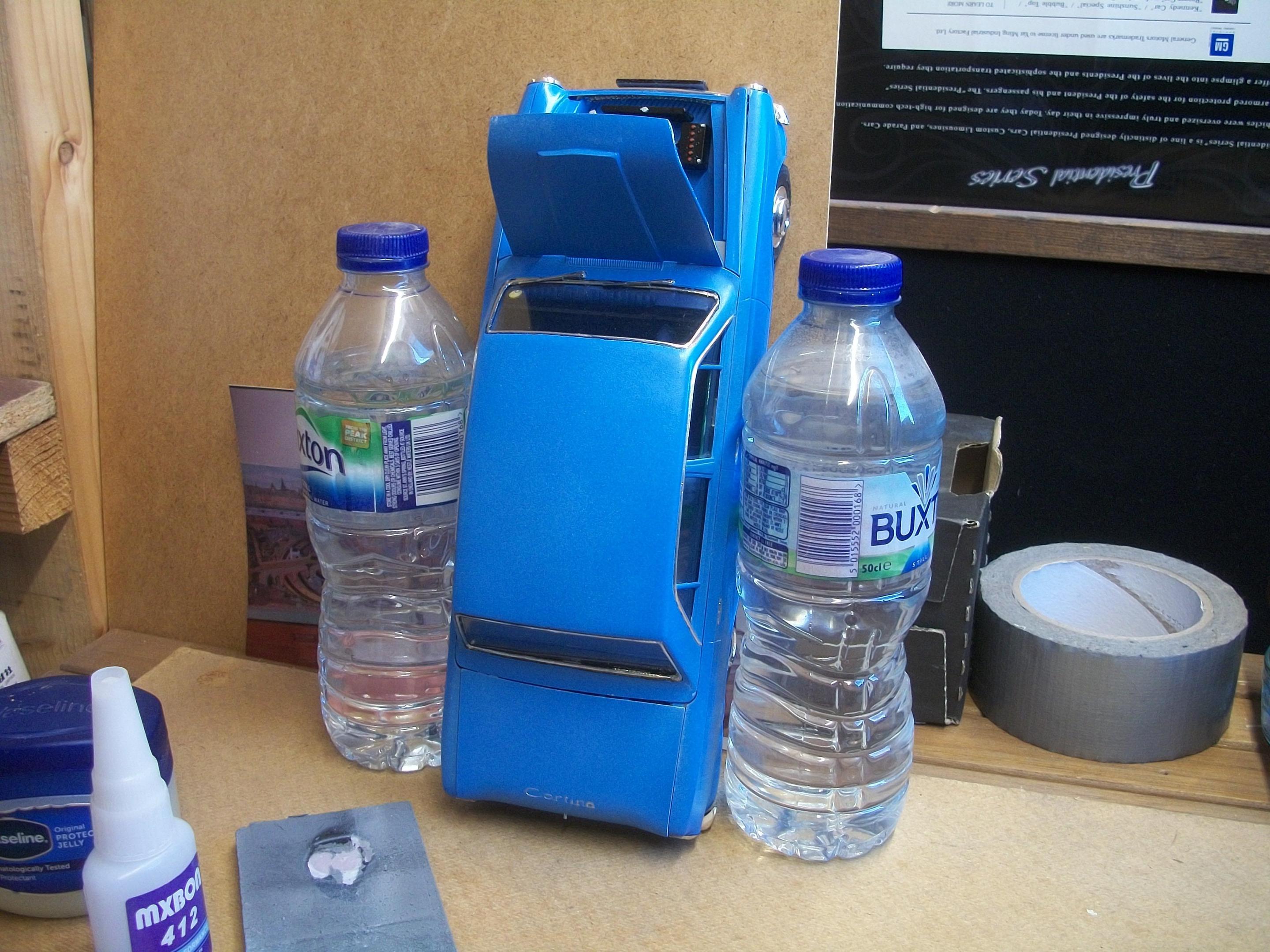

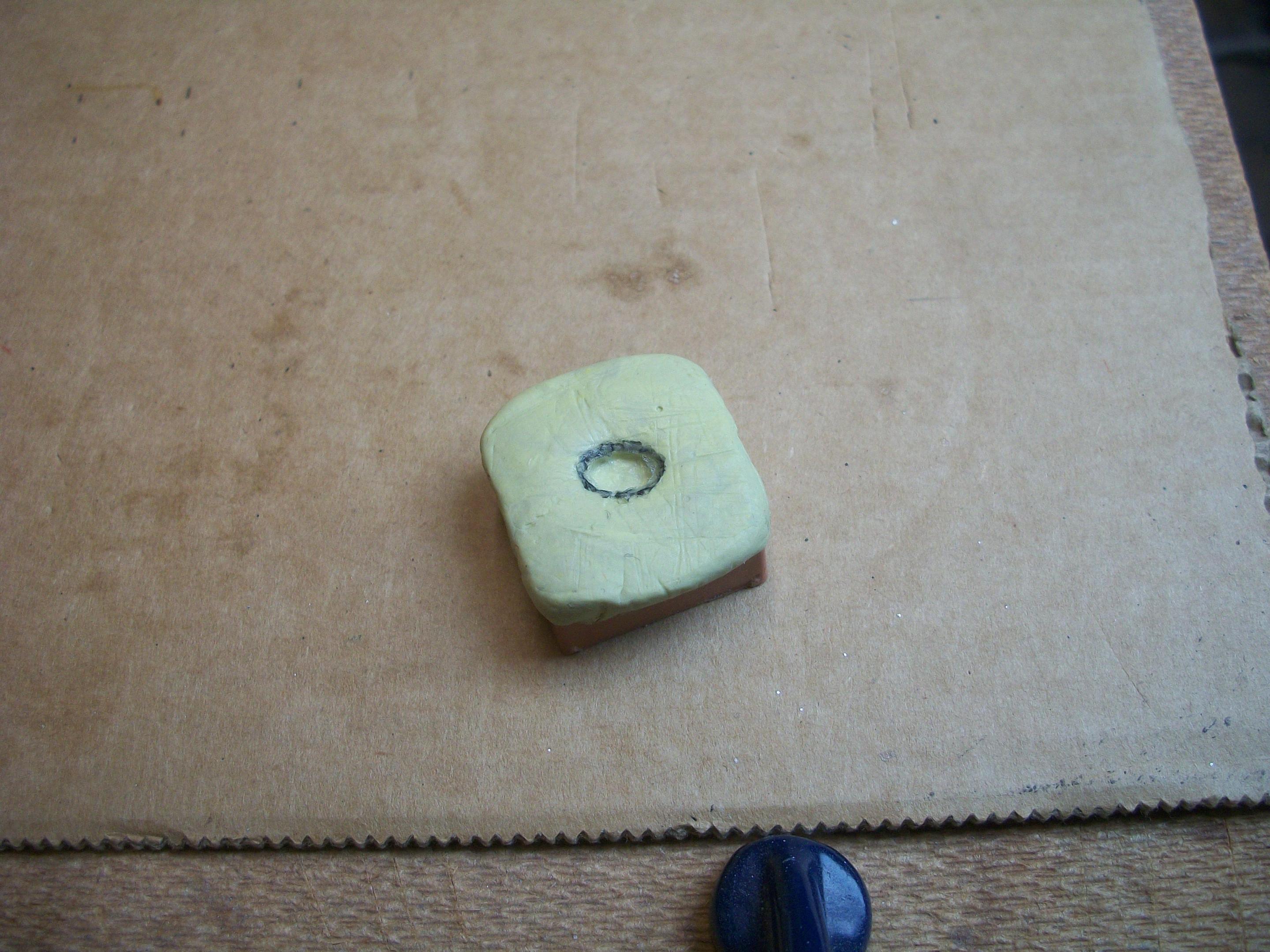

Anglia105E Posted July 19, 2023 Author Posted July 19, 2023 As things turned out, the hot glue version of the side light part was not good enough, so I decided to cast the part in the same Milliput material. By marking the outline of the mould with a black Sharpie, I was able to see the join, because both the mould and the cast part are the same colour. The Vaseline acts as a very effective release agent. The Milliput side light part is much better, and both front side lights are now glued in place on the car. Also, I have used Molotow Liquid Chrome from a refill, to brush onto the bezel around the side light. Both lenses have been painted with Humbrol matt white The side lights are on the car and done. There are no further parts to be assembled or painted. When the outdoor photo shoot takes place, subject to weather conditions improving, I shall be using my daughter's Nikon D3000 DSLR camera, which should be capable of handling the forced perspective that I am aiming for. I think this model is just about ready to post in the Under Glass section of the forum . . . This build has taken 38 days to complete. Many thanks to all fellow members who have kindly viewed my topic, and offered me valuable advice. This has to be THE best model cars forum ! David 1
