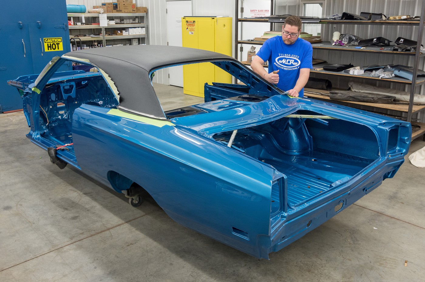

StevenGuthmiller Posted June 25, 2023 Posted June 25, 2023 My opinion has always been that masking tape is far too heavily textured for 1/25th scale. If you look at photos of a 1:1 vehicle, you'll see that the texture is nearly undiscernable. Far finer than what you'll get with masking tape. I agree with Daniel. After applying seams with the thinnest strip plastic that you can find, and adding the C-pillar trim, mask and spray the color of choice from a foot or so away from the subject. This is a circumstance where you want a fine orange peel tecture. Personally I find that a flat paint, shot from a distance and then rubbed with your fingers once dry gives a pretty convincing vinyl sheen. The oil from your fingers will polish the high points of the orange peel, leaving the base flat. If you want to go a step further, you can fill the top seams on the inside edges with some putty and sand to help alleviate the inside edge of the overlap. Steve 2
