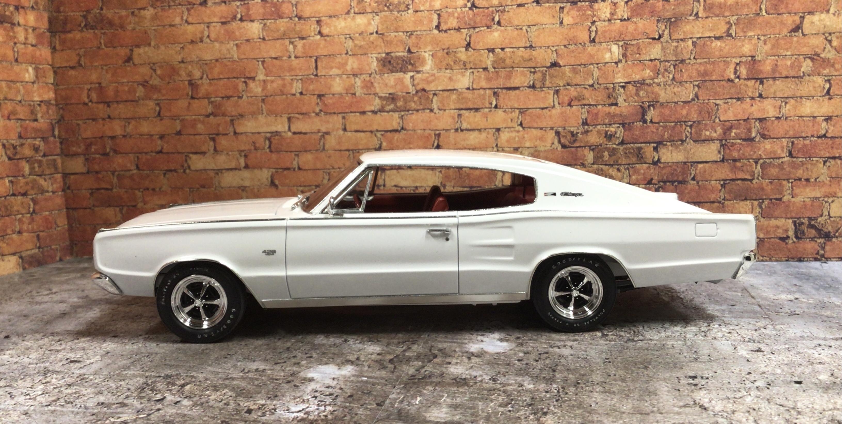

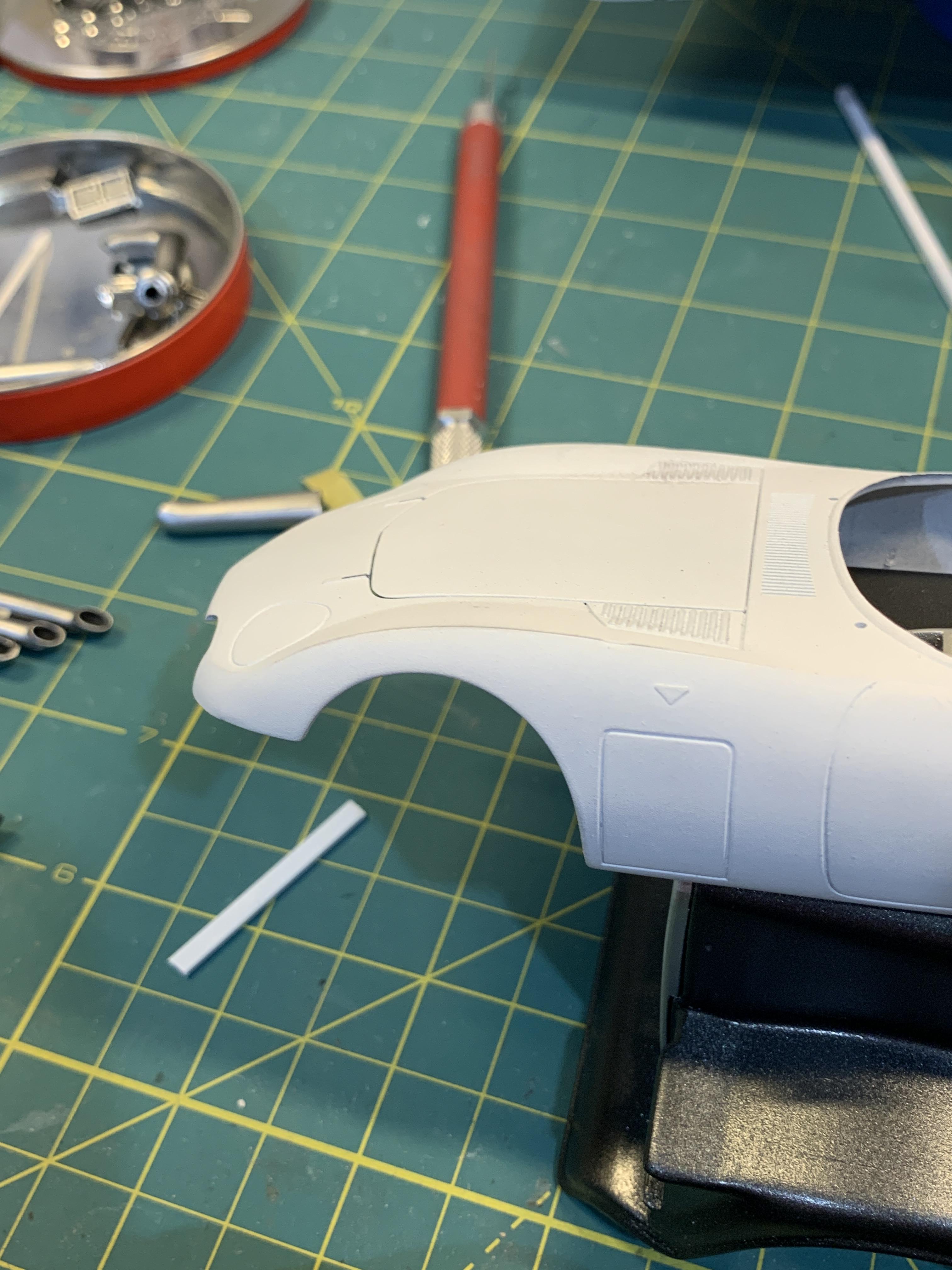

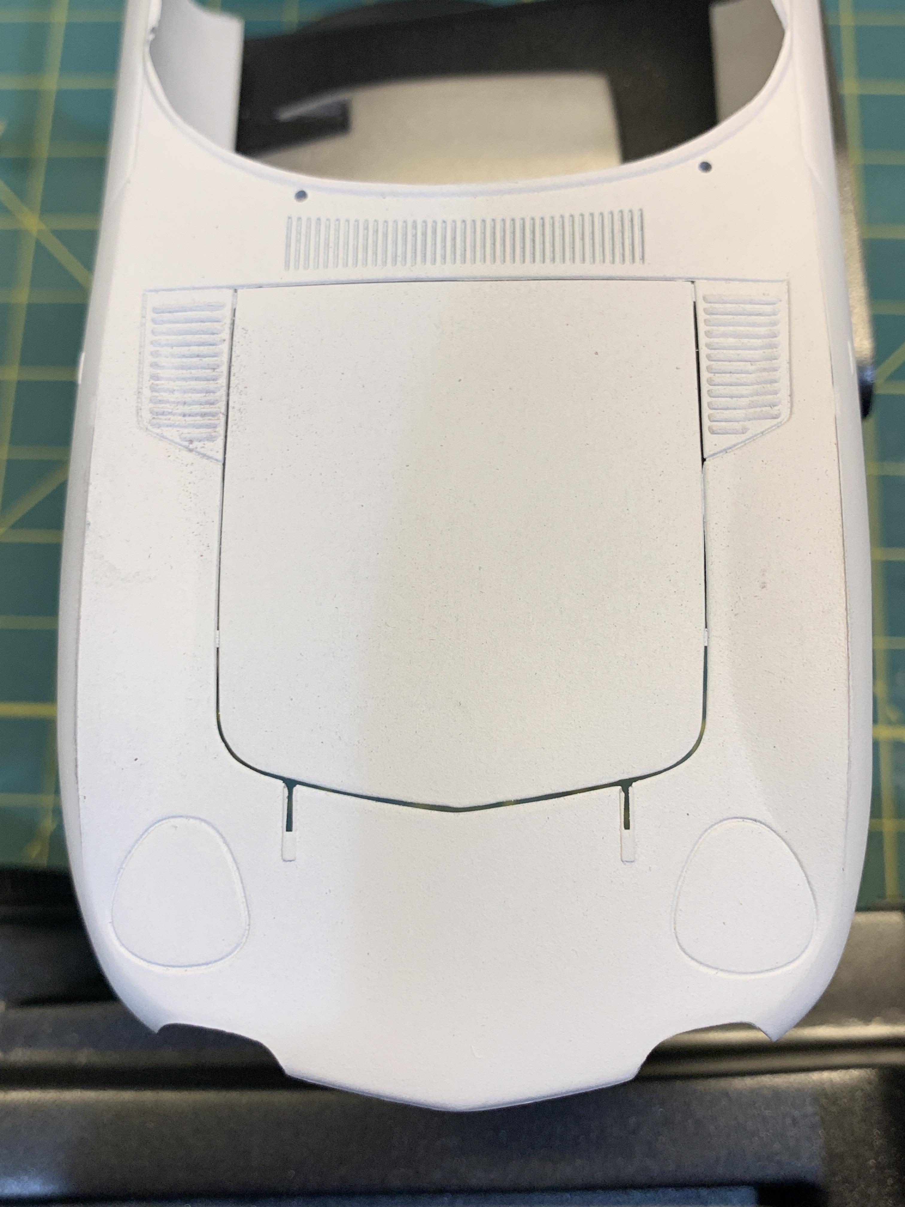

Sonorandog Posted June 27, 2023 Author Posted June 27, 2023 Thanks for all the advice. I typically use an airbrush. The current body I’m working on has gone through three paint jobs. I put down a white primer in each scenario. The three paints I have used have been ammo, Vallejo and Tamiya. The Tamiya was a bottle of the X2 white thinned with Tamiya thinner. in each case as well as with previous white paint jobs the final color always ends up being boring. I’m trying to get a nice crisp shade of white. A bright white. For some reason I can accomplish this with other colors, but the white always ends up just blah. I think I’m going to try buying a can of Tamiya white spray paint and see if that gives me better results. I don’t know if the attached images convey the issue. Those are the results with with Tamiya white.
Dave Ambrose Posted June 27, 2023 Posted June 27, 2023 White doesn't cover very well. The color of the underlying paint/model has a big influence on the final outcome. I have a few suggestions: Use white primer. Tamiya is fine, or use Mr. Color Surfacer, 1000 or above. Multiple very light coats. You need to build up the paint gradually. Use the Tamiya pre-thinned paints. Those seem to spray better, at least for me. If you're still having coverage issues, try the Tamiya matte white. That will cover better. You can follow up with a clear coat. The surface on your model looks rough. The paint is likely drying too much before it hits the model. This is a constant problem in a low-humidity environment. Spray less paint, get closer, move fast.
StevenGuthmiller Posted June 27, 2023 Posted June 27, 2023 Both of these models were painted with nothing more than Duplicolor white sandable primer, and Duplicolor white lacquer touch up paint, straight from a rattle can. The Edsel was molded in blue plastic, so good coverage was essential. Plenty of primer, and several light coats of color was all that was required. A few coats of clear will go a long way to adding depth to a “drab” paint job as well, even white. These are both painted with a “warmer” white, but you get the picture. I don’t recall either of these being any more difficult to paint than any other color. Steve

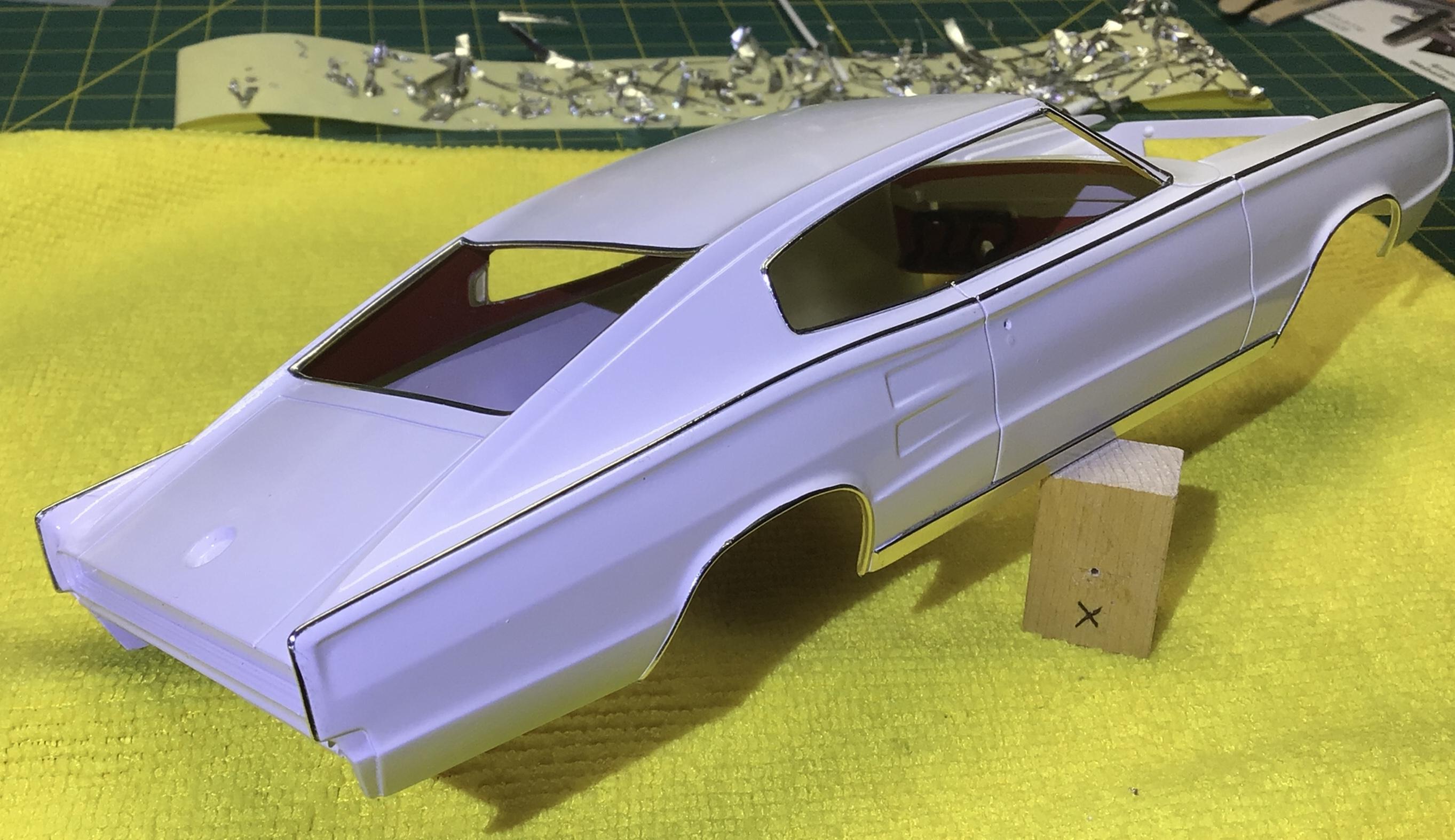

NOBLNG Posted June 27, 2023 Posted June 27, 2023 (edited) This is my first and only white one so far. Paint is Tamiya LP-2 and MR. Hobby UV cut clear. The first coat was a little pebbly, so I gave it a light sanding then a couple more coats. The foil gives some contrast and the clear gives it some depth. If your model doesn’t have any trim to accent the paint, white may look a little bland? Also, highlighting the panel lines before the paint may help to define them and break up the “whiteness”. I’m certainly no expert…just my thoughts. Edited June 27, 2023 by NOBLNG 1
