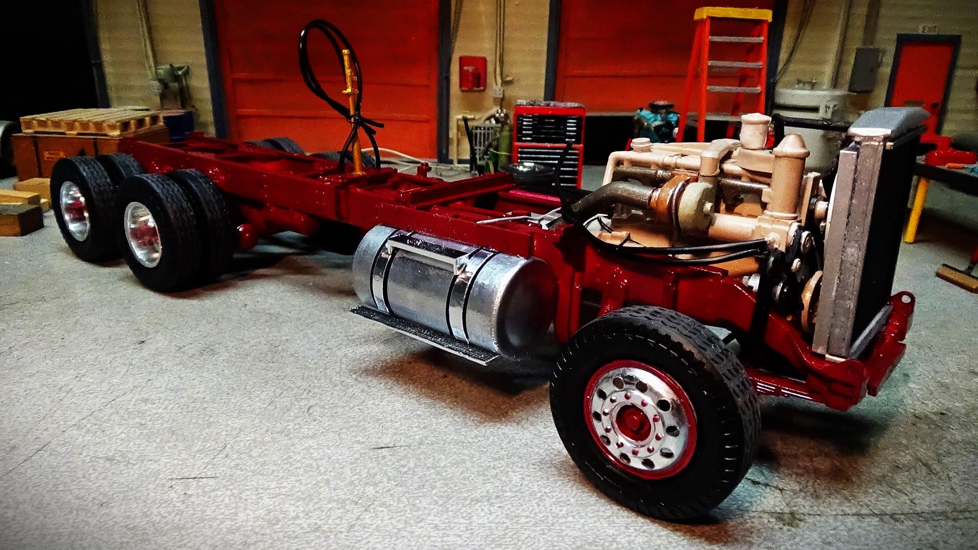

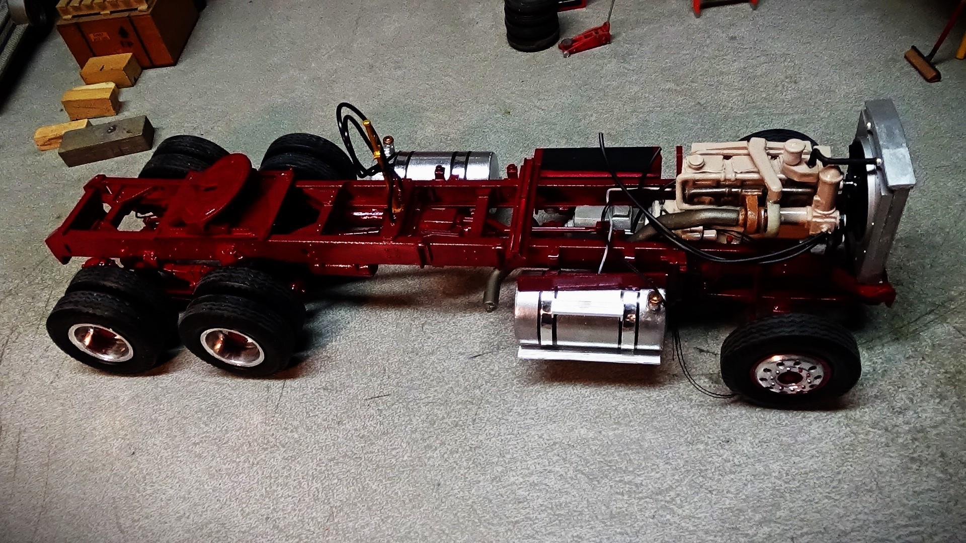

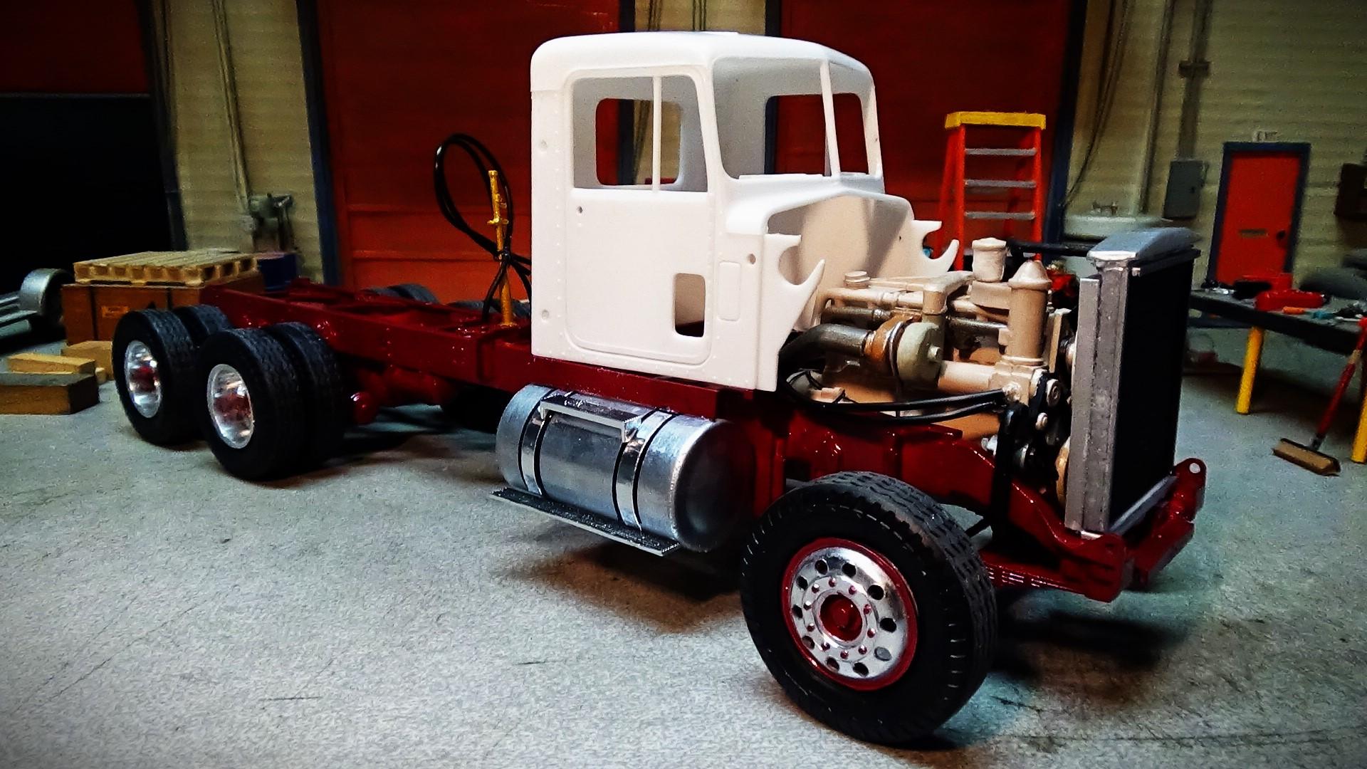

Bronzekeg Posted July 11, 2023 Author Posted July 11, 2023 13 hours ago, Rockford said: Hang on, these tanks have moulded-in straps don't they? So I'm assuming you have rubbed them out, but what have you wrapped the barrel of the tank with? Looks like ali tape. You're hiding your light under a bushel mate. Please, do tell. the tank straps were filed off along with the chrome. they were then steel wooled and painted with krylon silver foil spray paint in a rattle can. thanks for your interest Steve.

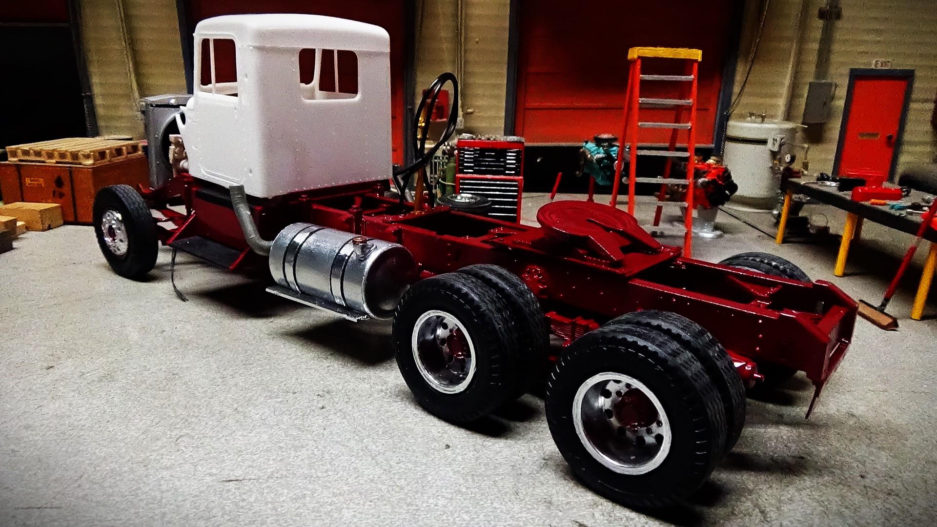

Bronzekeg Posted July 11, 2023 Author Posted July 11, 2023 I had to test fit the cab to figure out where to locate the right side filler neck on the fuel tank. I also took the time to locate the cab filler plate and the exhaust elbows. ( the instructions are wrong showing the location of the fill necks.)
Force Posted July 12, 2023 Posted July 12, 2023 Nice work Ken But this truck is technically a W923 as it has walking beam suspension, the 925/125 designation was for the dual drive torsion bar suspension...so AMT had it right from the very beginning when this kit was eveloped and had torison bars, but is wrong since the suspension was changed. It's the other way around for the K123 kit, it was originally wrong as it also had tosion bars but the number is right since they changed to walking beam.
Rockford Posted July 12, 2023 Posted July 12, 2023 AMT instructions, wrong!? Never! Looks great though. The ali on the tanks looks very realistic, that's why I thought you'd taped them. I saw someone did a box van with ali duct tape on the site.
Rockford Posted July 12, 2023 Posted July 12, 2023 Tanks look very realistic, I've never heard of the paint you used. Straps are good too. Good to see some plumbing going on too. You realise how old a truck this kit is depicting when you see those fuel filler necks. In the early 70s they went to the recessed type of fuel filler. Cue Force with the day and date... ?

Bronzekeg Posted July 13, 2023 Author Posted July 13, 2023 On 7/12/2023 at 2:44 AM, Force said: Nice work Ken But this truck is technically a W923 as it has walking beam suspension, the 925/125 designation was for the dual drive torsion bar suspension...so AMT had it right from the very beginning when this kit was eveloped and had torison bars, but is wrong since the suspension was changed. It's the other way around for the K123 kit, it was originally wrong as it also had tosion bars but the number is right since they changed to walking beam. thank you and thanx for the info Hakan!

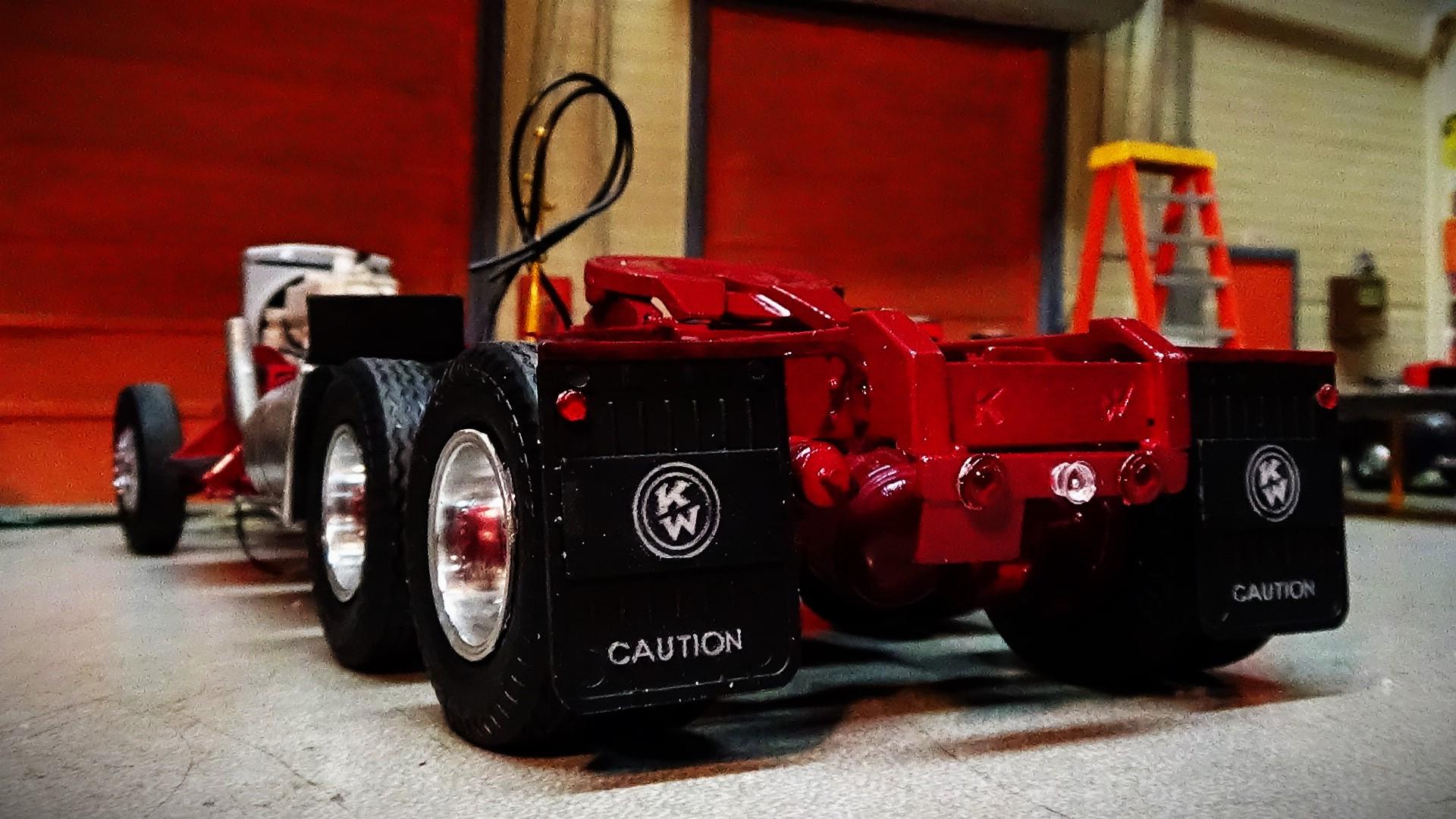

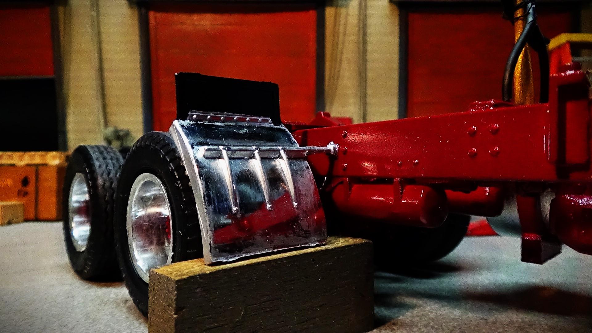

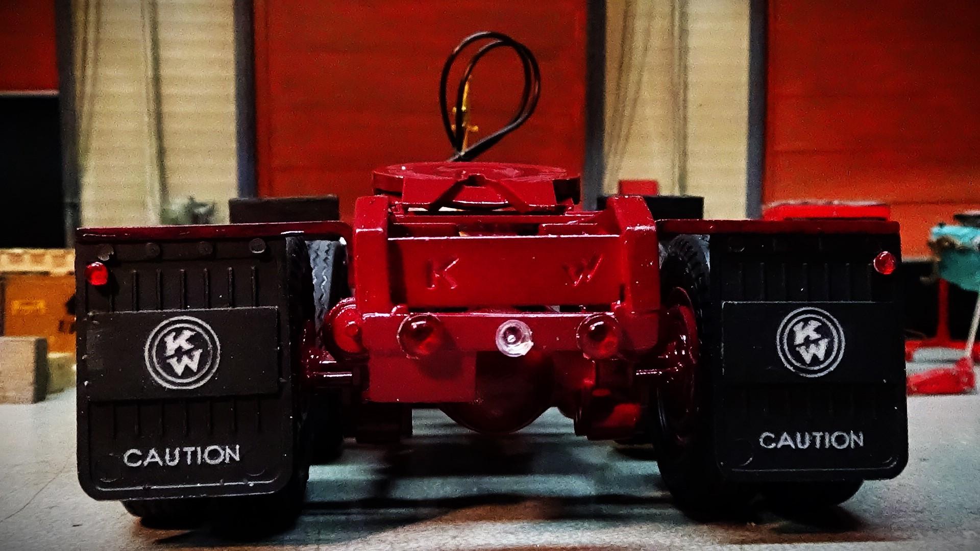

Bronzekeg Posted July 14, 2023 Author Posted July 14, 2023 working on rear fenders and mud flaps. also have scratch built mufflers and stacks. I don't like the diameter of the kit supplied ones.

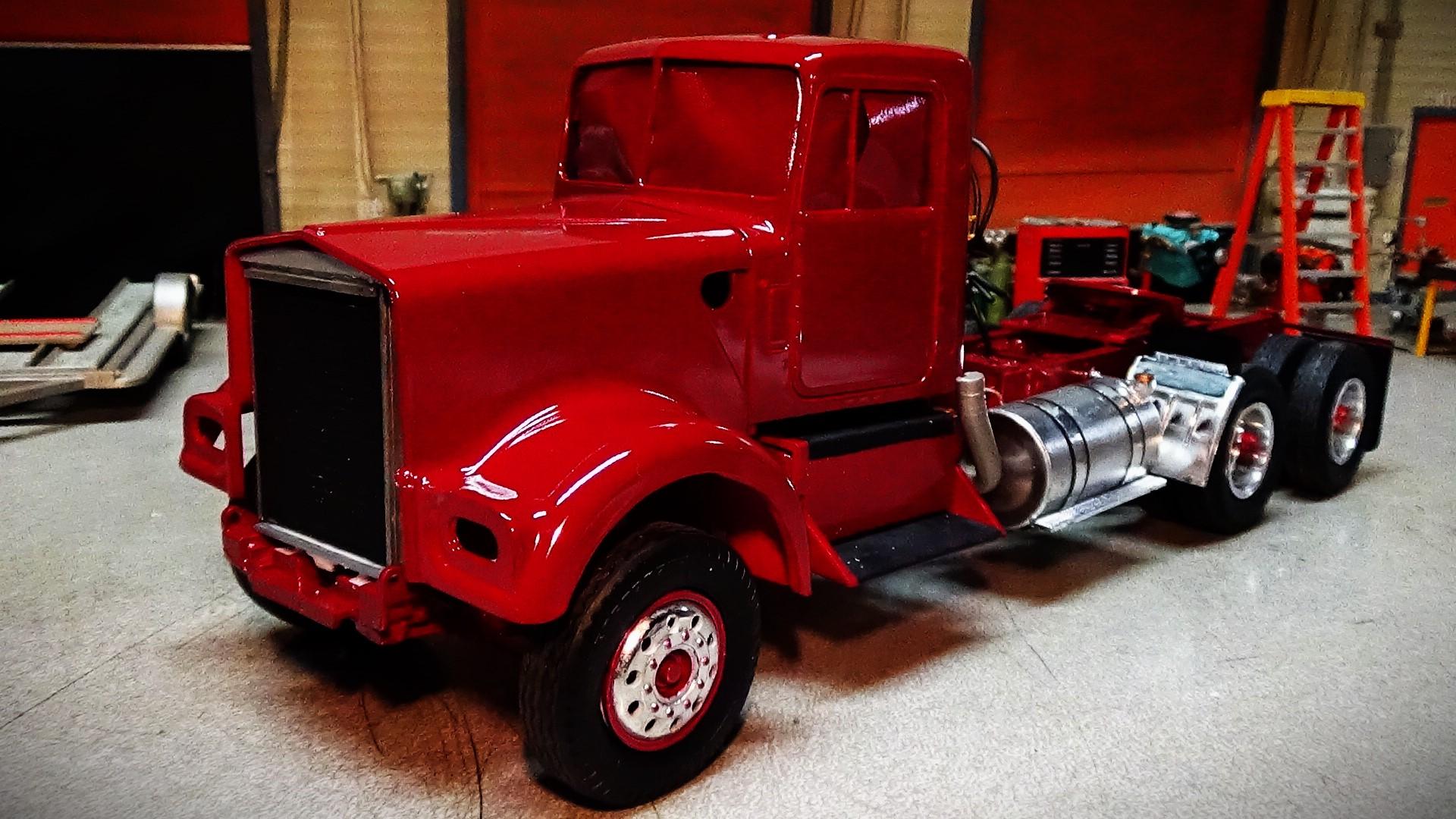

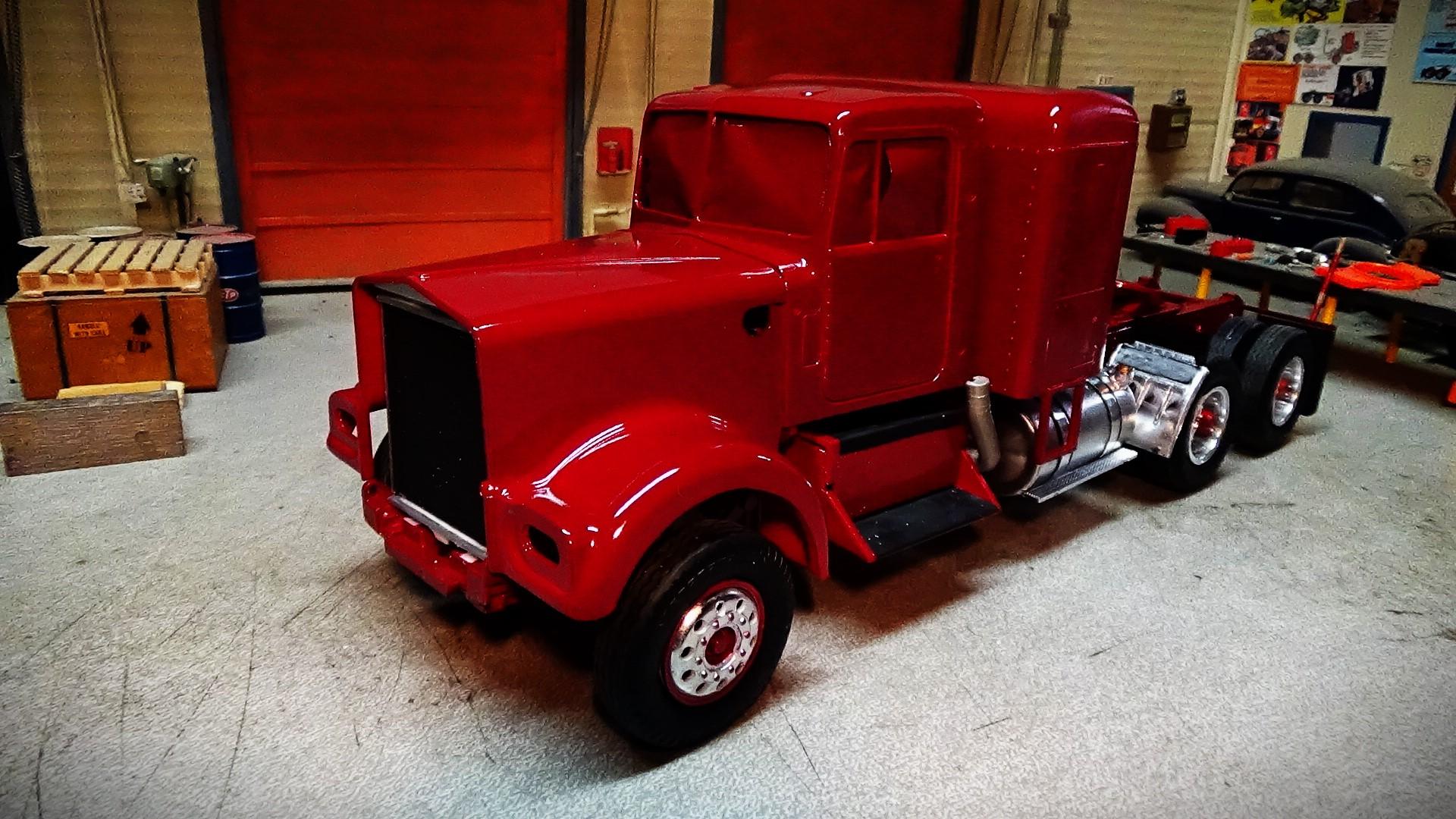

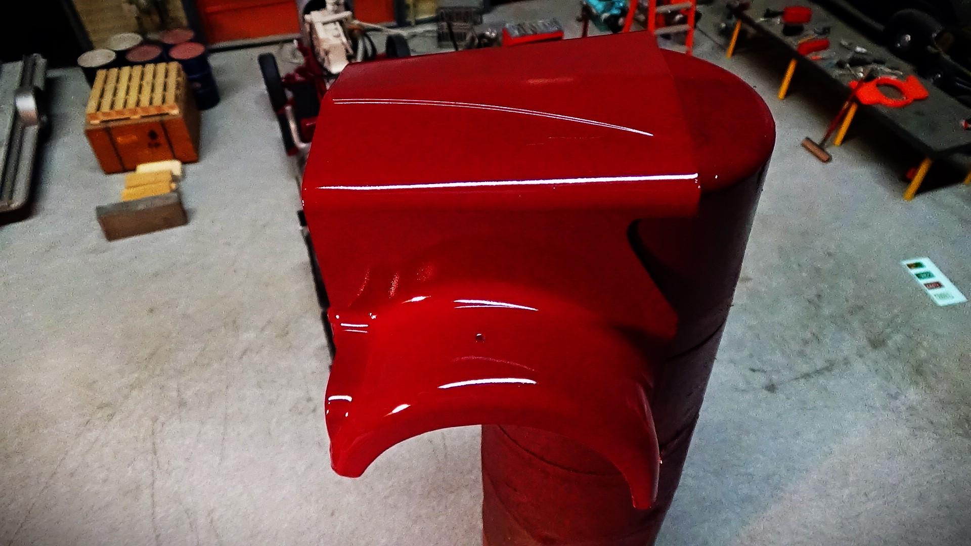

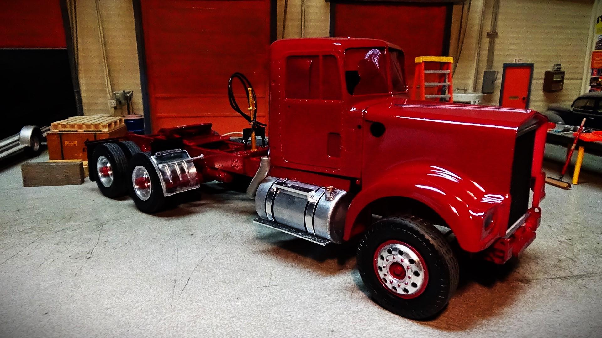

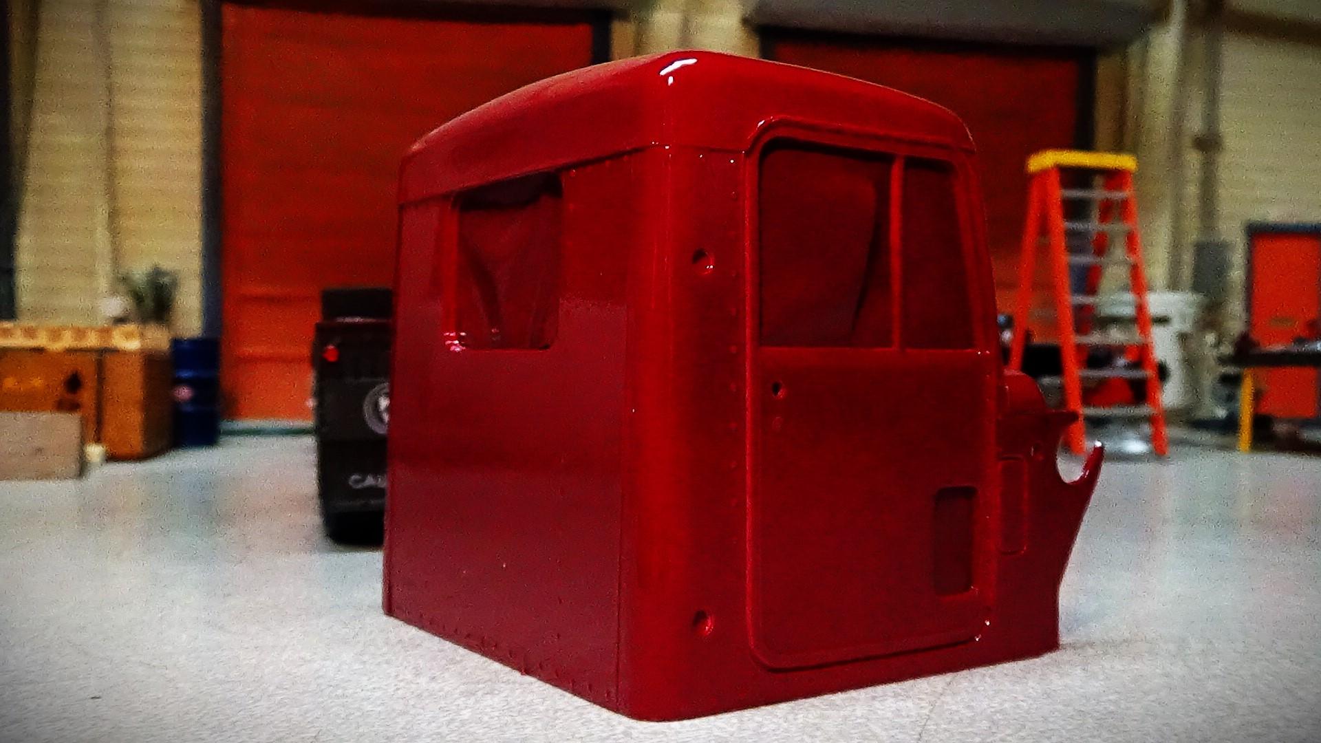

Bronzekeg Posted July 16, 2023 Author Posted July 16, 2023 got paint put on the hood and cab. they turned out pretty decent for a can of rust oleum spray. 2
Bronzekeg Posted July 16, 2023 Author Posted July 16, 2023 a quick mock up, I couldn't resist. it should look nice with stripes. 4
