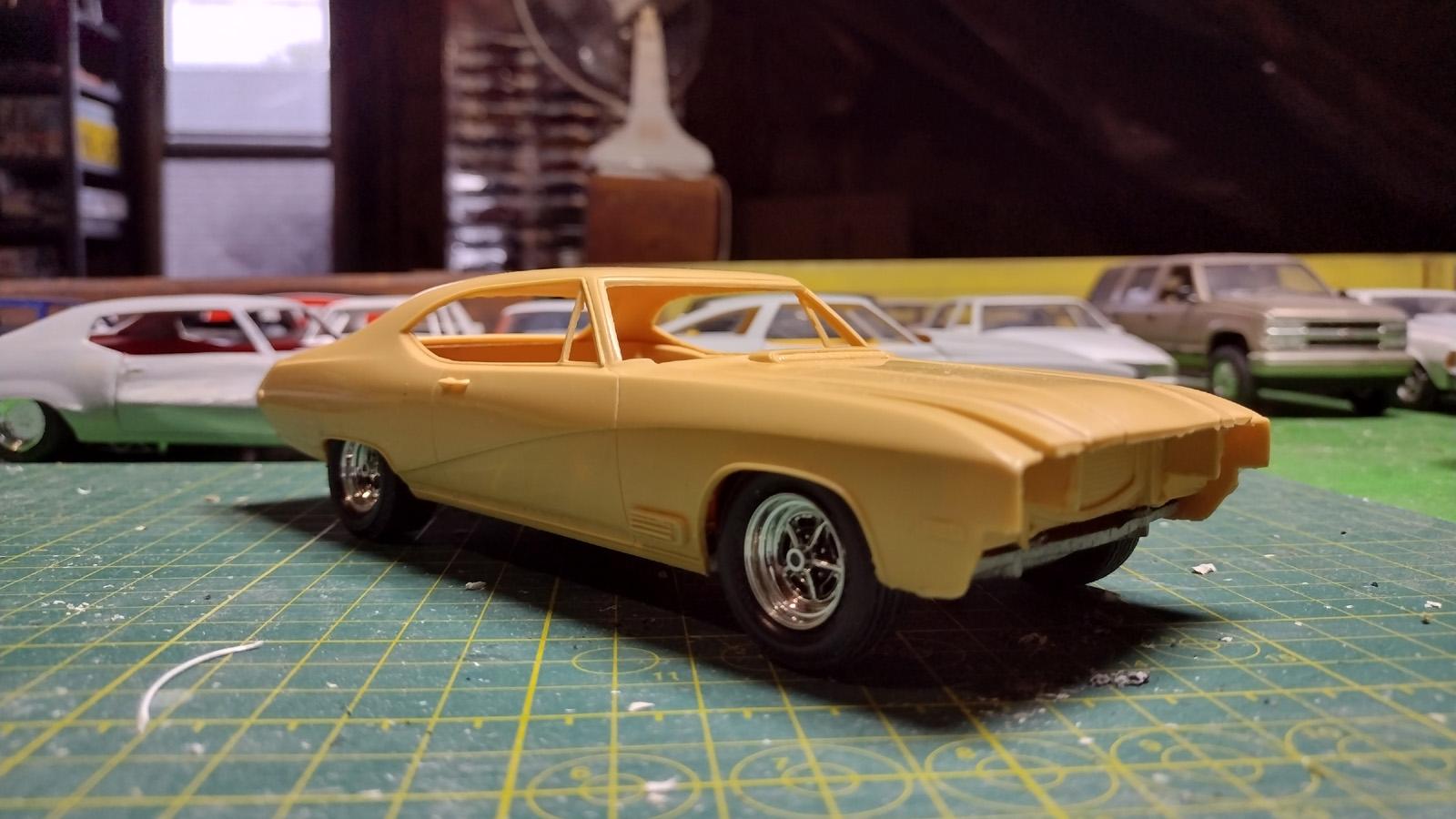

Daryl Romain Posted July 2, 2023 Posted July 2, 2023 Perry's Resin kit that I've had for decades. Amt 1966 Skylark dirt tracker chassis, because that's what I had. Monogram GSX rims. 2

Daryl Romain Posted July 2, 2023 Author Posted July 2, 2023 I'm pretty sure they went from 116" to 112 then, but I've found it doesn't show up in 1/25, or maybe I'm just making slight adjustments. Can't remember. This is an unaltered '66, although dirt track chassis, under this '68 body. That's what I had. If I were starting fresh, I'd use a 68 Chevelle donor. 1

Daryl Romain Posted July 4, 2023 Author Posted July 4, 2023 On 7/2/2023 at 7:02 PM, bisc63 said: Close; they went from 115" to 112". Less than 1/8" in 1/25 scale, so adjusting each end 1/16" would be pretty much imperceptible. On the other hand, the AMT '69 Olds kits (Hurst Olds, Cutlass 442) should be a perfect fit and have the correct BOP details, not to mention much better details than the older Chevelle kits. With prices like they are now, you can probably find one of these cheaper than a Revell '68 Chevelle. (Also beautifully detailed, but needing the BOP tranny cross-member) The Monogram 70 Buick GSX, though 1/24, might trim down as well. Any way, very cool project! Looking forward to you build. I used what I had on hand. I'm working on several projects at the same time. Under this '68 is going a '66 dirt track chassis. It fits without any adjustment. Maybe it shouldn't have, due to the 3" difference in the wheelbase, but it did. It is somewhat lacking in detail but I can remedy that somewhat. The '69 Skylark I have on order will get an Amt 70 Chevelle chassis and interior bucket. Again, that's what I have on hand. None of these cars is a 100% stock build. All are modified in some way, so I'm not going to be a real stickler for detail. 2
