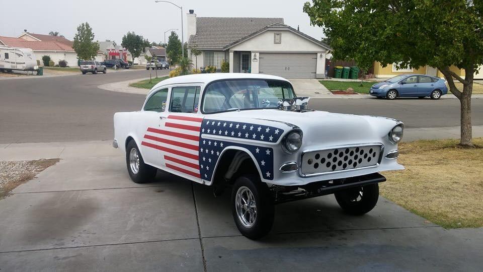

dwc43 Posted July 6, 2023 Posted July 6, 2023 Sorry for the bad pics, but it's all I have of this car. Yes, there is a firewall issue. I trimmed the hood tabs down a bit because they hit inside when you get everything mounted correctly. I forgot exactly what I did to it, but I had to do some trimming where the firewall meets and where the inner fenders meet at the frame. And if I recall correctly, I think it had more of an issue on the right side than on the left. But it does take a little work to make these kits look nice, but it can be done. 2
bluestringer Posted July 6, 2023 Author Posted July 6, 2023 I checked mine and yes it looks like it will be a problem. I'll try to sort it out. Meanwhile the engine is done and I got primer on the body. I'm not liking the headers much, look too cartoony, but I didn't have anything else. 1
dwc43 Posted July 6, 2023 Posted July 6, 2023 The bad thing about it, is that the injection scoop won't stick through the hood either. So, that's why I went carbed under the scoop. I think that's B Gas class.
larman Posted July 6, 2023 Posted July 6, 2023 Keep in mind, this kit is VERY old, the original dating to 1963 (IIRC), and has been produced nearly perpetually since then in the form of the Badman and Street Machine kits. The original is actually pretty nice, especially if you build it as the convertible. The Badman and SM kits appear to have chopped tops and the rear roof pillars are too wide, they are "cartoony" and were made for kids. In fact, nearly everyone I know in the model car world has built at least one in their modeling lifetime. That is why the Badman is beloved and people actually build real cars to emulate the kit! My advice is to just take this kit for what it is, if you want an accurate '55 hardtop, get a newer issue Revell kit (not the crappy one with opening doors!) they are super nice. That said, there are some easy things to do to improve the finished look of this kit: Open the rear wheel wells so they are higher. Use taller tires all around with appropriate mags. Make sure the rear tires fill the wheel wells and lastly, thin out the rear posts on the top. Thats what I am going to do with mine, anyway.
