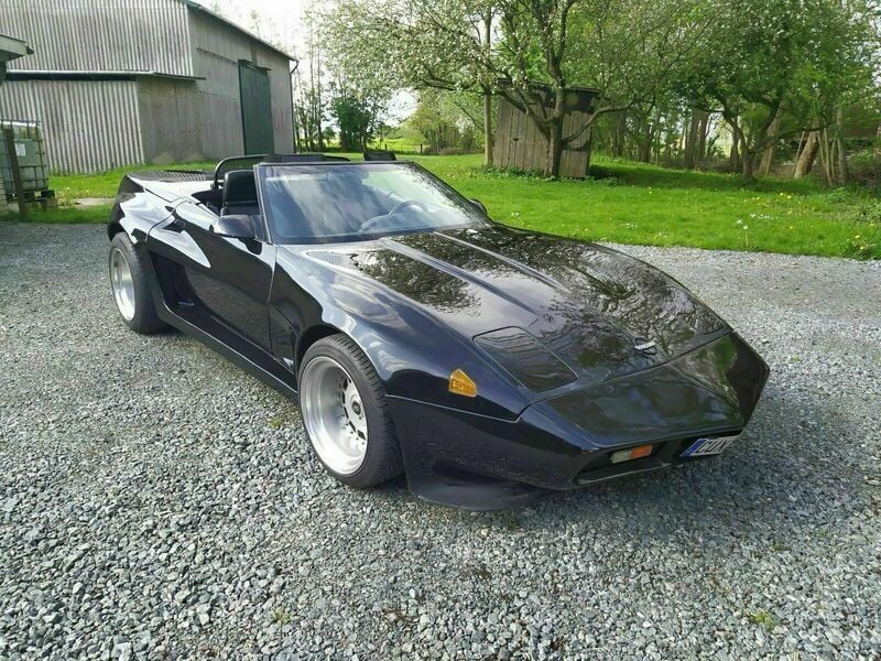

Just spectacular watching your build! Is this an actual car you are replicating, or something out of your imagination? Either way, too cool!
This is one of the cars I use as reference. Always liked this widebody style since I saw it for the first time back in the early 90s.
Verkauft Chevrolet Corvette C4 Cabrio ., gebraucht 1990, 68.000 km in  Cuxhaven
Pic from: https://www.autouncle.de/de/d/127307102-gebraucht-chevrolet-corvette-c4-cabrio-original-geiger-zr1-bre
