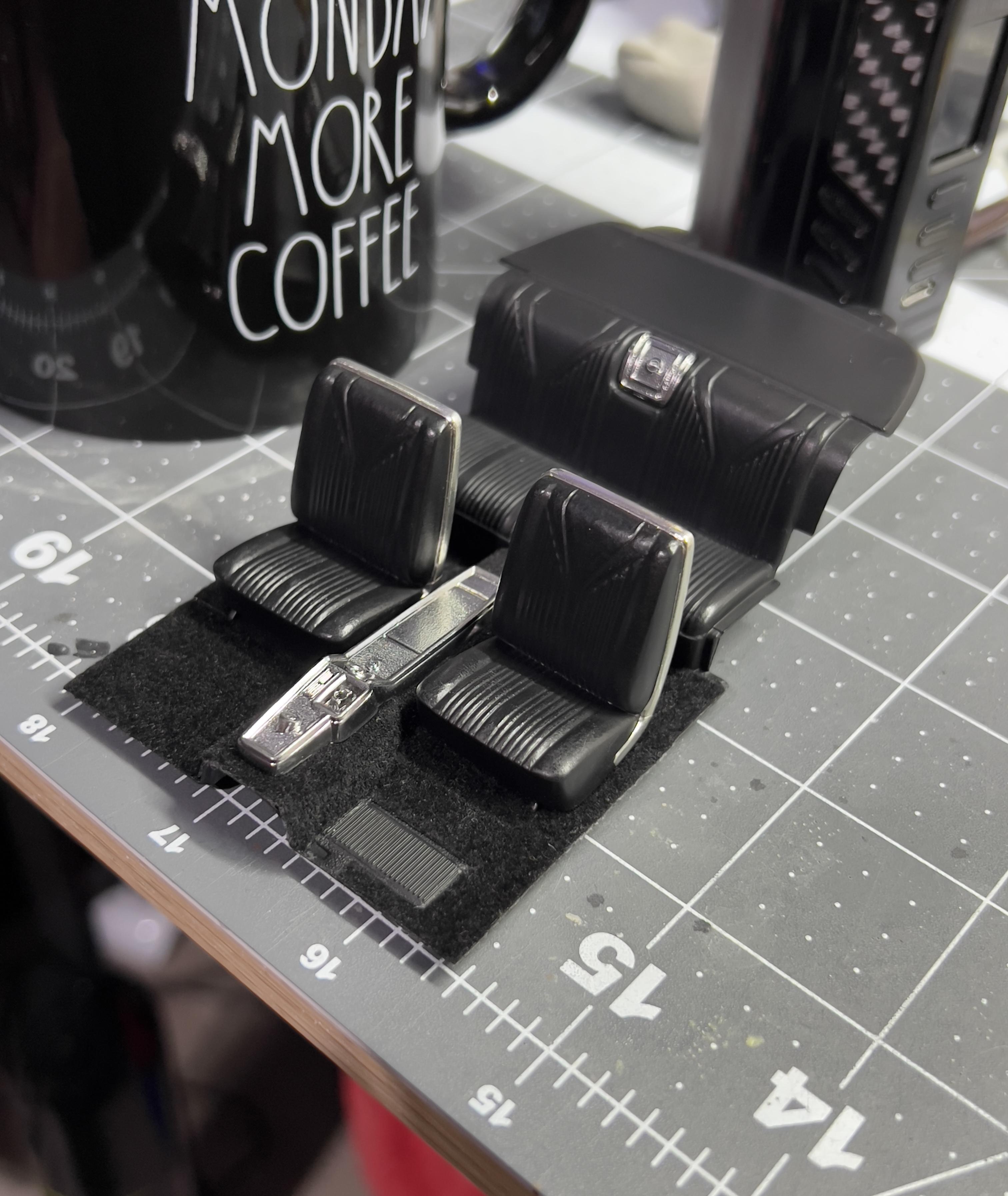

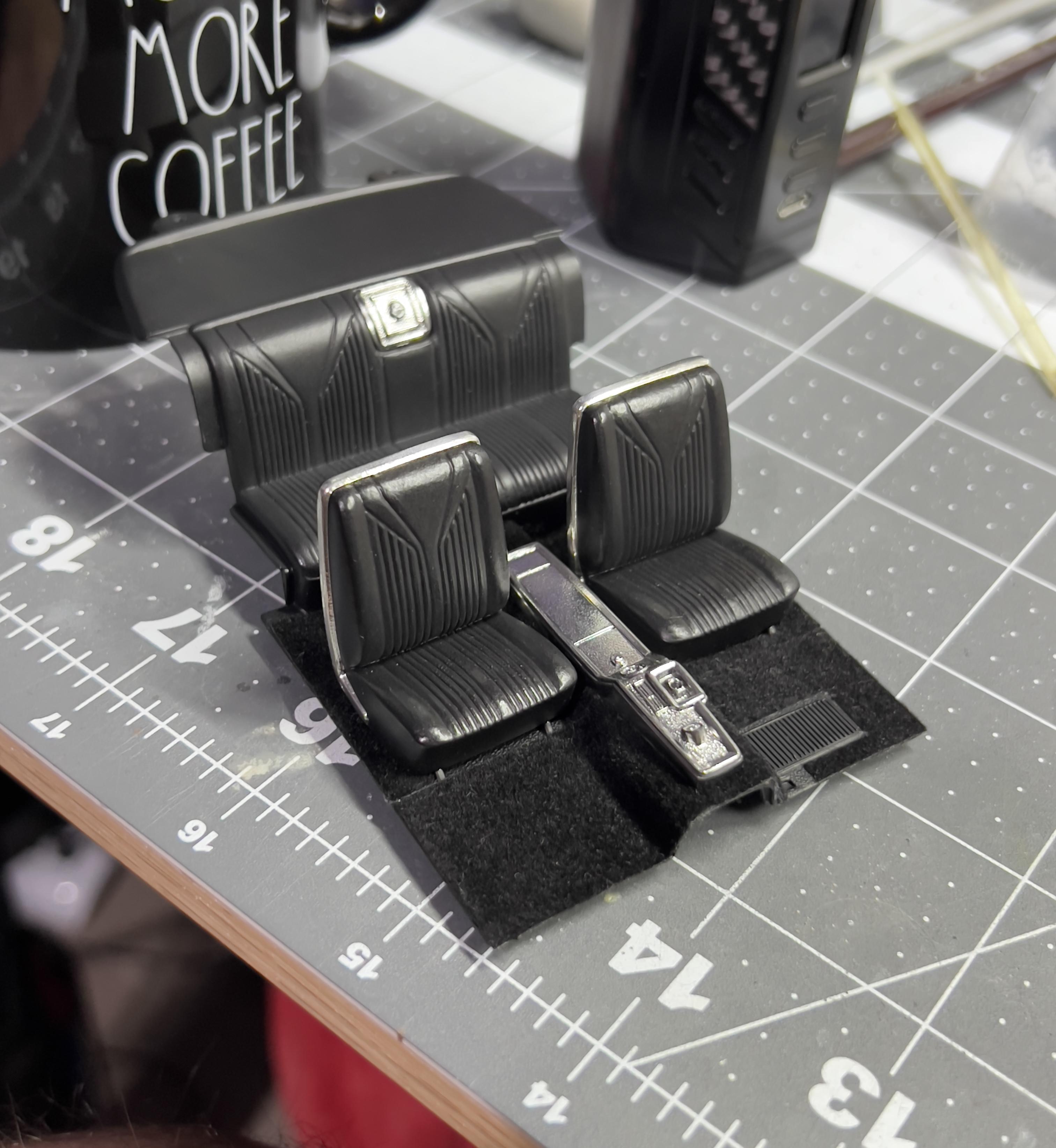

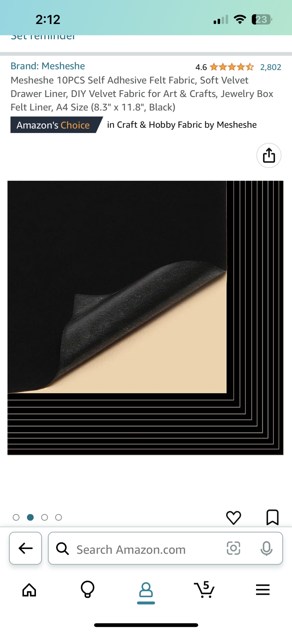

Dpate Posted July 11, 2023 Posted July 11, 2023 (edited) I was doing embossing powder, but I could never get good results with it on non flat services. So I started using the stuff they use to wrap jewelry boxes etc. stuff comes in lot of colors, and it very thin easy to cut, and sticks really good. Whether or not it looks real or not is mute to me - because isn’t no one looking at a fully built model like MAN that carpet look good - unless it’s convertible or something, but still get ya priorities straight lol. Edited July 11, 2023 by Dpate 2
Bills72sj Posted July 11, 2023 Posted July 11, 2023 35 minutes ago, Dpate said: I was doing embossing powder, but I could never get good results with it on non flat services. So I started using the stuff they use to wrap jewelry boxes etc. stuff comes in lot of colors, and it very thin easy to cut, and sticks really good. Whether or not it looks real or not is mute to me - because isn’t no one looking at a fully built model like MAN that carpet look good - unless it’s convertible or something, but still get ya priorities straight lol. That sounds MUCH less messy. Where do you get the stuff? 1
Dpate Posted July 11, 2023 Posted July 11, 2023 (edited) 1 hour ago, Bills72sj said: That sounds MUCH less messy. Where do you get the stuff? I got mine from Amazon. Different brands and different colors. But $9 for a 10 pack so enough to do tons n tons of models. I know lot of folks don’t like the look, but done right with better cutting than I did I think it looks the part for what it is. Edited July 11, 2023 by Dpate

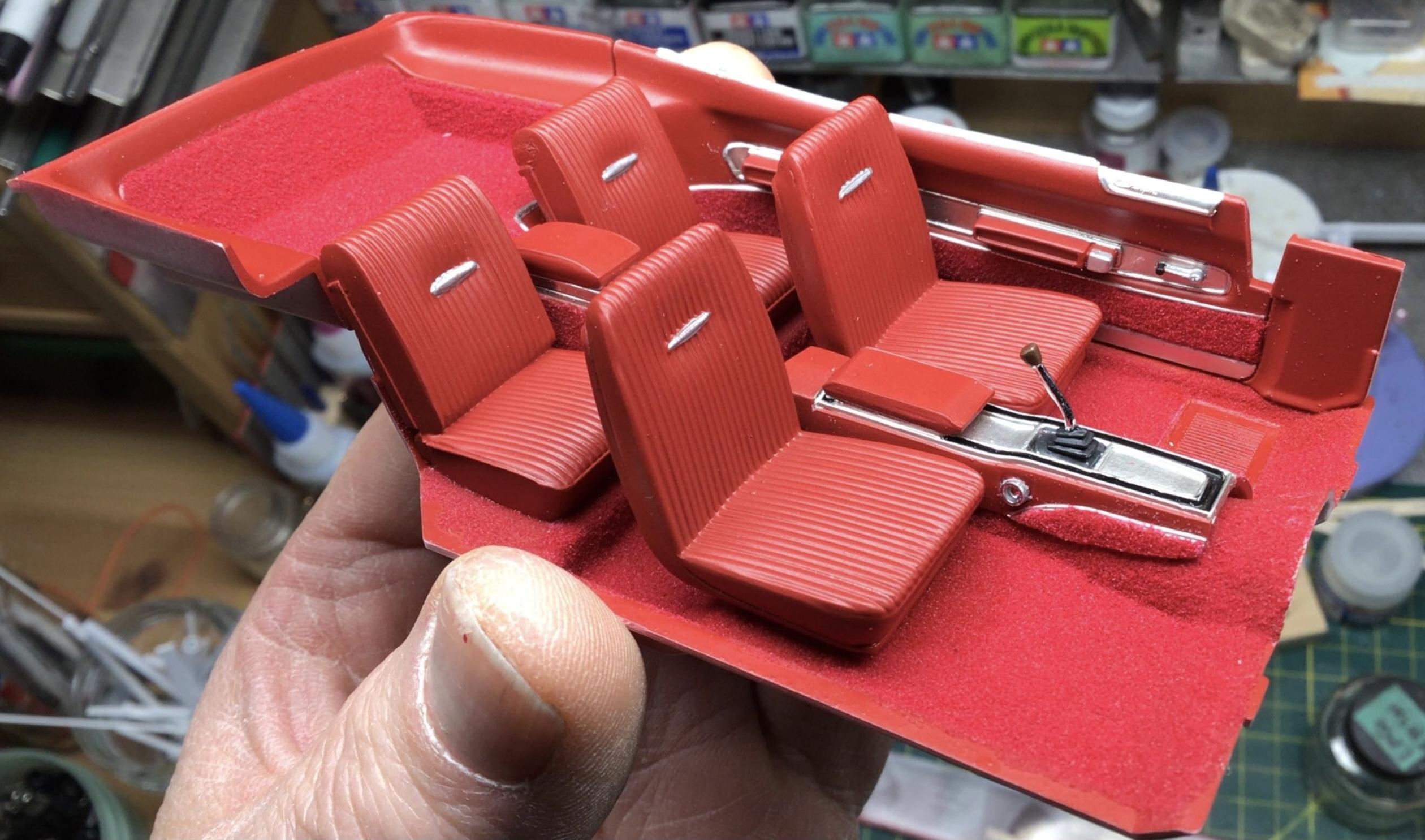

StevenGuthmiller Posted July 11, 2023 Posted July 11, 2023 (edited) Another one done with white glue and embossing powder. Steve Edited July 11, 2023 by StevenGuthmiller 3
