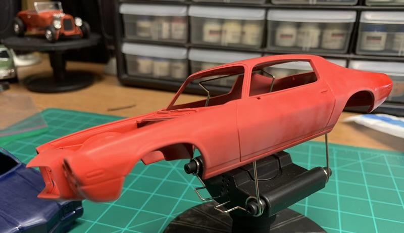

atomicholiday Posted July 11, 2023 Posted July 11, 2023 Quick question about Dupli Color perfect match. I just reshot my 70 1/2 Camaro and the finish came out smooth but blushed pretty badly. I’ve done some research here and elsewhere online, and know that humidity is the issue. In this particular case I don’t think it’s the outside atmosphere but a different cause I’ll explain in a minute. My question is, can I continue adding coats as usual, or do I have to sand or strip the paint? It’s smooth, without excessive orange peel. Just looks milky. What are my next steps? So here’s the root cause (and I won’t do this again). I’ve sprayed this exact color before without issue, but this is a brand new can. Don’t think that’s the problem. Outside it’s sunny, 85 degrees, and humidity is only 48 percent. I’ve sprayed this stuff in higher humidity without issue. Here’s where I believe it all went wrong. Watching a video from a well respected model builder, he recommended washing your model, and then drying it with a hairdryer (low heat) and painting immediately, to avoid dust collecting on it. I don’t believe his advice is wrong. He’s won many awards. But I do wonder if there might not be more to it. I followed this advice, drying the model until no visible moisture could be seen anywhere. My theory is that there must have still been some moisture (microscopic particles) on the surface.
moparfarmer Posted July 11, 2023 Posted July 11, 2023 If you've got blushing and some not so shiney spots a polish job usually fix that problem.
StevenGuthmiller Posted July 11, 2023 Posted July 11, 2023 Blushing is not a problem at all with Duplicolor paints. It happens quite often. you don’t need to do anything to correct it in order to shoot more coats. You don’t even have to do anything to it in order to clear coat. The clear coat will eliminate the problem. If you’re not using a clear coat, and you still have some blushing after your final color coat, just polish it a little as Wayne suggested. Steve 2
Rick L Posted July 11, 2023 Posted July 11, 2023 As a general rule, don’t spray rattle cans if the dew point is within 20 degrees of the ambient temperature. If you’re mixing paint you can add retarder.
Ace-Garageguy Posted July 12, 2023 Posted July 12, 2023 2 hours ago, StevenGuthmiller said: Blushing is not a problem at all with Duplicolor paints. It happens quite often. you don’t need to do anything to correct it in order to shoot more coats. You don’t even have to do anything to it in order to clear coat. The clear coat will eliminate the problem. If you’re not using a clear coat, and you still have some blushing after your final color coat, just polish it a little as Wayne suggested. Exactly.

atomicholiday Posted July 12, 2023 Author Posted July 12, 2023 2 hours ago, StevenGuthmiller said: Blushing is not a problem at all with Duplicolor paints. It happens quite often. you don’t need to do anything to correct it in order to shoot more coats. You don’t even have to do anything to it in order to clear coat. The clear coat will eliminate the problem. If you’re not using a clear coat, and you still have some blushing after your final color coat, just polish it a little as Wayne suggested. Steve Awesome. That's what I was really hoping to hear. 39 minutes ago, Muncie said: Thinking out loud... it may have been dry, However, the temperature of the water you used, or the temperature of the blow dryer may have changed the temperature of the model - there may have been too much difference between the model and temperature of the air or the temperature of the paint. It may take more time letting things sit between washing and painting to let everything get to the same temperature. You may be right. I used low heat, but it still warmer air than outside atmosphere. It would have had about 10-15 minutes to cool while the paint was warming up, but who knows. Thanks all for your quick replies.
StevenGuthmiller Posted July 12, 2023 Posted July 12, 2023 (edited) Duplicolor “Perfect Match” touch-up paints are extremely fast drying, which can ultimately trap a little moisture, which is the cause of blushing, and I’ve had this phenomenon happen virtually every time I’ve used it, regardless of the conditions at the time of spraying. It’s just kind of the nature of the beast. I’ve learned to ignore it because it’s absolutely nothing to worry about, and it will have no affect on the finished job whatsoever. Steve Edited July 12, 2023 by StevenGuthmiller 1 1
Bills72sj Posted July 12, 2023 Posted July 12, 2023 It has been awhile since I used Duplicolor. When I got blushing. I just recoated it later or simply clearcoated over it. 1
atomicholiday Posted July 12, 2023 Author Posted July 12, 2023 I’ve shot Dupli Color three times before but this is the first time I’ve seen blushing. Finally a paint problem I can ignore!?

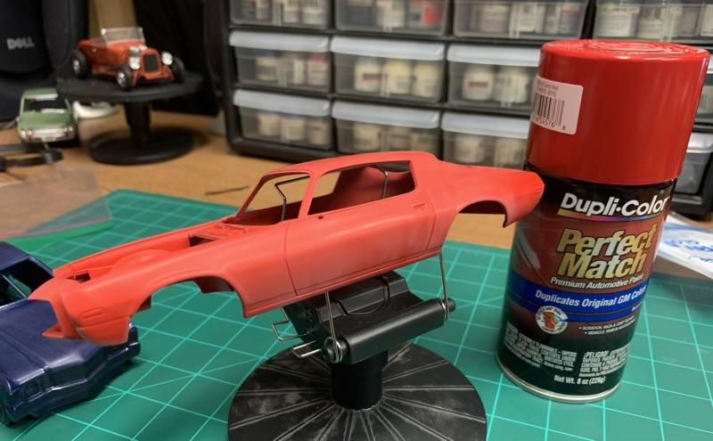

atomicholiday Posted July 16, 2023 Author Posted July 16, 2023 It looks like this. This is GM torch red. It should look just like the cap on the paint can.
Chariots of Fire Posted July 16, 2023 Posted July 16, 2023 Another experience with Duplicolor is that the more coats you put on, the brighter the color gets. Not saying it should be put on heavy but 3-4 coats is probably a good number. Duplicolor is a very fine spray that allows it to be done that way. Polish out the foggiest after the last coat. You should get super results. Never try polishing it out between coats or you will have a real mess on your hands. The paint will draw and bead up and Duplicolor is a hard paint to strip. 1
StevenGuthmiller Posted July 16, 2023 Posted July 16, 2023 1 hour ago, atomicholiday said: It looks like this. This is GM torch red. It should look just like the cap on the paint can. Yup. That's it. Steve
