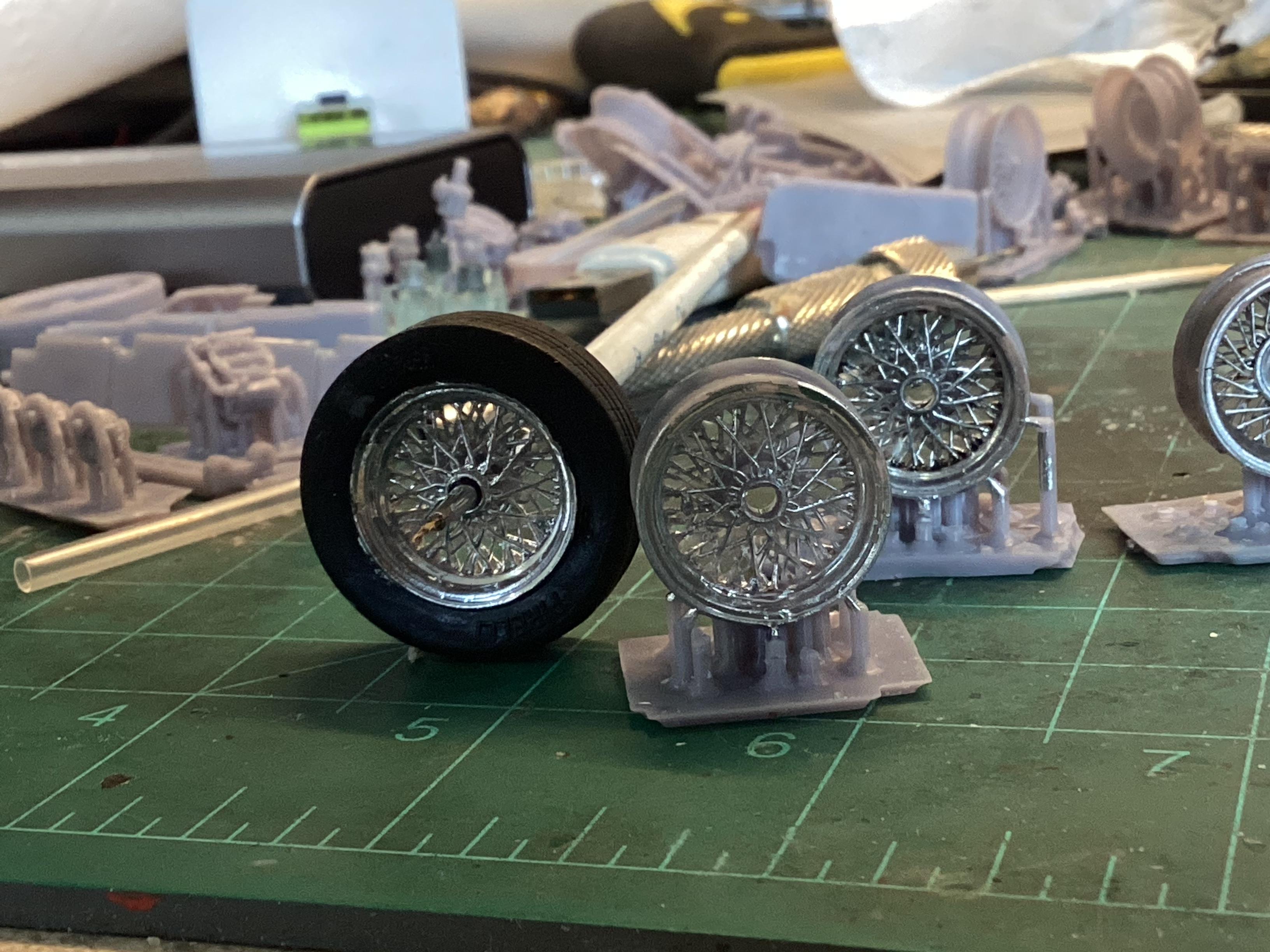

I have these 72 spoke Borani style wheels.  These I painted these with Molotov chrome paint.  Can print with or without tires.  A tip:  plan to have some kind of support for your model.  Resin wheels are delicate and will eventually start to distort with the weight of the model

Just a followup on the comment by Bugatti Fan.   These wheels are not resin cast, they are 3D printed.   The individual spokes are less than a third of a millimeter thick.   When I print them I have to be so gentle because before they are cured, just rinsing them off in water can break spokes.    I haven't seen any deformity issues with them yet, but I have seen 3D printed front tube axles sag after several months on the shelf so I wouldn't be surprised if these wheels sag after time.   These spokes are much thinner than any other wheel I have seen.
