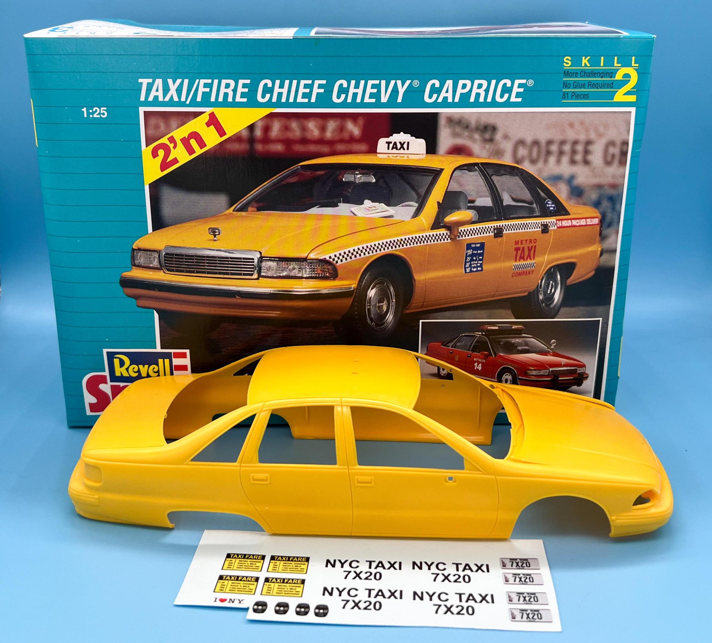

I picked up one of these kits at a model show last year, and this project has been rattling around my brain for long enough…
Actually, I got taken on the first one of these I picked up - it was sealed with tape and allegedly complete…and it was, besides the interior pieces, chassis, a tire…some crucial stuff like that.  Still, I was impressed enough with the quality and detail of this self-proclaimed Snap Kit that I REALLY wanted to build one, so I picked up another, designed some decals and here goes nothing…
As any model builder knows, following the directions is CRITICALLY IMPORTANT, and step one was gluing the engine halves together:
Once I’d done that, I lost interest in following the directions and jumped ahead to painting the body ?

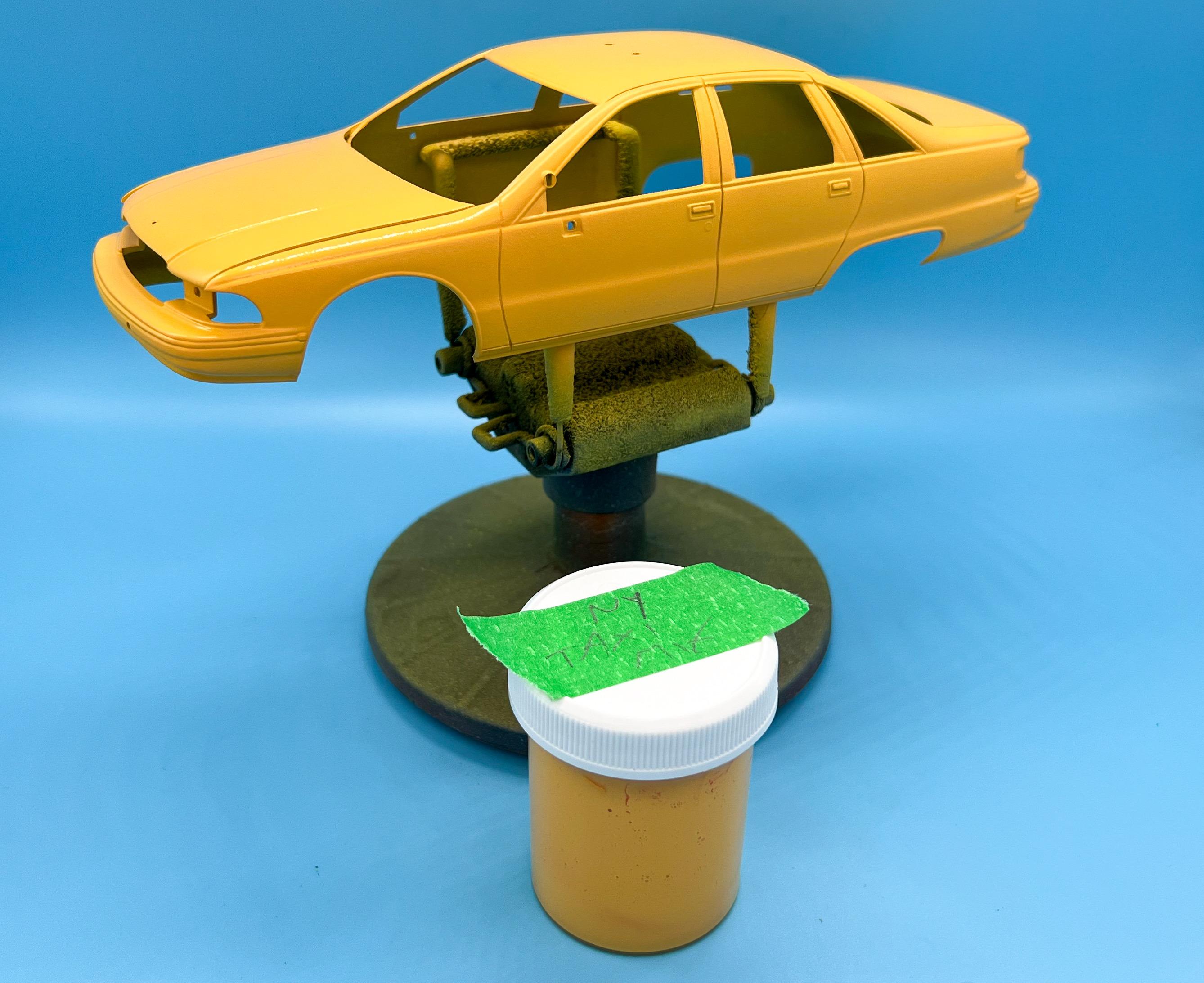

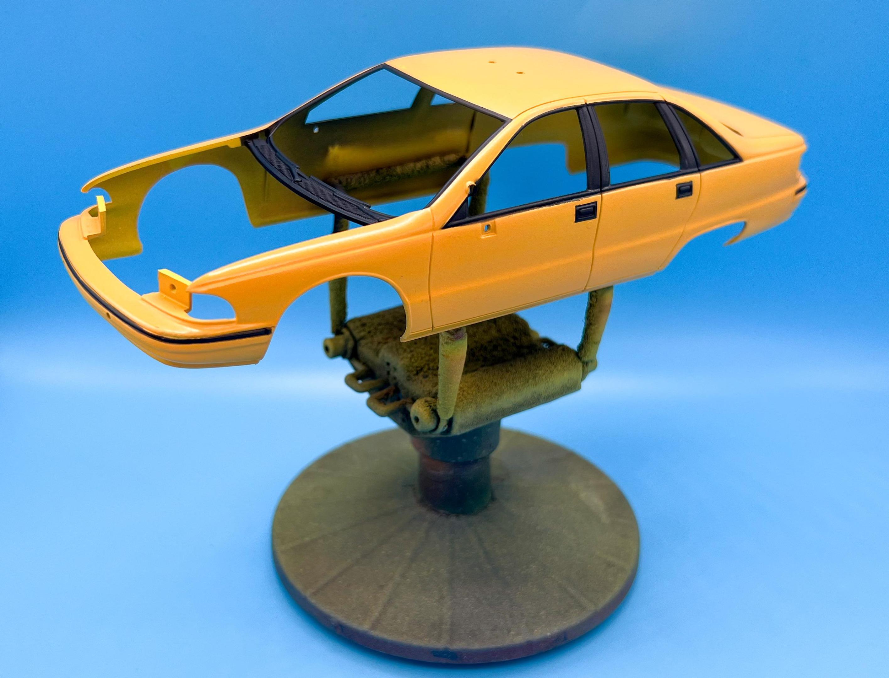

I regularly (daily, in fact) use a Pantone swatch book for my work; a Pantone book is a color chart used most commonly in the print industry to match colors, and when I was still living in NY I made notes of various colors in the city’s color palette for projects like this.  Having that reference number allowed me to mix up some Createx to get really close to the proper 90s NY taxi color:
Whilst that was drying, I got back to what I was meant to be doing and prepped and painted some engine components (more on those after the weekend, most likely):

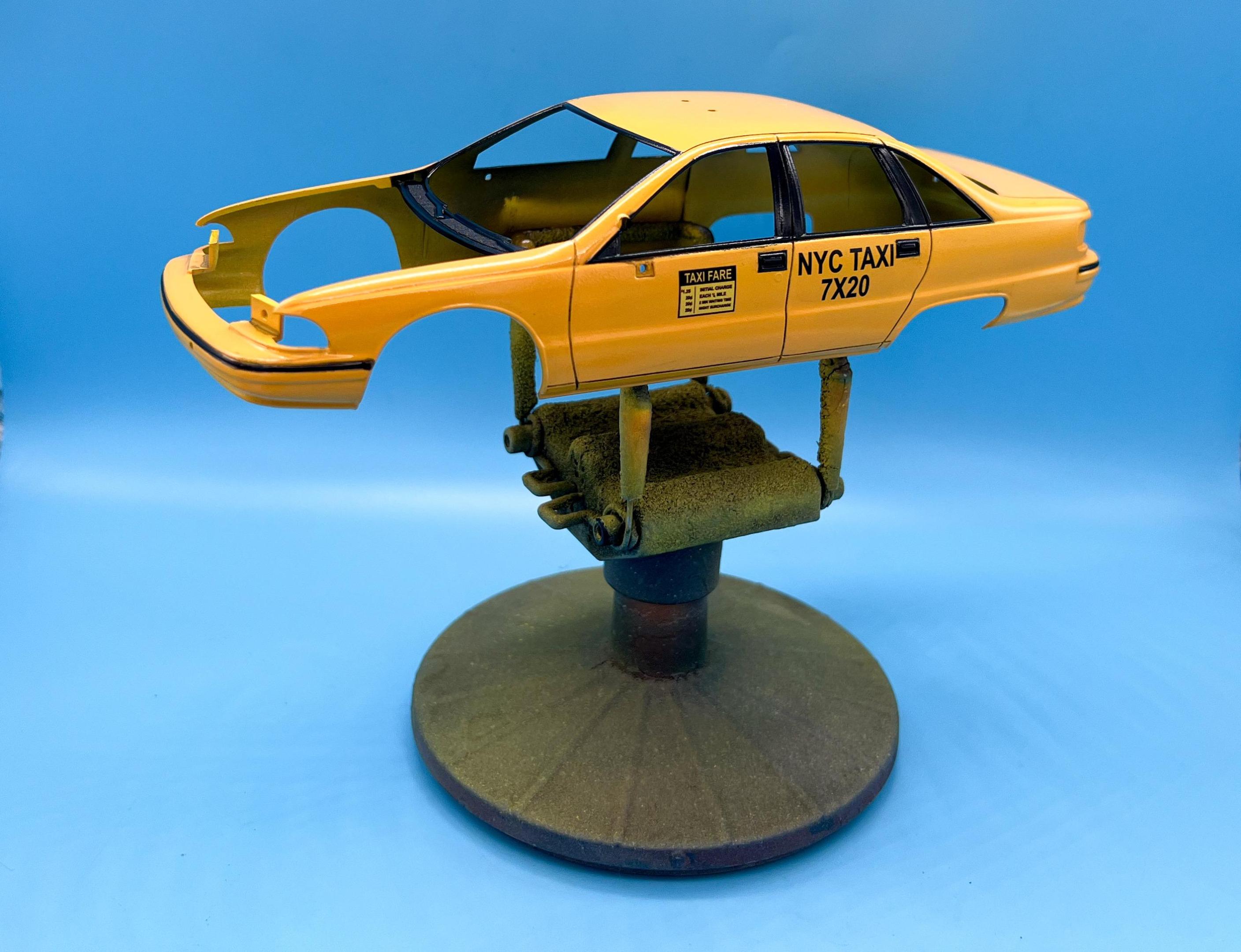

And then last night I spent a ‘fun’ hour masking up the body to shoot the black trim:
I like Createx black for projects like this - it shoots super smooth and clean, clean-up is easy and you can touch in any flaws with a brush.  Just a little clean-up required here and then I’ll shoot some intercoat before the next steps.
And…that’s about as far as I got so far…not a bunch of progress so far but I’ve got the idea in my mind that this one will be realistically used and weathered but not TOO much…a nice clean cab still, fairly early into it’s probably-long career.
More soon, soon as I’ve done more!

I will do!  So far it was gray primer, a yellow base, the ‘actual’ yellow, then a light coat of clear lacquer to seal it in, followed by Createx for the black.  I’ve got some more steps to do when it comes to the weathering tho.  I’d bet there’s more taxi cab kits out there, but I’m no expert…

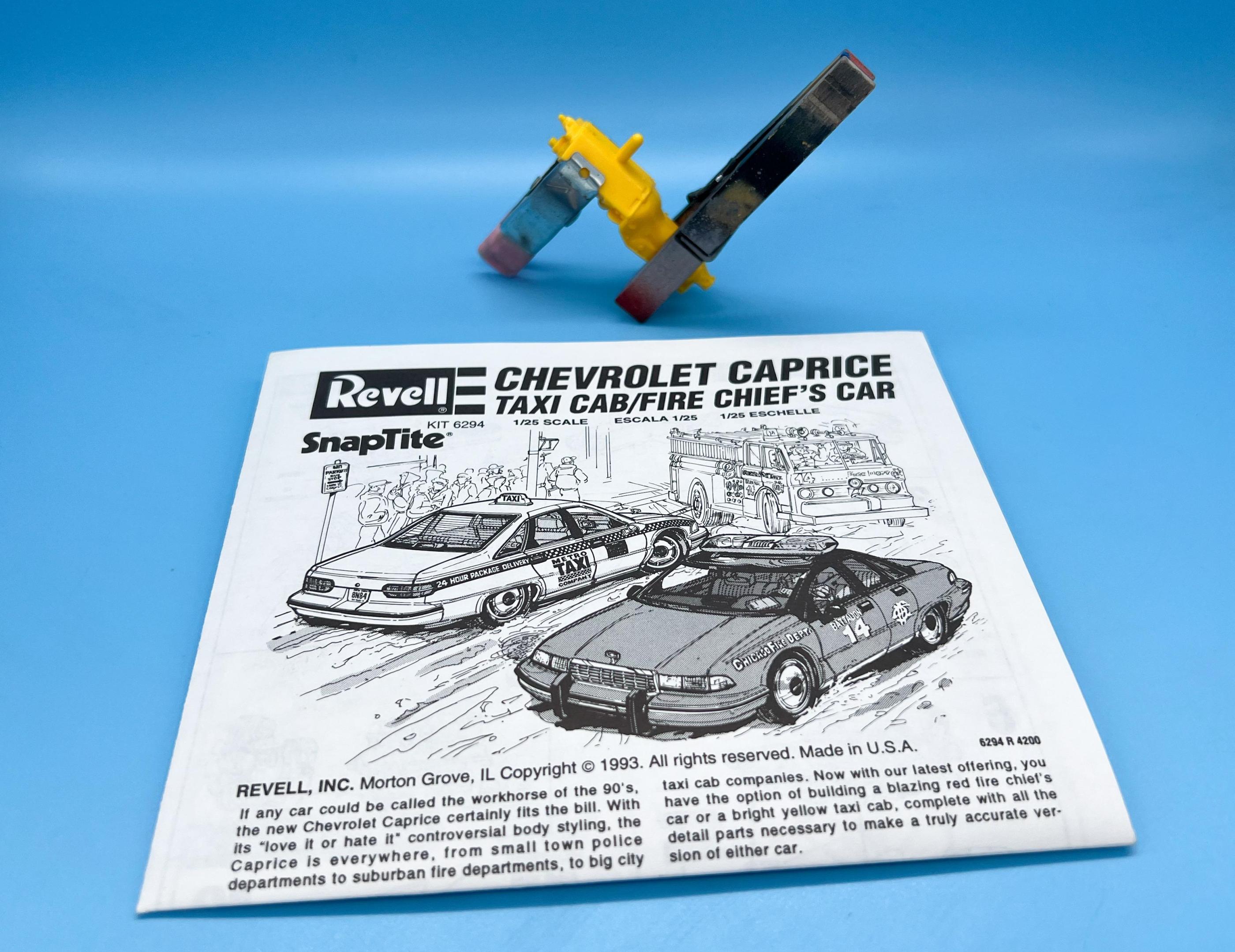

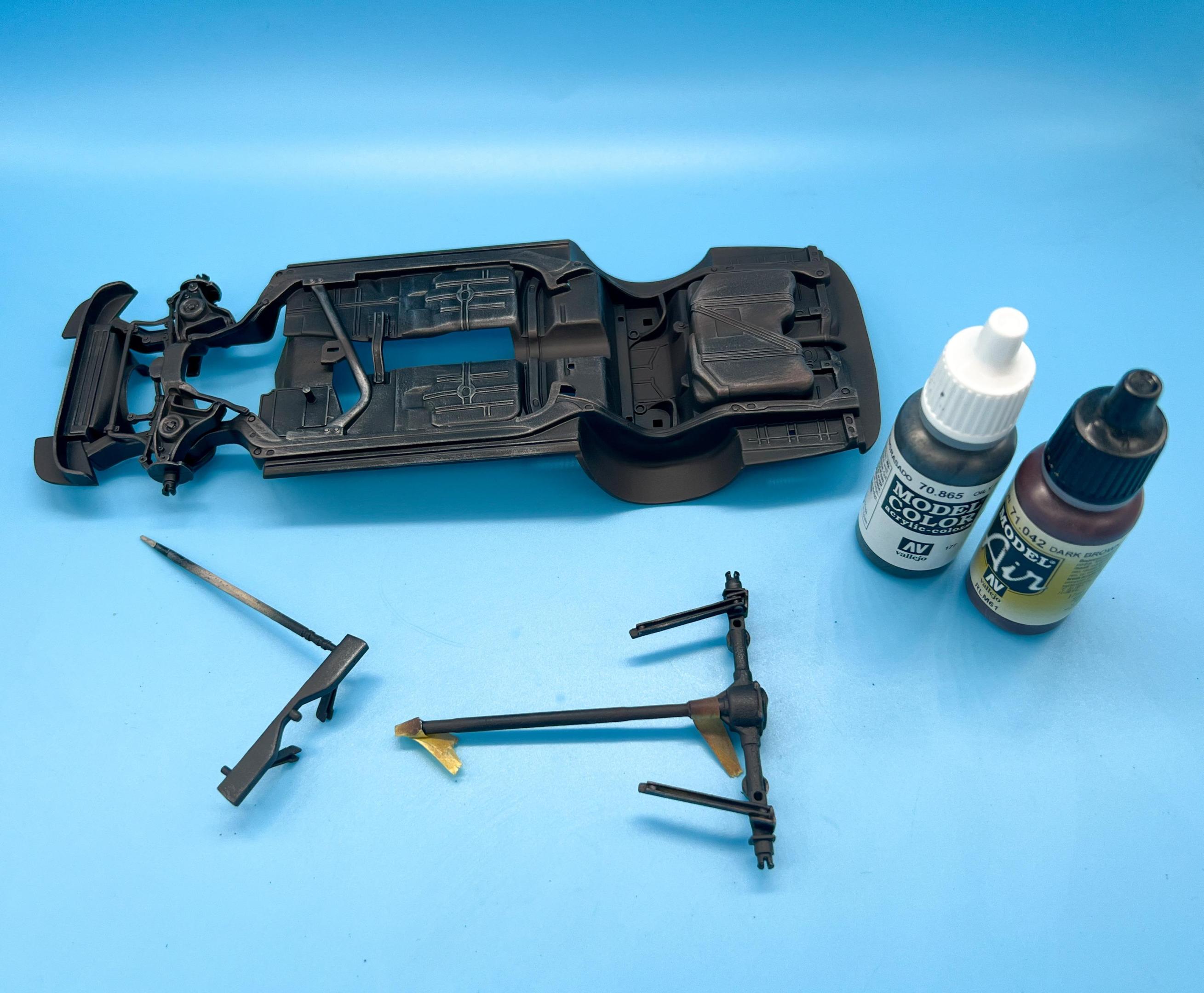

A little more progress today…
Applied the decals I had printed, and ran some Tamiya panel line into the panel gaps…

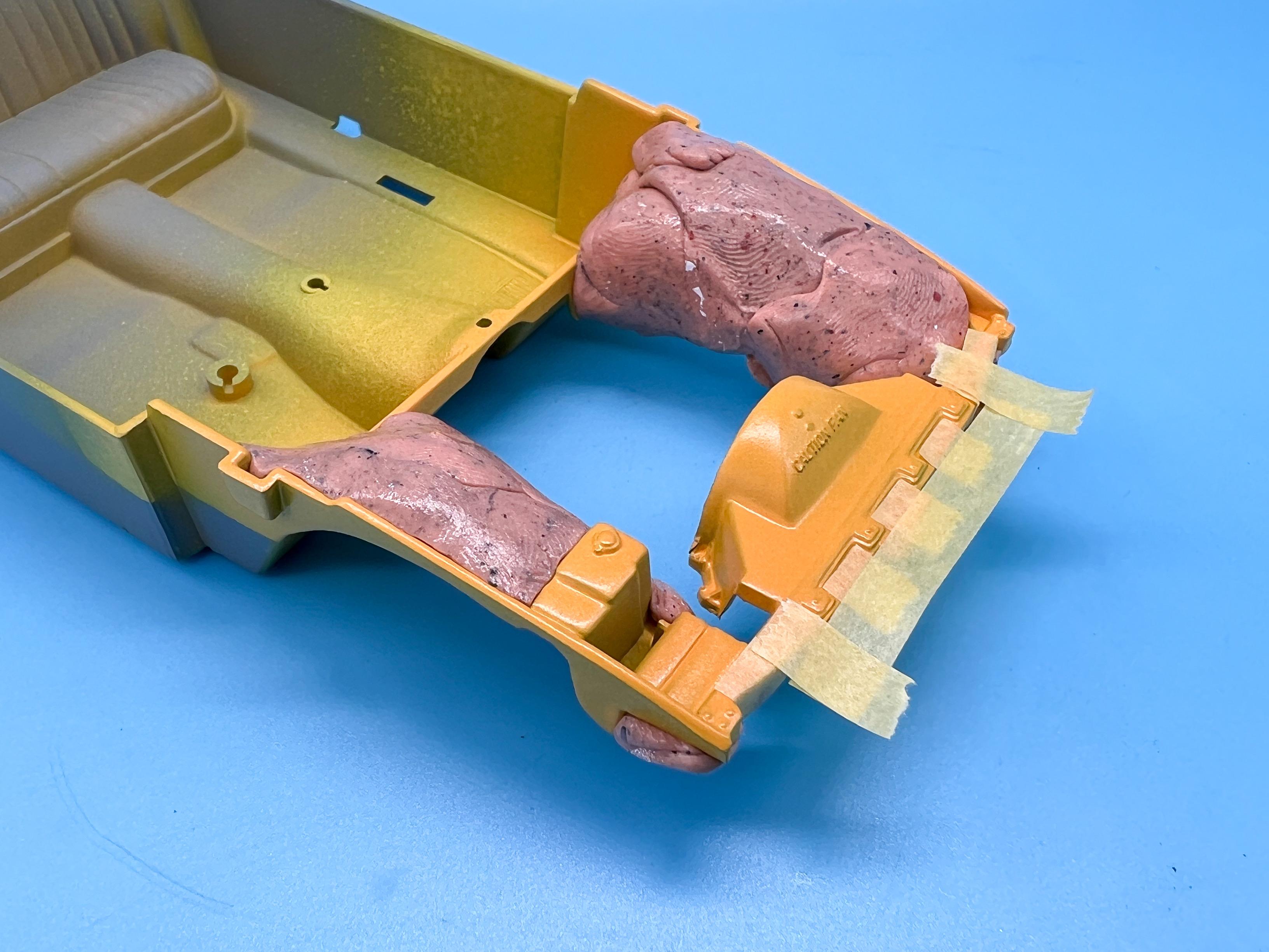

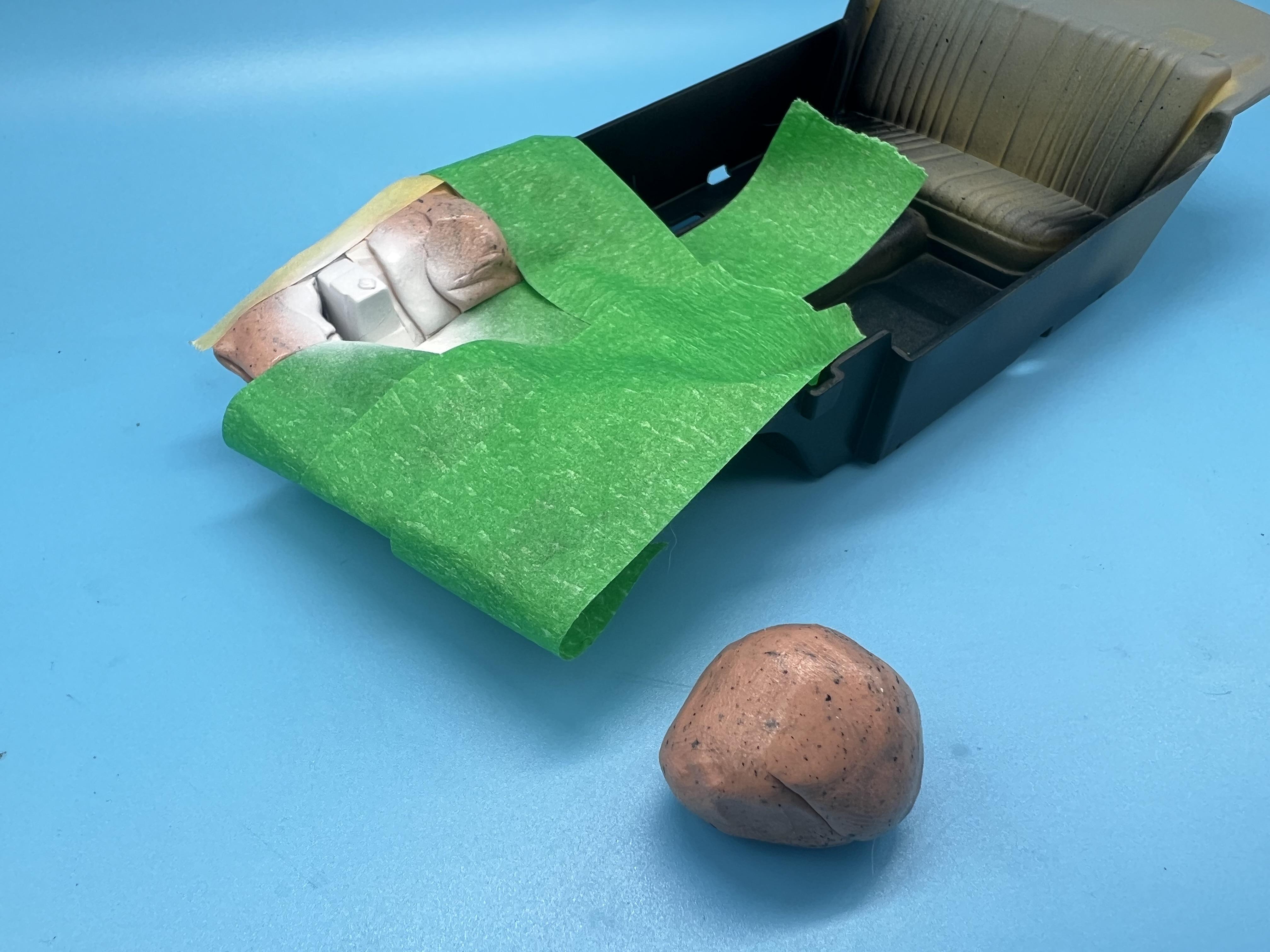

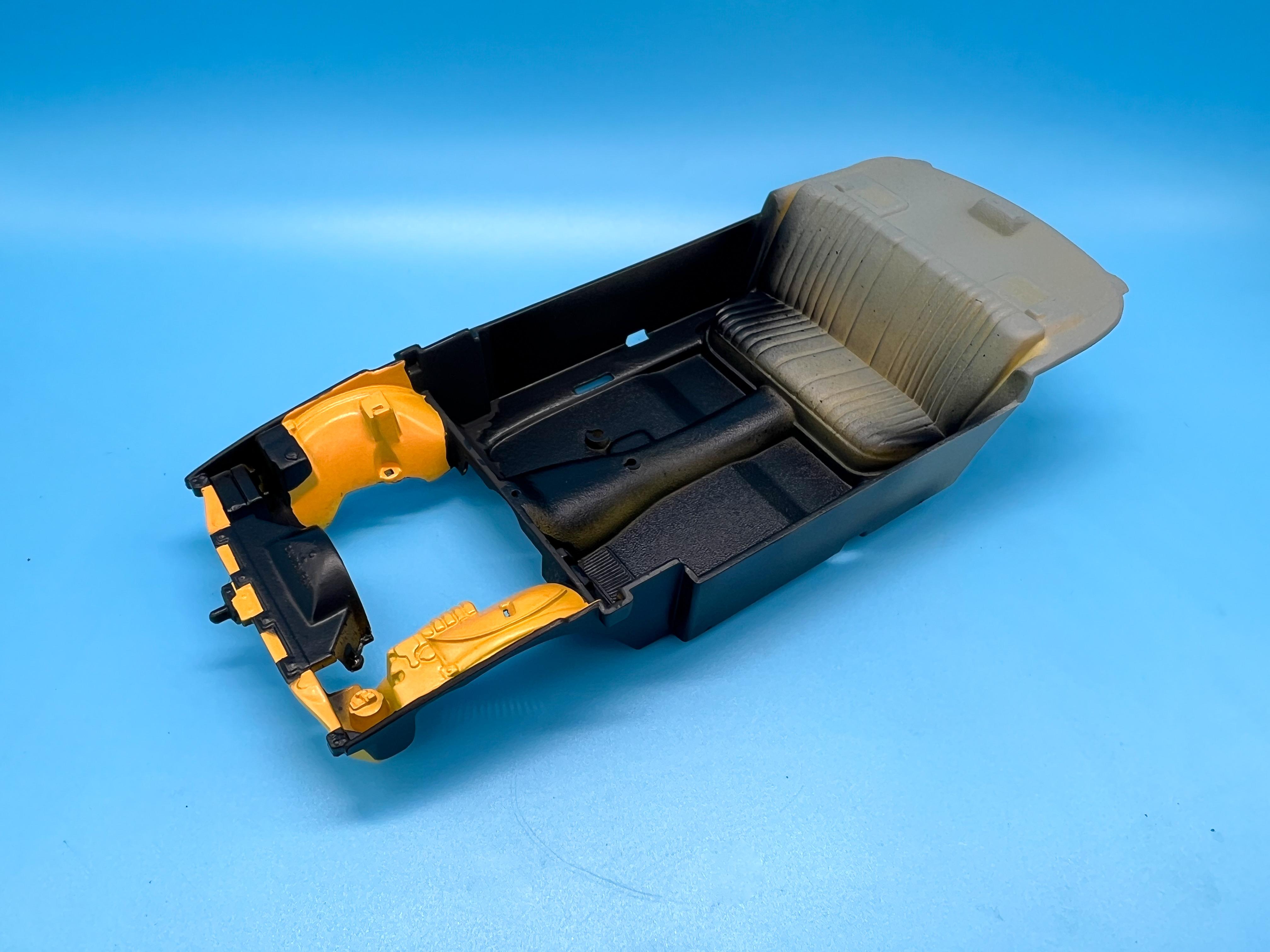

The engine bay needs a few stages of painting and masking to get all the details correctly painted, so I did the next step on that today.  Silly Putty is a LIFESAVER for masking tasks like this…
As you can see, the engine bay is also the interior tub, so this part is going to get a bunch more attention before I’m done…

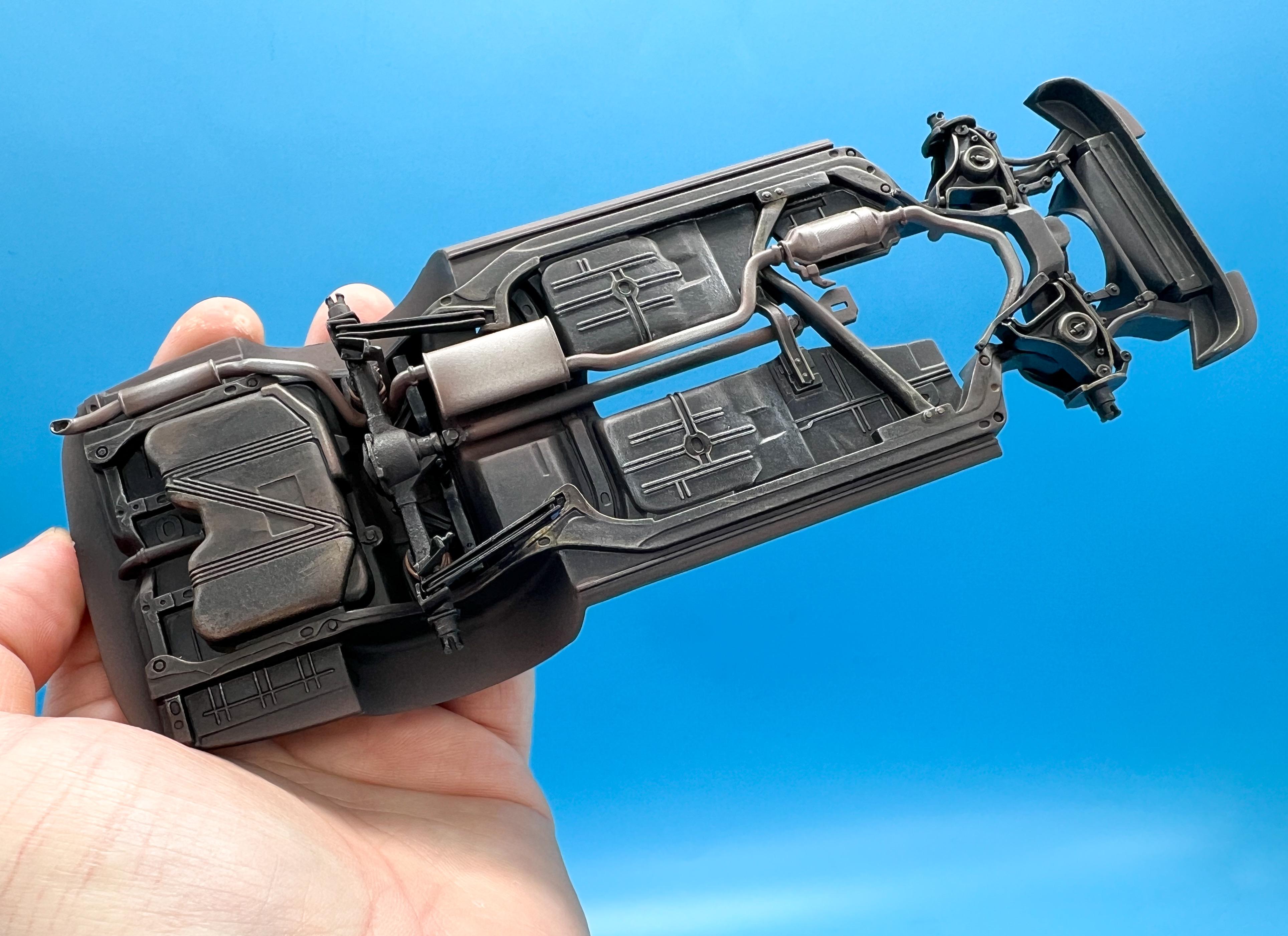

And I got the frame into paint…I’m going for used-not-ruined as my guide for the weathering on this project, but bad as the five borough’s streets are, even a fairly new car is going to get beat on pretty hard…first step was Createx black, followed by a healthy dose of drybrushing and then a little airbrushed Vallejo brown to bring out some of that nice detail:
Then, once that was all dry, I used some washes and did a little more airbrushing to add some visual interest…I’m pretty pleased with how the frame turned out!  The exhaust got much the same treatment; Vallejo dull silver with a couple of shades of brown airbrushed to add some grime and wear:
I’m excited to see these bits all together…but I forgot to paint a couple of the suspension pieces so that’s on hold for now…
And, that’s about the progress for today…plenty more to do…more soon, soon as I’ve done more!

This Caprice Taxi is really taking shape well and will really look the business when finished.
I have been modelling since way back over 50 years but would never have thought to use 'Silly Putty' material as a flexible masking medium. Just shows. You live and you learn!

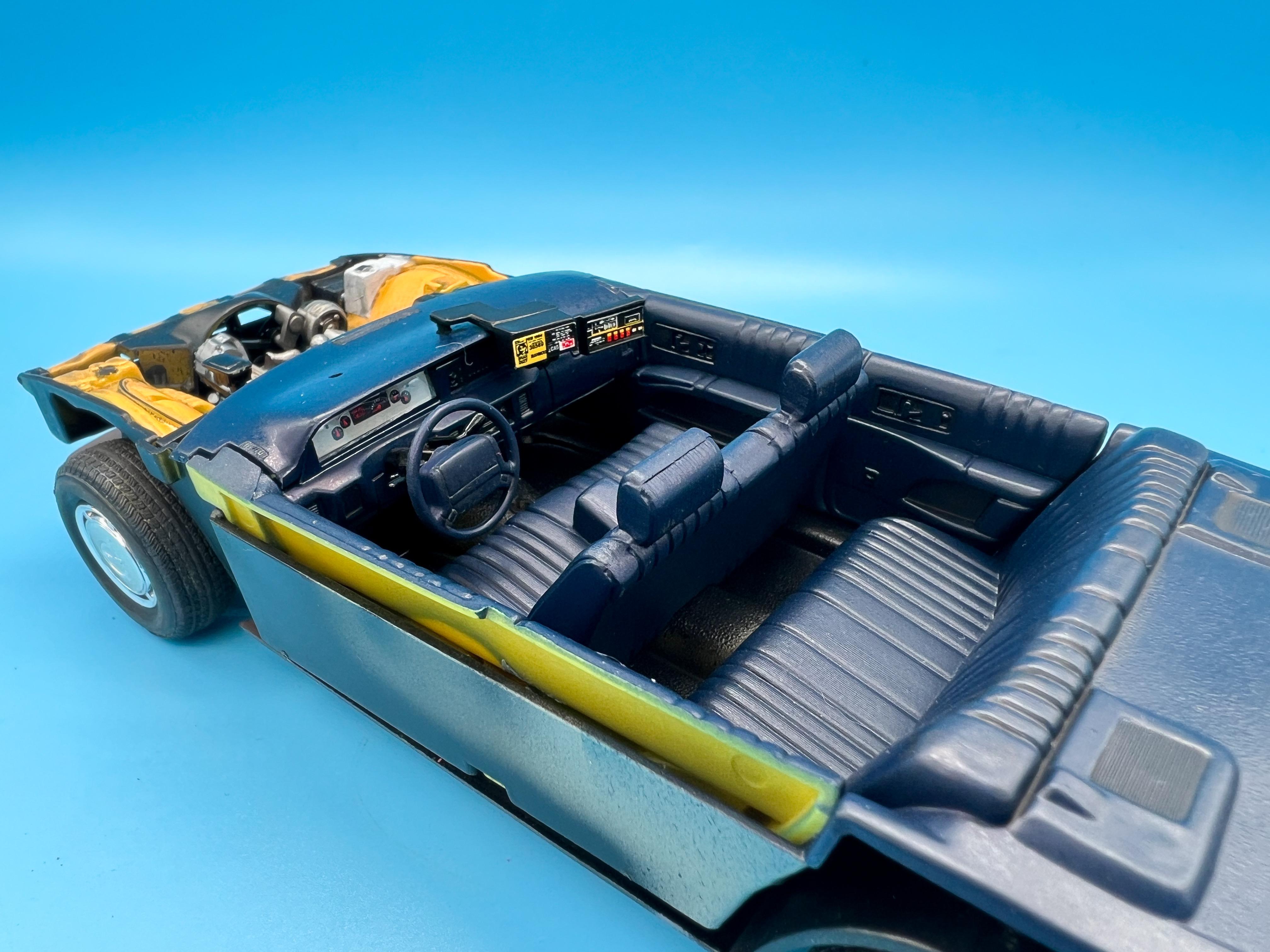

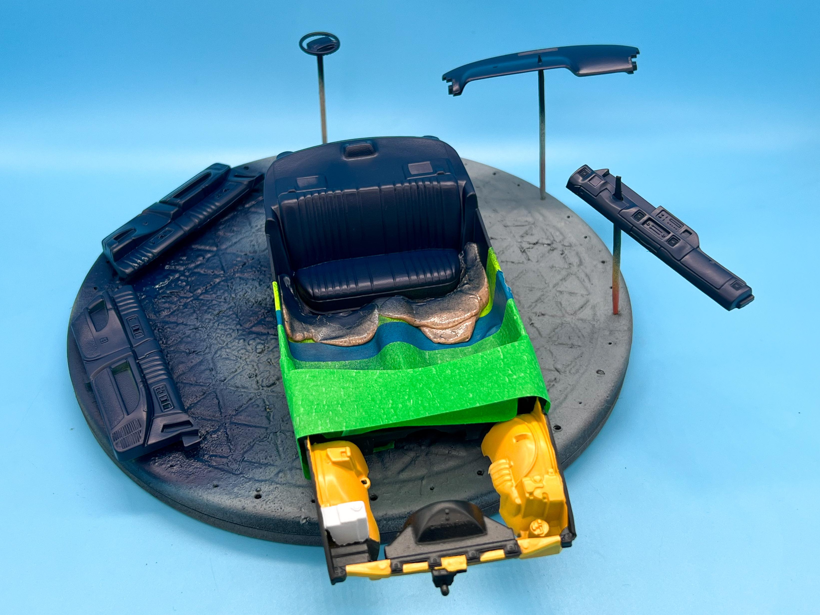

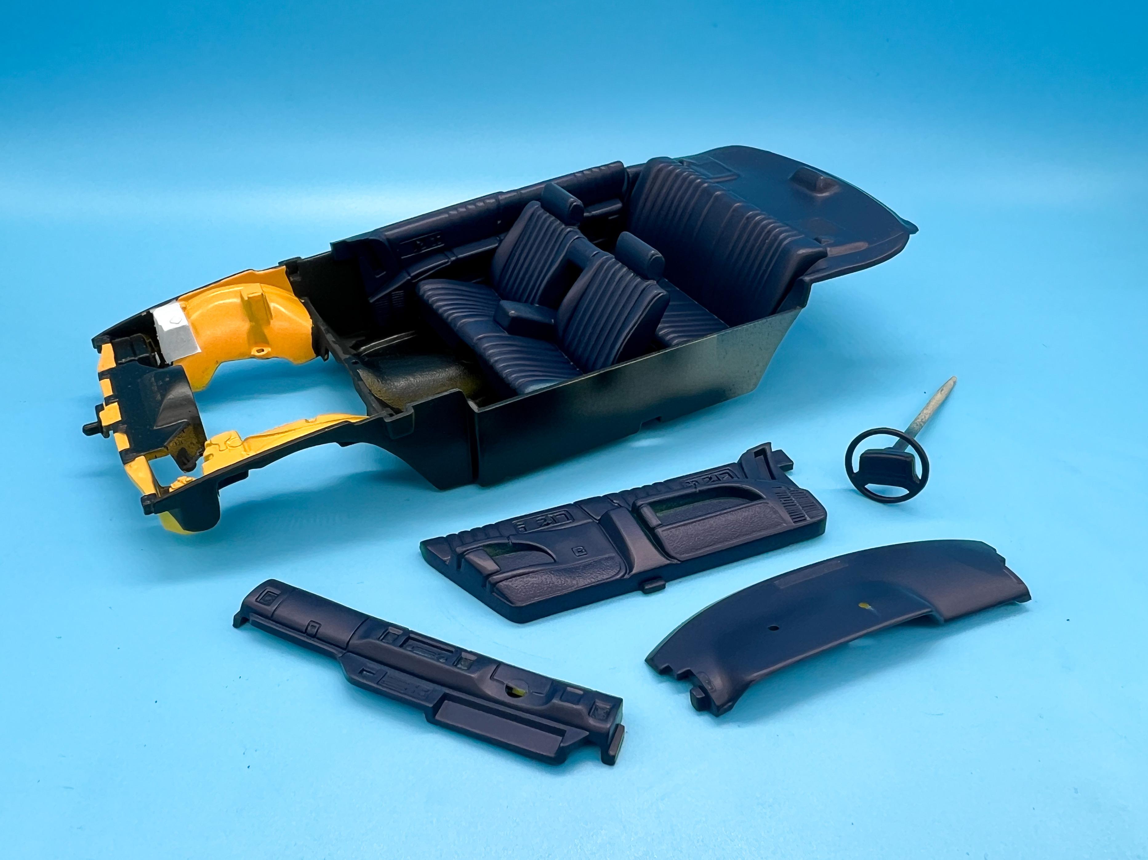

Did a tiny bit more on the interior tub (also the engine bay):
 Silly putty to the rescue again!  The interior of the taxi-spec Caprices was a dark blue, apparently, so I found some reference pics and shot the main components ready for future detailing (and picked out that washer bottle too)…plenty more stuff to paint on these bits…

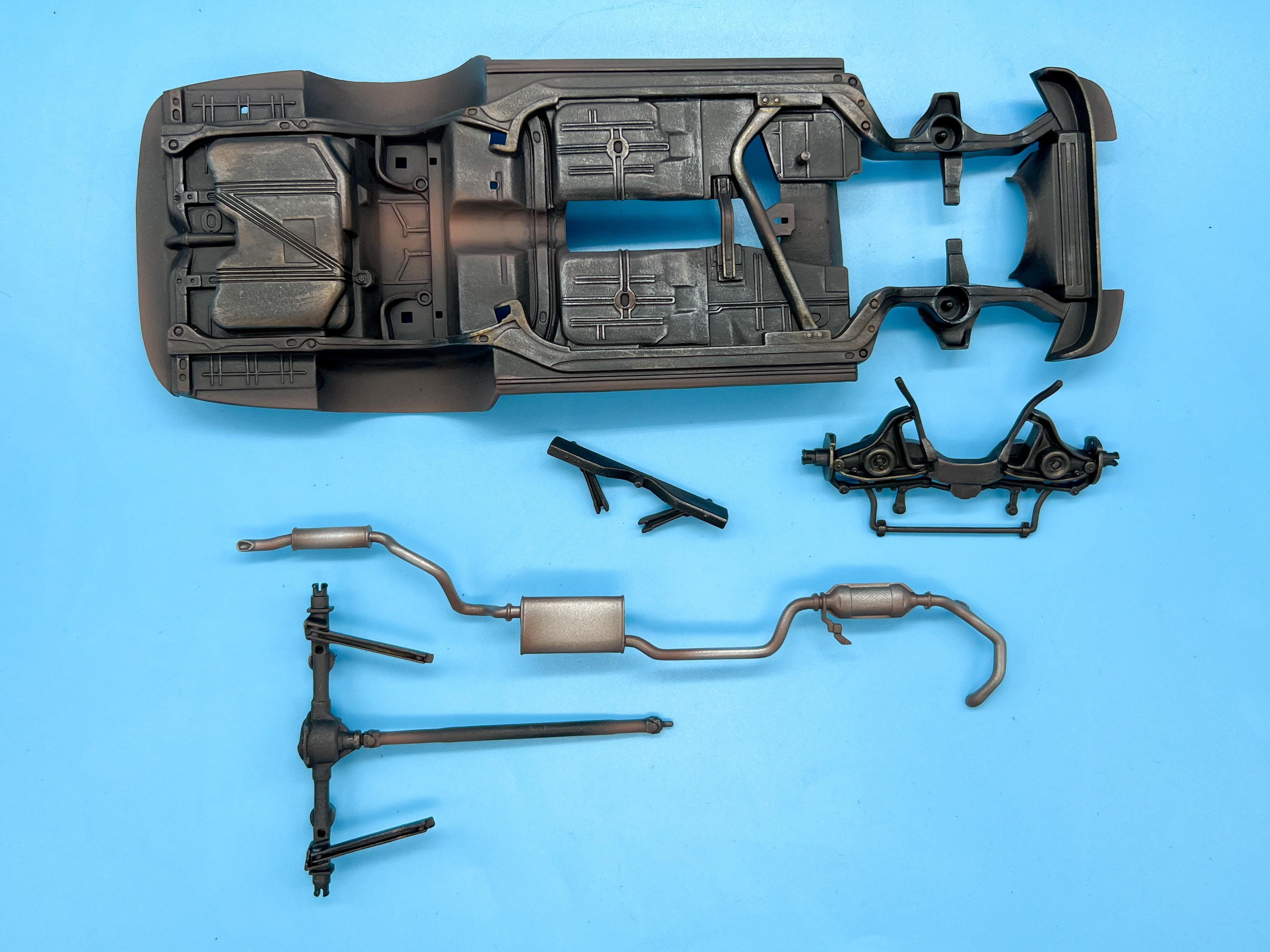

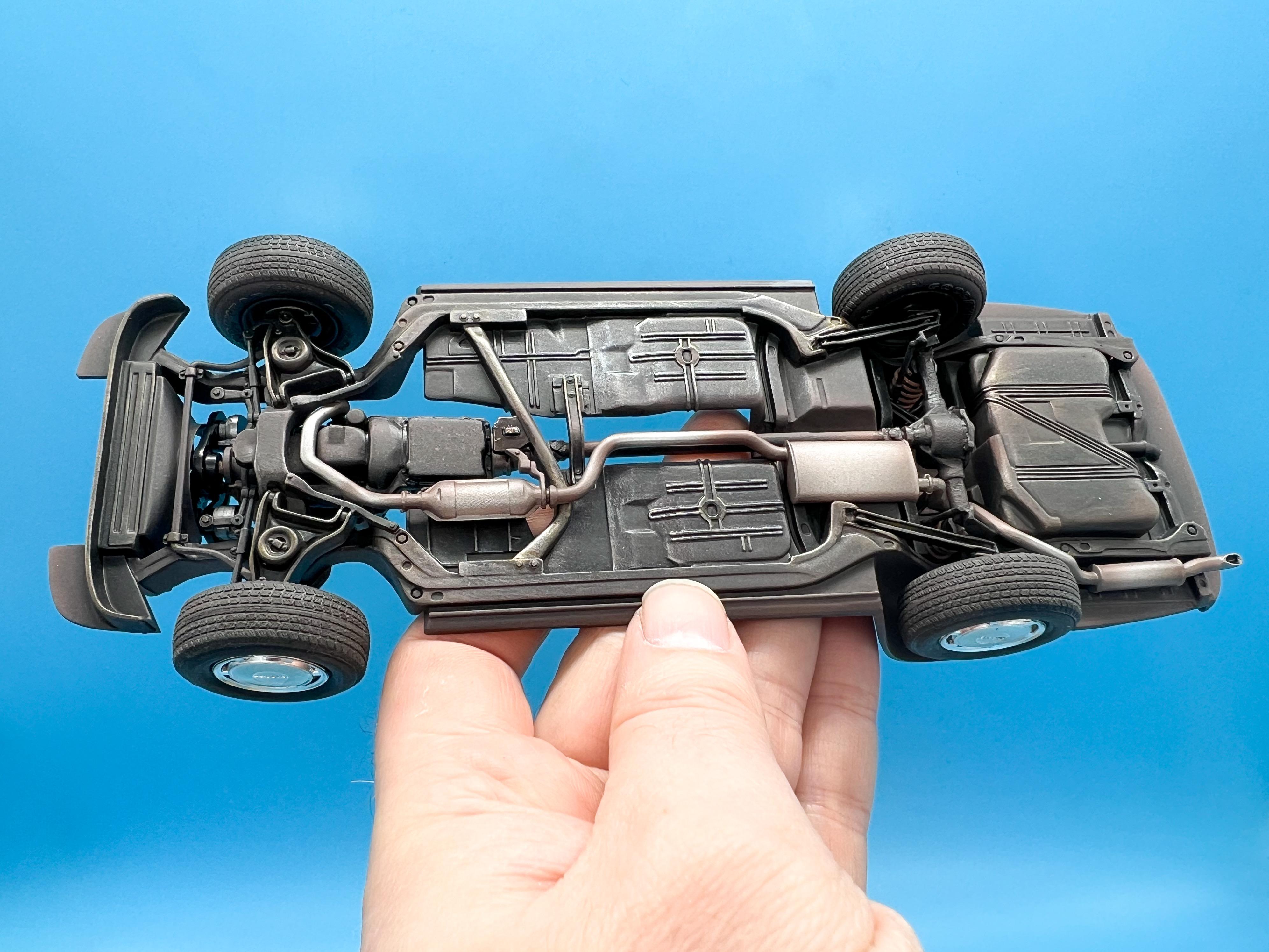

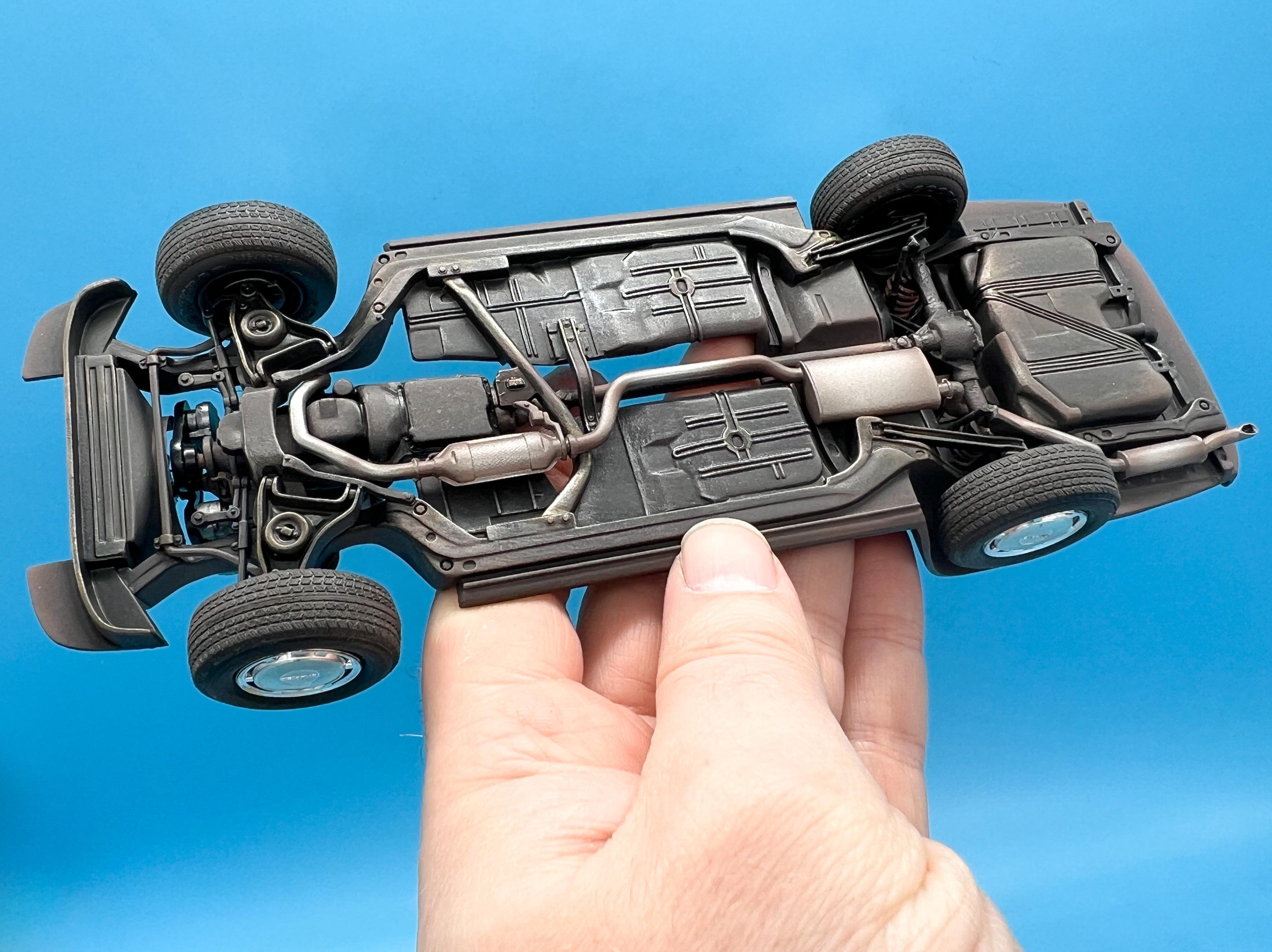

Next job, get the frame assembled (or at least the suspension and exhaust…):
I’m pretty pleased with the general look (at least for what is MEANT to be a quick easy snap-kit build ?)
Just a mini update - more soon, soon as I’ve done more!

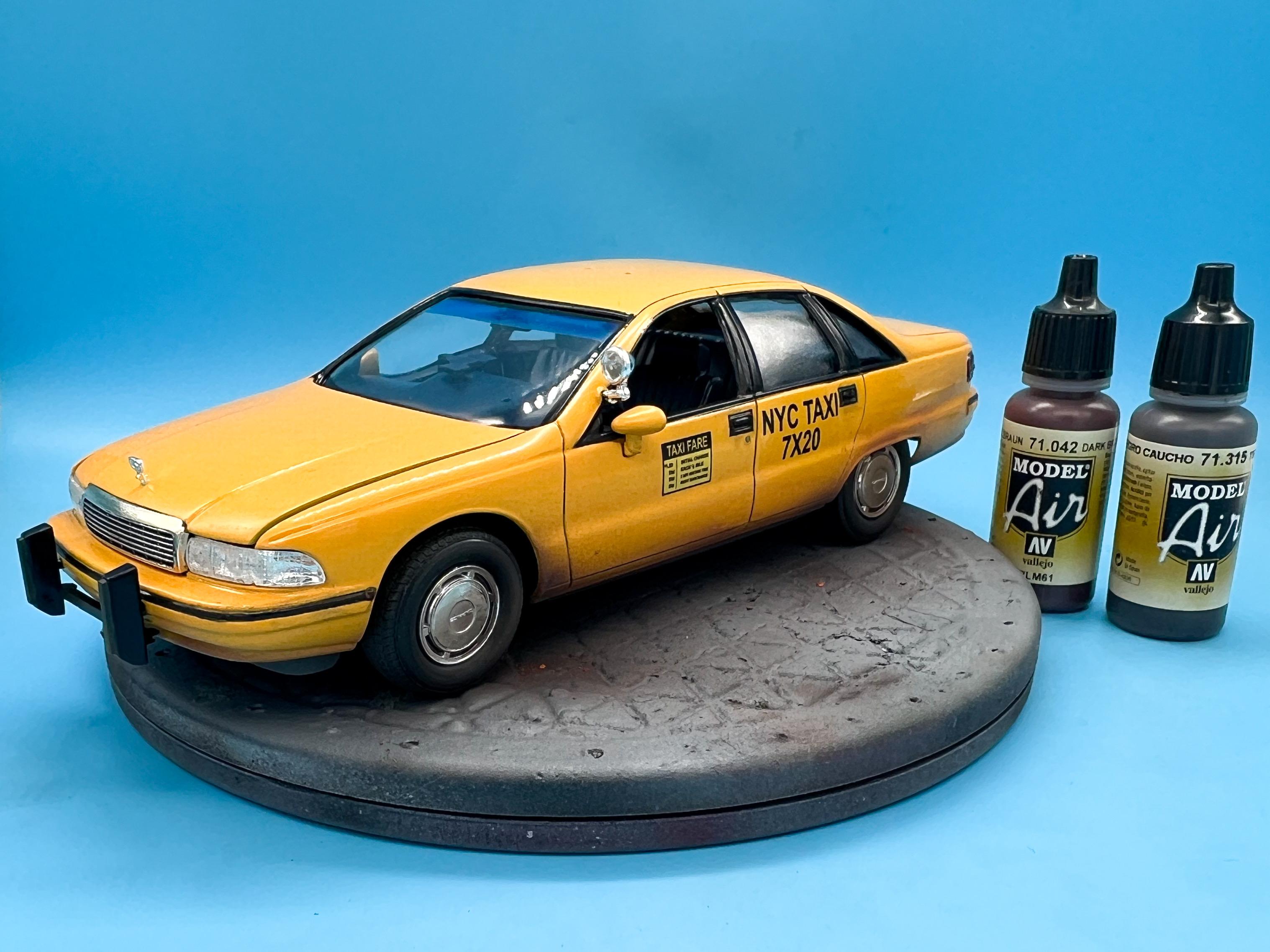

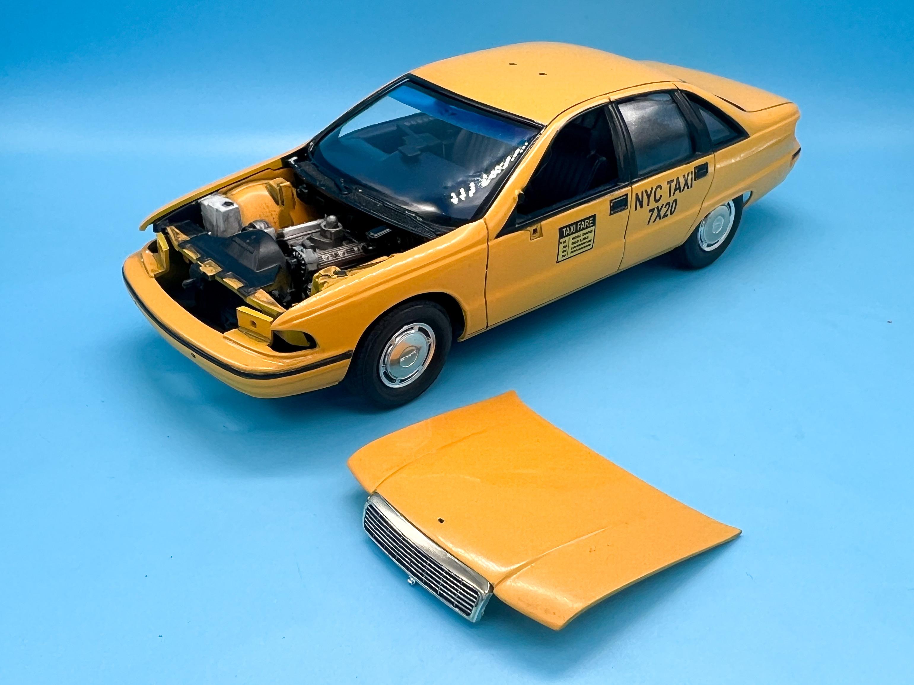

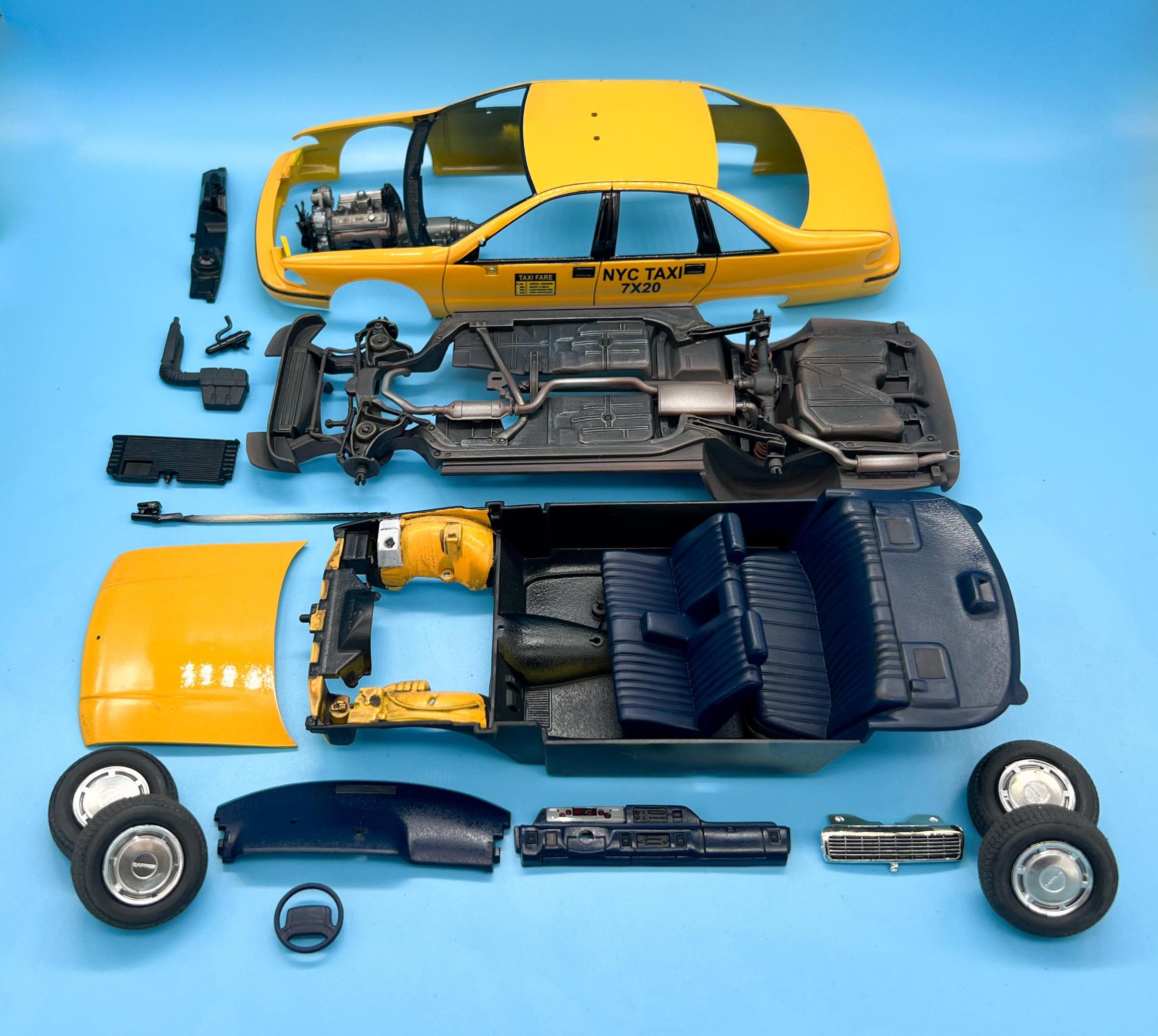

A little more progress this weekend, after spending the week priming and painting about everything that I hadn’t painted already…got a real yard sale coming together!
None of the bits I had left to handle were of any particular note - lots of satin black, but the wheels did get a coat of satin clear to dull down the chrome a little, plus a light black-wash and some weathering on the tires:

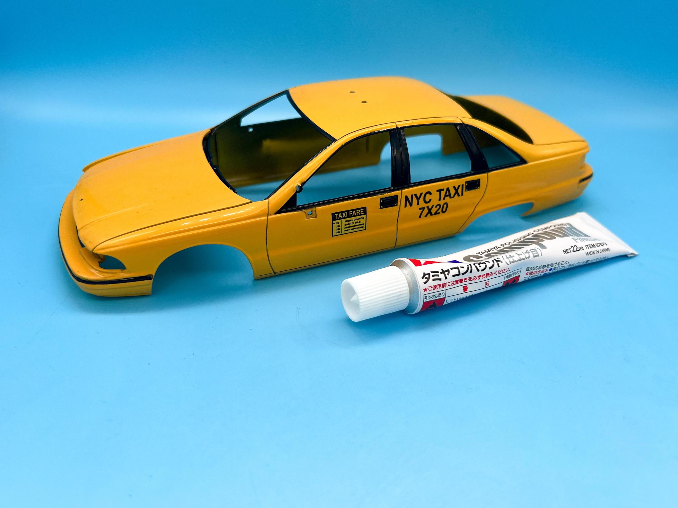

Polished out the body - I didn’t go NUTS on it, because it’ll be getting some weathering and really isn’t meant to be show-car shiny…just got the orange peel off it and gave it an in-scale sheen:

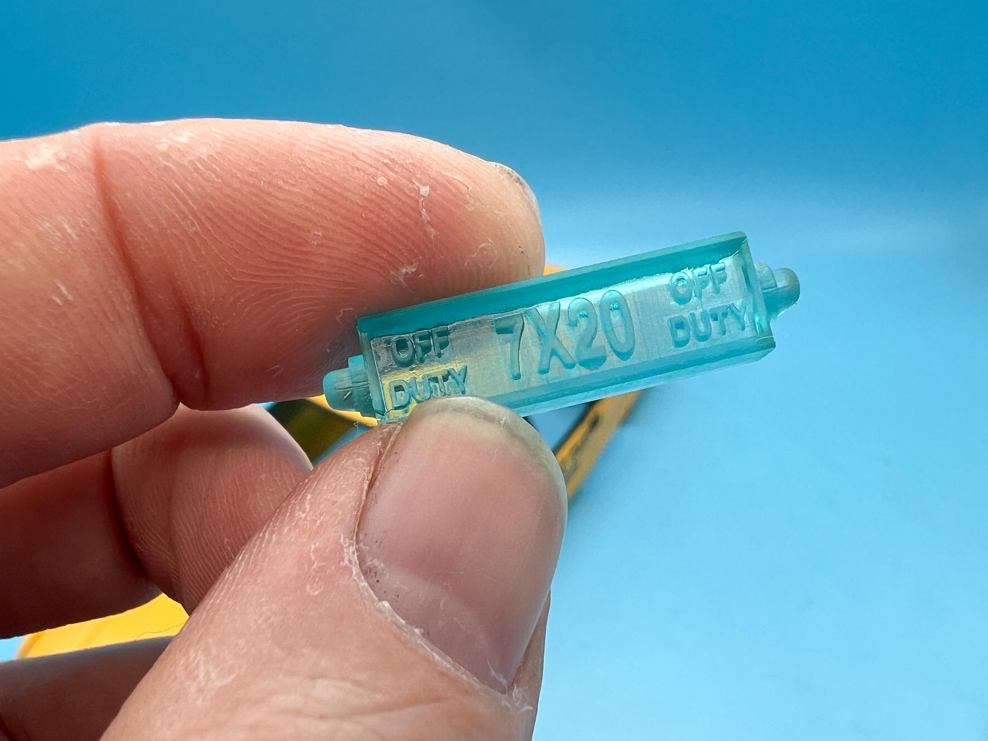

One kit part I WON’T be using is the kit’s taxi sign on the roof - it’s not accurate for a NY car so I 3D modeled one and printed it today:

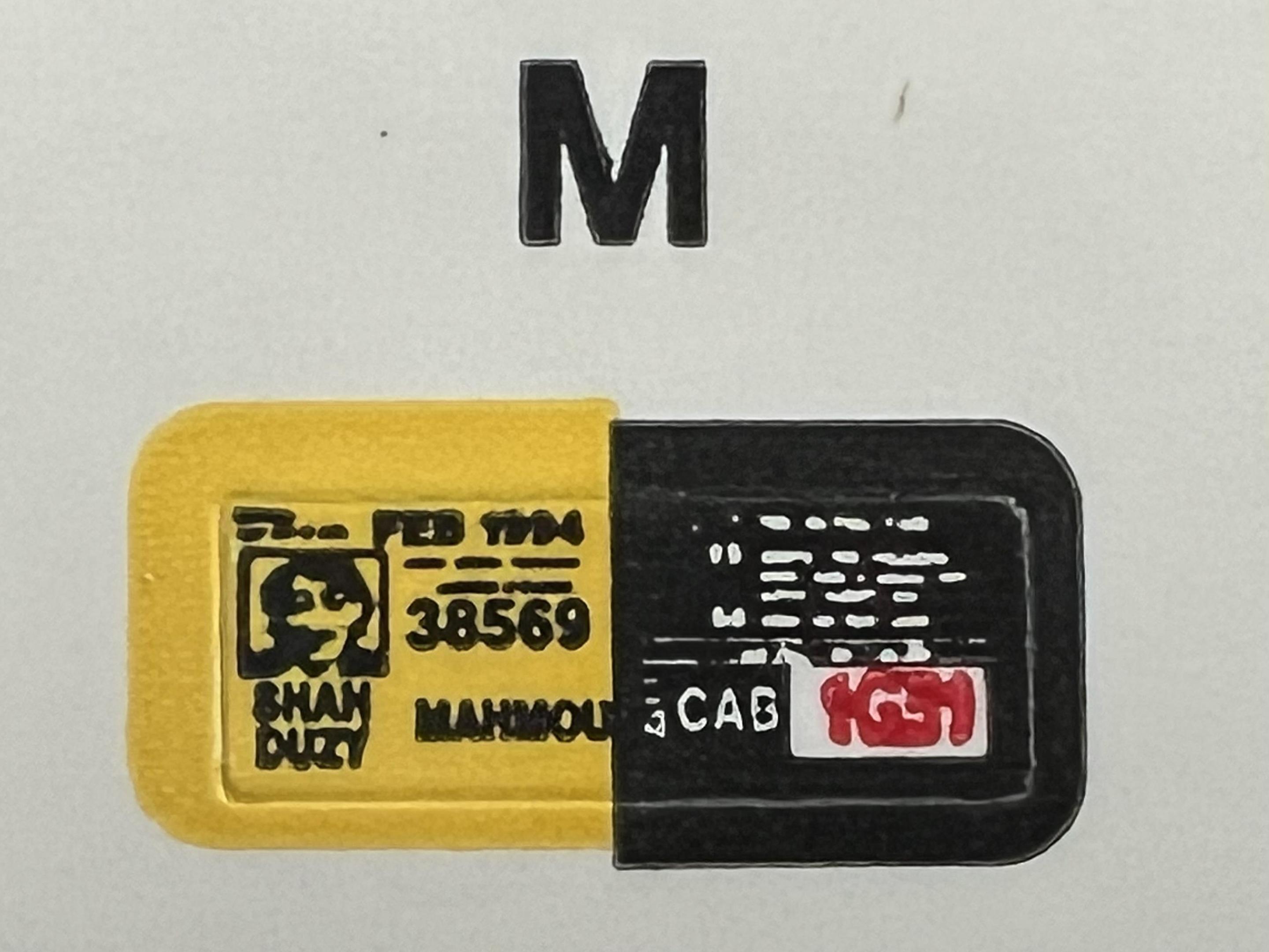

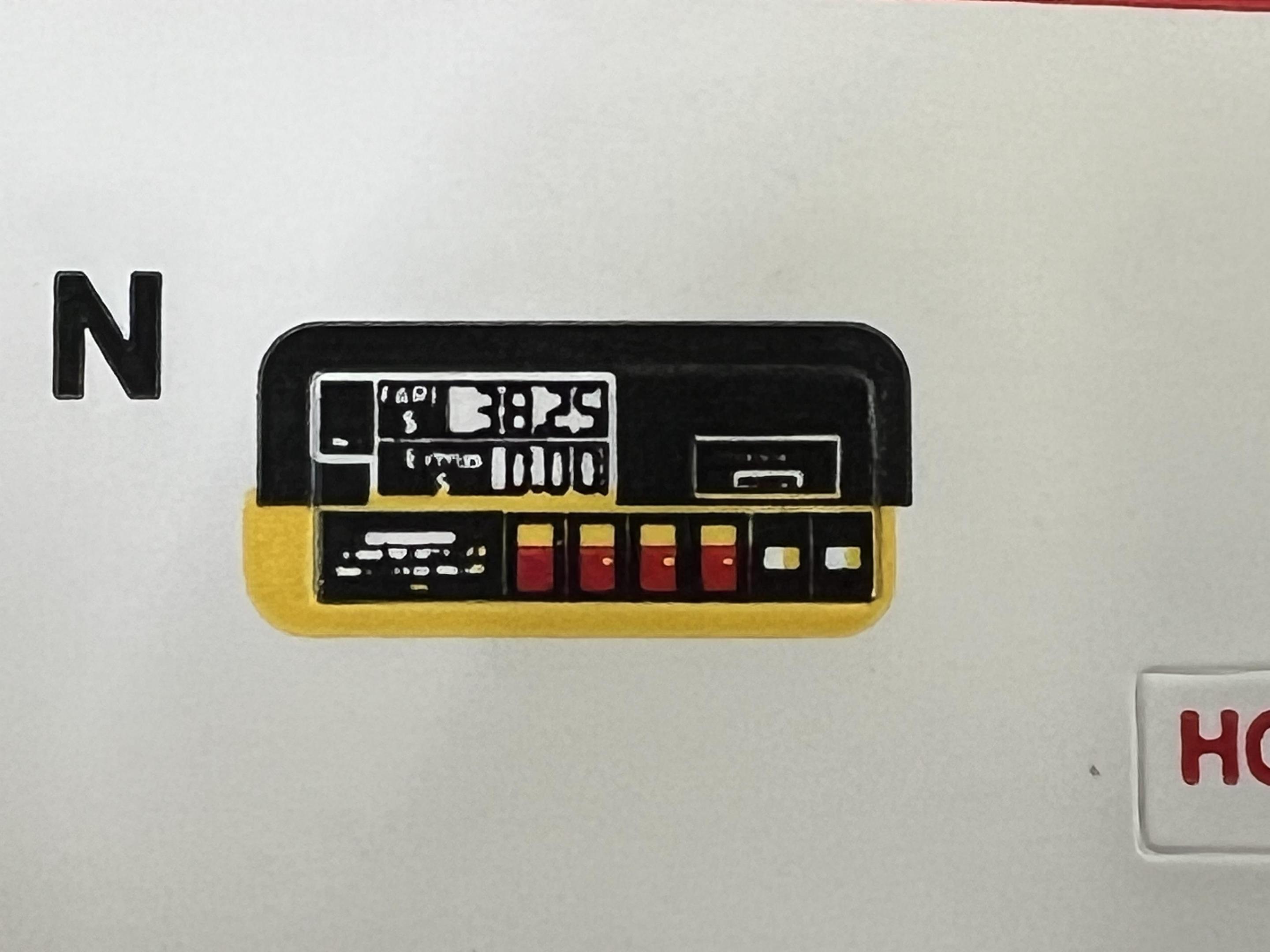

I got the few decals (actually stickers) applied to the dash and fare-meter - they’re all I’ll be using from the kit’s sheet:
Apparently the driver of this cab is named Shah Duzy Mahmou, which I guess is feasible ?
And he just got a $38-and-change fare:
The interior literally snaps together, as you’d hope from a snap kit, and everything fits beautifully - this kit was really a joy to piece together so far:
After test fitting everything I un-snapped it and got the engine glued in place - one of the few parts I felt NEEDED glue, to be safe…I love how this underside turned out!
Next up, getting the interior tub, frame and body all together for the final time…
And now we’re down to some of the final little details before I can add a light layer of exterior weathering and wrap this thing up…I’m excited to do a little airbrushing and some washes to add some subtle grime and use to this thing…

So that's what you can do with a Snap Kit? Pretty impressive! You sure brought out all the chassis and engine details with paint, drybrushing and washes, amazing!

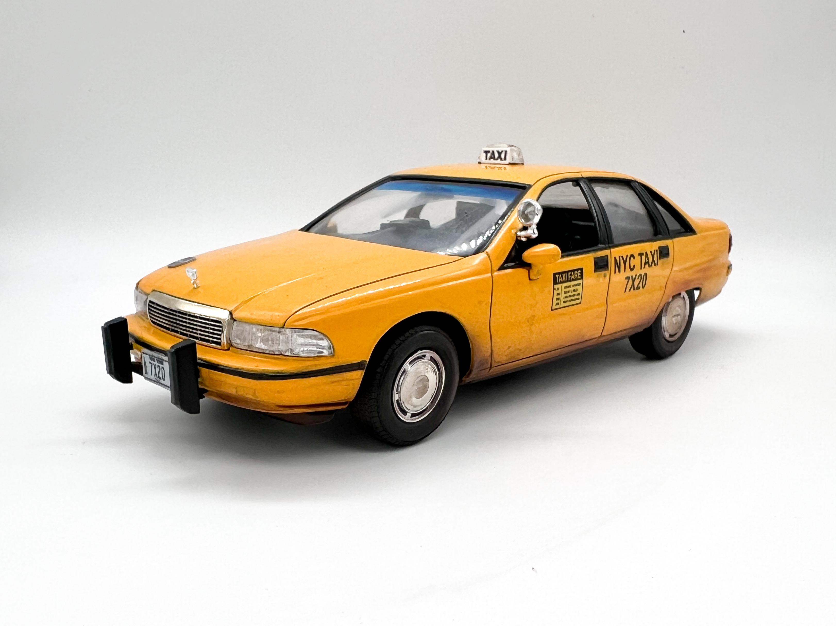

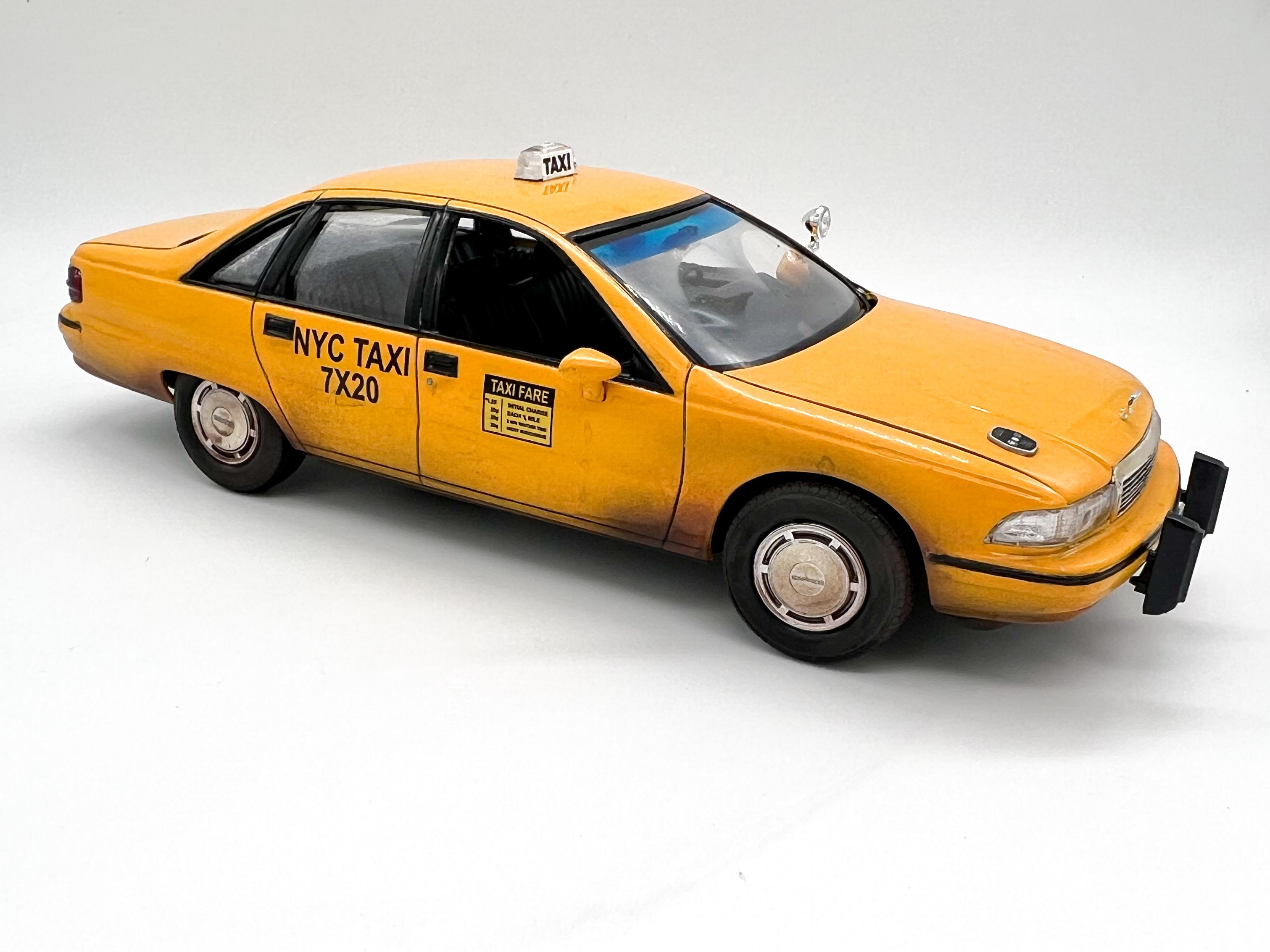

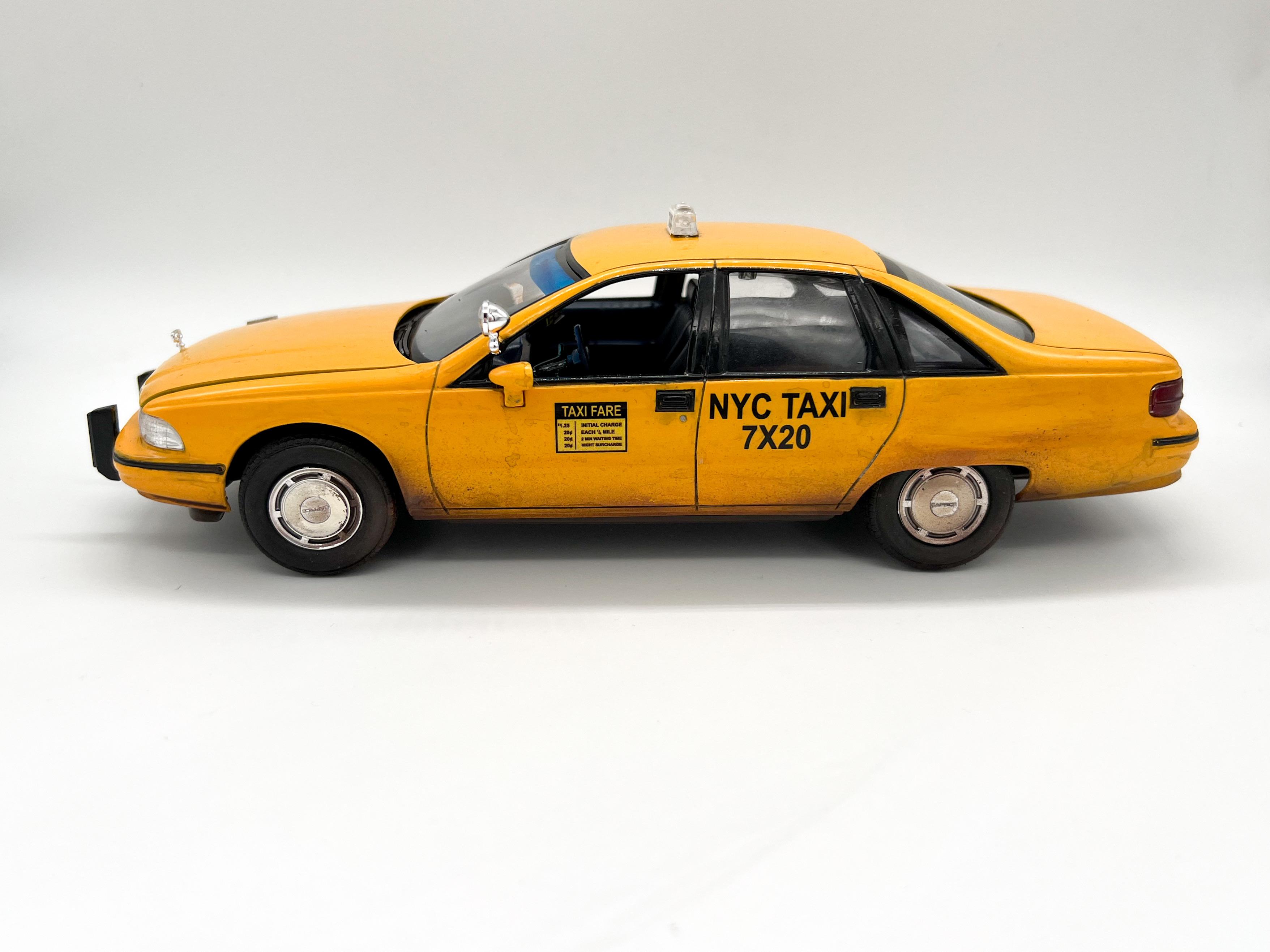

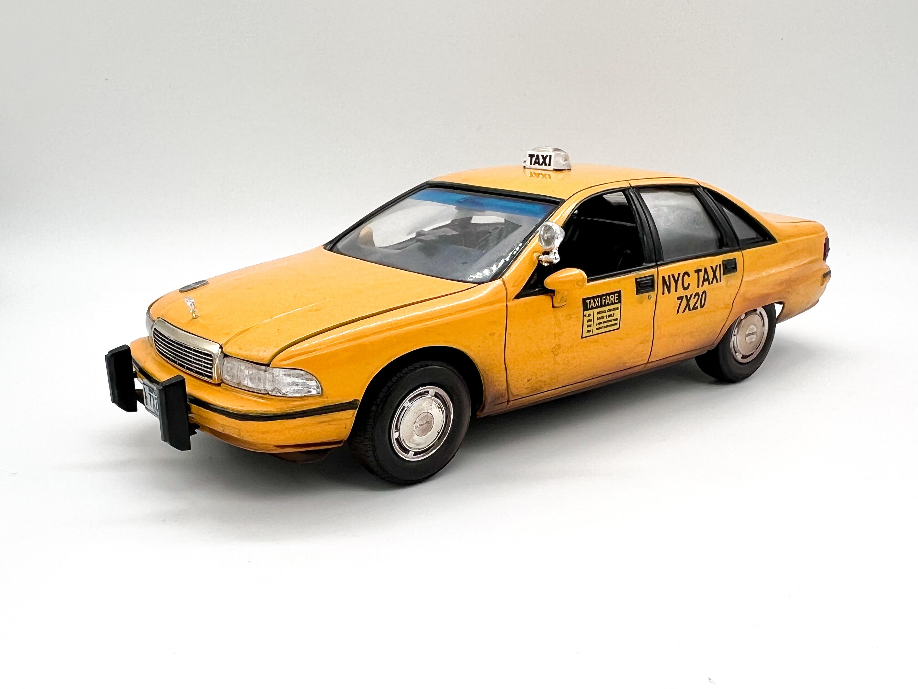

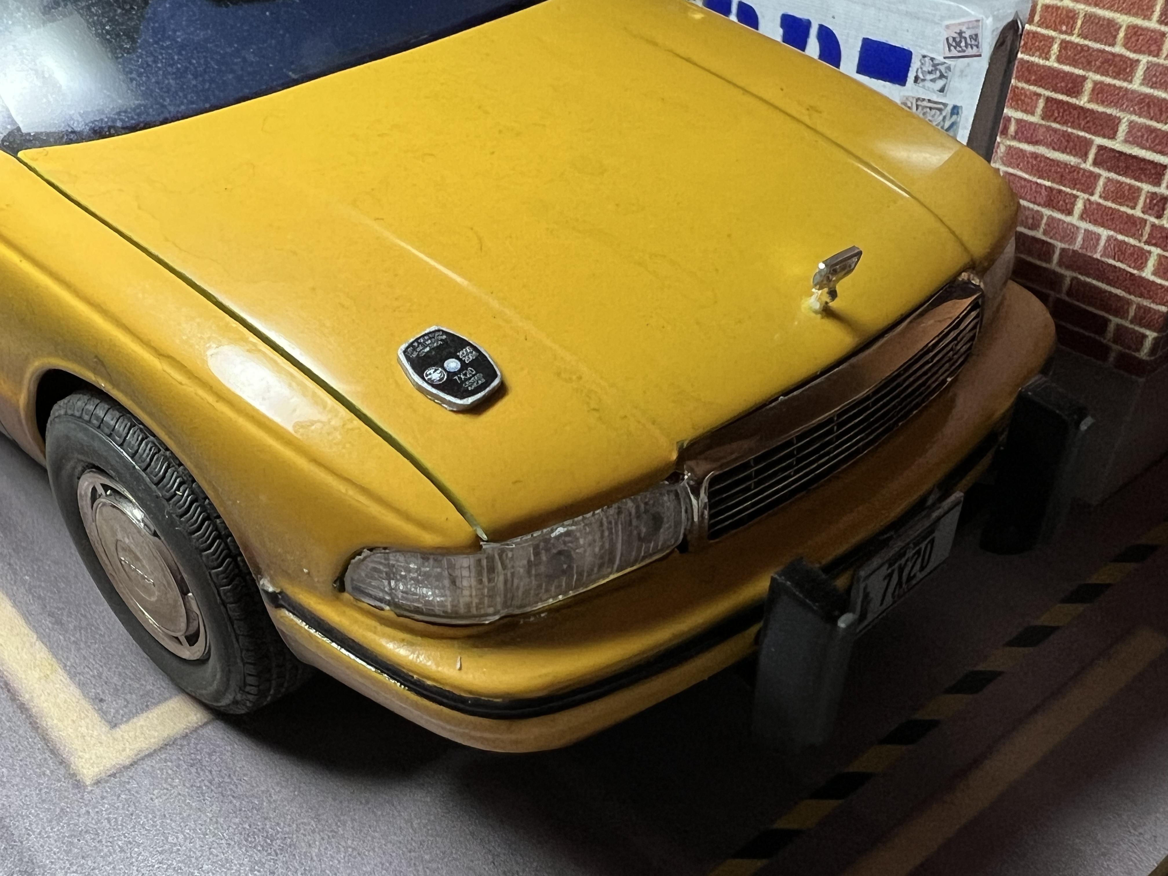

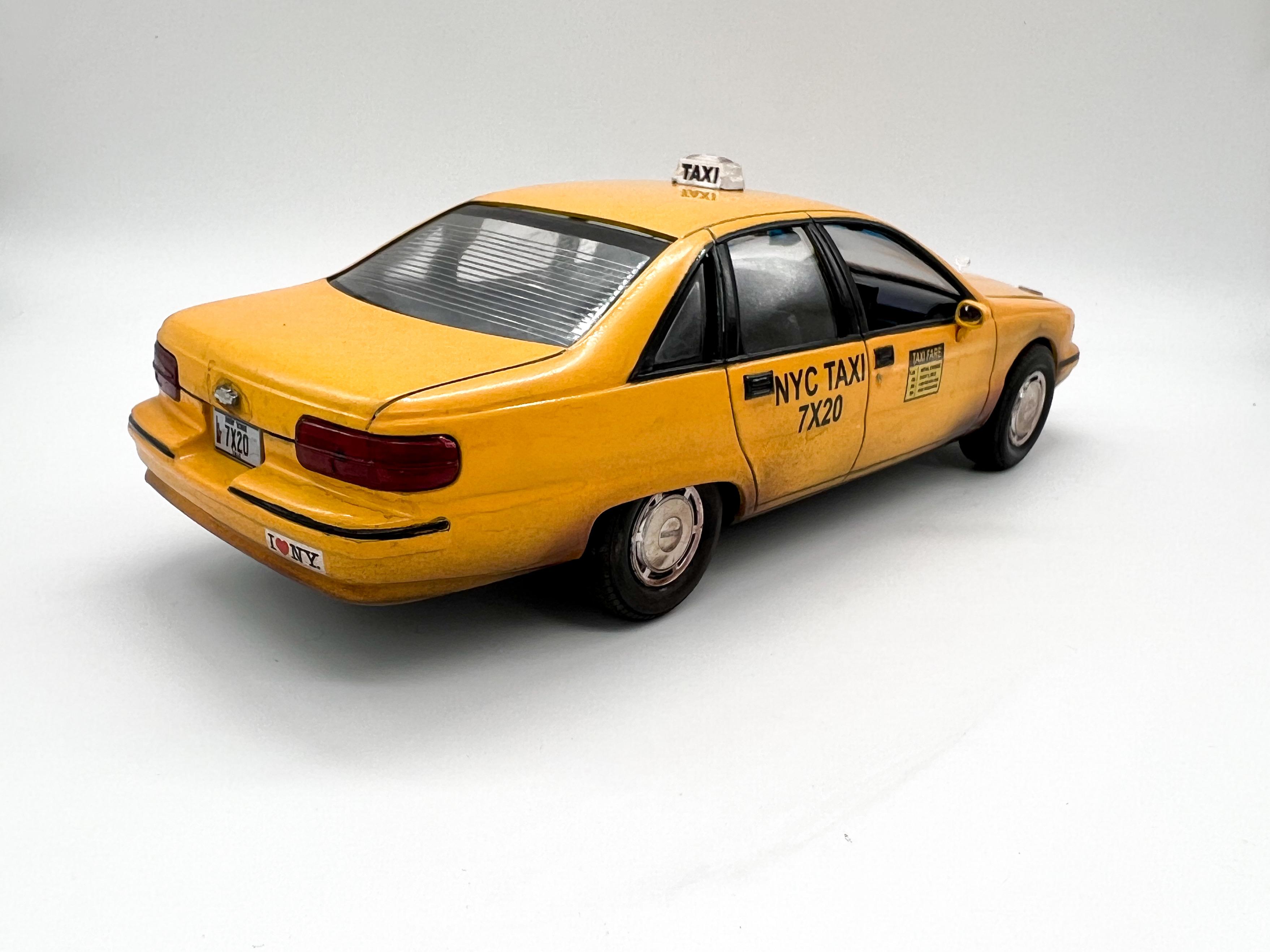

I finished this one up this week - most of what I had left to do was just attaching the last few parts to it…and attaching some good old NY grime to it too…
Some finished pics…thanks for following along!  Can’t wait to tackle another one of these - it’s a fun kit and it basically fell together!

Nice job!
But forgive my ignorance - what is that on top of the hood, right side front?  [Looks like a TV remote, LOL.]
  • Like 1
21 hours ago, Danno said:
Nice job!
Thank you!!  I probably shoulda explained that tv remote, huh?  That’s the medallion - a little metal plaque that mounts to the hood of an NY cab to prove it’s legit and properly certified.  That little chunk of metal would sell, pre-Uber anyway, for up to a MILLION dollars.  Here’s a close-up:
Because they got so expensive, NY introduced a cheaper variation for aspiring cab-drivers which would allow them to operate for a much lower starting price (but only permitted them to pickup fares in certain areas, primarily outside of Manhattan) - and they had to run this pea-green color scheme:
I need to build one of those too…
21 hours ago, Mittagskind said:
Yeah great. A car wash is surely nearby.
Yep - this one is deep into a 48 hour rotating-driver shift ?
