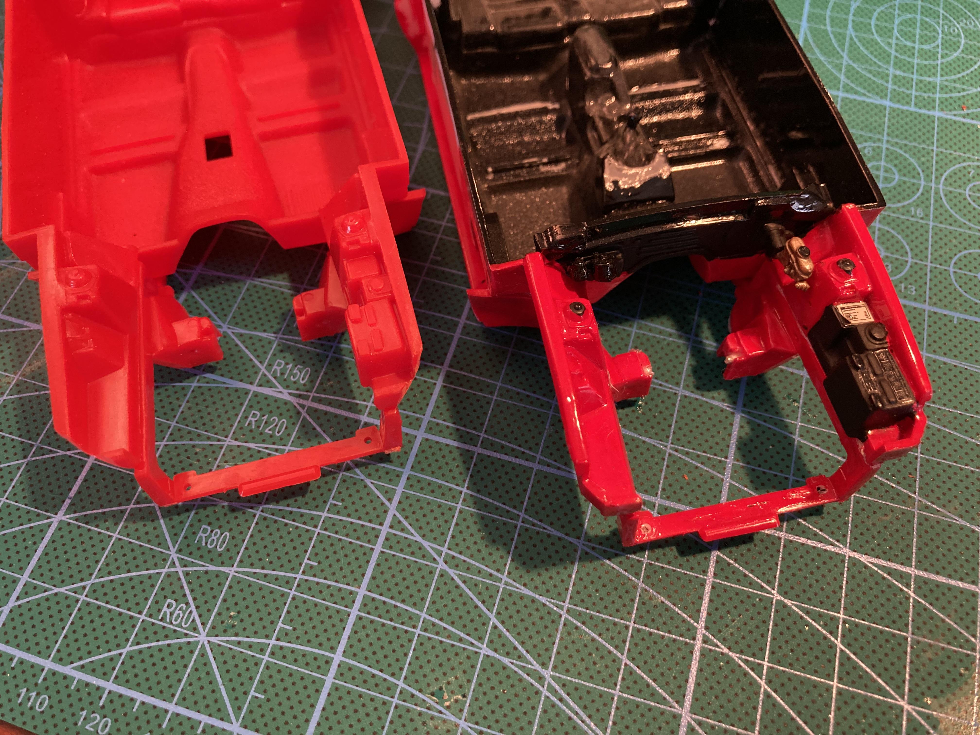

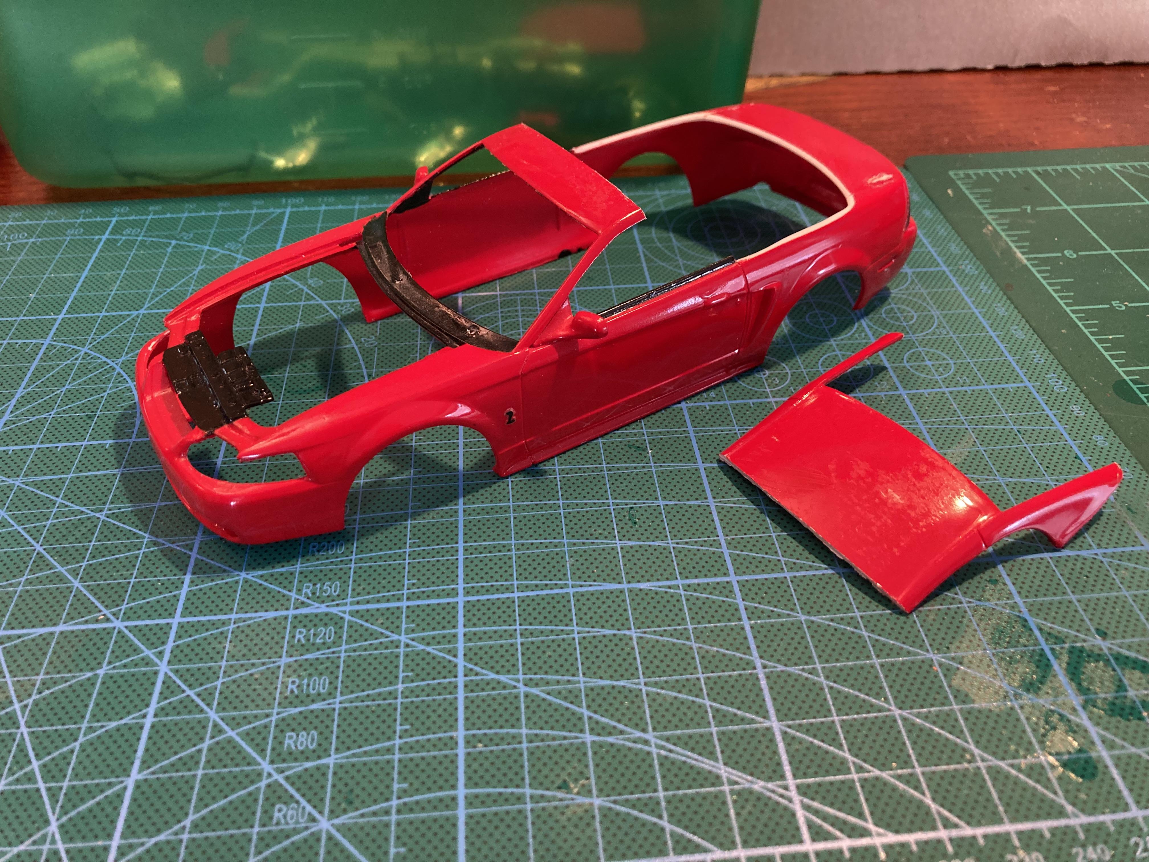

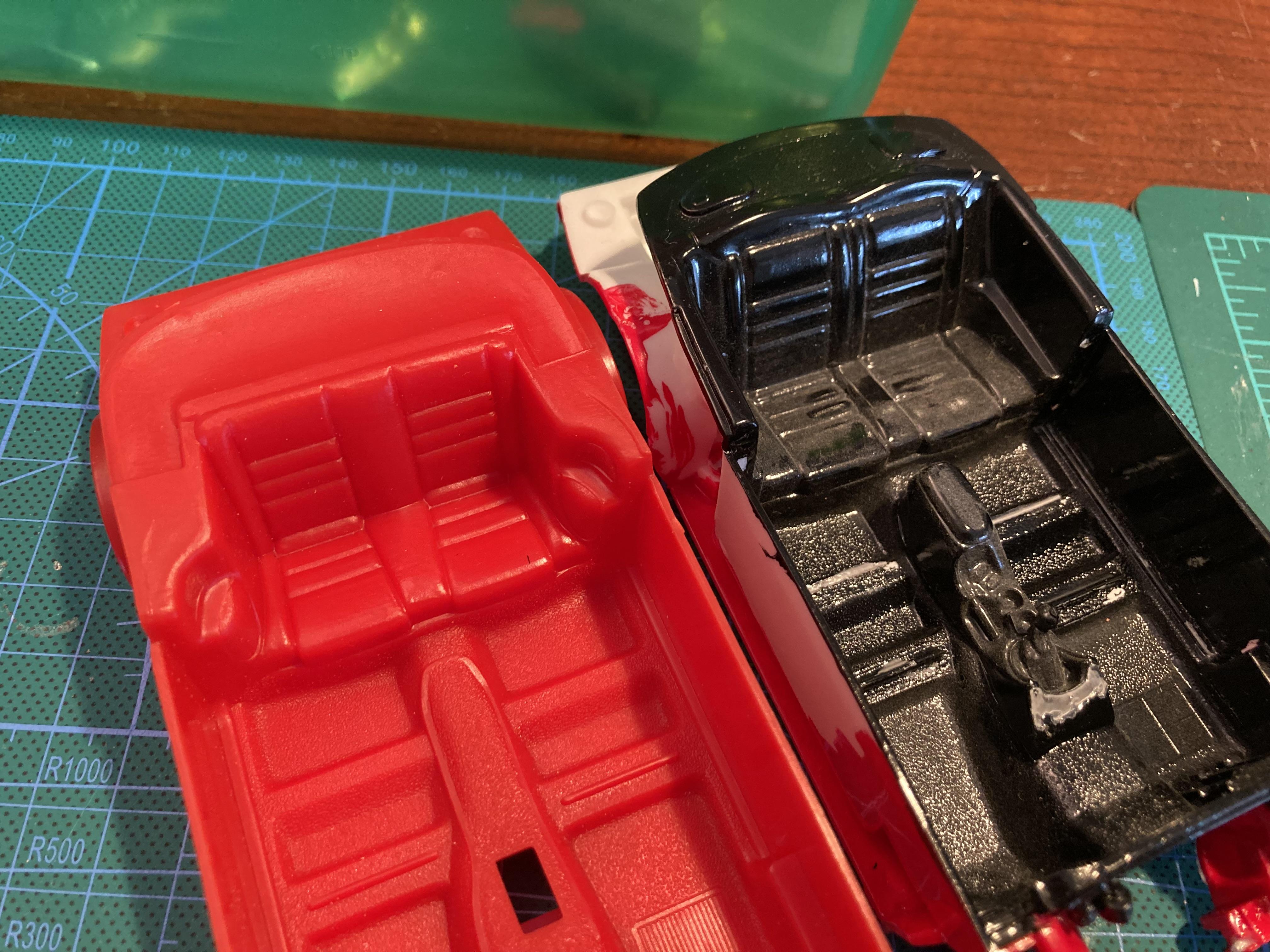

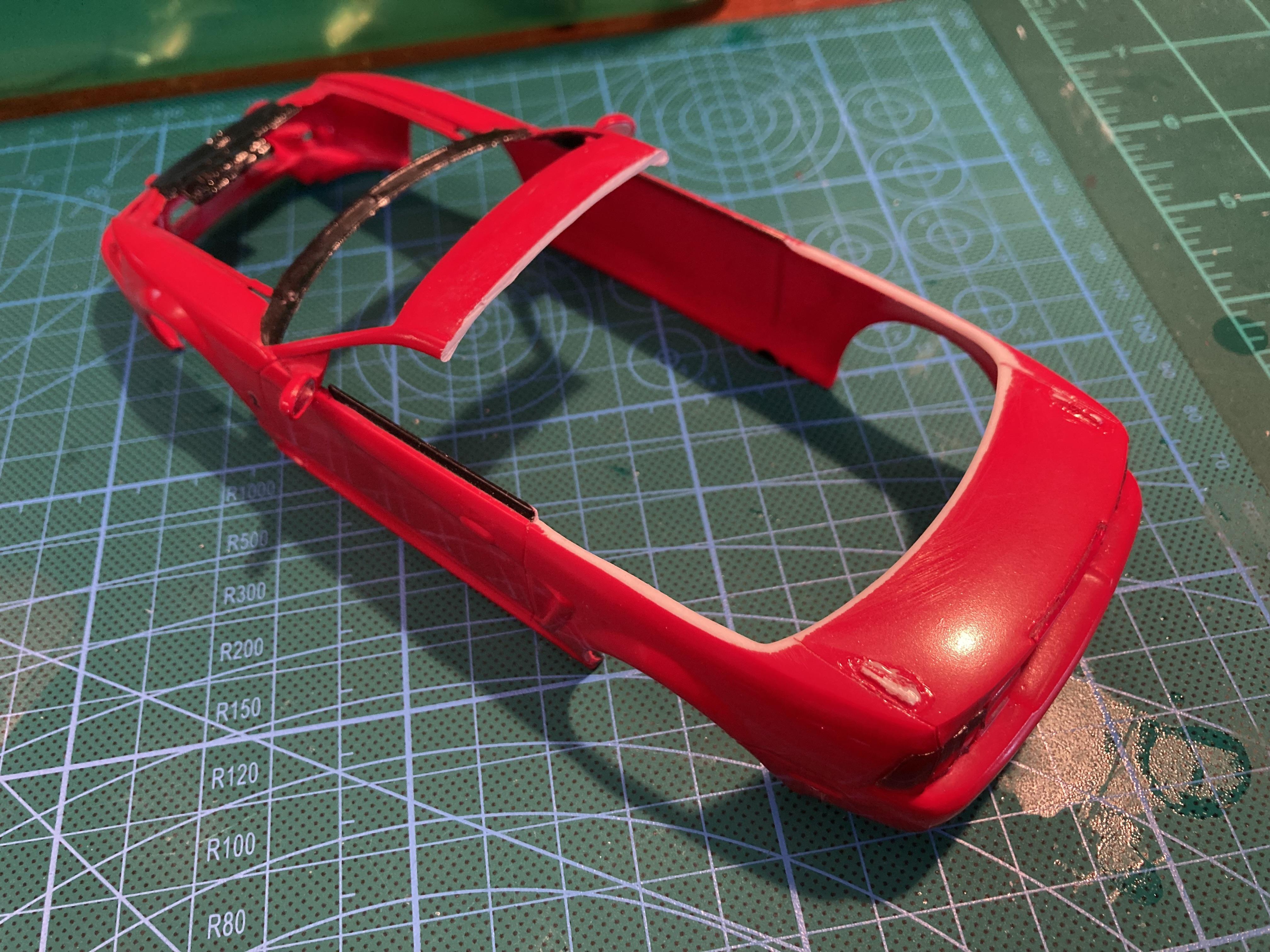

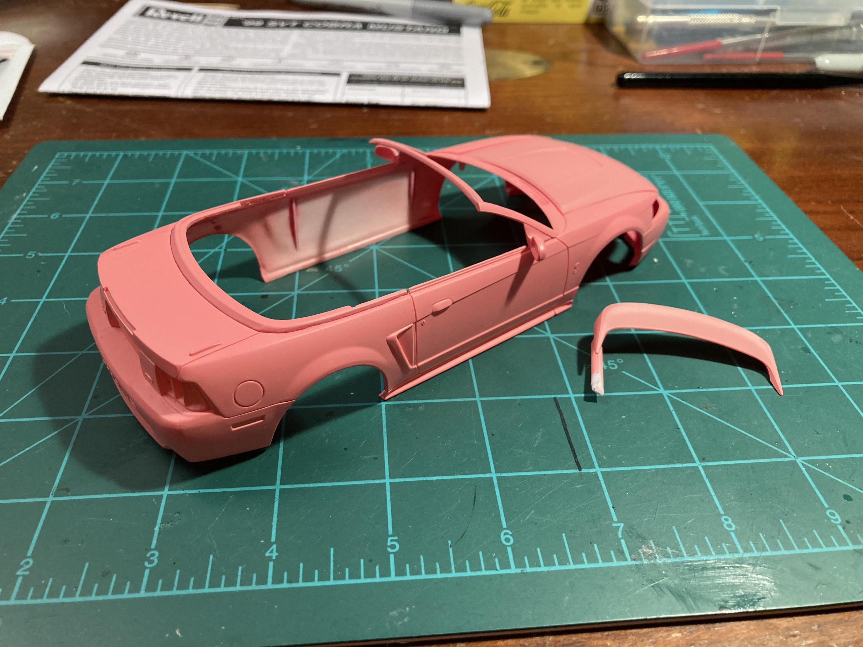

My idea for this project started when I was planning to simply rebuild my ‘99 coupe. But then Ollie’s recently released a new issue of ‘99 Cobra coupes, so I bought a new kit to build as a coupe and decided to hack up my childhood build. I forgot to take a before picture of it.IMG_1469.thumb.jpeg.28abad4e72964825d51be4dd25e3d9c7.jpegI chopped the roof off the 99 along with the 1/4 window trim. The door window trim will be my reference point.IMG_1470.thumb.jpeg.991d9a1e6f81df8ab284c41821c7f3b6.jpegThe ‘94 is donating it’s convertible roof base trim, up top and interior tub. IMG_1471.thumb.jpeg.96da76432c77dfbc01b877ca332d6fac.jpeg Both kits share identical interior parts including the seat pattern. I’m not sure if that’s accurate but the real New Edge interior didn’t change much from the SN95 so it is what it is. I’ll use the fresh ‘94 parts here.IMG_1472.thumb.jpeg.069e7fcb0a7334e9ee6bcbc7b93fe76a.jpegA younger me was pretty liberal with model cement… no chance separating the coupe interior from the ‘99 chassis. IMG_1475.thumb.jpeg.f6b1a394cc4b931f042375c0a8791ea3.jpeg

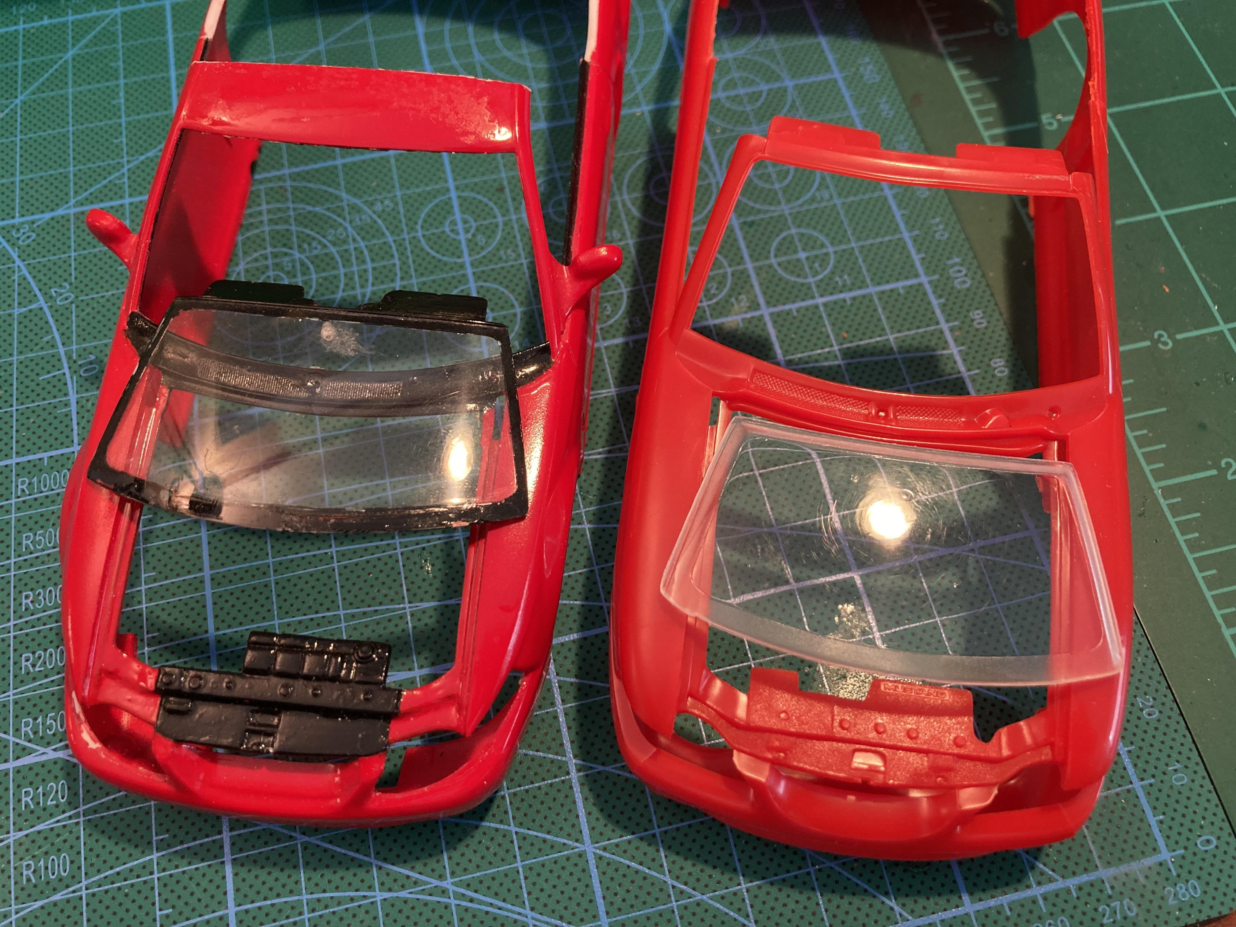

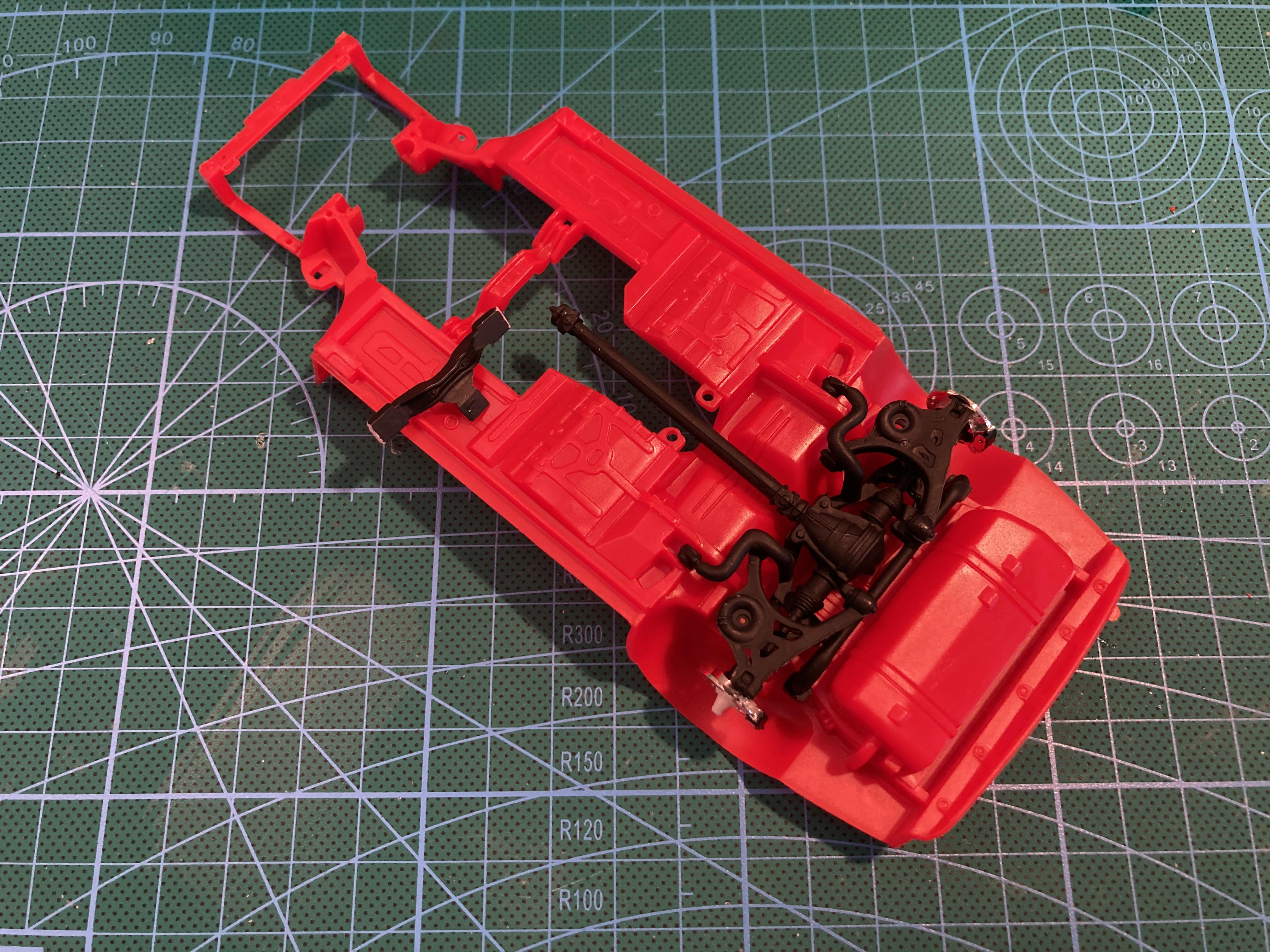

Luckily, the ‘94 chassis is essentially the same as the ‘99, except for the transmission mount and the front engine bay corners. I filed down the corners on the ‘94 inner fenders and cut out the ‘99 crossmember.IMG_1473.thumb.jpeg.f11eedd60a77cc99f1a445bd4206a35d.jpegJust like the real cars, the IRS swaps right in to the ’94 chassis. IMG_1474.thumb.jpeg.55c4fd13528389e915c80fd0de11fdf1.jpegThe windshield, frame and cowl are slightly different between the two, so my plan of cutting the frame and cowl out and swapping won’t work easily. IMG_1476.thumb.jpeg.0cfa4aaf309dc6359c8d720e74b7179b.jpegI’ll probably just leave the ‘99 frame in place and trim the former roof down to fit the up top. IMG_1478.thumb.jpeg.59b77e5442447656a8cf87ae46805cec.jpeg

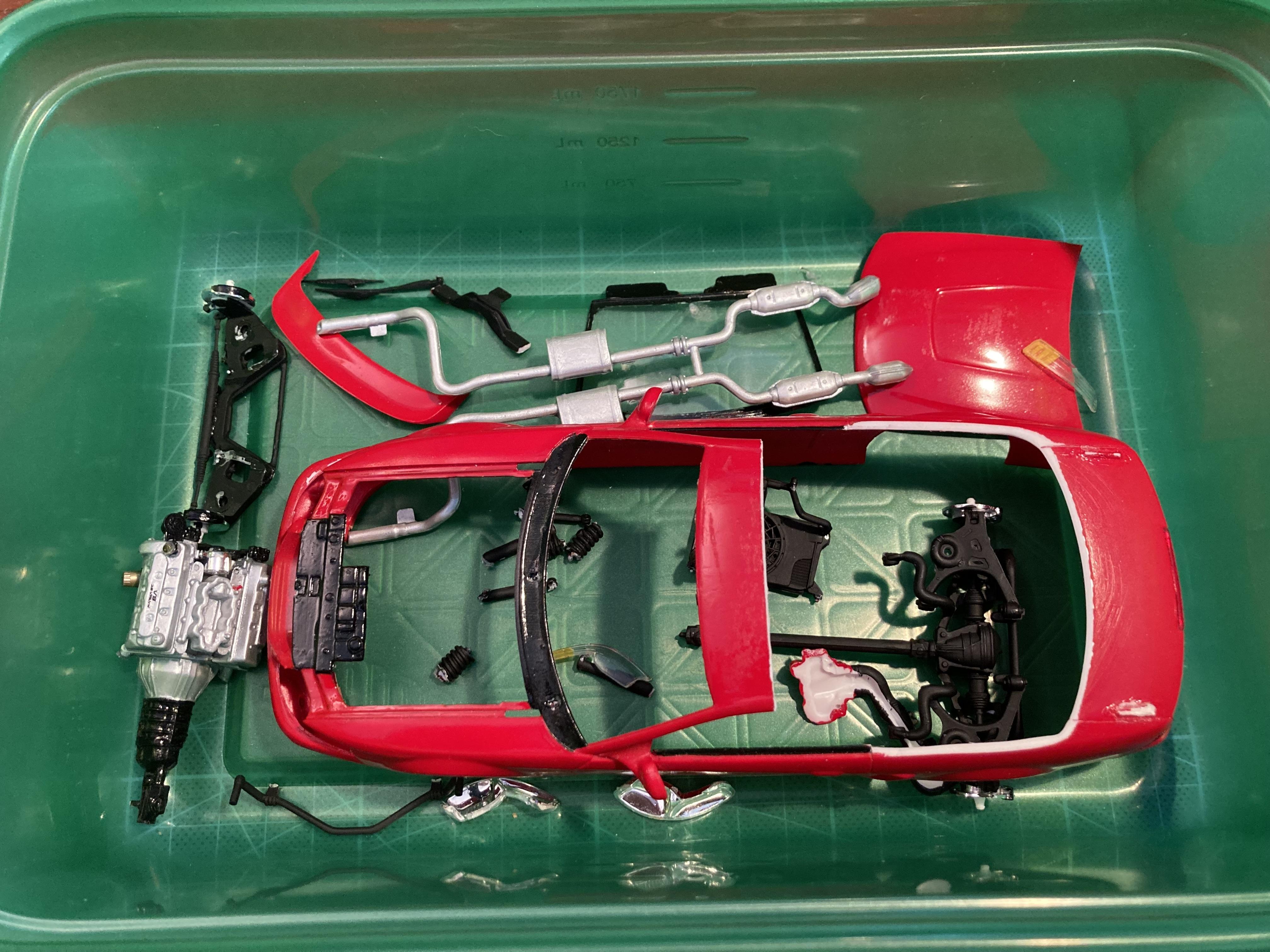

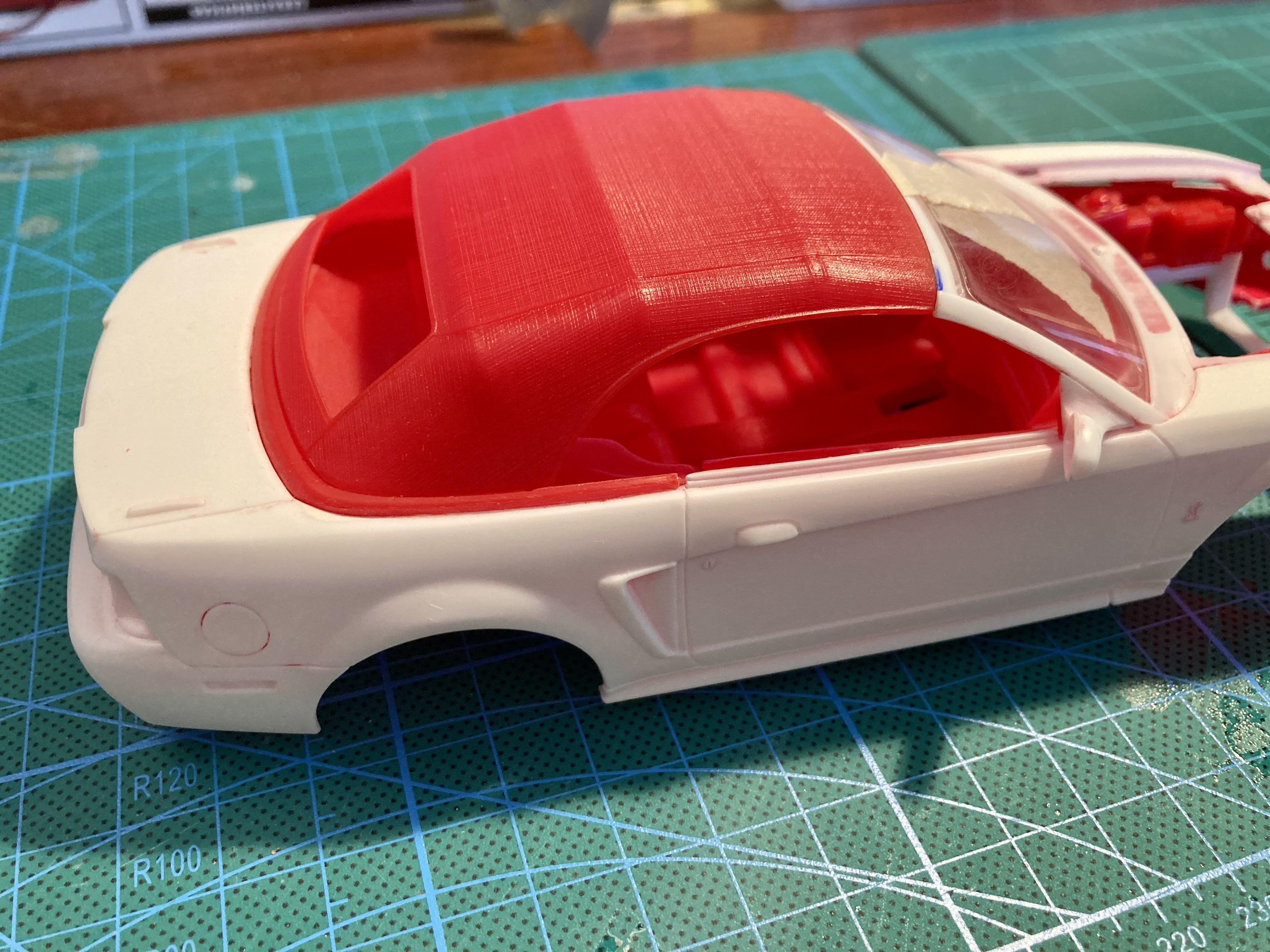

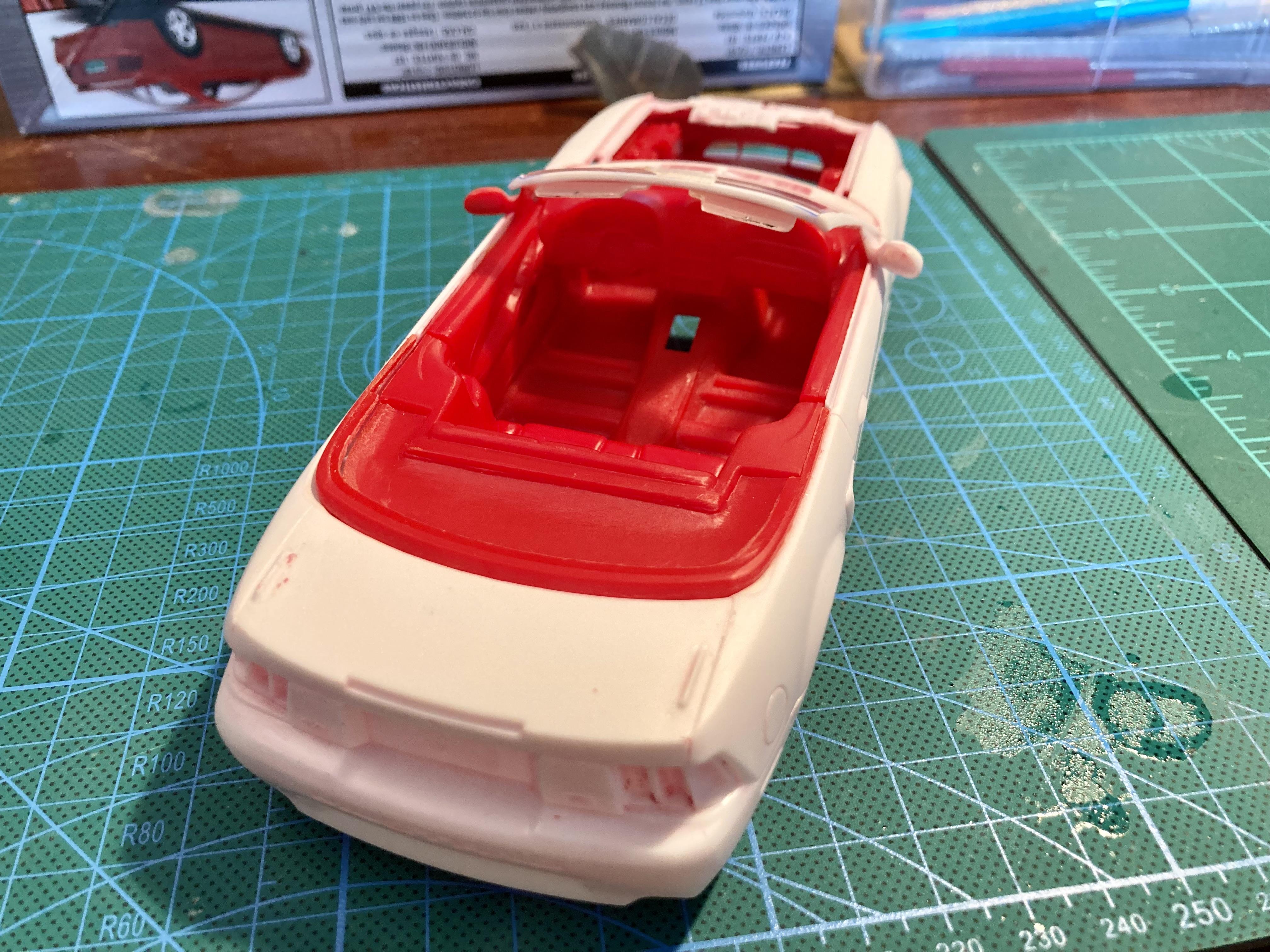

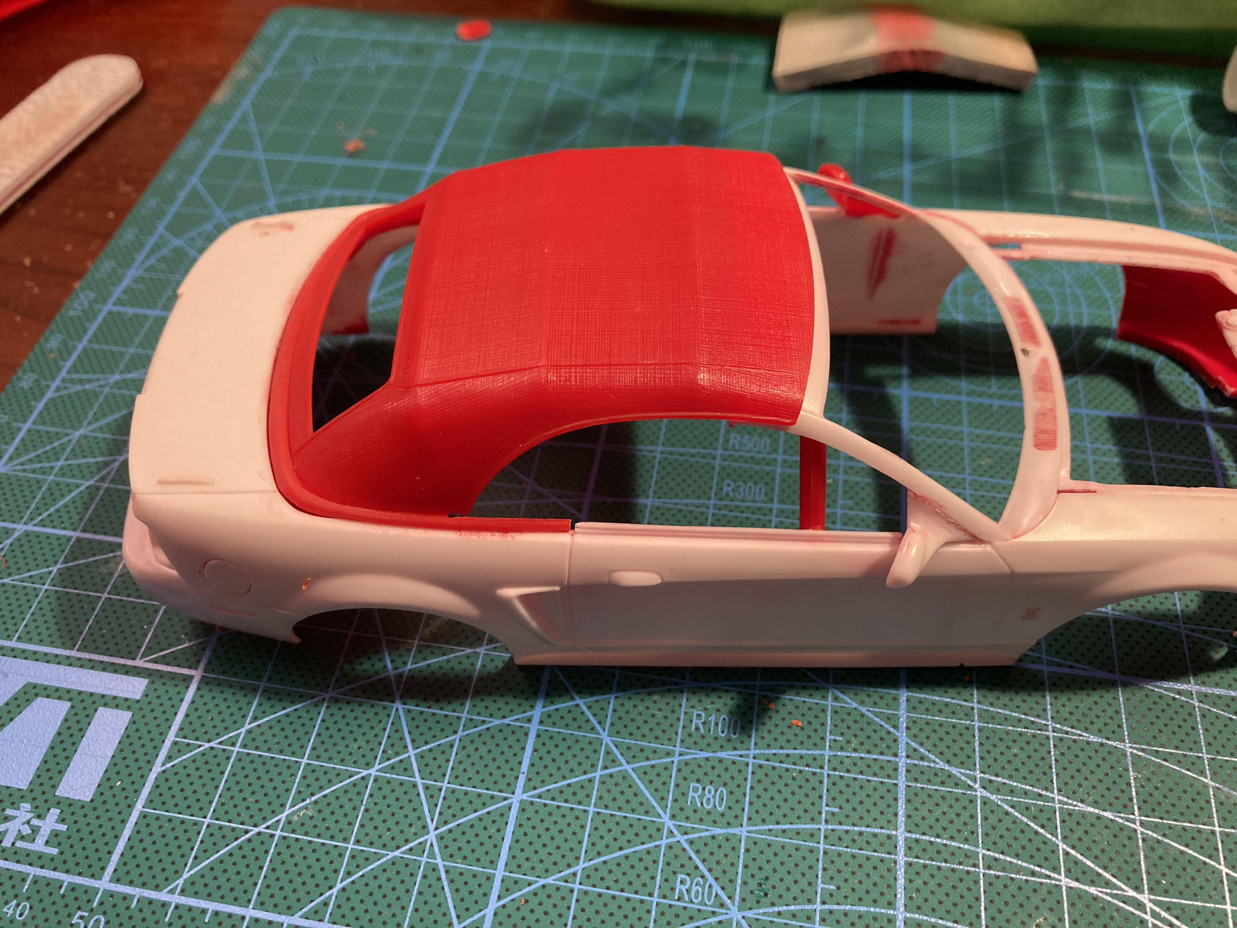

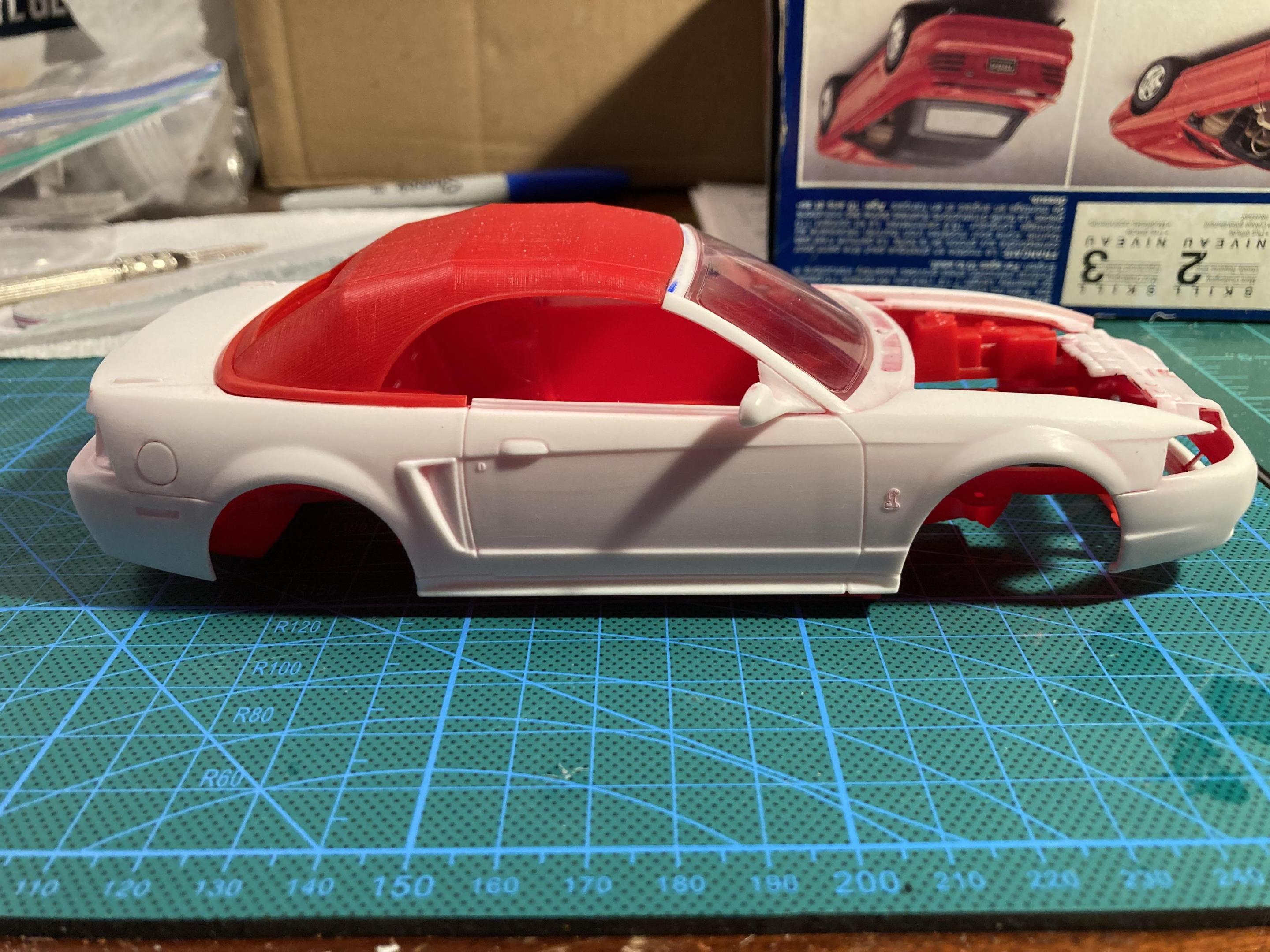

Here’s a quick mockup of the roof base trim. The trunk edge needed some shaping and filler will be needed where the rear roof pillar met the fender.IMG_1477.thumb.jpeg.b7a8a611040b6a379f53d14adf9e6105.jpegThe body and ‘99 Cobra-specific parts are ready for a soak in the purple power bath.

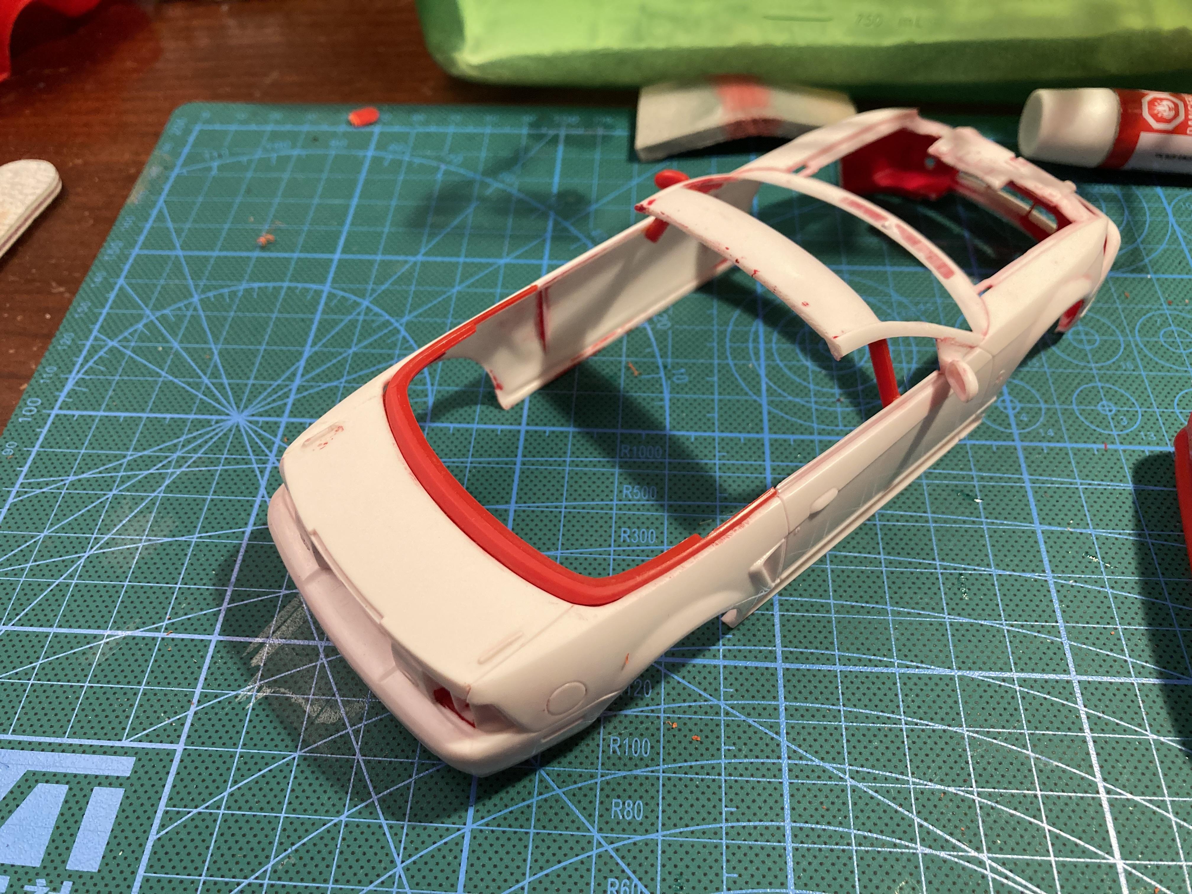

Some progress! I got the paint stripped and some sanding on the body.

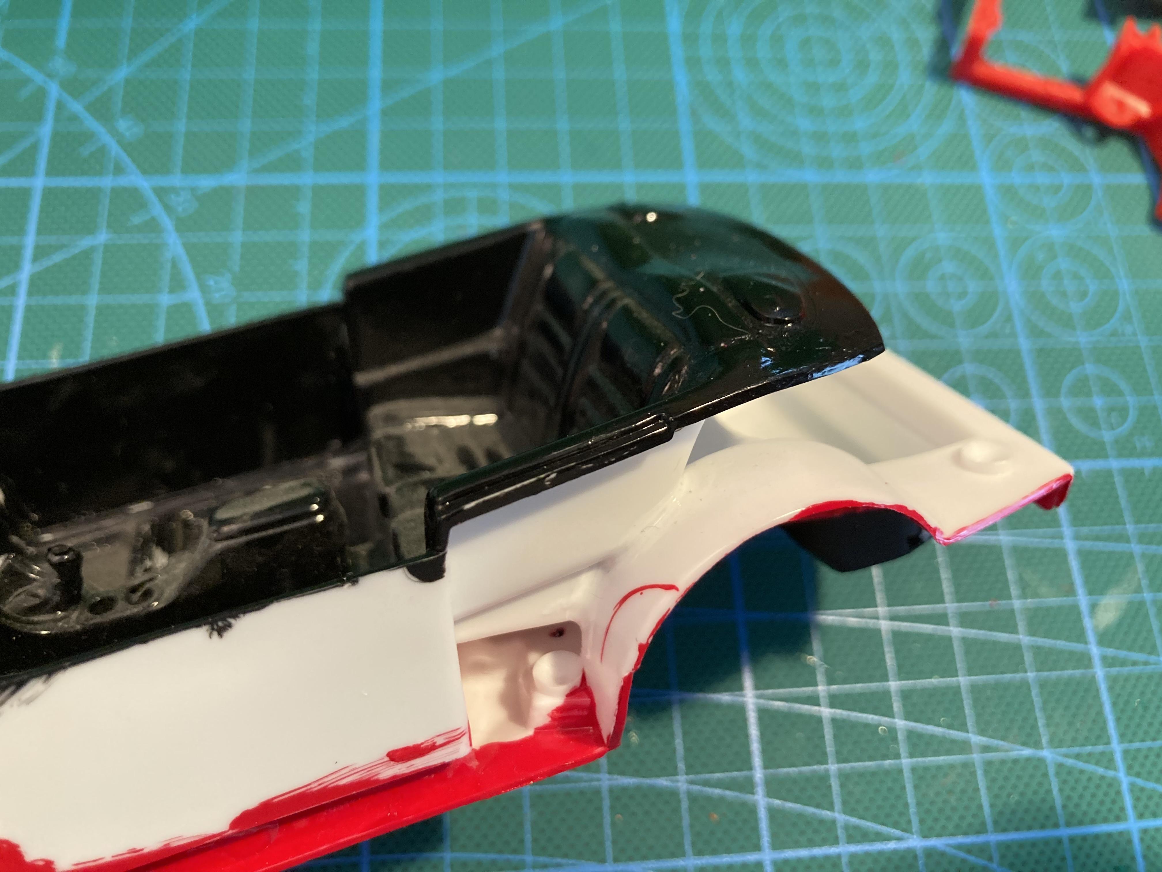

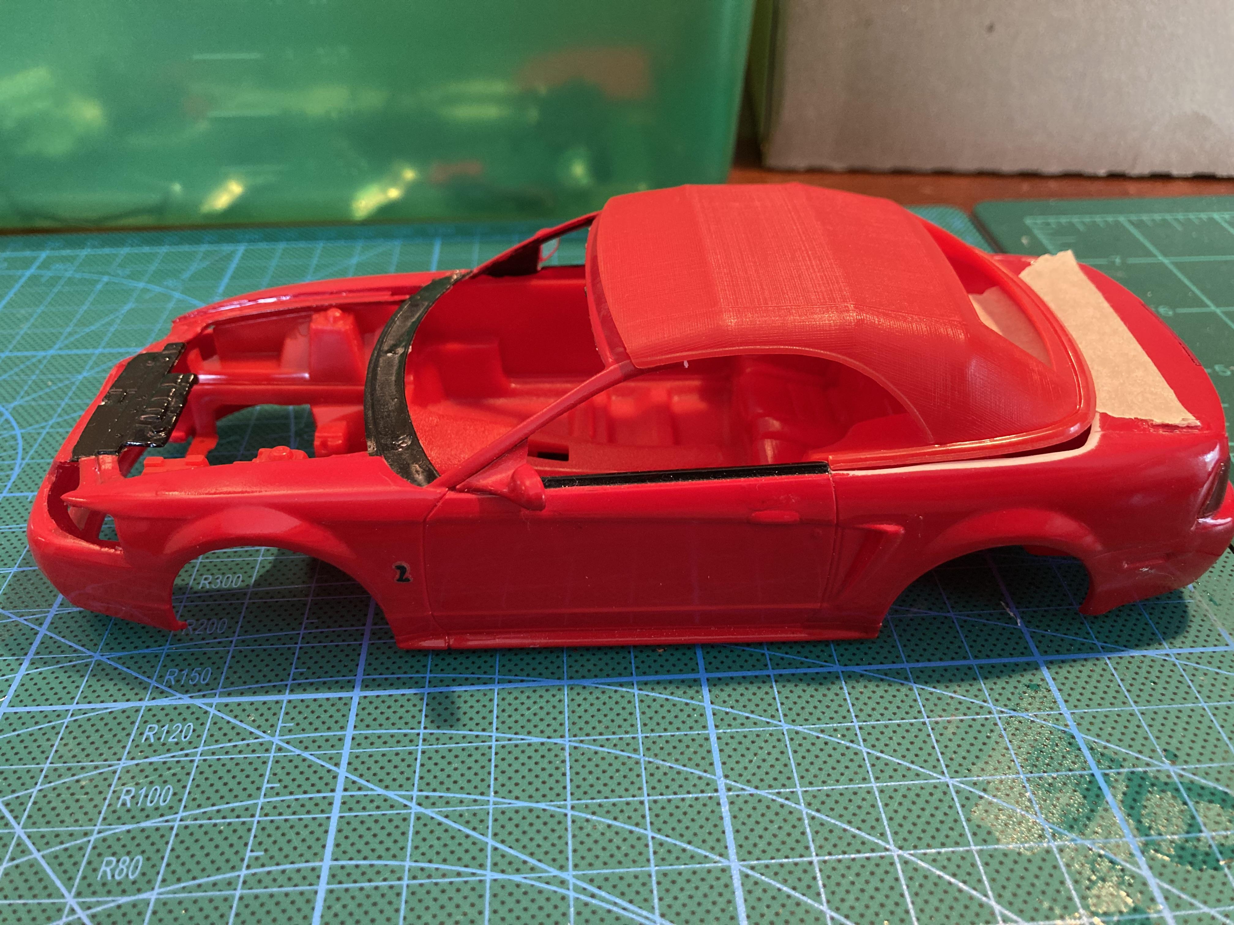

IMG_1481.thumb.jpeg.6b9c9d64a8ff233d3a29576f324003cd.jpegTo give the convertible roof trim somewhere to mount to, I cut a strip from the trunk lid of the ‘94 body and glued it under the trunk lid of the ‘99 to give it a lip.IMG_1483.thumb.jpeg.0e9174078fdc704bd23ca0e9eaf32a68.jpeg
I of course managed to break the passenger side A pillar before even touching the windshield frame, so I glued it and added some supports out of scrap sprue.

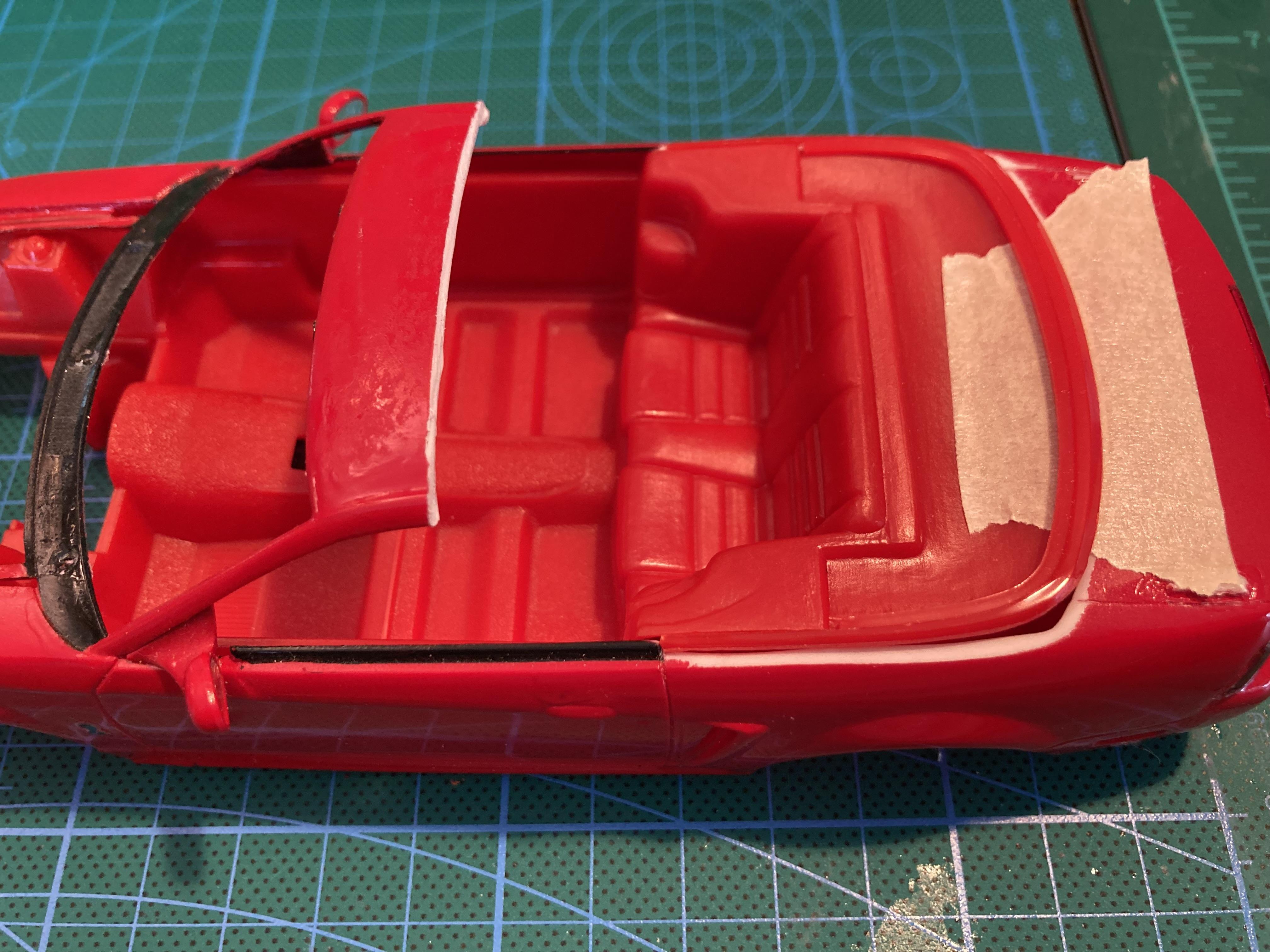

While rinsing the body, I snapped off the driver’s side mirror and it went straight down the drain. Luckily the ‘94 mirrors are identical to the ‘99, just like the real cars. I re-glued the mirrors to give more strength to the A pillars. IMG_1484.thumb.jpeg.94d7839da4afef7f37edee3009b411c6.jpegThe trunk edge will need some fine tuning but the roof trim is starting to look like it belongs there!

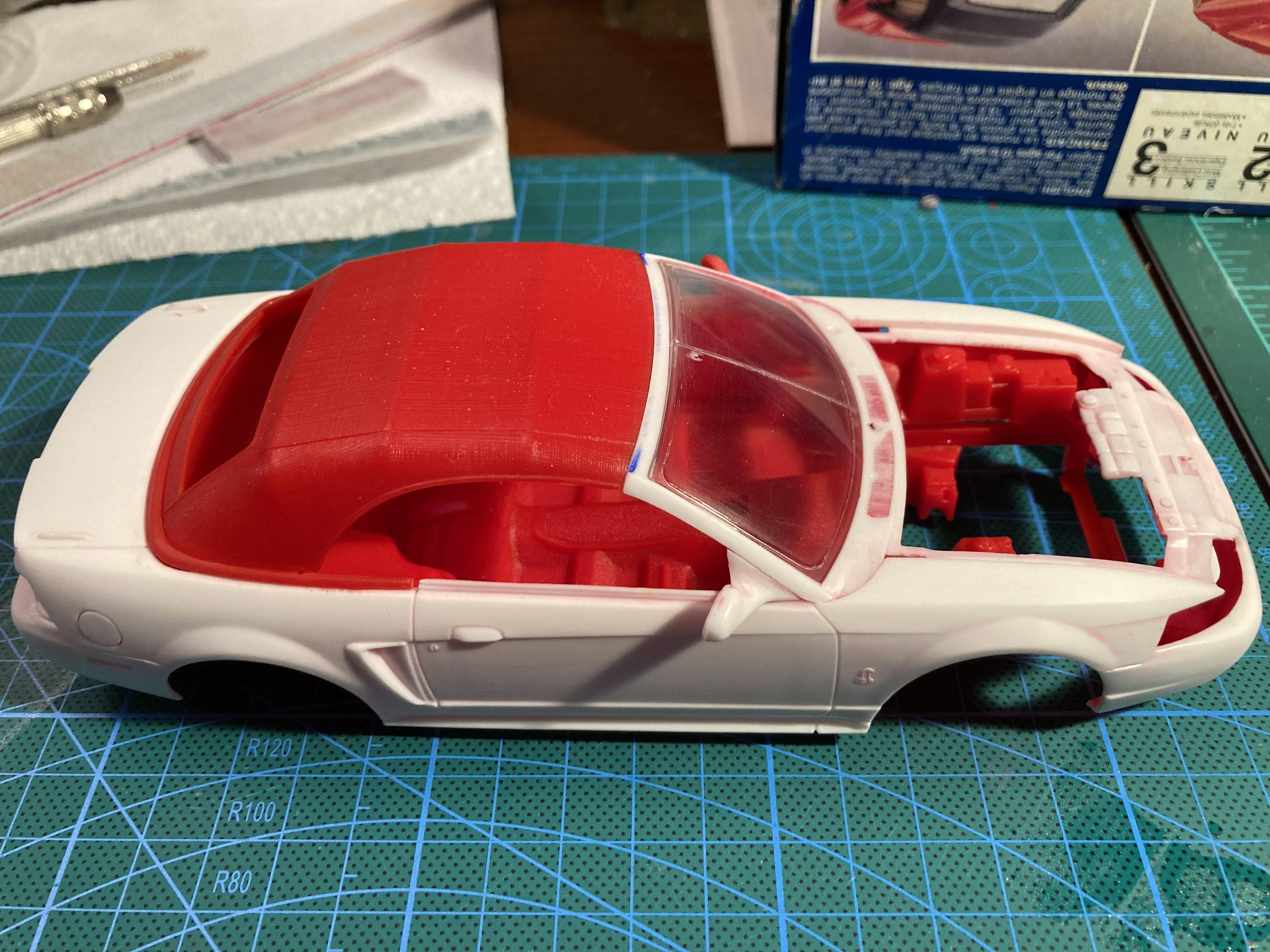

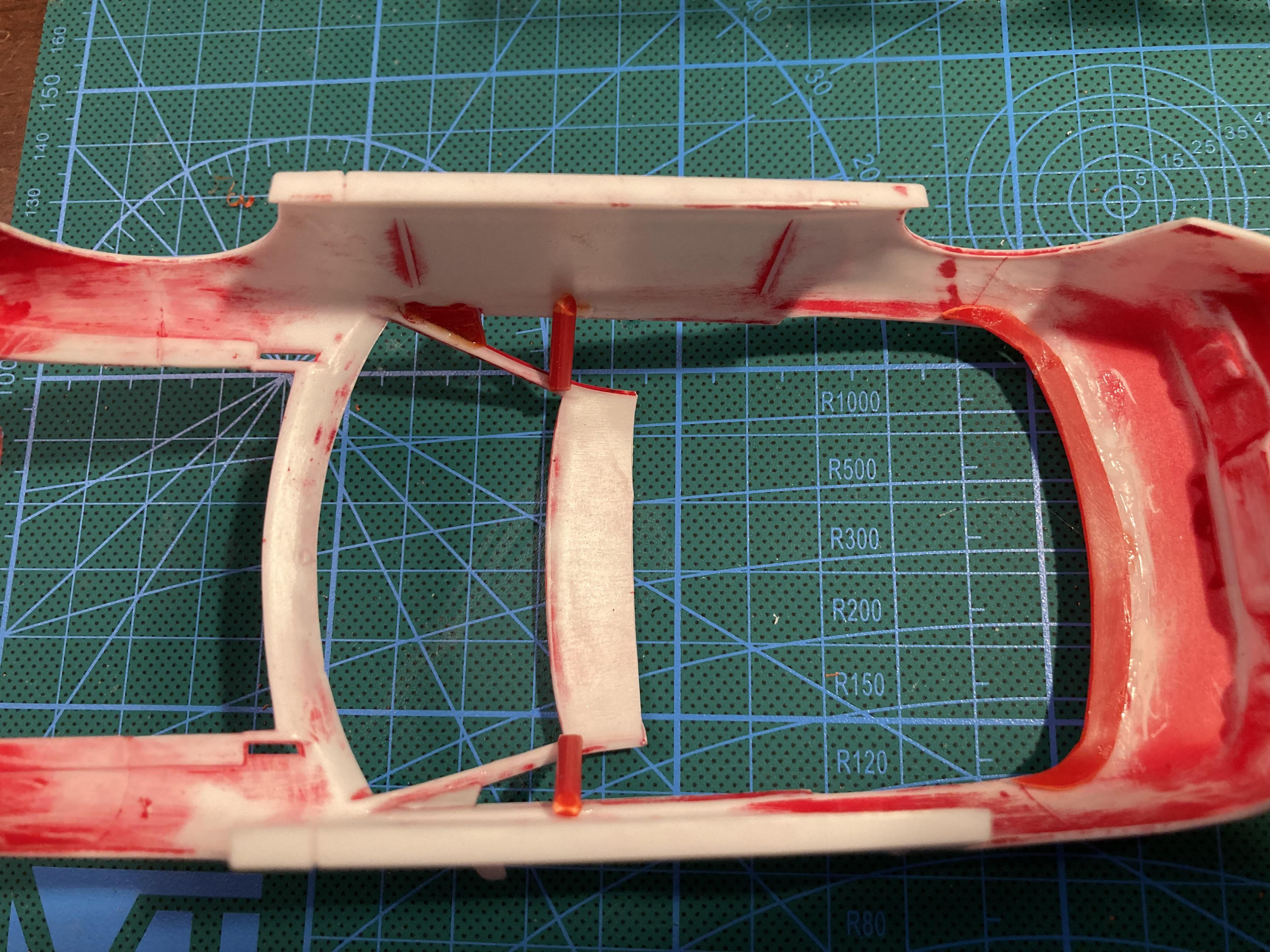

Needed another mock up of the up-top! I am definitely nervous about trimming the top of the windshield frame. Might add more scrap sprue to reinforce it.

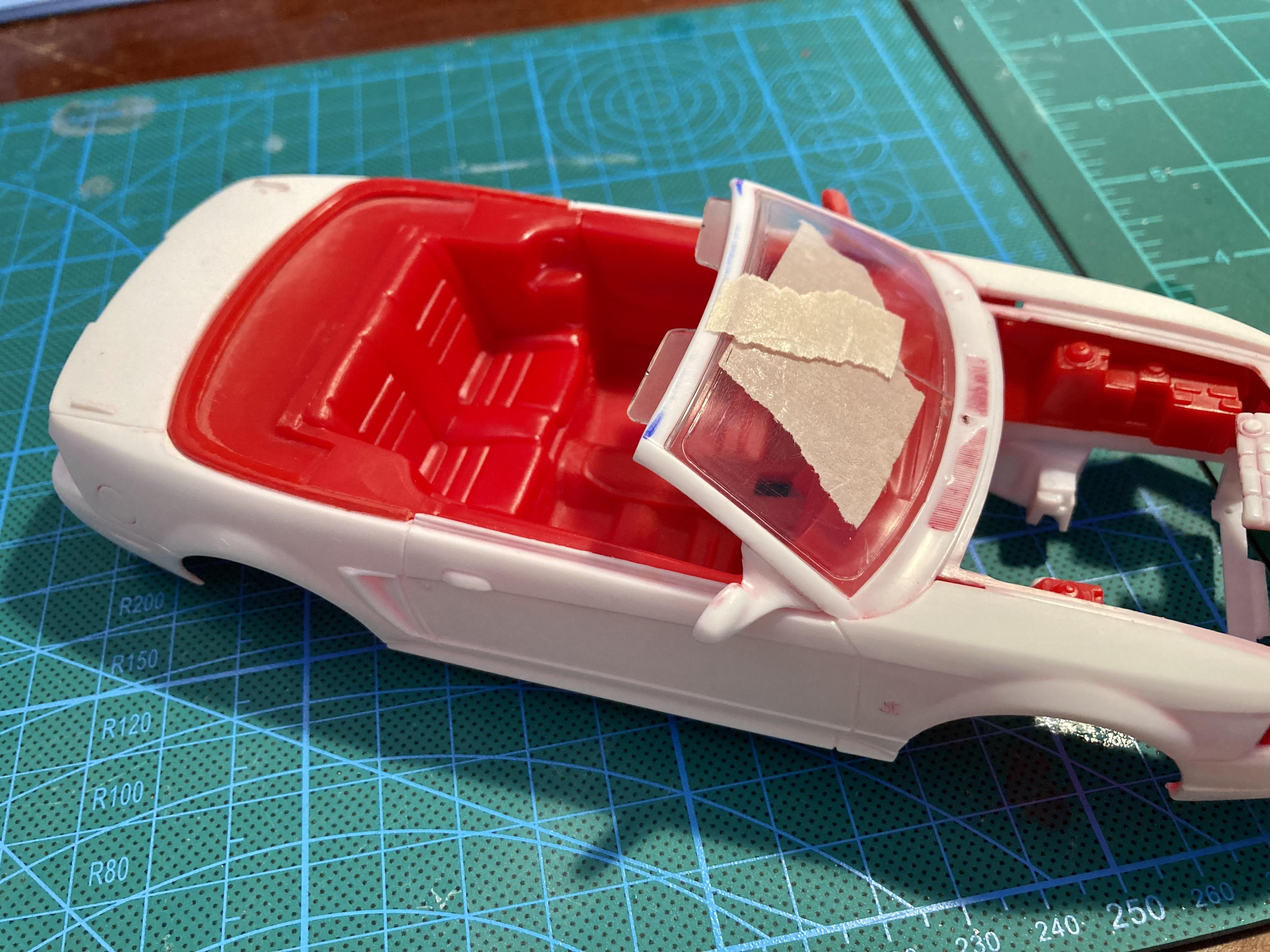

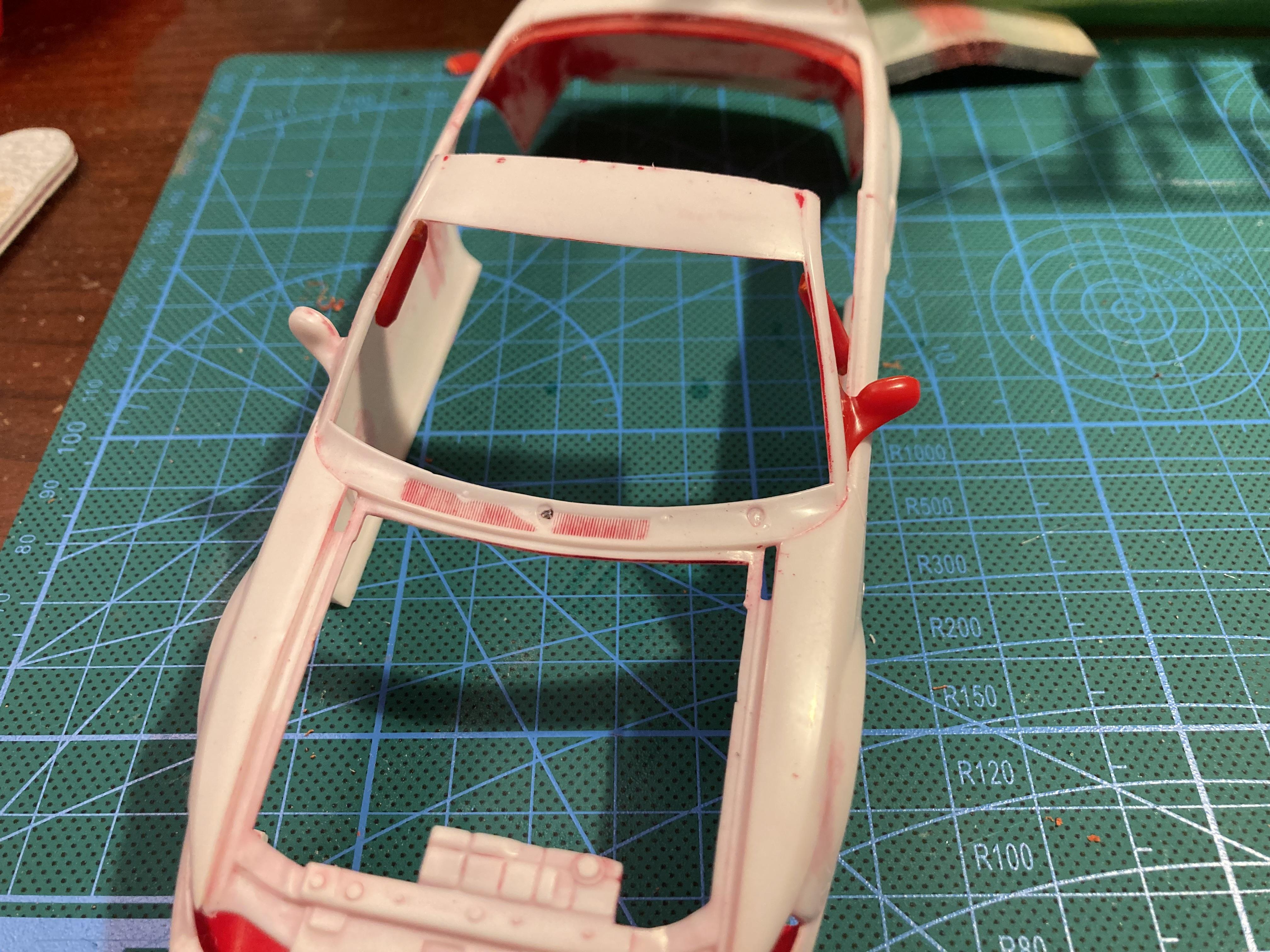

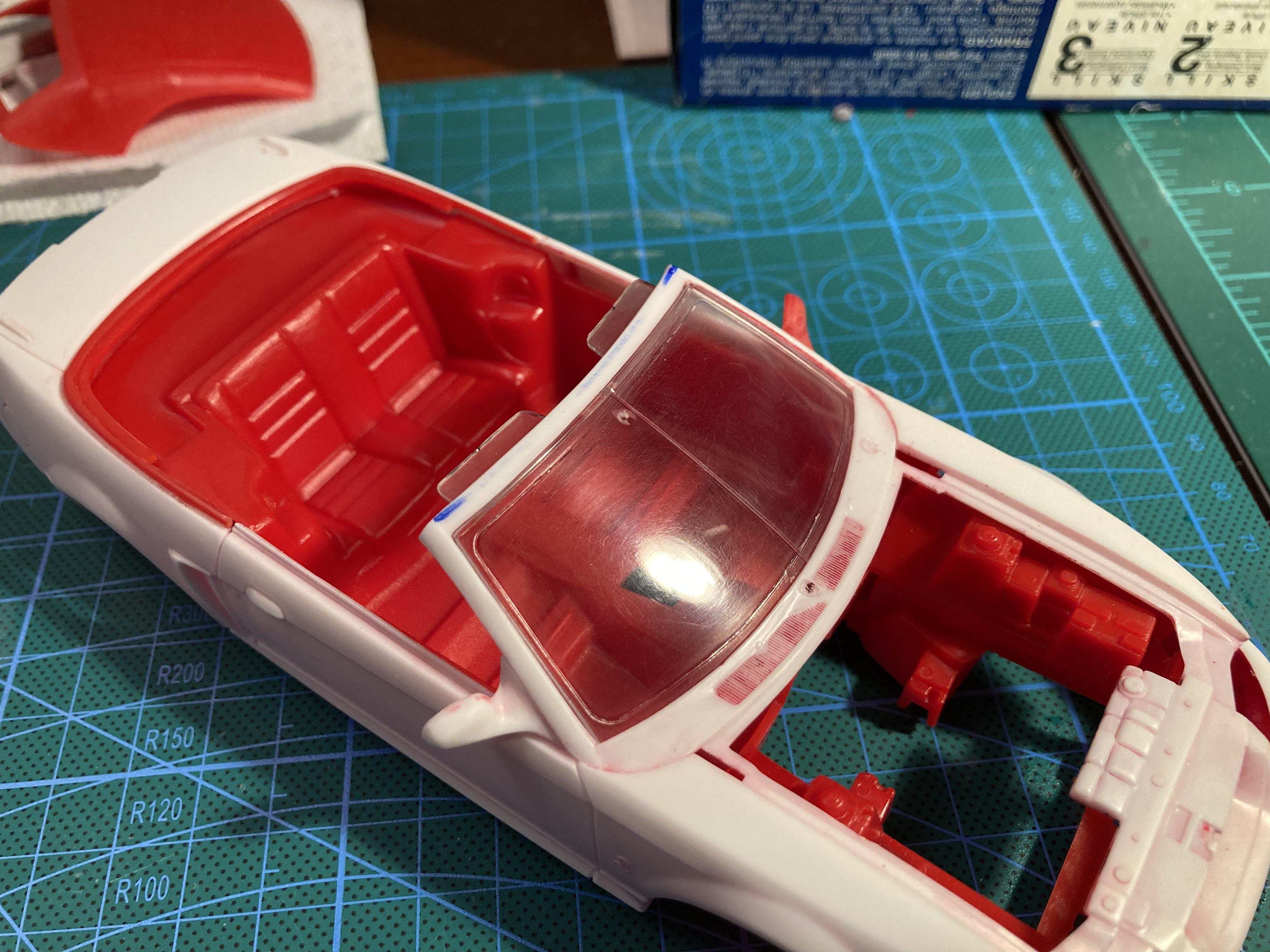

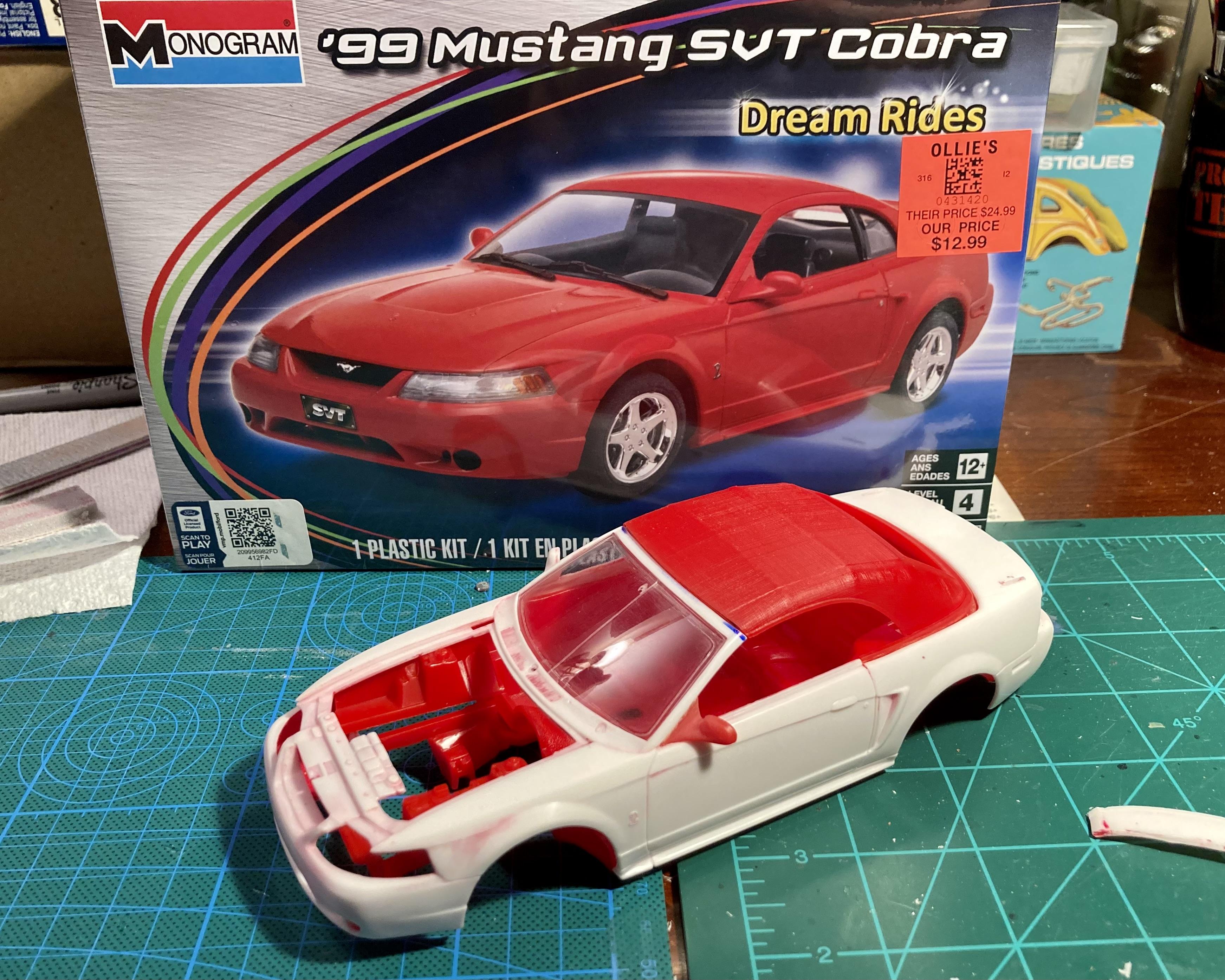

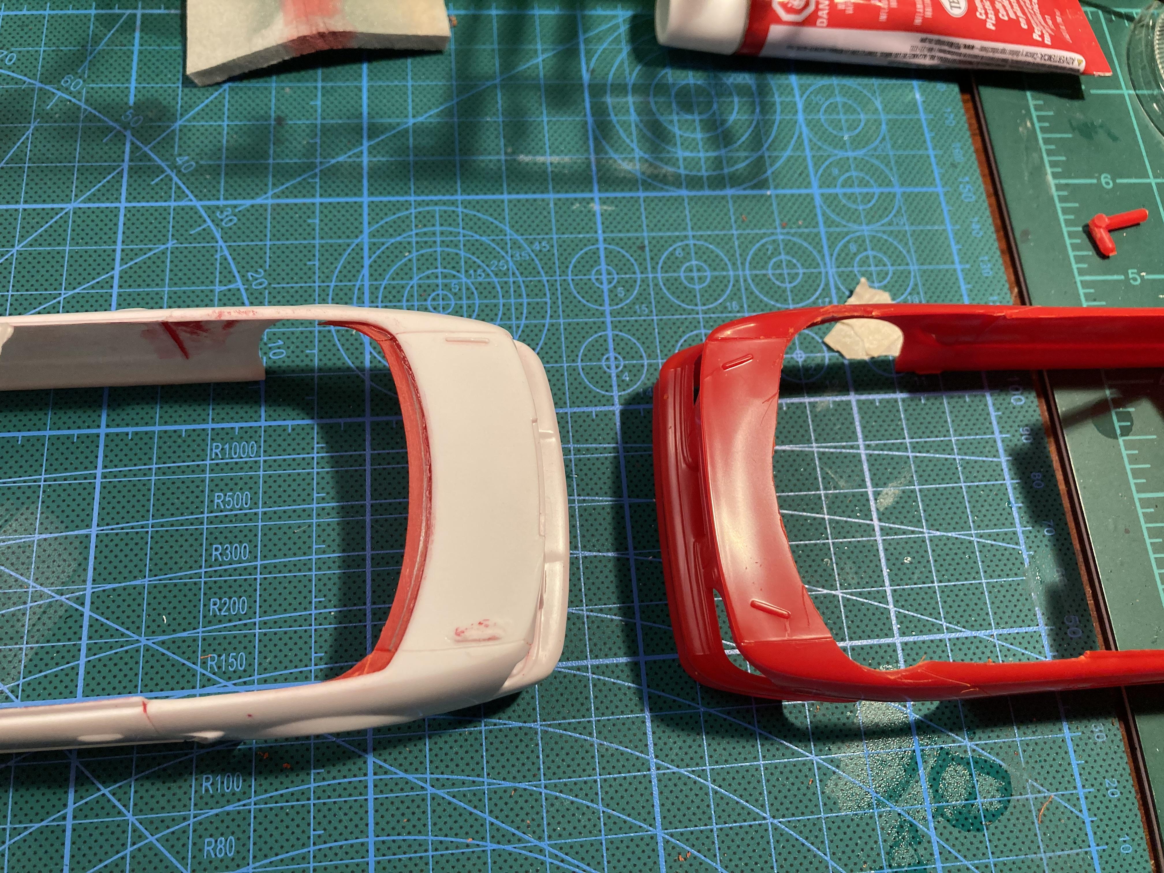

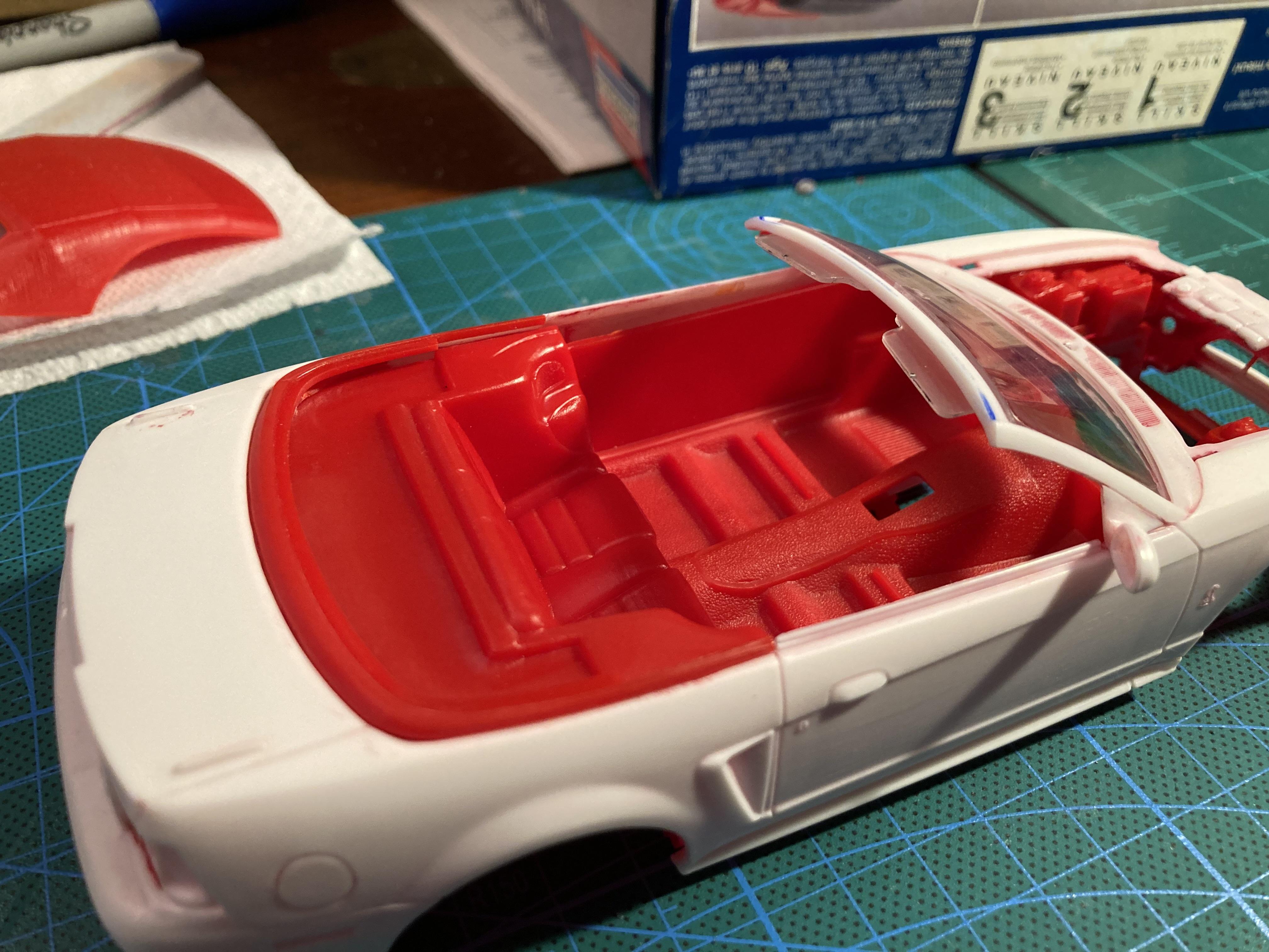

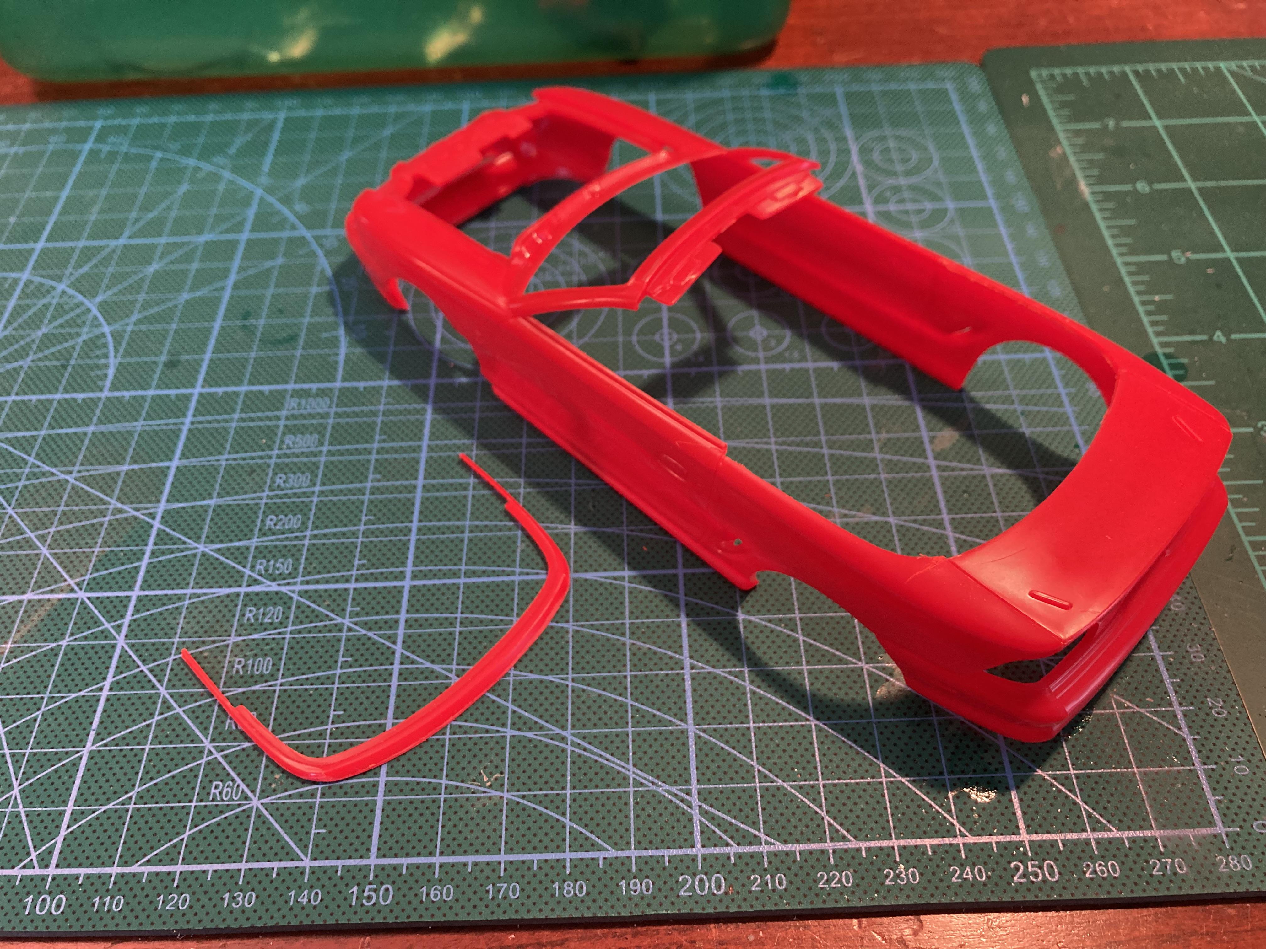

Windshield frame is complete! I managed to get it cut and sanded without any more damage to the A pillars or header. I did manage to crack the windshield itself while trying to polish out a glue blob. Luckily these kits are $13 at Ollie’s right now so I grabbed another. I’m probably going to use all of the parts (except for the body) from the new kit instead of trying to save my old glue bomb parts.IMG_1494.thumb.jpeg.86b519cdfeabef488157dc84f7bc078c.jpegIMG_1490.thumb.jpeg.4bab0e9cb462ad85f114cf3e47e698de.jpegIMG_1491.thumb.jpeg.0831a05ddc7e0db84a11760db153866b.jpegIMG_1492.thumb.jpeg.fb6d58034e17597b62f2bdc41fd2dfa4.jpegIMG_1493.thumb.jpeg.4afb121cffa485110814d286c5732f39.jpeg
The ‘99 windshield does already have sun visors molded in so that’s a nice detail I won’t have to come up with. Plus they give a place for the up-top to rest on.

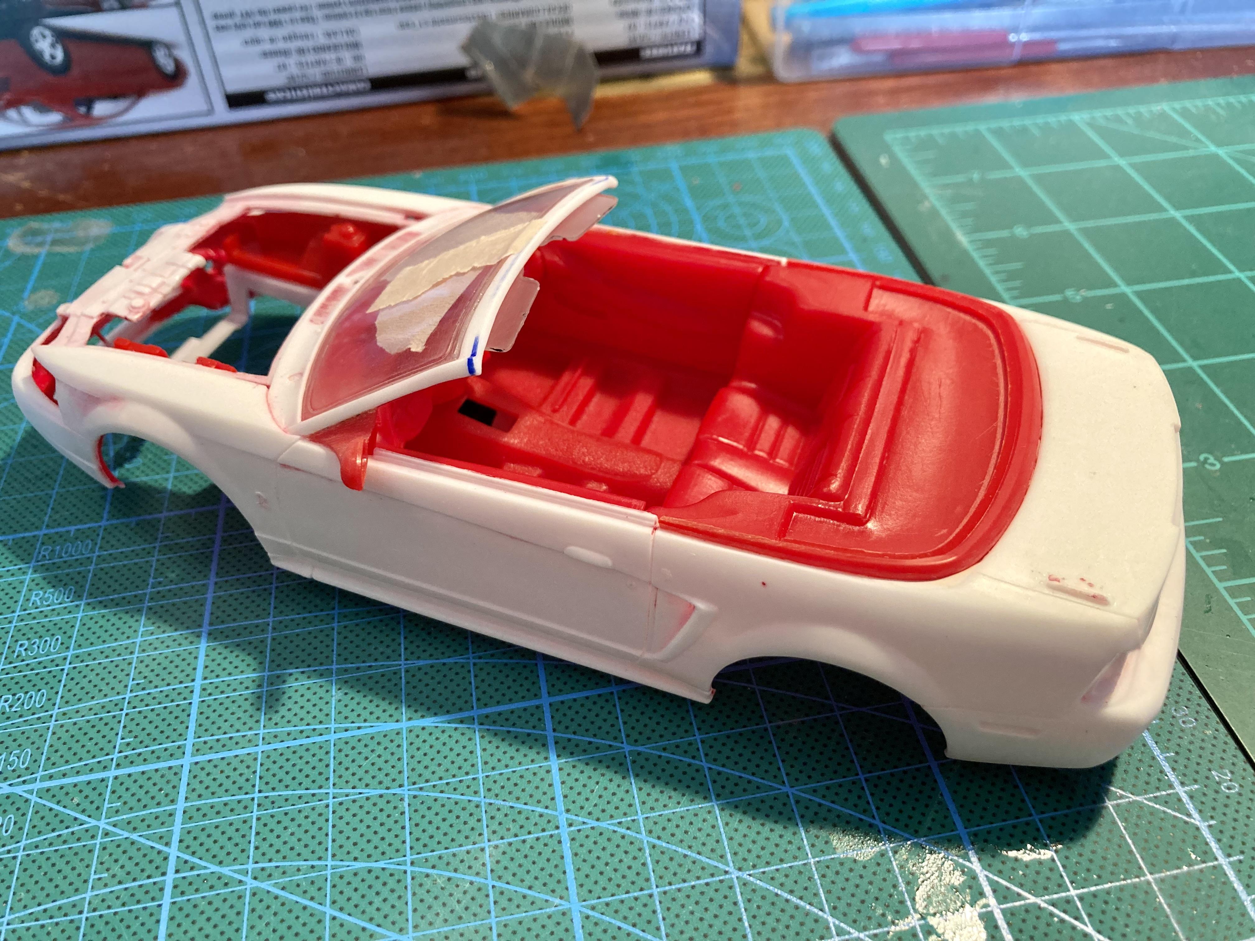

Another update: the body mods are done and it’s ready for primer! I haven’t set up my paint booth yet after my recent move but hopefully I’ll get this primed and painted soon.IMG_1505.thumb.jpeg.0a256a55709b304d8061d17d4b98e0ce.jpegIMG_1506.thumb.jpeg.4d72a85065b9143ecc815895a1eaf3e6.jpegIMG_1504.thumb.jpeg.44098debf3e442aae659ae7f6f113aa9.jpegIMG_1507.thumb.jpeg.6ae6dd80a14df004fc56da8fc7202189.jpegIMG_1508.thumb.jpeg.6cf0e66e1b9e9e4feeab8f9695377603.jpeg

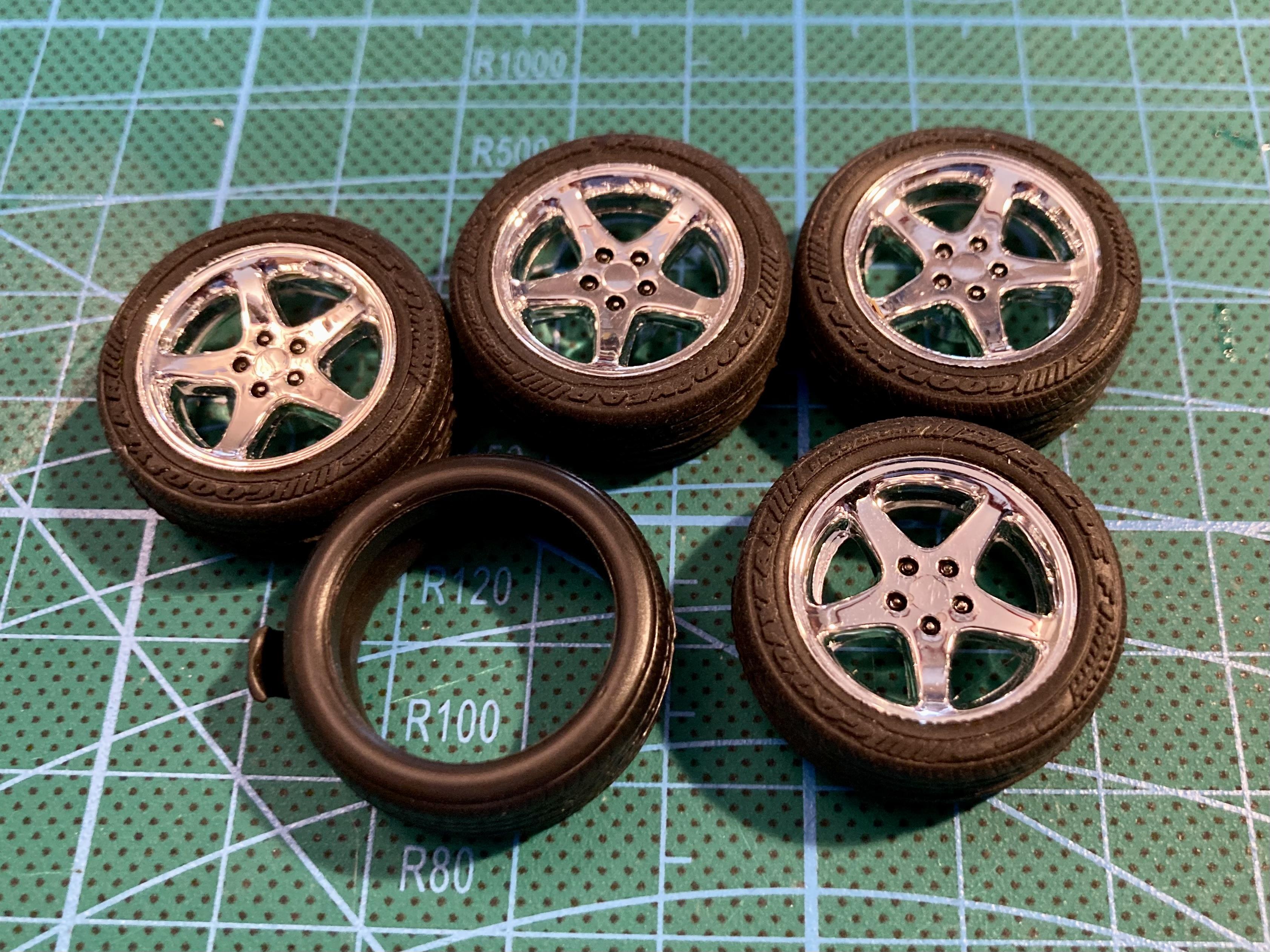

Quick update: wheels are done. I’m going with full chrome even though I don’t think it’s factory… just a simple black wash in the lug nut holes. I’m using the Goodyear Eagle tires from my O.G. release over the new Ollie’s special, since the new kit tires have no sidewall detail. IMG_1539.thumb.jpeg.eafdcb96577fbee179af6b1cf178f588.jpeg

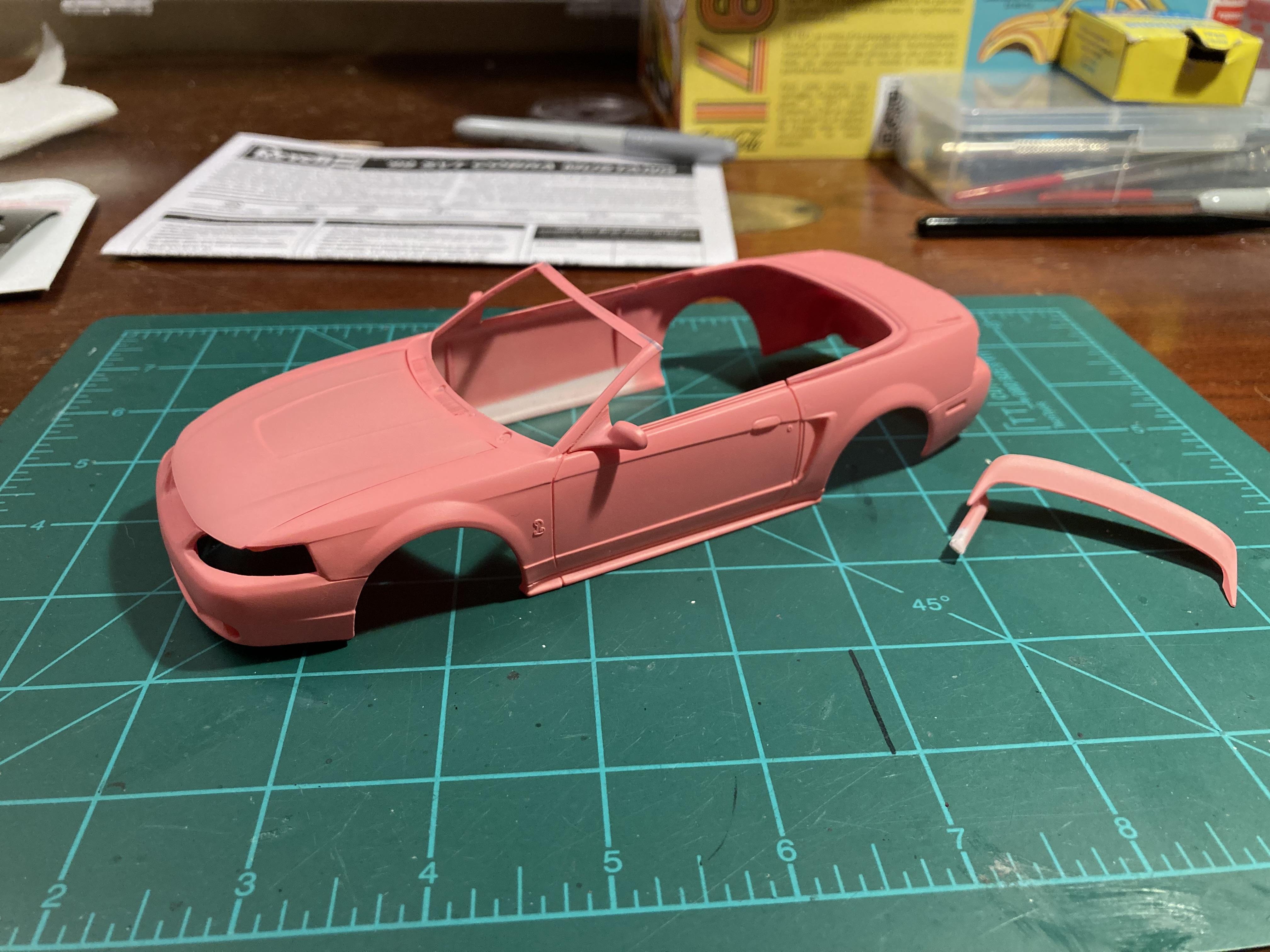

I’ve made some progress, primed the body in pink to help cover the red plastic parts. IMG_1546.thumb.jpeg.e3e3a3b7ee78a490dc53eee5090e6881.jpegIMG_1547.thumb.jpeg.028fb4f3410285781fb54554d0599fa2.jpeg

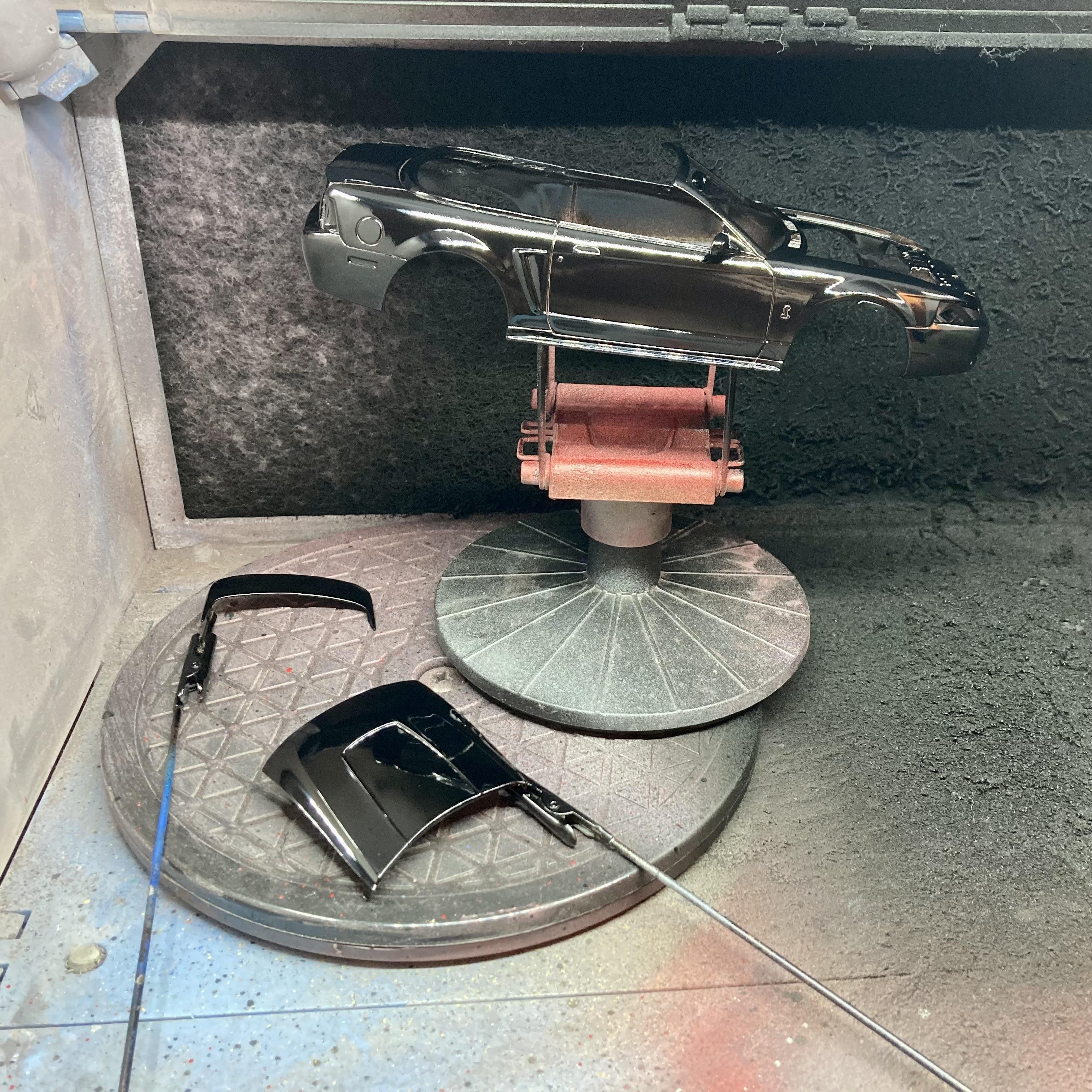

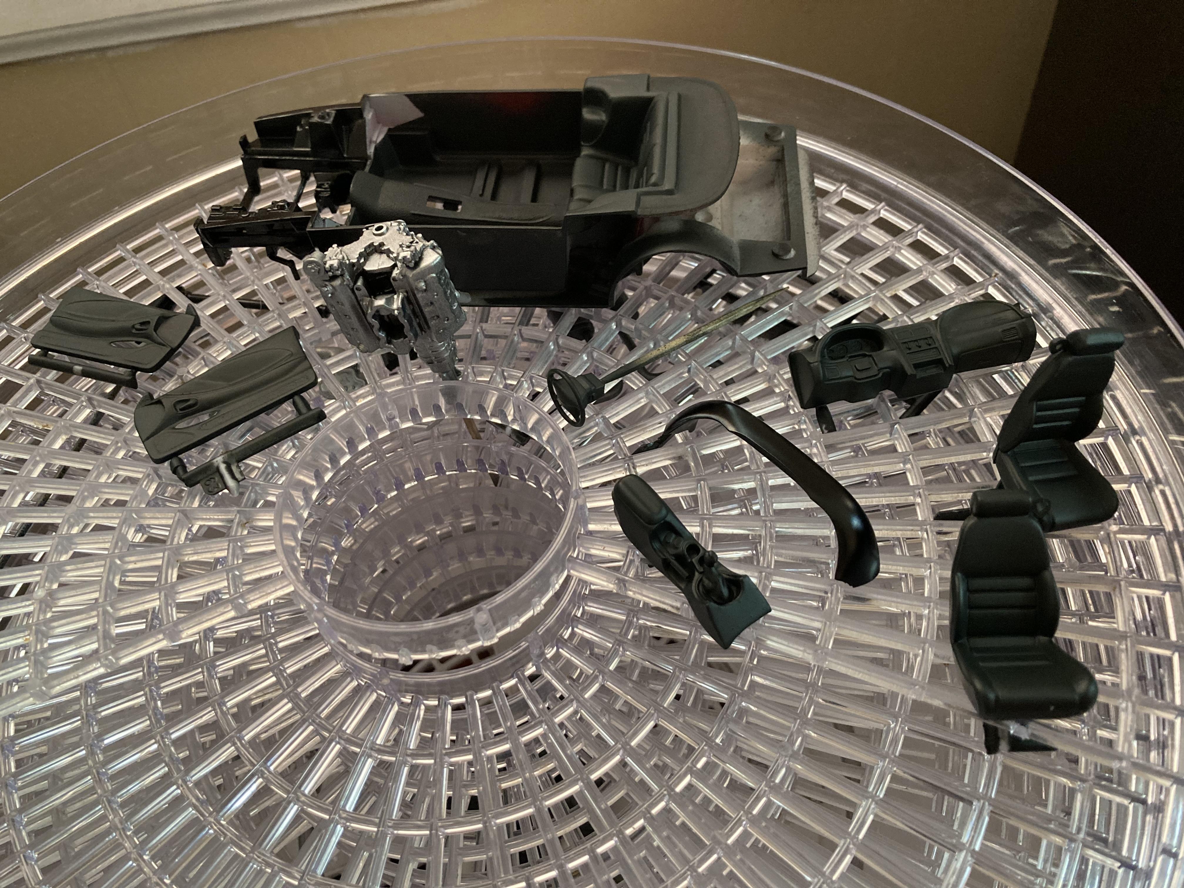

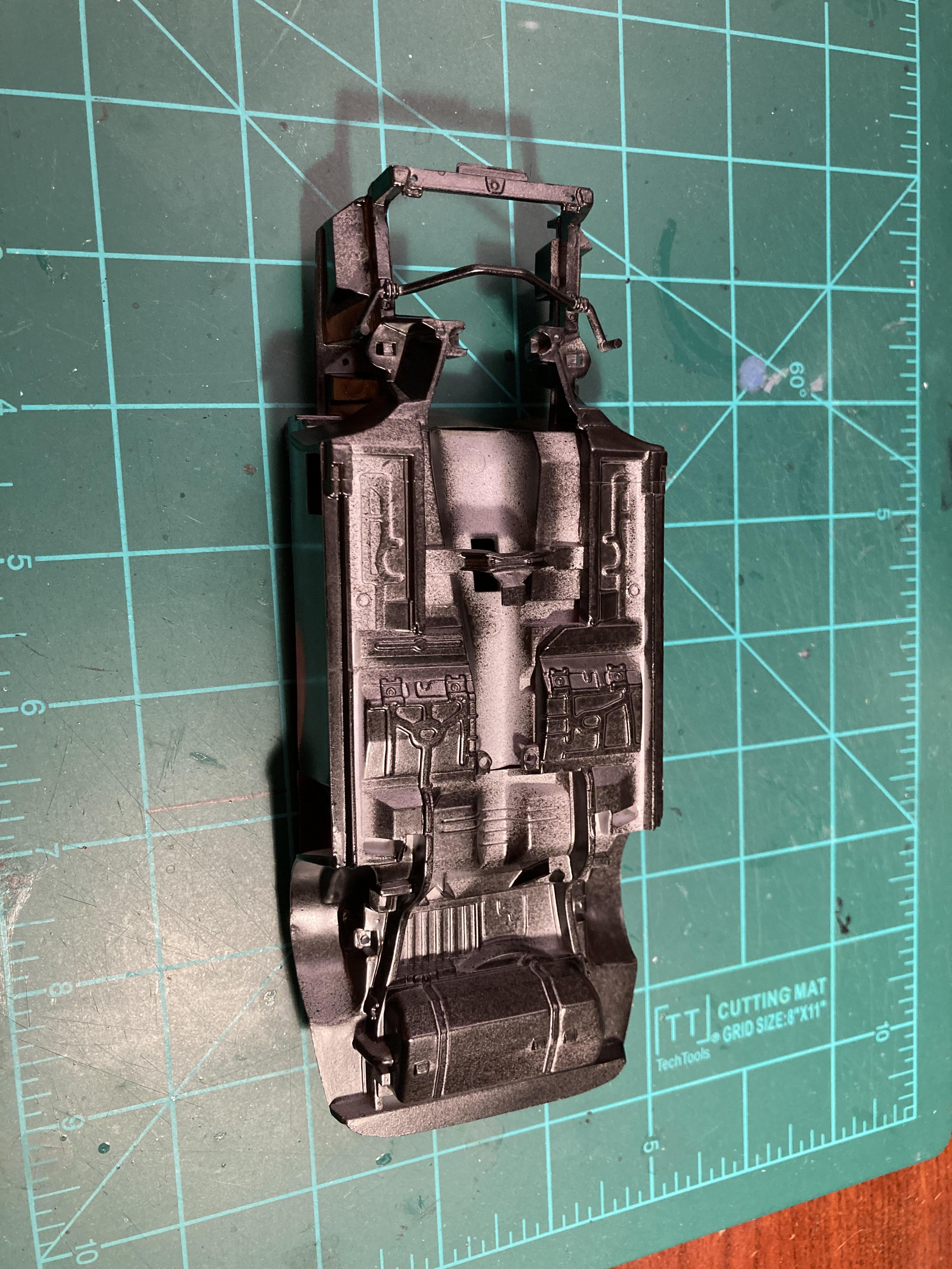

At this point I was still leaning towards red or yellow but I decided to go with black. I should have done another primer coat in gray or black, because my black gloss coat didn’t flow into the body seams so now there’s pink showing through. I’ll try a black wash in the seams to cover it I guess?IMG_1549.thumb.jpeg.4a62a079f9fb6d096d60af8e9a6475a8.jpegI’ll have to wet sand and do another color coat anyway so we’ll see how it goes. I might have to strip this one and start over. But I’m loving the triple black look so I’ll see it through!IMG_1548.thumb.jpeg.deca487fa08d5618be6d547133c55f7a.jpegI did prime the chassis in gray and gave it a black overspray coat. IMG_1550.thumb.jpeg.0ac12587b90419f769ac1aec63cf8310.jpegInterior, chassis and drivetrain parts are painted and curing in the dehydrator. Detail painting to come!

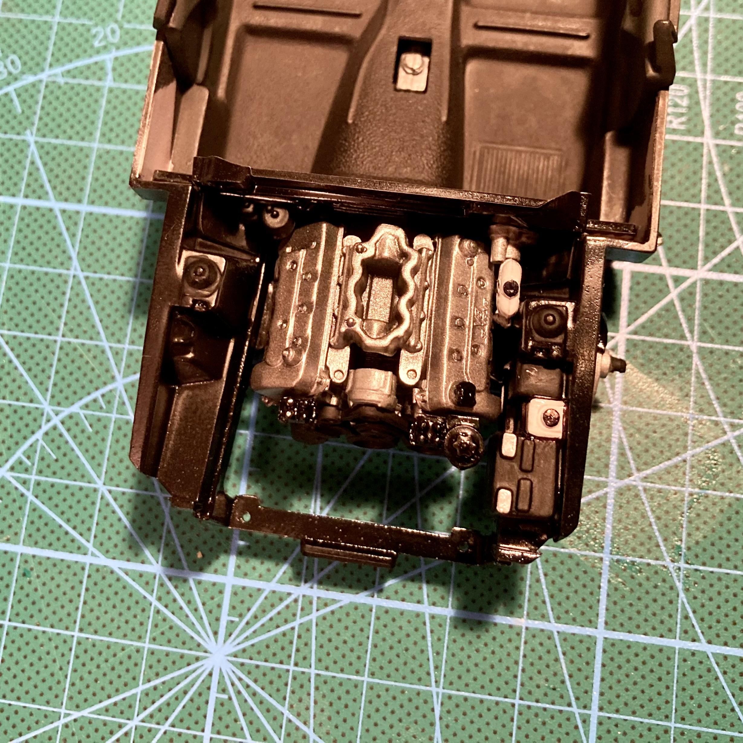

I haven’t forgotten about this build! I got the engine and chassis detailed and assembled. I’m still summoning the motivation to finish the body paint job but it’s going to happen soon.IMG_1721.thumb.jpeg.61c5984577bc4da34b3f6a6aab0f13b6.jpegIMG_1723.jpeg.b14017c59cc3387ce767a73cd26081a4.jpeg

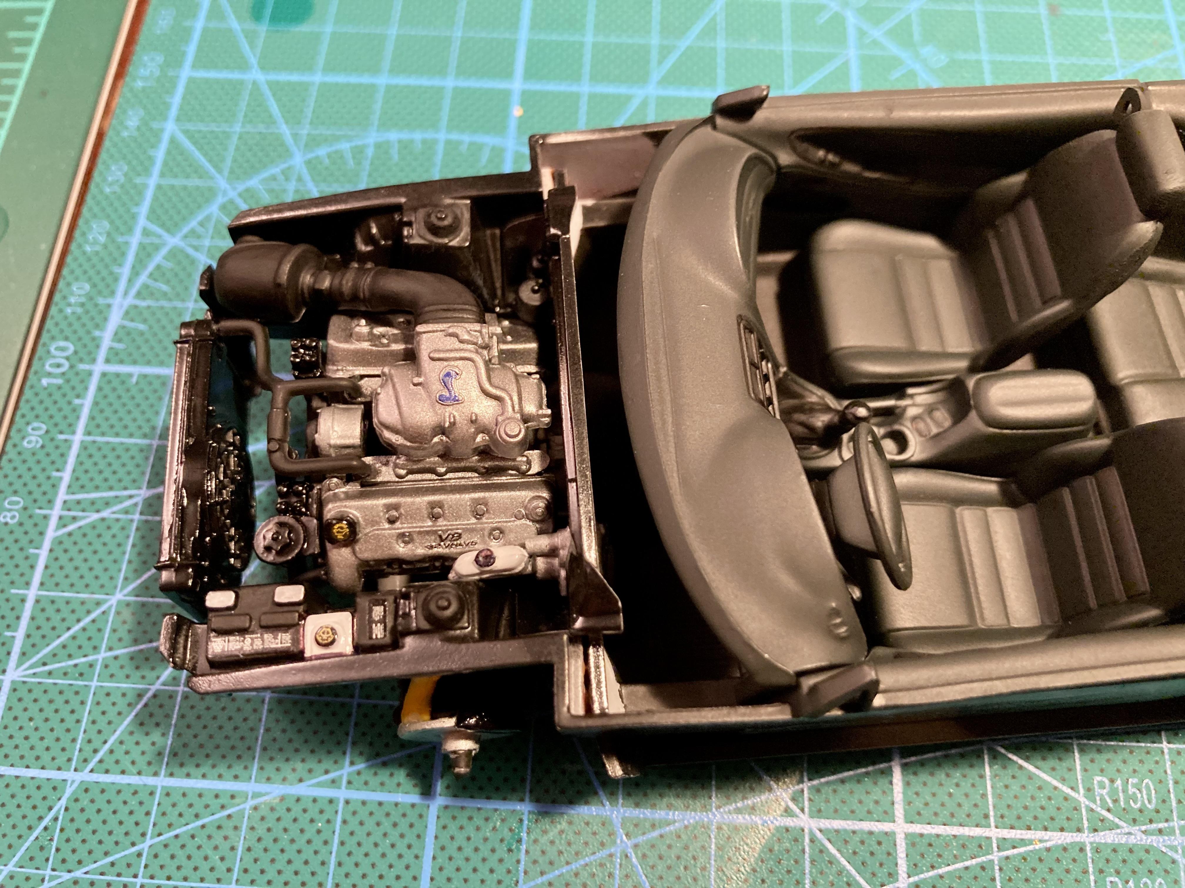

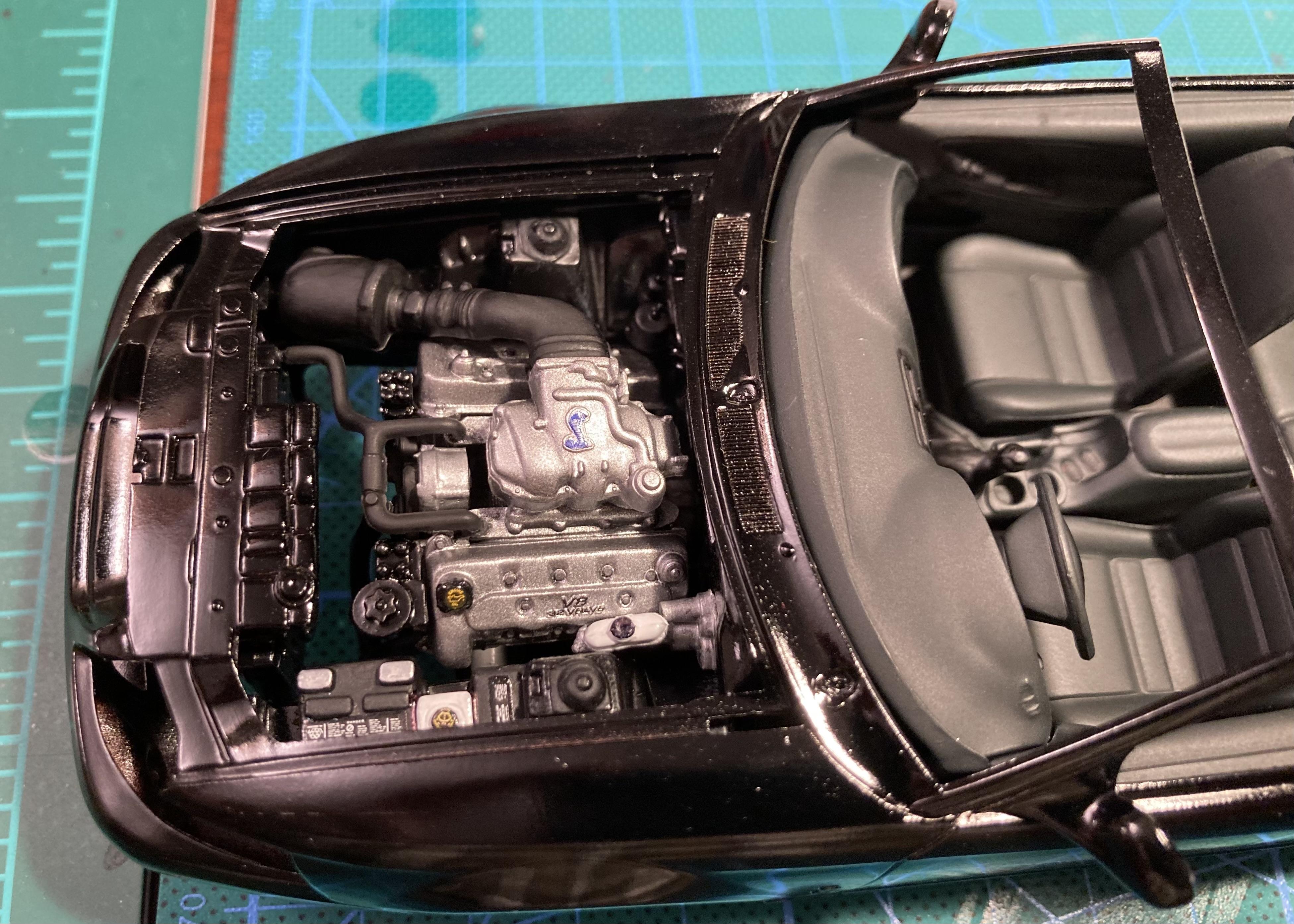

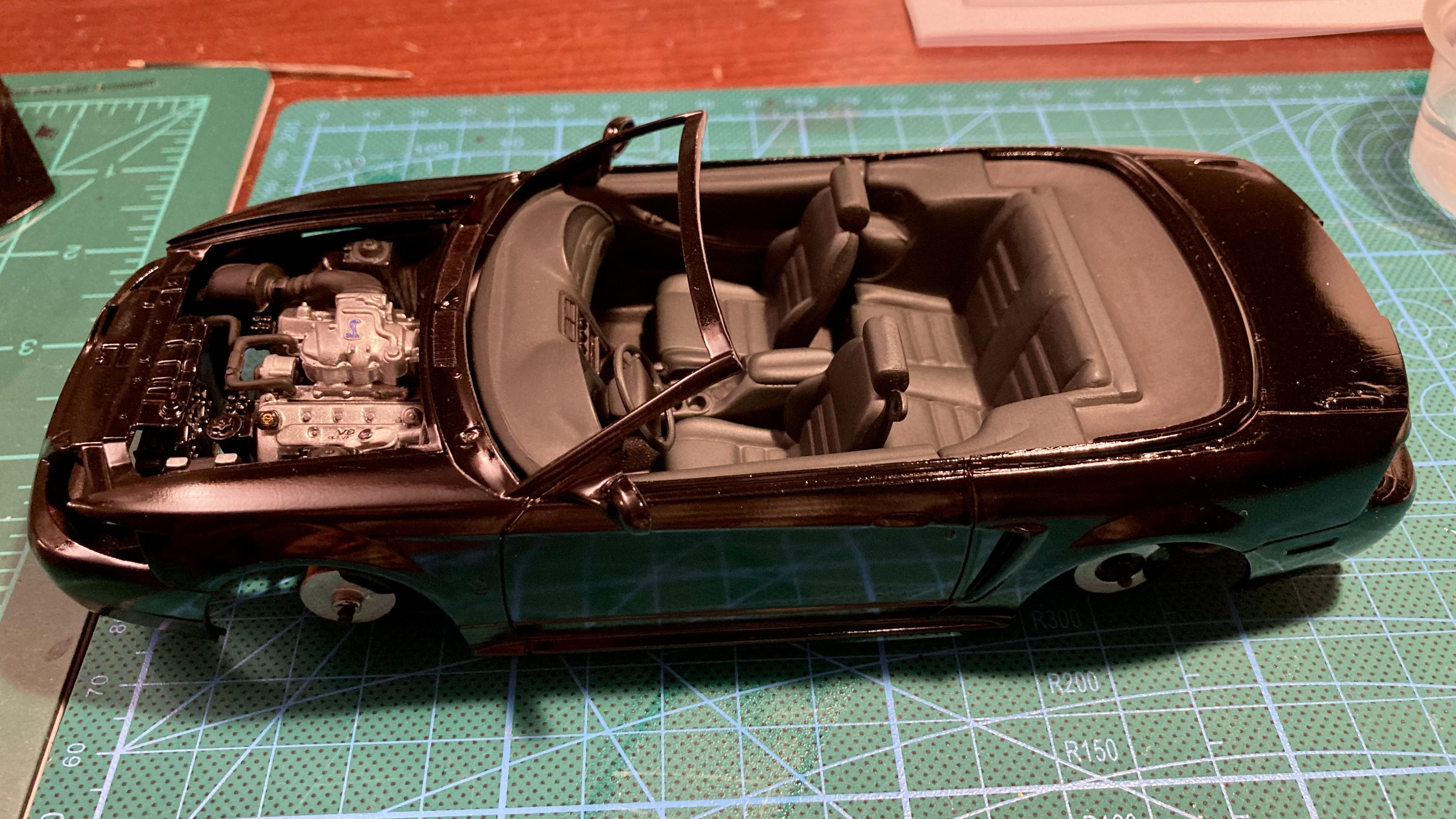

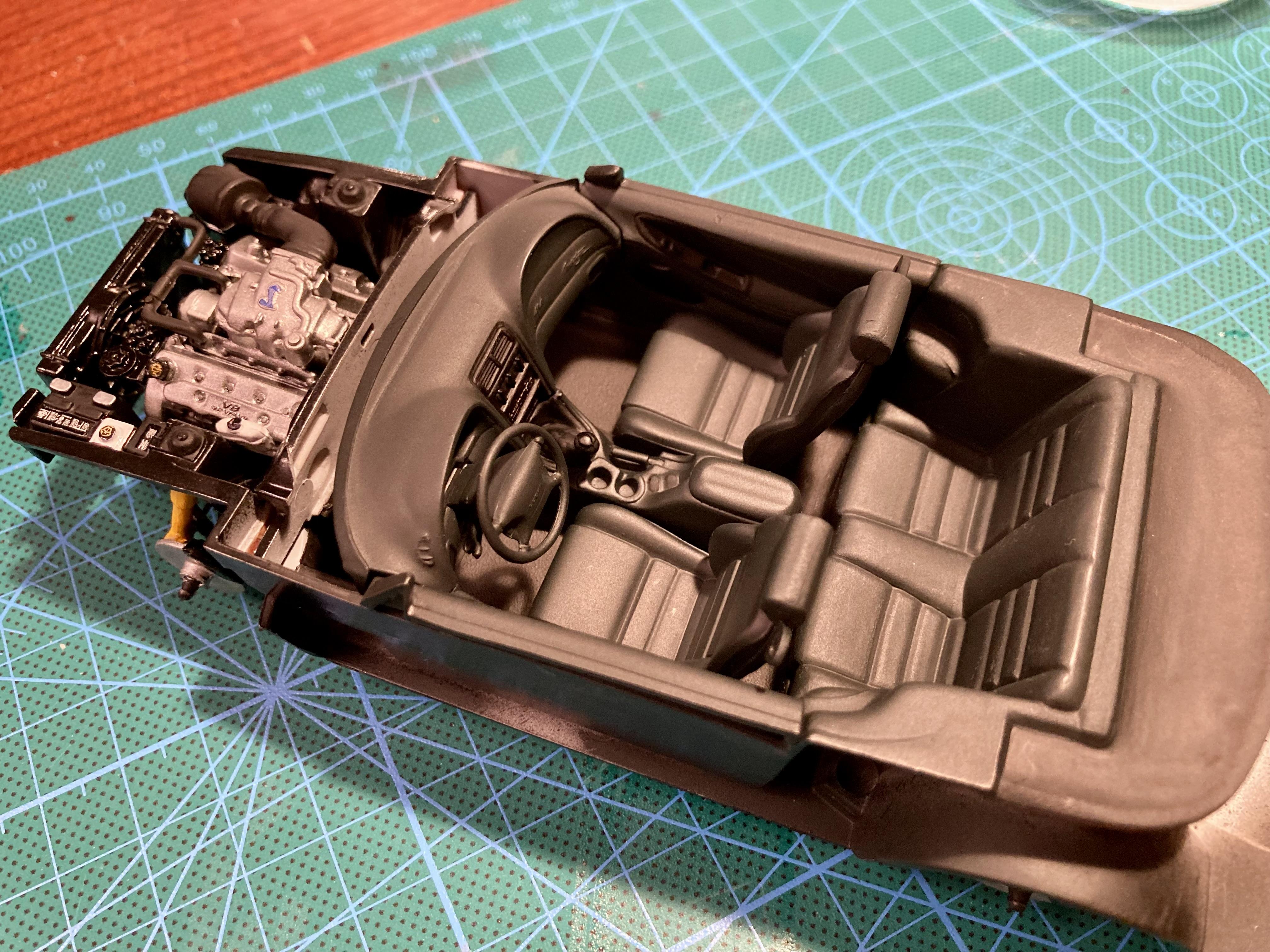

Another quick update: engine bay is now complete with decals.IMG_1729.thumb.jpeg.f789437b264be93a39da8890daba2f27.jpeg

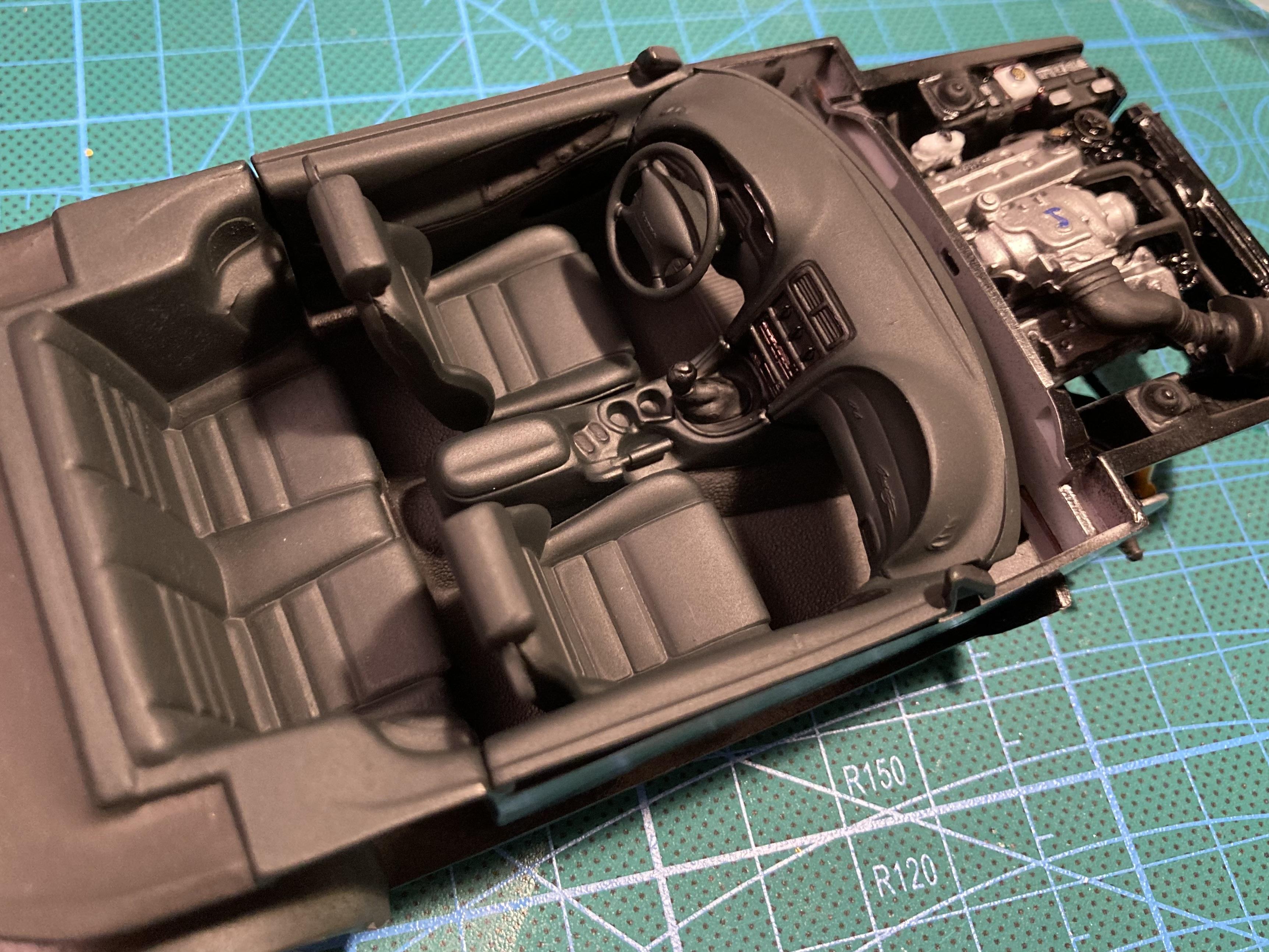

Along with the interior. I painted interior in Tamiya NATO black for a more charcoal-black look with primer black carpet and some of the trim in Tamiya flat black acrylic.IMG_1730.thumb.jpeg.1e754672bd023a746ffb583b49d13805.jpegIMG_1731.thumb.jpeg.83de5dd2d5ff76a7e3c4b65589afd284.jpeg
 I test fit the body. I will need to shave the firewall down a little because the front half of the body isn’t sitting down quite right. IMG_1734.thumb.jpeg.cbfc91f0fb15bc81eb13c1d4b1c01461.jpegIMG_1735.thumb.jpeg.9a45f6c89441c5a80b8ee1f62fe1b868.jpeg

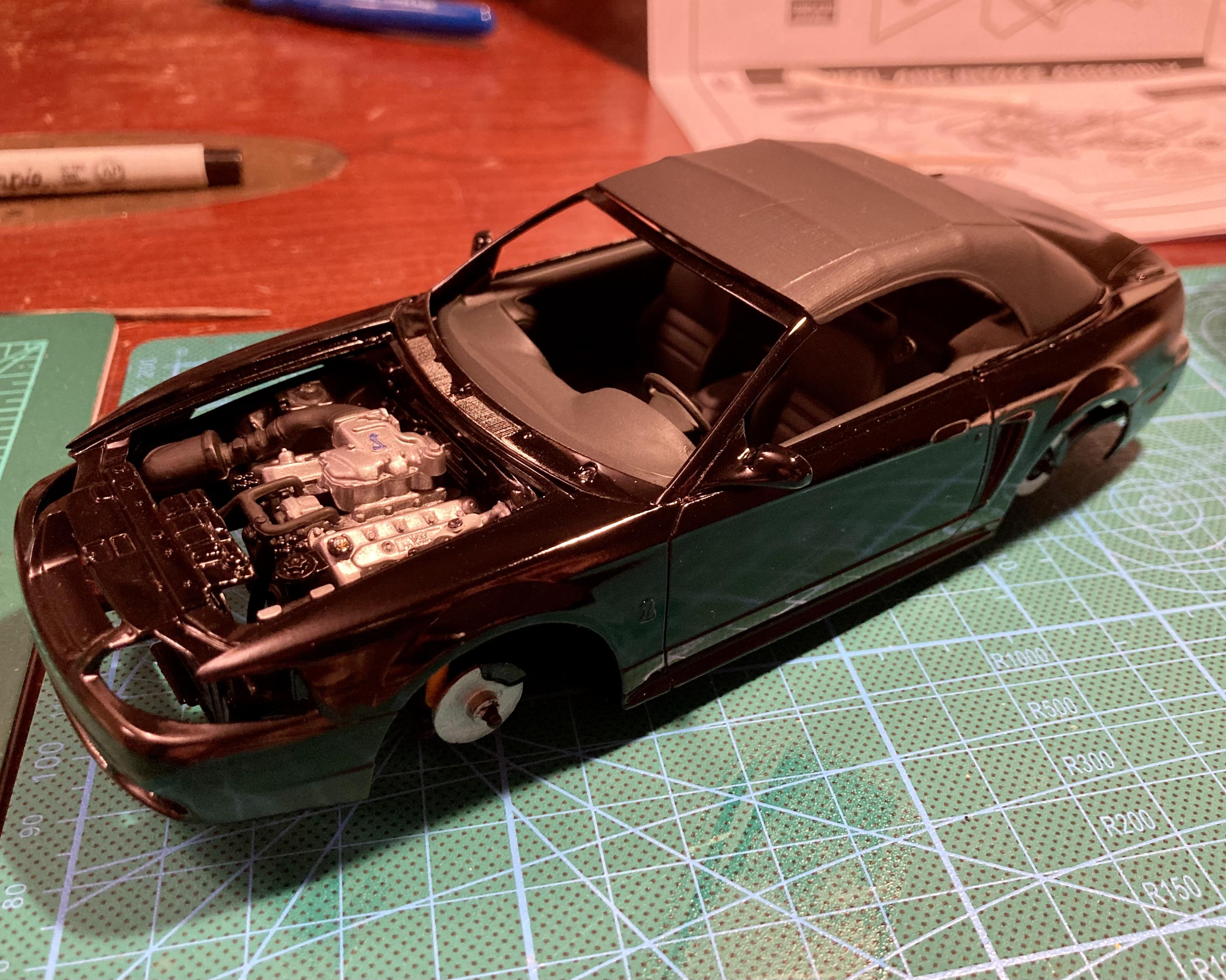

Preview with the top in place. I still need to sand the body down and reshoot another top coat. I think I can get away with not stripping it down to bare plastic. It doesn’t look too bad in pictures but I can do better. I’m excited to get this one done!IMG_1736.thumb.jpeg.7551d35f6dad6bed31fe3598a5360535.jpeg
