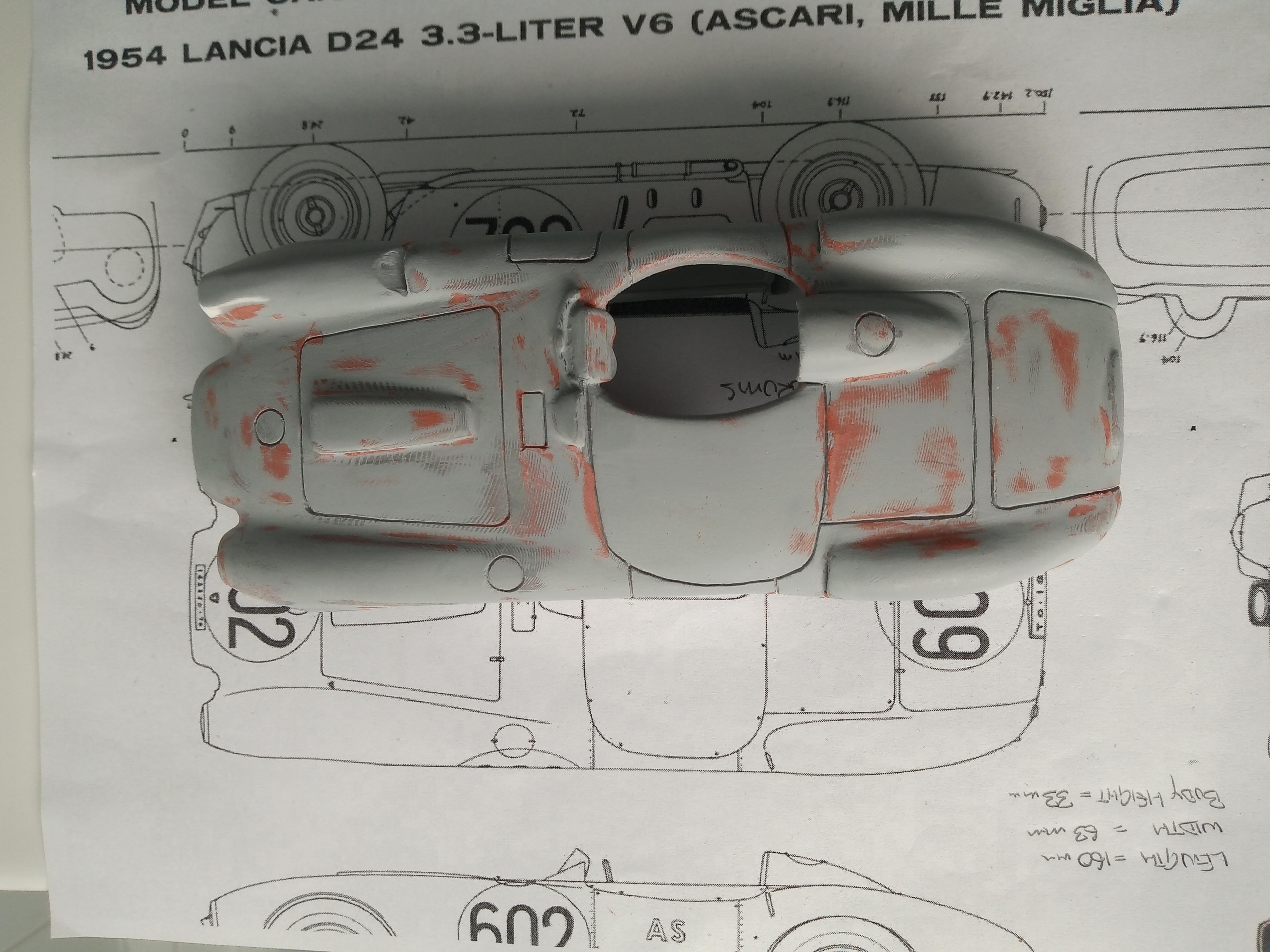

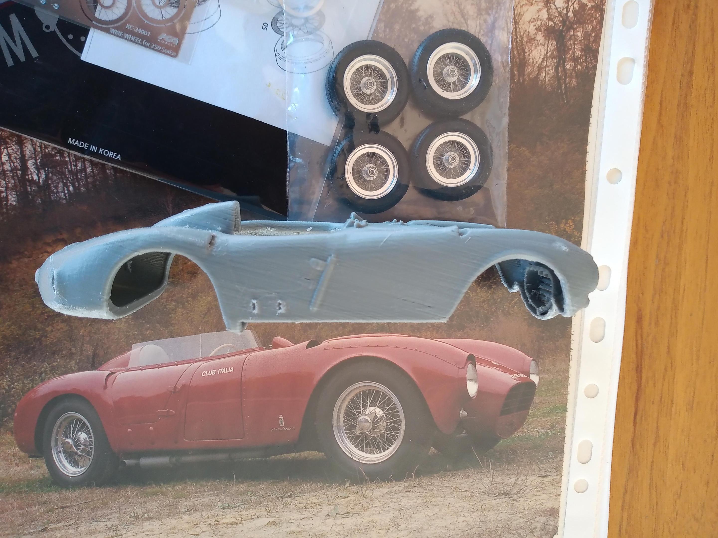

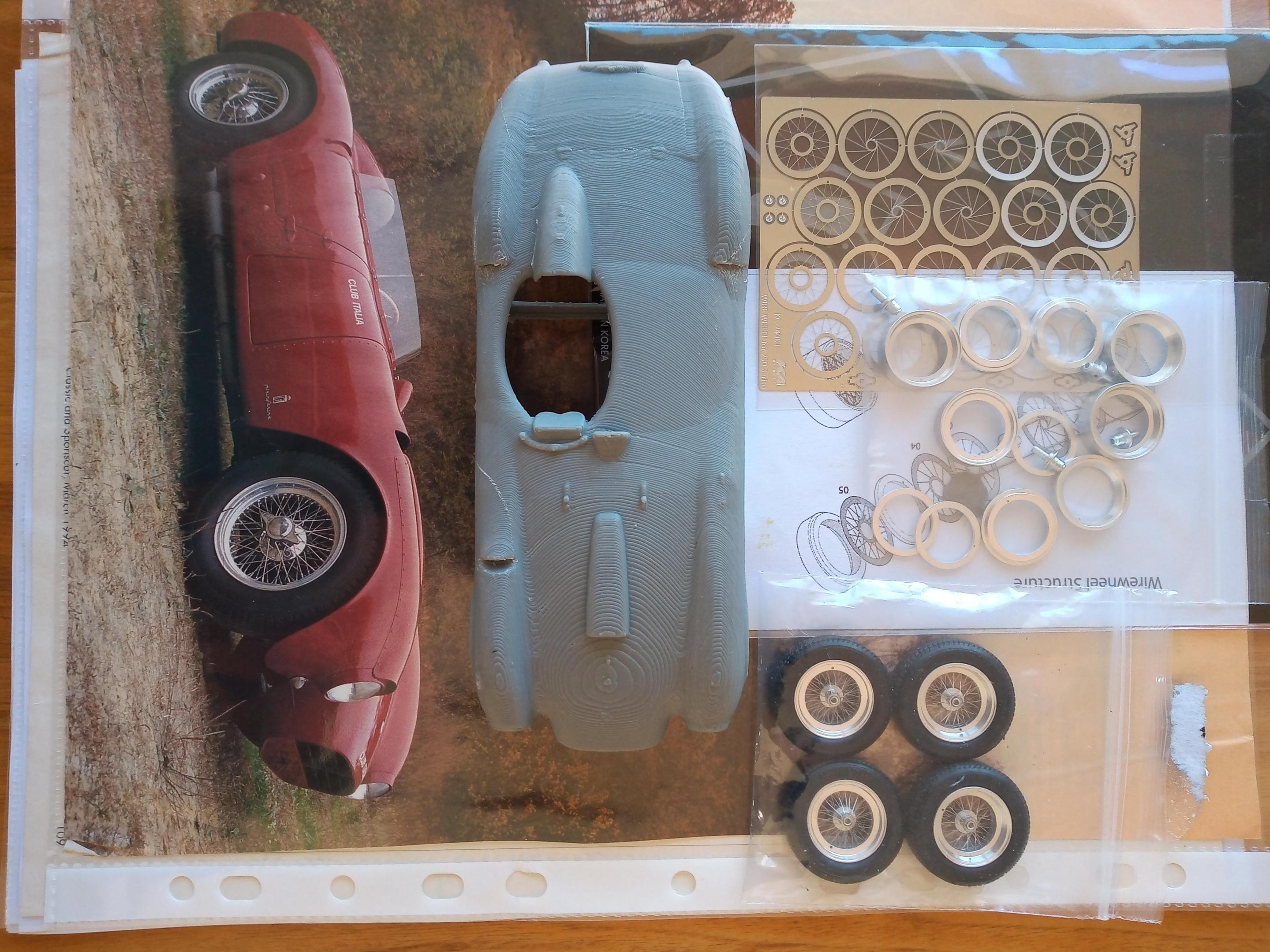

Dave B Posted July 21, 2023 Posted July 21, 2023 My mate showed me a 3D file site that was having a sale. Looking through it I found one of my favourite 50's sports cars, the Lancia D24. I did the obvious thing and asked him to buy the file for me and print me one. Here it is with the photo etched wires I have been sitting on waiting for an appropriate model, they're a tad too wide but the care factor is low!! Anyway I shall be working on this while finishing the 'not an Iso A3/C' (actually it is) which is convenient as, while painting the red on the Iso I noticed a split in the filament in the rear guard so it will need a little work. Tks for looking. Dave B 1

Bugatti Fan Posted July 21, 2023 Posted July 21, 2023 Nice interesting model project. Incidentally. Who makes the Photo Etched Wire Wheels?
Dave B Posted July 21, 2023 Author Posted July 21, 2023 (edited) 5 hours ago, Bugatti Fan said: Nice interesting model project. Incidentally. Who makes the Photo Etched Wire Wheels? Hi Noel, the wires are made in Korea by KA Models. They are beautiful, 5 layers of photo etch with machined aluminium hub and polished rim. I bought mine from BNA Model World in Aus. Dave B Edited July 21, 2023 by Dave B

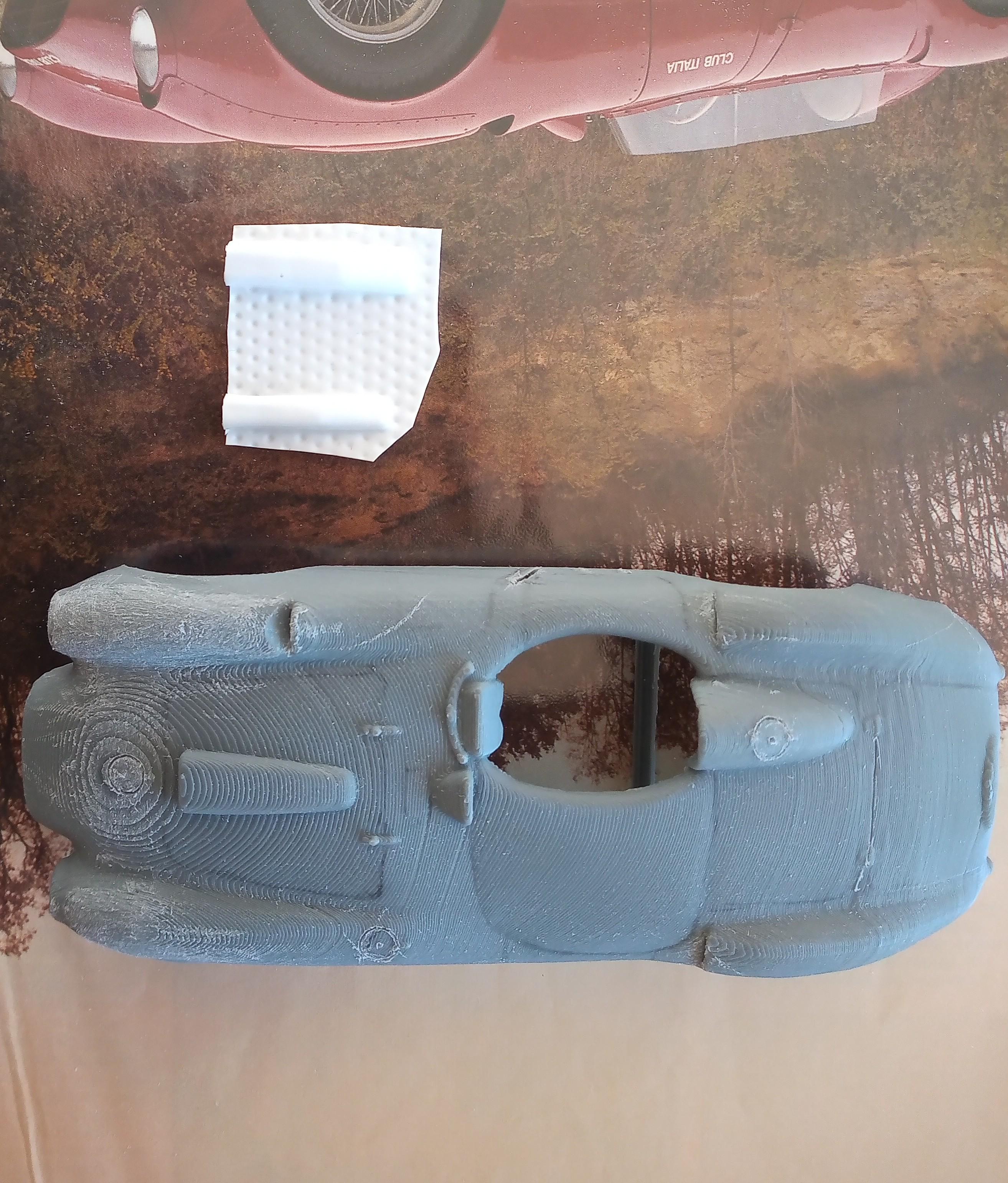

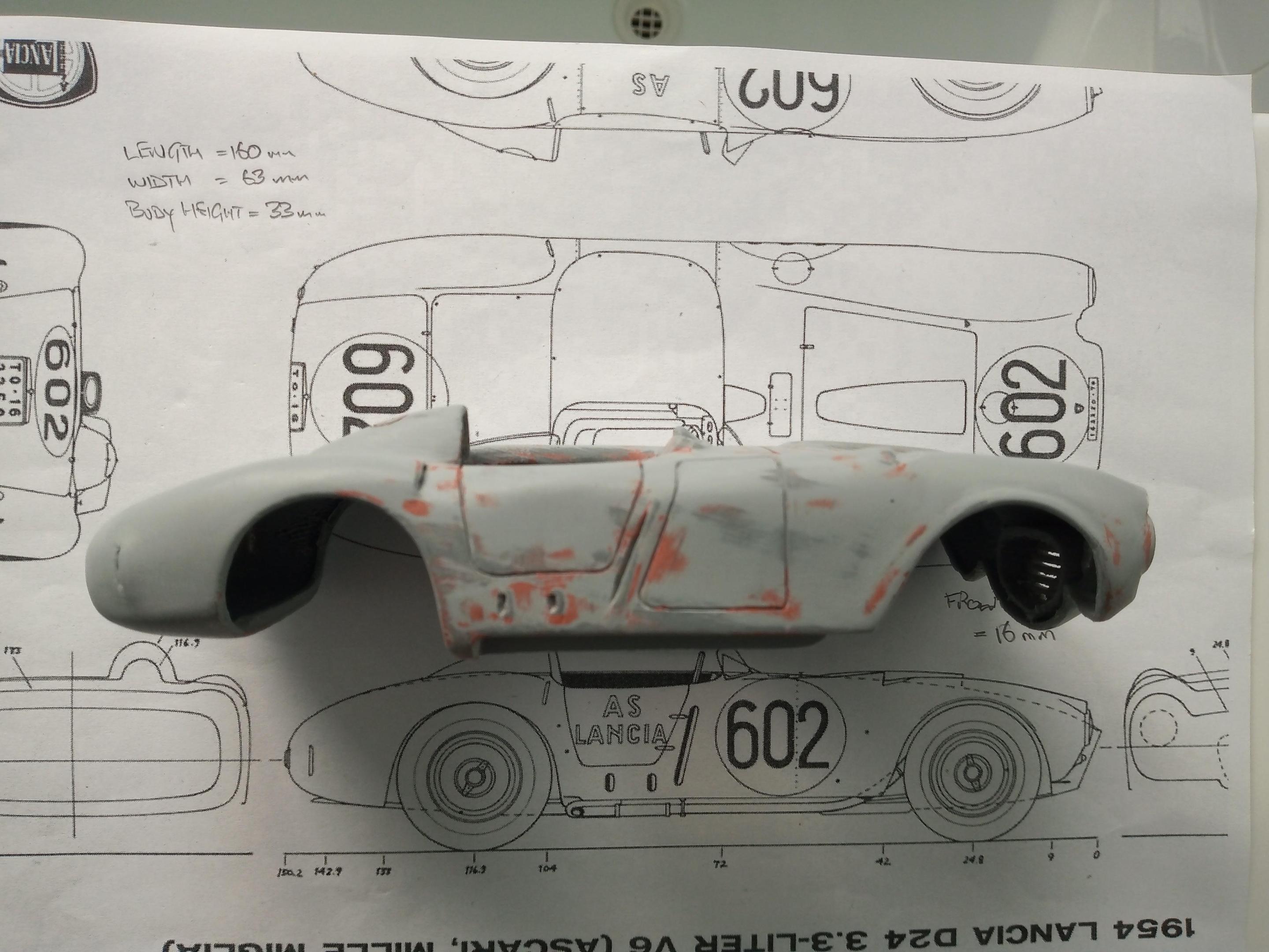

Dave B Posted July 23, 2023 Author Posted July 23, 2023 Still working on the rear guard of the Iso so I'm doing a bit more on the D24. I decided I would redo the scoop on the drivers side guard so I have sanded the existing one off and made a buck out of icecream sticks, shaped it and vacformed it. Two different sizes so tonight I'll have a play. Tks for looking Dave B

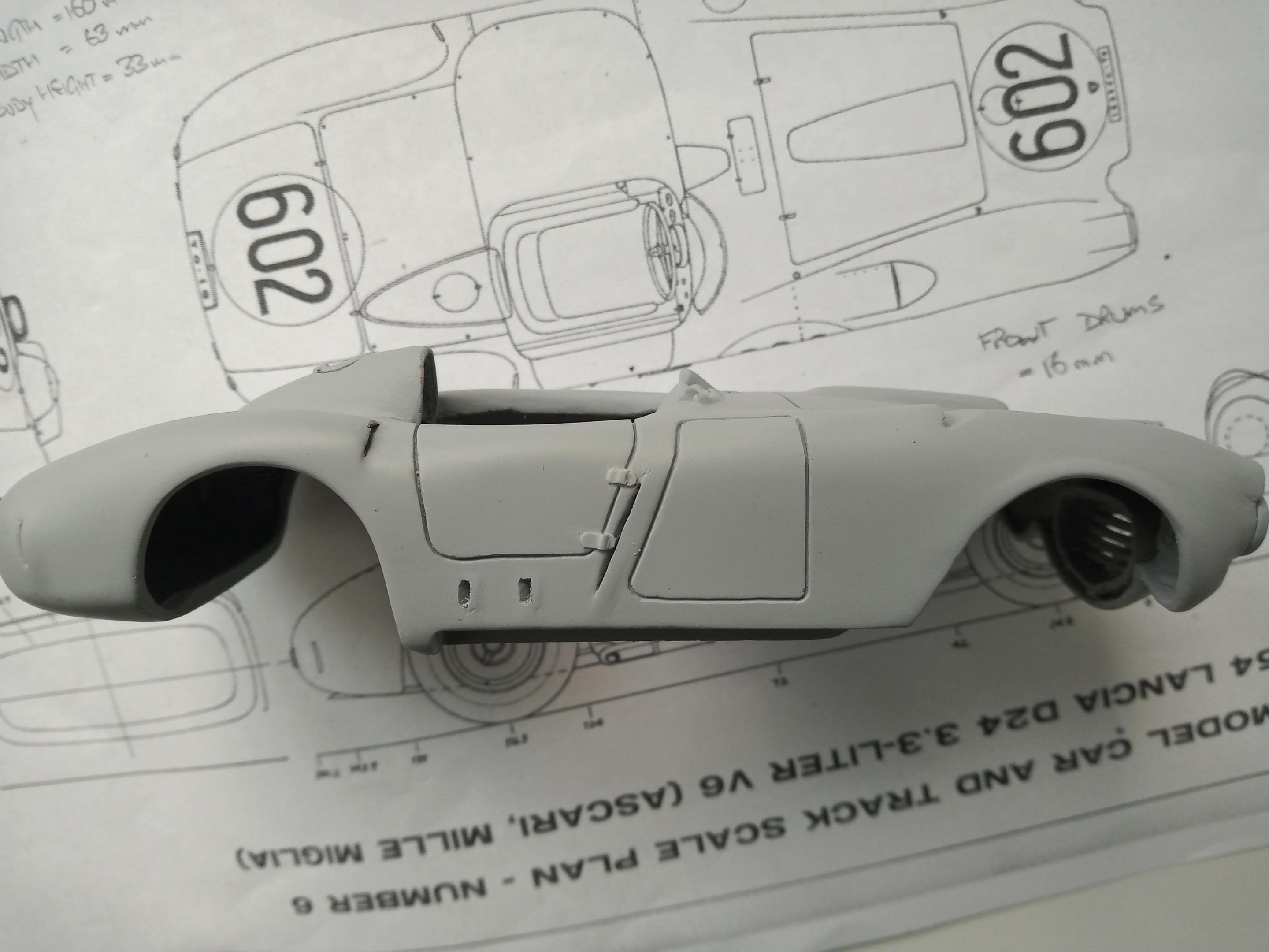

Dave B Posted August 23, 2023 Author Posted August 23, 2023 Well into it now and will have progressed a lot more in a couple of days Dave B

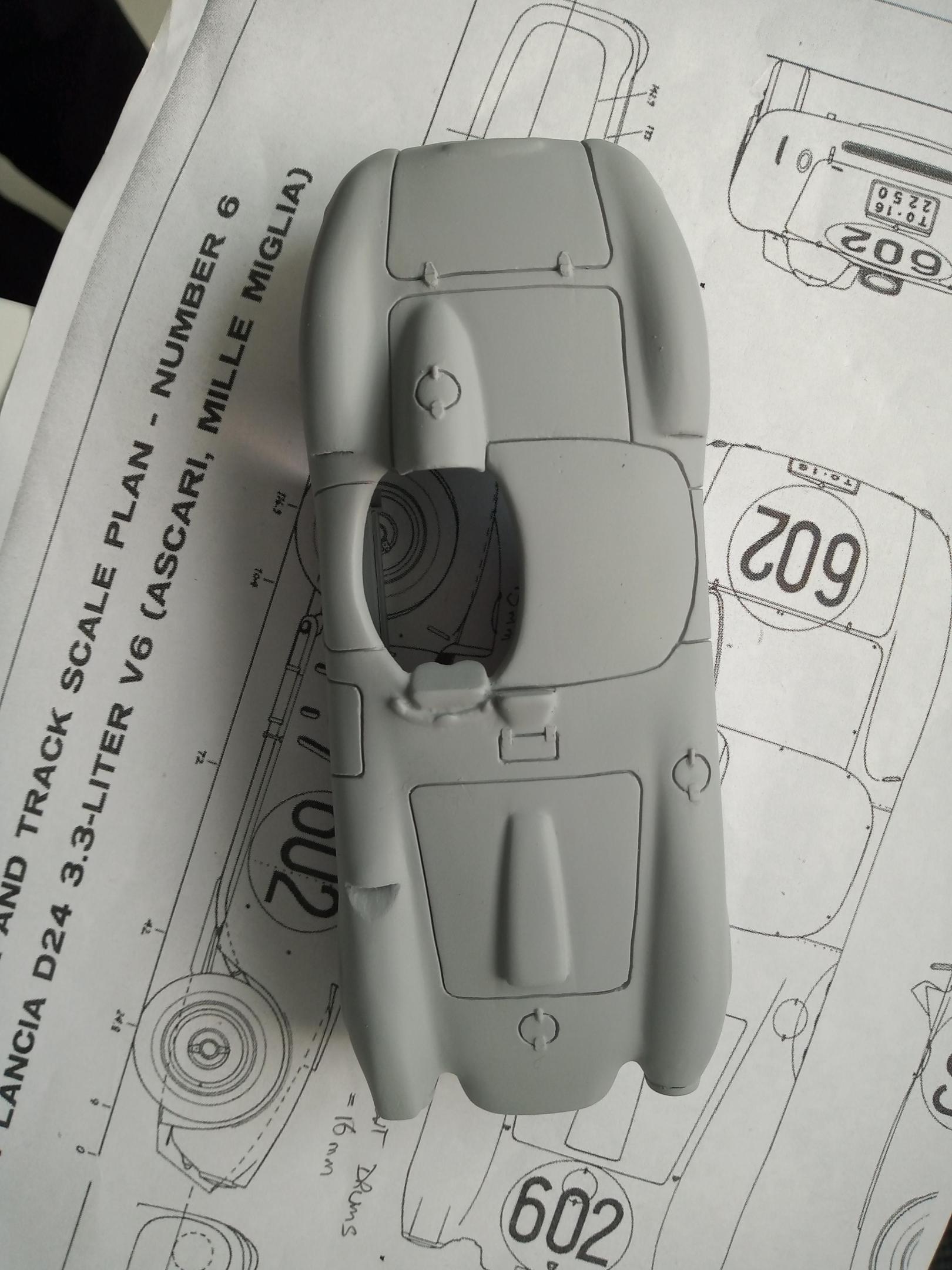

Dave B Posted August 24, 2023 Author Posted August 24, 2023 Update, bonnet fasteners still to be fitted Dave B 1

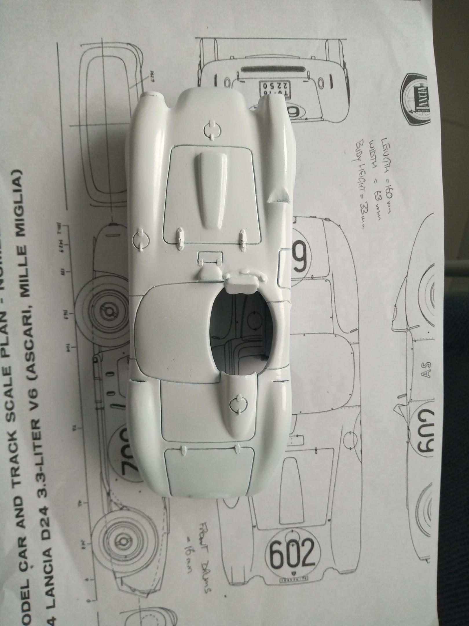

Dave B Posted August 25, 2023 Author Posted August 25, 2023 Ok, I've laid the 'fault' finding coat of white on but I'm now in a quandary. I thought Fangio's Carrera panamerica D24 was maroon but the only period colour photo I could find shows it red. I really wanted it maroon, does anyone out there have any information please. Dave B

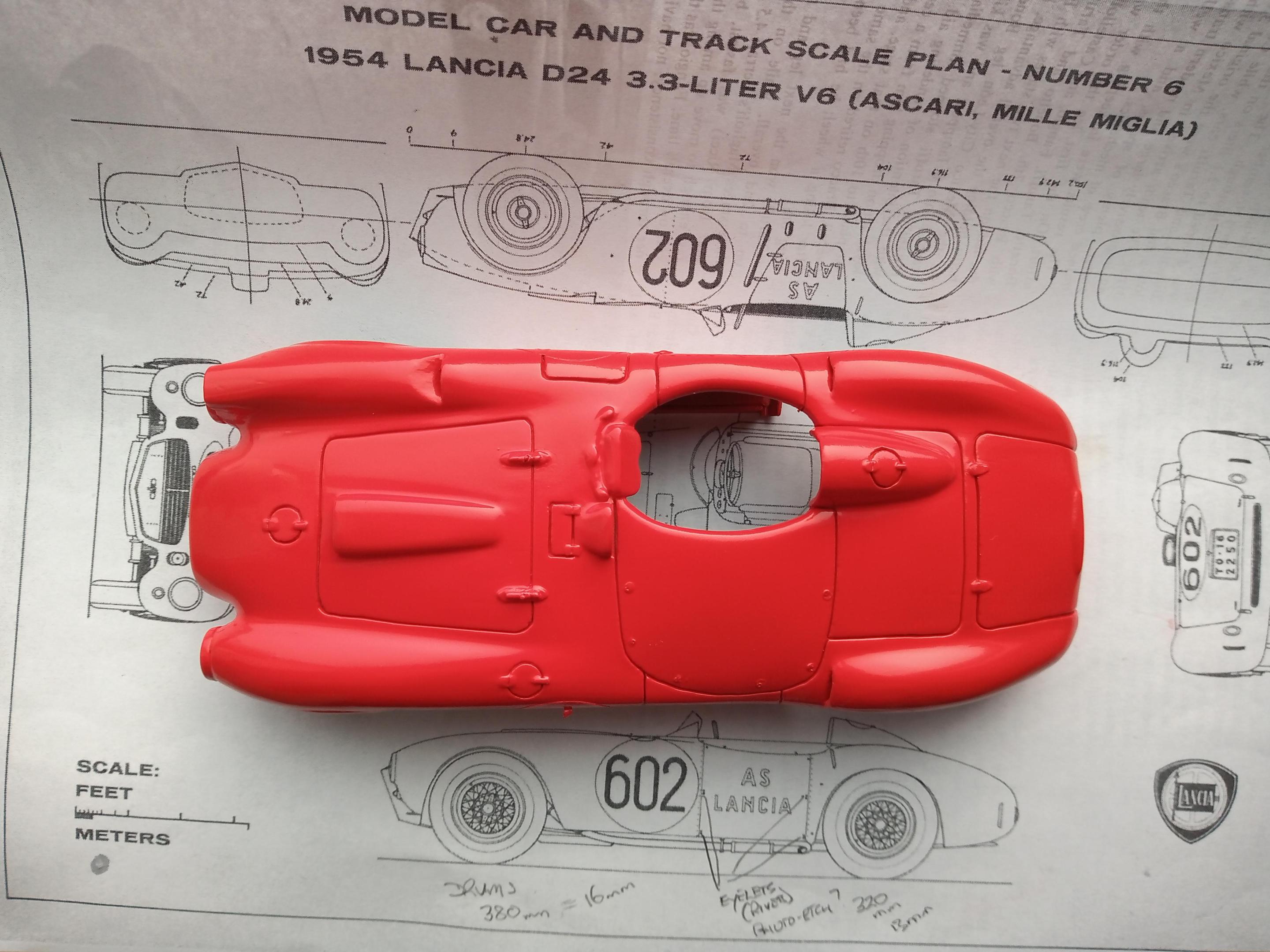

Dave B Posted August 26, 2023 Author Posted August 26, 2023 Just finished initial coat. It looks about correct. I might build a maroon one later as the new resin printer has arrived. Dave B 2
