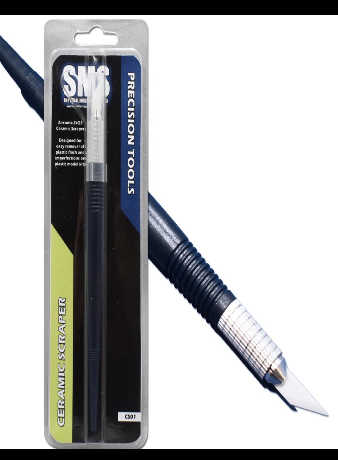

Dpate Posted July 25, 2023 Posted July 25, 2023 (edited) 18 hours ago, Milo said: How do I even clean seamlines and flash? I'm not really ever successful You can use the back side on a xacto blade at an angle to clean up flash etc. I use a ceramic blade though as it’s safer, and can’t damage the plastic by accidentally gouging it. Seamlines and moldlines is different though. The SMS tool is pricey as is the blades, but one blade will outlast 100 pack of xacto blades far as sharpness goes. Edited July 25, 2023 by Dpate
