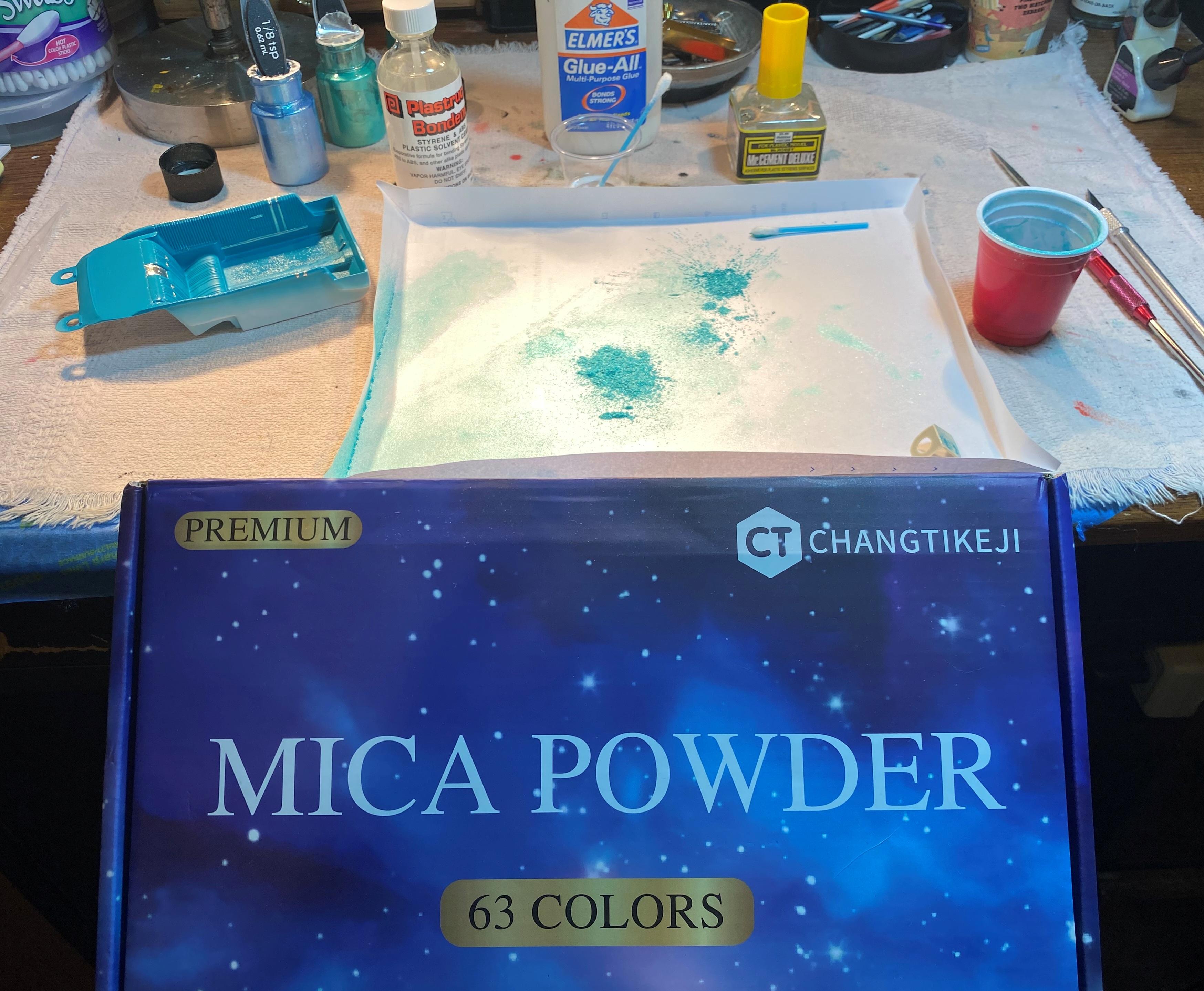

Bills72sj Posted July 29, 2023 Posted July 29, 2023 I tried an experiment this evening of using a couple of my mica powders combined together as flocking. Results were mixed. I picked a blue and a green to attempt to match the turquoise of my interior. Previous handling of the mica powders forewarned me of how potentially messy than can get. Preparation and carefulness kept everything to a minimum. I was able to get close enough to the shade I desired by adjusting the mix. I selected a scrap piece of painted plastic to minimize the background's color effecting the end result. However, after trying thinned Elmer's, Plastruct Bondene and Mr Cement I still ended up with various amounts of undesired clumping. The texture, sheen and color definitely have potential but, none of the adhesives I used are satisfactory. Then there is the issue of the masking needed to keep it off of where I do not want it. So, at this time, I am not ready to apply it to my mostly detailed interior. What adhesives have any of you has success with? P.S. This job definitely needs to be performed in the paint booth. 1
