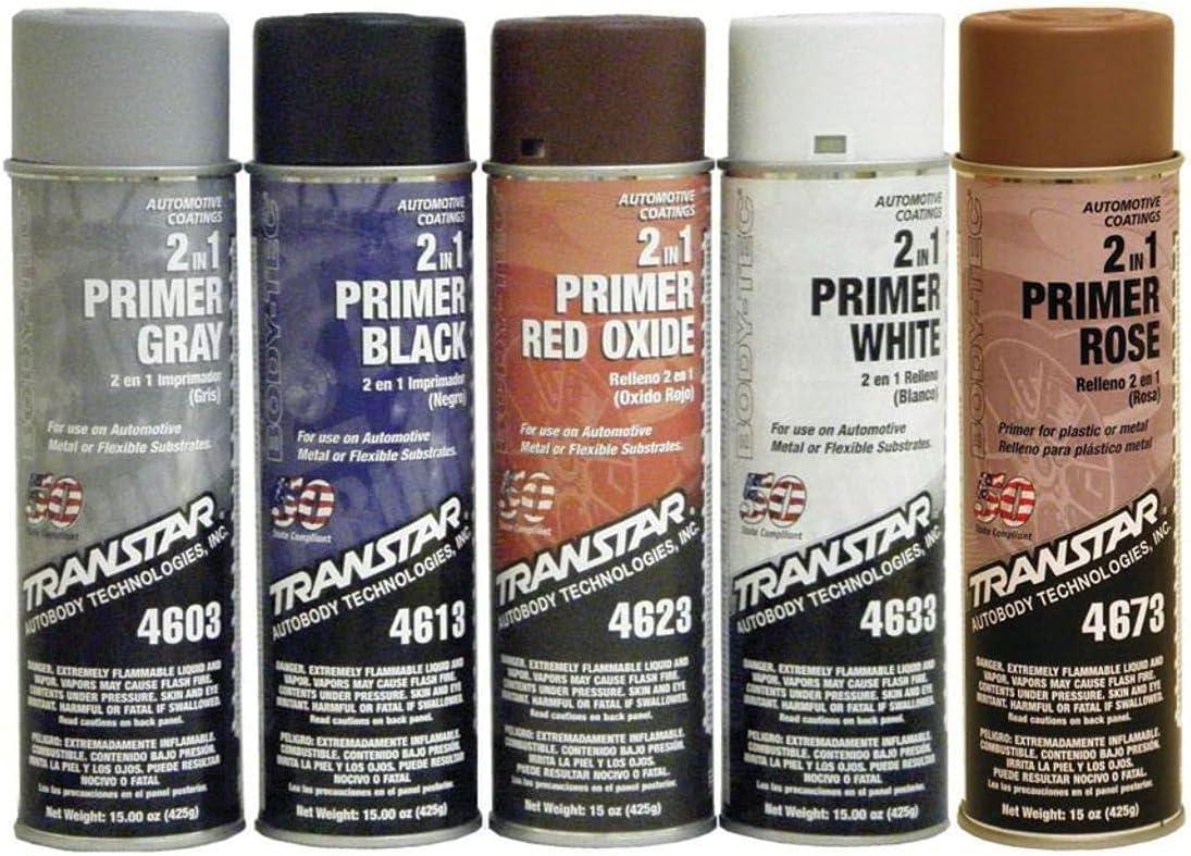

RSchnell Posted July 30, 2023 Posted July 30, 2023 I've used Dupli-Color and Tamiya primer in the past with great results, but have switched over to Transtar primers. Lays down incredible and sands like butter. a 15 ounce can will last me numerous builds and with my shop discount it works out cheaper than Dupli-color for 3 more ounces of primer. You can get it on Amazon or your local automotive paint supplier.
Dave G. Posted July 30, 2023 Posted July 30, 2023 Without a shop discount and for Joe Average consumer, Duplicolor is still the better bang for the buck, at least at Amazon.. That said, as mentioned, I airbrush the Mr products or Stynylrez personally. To me there is a lot of waste in spray cans. With airbrushing, smaller quantities go further. 1
