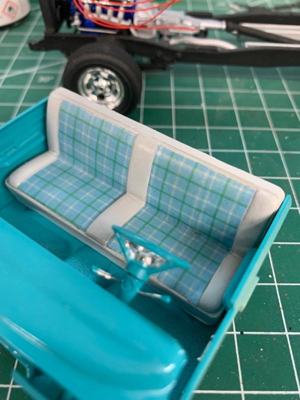

Glassparman Posted July 29, 2023 Posted July 29, 2023 (edited) I'm working on a Moebius Ford pickup and decided to try some Washi tape from Hobby Lobby. I wanted the seat to match some I have seen in real life and this one fits the bill. The truck is two tone white and blue. Cut to fit and apply over a clean seat. Cover with Mod Podge to keep it down. Going to try something more complex soon. Edited July 29, 2023 by Glassparman Spelling 4
ColonelKrypton Posted July 29, 2023 Posted July 29, 2023 That is an interesting idea and I will have to give it a try. Lately I have been fussing over different methods to finish off interiors - i.e. flocking, embossing powder, (etc). Never thought of using something like Washi tape. cheers, Graham 1
Bill Eh? Posted July 29, 2023 Posted July 29, 2023 Washi is a type of Japanese paper. It is the same paper that is used to make Tamiya masking tape. Basically it is very thin paper with an adhesive backing. Your results look great. I have lots of rolls, but never thought to use it as an upholstery substitute. Thanks for this great idea. 2
StevenGuthmiller Posted July 29, 2023 Posted July 29, 2023 Pretty good idea! I did a quick google search for "Washi Tape", and one of the first sites that popped up was one that does custom printed tape. Food for thought. Steve 1
OldNYJim Posted July 30, 2023 Posted July 30, 2023 I’ve played with this technique too 2 you’re right, there’s some cool patterned Washi tapes out there. Some things I learned from my experiments - first, Washi tape is somewhat translucent, and is affected by the base color underneath. If you stick bright red Washi tape over black you’ll get burgundy, most likely. Second up, due to it’s thickness, it doesn’t lay down very well into something like, for example, a tuck ‘n’ roll pattern. Works ok for flat stuff tho, like the example above. I didn’t like the somewhat glossy finish of the stuff I tried - it looked like, well, tape…but light mists of a satin clear worked ok on it, in my experience 1

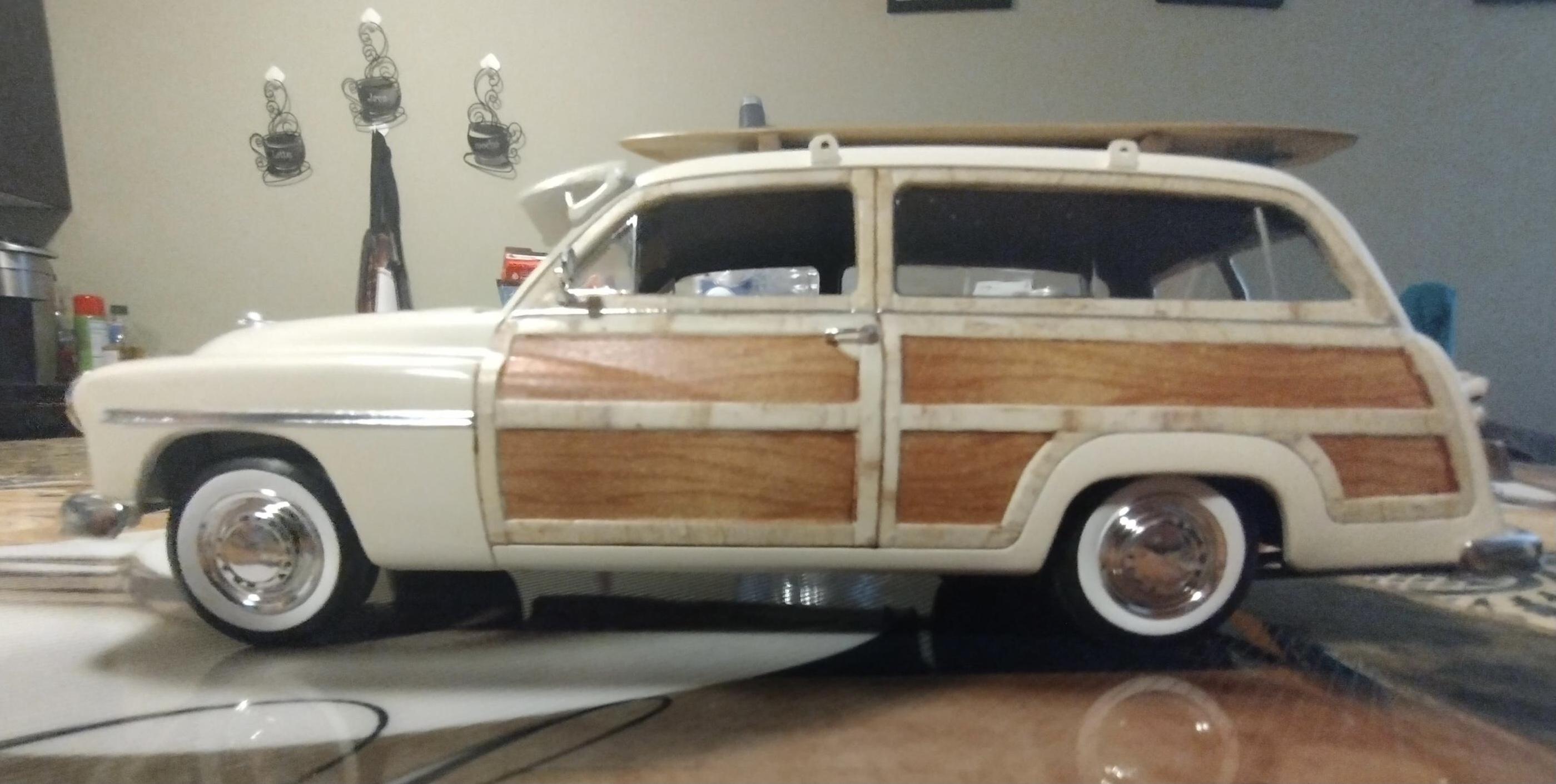

Chuckyg1 Posted July 30, 2023 Posted July 30, 2023 Someone fairly recently posted a Merc woody and used the tape for the wood panels. Looked very good. 1
Bugatti Fan Posted July 31, 2023 Posted July 31, 2023 (edited) Here in the UK Washi masking tape could be bought in Wilkos. It was a red colour when sold named Washi masking tape in the store. Wilko has now renamed it I think Paper masking tape and is now a very light beige colour. Same stuff. Different colour. A lot less expensive than Tamiya tape if you are prepared to cut it into strips. I use a flat piece of glass from a security lamp to stick the tape down to and use a scalpel and steel engineers rule to cut into the strip widths I want. Edited July 31, 2023 by Bugatti Fan 2
Deathgoblin Posted August 1, 2023 Posted August 1, 2023 On 7/30/2023 at 1:14 PM, Chuckyg1 said: Someone fairly recently posted a Merc woody and used the tape for the wood panels. Looked very good. That was me! The wood panels came out well. I worked it down like foil and it came out great. I'm interested in picking up some different patterns for interiors.
