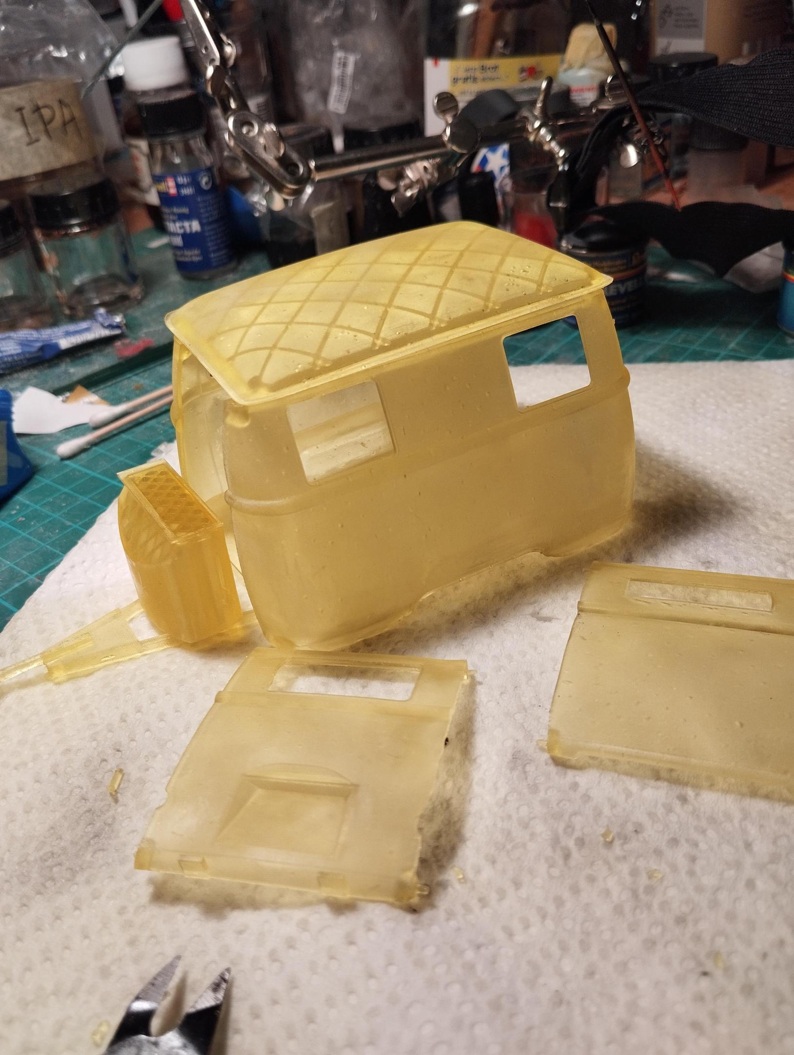

My trailer showed earlier was two round in comparison with Revell T2 bus and the sides were too soft to print properly. I did deliberately this way with the intention to add interior details later. Sadly, the first test print showed it was very difficult to put together. A multi piece design suffered from incontinent part deformations and printing tolerances. There was a greater possibility for flaws. To put it short: it looked nice on the screen but terrible in reality.
As a remedy, the body shell was strengthen by a mesh of stiffeners. The roof attachment pins were replaced by a large center tab. The floor panel was also strengthened. This meant interior had to be abandoned in favour of the sturdier body shell and ease of printing.
I will try to print the trailer today. Wish me luck....

Downloaded, but haven't printed Version 1 yet. Will wait for the update!
I wouldn't print the older design. See yourself
