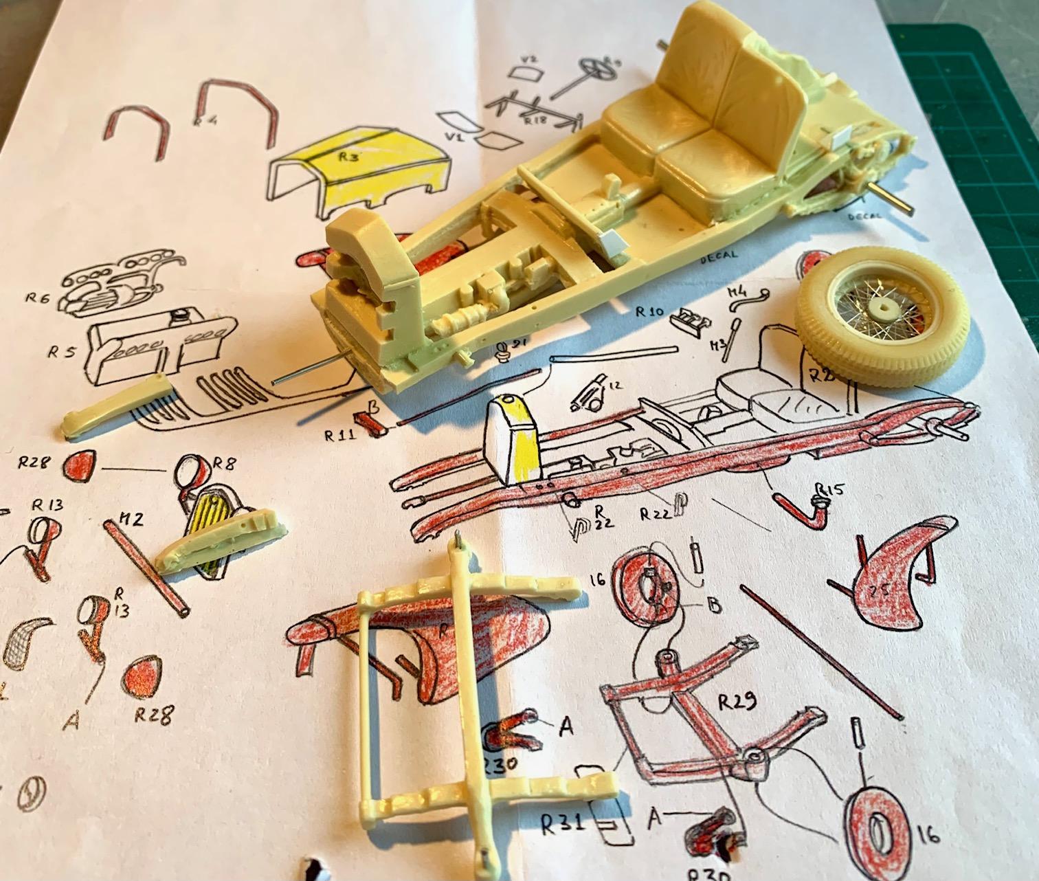

Pierre Rivard Posted September 9, 2023 Author Posted September 9, 2023 Thanks fellows. Just finished today's session and I now have body/hood/chassis relationship reasonably defined. It does not seem like much but just these 3 parts needed quite a lot of work...and more is needed but I'm getting used to this new stuff. I don't know how this resin kit rates compared to others but it appears quite a lot of work will be needed to make all the parts fit and look correct. Reassuring that Fernando thinks I only need this one page instruction sheet to figure this out. ?

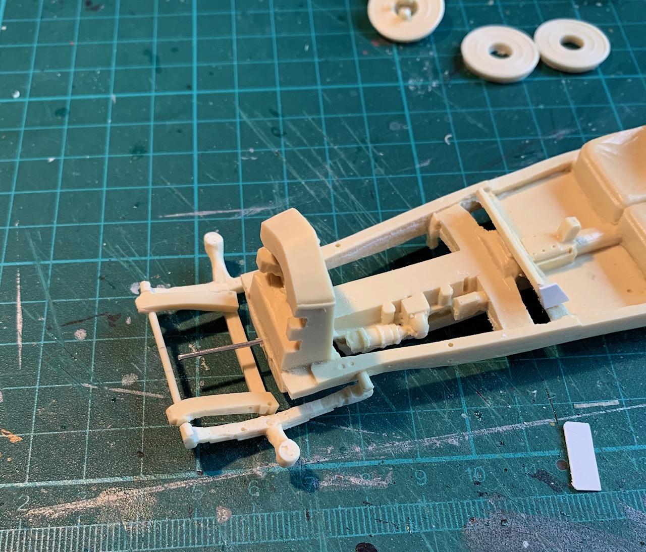

Pierre Rivard Posted September 10, 2023 Author Posted September 10, 2023 Going through my sequence process I'm thinking I need to get the chassis mock up done so that I can then figure out how to position the fenders (no defined method or attachment points) Instructions show the chassis pan includes complete frame rails molded in but the front pieces actually have to be added. Thought I would need to fabricate these extensions but found them in a bag of small parts. Makes things easier. Got these cleaned up and epoxy glued the front chassis components. Finally got to a decent dry fitted body and get a mockup done with the wheels on. I now have my foundation to figure out how and where to get fenders installed 2

Pierre Rivard Posted September 11, 2023 Author Posted September 11, 2023 23 minutes ago, MarkJ said: Wow, Pierre. It's coming together perfectly. So, I guess you're using epoxy to hold this creation together. Do you mix it in small batches or how exactly does it work. What do you mix it in? Yes, 5 minutes 2 part epoxy from Bob Smith Industries. I'm fortunate to have an amazing hobby shop in my area and they always provide good advice. The resin and hardener both come in 4.5 oz dispenser bottles and I can easily mix mini matches (as small as one drop from each)

Pierre Rivard Posted September 14, 2023 Author Posted September 14, 2023 Thanks Mark. I like the kit very much but it requires some thinking and referring to period pictures / artist drawings to see what it needs to look like since there are no real instructions. Big challenge ahead is the resin surface preps and finishing.
