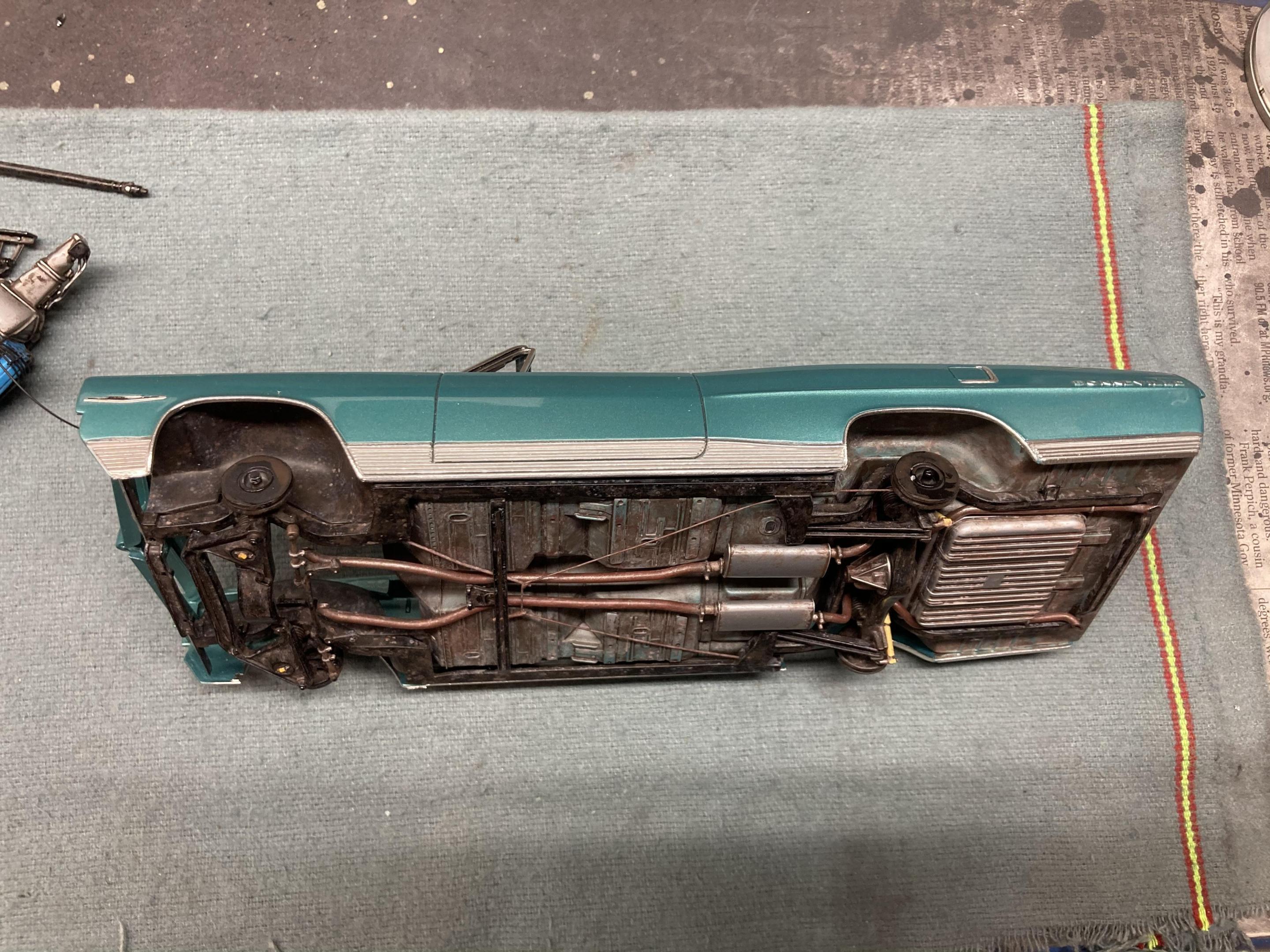

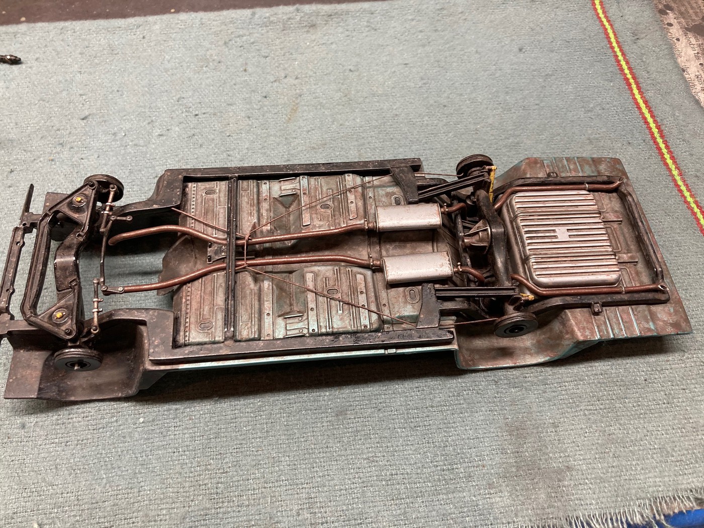

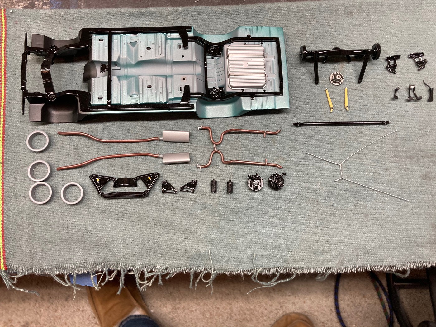

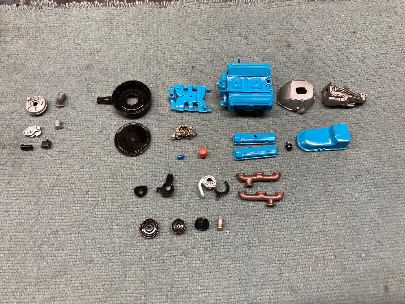

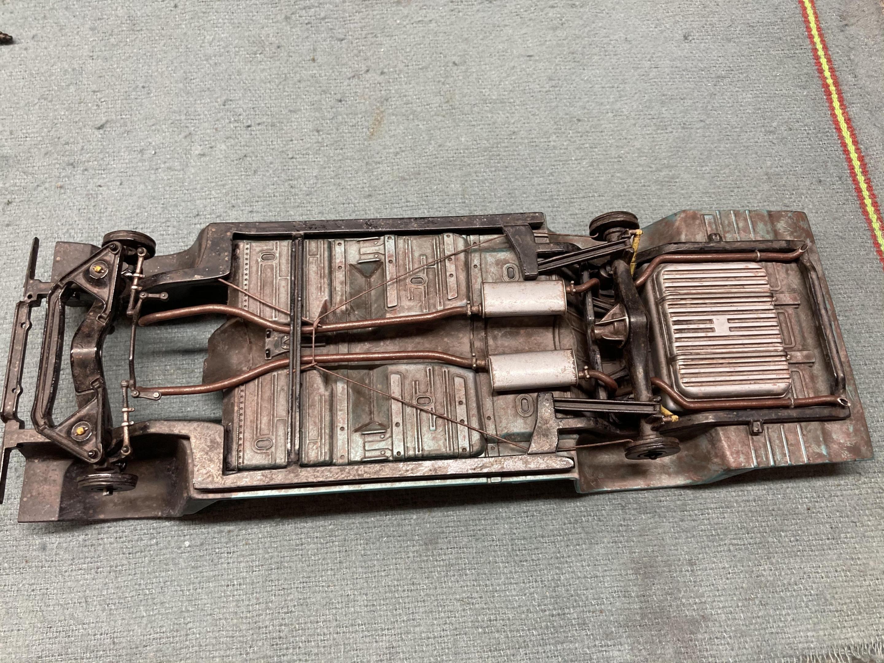

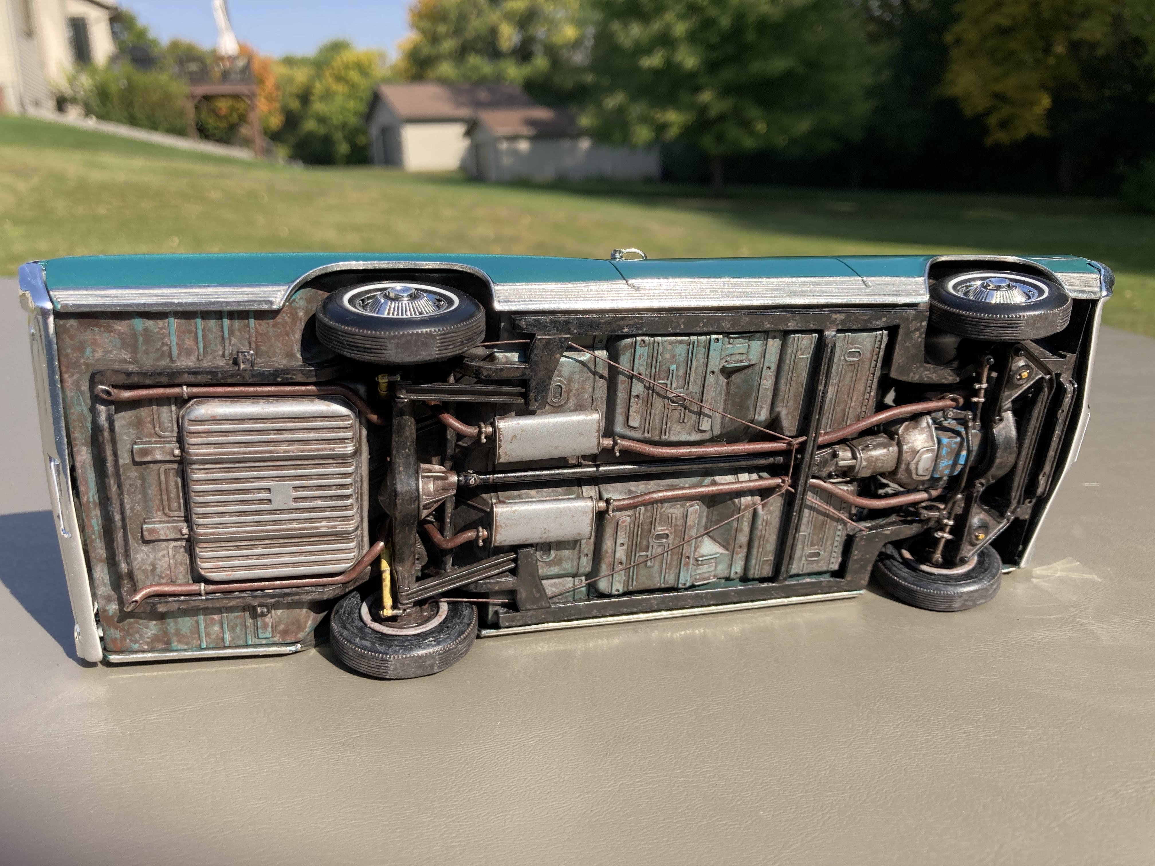

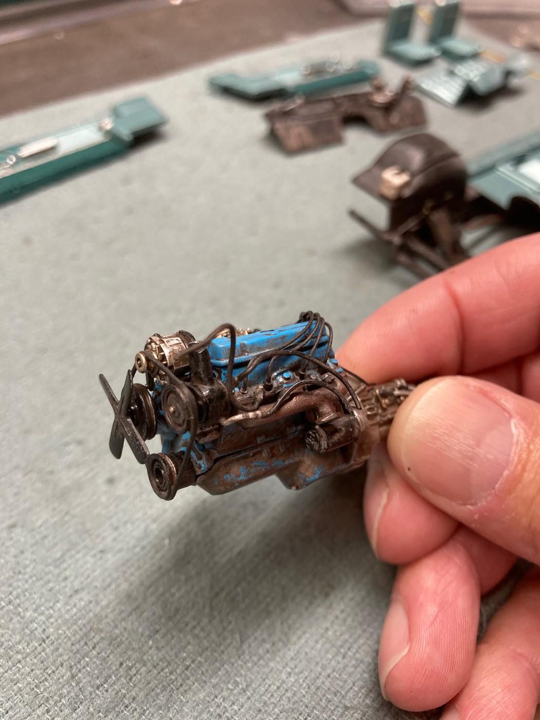

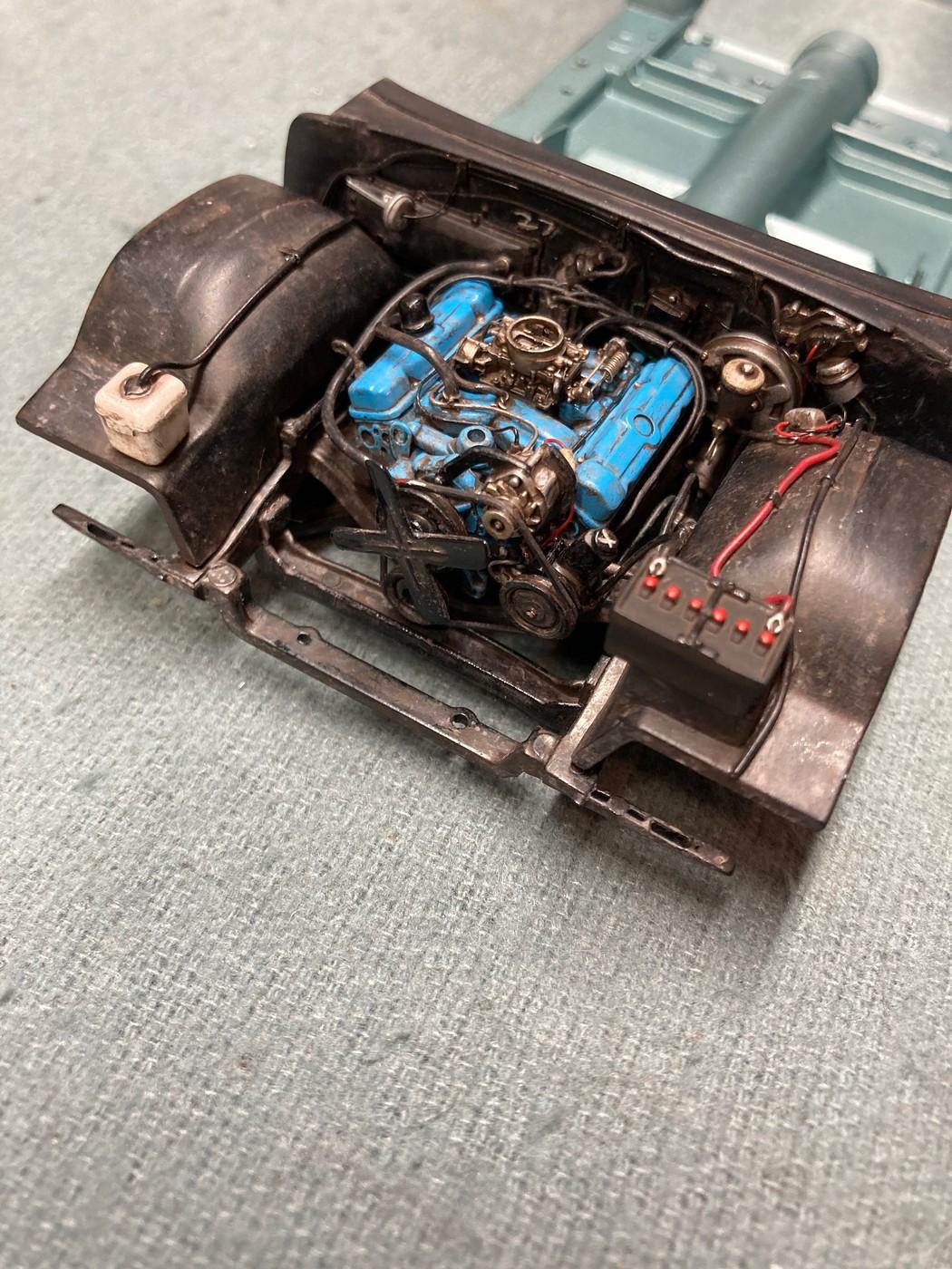

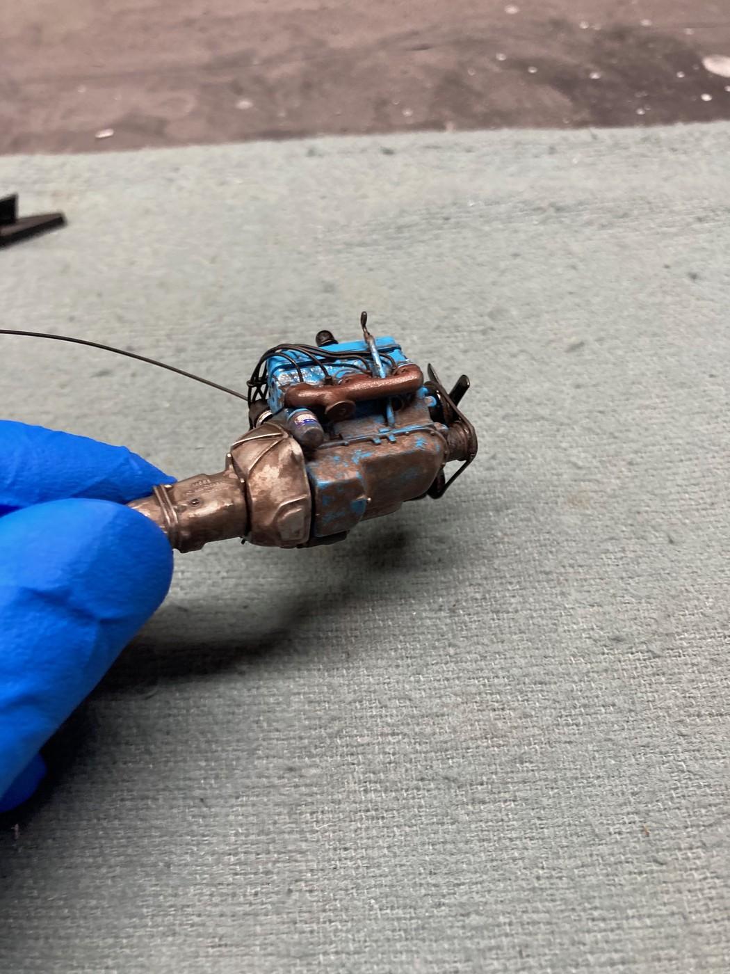

StevenGuthmiller Posted August 2, 2023 Posted August 2, 2023 (edited) Hello folks. I posted this basic weathering tutorial in a thread by Jeremy Linn who was looking for some tips on some basic weathering for chassis, engines and engine bays. This technique was designed to help depict a vehicle that has seen some time on the road, and of course can be modified to portray something less, or more used. My intention was to begin getting away from the standard "like new" builds that you normally see, and begin to represent my models as something that that the average car enthusiast would likely have in his garage if the car was actually driven on a regular basis.. Or more specifically, a representation of a well maintained vehicle of a several years of age, and 20,000-30,000 miles on the odometer under normal daily driving conditions. Nothing more is required than a few colors of acrylic craft paint, a medium sized paint brush, Q-tips, and paper towels. The colors chosen are a series of 3 colors, mixed from the 4 colors of paint pictured, and thinned to a wash consistency. (all flat colors) A dark "oily" brown mixed from brown and black, a rusty color mixed from brown and red, and a dirty tan mixed from light tan and a little brown to simulate a little road grime. First, the oily brown was washed onto the parts, allowed to dry slightly, and then, using a lightly dampened Q-tip, the parts were wiped mostly clean to the point of leaving the color mostly only in the recessed areas. Once dry, (it only takes a few minutes to dry satisfactorily) the next color, the rusty red, was dry brushed very lightly over select areas of the parts. By select areas I mean only the areas where you might see light surface rust, such as the chassis plate, lower portions of the engine, and lower portions of the firewall, radiator bulkhead, etc, as you wouldn't expect to see a lot of rust on the upper half of the engine or engine bay. The dry brushing is achieved by dipping the brush in the thinned paint, and then wiping and dabbing the brush on a paper towel until almost no color is being noticeably transferred to the paper towel. Then using the same dabbing motion, dab around various areas of the part to be weathered. Let the paint dry for a few seconds and then with another lightly damp Q-tip, roll and dab the Q-tip over the surface to distribute the paint in a random fashion to blend and eliminate any noticeable brush marks. The colors should be barely visible throughout the dry brushing process, but the building of the different colors will give a nice grungy weathered effect as you continue along. Then using the tan, and the same dry brushing technique, again go over the areas where you would expect to see road grime, dust and dirt, and again, use the Q-tips to blend. Finally the same techniques were used returning to the oily brown to give the effect of a little more surface oil and dirt. Yes, this technique will take some time to get all of the surfaces covered, but in the end, I think it's a nice affect, and a relatively easy one that doesn't require purchasing a bunch of specialized paints, chalks, etc. And in the end, you're applying oil, dirt and rust, so it's nearly impossible to make a mistake. Grunge has no pattern per-say. Concentrate the heaviest weathering on areas where you would expect to see it, (say the lower half of the engine) and lighter where the surfaces are more protected, (like the upper portions of the engine). Steve Edited August 2, 2023 by StevenGuthmiller 6
atomicholiday Posted August 2, 2023 Posted August 2, 2023 (edited) As we know, different cars came with different color undercarriages, whether it's body color, primer, or rust inhibitors. Would you use the same four colors mentioned above for weathering? Seems logical since the color of dirt and grime is independent of the car. And I'm just talking about average everyday weathering. Not even getting into different environments. That would open a whole new can of worms. Edited August 2, 2023 by atomicholiday
StevenGuthmiller Posted August 2, 2023 Author Posted August 2, 2023 1 minute ago, atomicholiday said: As we know, different cars came with different color undercarriages, whether it's body color, primer, or rust inhibitors. Would you use the same four colors mentioned above for weathering? Seems logical since the color of dirt and grime is independent of the car. And I'm just talking about average everyday weathering. Not even getting into different environments. I would use the same colors. The chassis pictured above was first painted with varying finishes, including gray primer, body color, flat black, gloss black and some metal finishes. As you said, the rust oil and dirt doesn't care what color the surface is. Steve 6
atomicholiday Posted August 2, 2023 Posted August 2, 2023 That last set of pics really tells a story. Particularly the first two pictures of the undercarriage. You'd never know it was the same parts. Two things I find really interesting about this technique: a) with all the colors of craft paint available, and an infinite amount of mixing ratios, you're really only limited by your imagination. You could build hundreds of kits and each one could be unique. b) you've got maybe $6-$8 total in paint. It's just about the cheapest trick you can do in this hobby, and the effect is very dramatic. A lot of bang for the buck. Thanks again Steve. I'm sure a lot of folks are going to benefit from this. I have plans myself. Going to try it out on my current Camaro build.

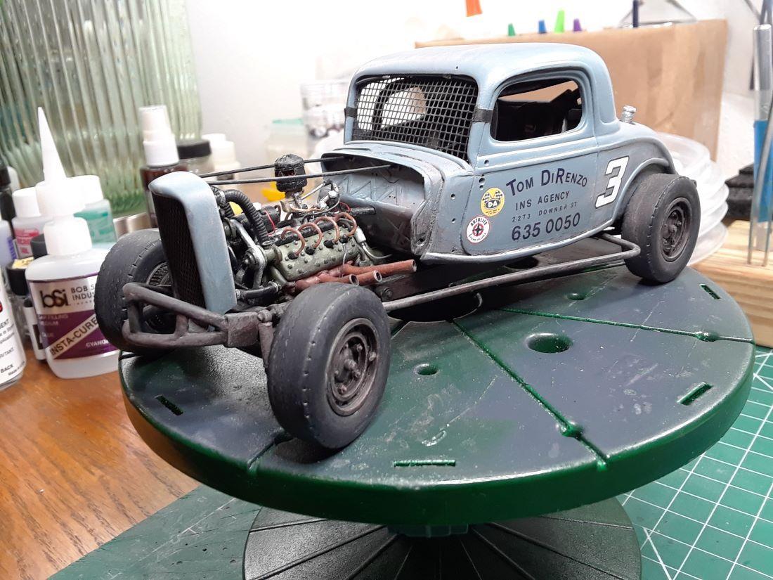

Rattlecan Dan Posted October 12, 2023 Posted October 12, 2023 Steve, I completed my 34 Ford flathead using your technique, got some nice compliments. Thanks for the tip and tutorial. 4
atomicholiday Posted October 14, 2023 Posted October 14, 2023 On 10/12/2023 at 11:48 AM, Rattlecan Dan said: Steve, I completed my 34 Ford flathead using your technique, got some nice compliments. Thanks for the tip and tutorial. That looks amazing. Great detail. Even the tires look worn out. Great job.? 1

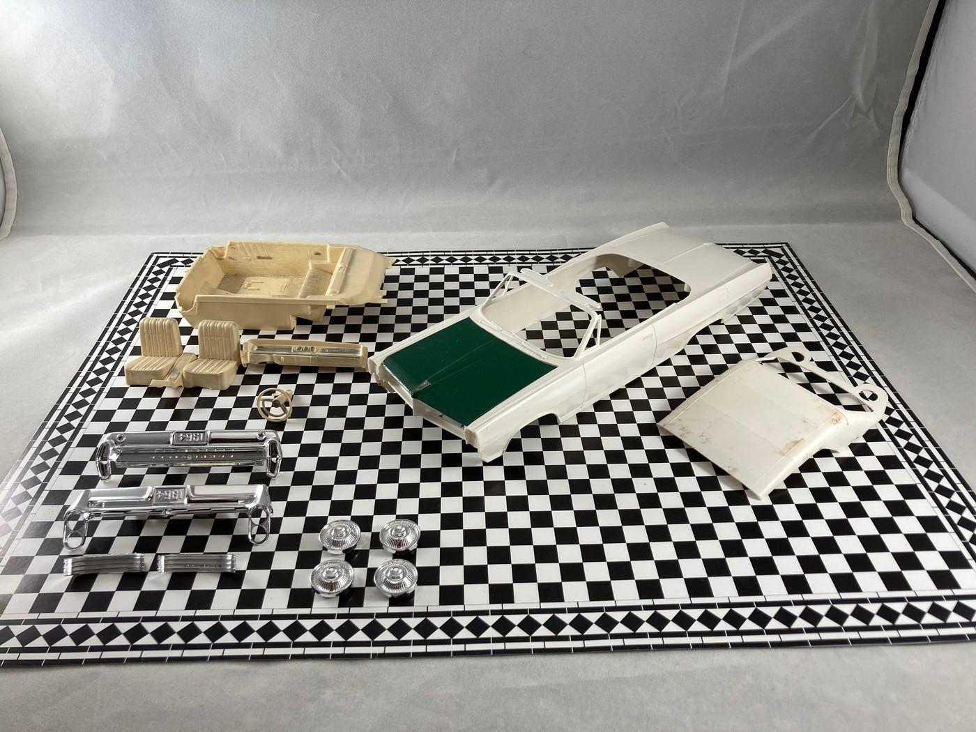

marast78 Posted November 6, 2024 Posted November 6, 2024 (edited) Great tutorial, thanks for sharing! I have a question regarding the model itself though, as it looks quite detailed. Can you share the model brand and what scale it is? OTOH, image of the second model from bluestringer seems like a disassembled pre-made model, but I can be wrong of course. P.S. And sorry for necro-posting. Edited November 7, 2024 by marast78 I didn't realize the thread is so old

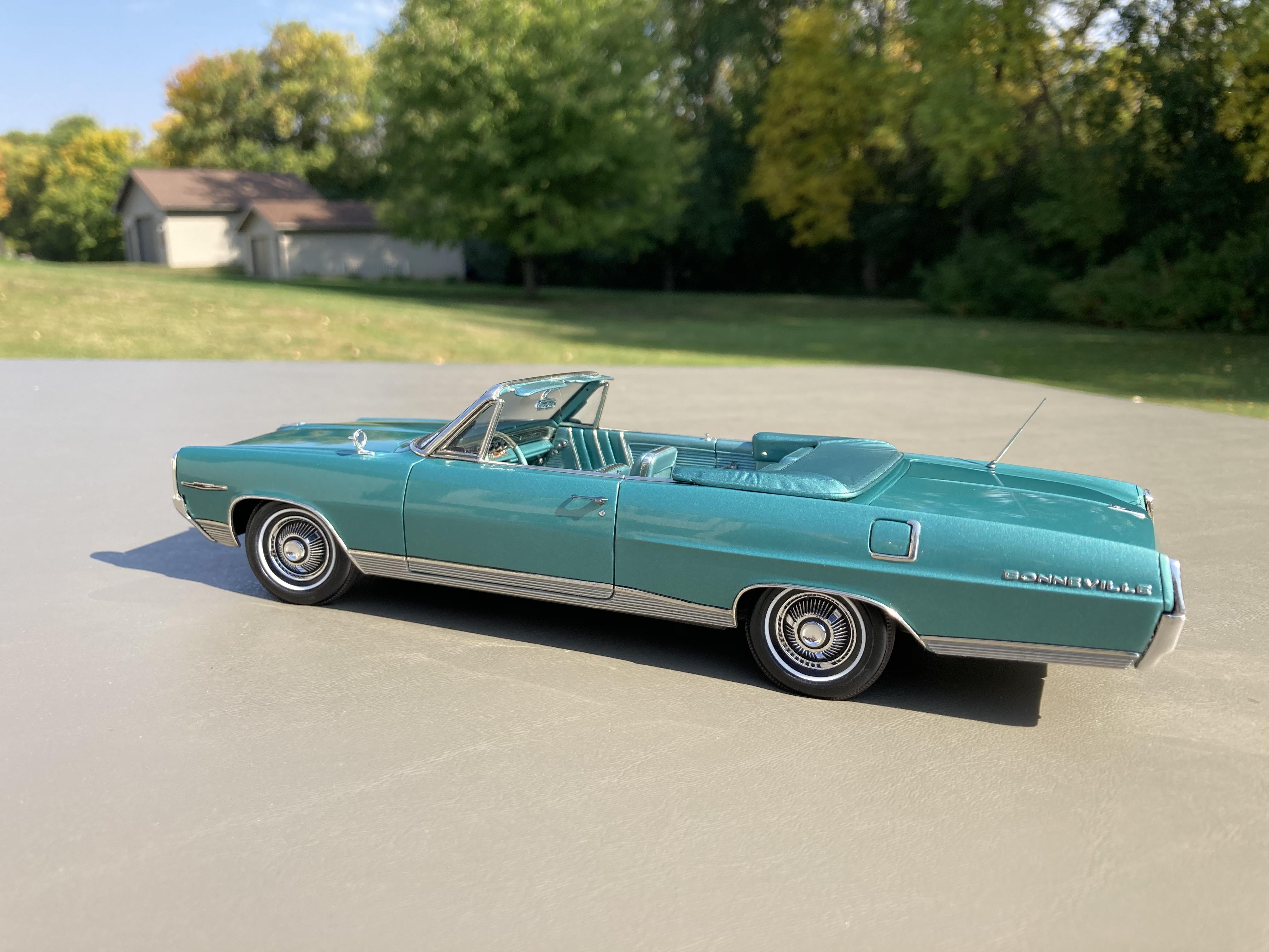

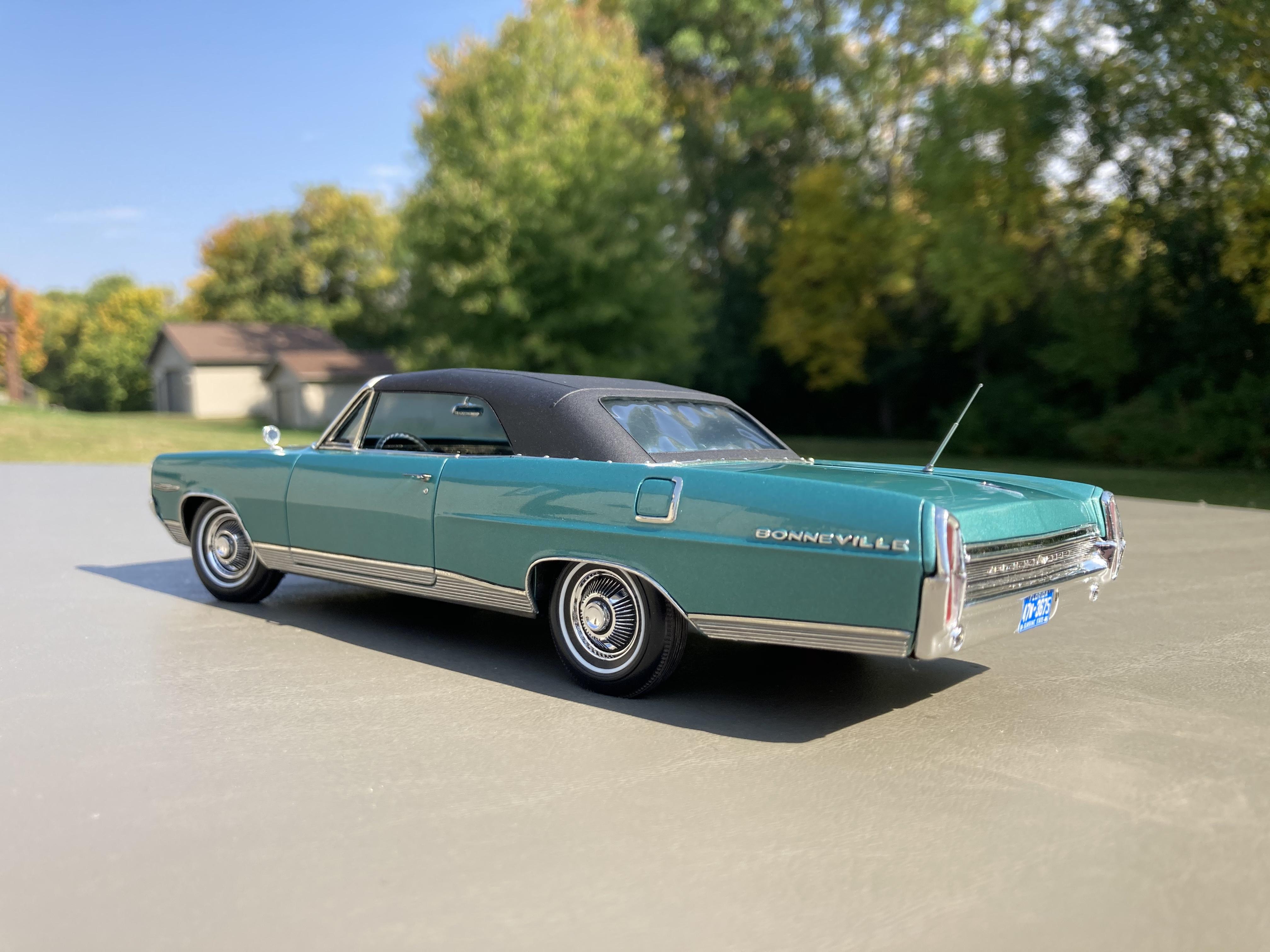

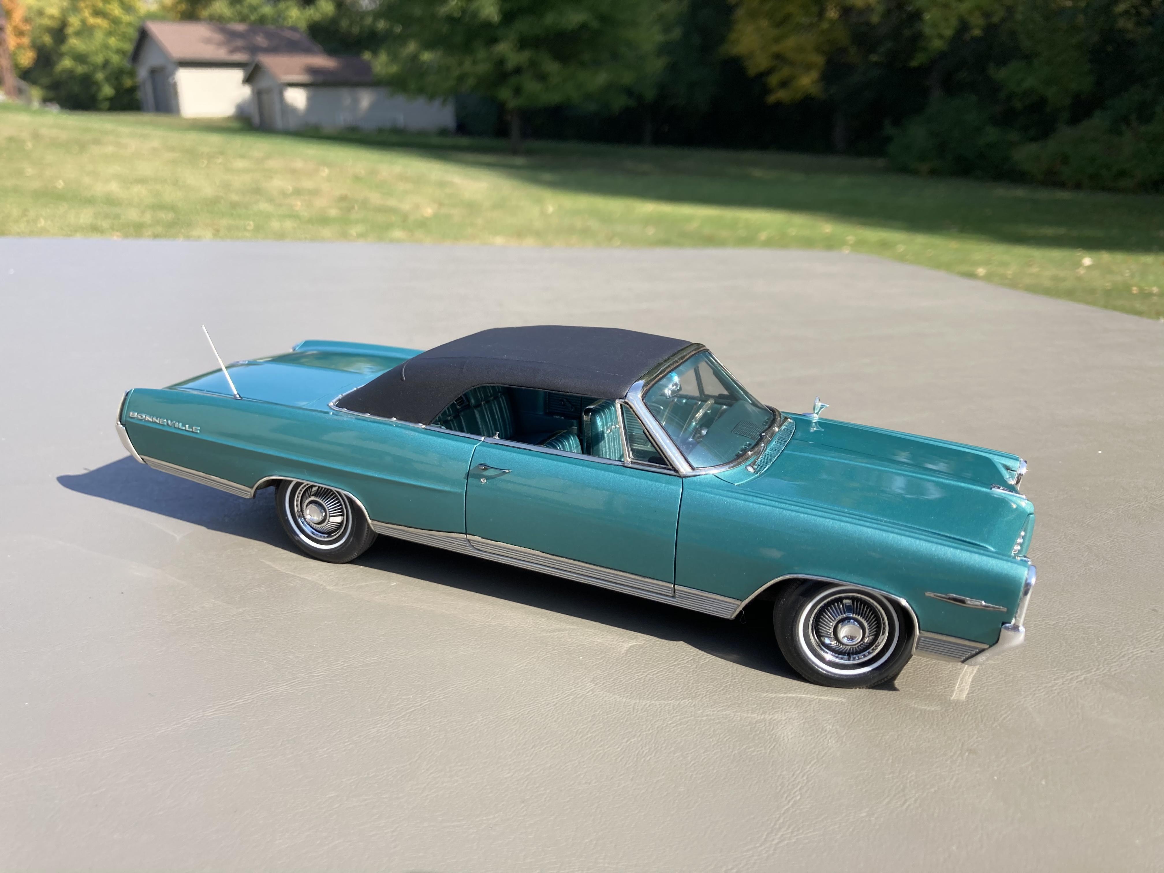

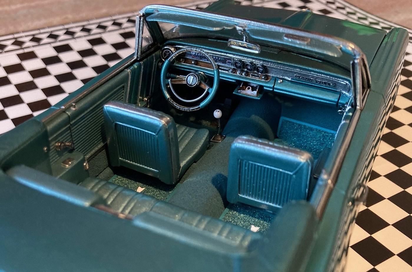

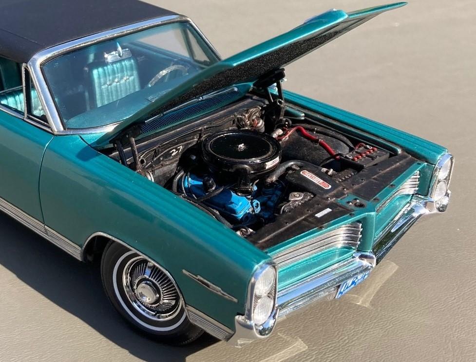

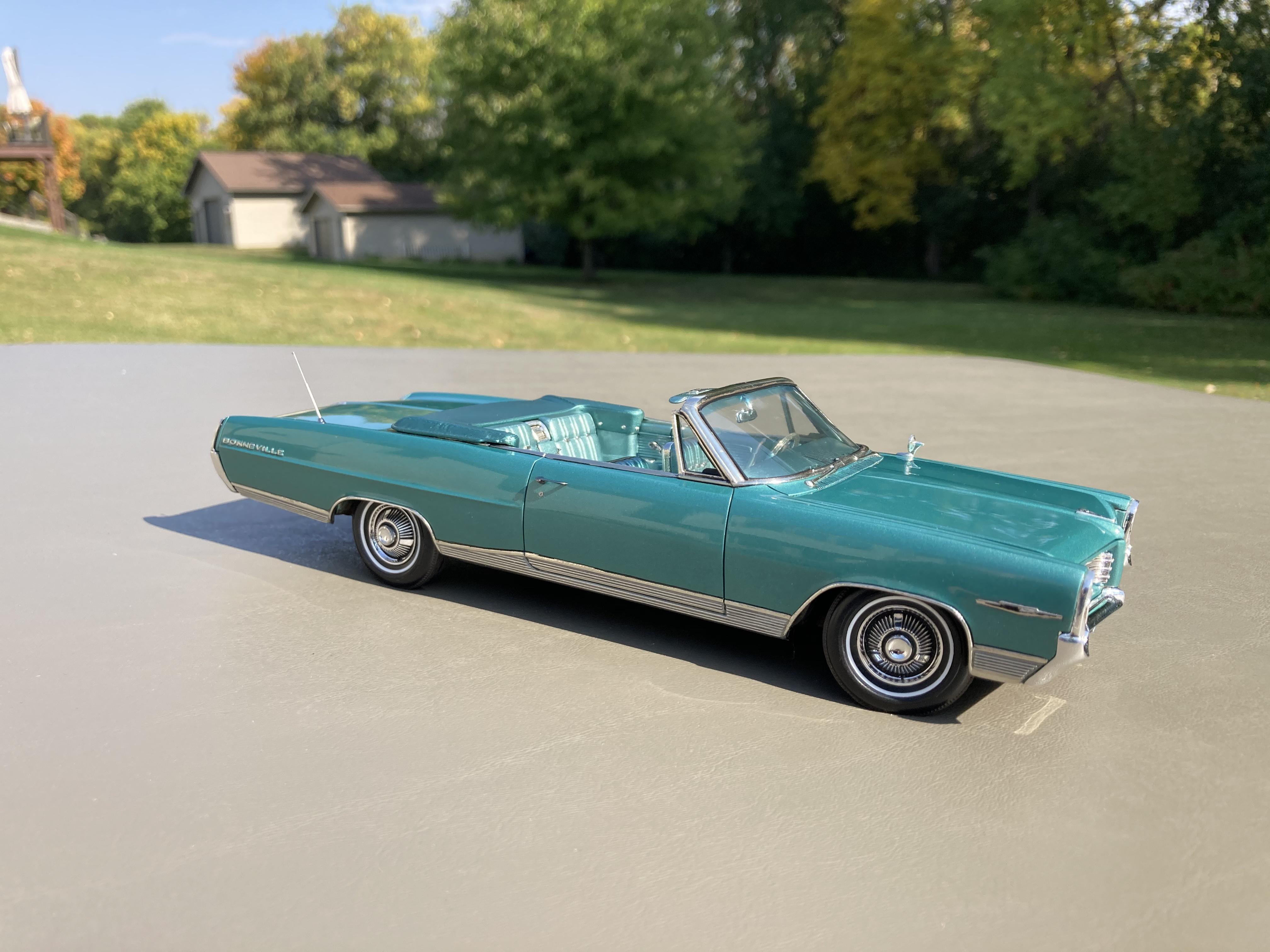

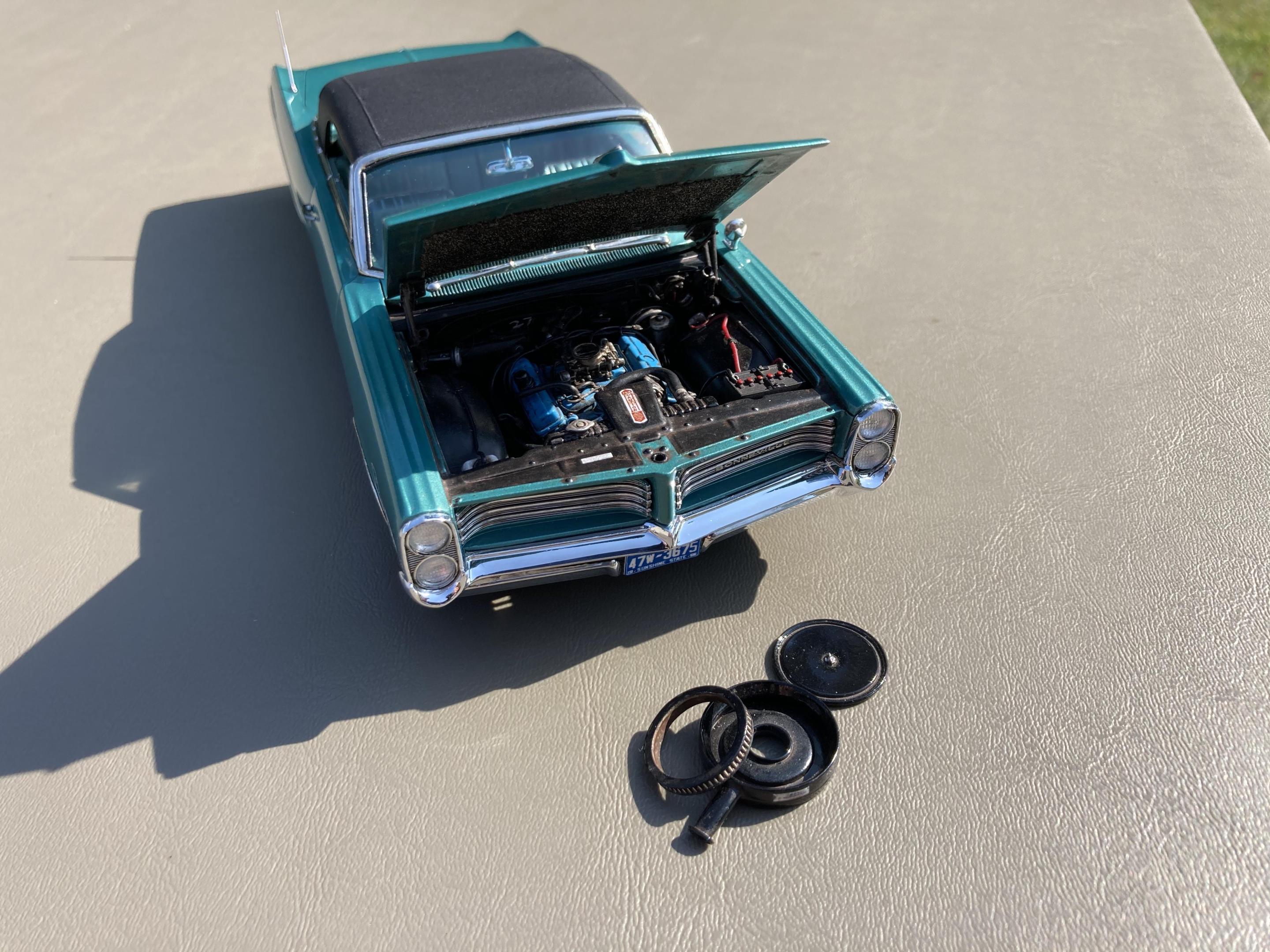

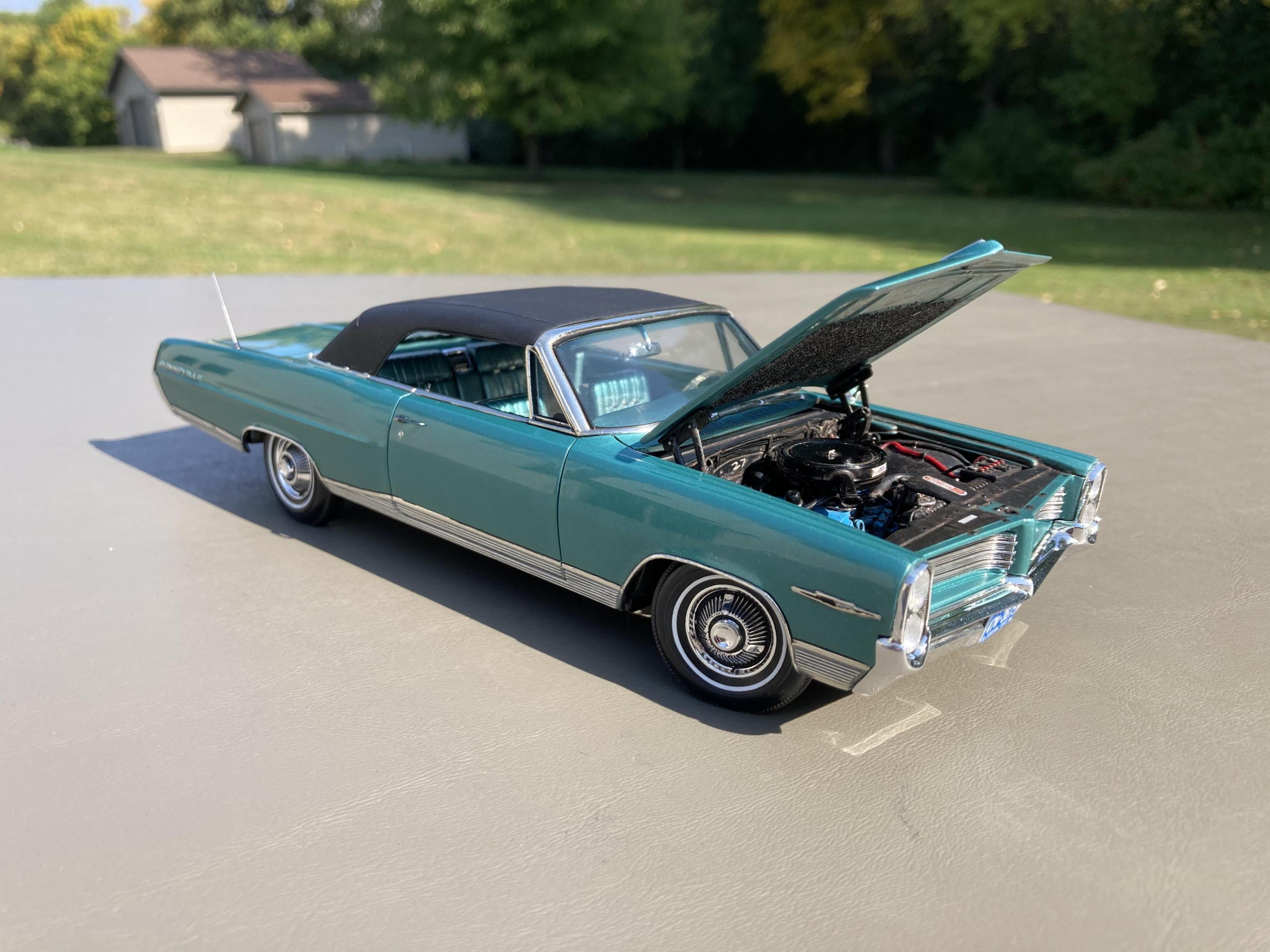

StevenGuthmiller Posted November 8, 2024 Author Posted November 8, 2024 On 11/6/2024 at 10:20 AM, marast78 said: Great tutorial, thanks for sharing! I have a question regarding the model itself though, as it looks quite detailed. Can you share the model brand and what scale it is? OTOH, image of the second model from bluestringer seems like a disassembled pre-made model, but I can be wrong of course. P.S. And sorry for necro-posting. The model is an AMT 1964 Pontiac Bonneville annual kit that has been highly augmented using an array of different parts from other kits, as well as scratch made and a few aftermarket parts. Almost every part has been either modified or replaced. This is what the kit looked like prior to beginning the project. And the finished piece. Steve 5
marast78 Posted November 8, 2024 Posted November 8, 2024 What can I say, this is just stunning work! I don't know how much time this took, but to me it screams dedication and love for doing things. I also adore how perfectly the roof fits around the top of the windshield/A-pillar area. And as I understand it from the pics, the doors don't open, but you made it look like there are shut-lines visible in the interior? Very cool. I am just returning to modelling after many, many years and things like this are inevitably a form of catalyst to actually do something 'more heavy', so to speak. Well, only that these days I also need glasses for the stuff I like doing the most - details. Those many years ago I used enamels, but I just prefer acrylics today, partly because I don't have a dedicated well ventilated room and partly because it's also on one hand perhaps a bit more difficult do some things (like wash), but on the other I don't need to wait several hours to continue. But since you used acrylics in the tutorial, did you use it for the chrome parts, e.g. around the windshield? I don't know of any good chrom-like paints that would also be useable with a brush. I have Tamiya's 'chrome silver', but even though it can be used for some things, it's far from ideal. Revell's chrom spray is quite good, but expensive and not for a brush. Anyway. Awesome work and pics, thanks!
