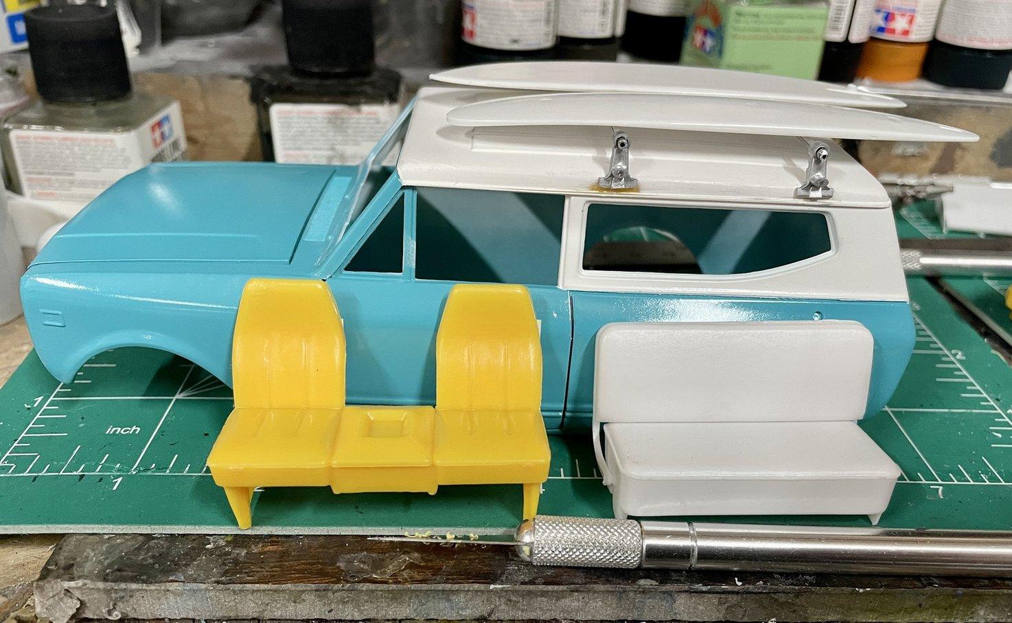

Jonathan Posted August 9, 2023 Posted August 9, 2023 *warning* I am a painfully slow builder, easily distracted by the next project My Brother-in-Law gifted me the AMT/ERTL Scout II for Christmas last year (2022). If you're familiar with the kit, it's pretty simple. But, there's no other Scout kit available to my knowledge. I was happy to get it. Right out of the gate, I knew that the very minimum thing I would do would be to fill the large gaps between the chassis and the body. In picking a color, decided to go with Tamiya's Coral Blue With a white top: I had this surf rack from some old Japanese detail set that I picked up years ago. I think this Scout is Beach Bound! I also shaved the door handles and plan to use Fireball's GM Truck handles. More to come. I hope .... 9

Jonathan Posted August 10, 2023 Author Posted August 10, 2023 Taking a clue from Dennis Ezmerlian's beautiful Scout II build and Tom Geiger's comments, I'm going to attempt to create a more pedestrian seat for my Scout using parts scavenged from an old Chevy. But, as noted, I'm a slow builder and this will probably have to wait until tomorrow or this weekend. The seat option given in the kit is a little too "sporty" for what I have in mind. 2
espo Posted August 10, 2023 Posted August 10, 2023 18 hours ago, Jonathan said: Taking a clue from Dennis Ezmerlian's beautiful Scout II build and Tom Geiger's comments, I'm going to attempt to create a more pedestrian seat for my Scout using parts scavenged from an old Chevy. But, as noted, I'm a slow builder and this will probably have to wait until tomorrow or this weekend. The seat option given in the kit is a little too "sporty" for what I have in mind. Another seating option might be found in either of the early 1950's Chevrolet or Ford pickup kits. Their interiors were mostly exposed painted metal and seating that you wouldn't want to drive more than a couple of hours on. Think of a very industrial and rugged type vehicle, along the order of a Blacksmiths Anvil. They were built to last, and they usually did. Just not built for the comfort that many take for granted even for the time. These were products of a company that built Farm Equipment, so they understood building a durable vehicle.

Jonathan Posted August 18, 2023 Author Posted August 18, 2023 (edited) It seems that August is pretty busy with everything except being at the workbench. That said, I did manage to cobble together a 2/3 split bench seat for the Scout. An AMT 1955 Chevy pickup donated it's seat to the cause. One cut and a few odd bits of styrene later, and we have the basic seat. Edited August 19, 2023 by Jonathan 4
