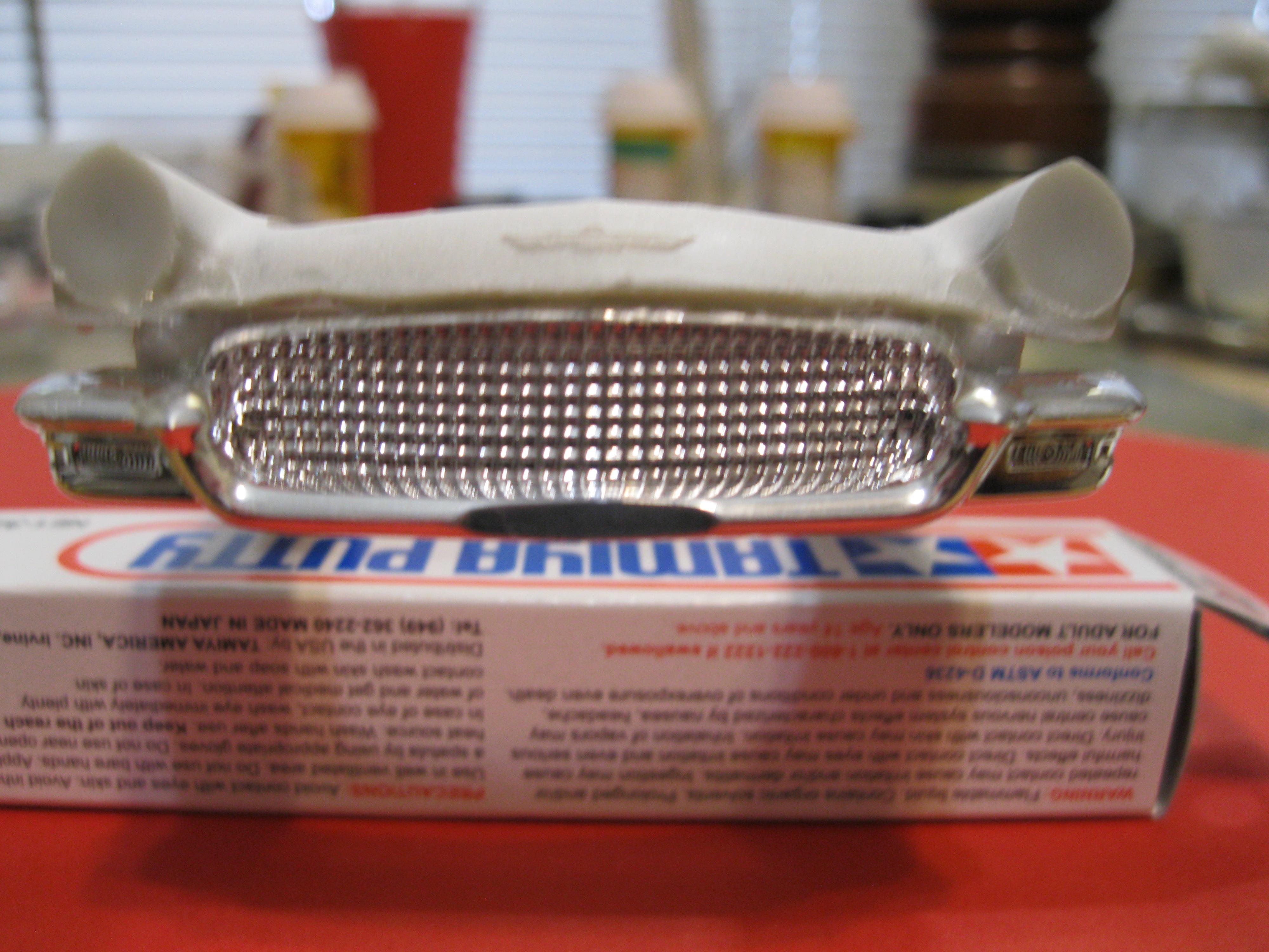

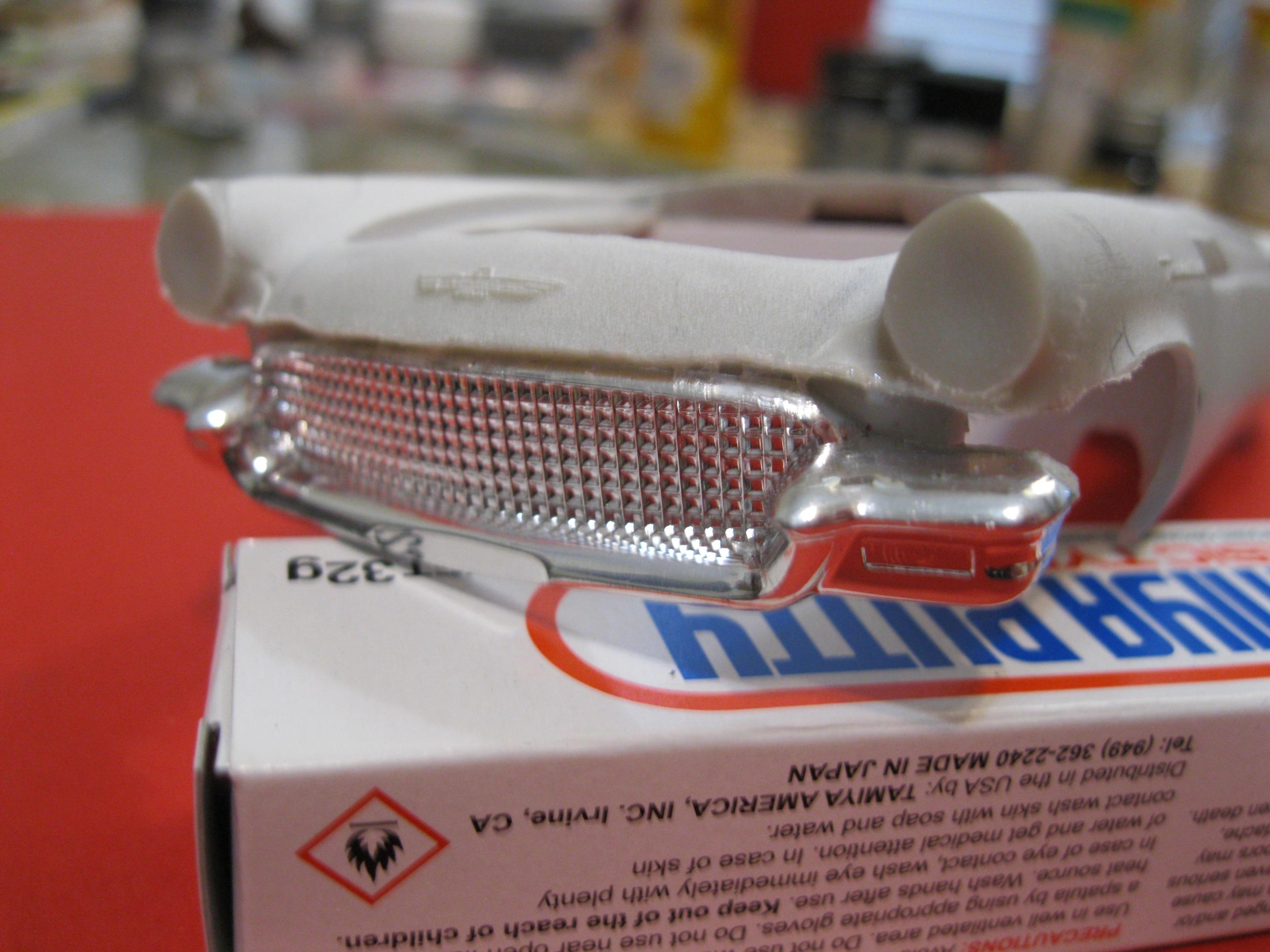

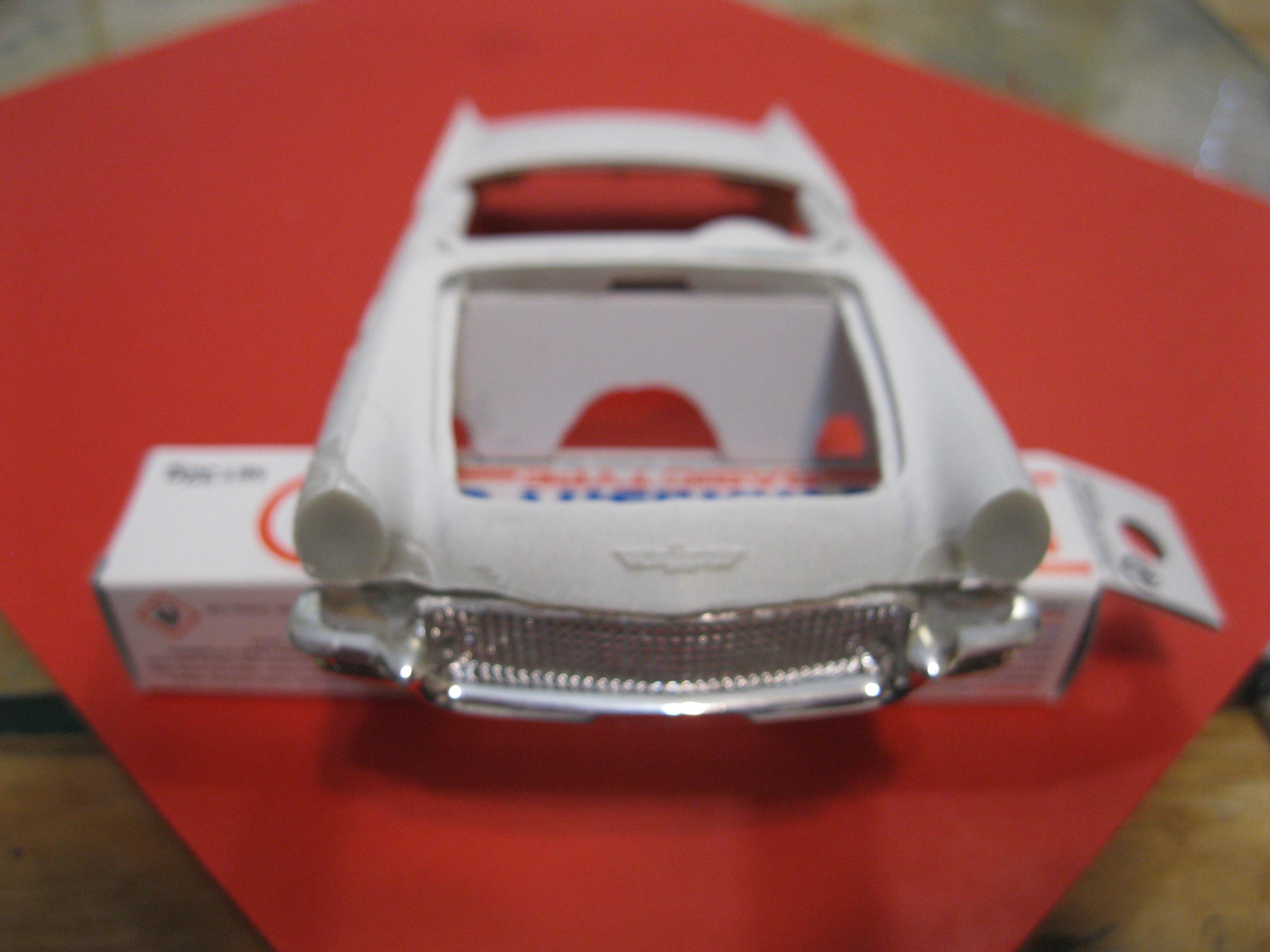

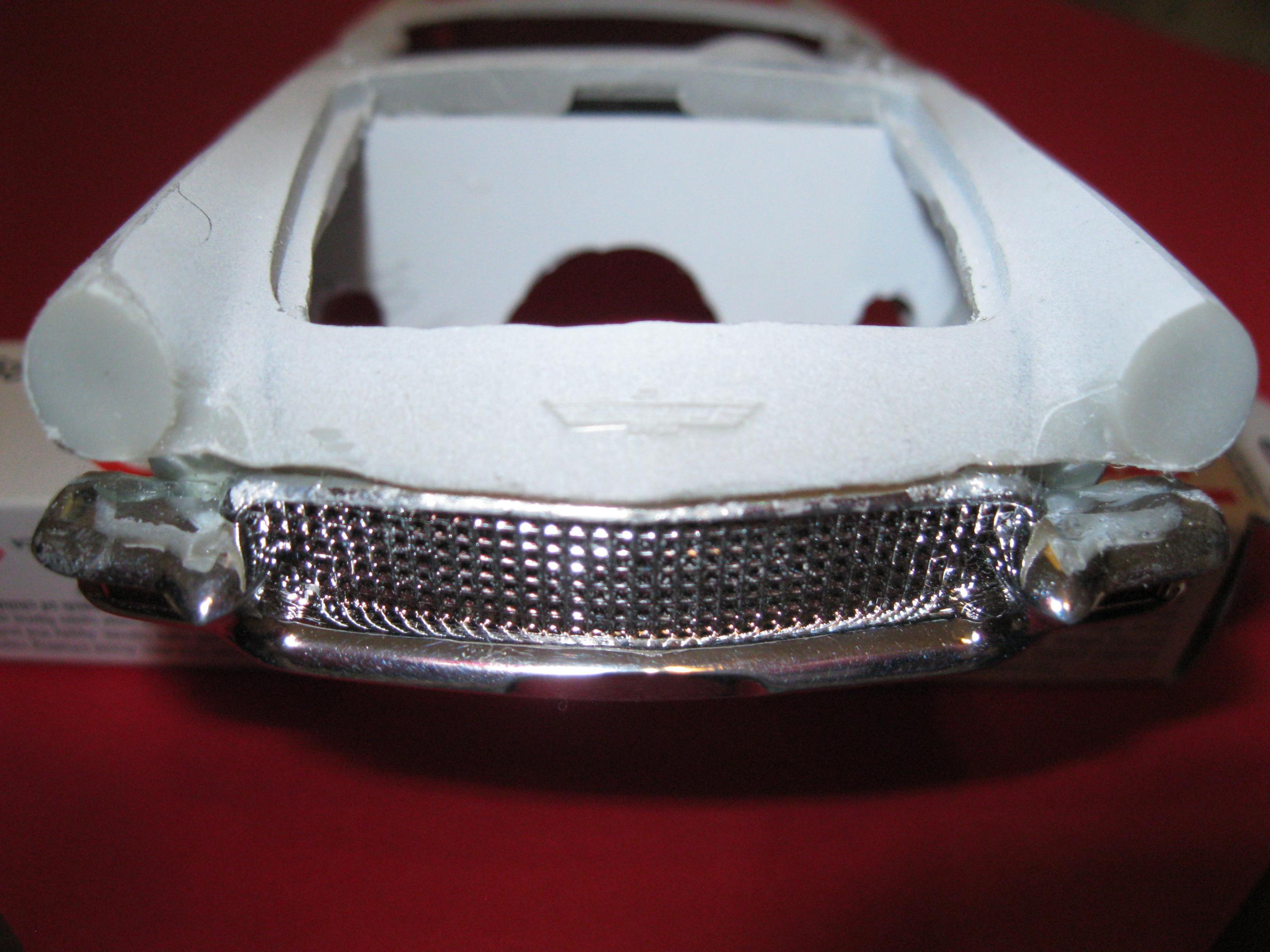

fiatboy Posted August 13, 2023 Posted August 13, 2023 So: anybody ever build this critter? Well I have. The fit of the front chrome grille/bumper is pretty bad. I 'took' my Dremel grinder to it for about a 1/2 hour, both on the body and the chrome piece. See for your self. I'm sure a bunch of you folks could have done better. I really did not fit the piece: I used epoxy and just held it in place (for another 30 minutes)! Go ahead, you try! The '57 is one American classic for sure, but the kit is not so hot. The '57 was a one-year-only design.

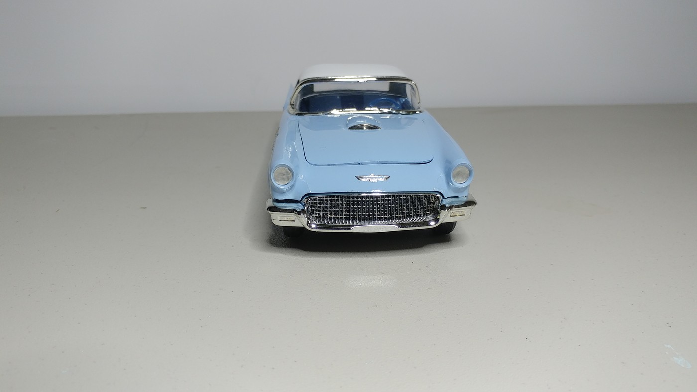

JollySipper Posted August 13, 2023 Posted August 13, 2023 Yea, we really need a nice kit of the '57 Thunderbird! One of the more iconic cars from the '50s..... Here's mine I built a couple years ago........

fiatboy Posted August 14, 2023 Author Posted August 14, 2023 Mr. sfhess: I am deeply offended that you think my build, if it can be called that, is a glue bomb. I'll have you know that I am putting a shortened NASCAR chassis under it, and a 1/25 scale Ford Cammer engine. Thus I cut away all the underhood 'stuff', like the inner wheelwells and the radiator. So there was really nothing to attach a new radiator to, or for that matter, the chrome front assembly. I do apologize for the mess I photographed. I will publish more photos - maybe.

Dave Darby Posted August 14, 2023 Posted August 14, 2023 On 8/12/2023 at 9:04 PM, fiatboy said: So: anybody ever build this critter? Well I have. The fit of the front chrome grille/bumper is pretty bad. I 'took' my Dremel grinder to it for about a 1/2 hour, both on the body and the chrome piece. See for your self. I'm sure a bunch of you folks could have done better. I really did not fit the piece: I used epoxy and just held it in place (for another 30 minutes)! Go ahead, you try! The '57 is one American classic for sure, but the kit is not so hot. The '57 was a one-year-only design. I hate to disparage another modeler's work, but having built a few of these, I know for a fact that the grille/bumper fit isn't *that* bad. The ProShop pre-paint in a previous post bears that out. It does appear that you ground away a significant amount of the body that surrounds the grill. I built my first one when I was 12 or 13 and had zero fit issues. The newer issues fit together just as well. At this point I'd leave the assembly off and make it a gasser. 1

Sledsel Posted August 17, 2023 Posted August 17, 2023 What needs trimmed is the bumper below the headlights. The fenders extend behind the bumper. 2
fiatboy Posted August 19, 2023 Author Posted August 19, 2023 You're absolutely right, Dave. Other people did not seem to have any trouble fitting the grille/bumper. And Scott, I was just trying to "make a funny". I appreciate the photos of other builds of the '57 T-Bird. They look great. And if worse comes to worse, I could just buy another kit. Thanks for commenting. 1

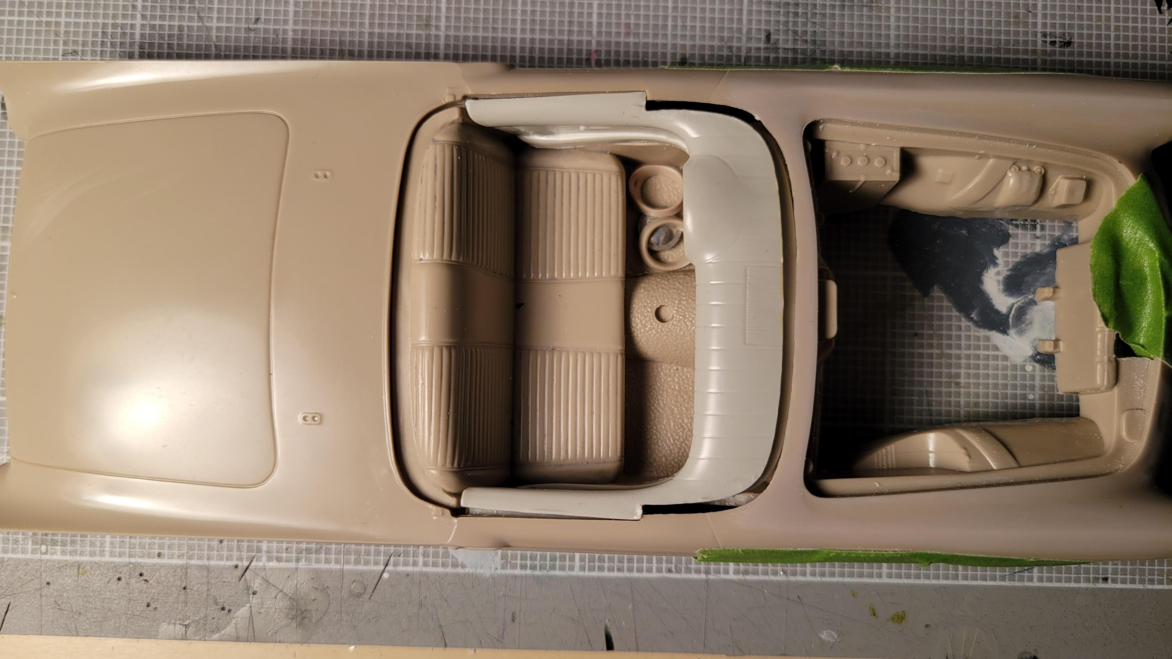

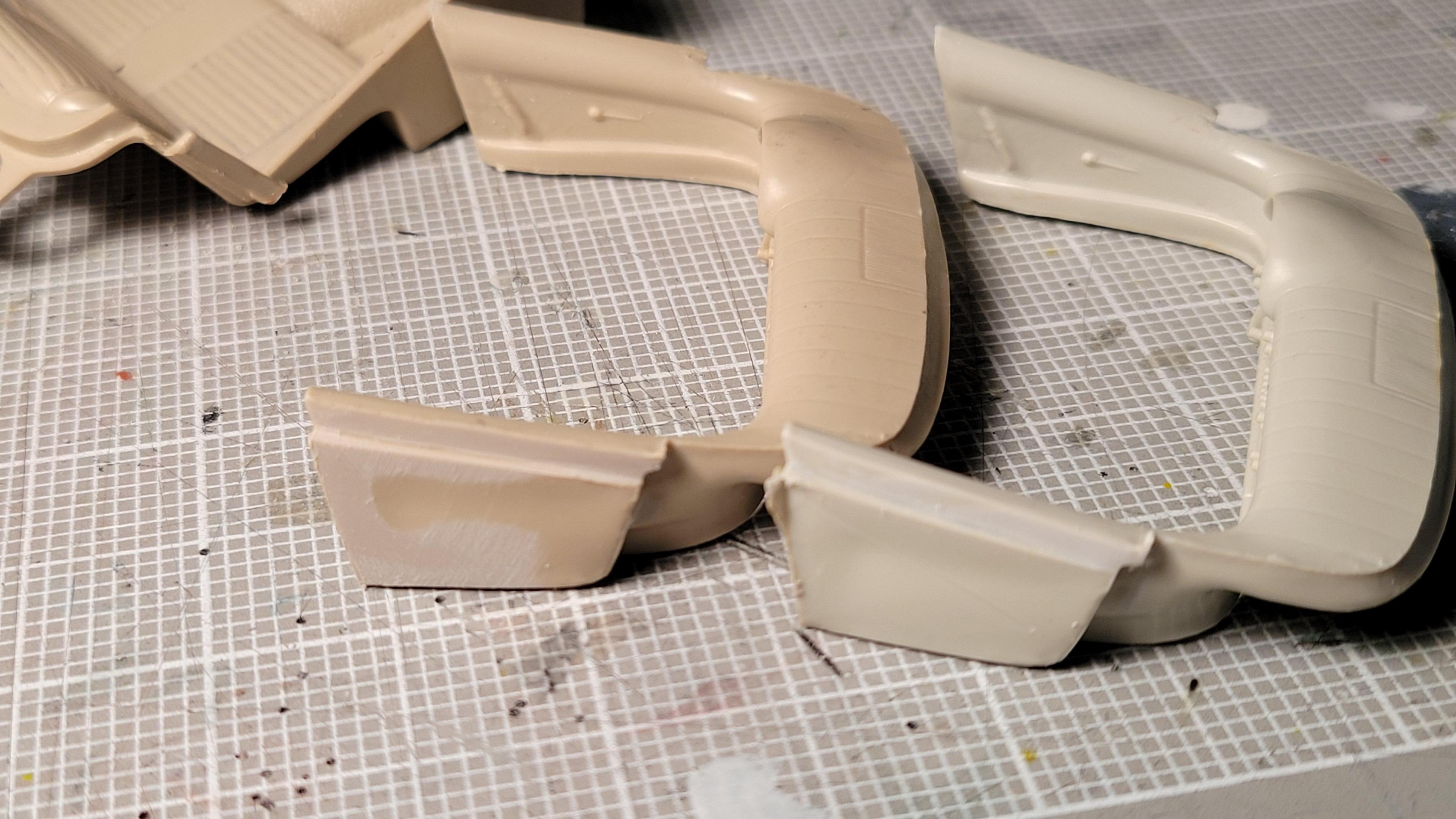

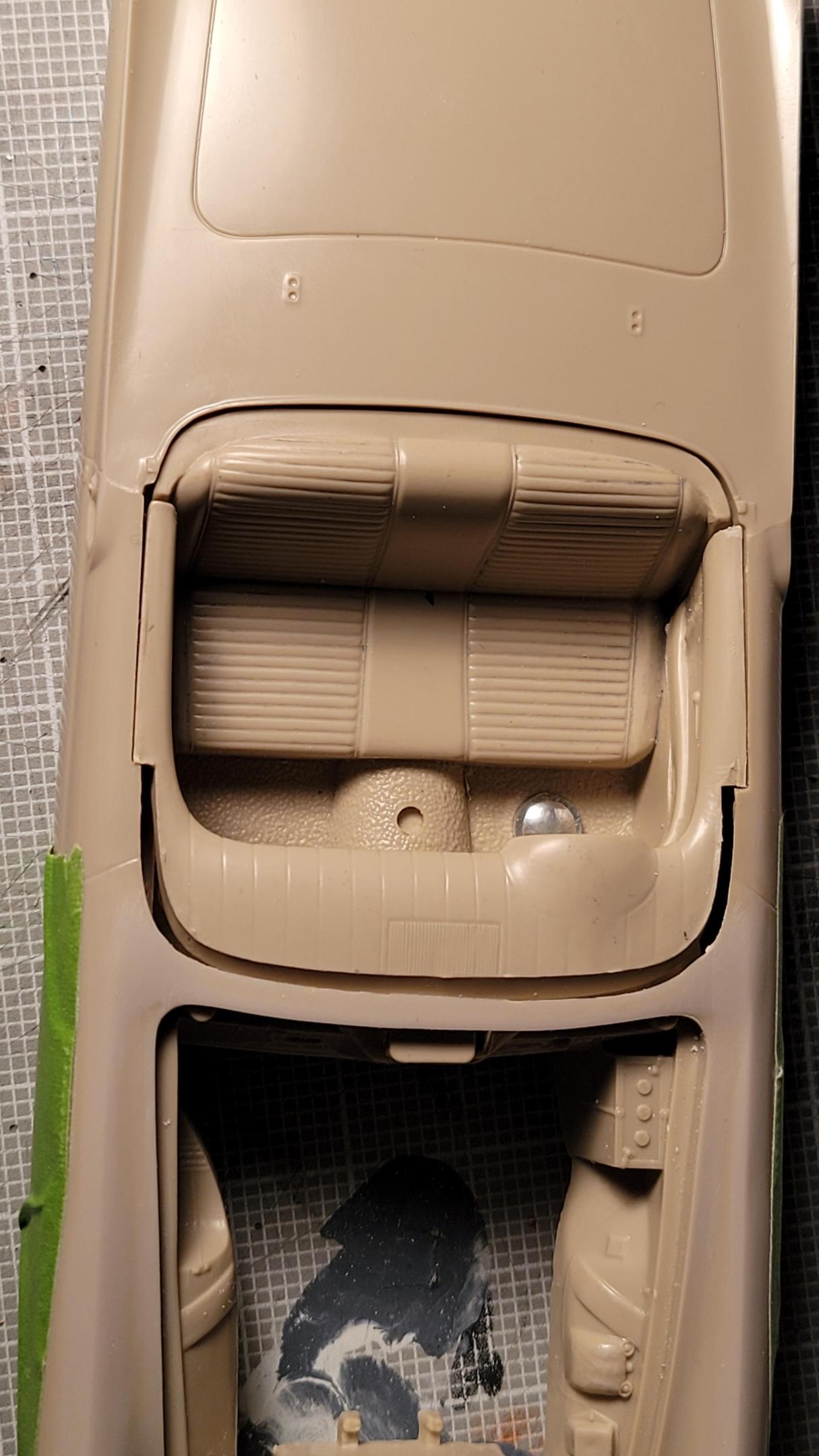

Dave Darby Posted September 2, 2023 Posted September 2, 2023 (edited) On 8/31/2023 at 9:49 PM, fiatboy said: I went and bought a new kit. I'm grateful for all the comments. I'm actually playing with one right now, and I think the biggest problem child fit-wise is the interface between the dash/upper door panel unit and the body. It fits into the notches at the top of the doors. It might take a little filing on the ends to fit into the notches. Also the lower rear outsides of the unit are are a bit thick (even after removing the flash), which squeezes it in a bit, not allowing it to expand out to fill the opening in the body. (It fits within a pair of tabs on the rear of the interior bucket.) Take your time test fitting and filing, and the rest should fall together. This is probably AMT'S oldest currently running tool, having been first used to make the original promo models in 1957. Looks like I need to file a little more off on the driver's side so it can come forward a bit on that side. (Note the uneven gap in front of the dash). Edited September 2, 2023 by Dave Darby Clarity
