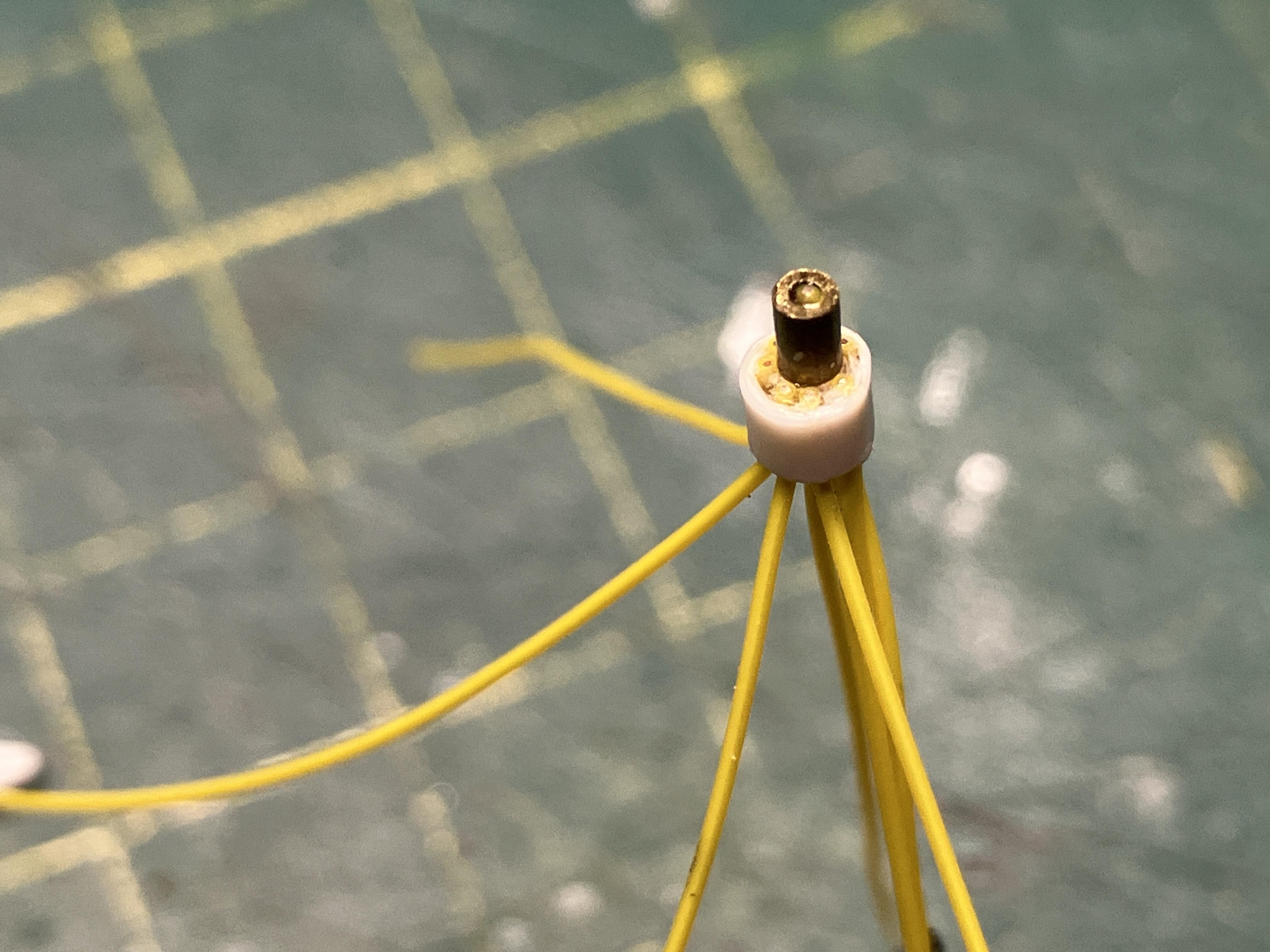

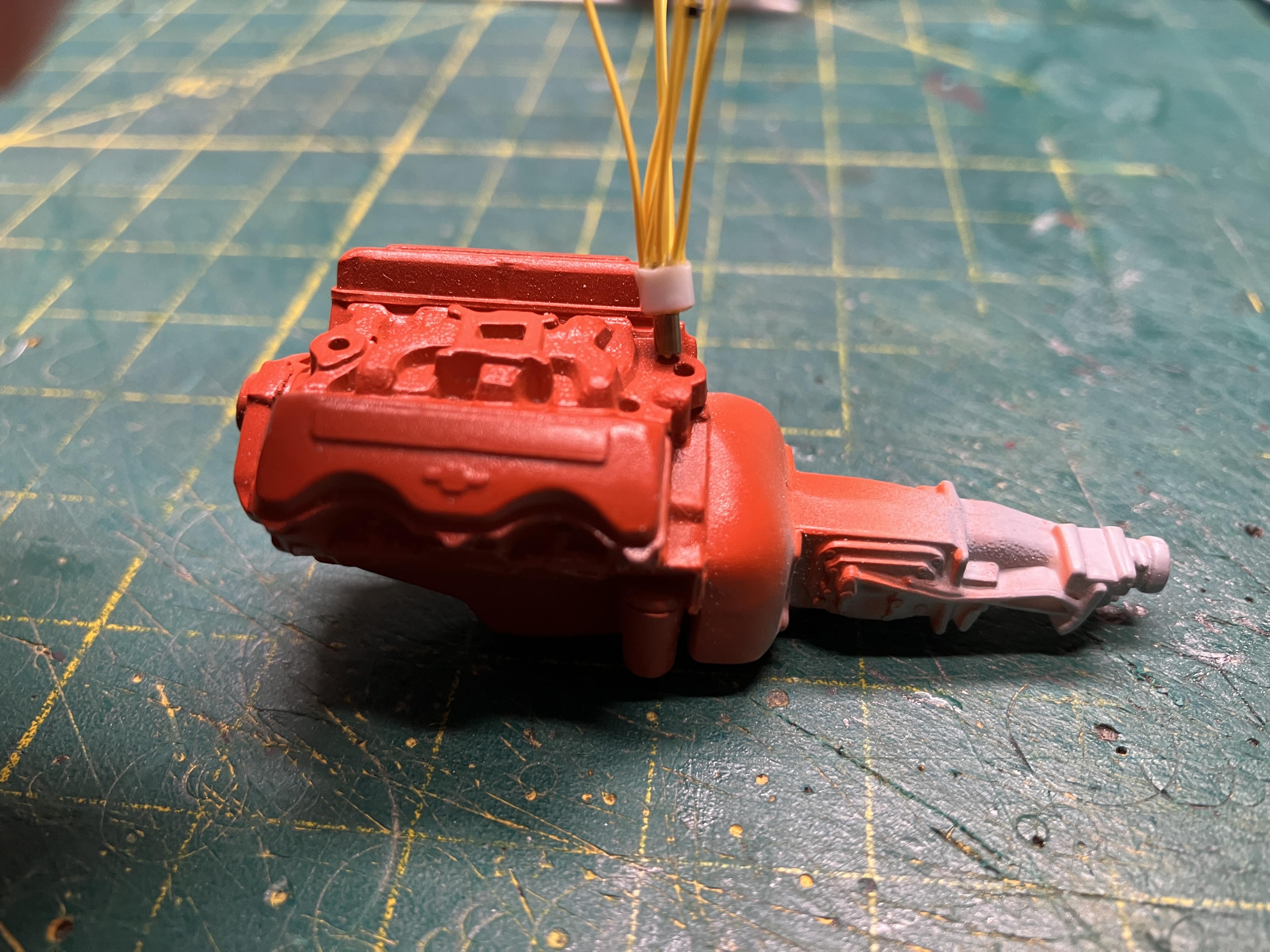

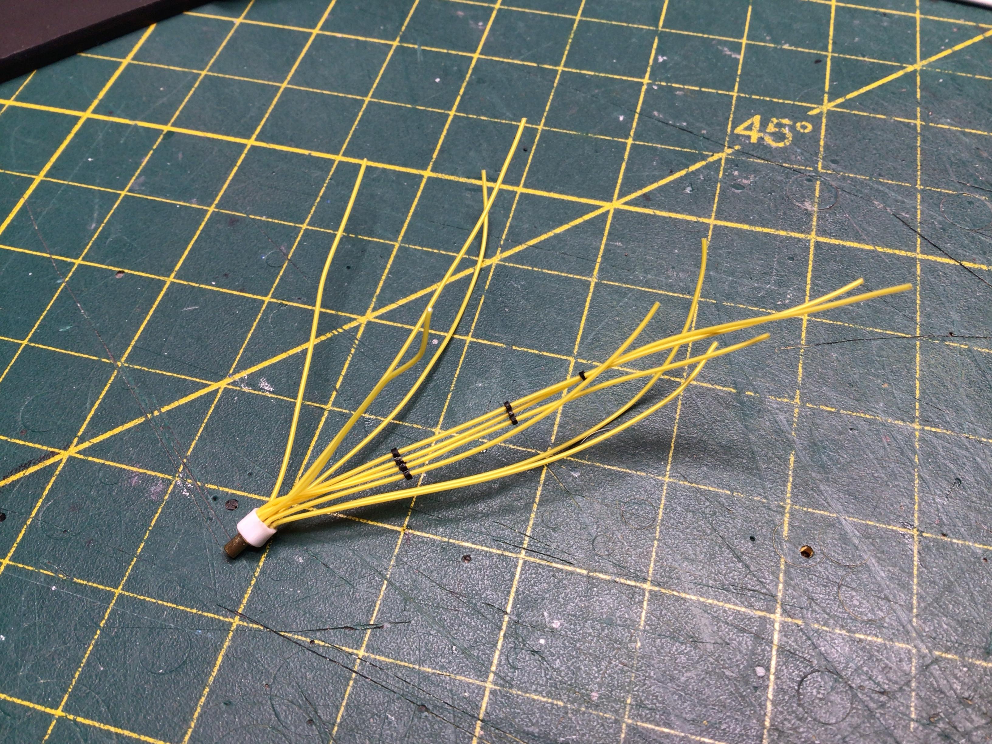

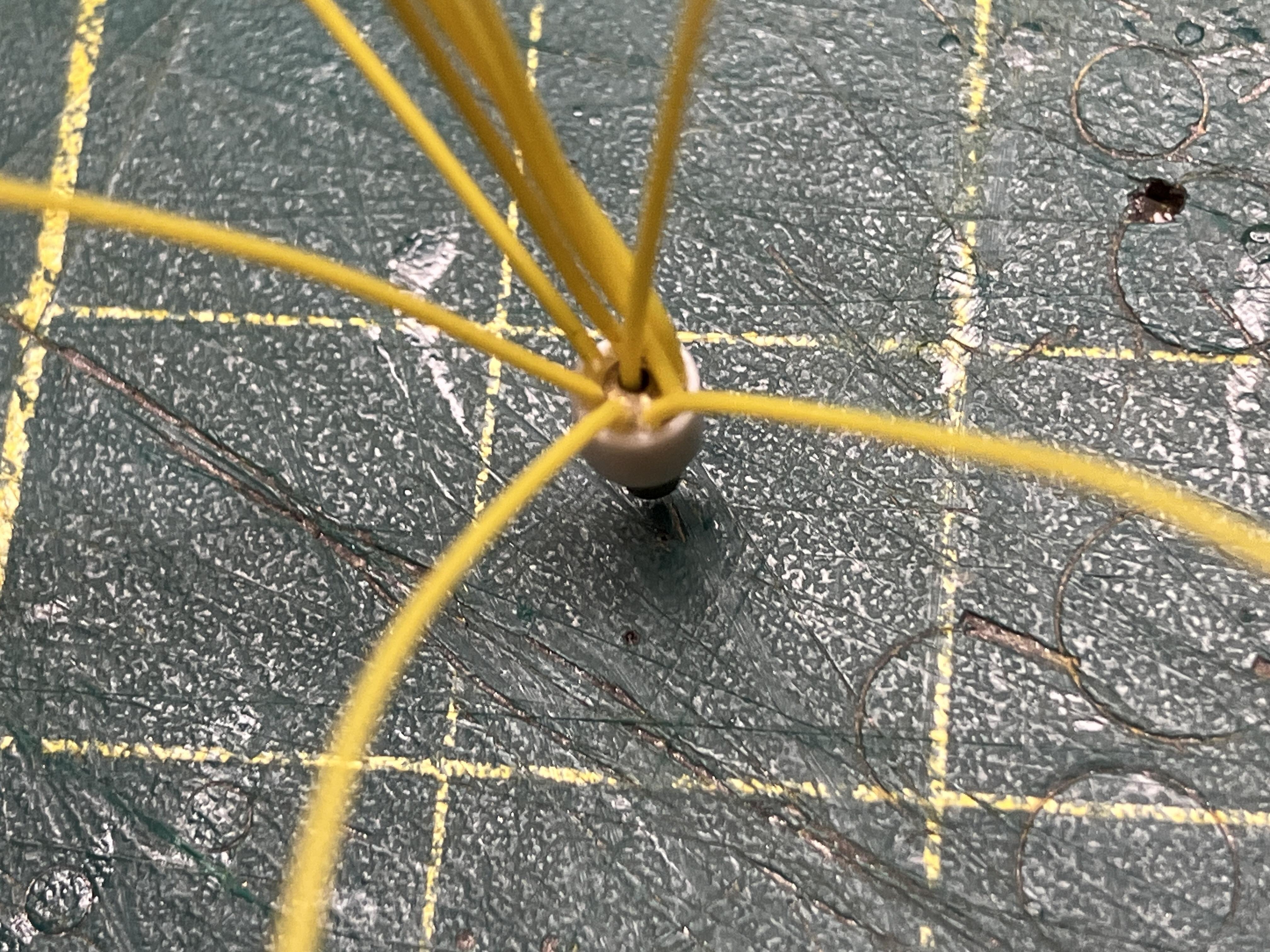

NOBLNG Posted August 16, 2023 Posted August 16, 2023 (edited) I made a similar one using 1/16” brass tube and a piece of 1/8” o.d. x .100” long styrene tube. The wire is .020” diameter and I don’t recall if I reamed the styrene tube or not. Edited August 16, 2023 by NOBLNG 3
bobss396 Posted August 23, 2023 Author Posted August 23, 2023 On 8/16/2023 at 11:26 AM, NOBLNG said: I made a similar one using 1/16” brass tube and a piece of 1/8” o.d. x .100” long styrene tube. The wire is .020” diameter and I don’t recall if I reamed the styrene tube or not. Mine are similar, only with a little ring between the 1/16" and 1/8" pieces. All telescoping aluminum tube. I made 2 to bring to a club meeting last week and gave them away. Like this one from Gofer. The last ones I got were literally breaking in the package. http://www.hobbylinc.com/gofer-racing-wired-distributor-with-boot-red-plastic-model-vehicle-accessory-1:24-1:25-scale-16002?source=froogle&gclid=EAIaIQobChMIuf2nv9rygAMVTPvjBx3Z4wo2EAQYAiABEgKiy_D_BwE VERY flimsy.
